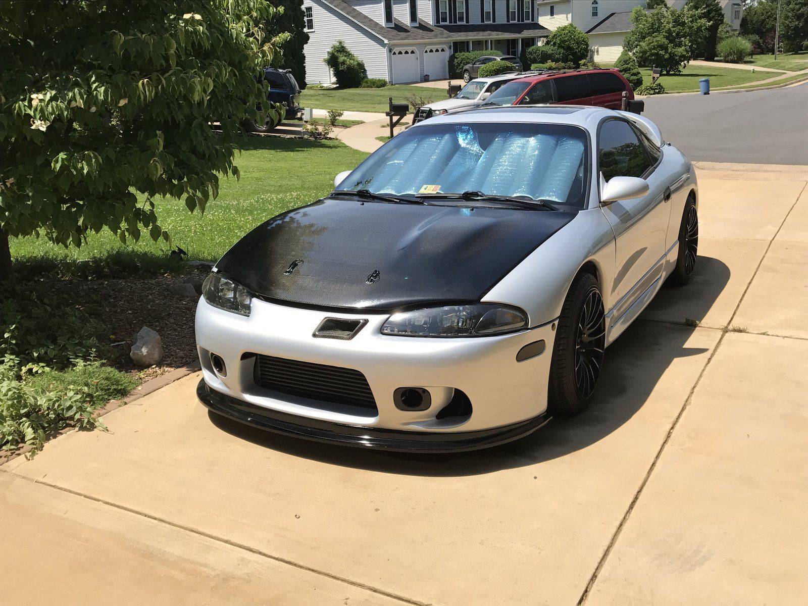

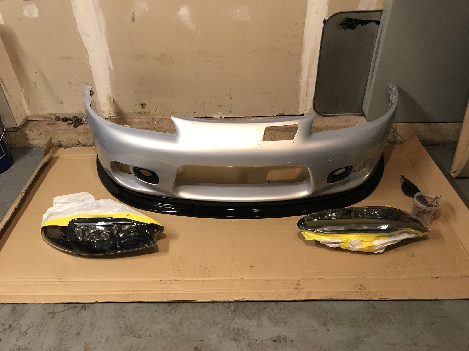

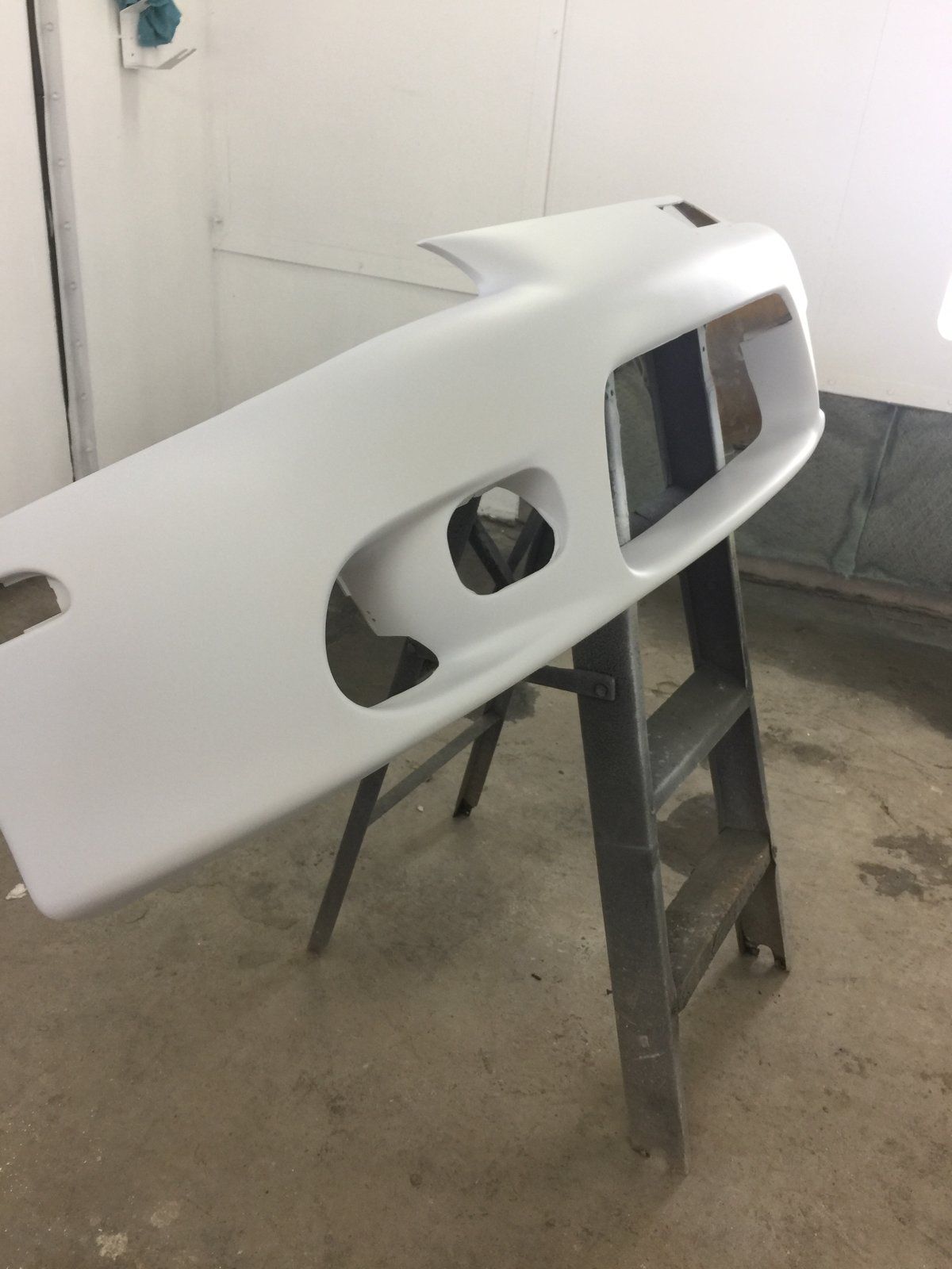

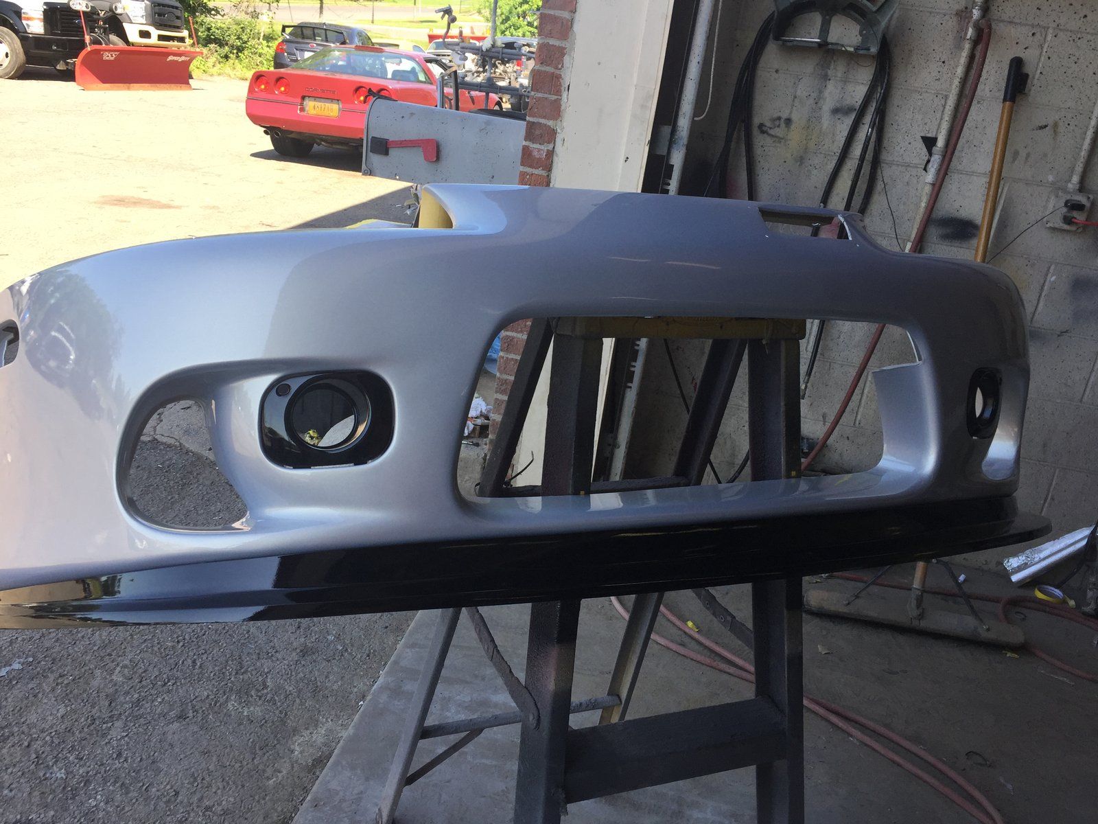

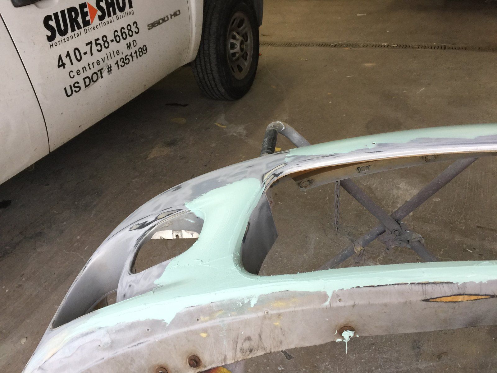

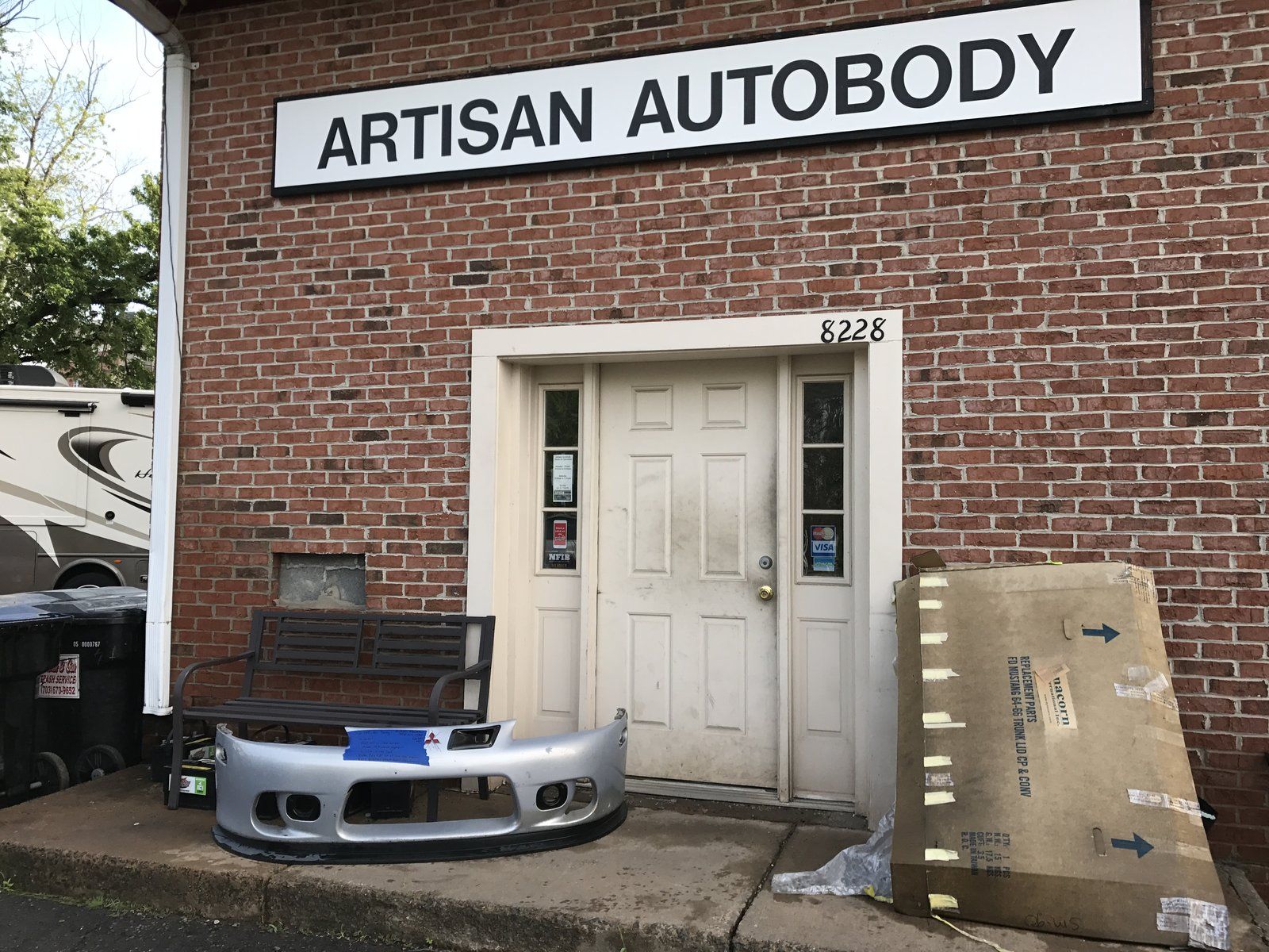

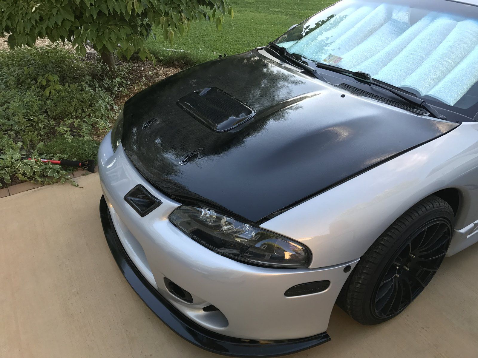

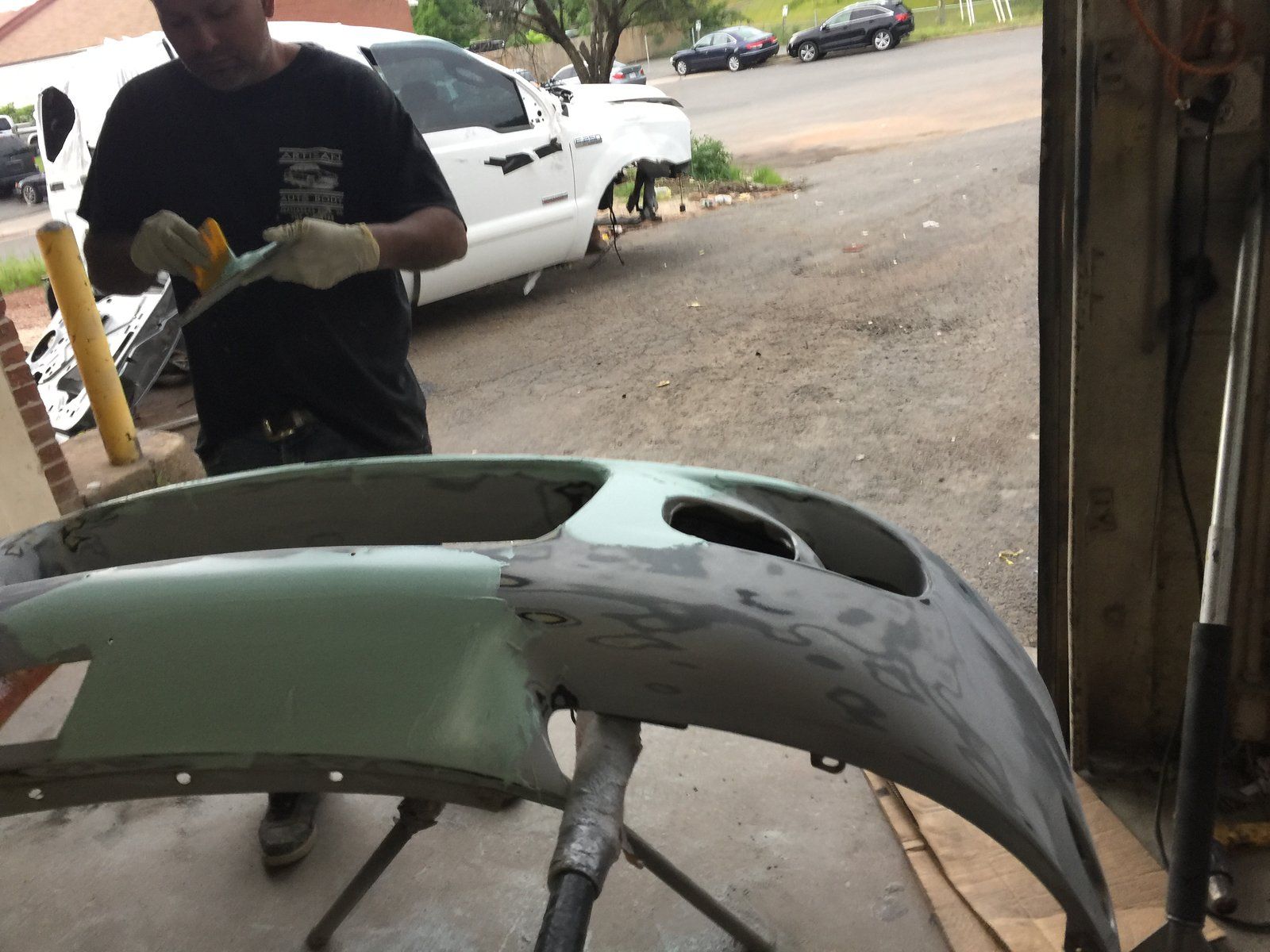

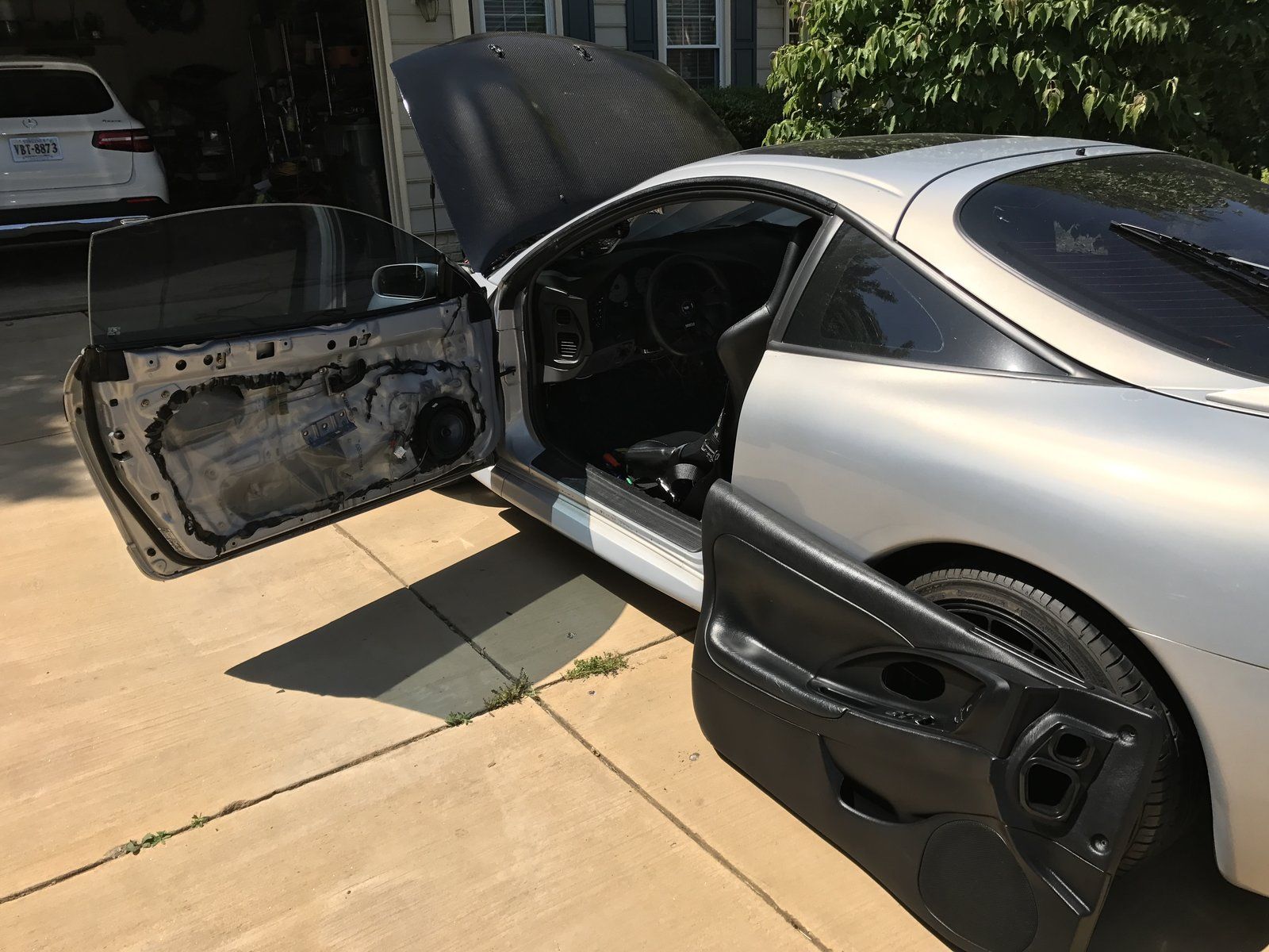

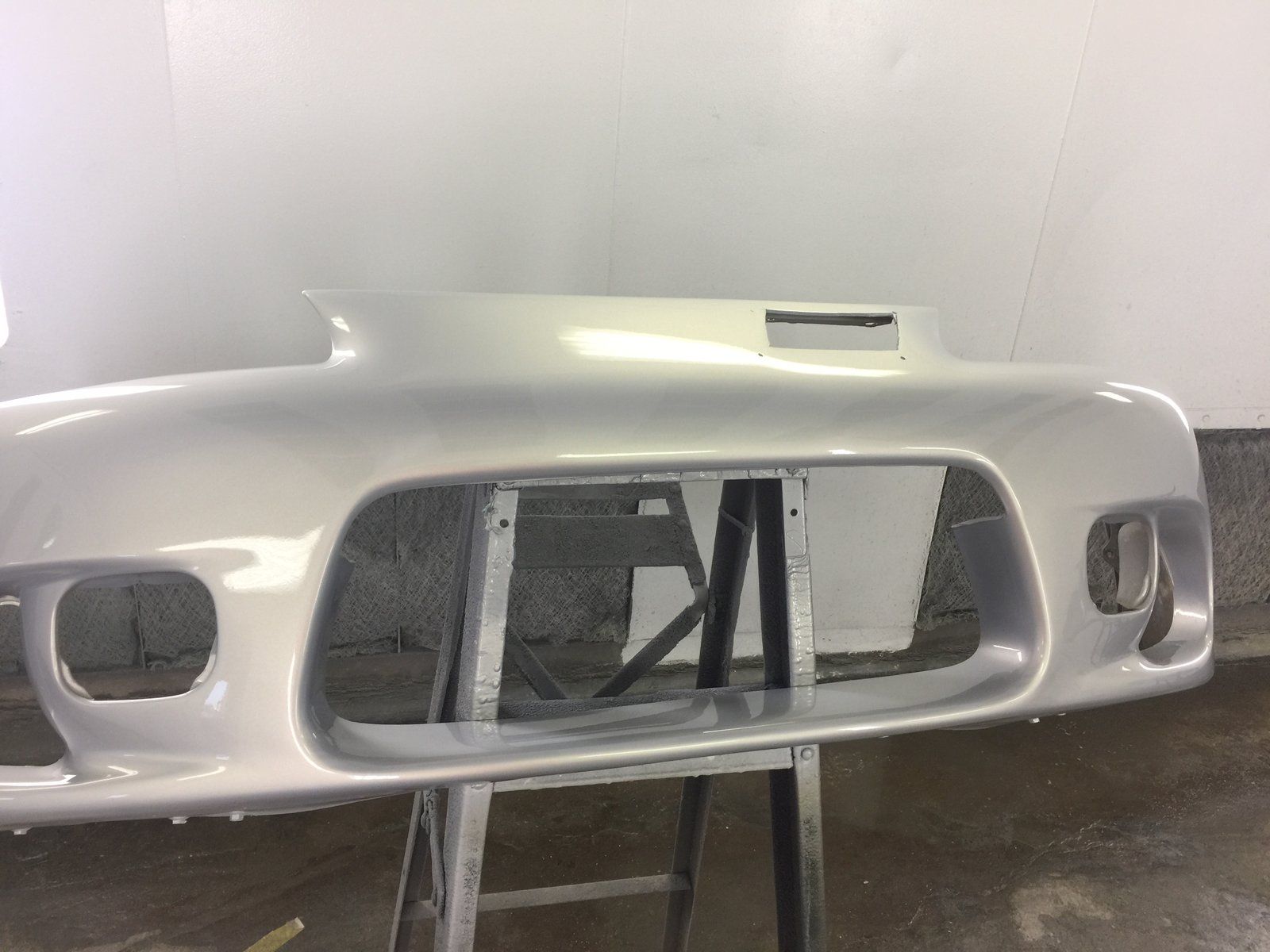

The car is pretty much ready for boxerfest this weekend. I spent a little time Sunday morning washing the car, and putting the headlights and bumper on. I think everything came out perfect. Artisan AutoBody did a great job. Very pleased to be working with them again.

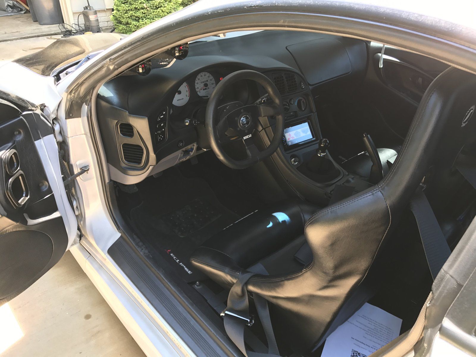

I also pulled the door panels and removed the horrible sounding "kicker" speakers, and re-installed some spare infinity ones I had laying around. I have to admit the infinity sounds system is very impressive for a factory option. Also my buddy Phil came over and reinstalled my double dine and fixed the wiring issues I was having. It is such a relief when everything works in your car.

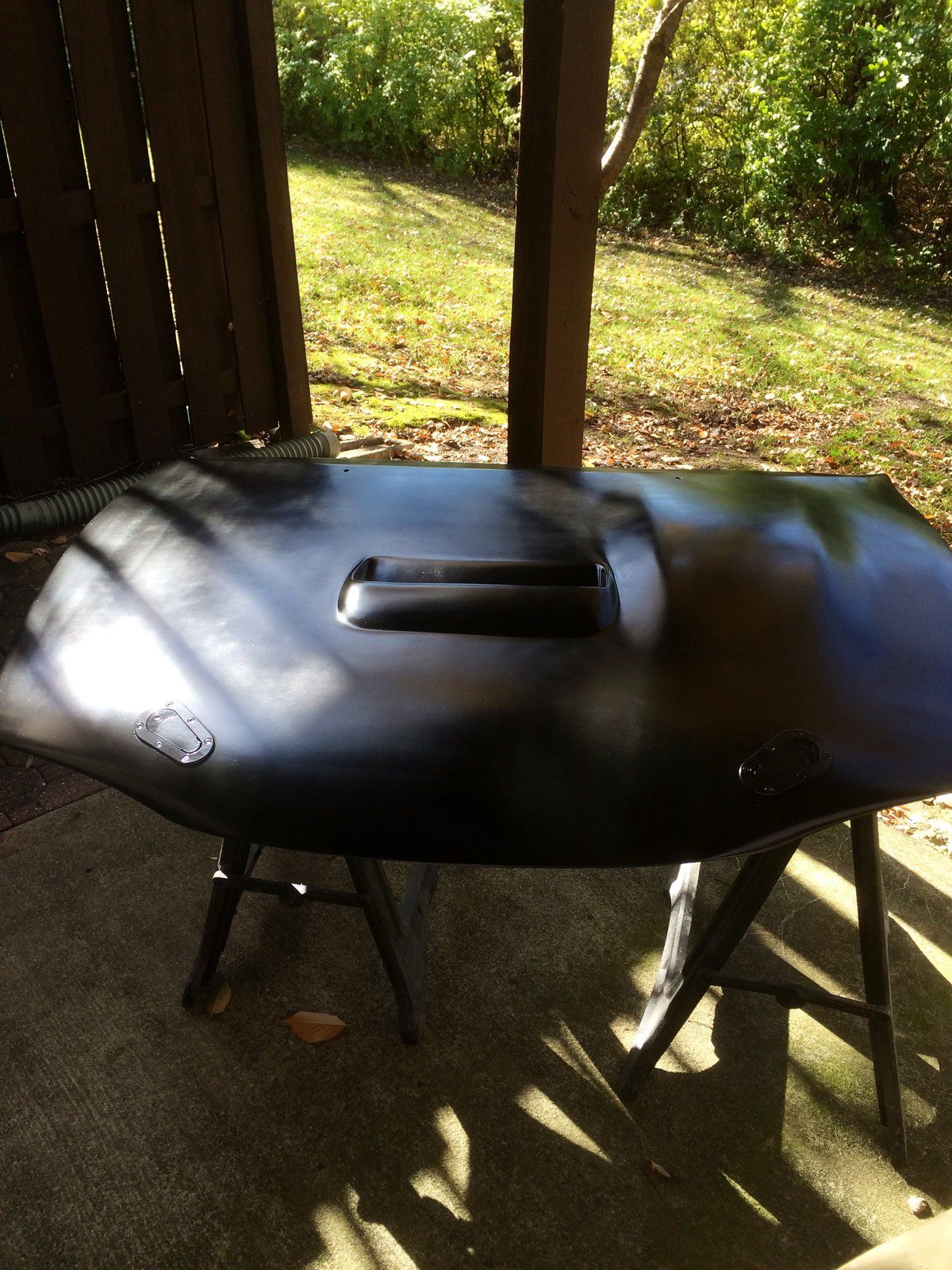

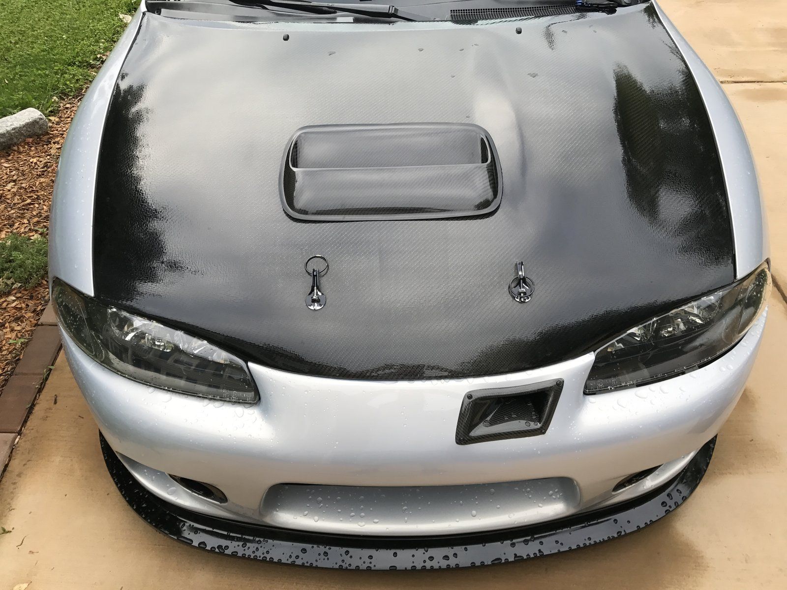

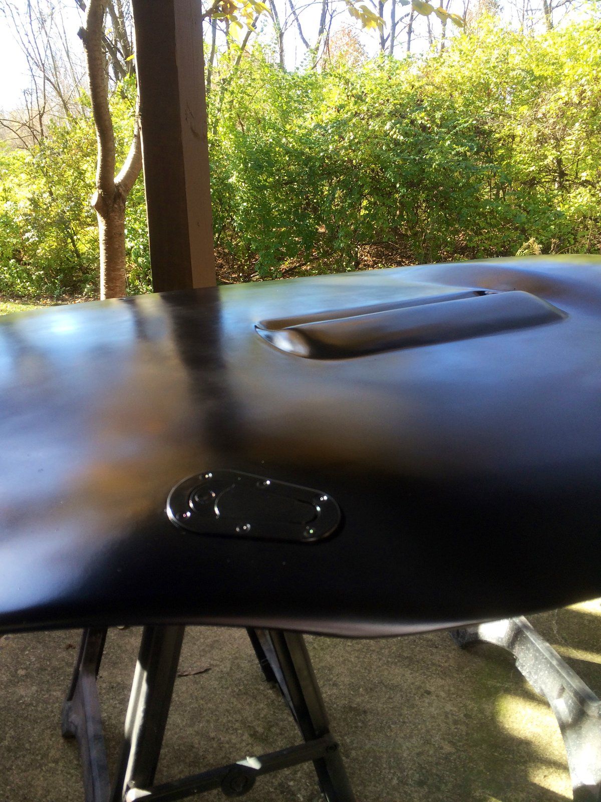

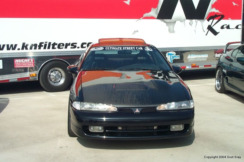

I have that vent, im mounding it into a new hood thats being moulded up for me, so it will be an all in 1 unit for my use when racing and can replace it easier if needed
I like the way they look molded into carbon hoods as well. Unfortunately I'm going to be securing mine with Bolts, and nuts tonight. Just need to get the position of it set just right before i drive my first hole.
Maybe in the future I will mold it in. But I also want the Carbo.netics AB hood as well. Still waiting on my CSL hatch to be completed.

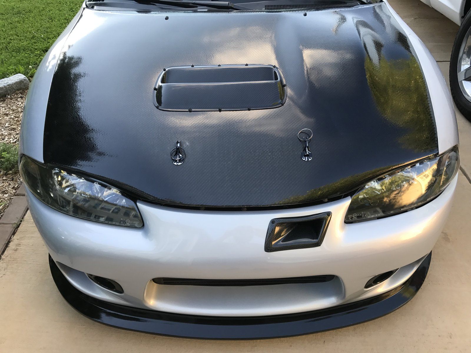

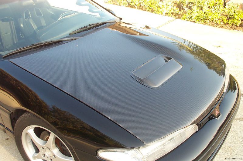

If I saw correctly dsmcrzy has the same vent on his Eclipse so he might be able to chime in. I've been lusting over this vent since I saw it on RRE's website back in 2002, I'm finally to a point where I can actually use it. I'm thinking more along the lines of the 13x10 as opposed to the 18x10, but if I can save some $$$ I'd rather go fiberglass. They used to advertise the fiberglass versions on their site, but if they will still make them to order I remember them being almost $100 less than the CF versions.
Yea I went with the fiberglass 13x10 as that's all they had in stock at the time. I cut it in half and added about 2". So mine is like 15x10. Molded to a VIS carbon fiber hood I picked up for dirt cheap.
I love it. Does a great job just from looking at coolant temps.
Is the vent reversible? My current hood is really crappy and I plan to get a cf in the near future, but I'd still like to install this. Thanks.
Its called reversible because of how we install it on our cars. to Vent air installed of capture it.

I see your vent placement would put your opening right above the valve cover behind the turbo area?
I would think that would be a great spot to pull the hot air off the front area as more air flows through the front.
dsmcrazy.
Correct when I look into the bay through the hood, I look right at my manifold and can see the valve cover just a little. There is a whole carbontrix thread on here that discussed the placement a little. that's basically what I based mine off. I'll see if I can find the thread.

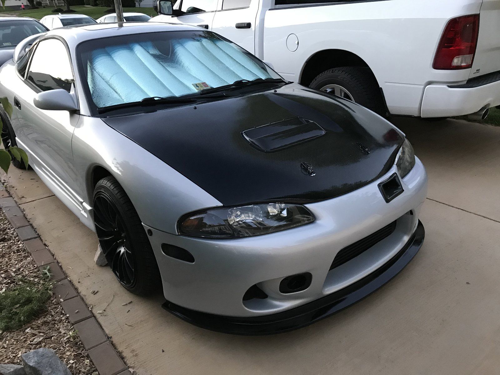

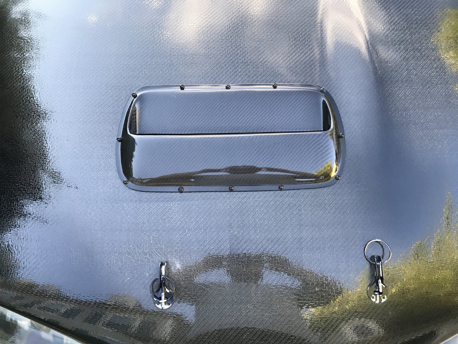

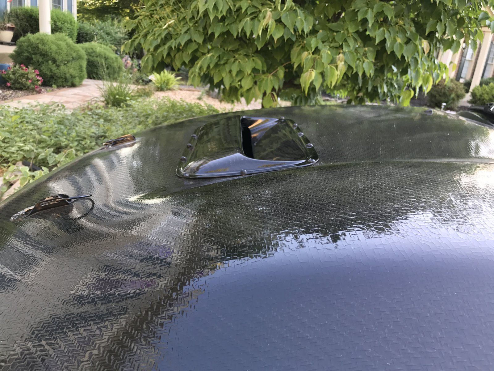

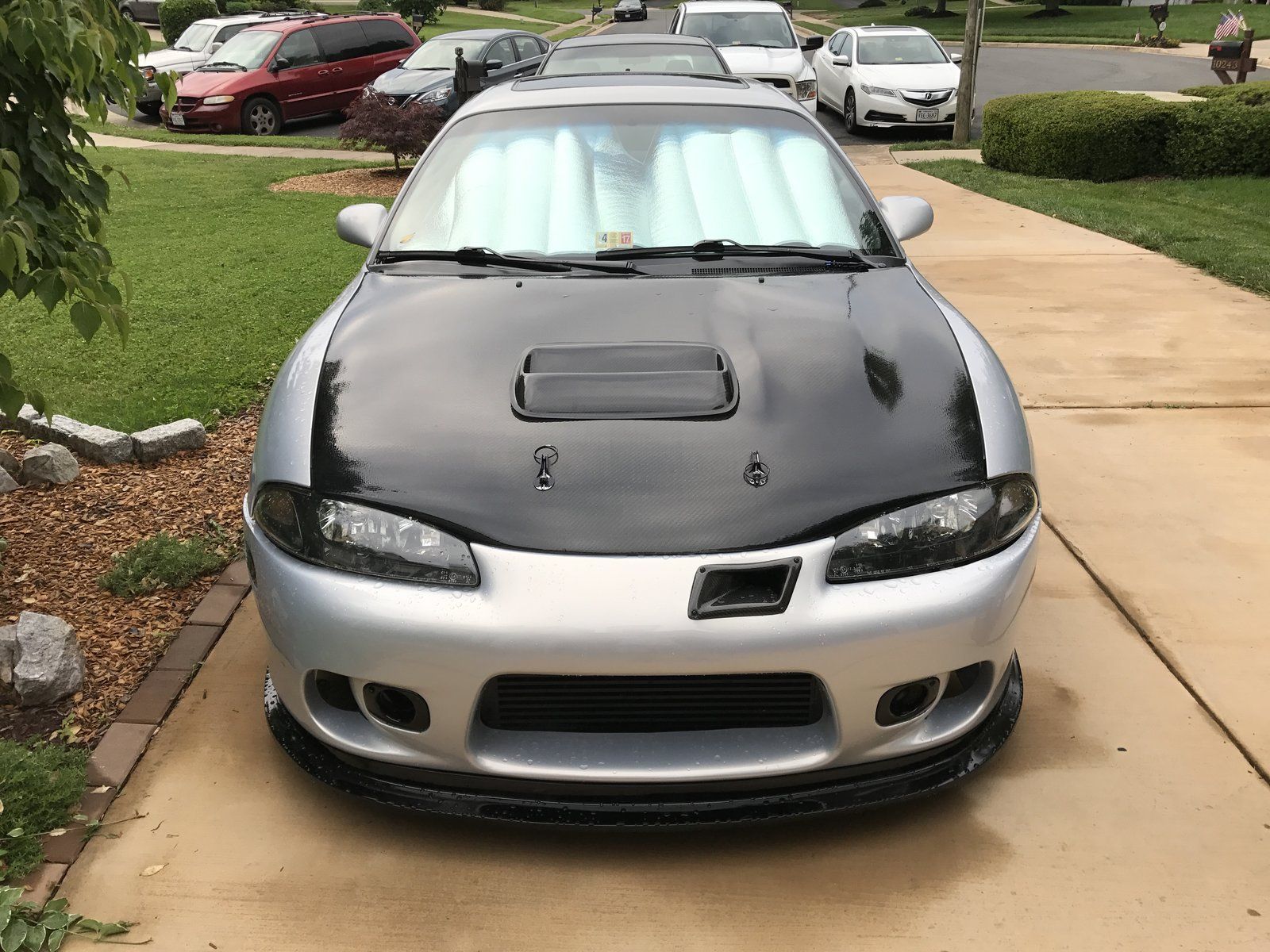

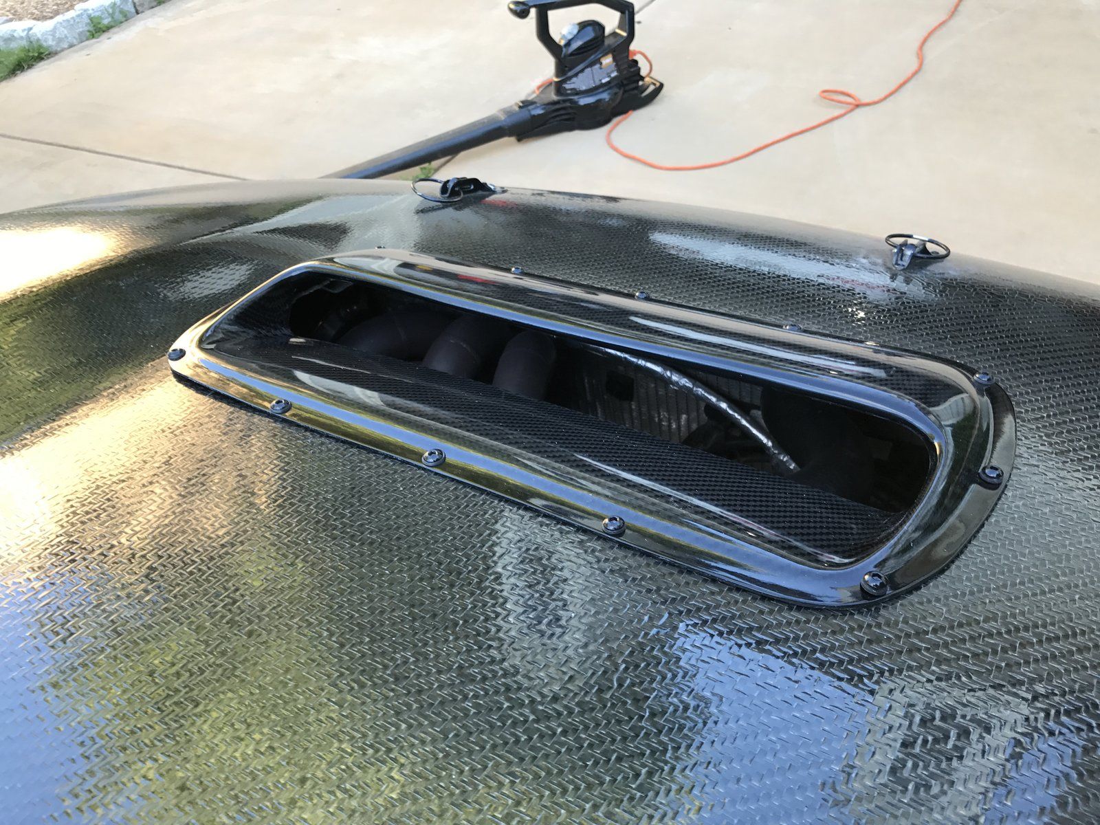

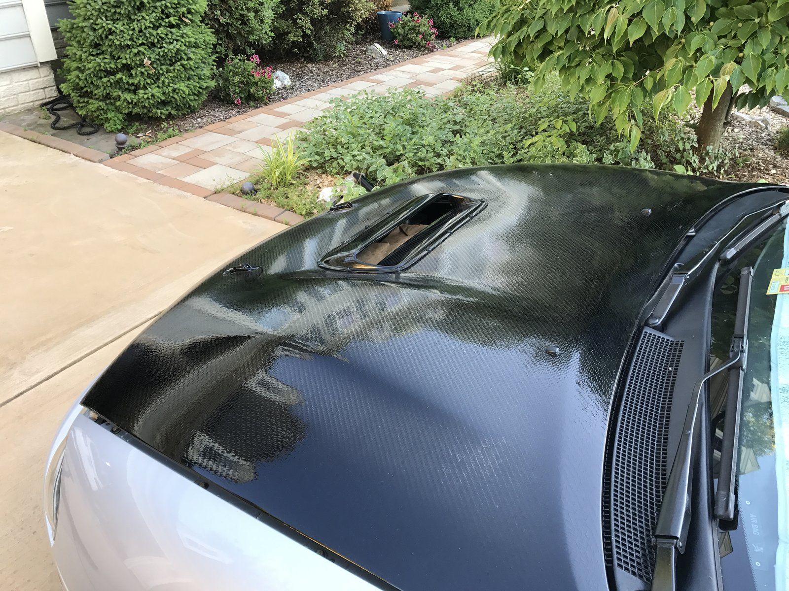

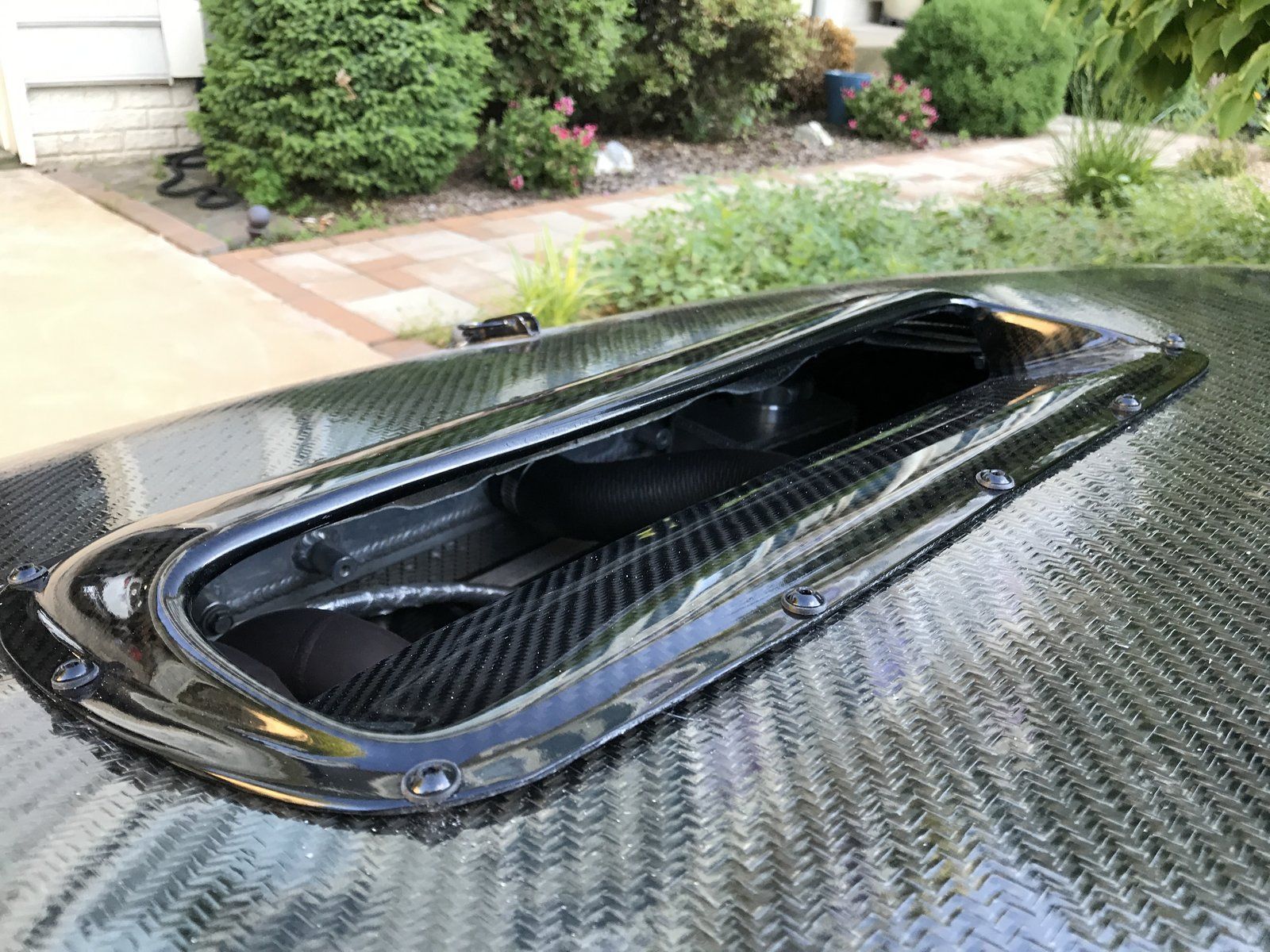

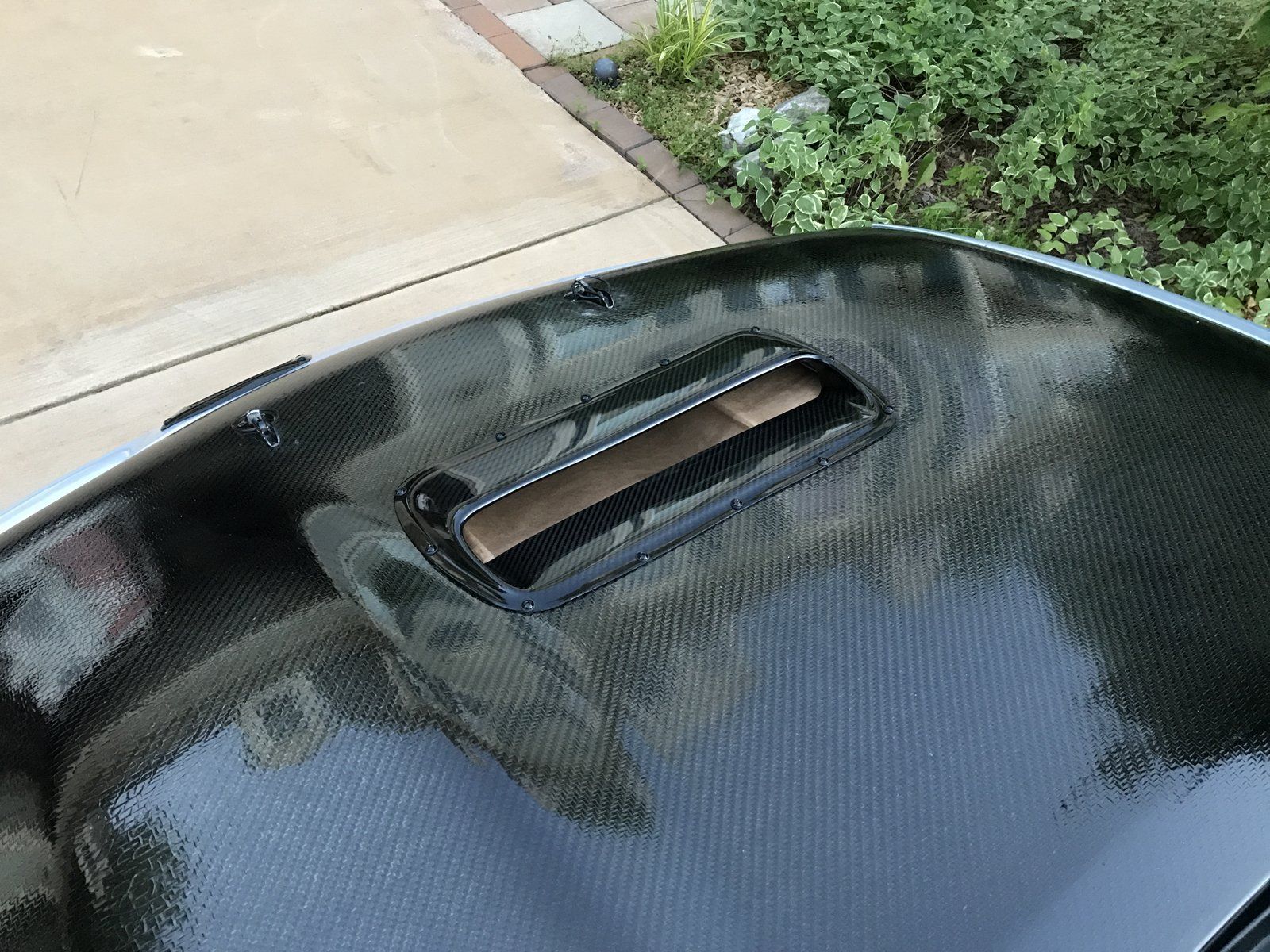

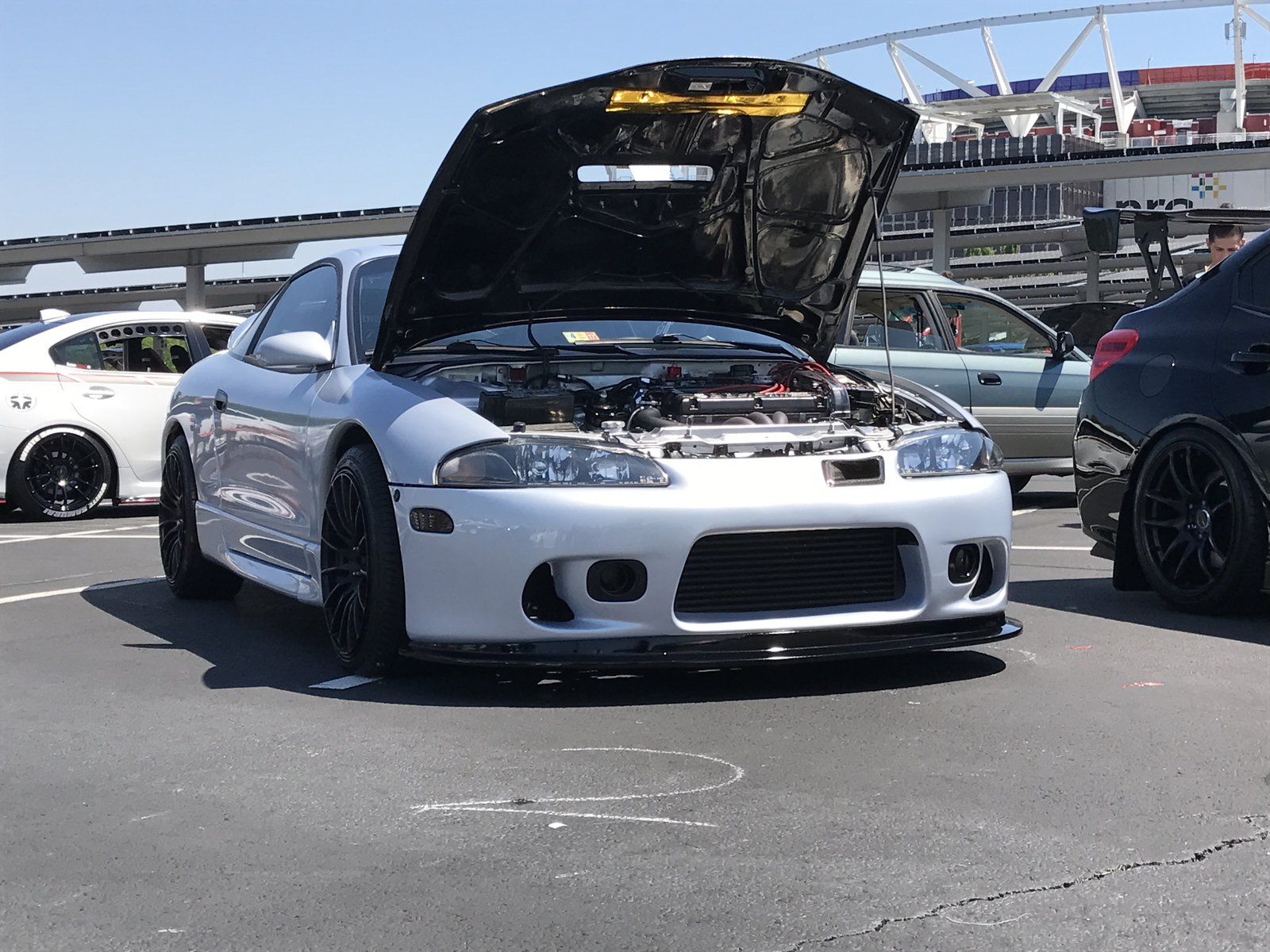

Well I installed mine last night. Started at about 6pm and finished around 8:20pm. A good 2.5 hours as i stopped and cleaned up my area twice before finishing.
**Tools Used**
-Painter tape
-Level
-Dremel w/standard cutting wheels
-Permanent marker
-Drill and multiple size drill bits
-leaf blower
**Hardware**
-SS Allen head bolts
-SS washer
-SS Nylon Locking nut

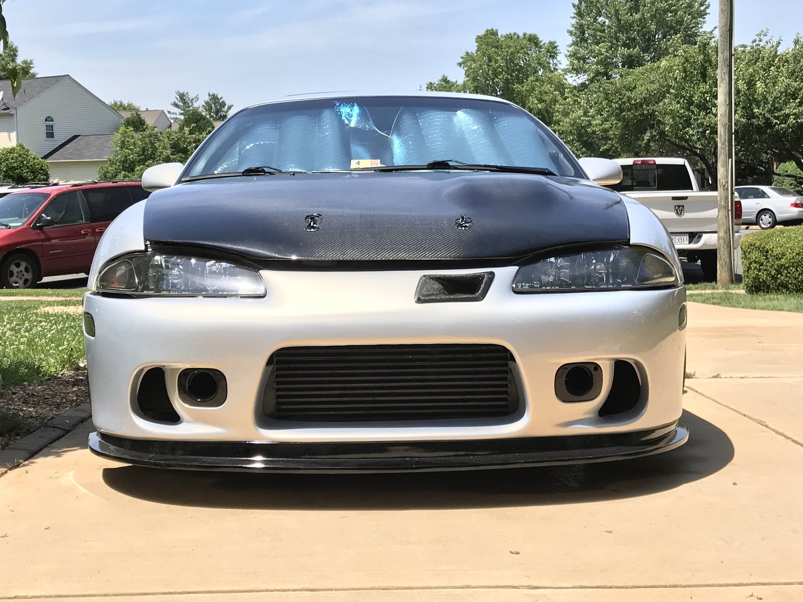

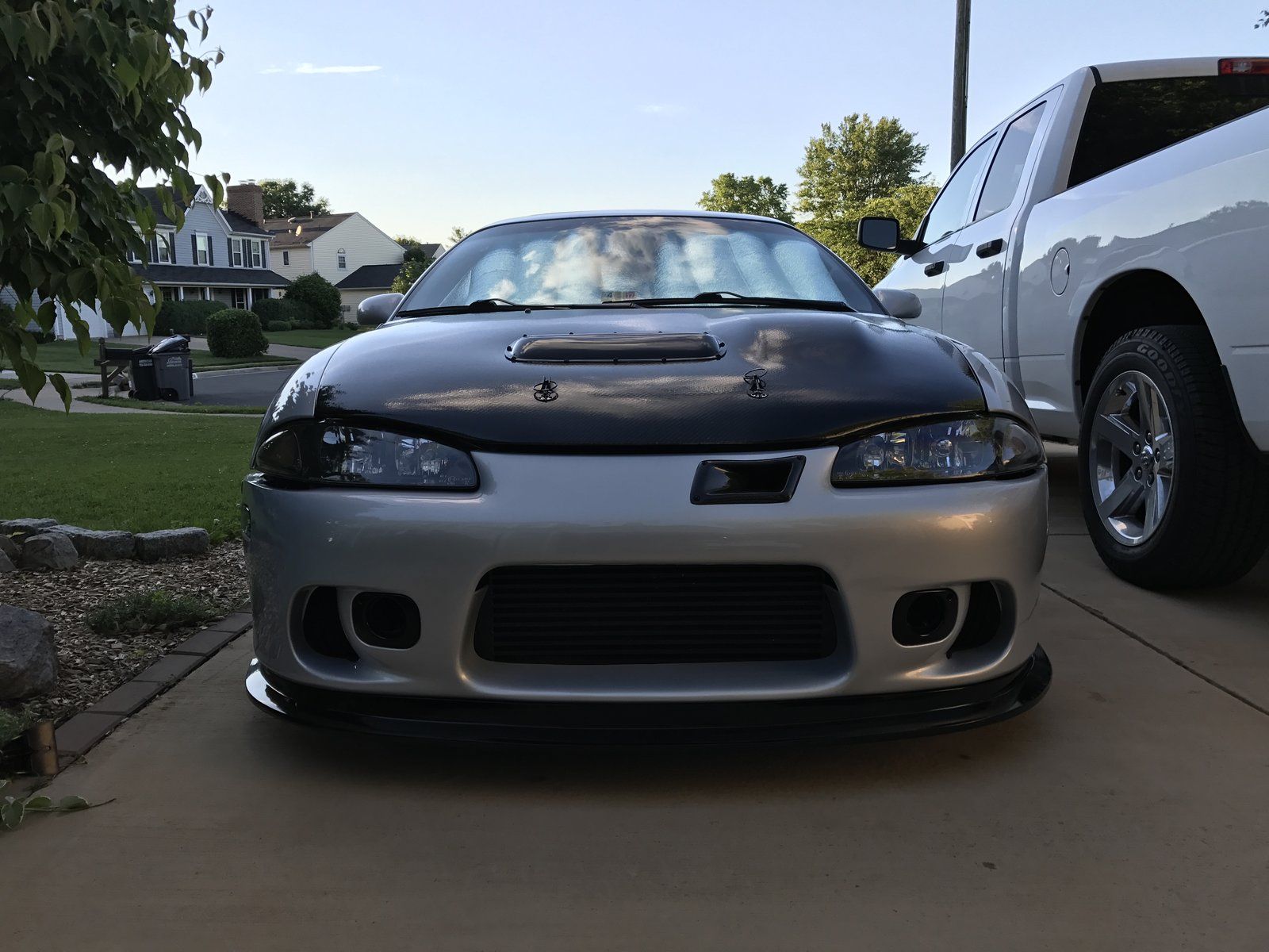

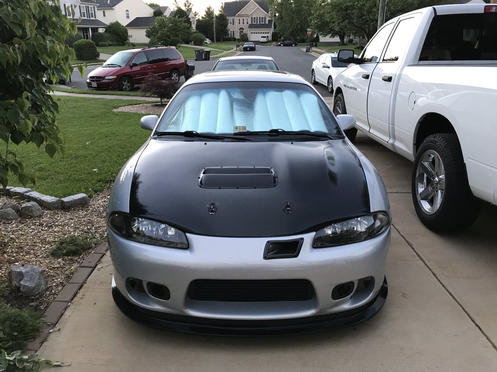

Here are the final results. I like the overall location of the vent, but the pictures make me feel like I am a little high compared to the hump in the hood. In person I felt as though it looked closer, which it probably does. Im sure it is just the angle of the camera throwing me off.
Regardless of the position, this vent has a clear shot at the manifold and radiator. And a decent amount of surface area to pull the heat out of.
