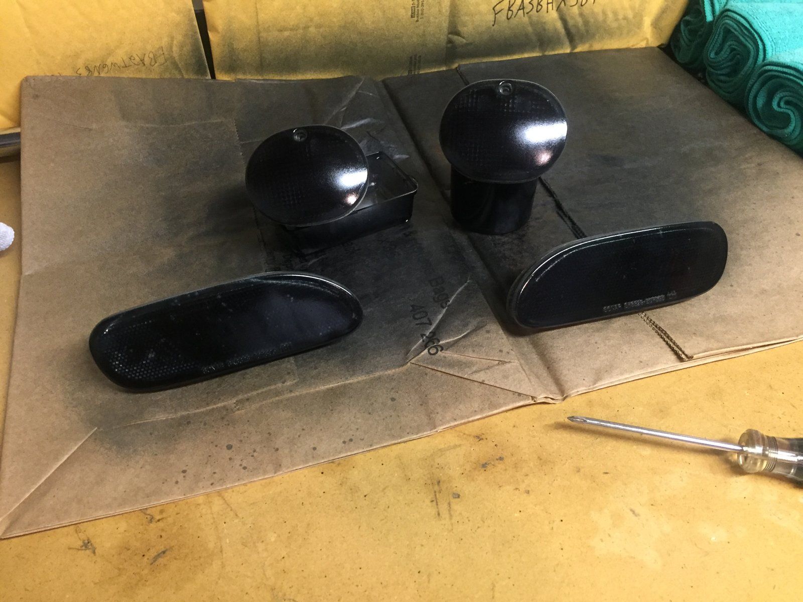

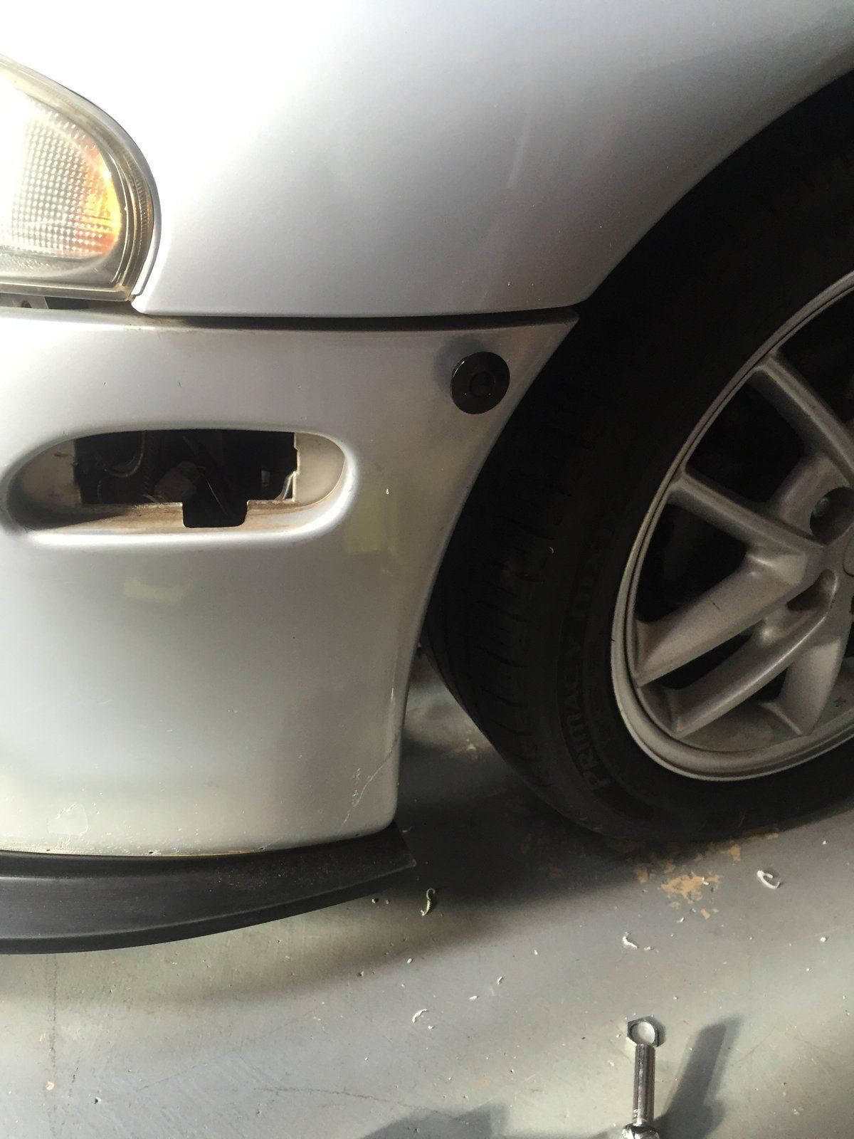

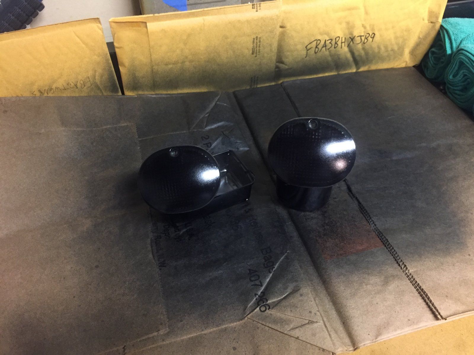

Picked up some night shadow glass tint with the goal of blacking out my reverse lights and side markers. This stuff sprays pretty decent. I didn't do to much prep before spraying them. Came out okay. I'm probably going to do the front side markers again. But use Amber ones this time. I had clear.

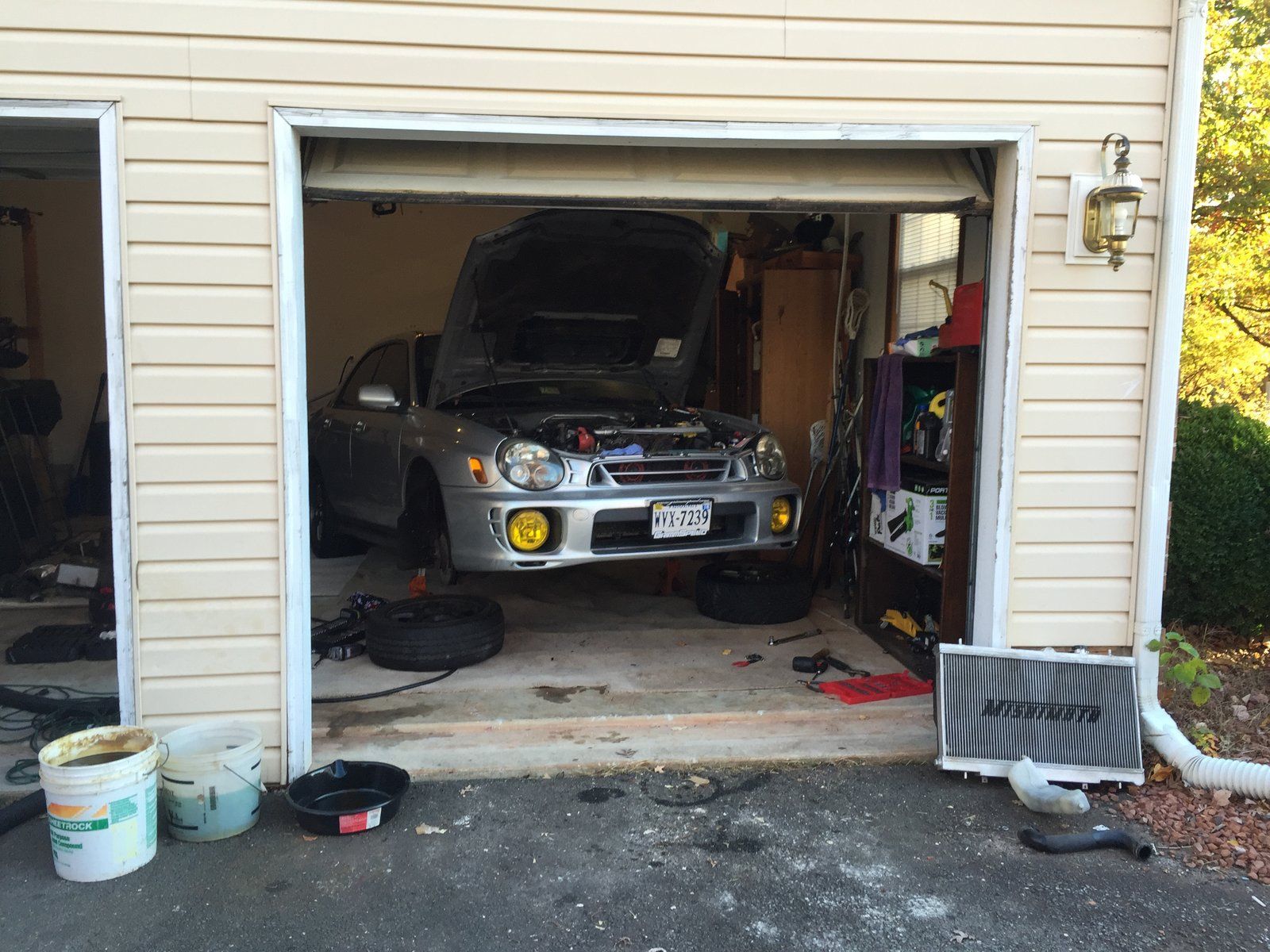

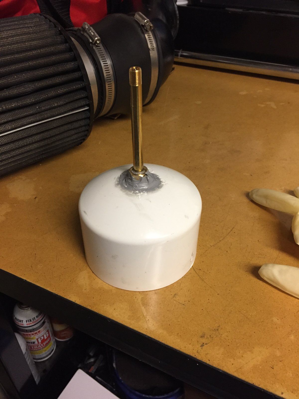

With my tune coming up I decided to make a boost leak tester and see if I have any leaks. So far not sure if it's working or not. I also decide to install my quick disconnect bumper latches. This is really a lot more work then it seems.

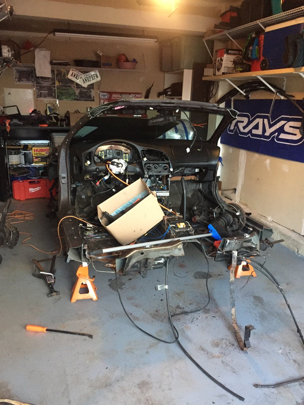

In other car news (not DSM related). I have been following along with a good friend of mines build. I was over a couple weeks ago, and helped him put interior chassis parts back together. This Suby of his is definitely one of a kind. It was a street car that he built for Time attack trials.
-Full wide body bugeye. With Hyper Blue paint. (First one of its kind I think?)
-Fully built motor with a rotated 30r kit.
-V mounted Radiator.
-Full Piper cage. with flocked dash.
-Stance 3way adjustable coilovers.
-APR GTC-300 wing
-Sitting on custom offset wheels and Toyo R888 tires.
On to the pics.

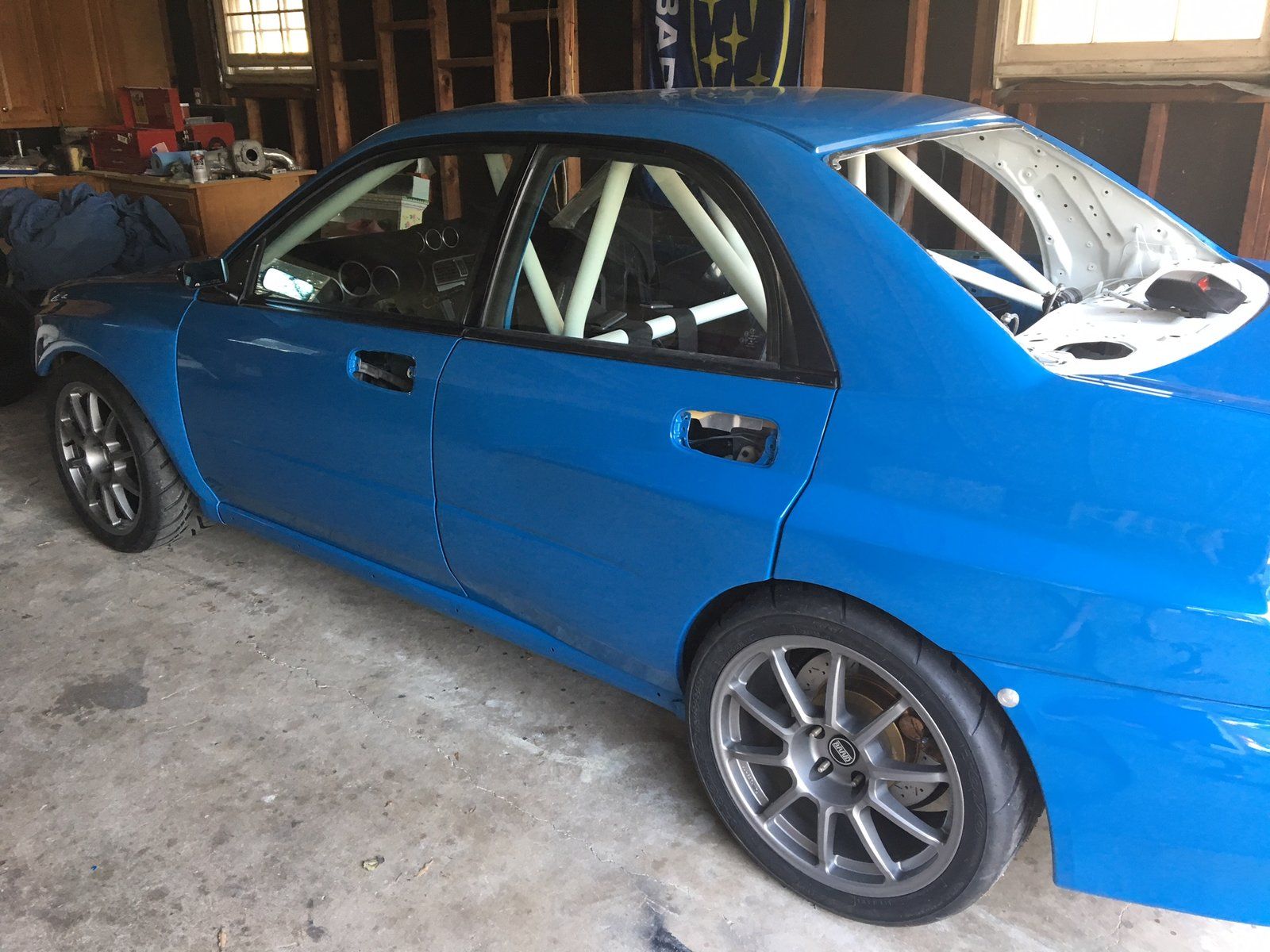

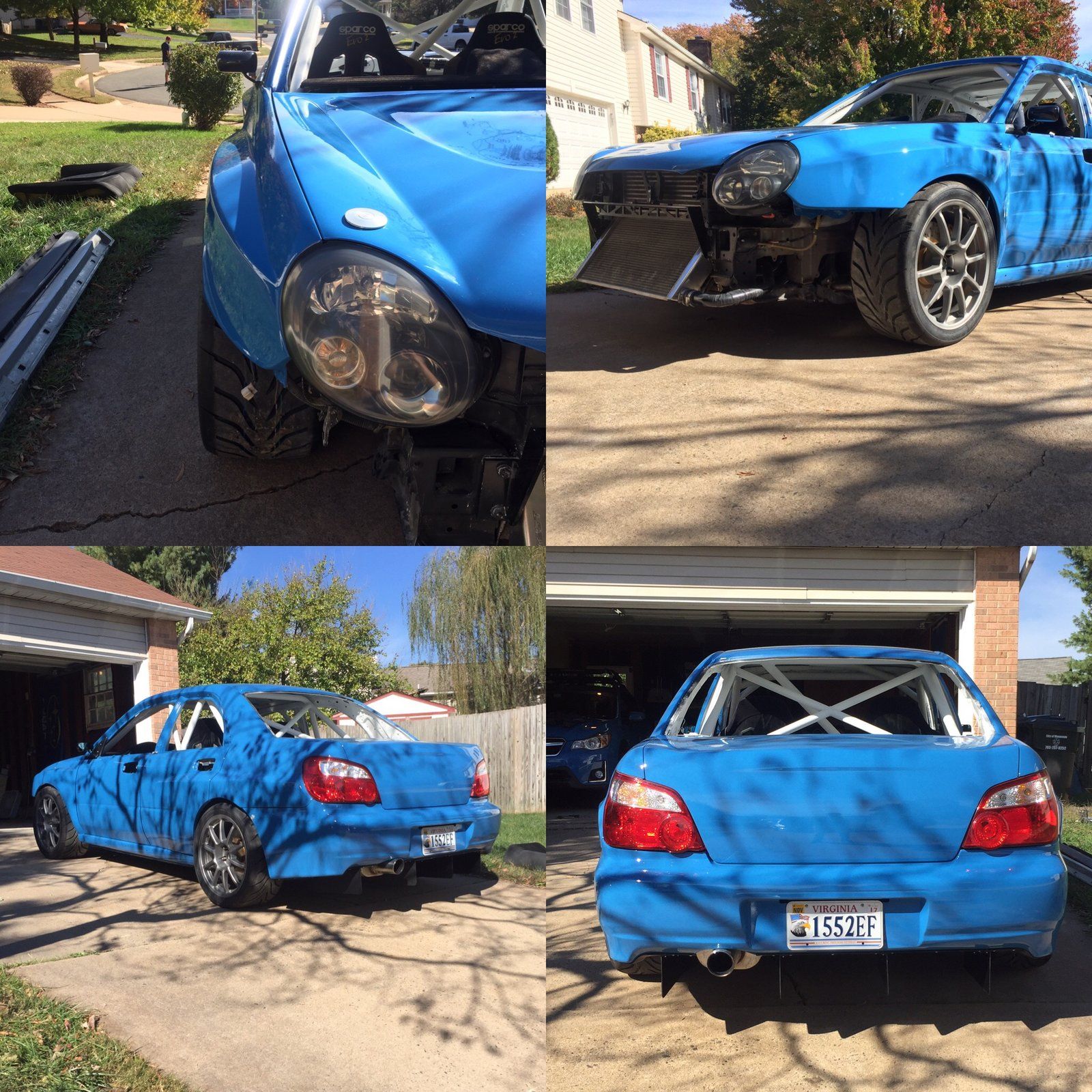

As for the Bugeye.

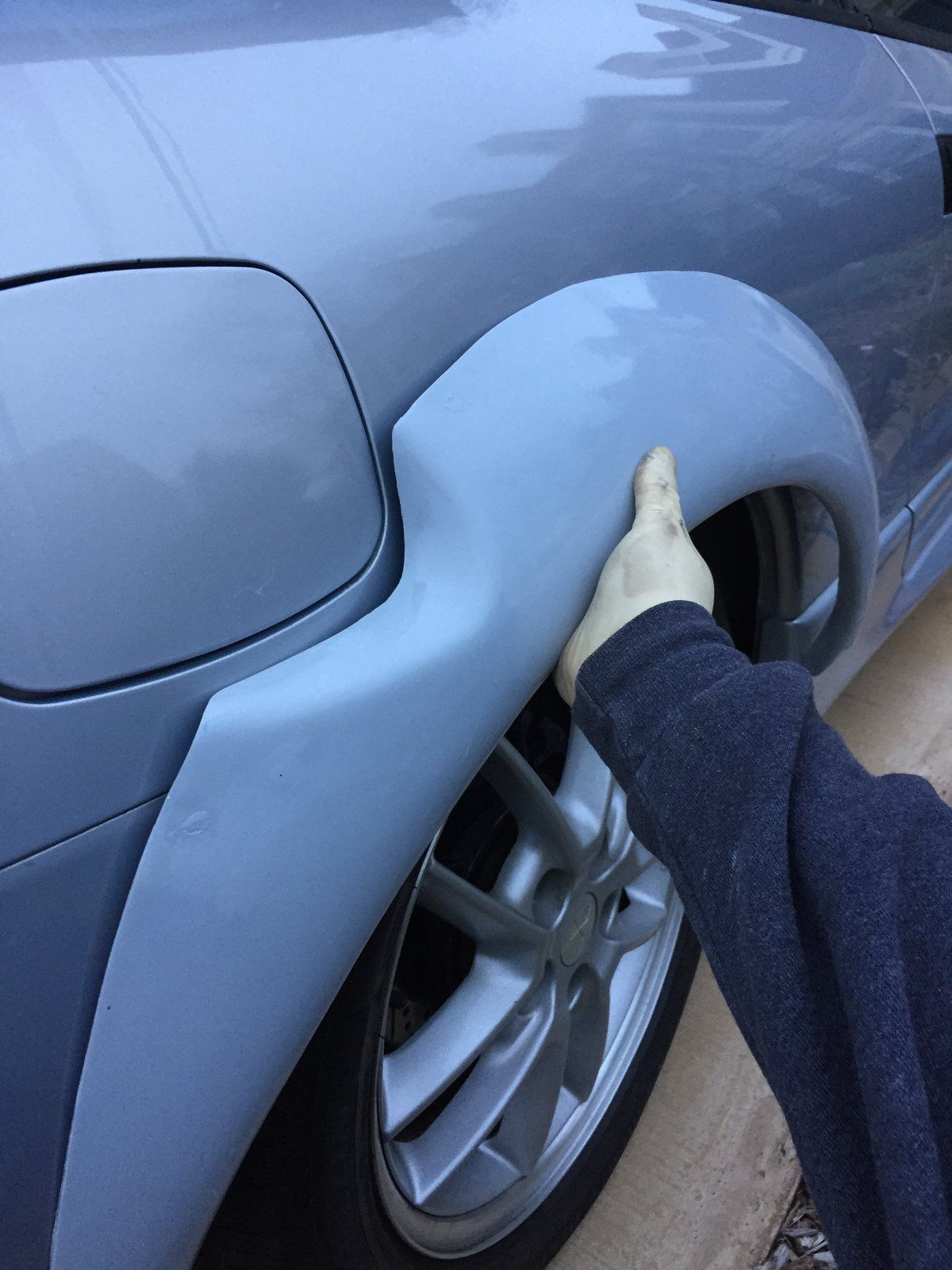

It's a full STI swap motor and drivetrain and interior for sure. I supplied him with the BDA 4000 rotors wing and suspension etc. But this color is actually the Hyper Blue color that comes stock on the 2015+ STI and the crossteck. It just looks so different on a GD chassis. He actually has a hyper blue crossteck also and it's a beautiful cooler in person.
For the front end I loved the look it had when it was silver wrx with Jdm goodies with the over fenders. But this Widebody is so nice and molded into the body. The paint work is great. He went with a RS hood because he is going to do custom carbon hood vents. Something like a seibon CW style venting. He needs more surface area to vent for heat during TA.

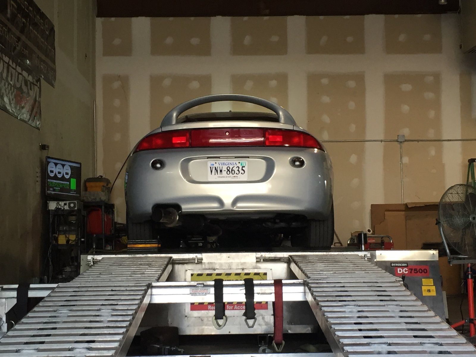

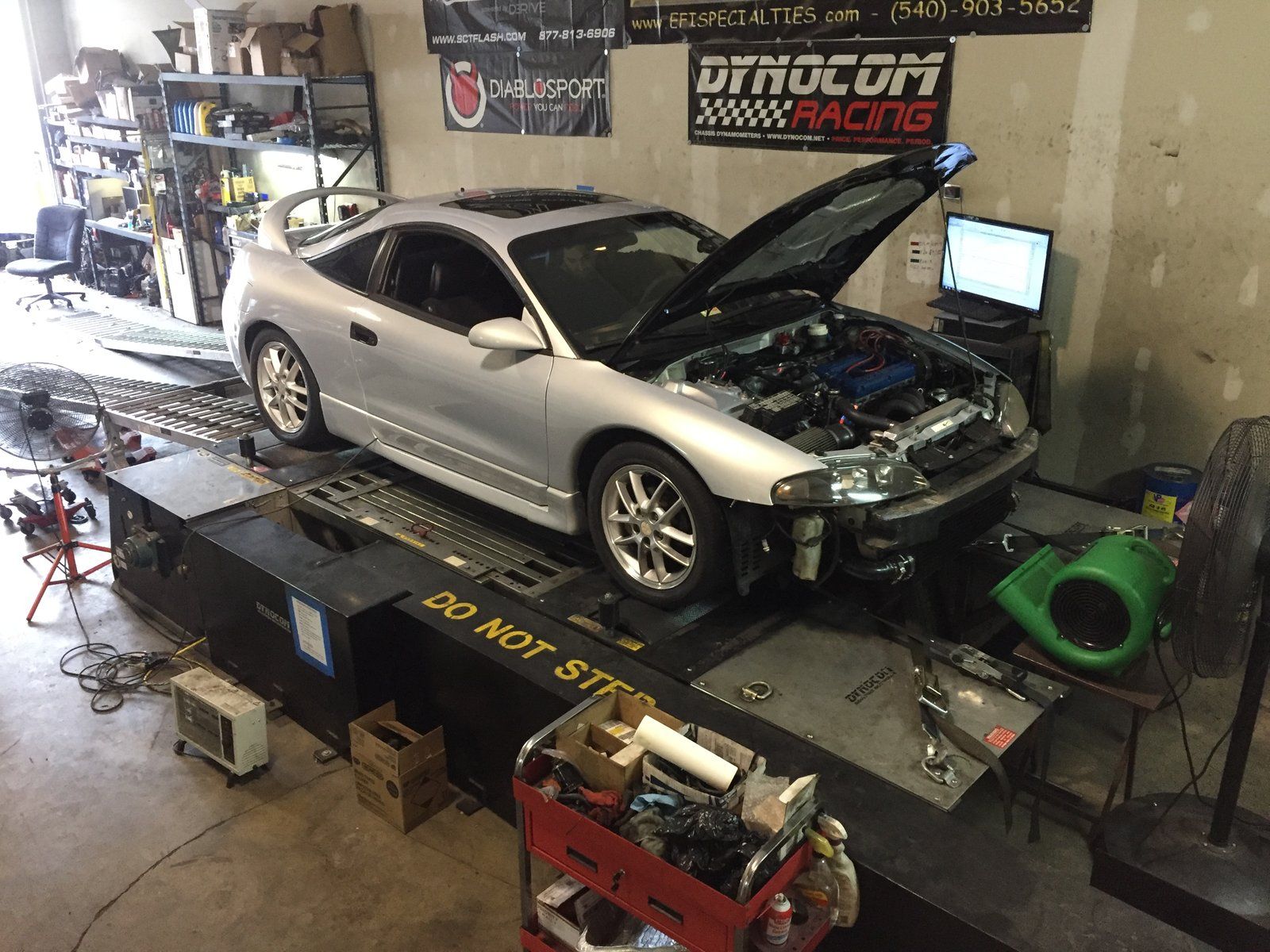

So November 11th finally arrived. I woke up around 6am unable to sleep. My tune apt was schedule for 1pm at EFI specialties but I was too excited to go back to sleep. I got my tools around and had a charger on the battery. My buddy Tyler showed up with his Ram 2500 Cummins around 9:30 and we were off to u-haul to pick up the trailer for the day. All and all no issue with the trailer. Beside it being beat to shit and not being able to open my car door. I had to crawl out of the rear hatch to exit the car... :banghead:

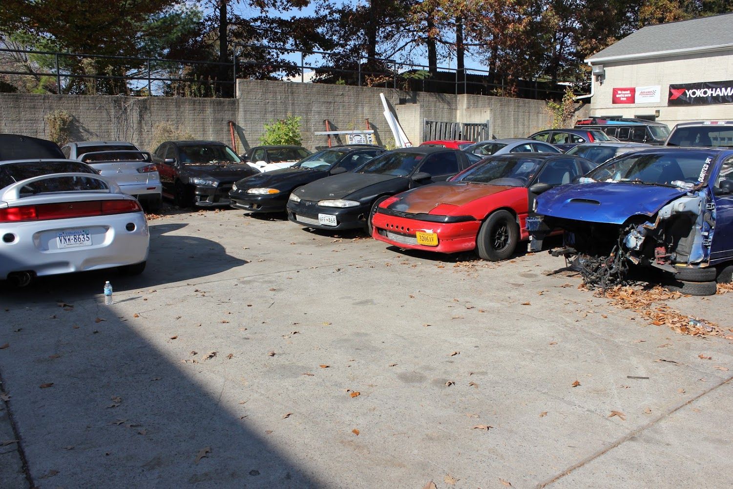

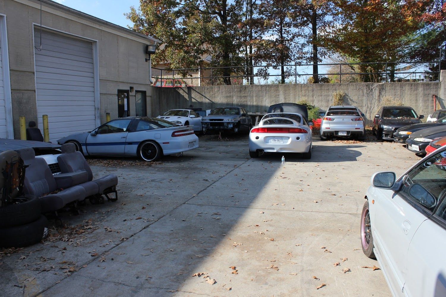

We got to EFI in Fredericksburg around 12:30ish. Dave Katz wasn't there yet so Tyler and I took our time pulling the car off the trailer and had a look around his lot at different projects he was working on.
Parked out front EFI Specialties. My GSX looks at home with the rest of the DSMs and Evos.
w2lZeHulPCfdX1afd5XsMQNeG8GnCfoR3PLEaTF99IJItMTSKwBUpuJuY_IL3xIjBe8xdu3ofLdXVPw=w1920-h1001.jpg
L6NrXMA6ILrllwTYV_qf-mwLiuBtDJ1xDPPADL2A7Fz7yGIXpm1-jWd8rl1HcTugCYGlyLIqS1J9LCU=w1920-h1001.jpg
u0XPhf7Hoegpuq2m-q2nSE5CyfEVZ7AP7vcVsdn0PAHmwPxWMRWELwgeiD_q5fDJd7VLijv04dQPUmk=w1920-h1001.jpg

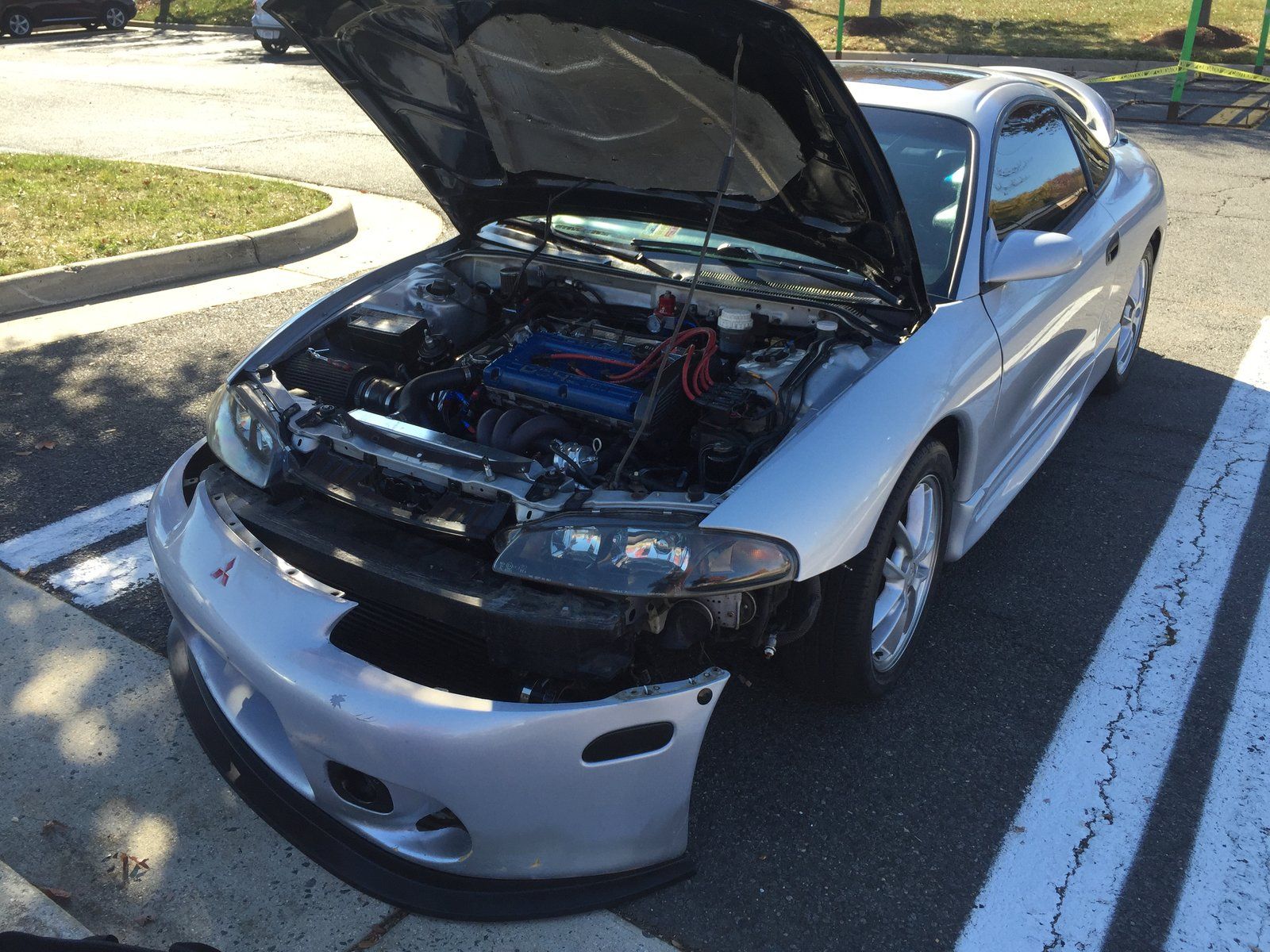

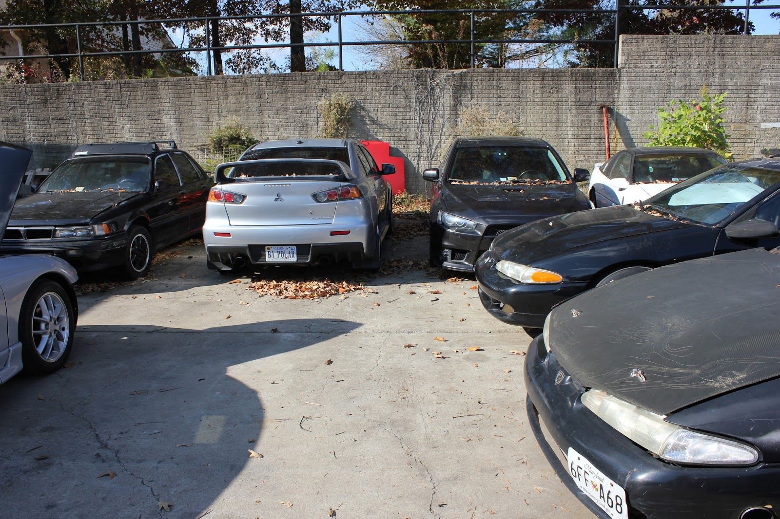

Two EVO X's other silver one is a GSR and the black one is a MR. They both need motor work.
Side Exit exhaust 1G

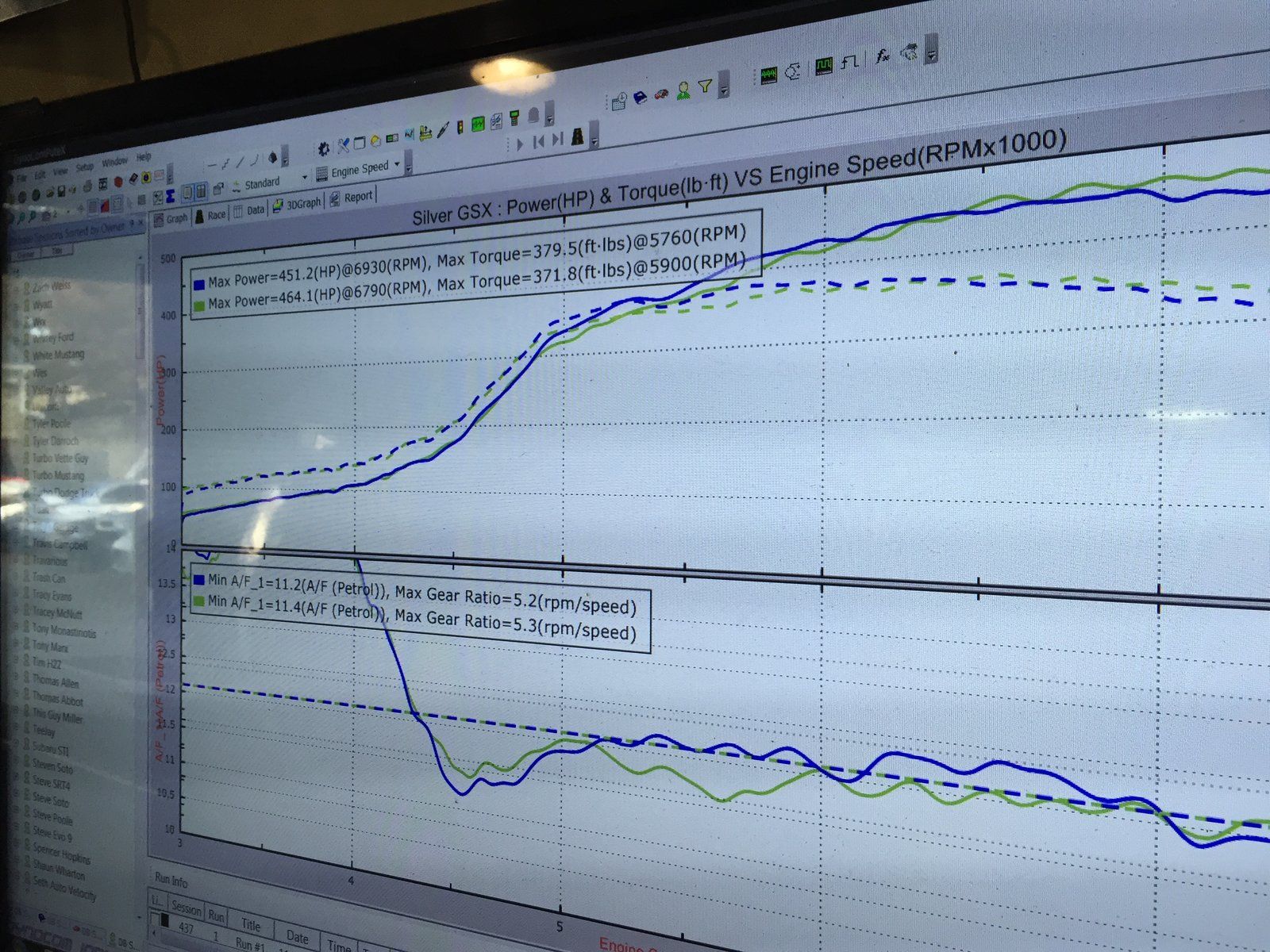

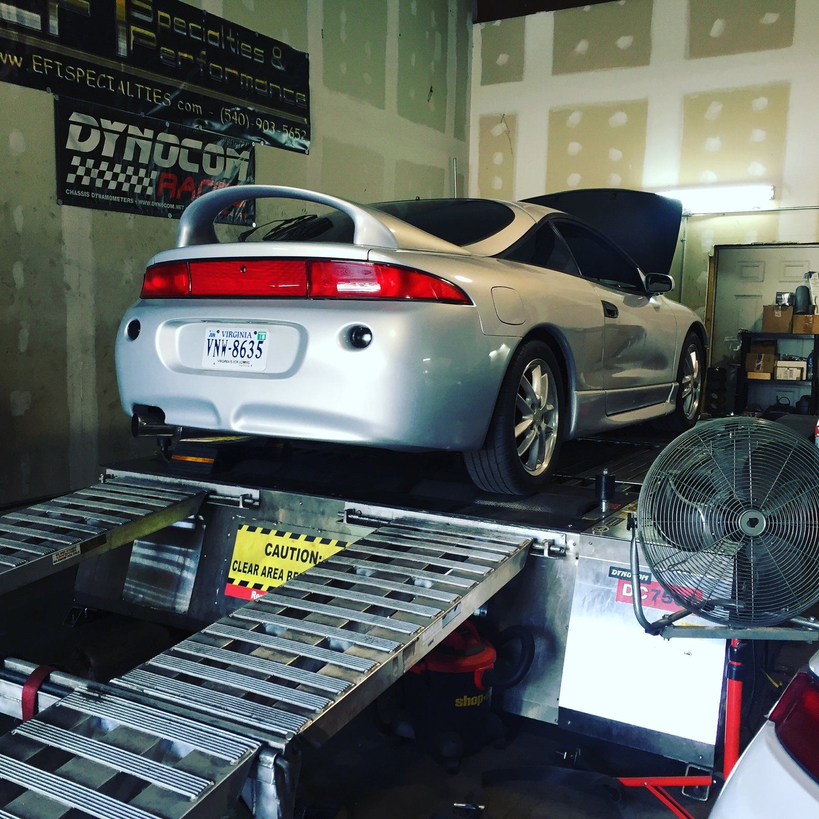

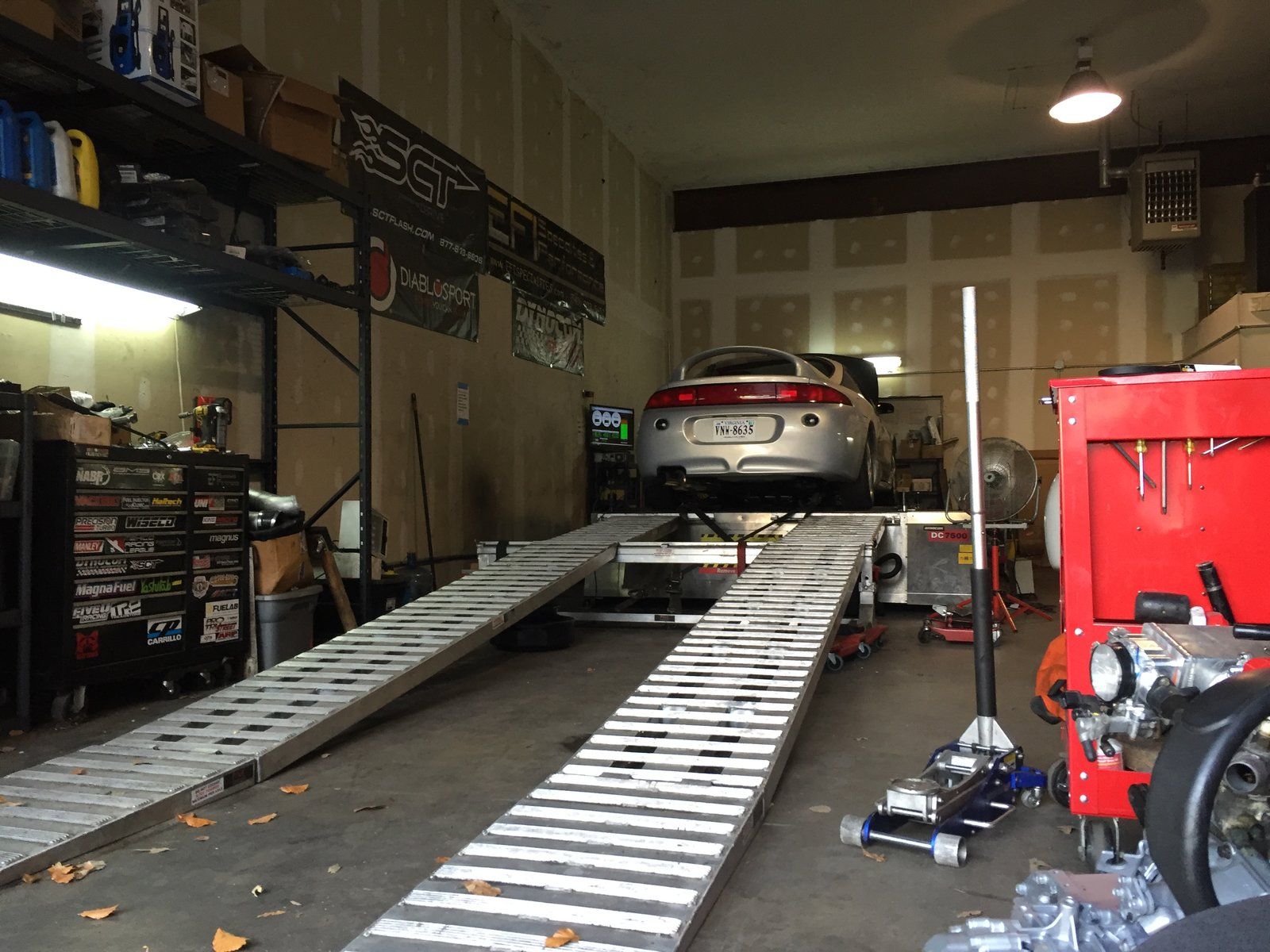

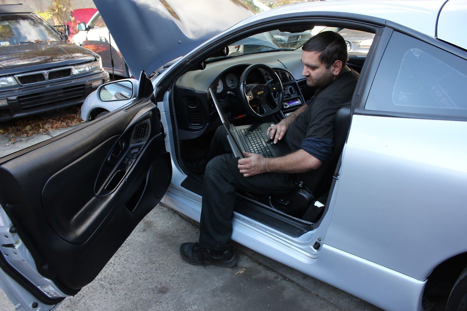

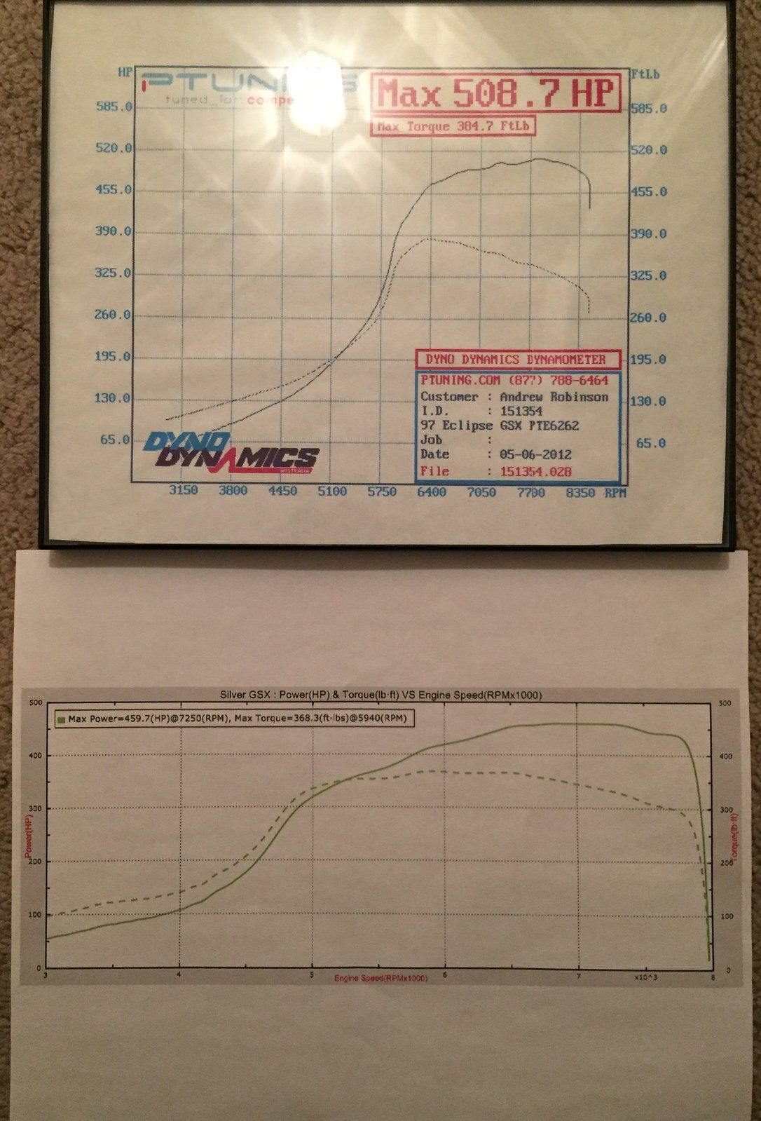

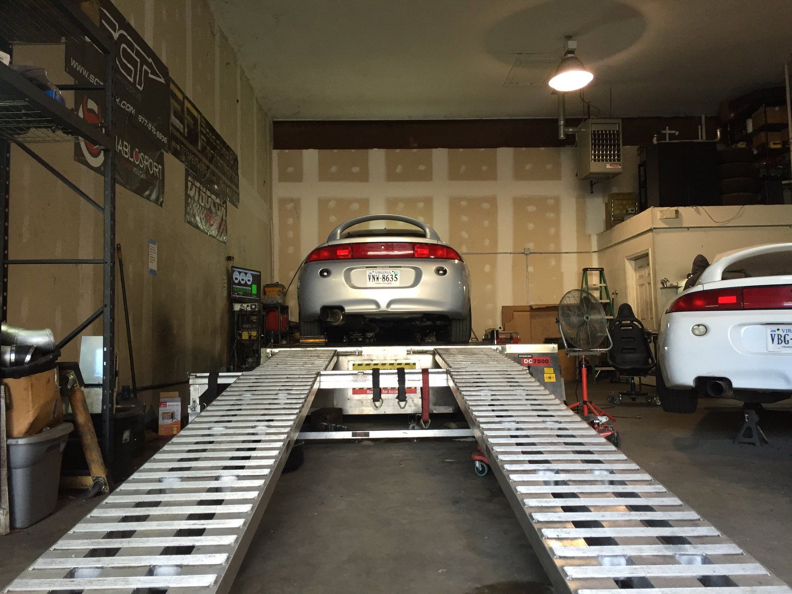

Dave finally arrived and we had a quick chat about his customers projects, and then we went over what I was looking to accomplish with my tune. I was going after good power that I could daily if I wanted. I swapped my plugs and Dave grabbed his timing light dialed in my timing. Within 5 mins Dave had my car idling better then I had been able to do in 1 month. Made my feel confidant I picked the right guy.
Highest pull of the day. Max Power 464, Max Torque 371.8 (FtLb) @26psi

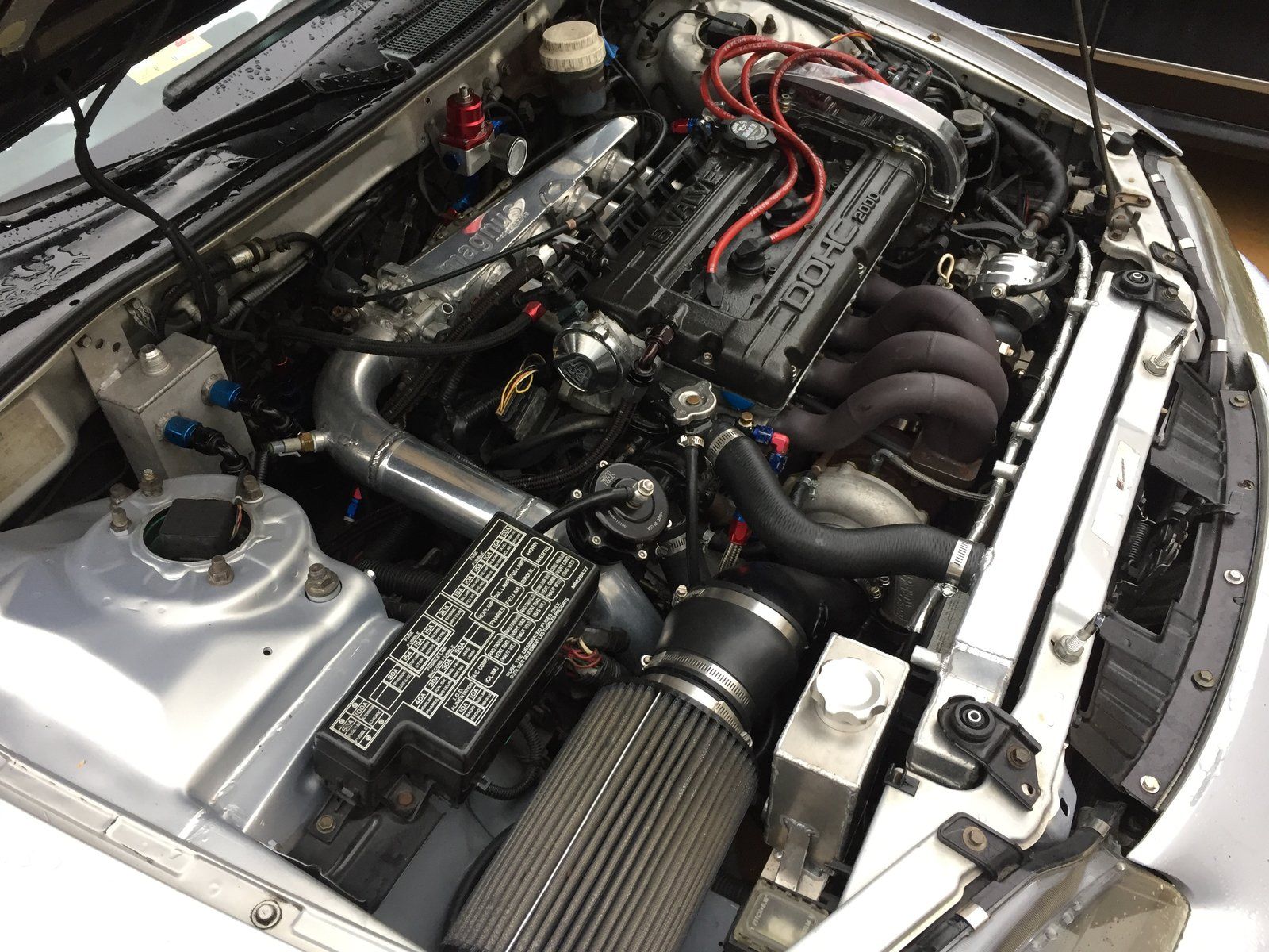

Built 2.0
Kelford 272 cam
Magnus Intake manifold
PTE-6262 .82
Here is a comparable dyno graph of my 99 GSX Vs my old 97 GSX build. As you can see those extra liters helped make up for some power.

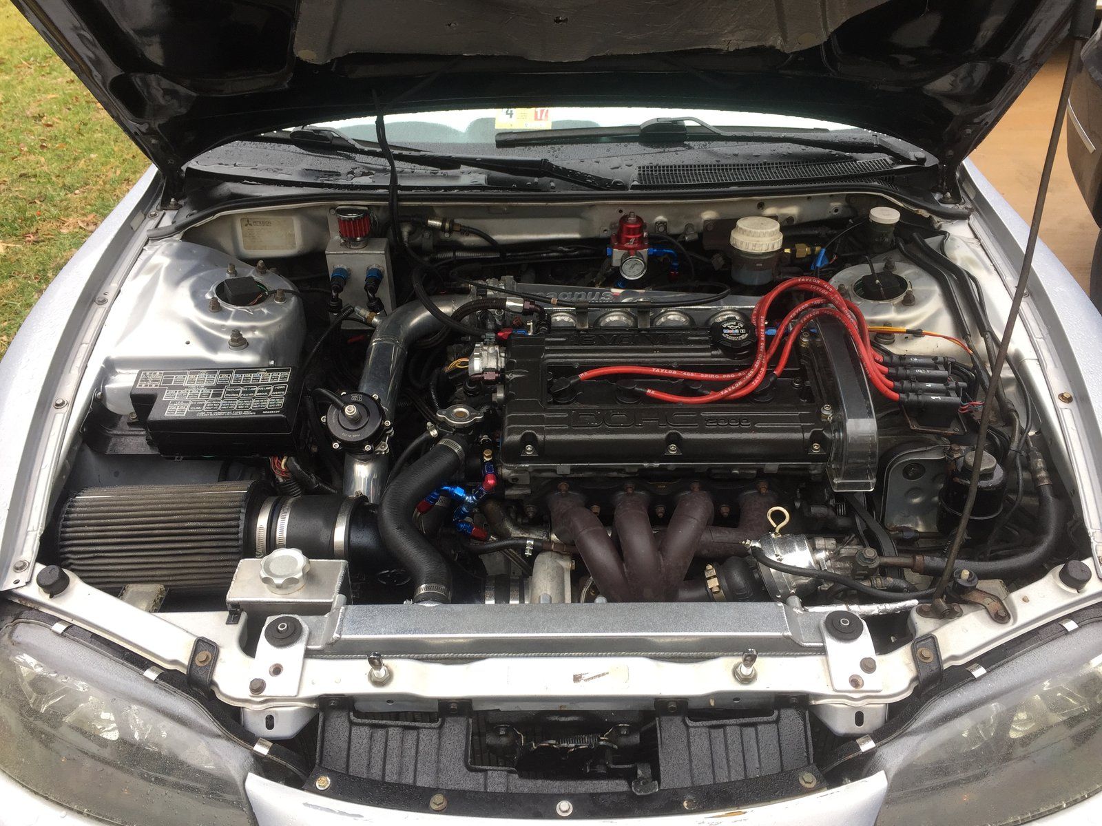

2.3L
FP4 280 cam
JMFab Race manifold
PTE-6262 .82

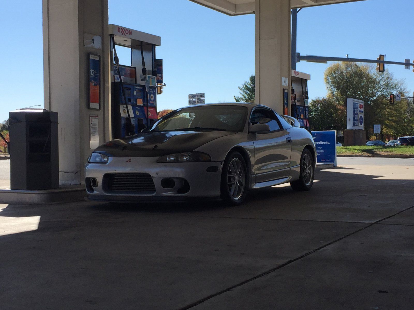

The following day, I took the car out for its first fill up (93 oct) and first drive in over 3 months. Before I headed over to my friend Phil's house to help him with his bugeye. Full boost happens around 4k and damn it felt good to be slammed back in my seat, and rev out 2nd and 3rd.

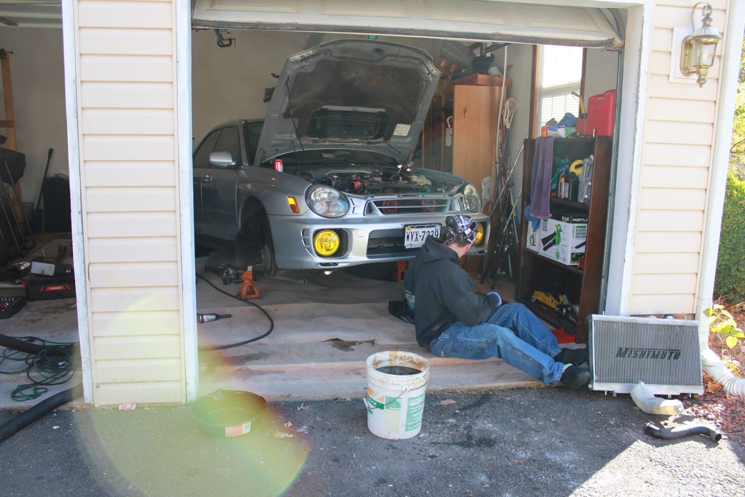

Got to my buddy Phil's house with no issues beside having to re-tighten my PWS belt. As you can see Phil is in the middle of a motor pull on his bugeye. He finally decided to take the leap and swap over to the JDM 2.0 STI motor and 6 speed trans. This was my first time pulling a boxer motor. simple things felt tedious at times to remove, but I am so used to inline 4s that the learning curve on this thing was a good experience.

Its a huge difference! I cant believe the power and how smooth it comes on. My 2.3L seemed so angry when full boost hit. It did feel a little better with the 2.3 for cruising light to light.
I am so happy with the setup I plan to drive it to work on Friday. Glad to have my car back and running.

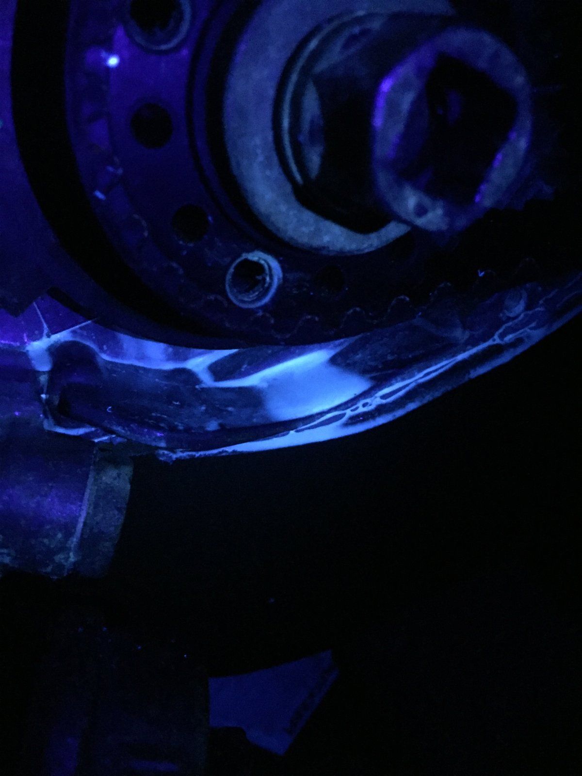

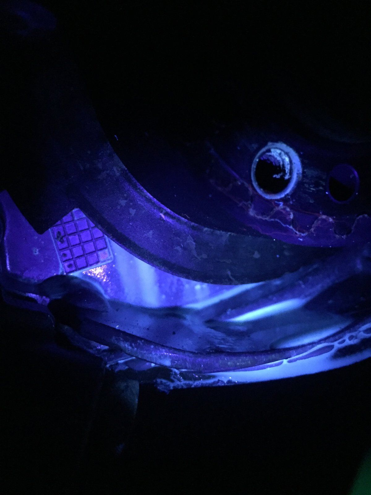

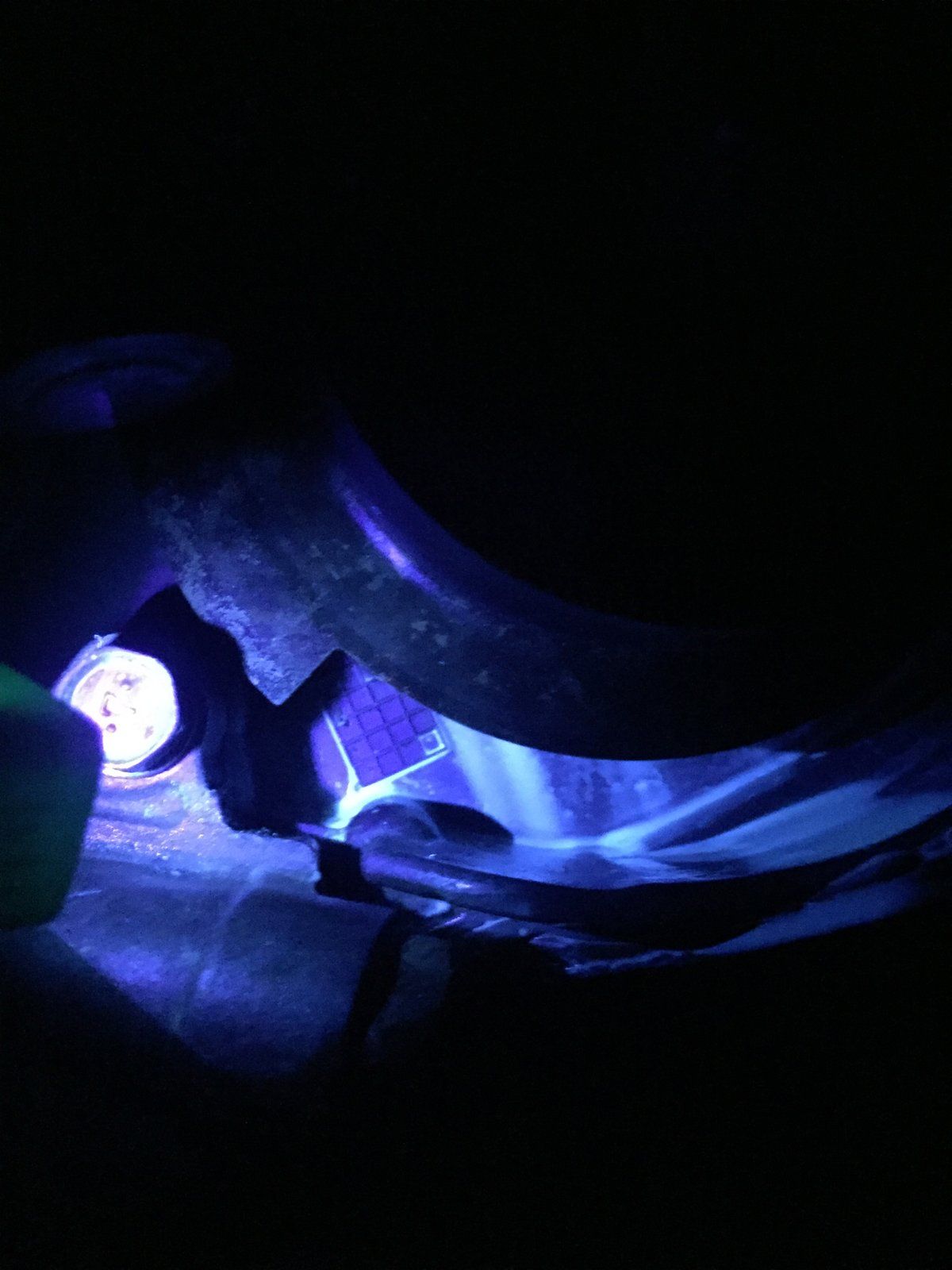

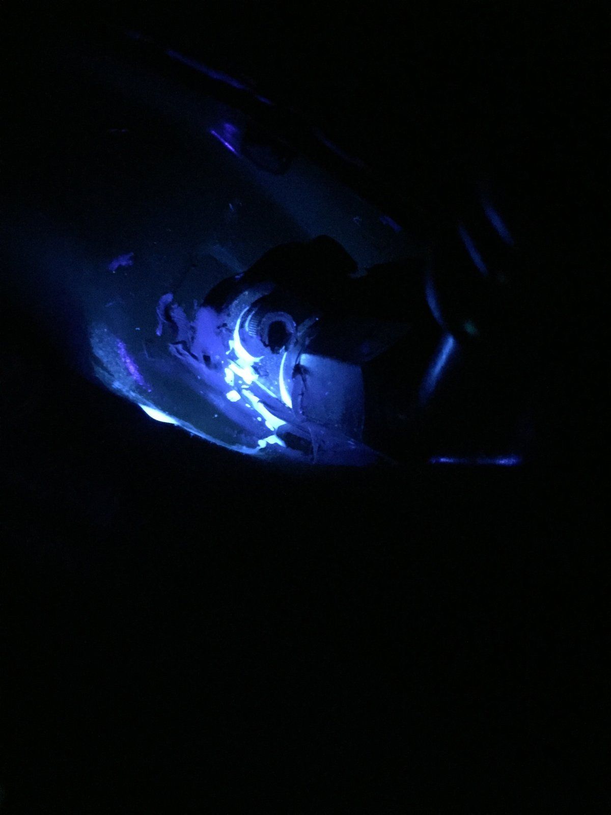

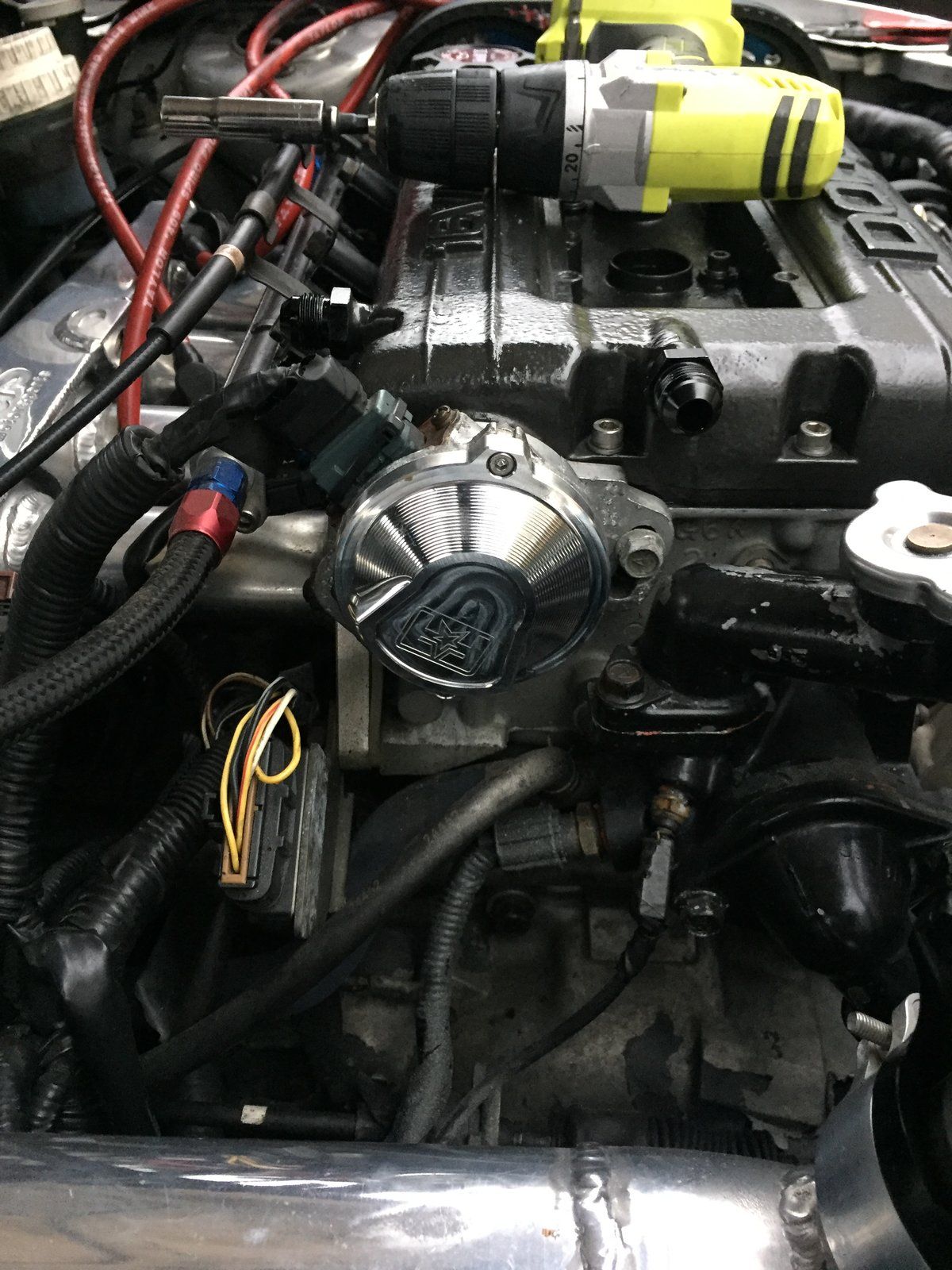

Well when you drive them you find out where the weak points are. Came out for lunch today to find a oil spot under the filter housing. I was like WTF??How?? I just did all this maintenance.. I couldn't see all that well so I decided to just pop off the quick release and crawl under and look at where is was coming from????
Oil is dripping straight from the lower cover parallel to the crank pulley. I'm guessing its either the pan seal or that front seal. I thought I got all the leaks but who knows. Also I don't know if the oil filter housing has ever been ported but this motor could have high oil pressure.

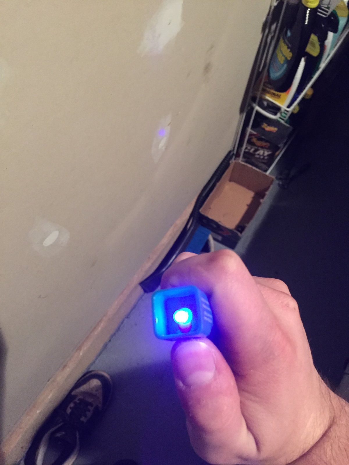

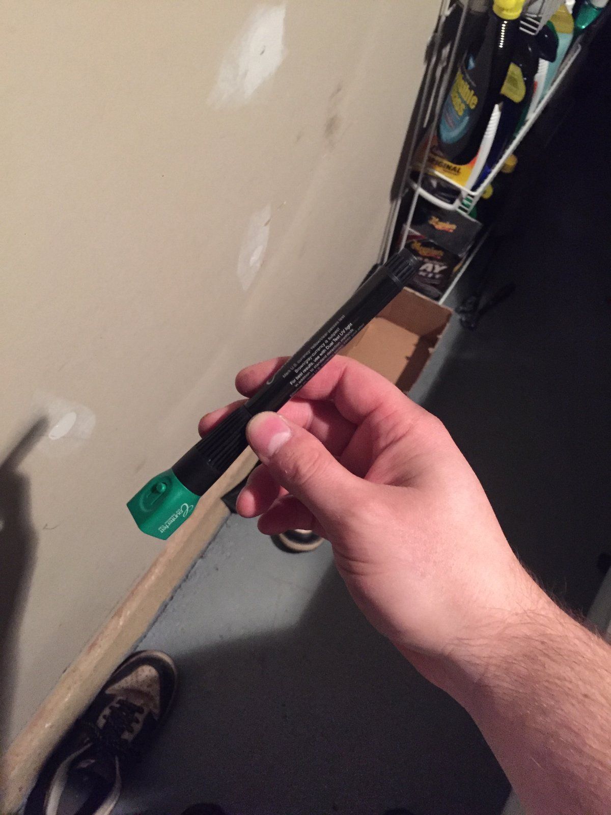

Update: Nov 16 11:51pm I found my leak. Front main seal. UV light is awesome for tracing a leak.
UV light makes the oil illuminate.
There's my leak. The front main seal didn't seal properly. I didn't use oem so I learned that lesson.
I even tried it on my return line. I tired a couple times to get this to seal.

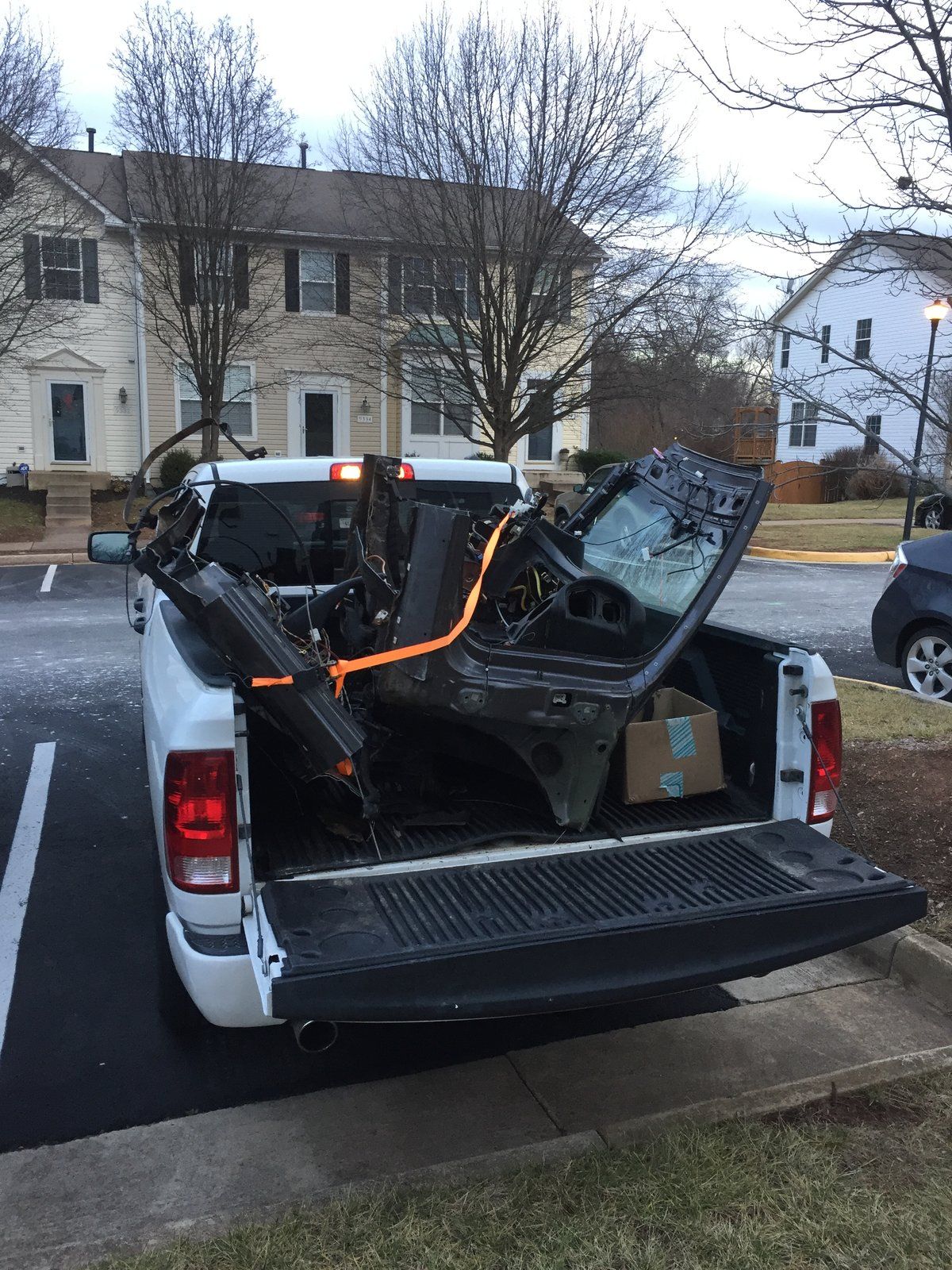

haha Thanks man. Once my part out is completed on the 98 GSX. This car will be getting a lot of new items installed.
Well now that this 98 GSX is out of my garage. I can finally clean up and bring my 99 GSX home and start installing all of the new goodies I recently acquired. :]

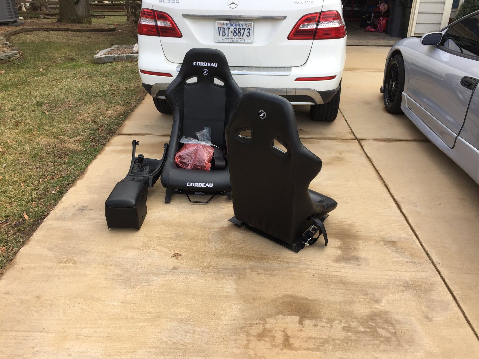

New Corbeau Seats w/ harnesses (I am going to repaint my cage)

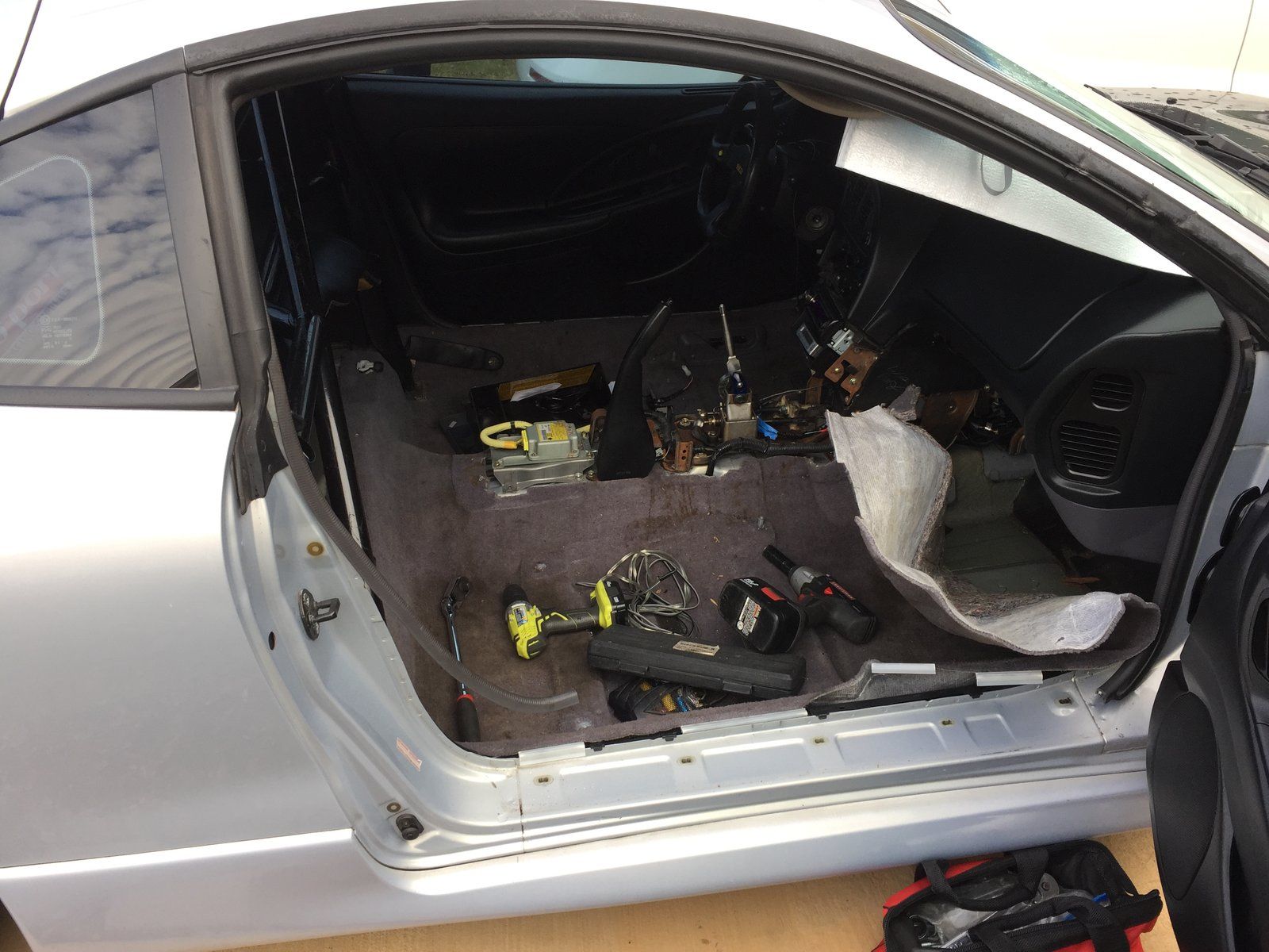

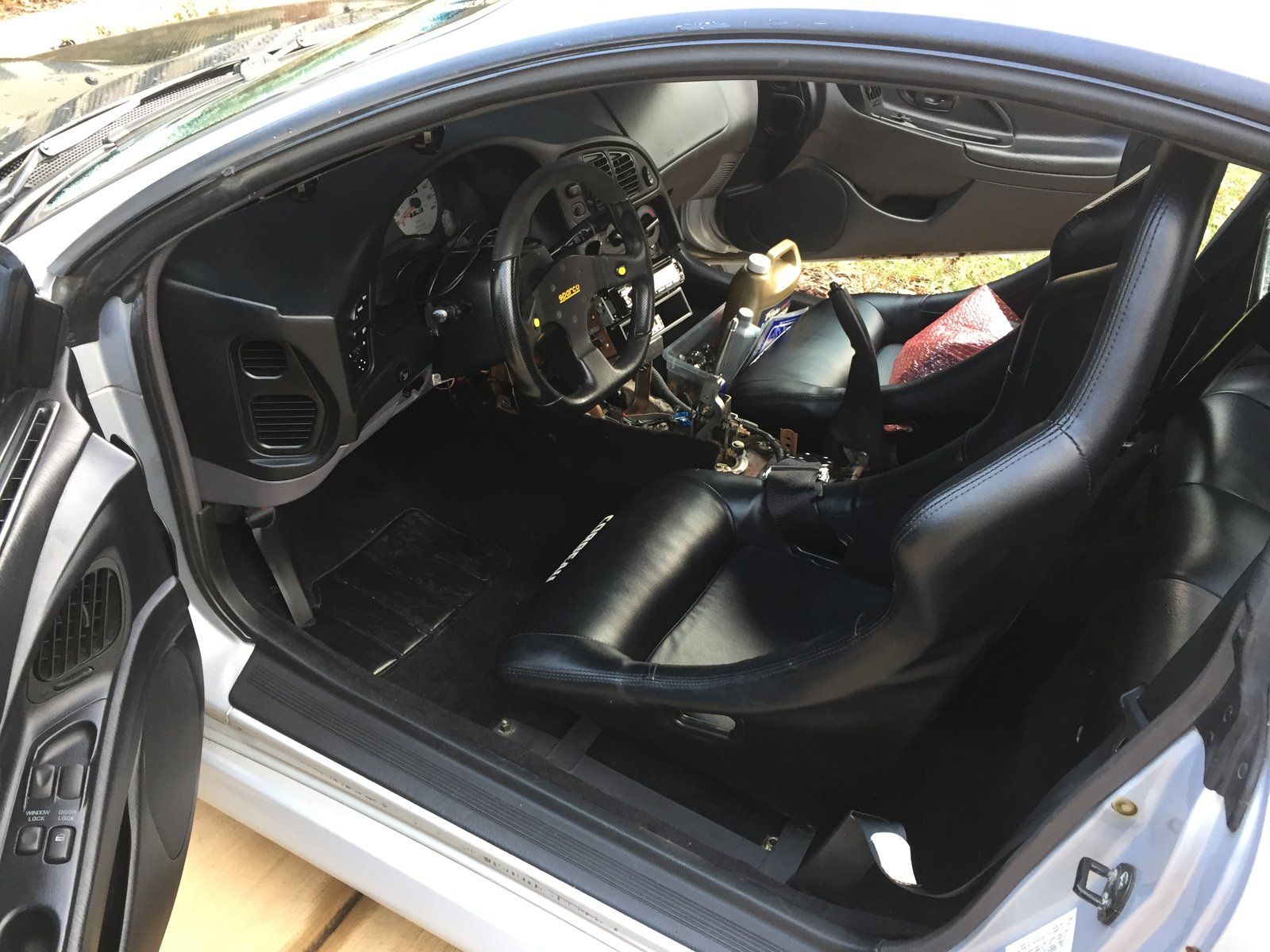

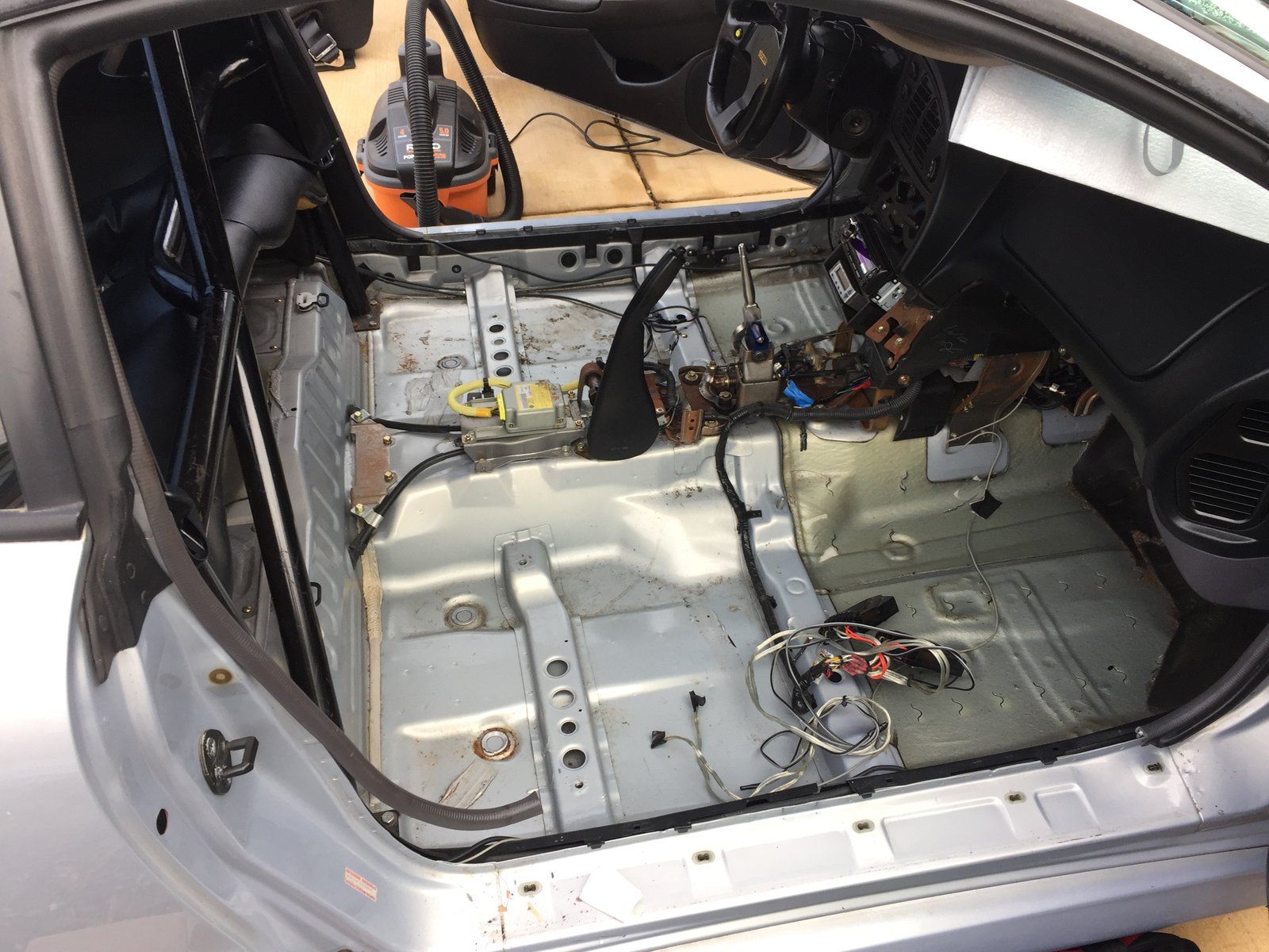

Sunday was a warmer then usual day in Virginia, so I decide to take advantage of the weather and swap out the interior of my GSX to all the new parts I pulled from my 98 GSX part out.
First thing on the list was removing the old worn, and stained gray carpet. Found a lot of dirt and coins under it, but for the most part the body was very clean. The new carpet was much thicker and harder to install. I still need to go back and adjust a couple panels to make it fit just right. After the carpet was done In stalled my new Black glove box, and lower kick panels. Then I moved on and I bolted in my Corbeau Seats. I have to say the car feels, and looks so much better with all black interior. I also swapped over a Suede shift boot. I never liked the fact that our OEM shift boots looked so much like the plastic panels of the car. This suede replacement is a lot nicer.
Next update will included New steering wheel, new radio and door speakers.

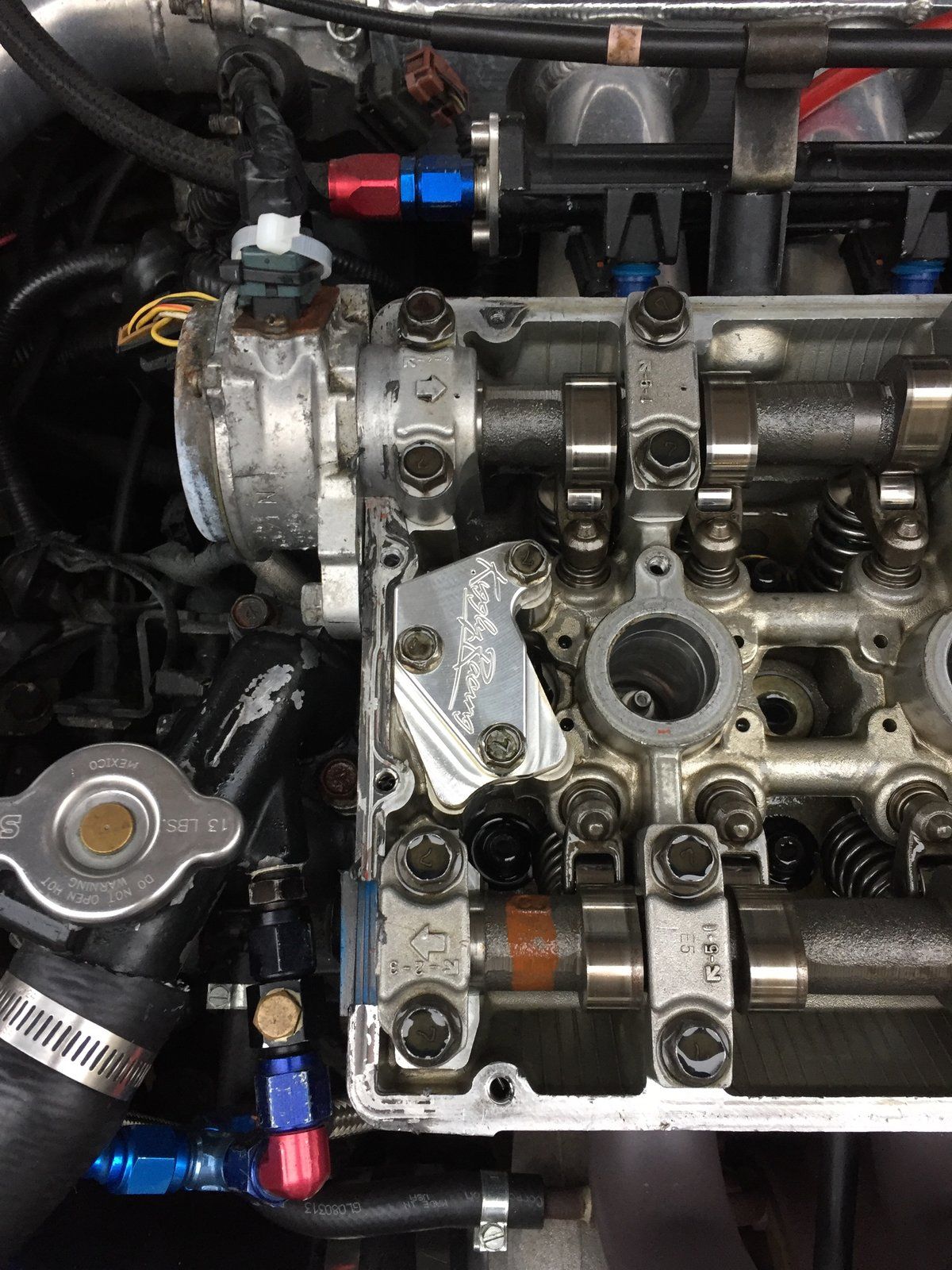

Even though it was rainy and wet all weekend I still found a couple hours to get some work done on the DSM.
Here is a run down of everything I installed this weekend:

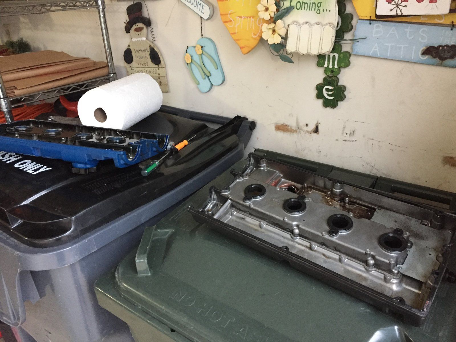

Kiggly HLA
Vented Valve cover with SS bolts
Gamble oil catch can
Gamble coolant catch can
Frontline Fab Cas cover
Aluminum Radiator Brackets
Clear Cam cover
Sparco Steering wheel (need to get the horn fixed)
