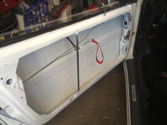

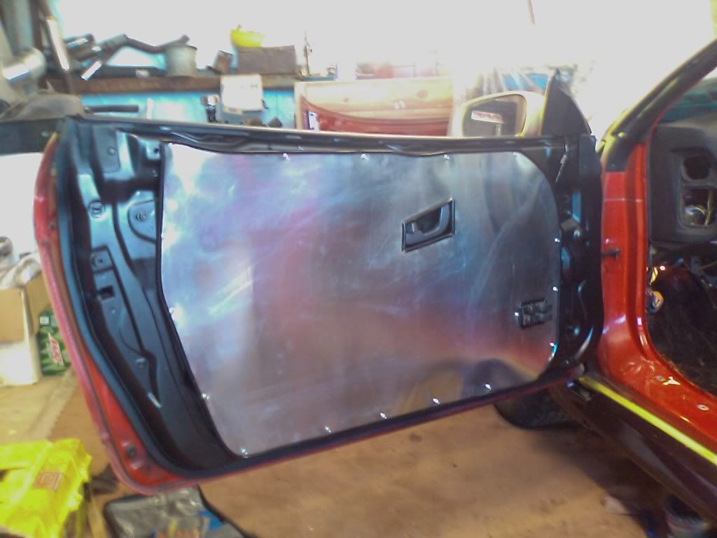

With the doors gutted, the Lexan windows in, and 80 pounds dropped, I was ready to clean up that jagged, gapping hole in each of my doors. I was originally planning on using aluminum sheet metal and riveting it in place like everyone else does. However, in the midst of my brain storm I came up with an idea. What about something lighter, cheaper, and better looking then sheet metal? I think I found it.

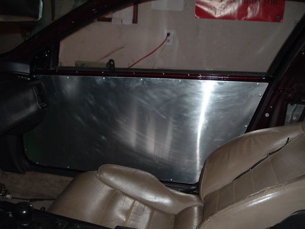

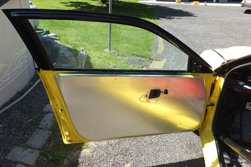

Here are some pictures of sheet metal door panels.

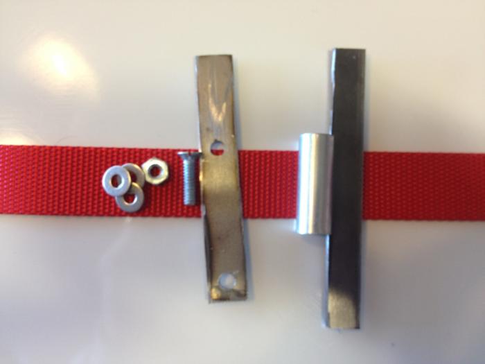

The hardware I used for the mechanical door lock and nylon door pull.
Installing the Door Pull.
Close up of the lock.

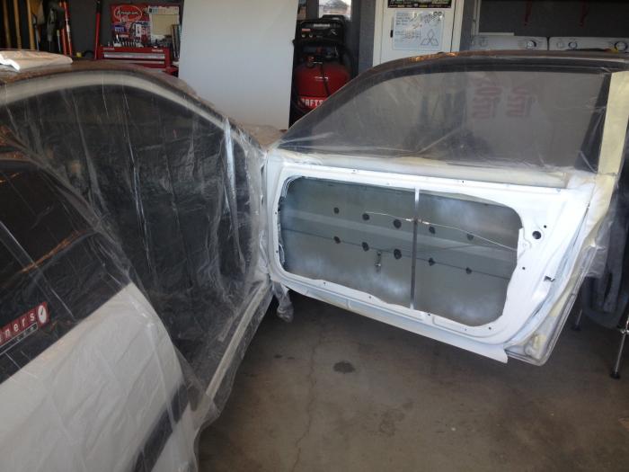

Painting the inside of the door.

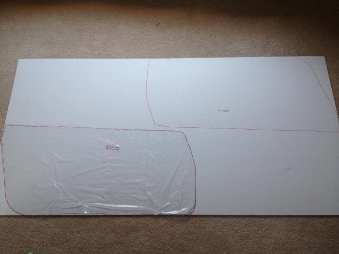

Tracing out the door panels onto the corrugated plastic. I made a template by tracing out the opening onto clear plastic.

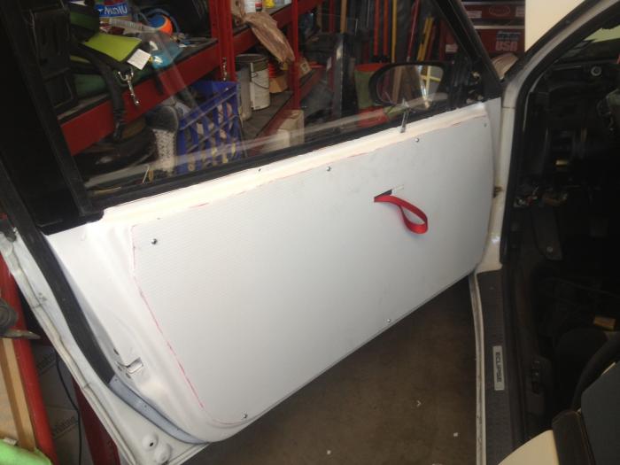

Test fitting and cutting the opening for the door pull.
I also welded in a support brace, right where my elbow will be when I pull the door release so I can just push it open with my elbow.

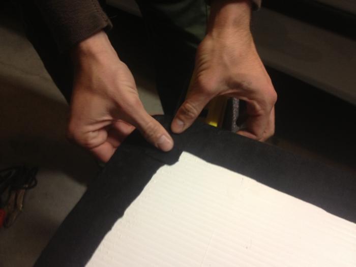

Cutting out the suede to cover the panels.
Glueing the suede onto the panels with 3M general trim adhesive. It's the same stuff you use for headliners.

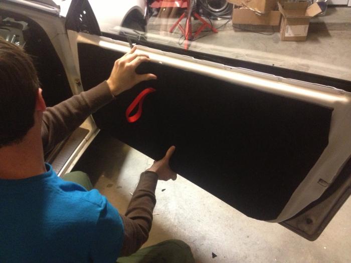

Putting the panel into place.
All done!!! What do you think?
