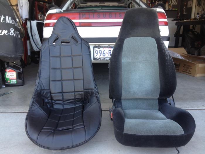

I'd probably pay $150 for the cover and seat if the cover wasn't sharted in and didn't have too much wear. How much is he asking?
:dsm:
He was asking $150 but I got him down to $125. Brand new the combo is $190. However I can get the Summit seat and the cover for $72 brand new. Is the Kirkey that much better? Keep in mind its the economy seat, not the pro.
Put carpet back in if you want the nicer look. It'll match your fancy door panels. If theres no carpet might as well have no panels.
Good point! Guess I've got get to cleaning!

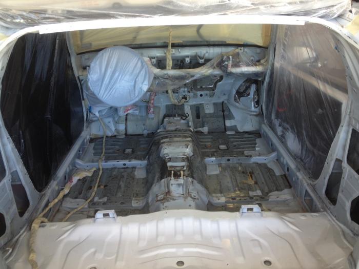

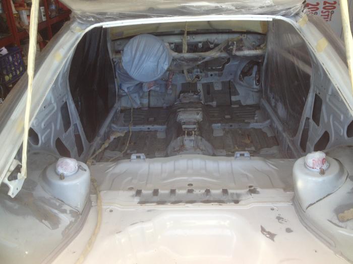

I spent the morning prepping for paint. Everything is wrapped up but I've got to go to work now. Tomorrow I'm off so I will drill out those last two brackets for the rear seats, clean everything really well, and hopefully get it all painted.

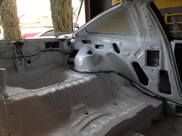

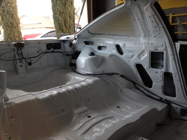

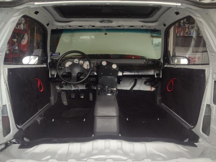

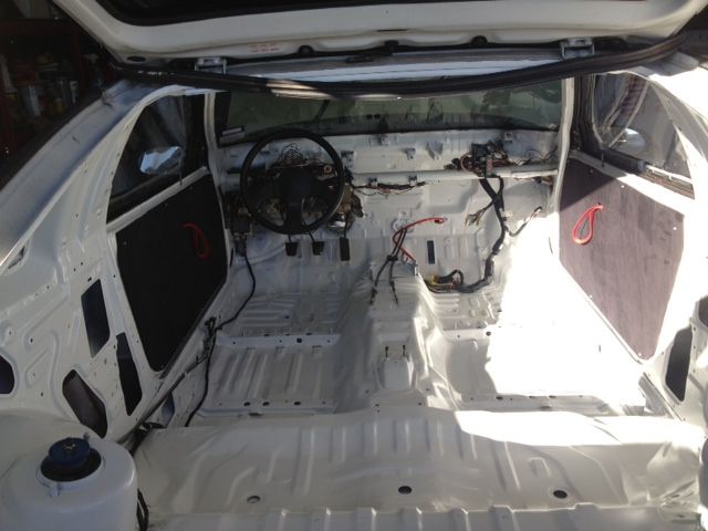

Just a quick update, I painted the interior yesterday and am in the process of putting it all back together today.

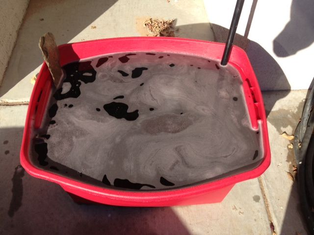

Also I decided to dye my carpet black like in this tech article: http://www.dsmtuners.com/forums/articles-exterior-interior/395839-dying-your-carpet-rit-dye.html. I got the 30 gallon tote for $6 at Walmart and with the 6 bottles of black dye it came out to a total of $25. I'll let you guys know how it turns out.

Also I've pretty much decided that I'm just going to go with the pair of Summit Racing seats and 5 point harnesses as I was originally planning.

It's Rustolium ultra coverage semi-gloss white. It's super cheap, less then $4 a can. I used 8 cans, probably could have used another one or two for under the carpet area but I didn't really care since I'm using the carpet anyway.

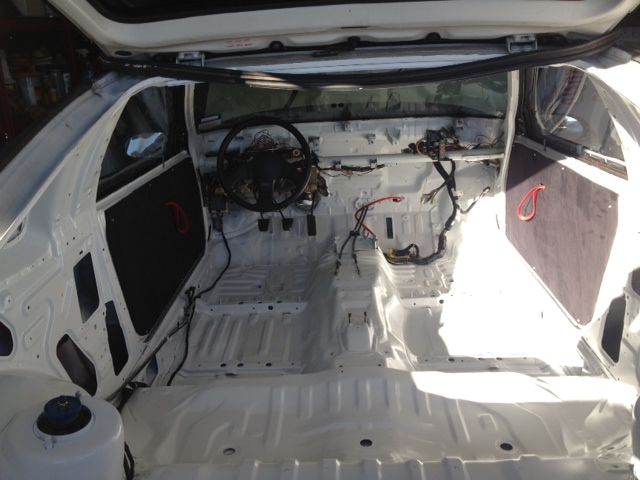

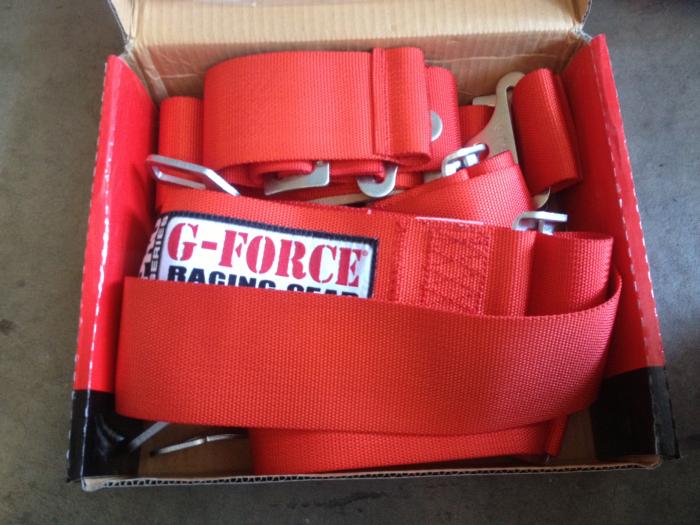

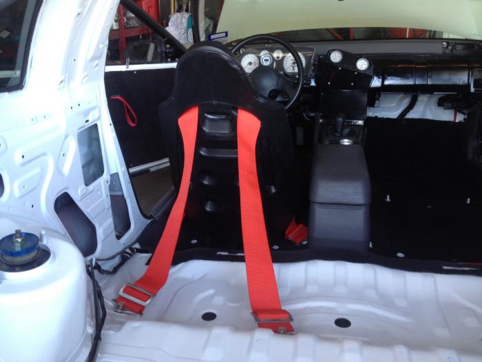

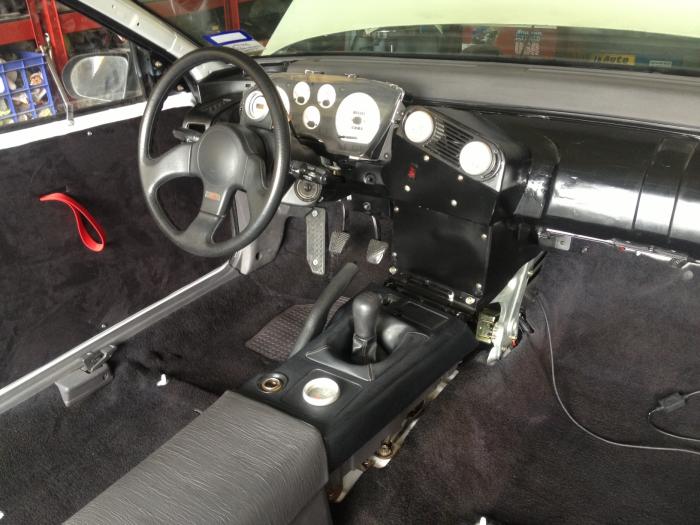

Here is the finished interior for now. I'm just missing my Summit Racing seat with an all black cover and G-Force 5-point harness in red (which I haven't even been able to order just yet).

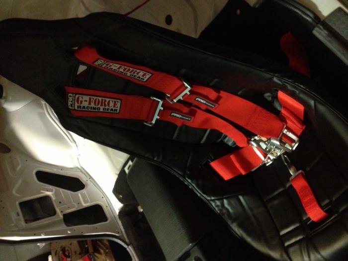

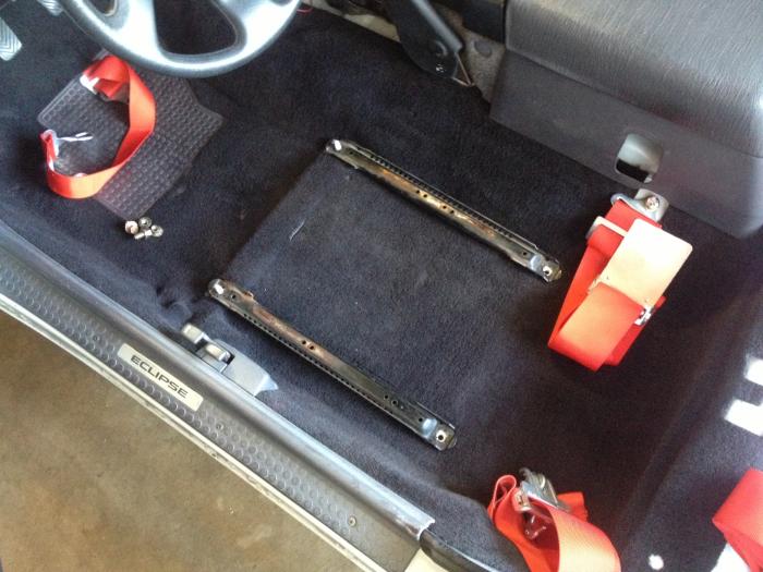

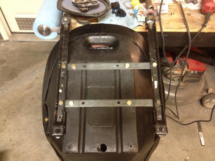

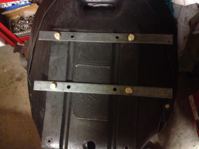

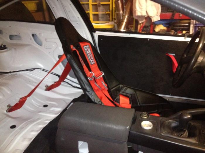

Seat and harness are installed! I received them yesterday and immediately got to work on the install. I decided to use a portion of the original stock seat brackets so I got to work drilling them apart to remove the slider portion. I then used some 3/16" thick by 1" wide steel bar to make brackets to attach from the seats themselves to the stock lower brackets. After that I drilled a few holes and bolted everything together with 3/8" x 3/4" grade 8 bolts. Not to shabby!
As for the harness it bolted up to the stock seatbelt holes using the stock hardware with no issues. I know this is not the ideal angle for the shoulder straps but it is the best I can do until I get a cage, which is still a ways off. The only thing not attached yet is the submarine belt. Anyone ever mounted one of these before? If so where?
This is probably going to be about it before hitting the drag strip in March. I'm going to try to get it back on some scales to get an exact weight soon. The next few mods will be a fuel cell and bumper exit exhaust but they are being put on hold for the moment. We found out our baby is going to be a little girl so we are currently working on the baby room. Then Autox season will be starting up so I will be playing with the Evo too. Life pulls in all directions but its a blast. Enjoy the pictures!

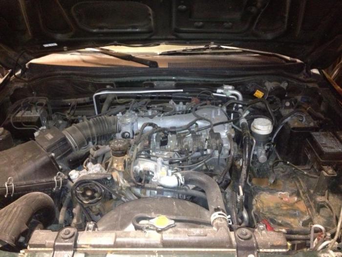

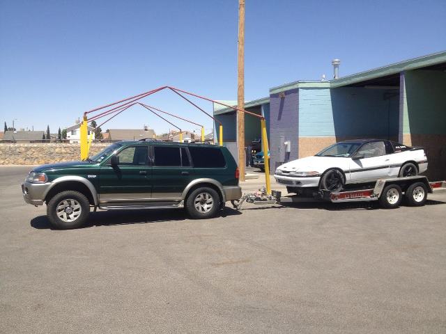

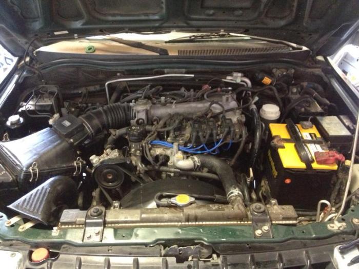

With less then two weeks to go before my first rallyx in Tucson, Arizona, I needed a way to tow my Eclipse 5 hours away. I went out and bought a 2000 Mitsubishi Montero Sport 3.0 4wd with 120k miles for dirt cheap. It was barely running and in no shape to tow anything anywhere. I got to work and over the next 10 days, I replaced the timing belt, water pump, valve cover gaskets, cam seals, spark plugs, wires, idle air valve, battery, transmission filter, did a transmission flush, headlight and brake light bulbs, wiper blades, installed a trailer hitch, and got it inspected and registered. After all that it ran like a champ!

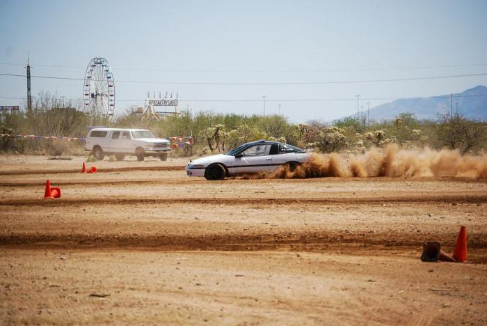

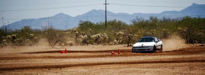

This Friday we headed out for Tucson, AZ. The Montero did a great job towing although it was sagging a lot in the back. I will be replacing all the shocks and installing a Airlift 1000 kit in the rear for future towing. On Saturday morning we got to the event and the fun started! They only run 4 classes at this event - stock 2wd, stock 4wd, modified 2wd, and modified 4wd. My Eclipse was in the Modified 2wd class. There were 25 entrants, mostly Subarus. There were 2 Evo's, one that came out from El Paso with me, a C6 corvette (Not expecting that!), a couple of Ford Focus's, a truck, and pretty much the rest were Subarus. In the Modified 2wd class it was just me and a fully built rally Focus.
Things went well during the event. For those that don't know, in Rallyx all the times are added together collectively and your score is your time for all 6 runs together. After Rounds 1, 2, and 3, the Focus was ahead of me. I made a comeback and took the lead in round 4 after he hit a gate, kept the lead after round 5, and he retired before round 6 due to the car overheating so I walked away with a first place class finish in my first ever rallyx. I was quite excited!! Here are some pictures of the event thanks to Corey (gofer) who came down from Phoenix to hang out at the event and take some pictures!!!
