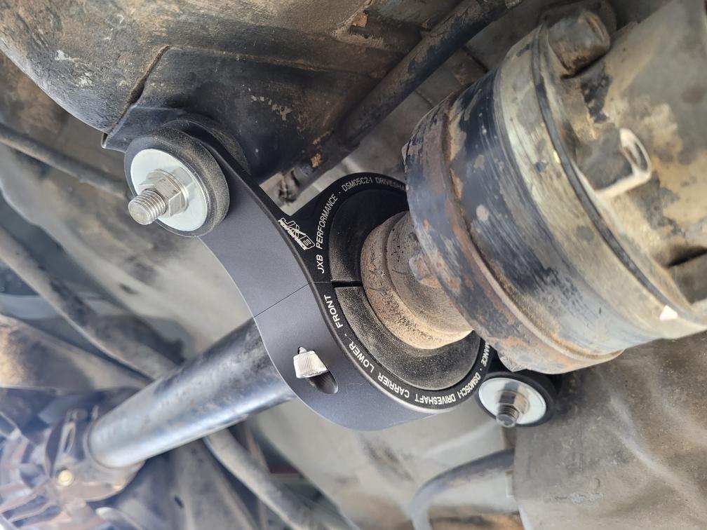

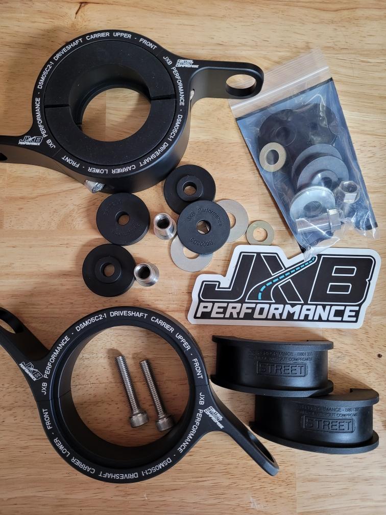

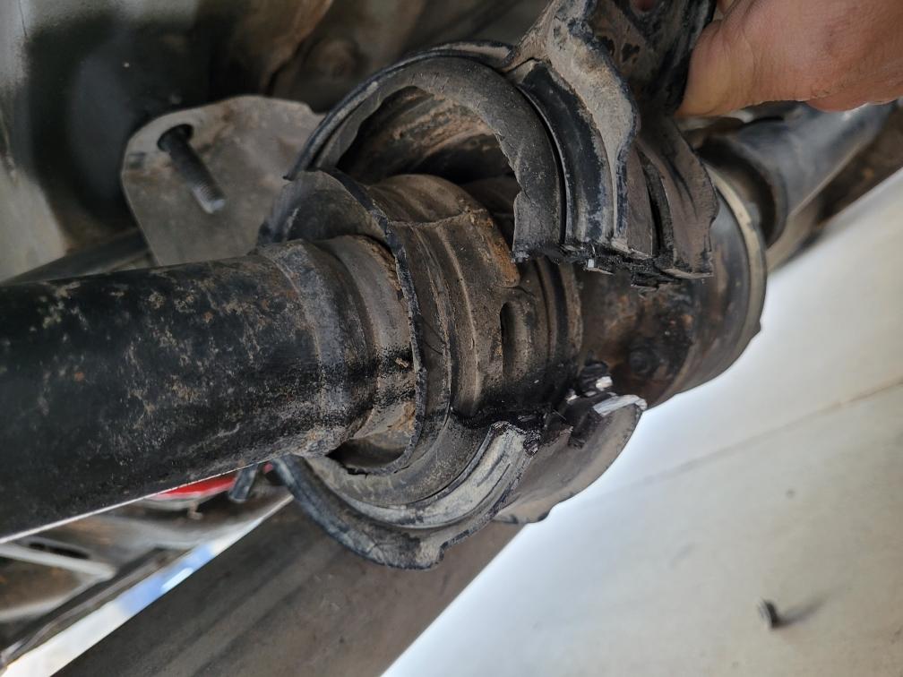

This morning I installed the JXB Performance driveshaft bearing carriers. It was a very easy install, jack up the car, lower the exhaust, unbolt the old carriers, cut the metal portion I used a grinder with a cutoff wheel), remove what's left of the rubber portion (I used a box cutter), and reinstall the new ones. I went with the "street" material which is softer. They also offer a "race" version which is stiffer.
Check out the before and after video to see the vast improvement in play!
I drove my Eclipse to work today (you've got to drive your Eclipse on Eclipse Day, right?), and the improvement from the JXB carriers is incredible! That clunking sound it gone, the shifting is much better, and the overall quality of the drive is vastly improved. I am very glad I went this route and highly recommend them!

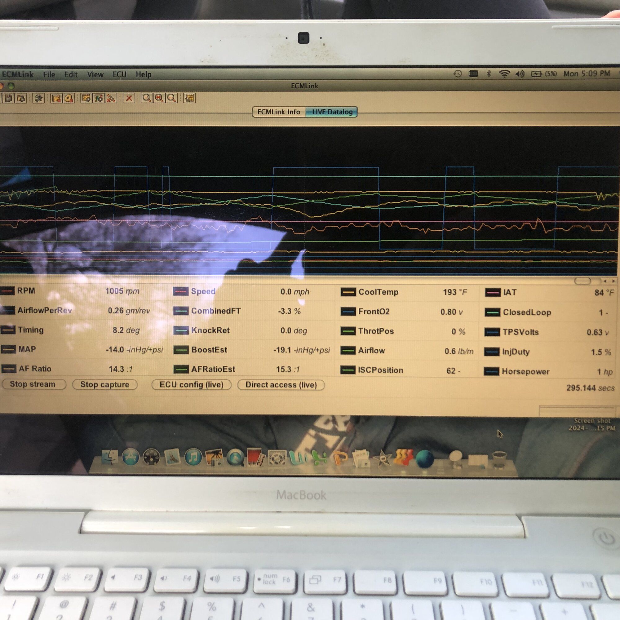

I think the prime feature would completely solve my issue but can't get the newer ECMlink application to work on either of my laptops and my current version of the application doesn't have that feature. I have also changed the diaphragm in my AFPR to no avail, so I think it is just the lack of a check valve in the Walbro 255.
On my old laptop that I have always used ECMLink on (2006 MacBook running OS X 10.6.8 and ECMLink 3.22.172) I can connect to my car (running V3 Full). So that tells me my ECU, cable, etc. are all working.
I tried to update to the newest ECMLink application (ECMLink 3.46.226), but it requires OS X 10.11 or newer. This laptop is running the newest OS it can handle (10.6).
I pulled out my wife’s laptop (2009 MacBook running OS X 10.13.6 and was able to install ECMLink 3.46.226 and the drivers for OS X 10.4+ but it cannot connect to my car.
I was able to download the firmware request from my old laptop but can’t move forward until I can get the laptop with the newest application version to connect.
I haven't messed with hot start enrichment, but it starts great after it's been running. The only issue is after it's been sitting for hours and fuel pressure has dropped.
Also on the low idle issue, I checked with ECMLink when I got home yesterday and my ISC was at 90+. The car was idling so low it actually did shut off when I pulled in the driveway. I unscrewed the BISS a couple of turns until the ISC position moved to 60 and it seems much better now but I'll have to drive it a little more to confirm.
I've been reading that the latest version of the app is causing problems (ie. not running/running well). 3.36.73 is the sweet spot still. Are you able to get that one? I have the Windows installer if you need it.

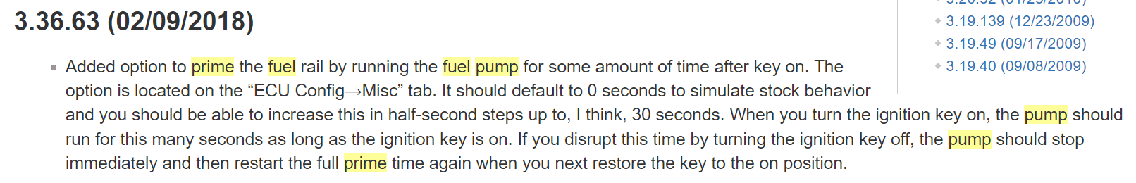

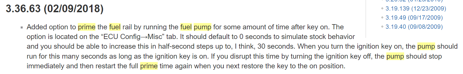

For your long cranking/not holding fuel pressure issue, do you have this feature enabled in ECMlink to prime the pump with the key on? This may be a quick and easy fix.
I was very excited when I found out about this feature, but I have not been able to get my laptop that can run it to connect to my ECU. I made a post on ECMTuning about the issue but no solution as of yet.

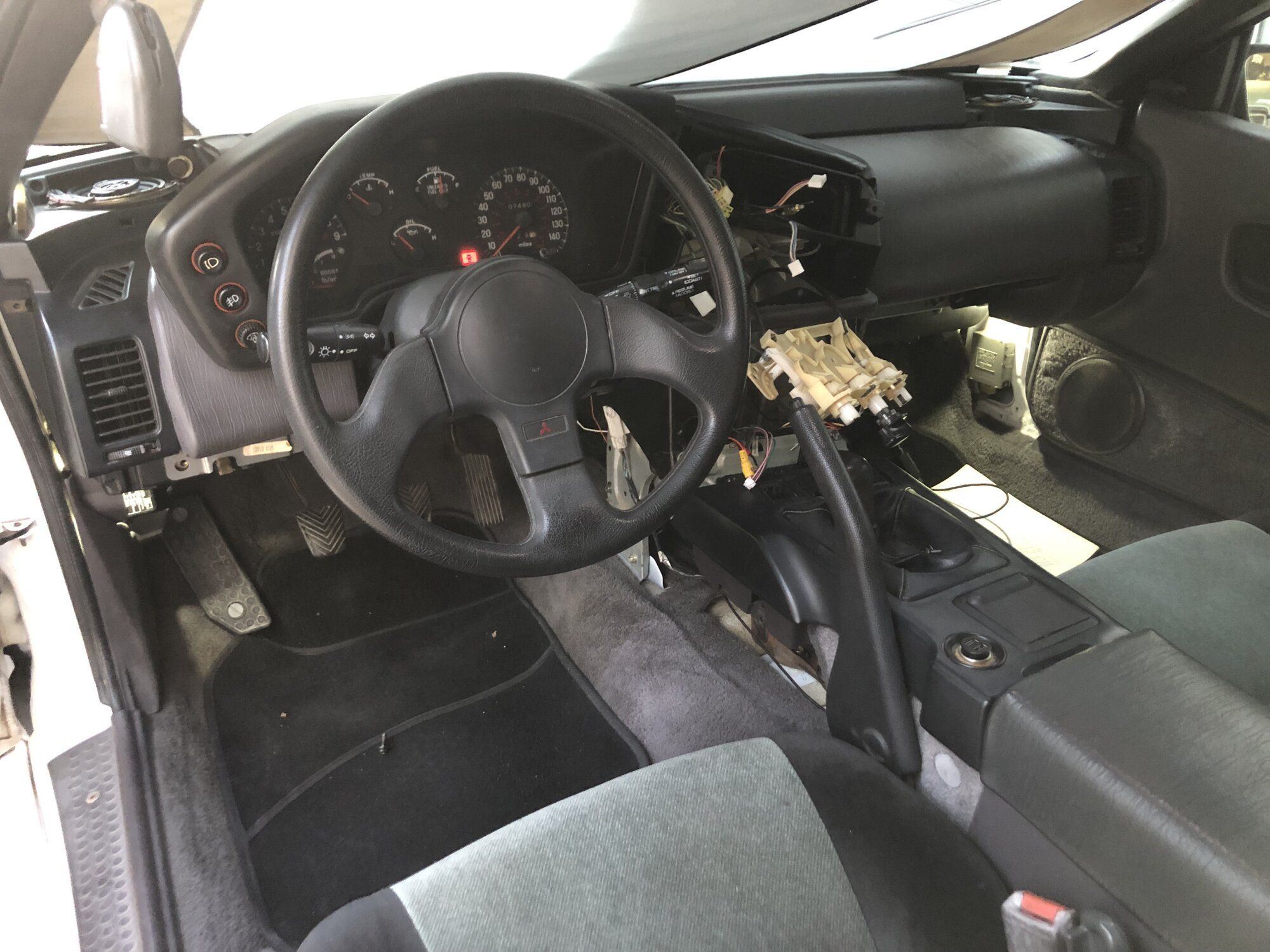

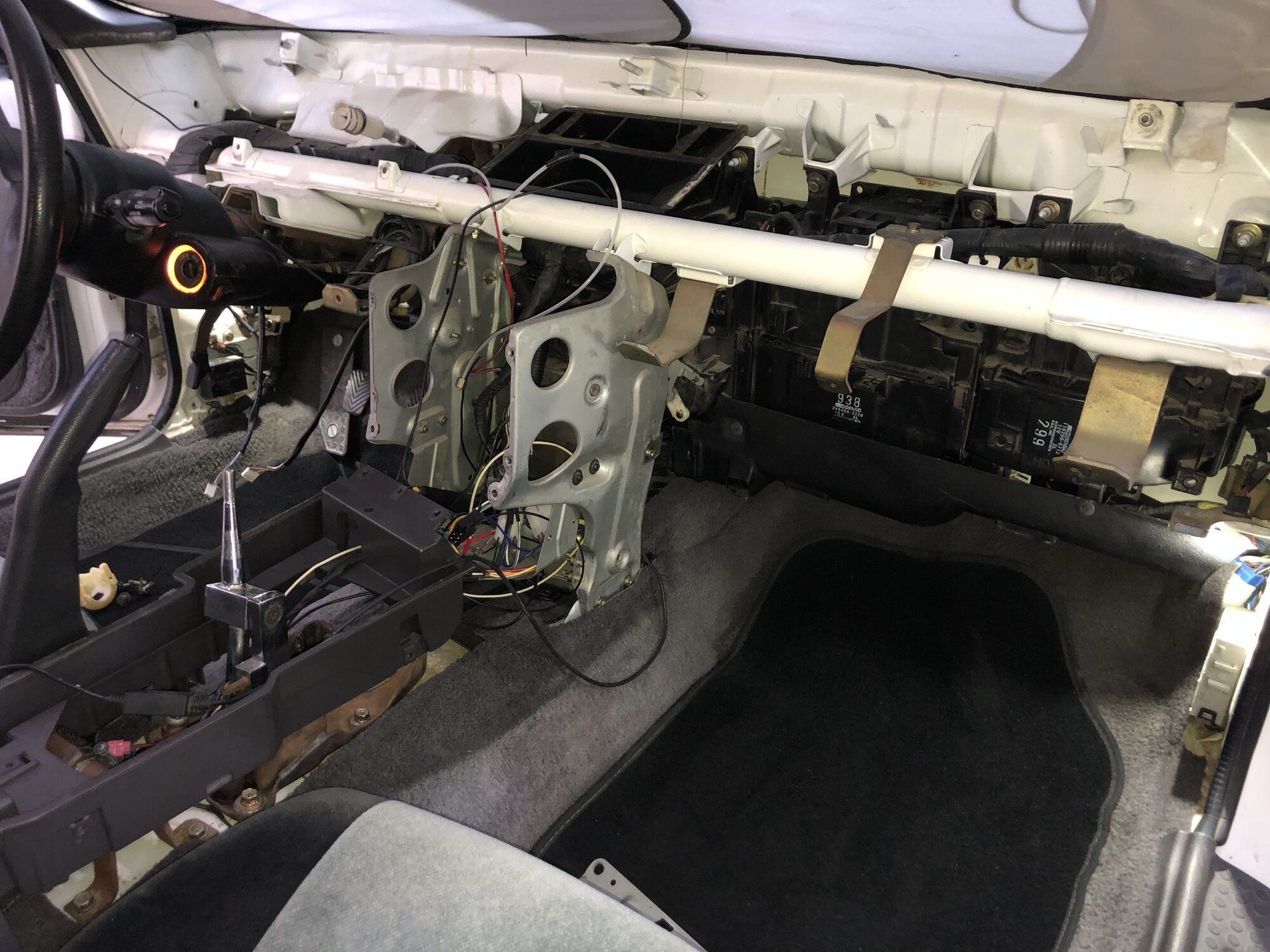

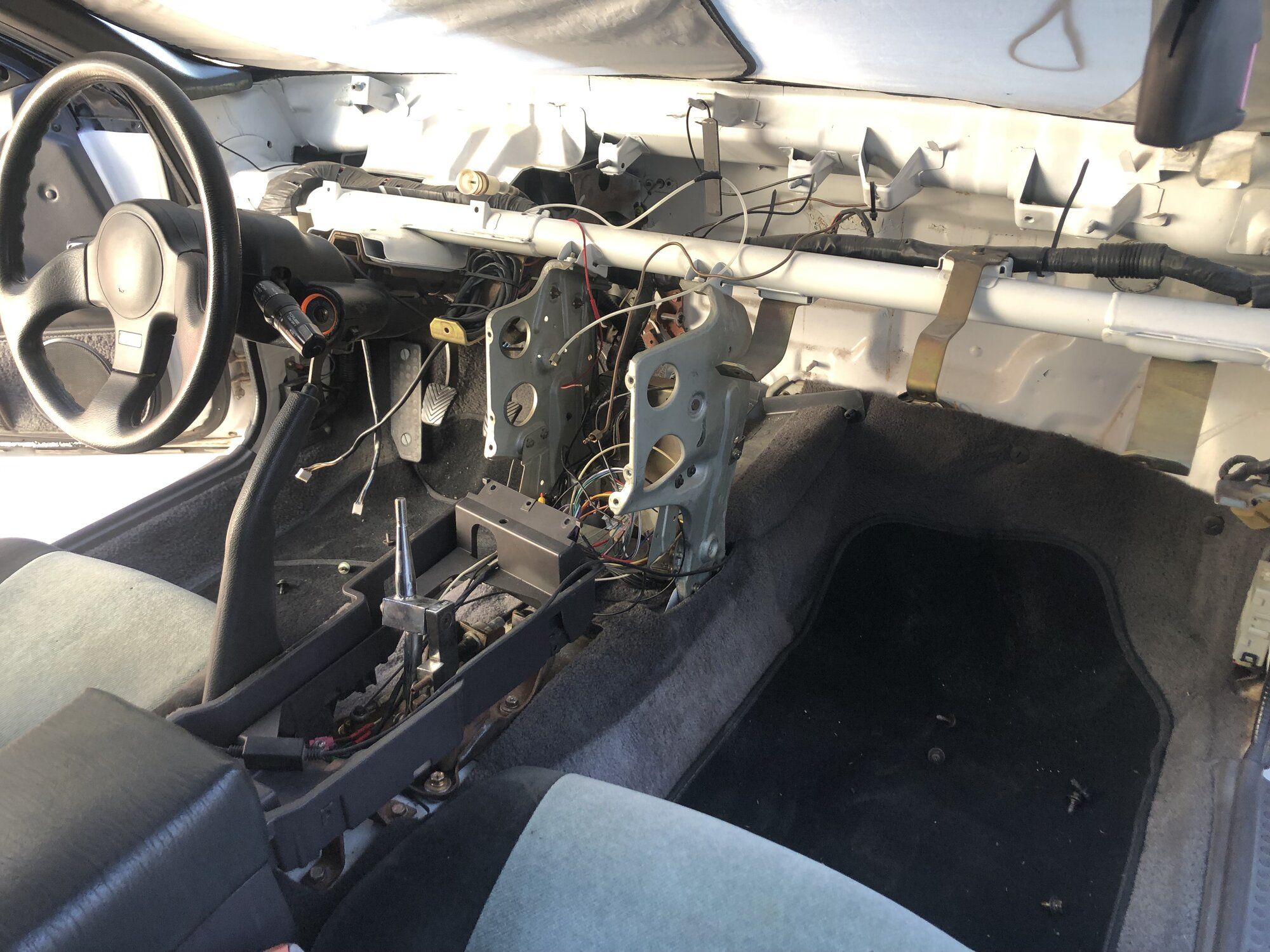

It's been a few weeks since the last update, but I've been busy behind the scenes collecting parts. I ordered all the missing ducts to reinstall the HVAC system and new cluster and HVAC surrounds since mine had warped from years sitting in the El Paso heat (a big thanks to DSM Partout!). I also ordered a new AEM boost gauge to match my wideband, as I am ditching the old Autometer Ultra-lite gauges I've had for decades.

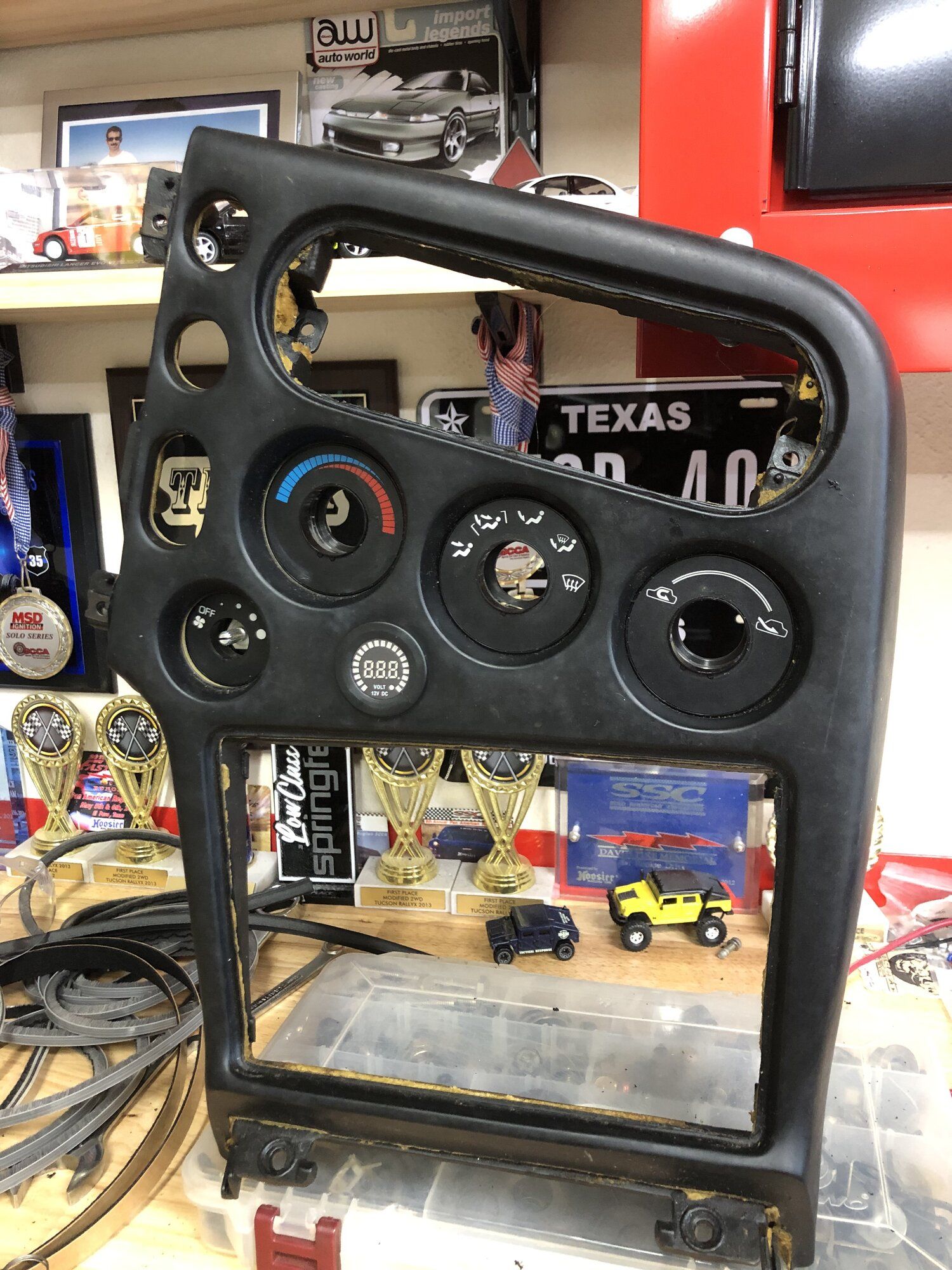

I pulled the dash and reinstalled the HVAC components (except for AC). That was all quite simple.

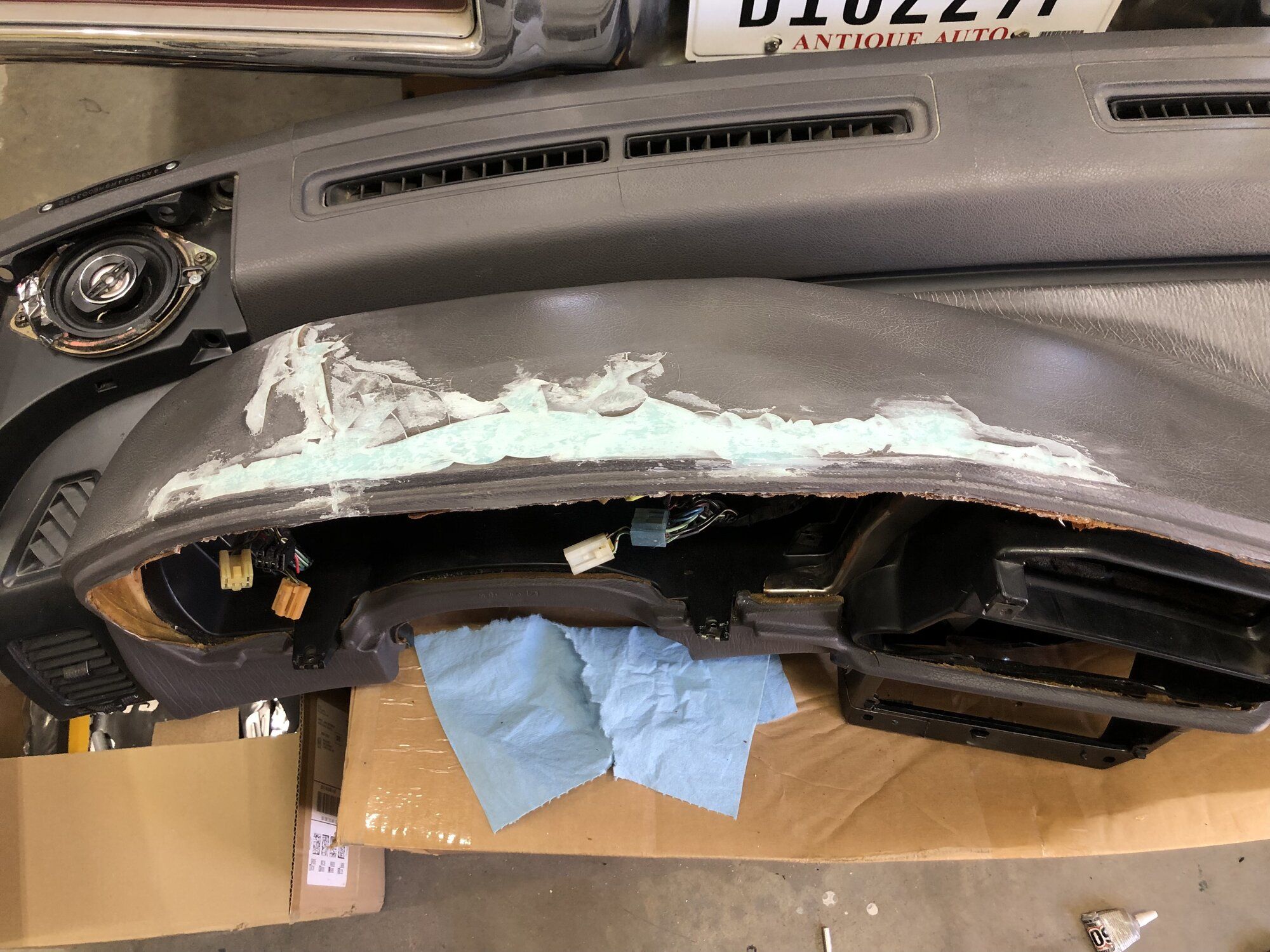

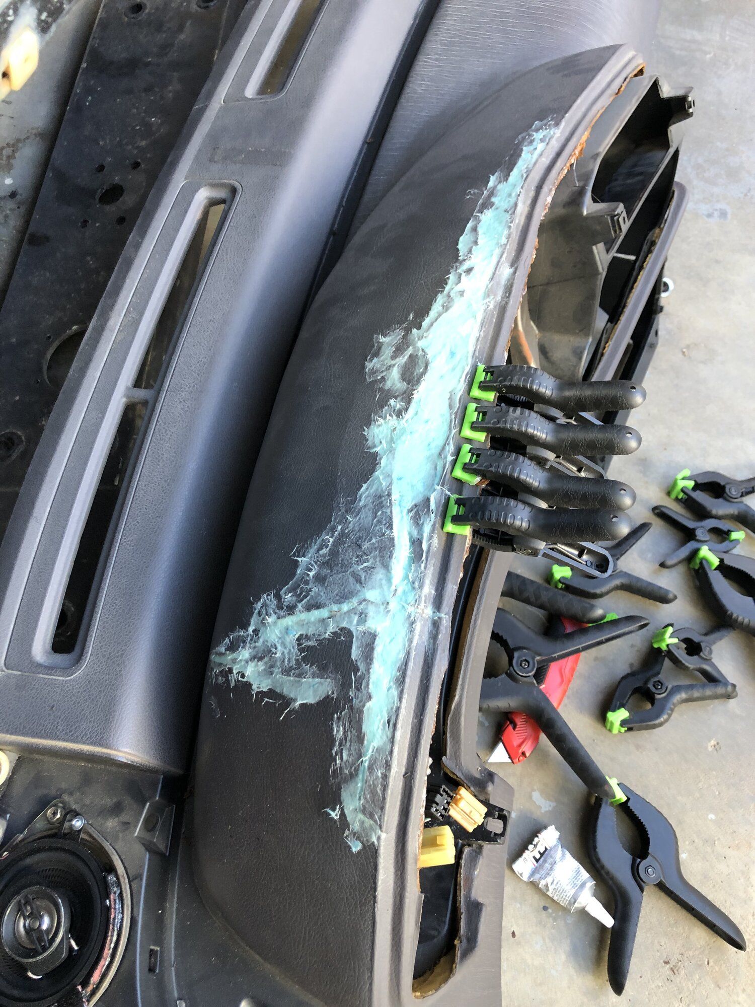

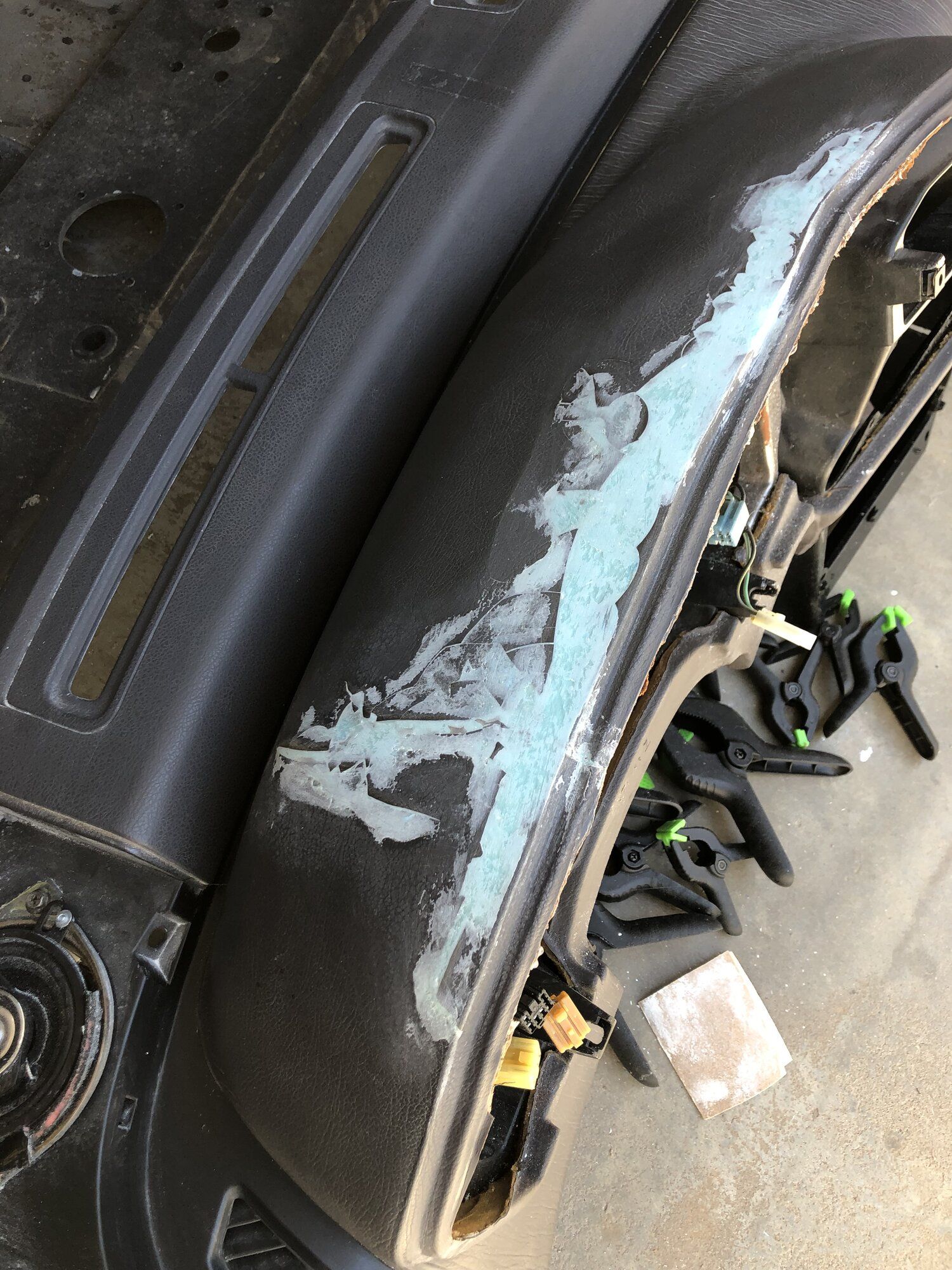

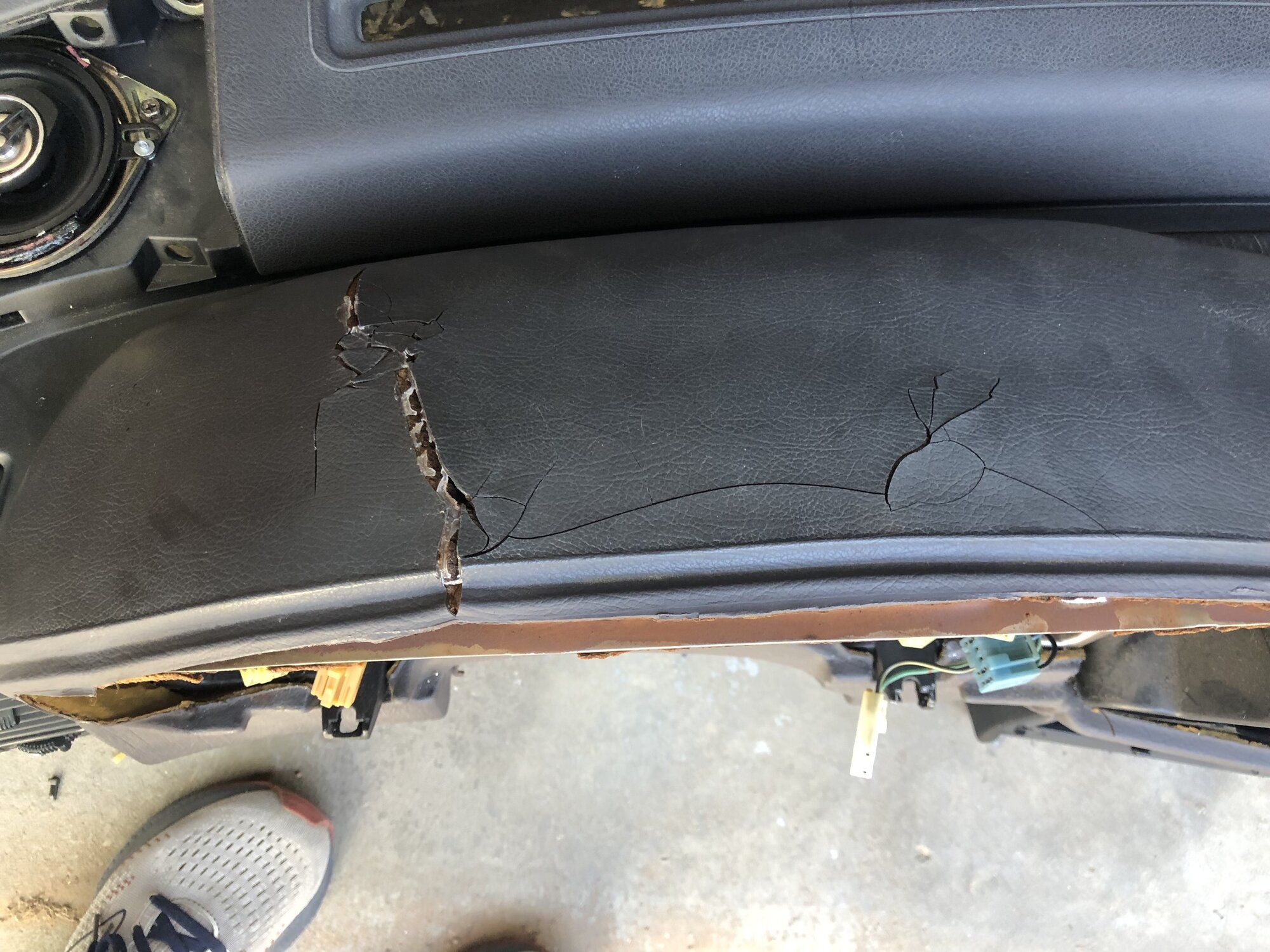

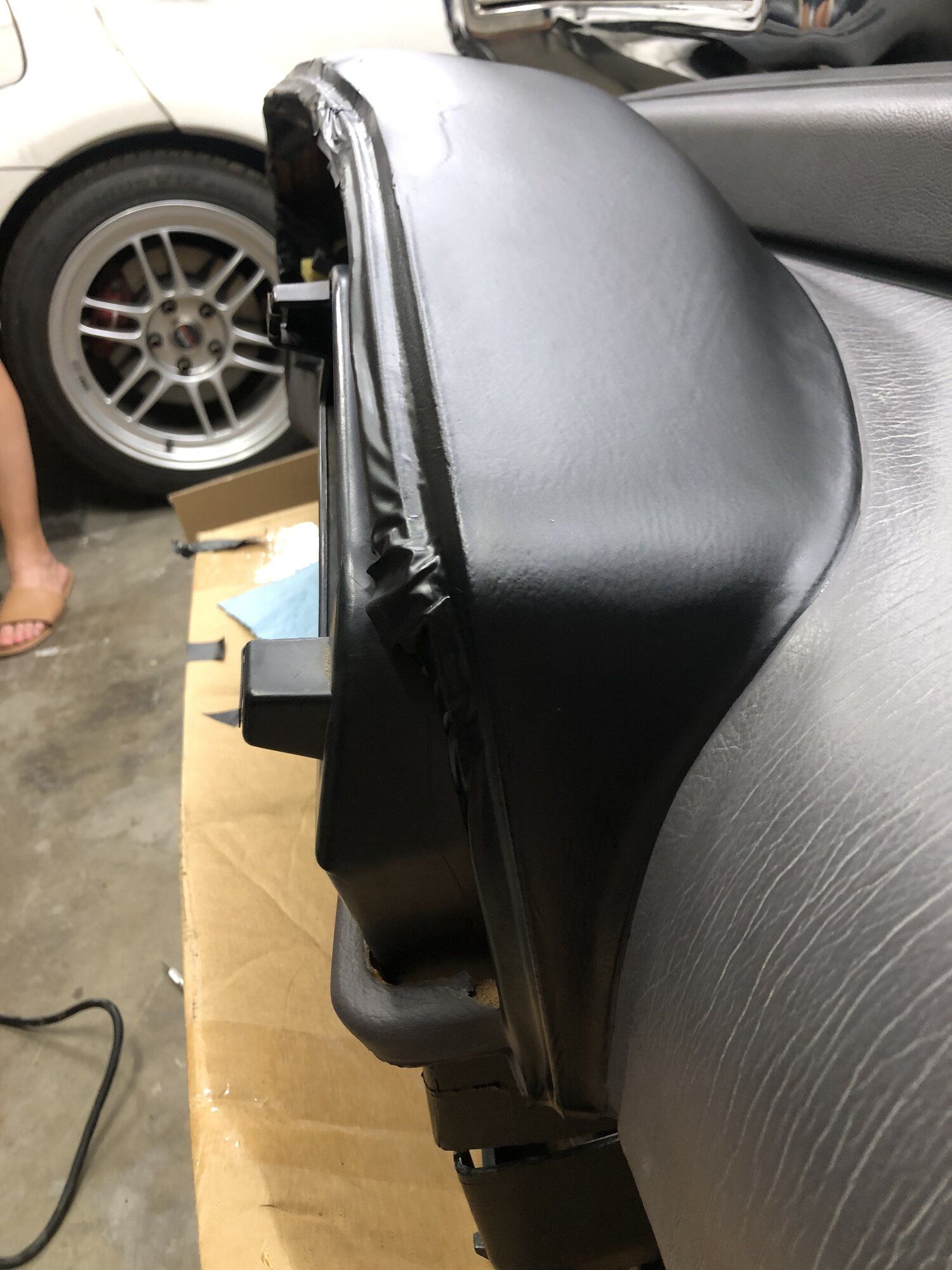

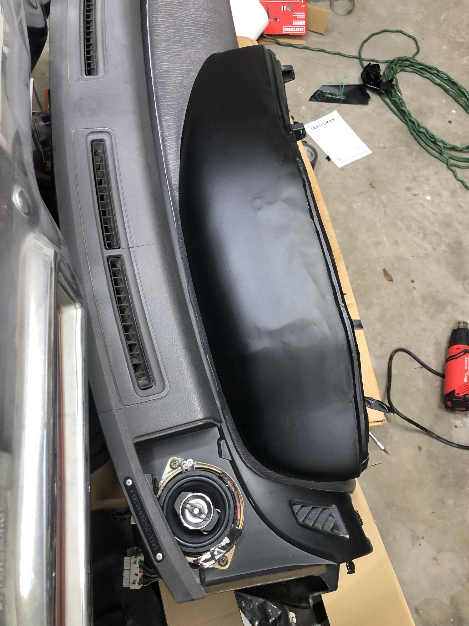

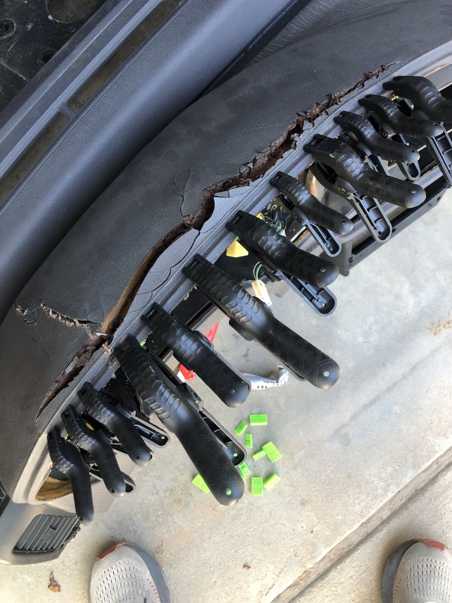

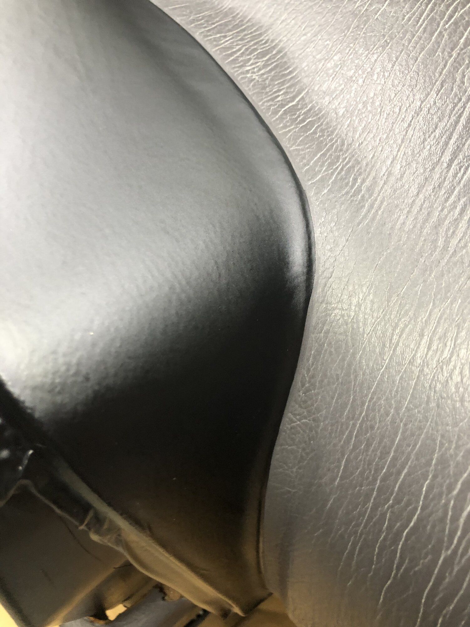

I wish I could have gotten a new dashboard too but too bulky to ship and none were available at any local junkyards. Since replacing it wasn't an option, I had to get creative.
The top was so dry it was cracking and had pulled away from the edge, leaving a big gap behind the surrounds.
Step one was to get the front edge back where it needs to be. To accomplish this, I cut a line across, repositioned the edge, and glued it in place. Then I glued under the dashboard padding on both sides of the cut to hold it down.
Finally, I did two coats of fiberglass to fill in the huge gash and all the cracks followed by lots of sanding. It's not perfect, but it should work. My plan is to wrap this portion of the dash in matte black vinyl to cover everything.

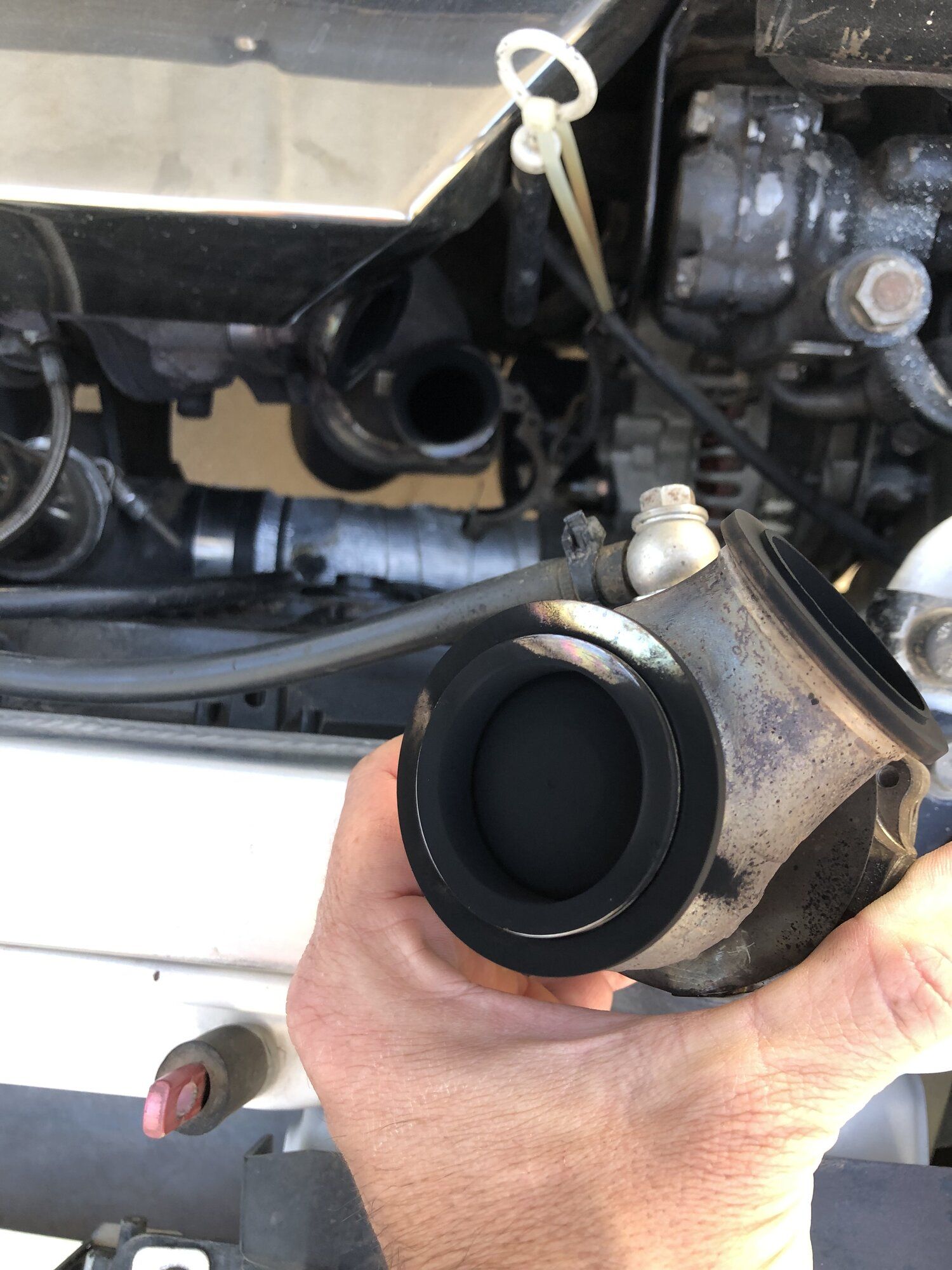

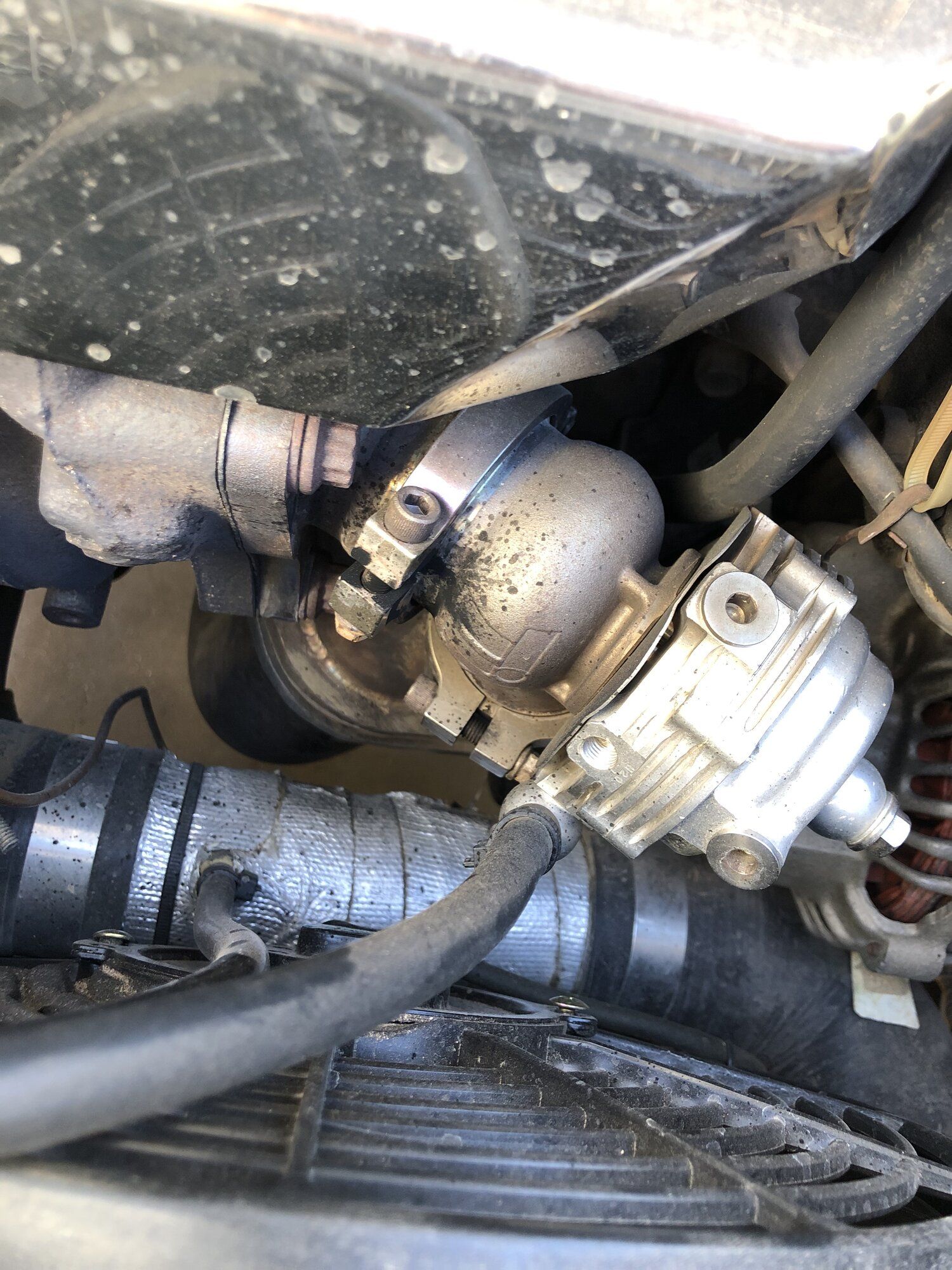

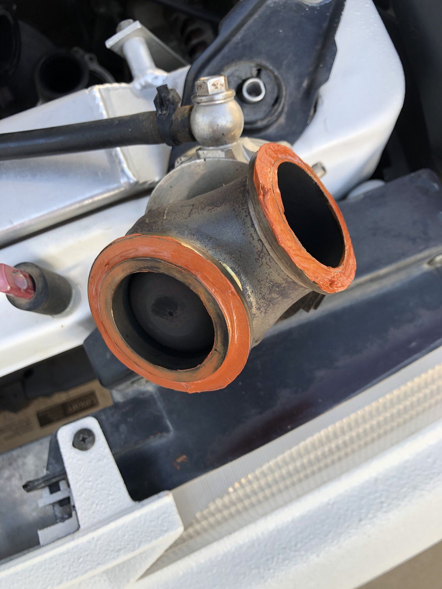

Lastly I had noticed a sound under boost that sounded like an exhaust leak. I checked it out and found exhaust leaking from the v-band on my wastegate. I don’t know why because it was on there tight. I loosened it up, repositioned the clamp, and retightened it. Hopefully that helps.

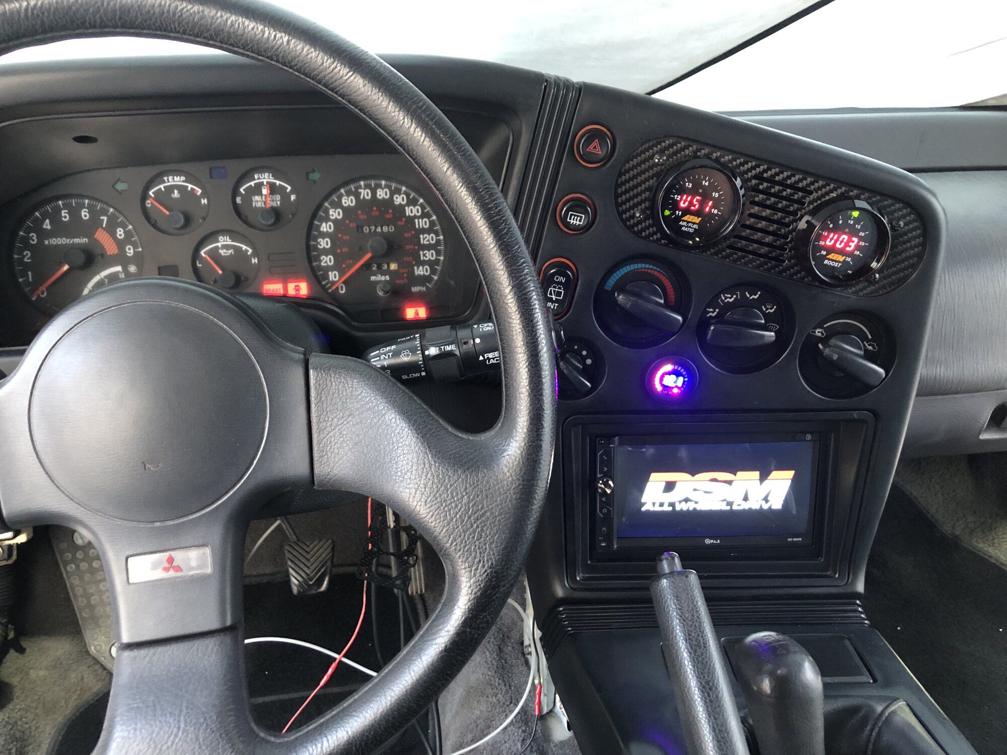

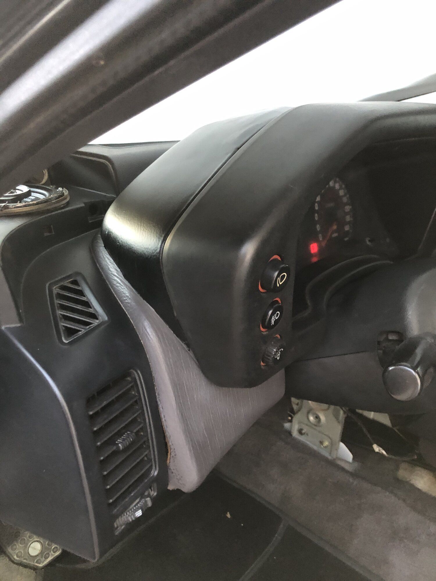

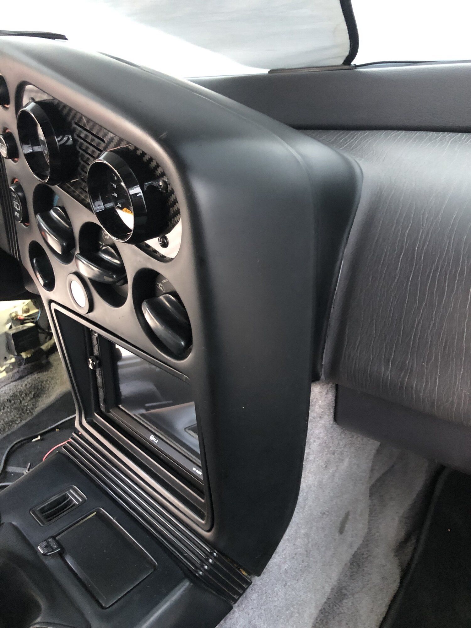

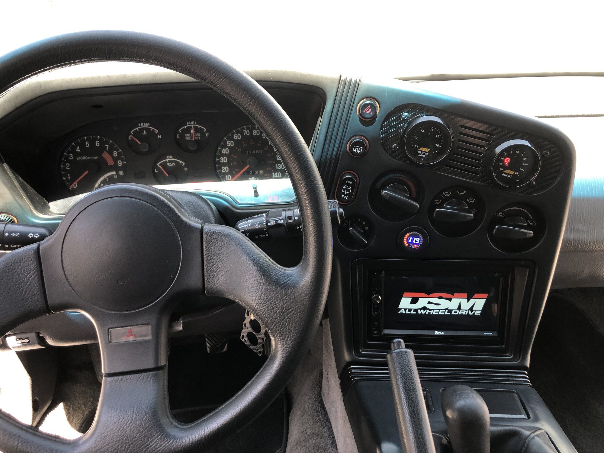

I ordered a small roll of VViVid matte black vinyl and a heat gun and got to work wrapping the top of the dash. This is my first time ever wrapping anything and I think it turned out pretty great. It's not perfect, but I'm not embarrassed by the cracks all over my dash anymore either. Now I'll have to see how this repair holds up over time.

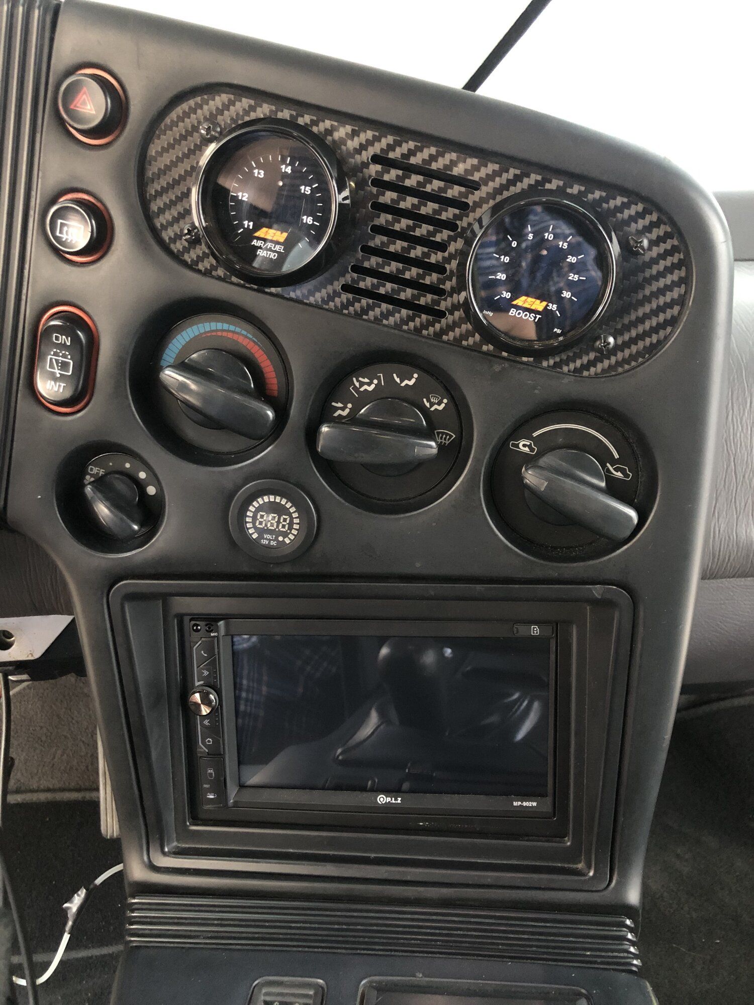

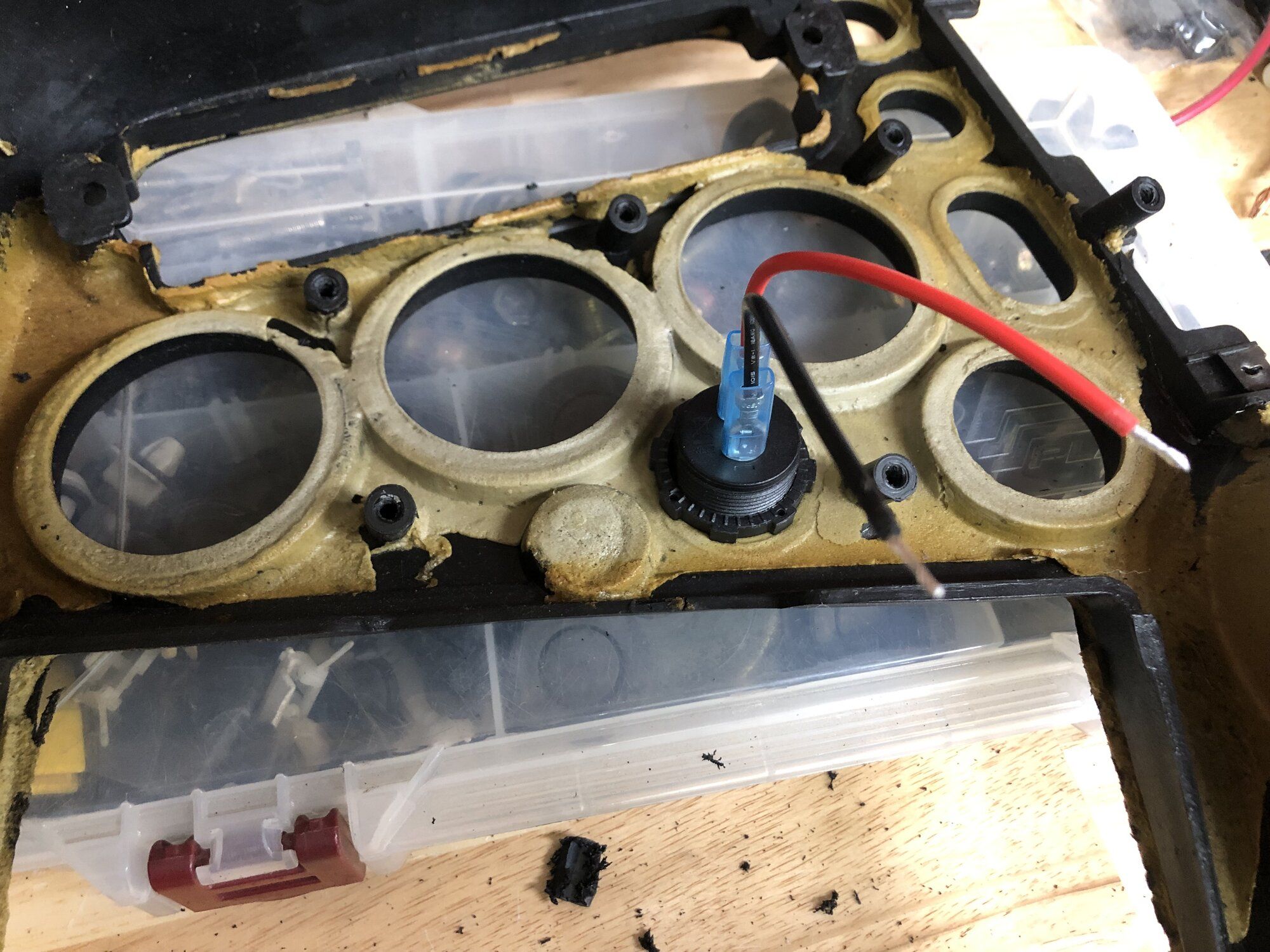

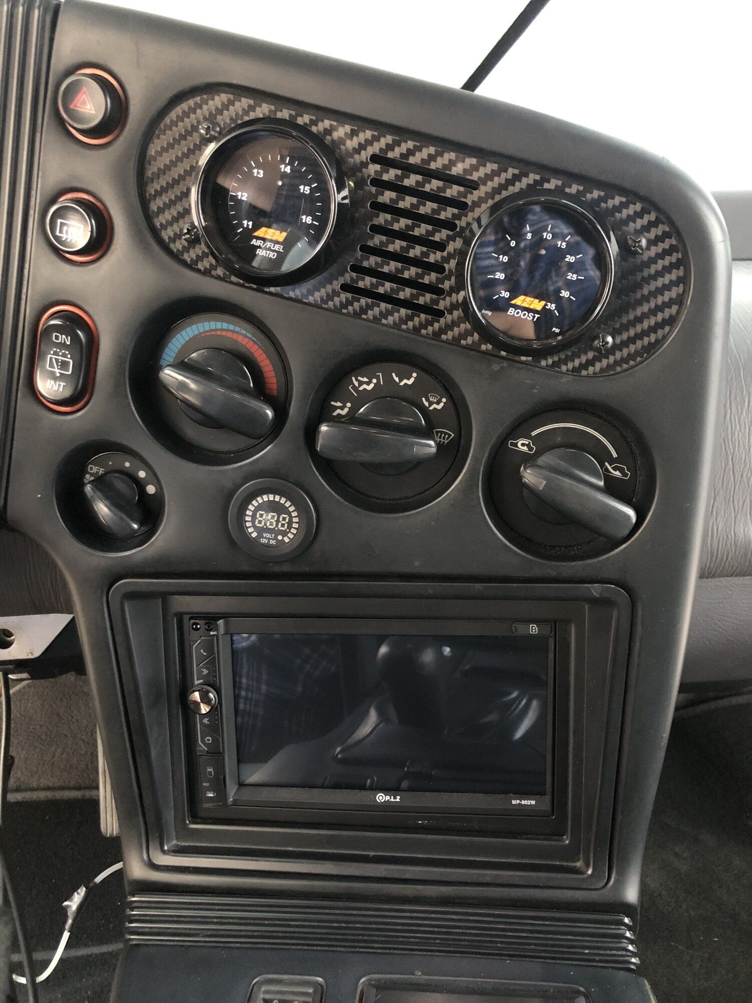

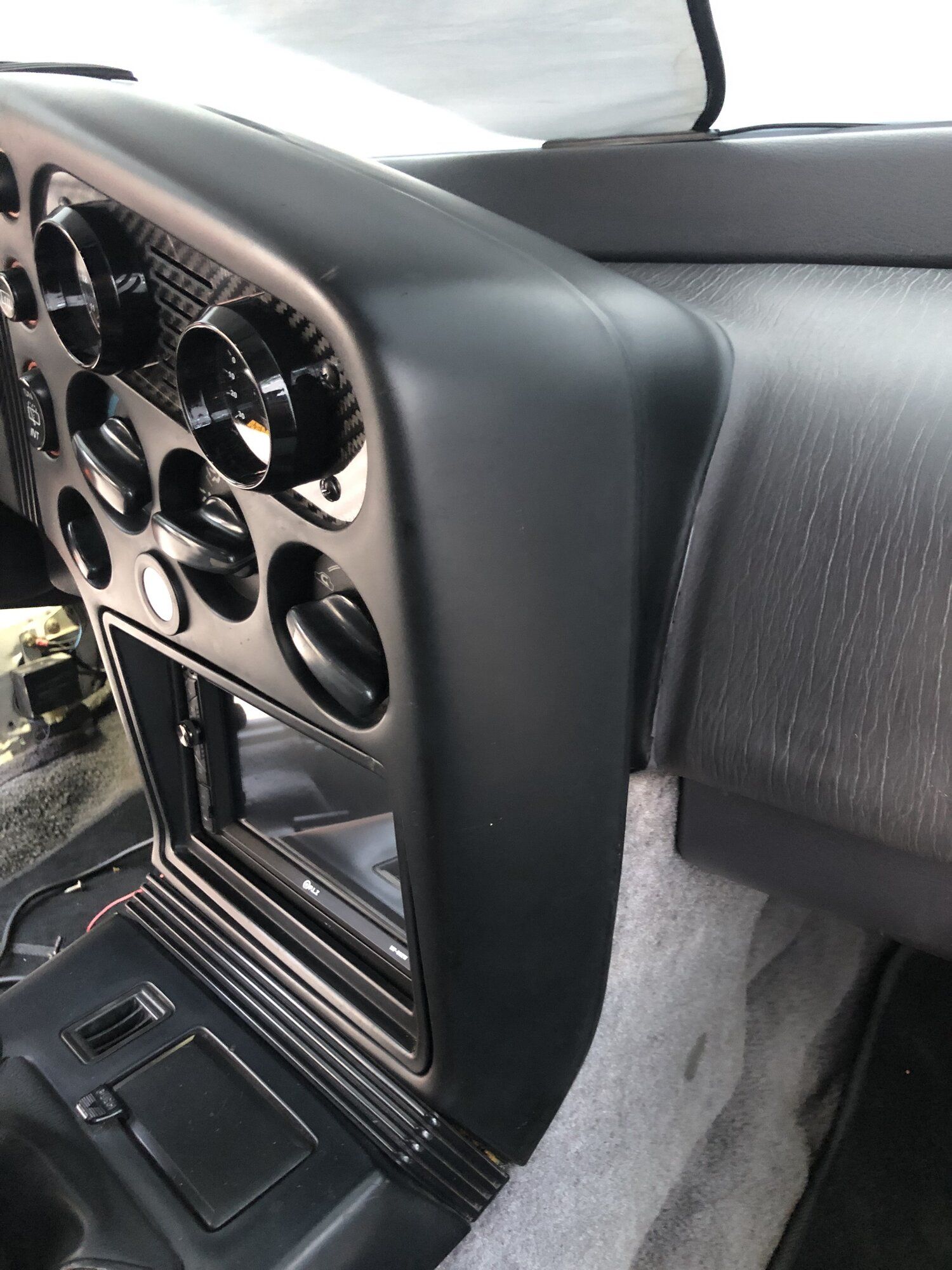

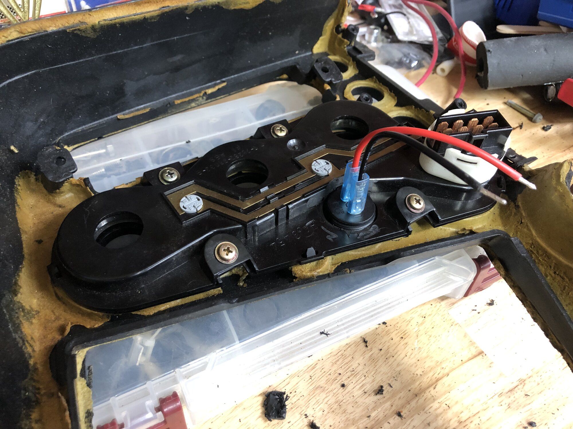

Since I'm still not running AC, I bought a small voltmeter to install in the AC switch location. I made a few mods to the plastic dial insert and it fit in great!
This evening I'm hoping to hook up the HVAC cables, install the AEM gauges, and the remaining lower vents.

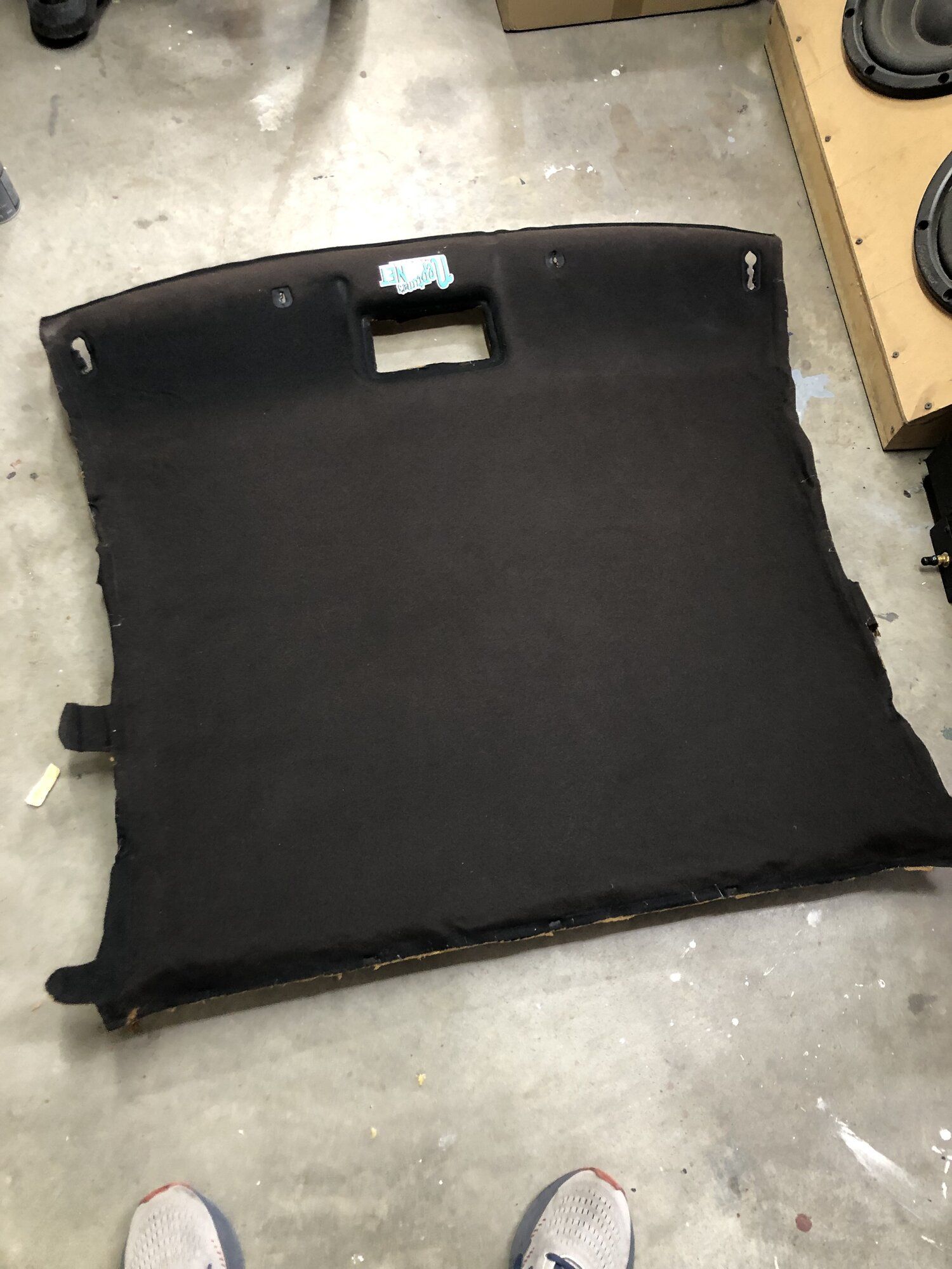

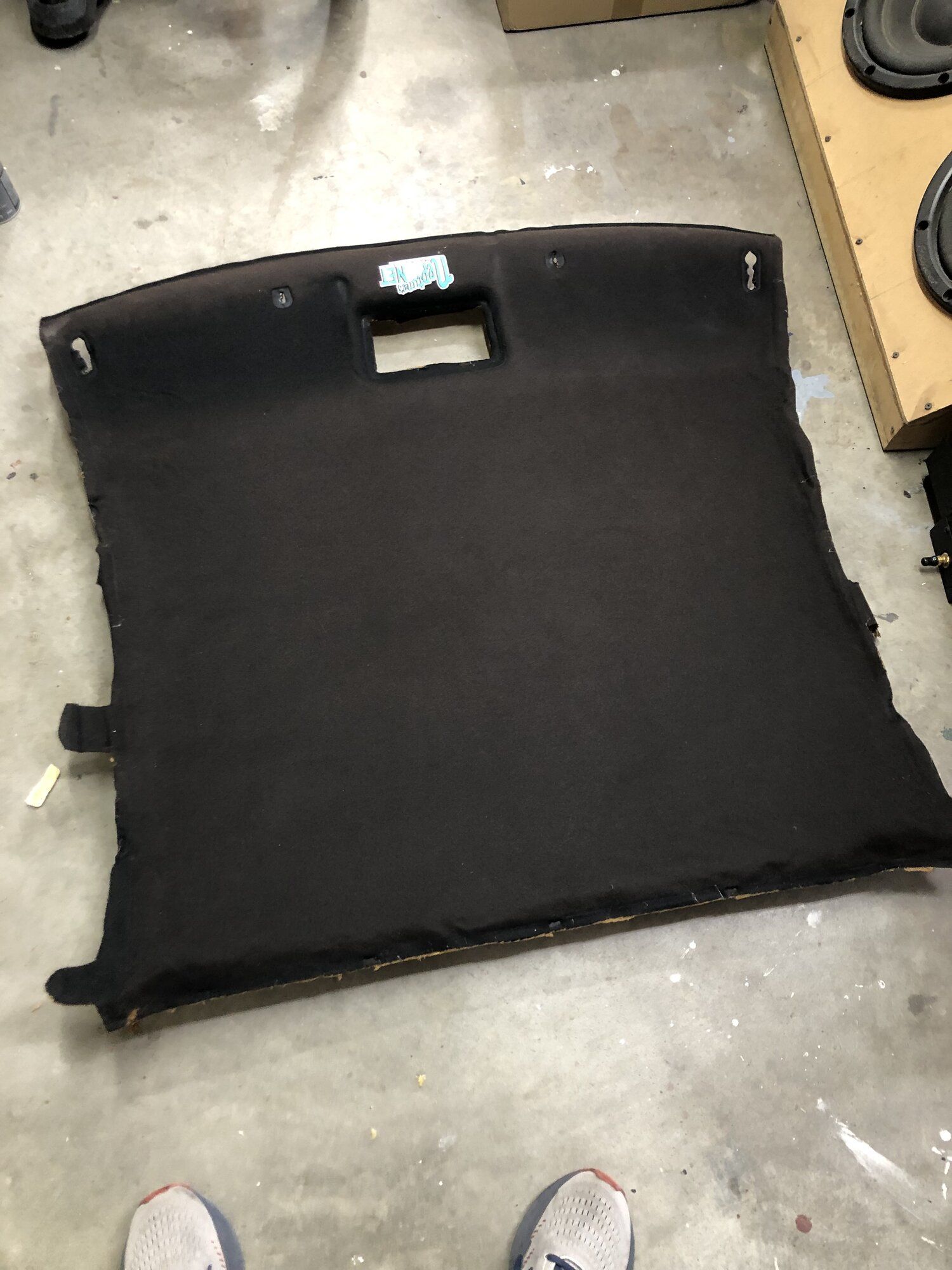

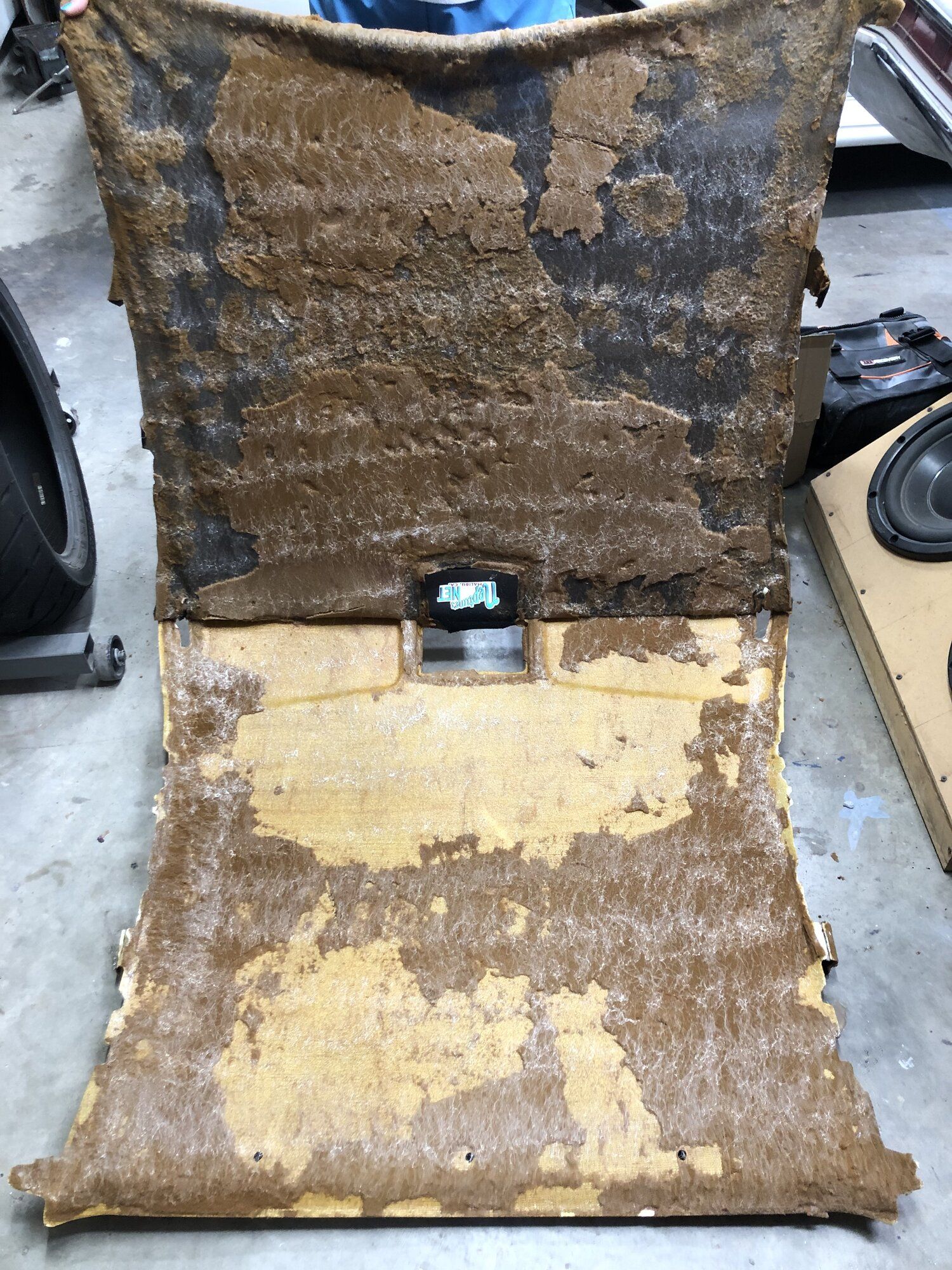

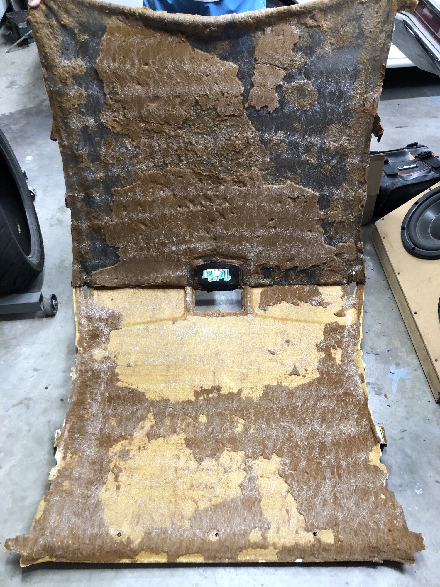

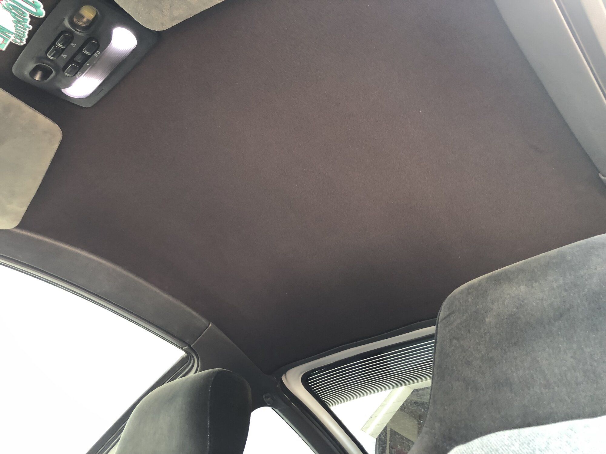

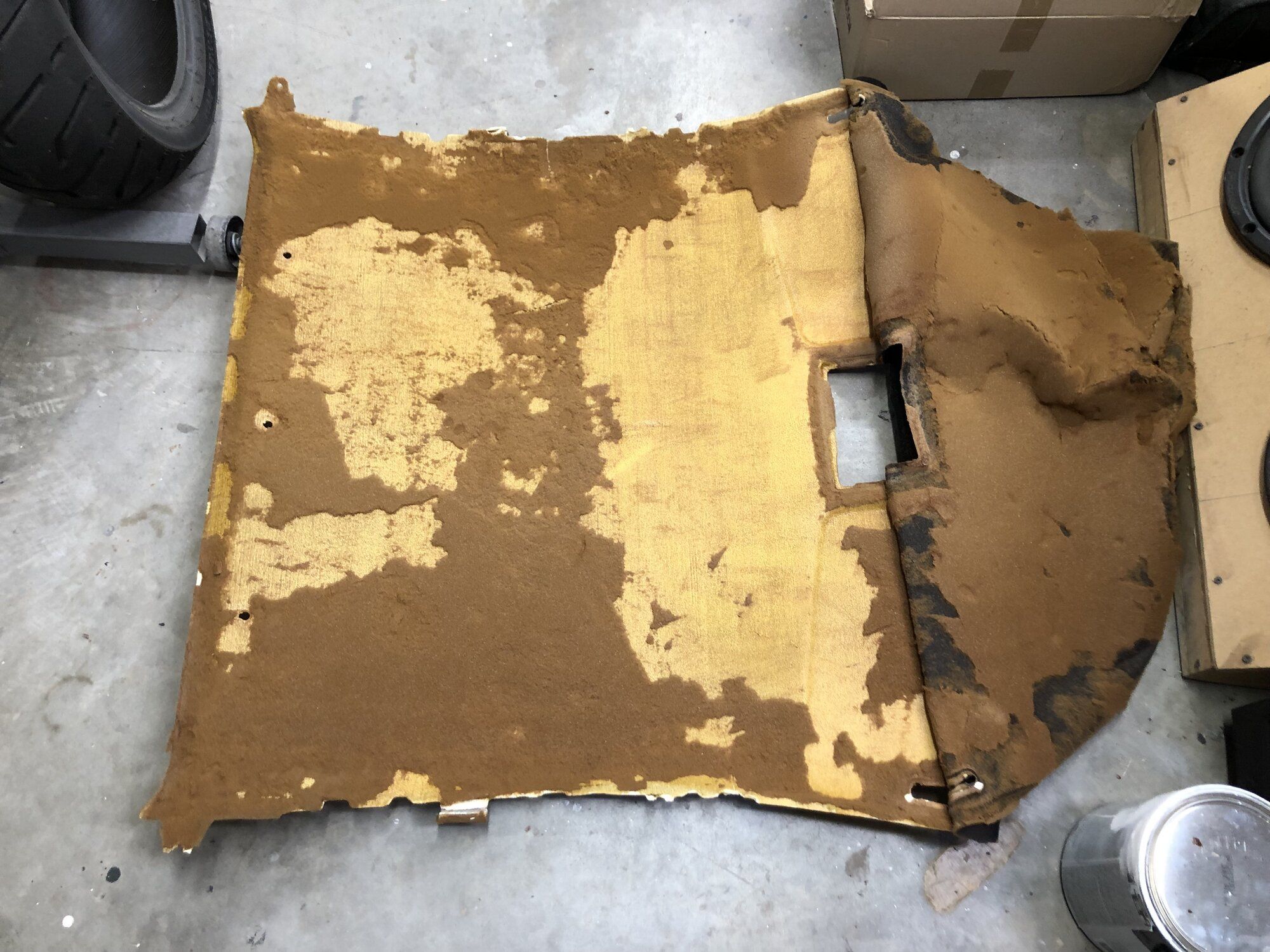

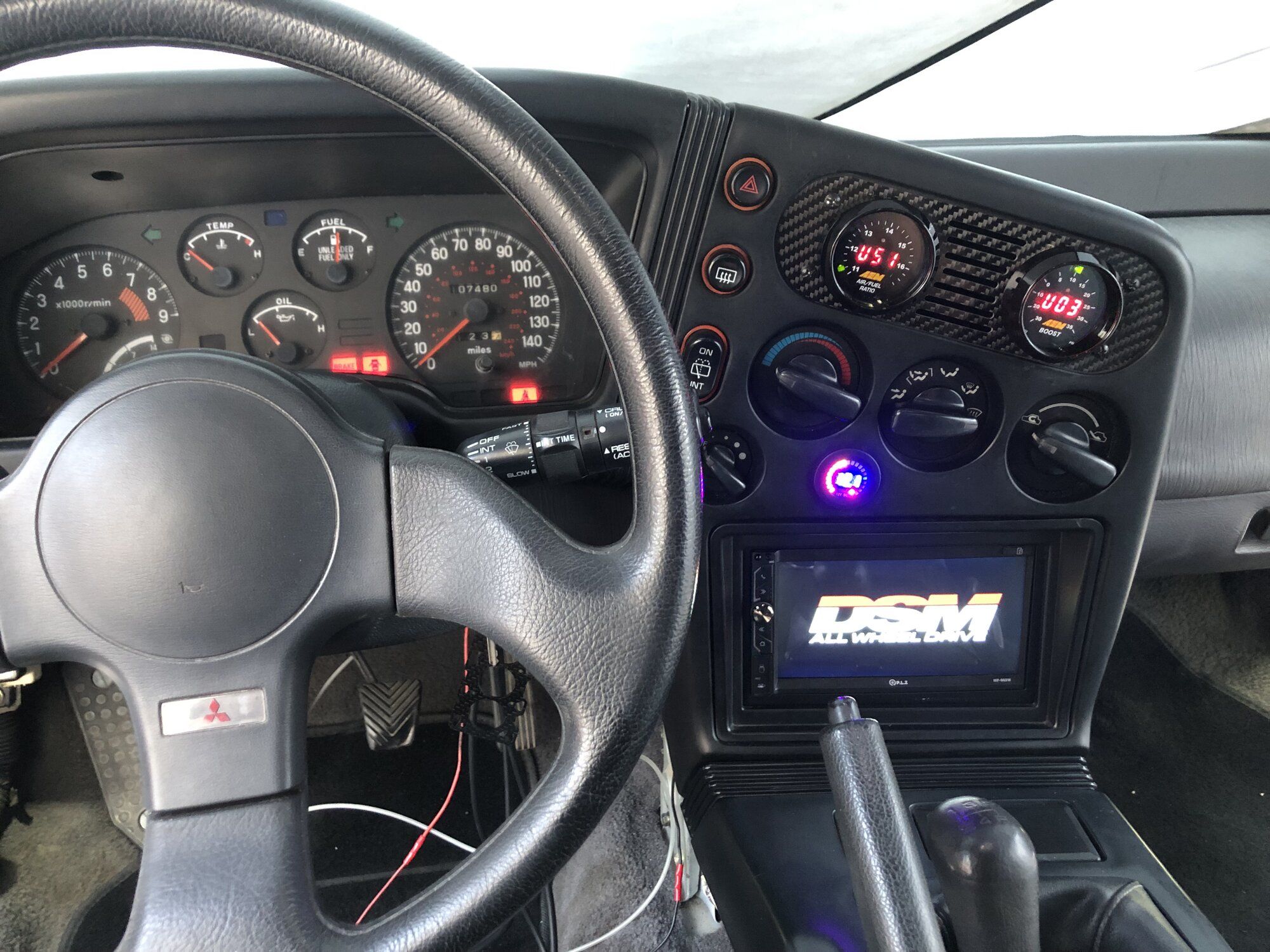

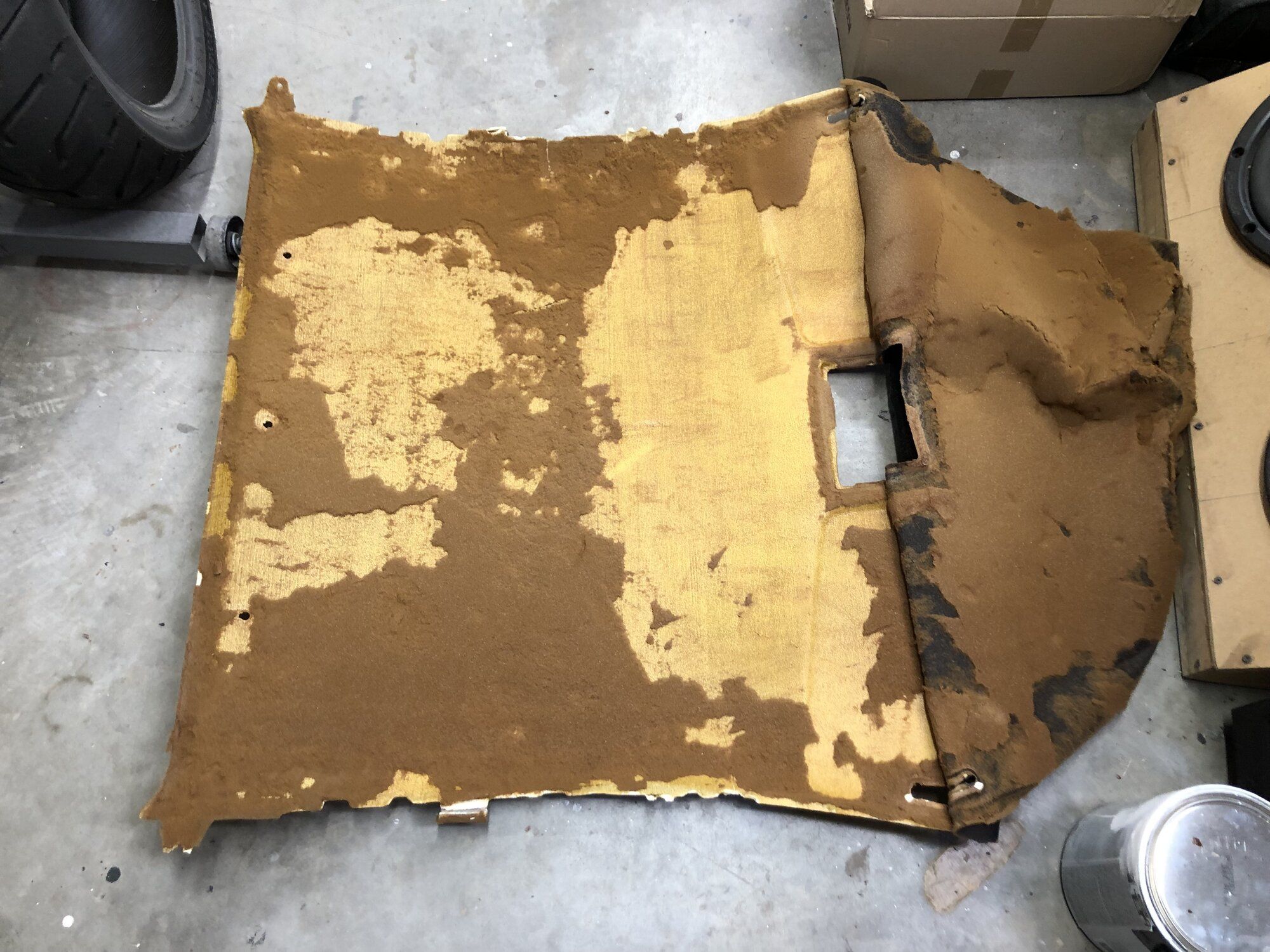

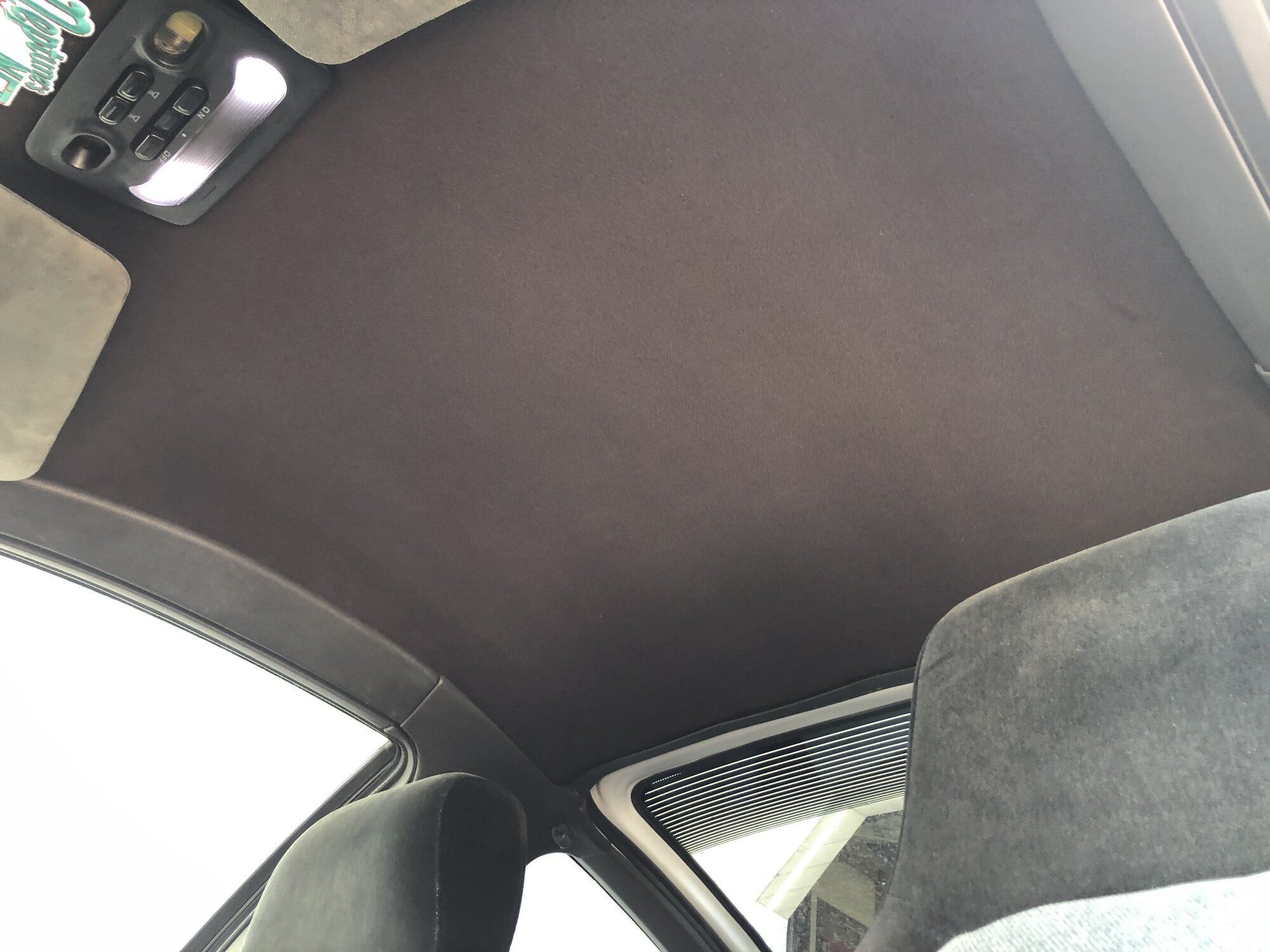

Done! I got everything buttoned back up and took it another step and pulled the headliner back out to re-glue the fabric. Everything turned out great! I now have heat and defrost, just in time for summer (it’s already hitting 100* here), LOL!
Heat and defrost, but no AC... In El Paso! :oops: 🥵
Remind me again how you got that DSM logo on start up? Really jealous of that might want to copy..headliner looks great!

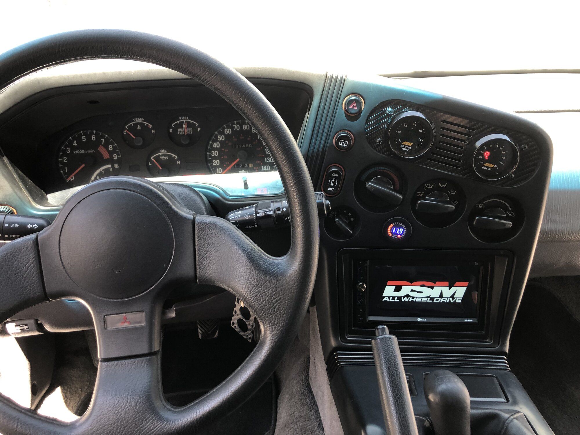

It’s an Apple CarPlay compatible head unit from an Amazon company called PLZ. Once I installed it I sent them an email with the image and they provided an update with the custom startup screen.

After repositioning the clamp on the wastegate I was stilling hearing what sounds like an exhaust leak. I pulled the wastegate off and used a ring of Permatex high heat sealant on each opening and reinstalled. I took it for a drive today and heard no change, so I'm going to have to keep investigating.

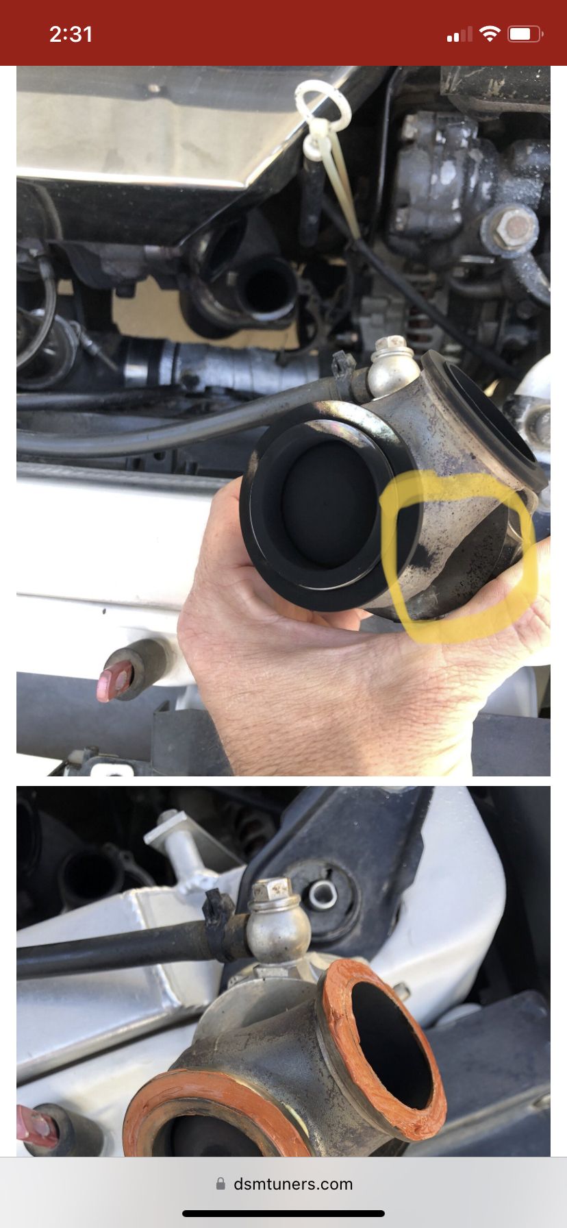

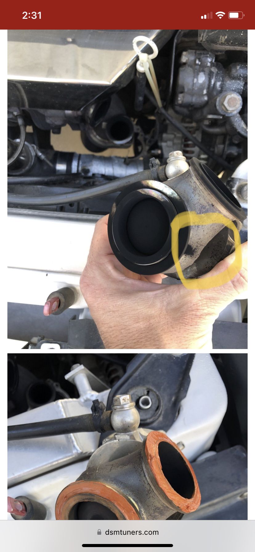

Is it me or does this area I circled below look like an exhaust leak? Looks like you can even see where it starts to splatter condensation mixed with soot? Hard to tell but I’m assuming you have the fire ring installed as well?
-Daniel
It was pretty clearly leaking from the wastegate. You can see a little bit in that picture but also a lot more in this picture from before I messed with it. However, I am still hearing the same sound, which makes me think there is another leak.
