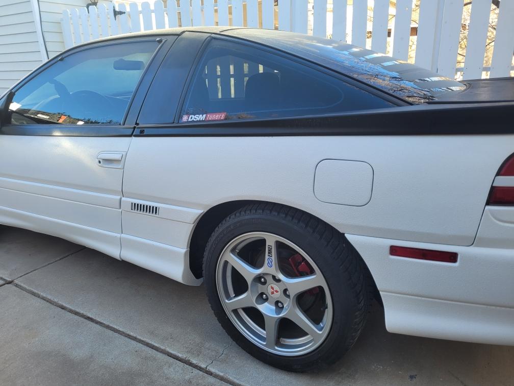

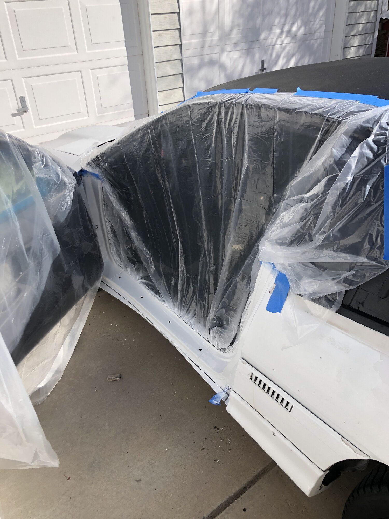

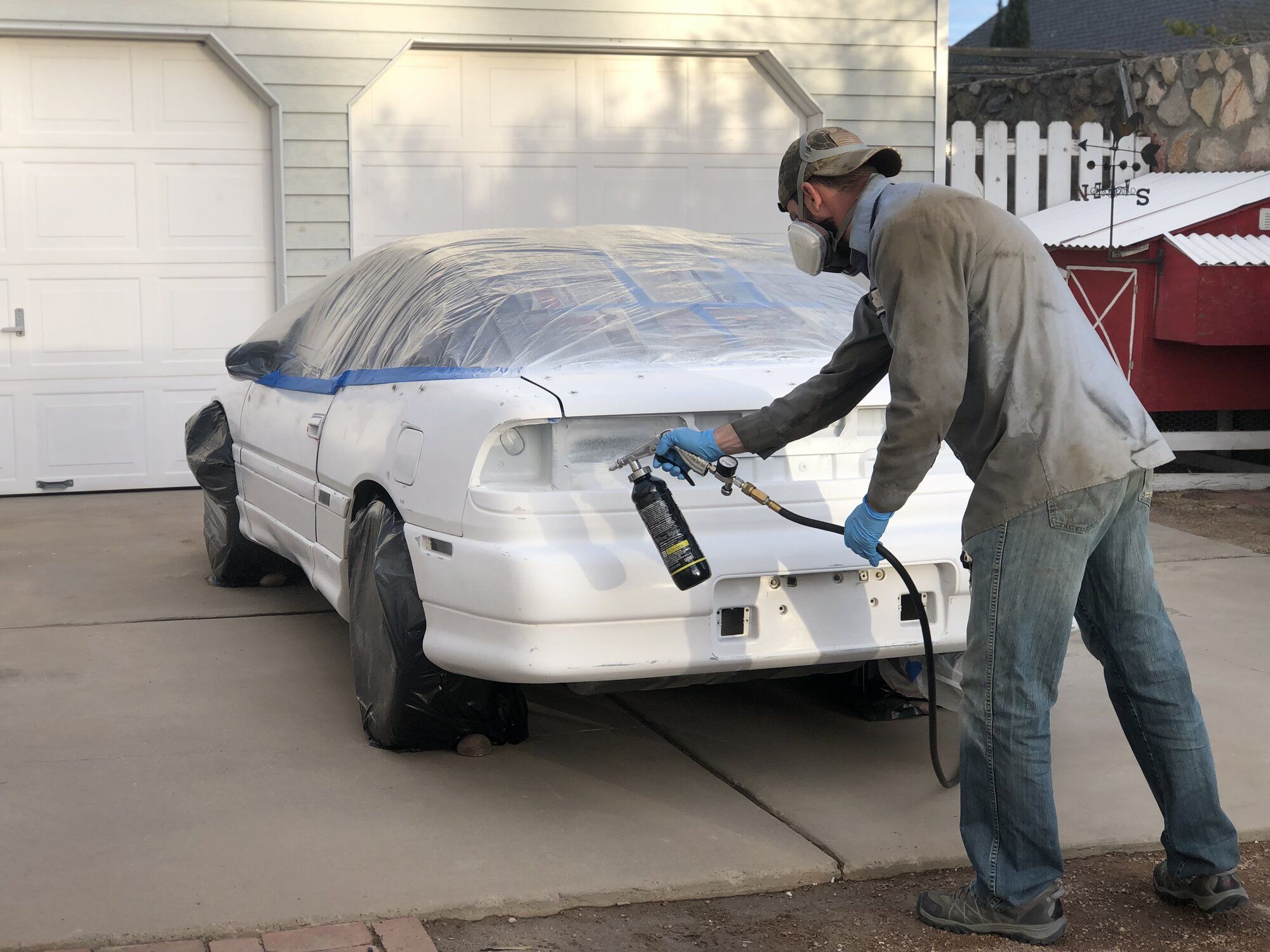

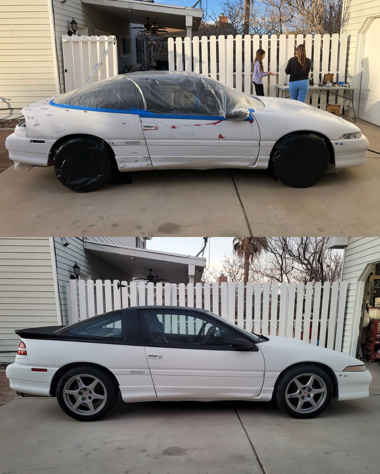

Next, the El Paso Sun had eaten away my DIY rattle can clear coat. I know this is not traditional, but I was very impressed with the Raptor Liner I applied on my Humvee and decided to give it a shot on the DSM. I would hate to spend a bunch of money on a paint job have the clear be eaten away from sitting outside. I had some leftover tintable Raptor liner so just ordered the white tint and went to town. It turned and really great and I’m very happy with it.

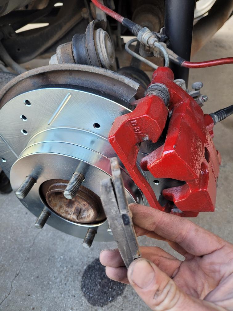

Next is the brakes. I pulled the pads to repaint the calipers to find they were in rough shape. One of the rear pads was actually separating from the backing. I ordered a full set of PowerStop coated rotors and carbon-fiber/ceramic pads that should be here by the end of the week.

Love the variation of vehicles! I'm in the same boat after a work bonus. Trying to focus on the current cars and stay off Craigslist/Marketplace.
The textured white does look sick and you did a great job with it.
Welcome back. And I personally like textured coatings for paint jobs, if done correctly.
Thank you! I was blown away at how easy it was to spray the Raptor liner, keep it clean, and how durable it's been on the Humvee over the past 2.5 years. I was very nervous to spray it on the 1G but am very pleased with how it turned out.

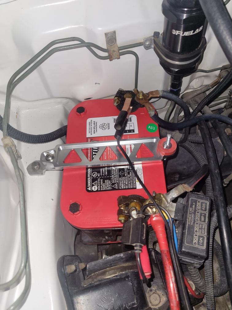

Also, I forgot to add this to yesterday's update, but I also replaced the battery (it was 10 years old and would only charge up to 6 volts) with an Optima 25 Red Top and replaced the rear hatch struts (again!).

Last week my new brakes came in. The brakes on the car were good but the sitting had taken a toll. Rotors were rusted and one of the pads was separating from the backing plate. I installed PowerStop Extreme Performance coated rotors and carbon fiber -ceramic pads. It was a very easy install and then I took it out to bed them in properly.

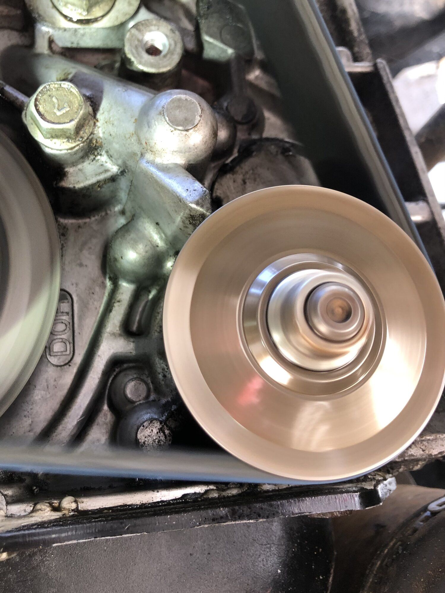

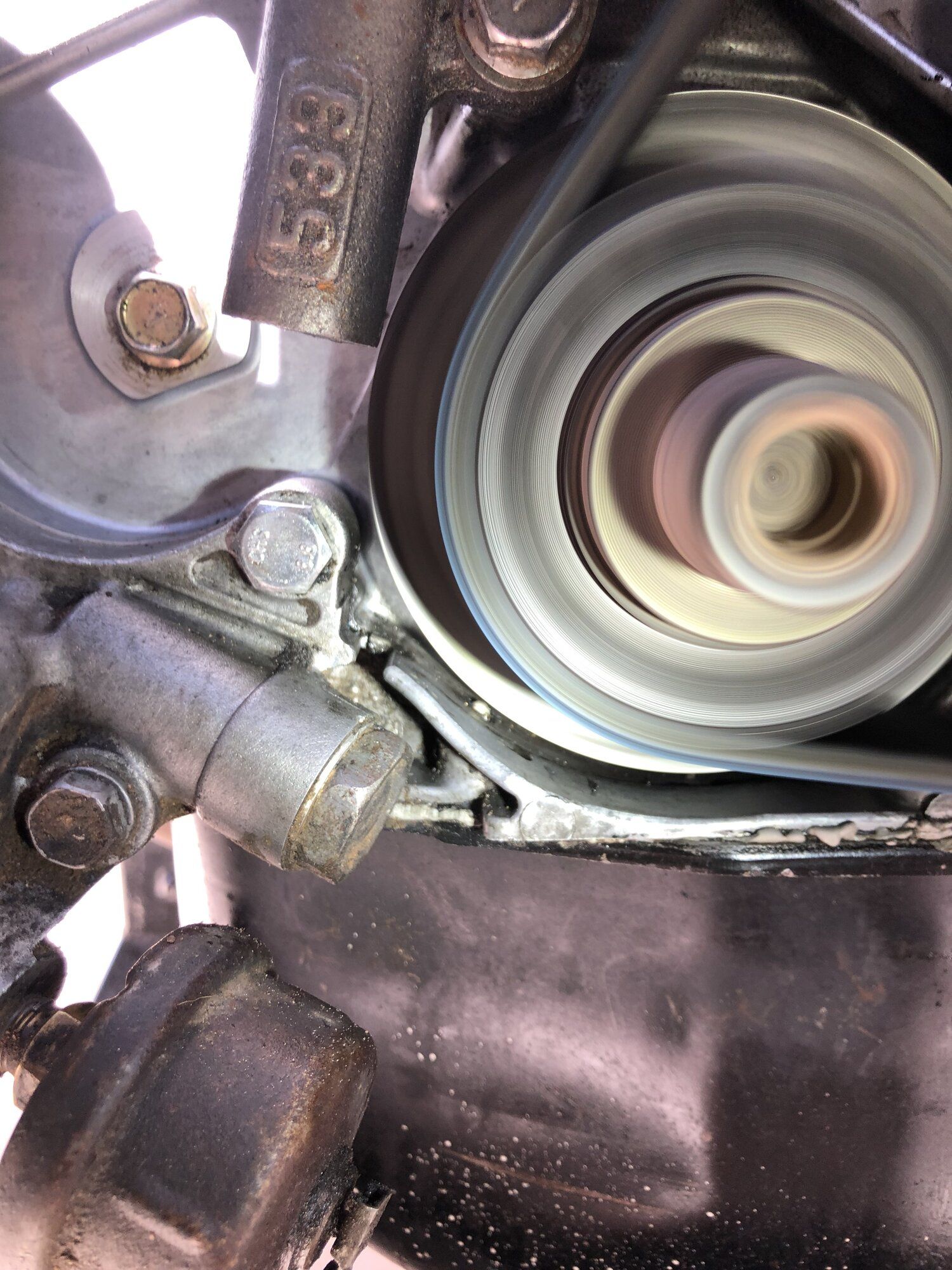

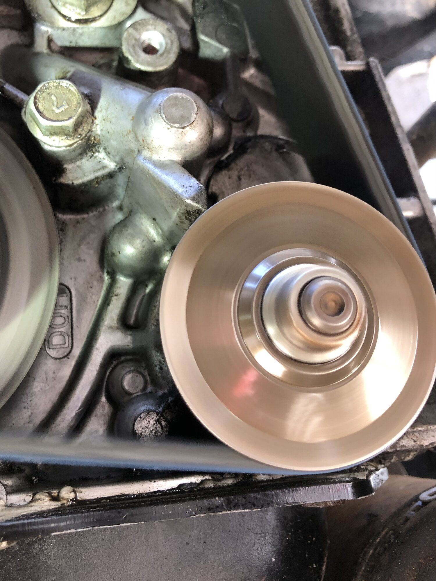

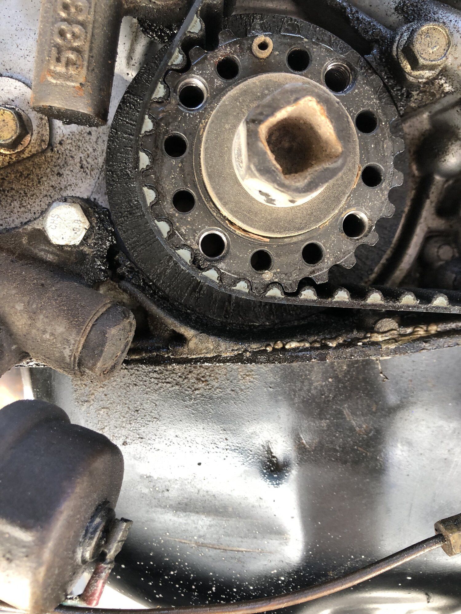

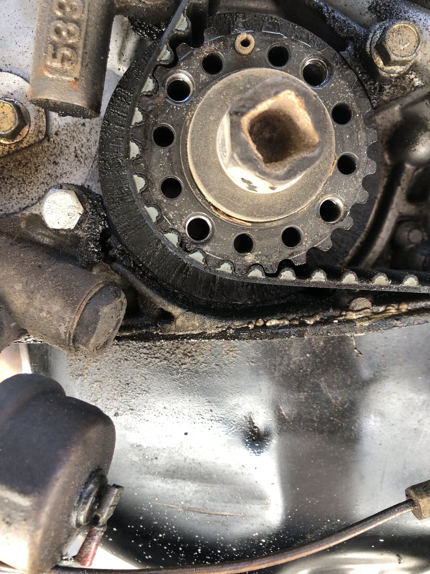

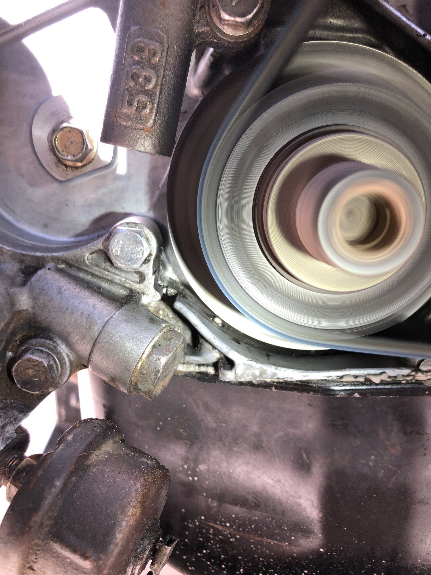

I made some great progress today! I decided to track down the oil leak so I removed all the accessory belts, pulleys, and timing belt cover. It was an oily mess behind the cover. I cleaned everything up and then ran the motor to identify the leak. It turns out the nut on the oil pump sprocket had loosened a bit and that was the source of the leak. I cleaned the threads, applied blue thread locker, and torqued to the factory 43 ft.lbs. Afterwards I started it up again and verified that it was no longer leaking! Tomorrow I will put everything back together.

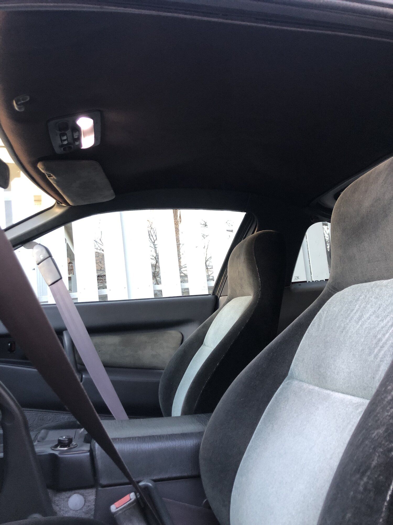

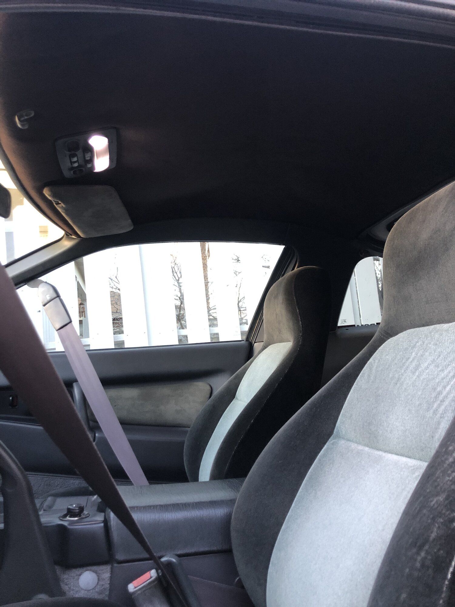

I also looked into the passenger seatbelt being stuck in the forward position. It took some trial and error but it turns out the door latch on the chasis side needed to be adjusted to activate the switch on the door side latch. As soon as I got it adjusted, the seatbelt started functioning again!

Do you mean the latch mechanism in the door, or the actual striker on the door frame? Neither of mine will go back from the forward position and I’m trying to figure out why. The passenger side WAS in the locked position but when I opened the door it beeped and moved forward which is where it’s decided to live permanently. LOL
The actual striker on the door frame needed to be adjusted. I had taken it off when I painted the car and when I put it back on it wasn't quite activating the sensor on the door side. It took several attempts to get it in the correct place so I left the key in the on position so after each adjustment I would shut the door until finally the seatbelt went forward as soon as the door shut.
I drove it to work yesterday and can confirm that there is no more oil leak!

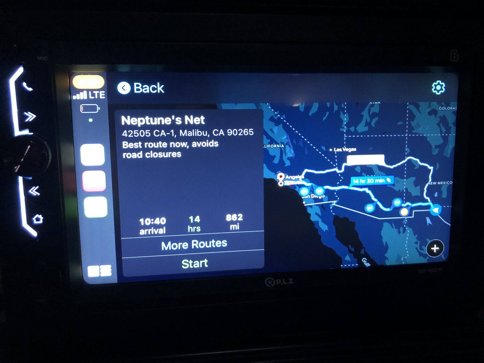

I decided to do something fun with the Eclipse, something I have never done with this car before in my 21 years of ownership. I'm going to take it on 1,800-mile long-weekend road trip! My plan is to drive from El Paso, Texas to Los Angeles, California! I'm going to drive all the way out to the coast, drive the whole length of Mullholland Drive, see the Hollywood sign, visit a few of the original F&F filming locations, drive the PCH down to San Diego, hit a few beaches, and head back to Texas.
Of course I am running E85, so I'm plotting my trip and fuel stops using the US Department of Energy's Alternative Fuels Data Center App. I will also be carrying 10-gallons of spare E85 in military Sceptor MFC containers. The longest stretch without an E85 station is 300 miles from El Centro, CA to Tucson, AZ.

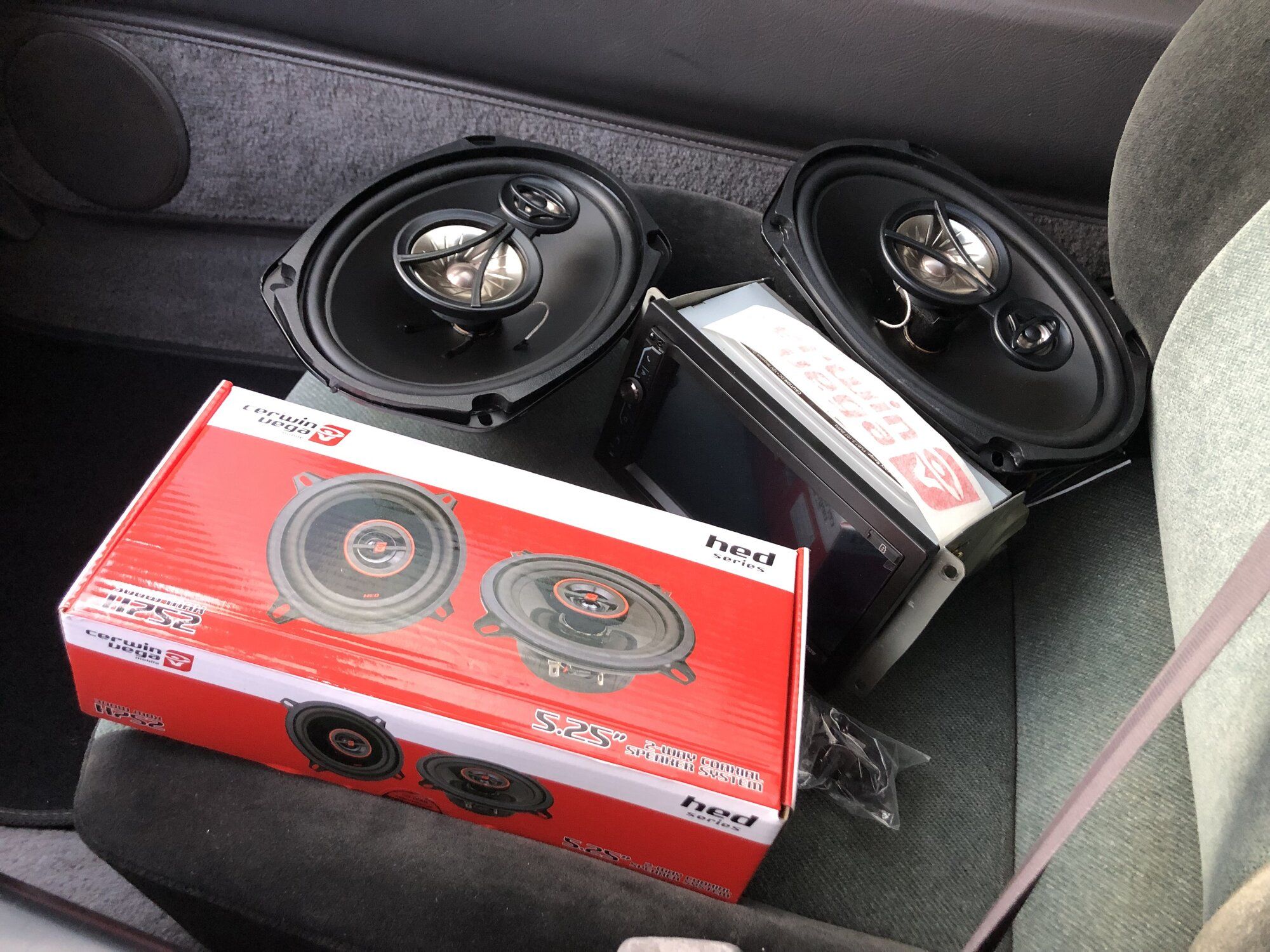

To make the trip more enjoyable, I just ordered a new Apple Car Play enabled double din head unit and 4 new speakers. I also ordered a refurbished passenger window motor and regulator assembly because the last new aftermarket one I purchased is already shot again.

Last night after work I got to work installing the new head unit (PLZ MP-902W) and rear 6x9 speakers (Cerwin-Vega XED693). The rear speakers didn't quite fit in the pockets due to the depth of the magnets, but I was able to use some spacers between the pockets and speakers to give them proper clearance. I bought the Metra 70-1743 harness adapter which made installation of the new head unit a breeze. I soldered all the connections and sealed them with heat shrink. It's great to have a working stereo in the car again, especially with all the added Apple Car Play features. I still need to install the door speakers and I just ordered a set of new dash speakers as well. It's coming together!
Which head unit and does it have HDMI?
The brand is PLZ (Amazon). It was only $129 (with coupon) and has 4.5 stars so I figured I would give it a try. It does not have HDMI connections, but it does capability for both front and rear cameras. The big thing for me was Apple Car Play compatibility.
