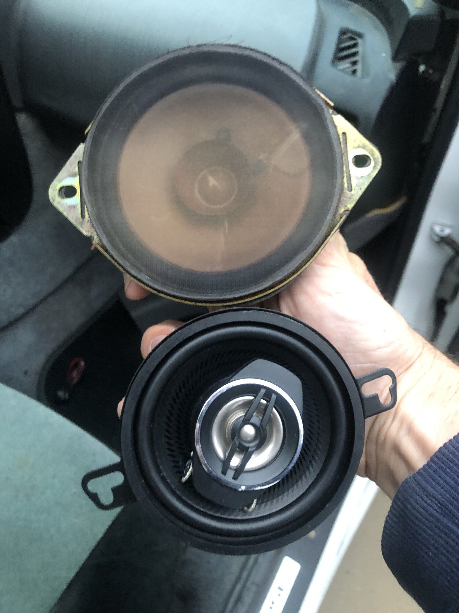

The dash speakers came in (Pyle 3.5” PL31BK) and I mounted them into the original speaker mounting rings because they were slightly smaller. 3.5” instead of 4”. I went with the 3.5” speakers because they were only 2” deep, same as the originals.

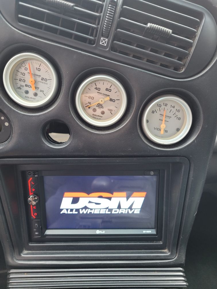

I added a new boot up logo to the stereo! This flashes on the screen for a second or two when I first turn the ignition on. I love it. Sometimes it’s the simple things!

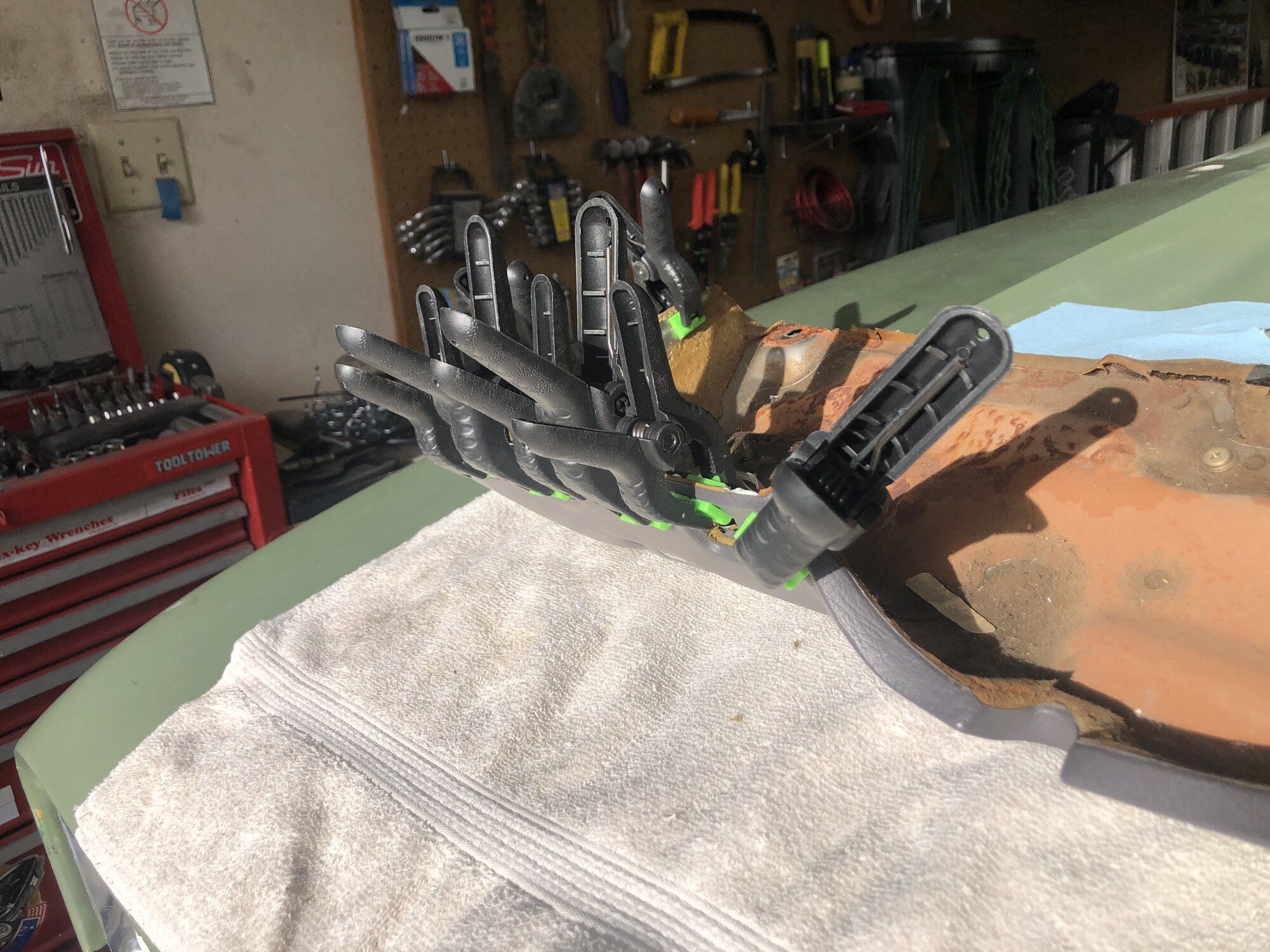

I had a bunch of scratches on the windshield from the wipers pushing dirt and mud during my RallyX days. I tried to polish them out to no avail. I went to a glass place to see if they could polish them out but they couldn’t either so instead l had a whole new windshield installed. It looks awesome but now I’m wondering if I should have waited until after the California trip (rocks on the highway and such).

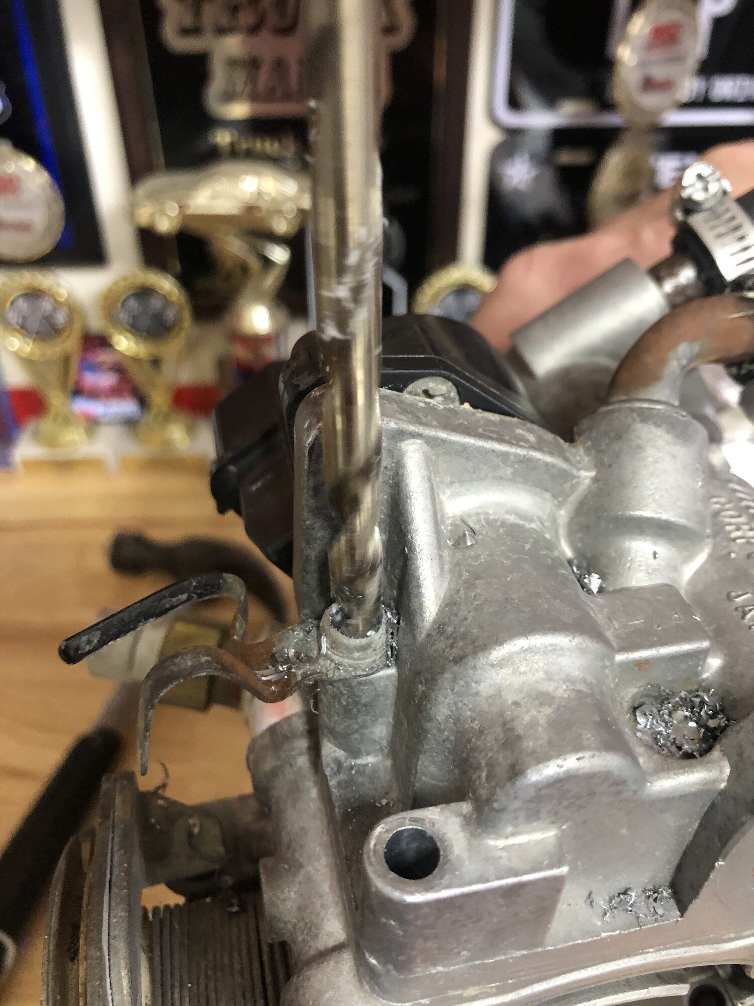

After fixing the leaking PCV line I was still getting idle surge, so I pulled the TB and adjusted the FIAV as much as I could, which ended up being about 4-5 quarter turns. It wouldn't go any further after that. I reinstalled it and it seems to have lessened the idle surge considerably, but it is still present. I'll get a better idea when I drive it to work tomorrow. I may be ordering a bypass plate to fully block of the FIAV depending on the final results.

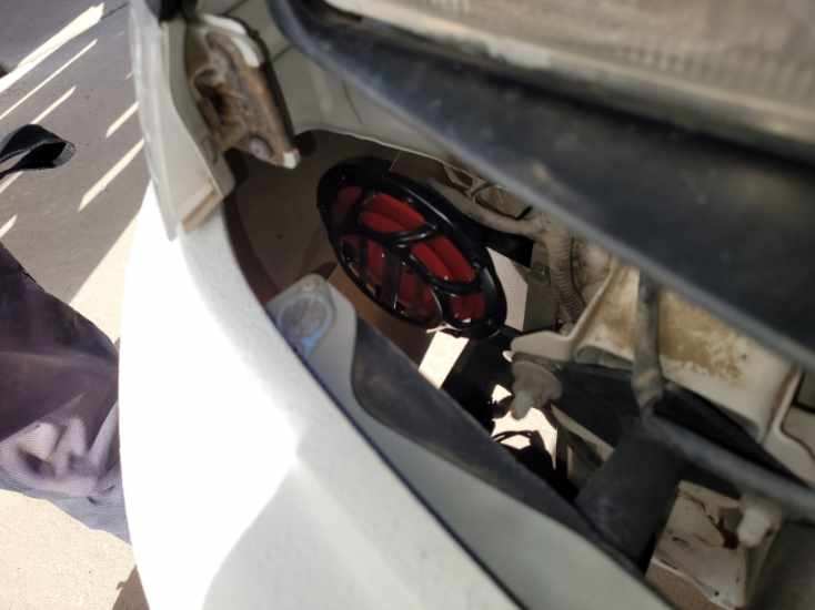

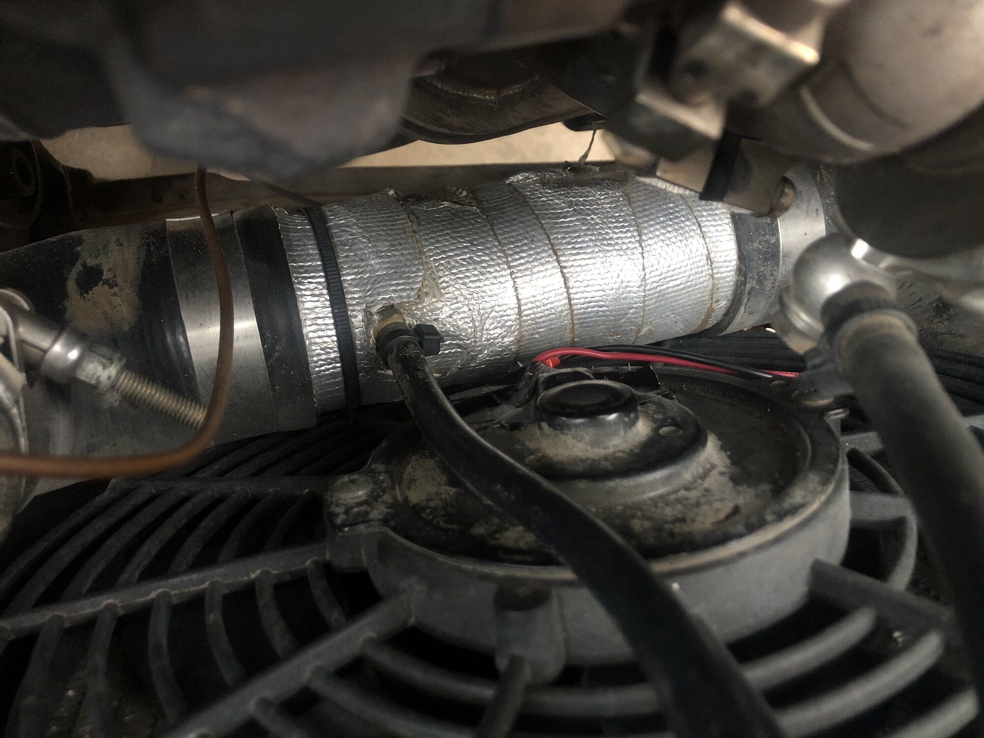

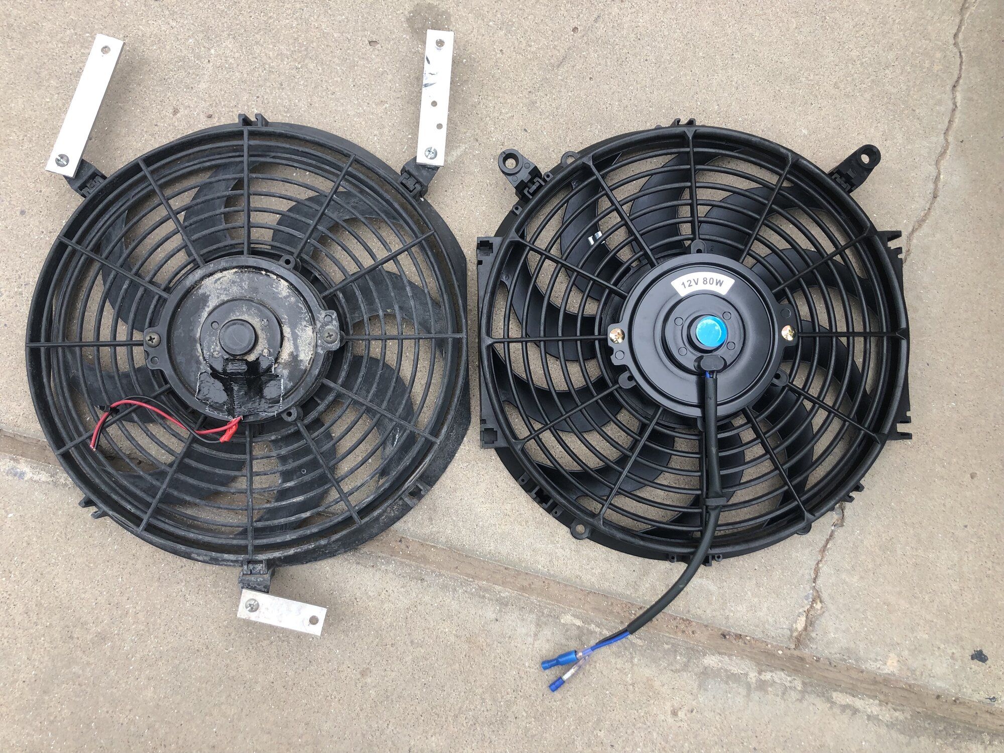

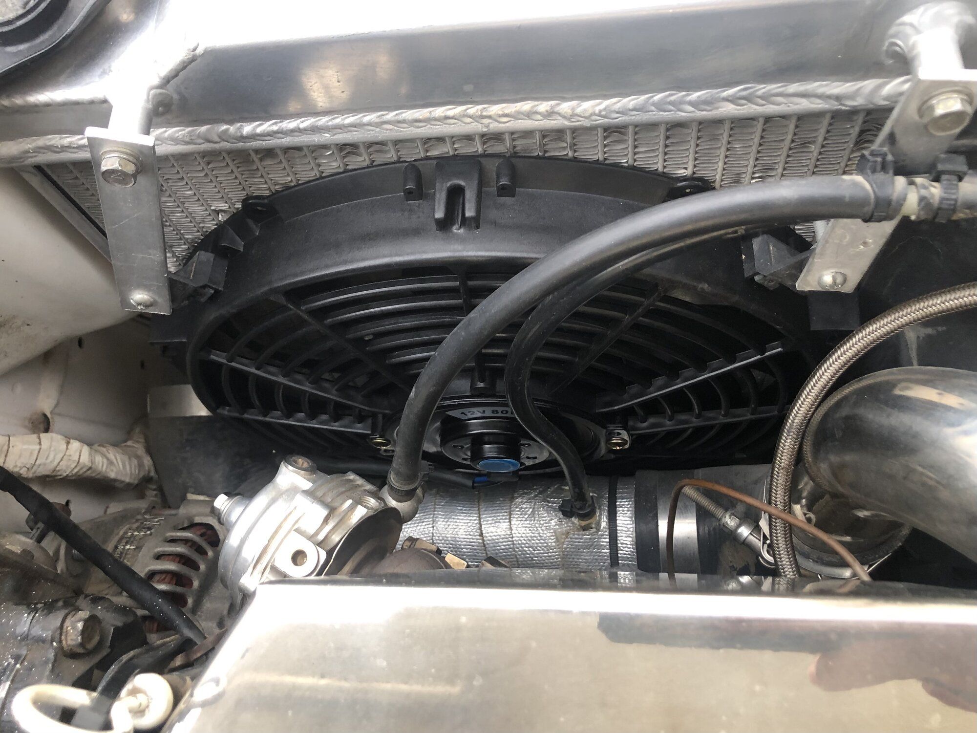

After the drive yesterday, I also noticed only my main fan is kicking on and the supplemental slim fan in front of the turbo isn't doing anything. It looks like the wires might have gotten pinched or damaged by the lower intercooler piping. My plan is to rewire that after work today so both fans will work together.

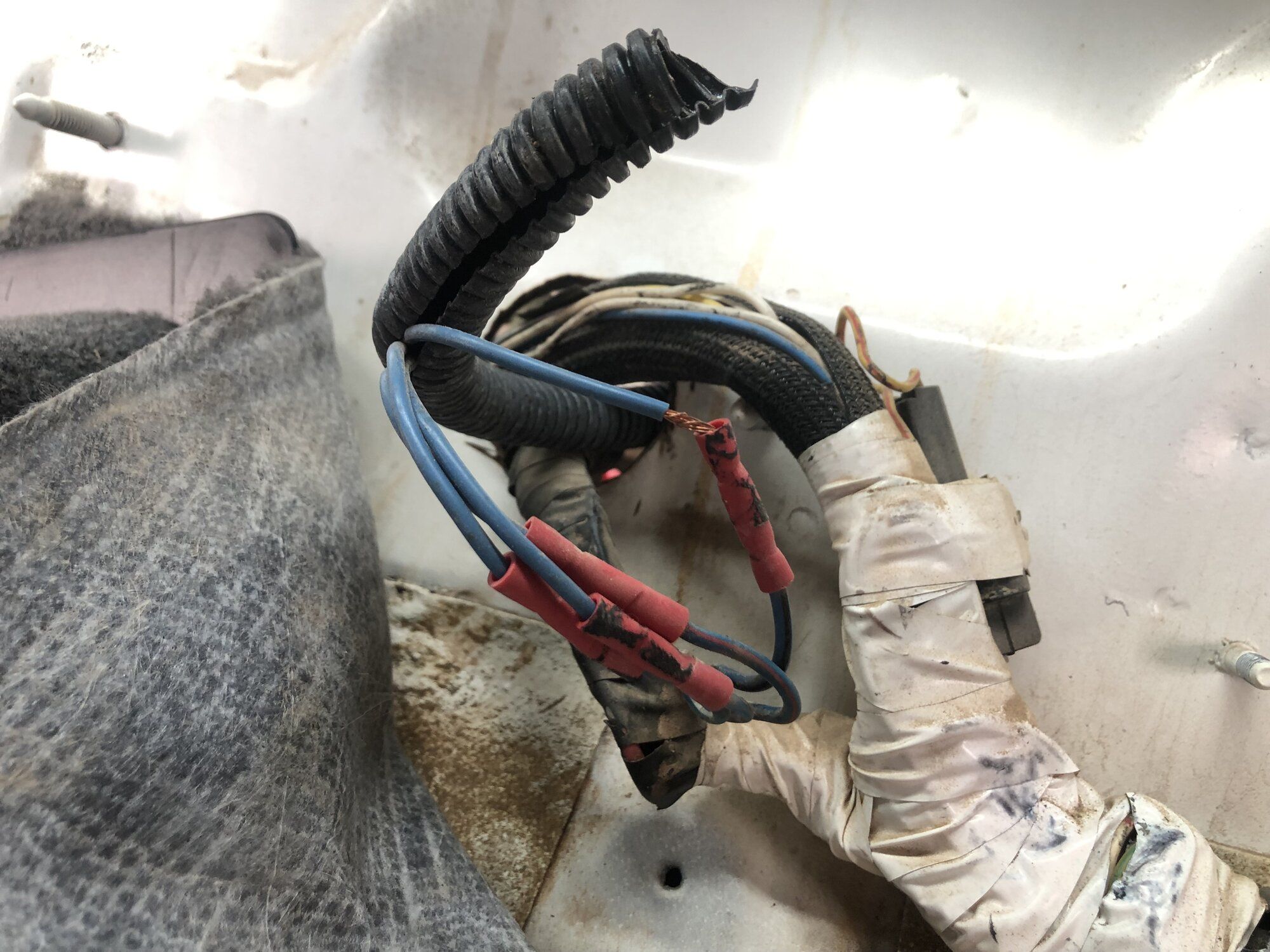

Yesterday evening I pulled the slim fan and found the issue, the wires coming out of the motor were very brittle and one had already completely separated. I soldered new wire in but there wasn't much to connect to so I'm not sure how well it will work. I also lengthened the wires and routed them around the lower intercooler pipe instead of going straight down. Hopefully this fixes the fan, at least for now, but I will probably just buy a new one in the future.

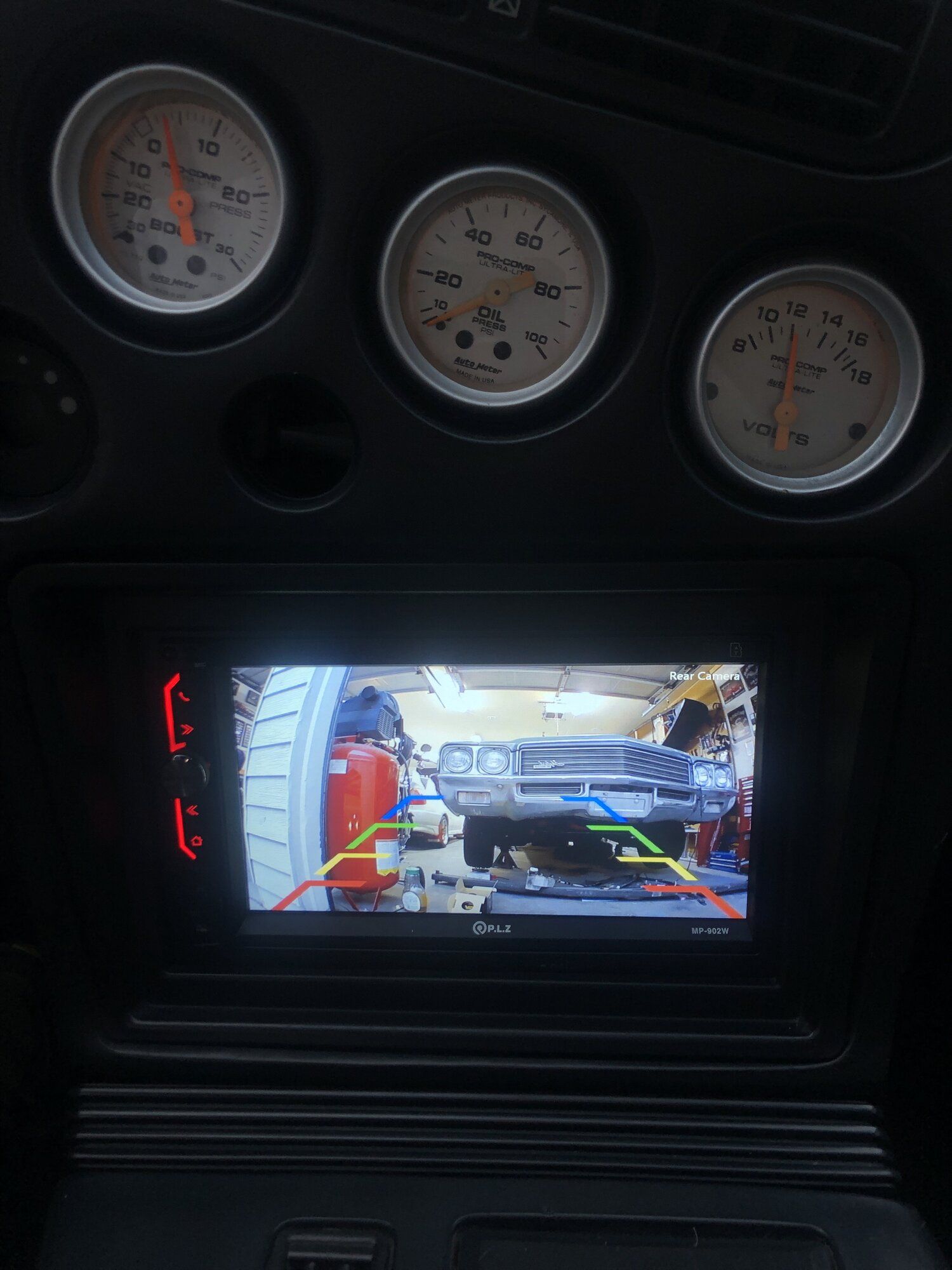

On the inside, I installed the backup camera that came with the head unit and tied it into the reverse lights, so it kicks on automatically when I put it in reverse. I also installed an external microphone for the head unit as the built in one had terrible sound quality.

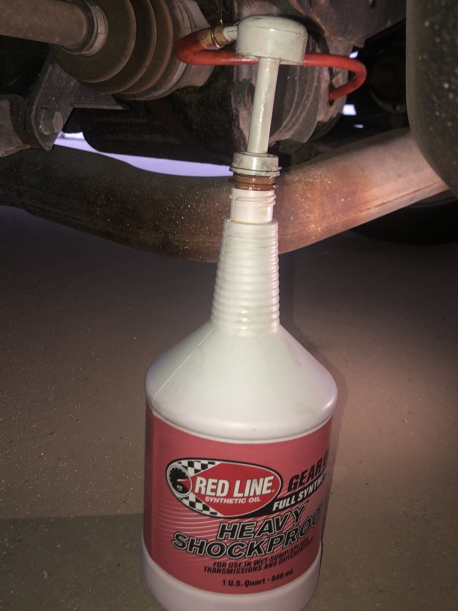

I also topped off the rear differential with some fresh Redline Heavy Shockproof. Unfortunately, I ran out of time and daylight to check the trans and x-case but I'll get to those tonight, along with the new fan install (if it fits!).

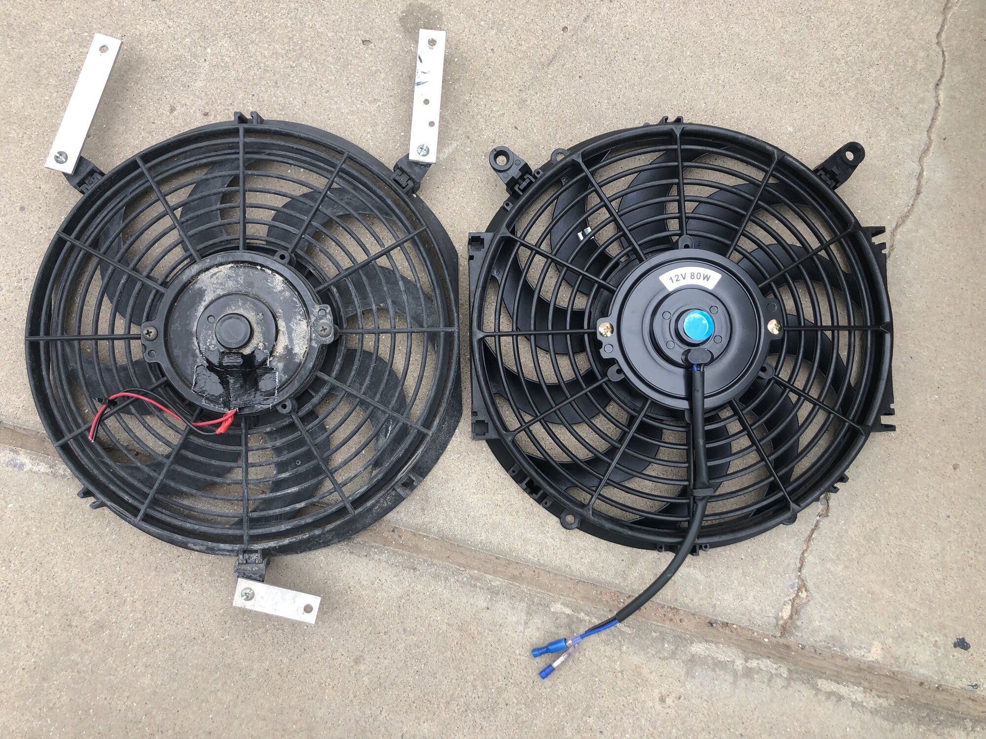

Free overnight shipping from Amazon is incredible! I was planning on upgrading to a SPAL but couldn't get one before the trip. I ordered a generic 12" slim fan, and it was at my front door when I got home from work yesterday. It was an easy install and should help supplement the factory fan with keeping the engine temps down.

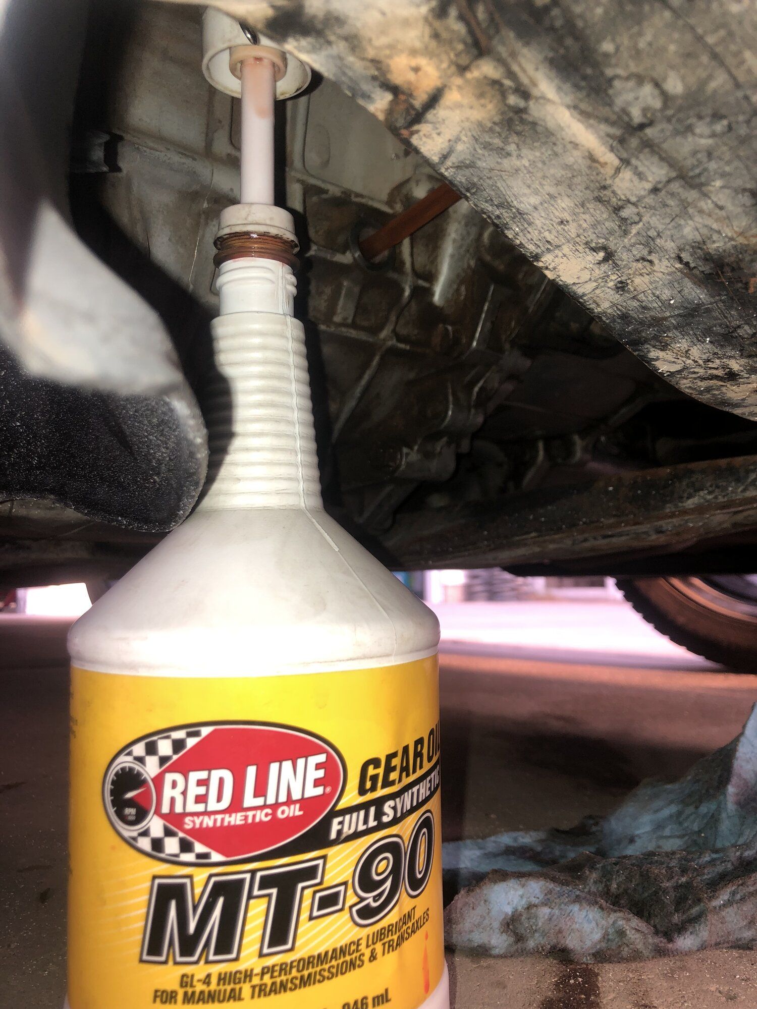

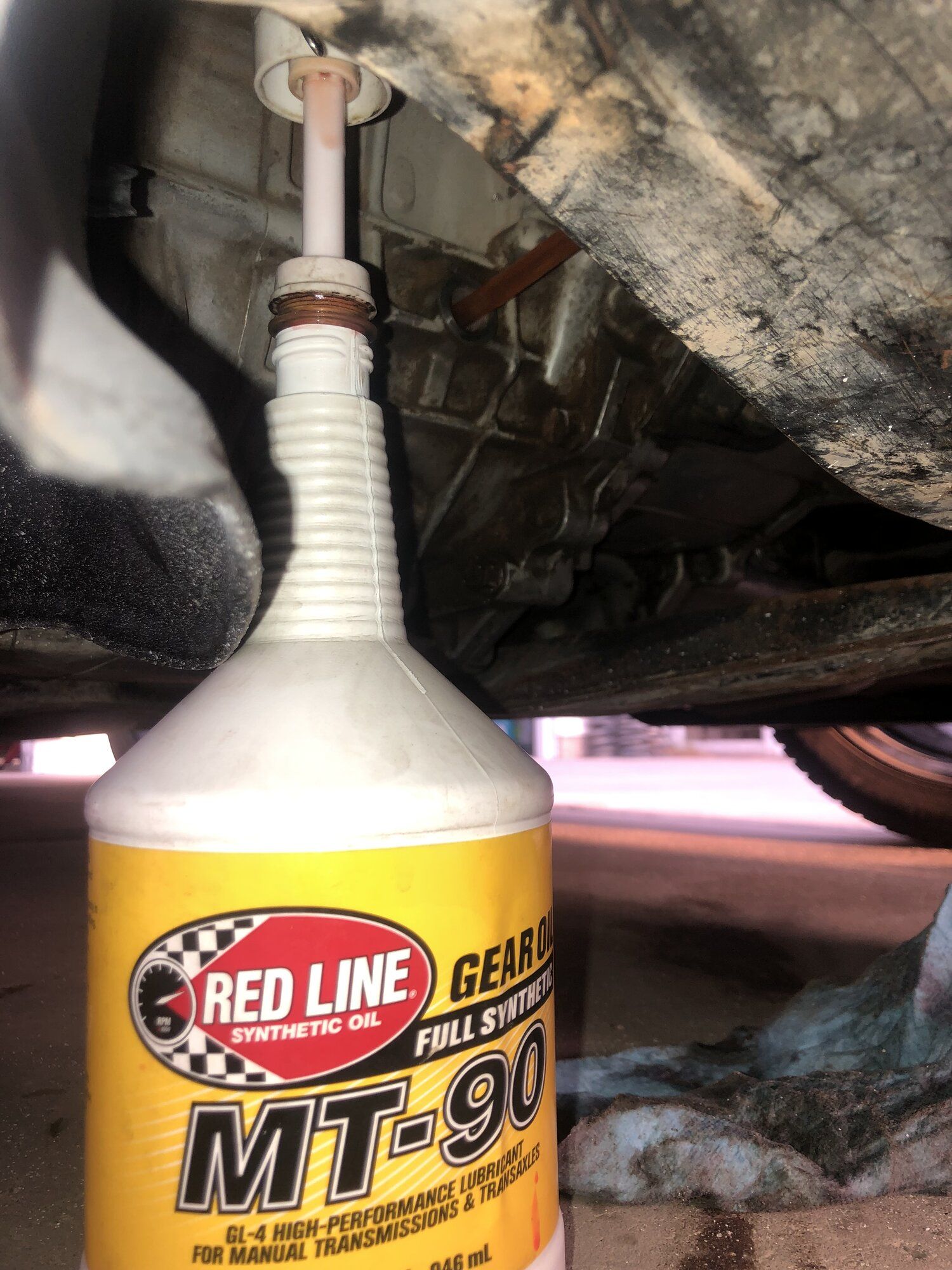

I also finished up the fluids, topping off the transfer case with Redline Heavy Shockproof and the transmission with Redline MT-90. The transmission was a little low and took about 1/2 a quart so I'm glad I put in the time to ensure they were fully topped off. The transfer case and rear diff just needed a few pumps to be full. I would have liked to have completely changed the fluids instead of just topping them off, but I didn't plan ahead and only had the fluids I already had on hand, which wasn't enough for full drain and fills.

How did you get the spout to work with the redline bottles?
I just drop it in and start pumping, it fits perfectly. I’ve been using this one for years, I got it at O’reillys or Auto Zone.

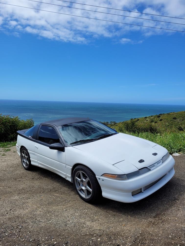

We made it from Texas to California today, about 750 miles. I started a dedicated thread for the road trip so check it out and follow along, it should be a fun adventure!
Thread '1,800+ mile Road Trip to the Pacific Coast in a 1G!'
https://www.dsmtuners.com/threads/1-800-mile-road-trip-to-the-pacific-coast-in-a-1g.546203/
Damn I’m so jealous. I’ve wanted to road trip a dsm for years. Used to make the 500 mile trip to Las Vegas all the time. Was so much fun. But that was early 2000s!
We are having a blast for sure! It’s hard to believe I’ve had this car for so long and this is the first time I’m taking it on a long trip like this. It’s doing awesome, pretty comfy for two, fun to drive, and getting great mileage!

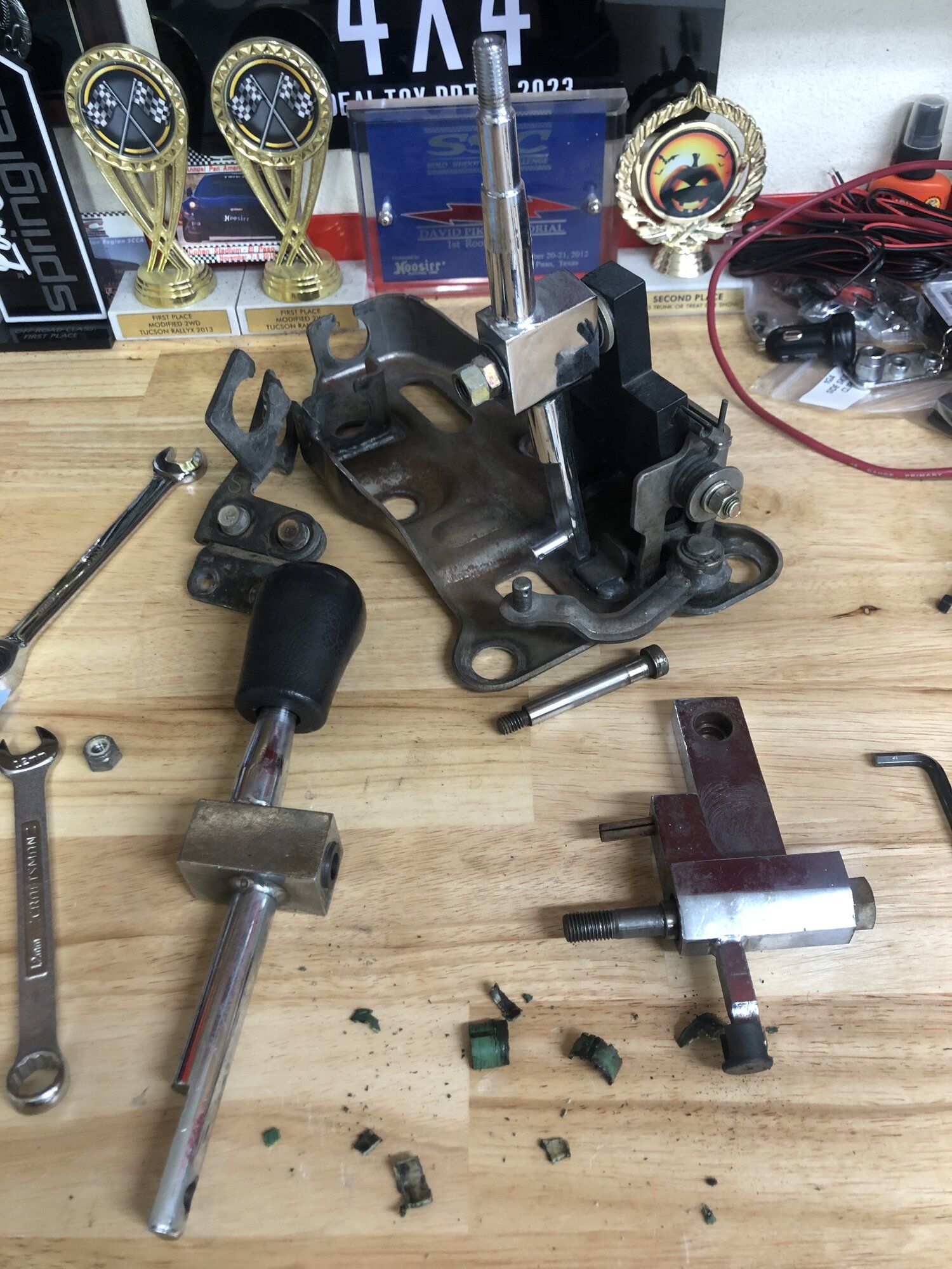

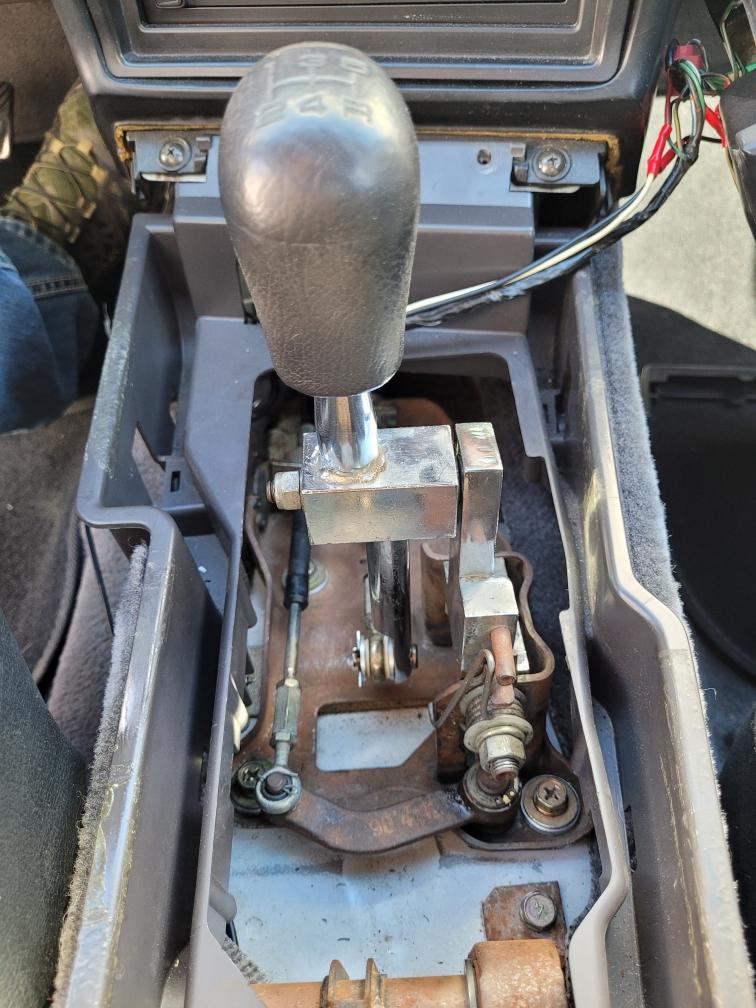

Yesterday I tried to work on the shifter. It was super sloppy and there was a ton of play all over the place. I tried to swap in my 91 shifter (trans is a 90) and 91 cable mount but even after adjusting the cables as far as they would go I could only get into 1st, 3rd, and 5th. I couldn’t get into 2nd, 4th, or reverse. I pulled the 91 stuff back out and cannibalized some bushings from it to install on the 91 shifter. I firmed up the selector arm, both pivots on the short shifter, and where the cables attach to shifter. I followed the factory service manual and adjusted it perfectly and it feels a lot firmer and I can get in all the gears but it still pops out of 3rd as soon as I push the clutch in or let it deccelerate. So basically I’m back where I started, except it’s a little firmer now.

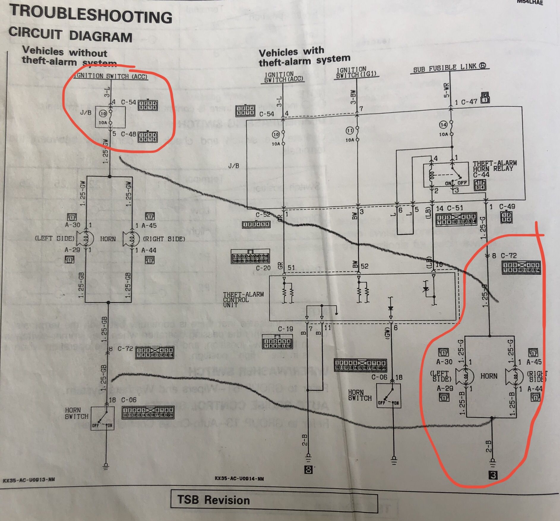

Today I did some digging on the horn issue and actually got it working. The issue is that the engine body harness came out of a car with the anti-theft system and the interior harness came out of a car without the anti-theft system. The two systems are completely different in function. Eventually what I did was grab the wires that came out of the body engine harness for the horns and reran them to the horns. This got everything back to how it should be without the anti-theft system. I’ll post a picture of the diagrams to show the difference and better explain how I fixed it. I had also already bought some aftermarket horns so I went ahead and installed them at the same time.

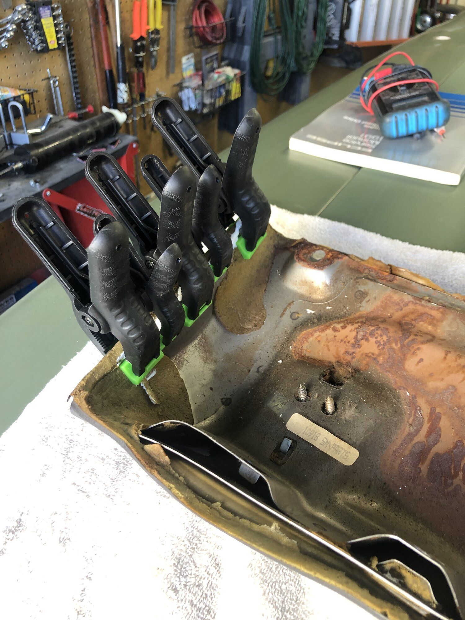

While I had the lower steering wheel/dash cover off I also started re-gluing some of the padding that was starting to peel. it looks like I caught it early enough to be able to save it.
I'm pulling the foam off and re gluing it back on.
I actually like having the foam. How is yours turning out without the foam?
Here is the horn diagram showing the differences with and without the anti-theft system. You can see on the anti theft system the horns are always grounded and without they are only grounded with the switch. The red circles show how my car was setup and the black lines show how I modified it to get it back to how it should be without the anti-theft system.
I haven't glues it yet.
Oh, I see. I'm interested to see how it turns out.

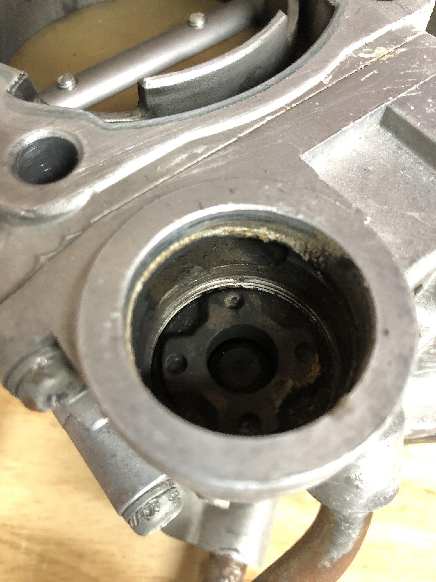

Also, my FIAV bypass plate came in and I got it installed. Two of the screws to separate the throttle body were stripped out, but the drill made short work of them. I bought new 10.9 fasteners with Allen heads to make it easier in case I ever have to remove them again. No more idle surging, but now my idle is dropping very low (similar to the other idle issue I had identified on the trip) down to about 500 and almost shutting off. I will adjust the idle now that the FIAV has been bypassed and hopefully that will take care of the extremely low idle condition I was experiencing.
