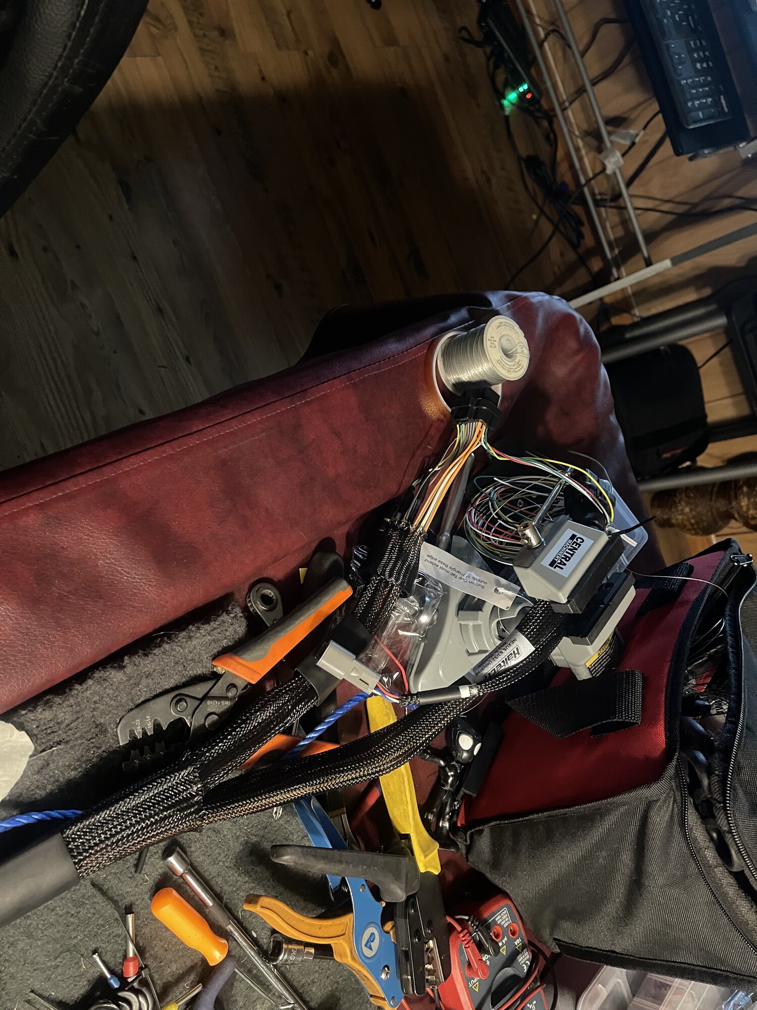

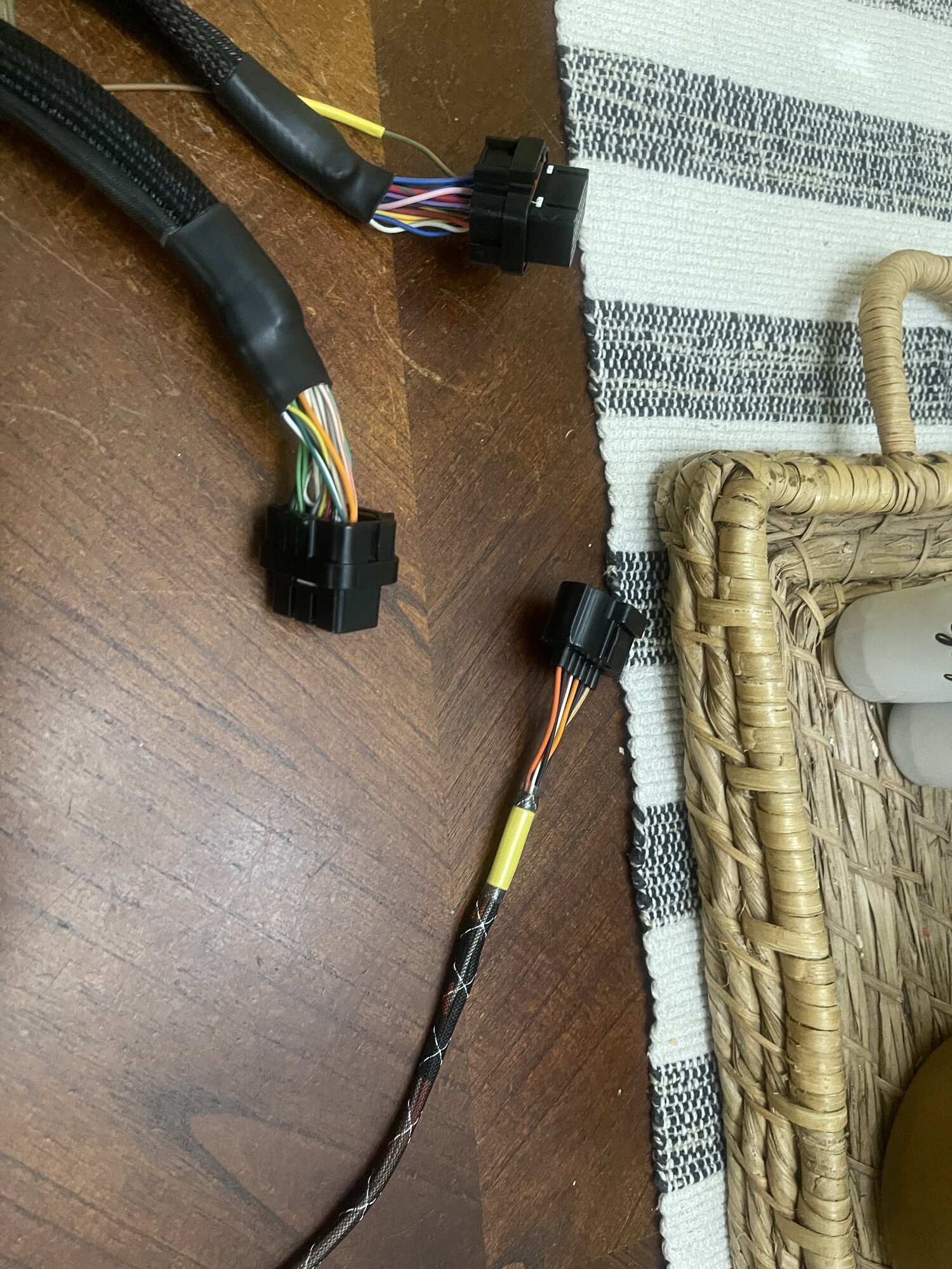

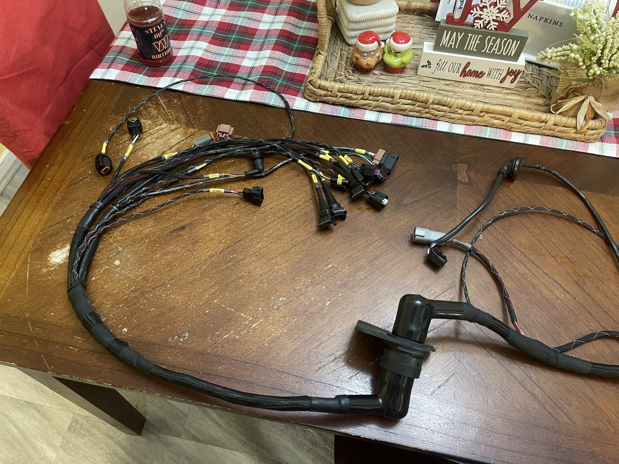

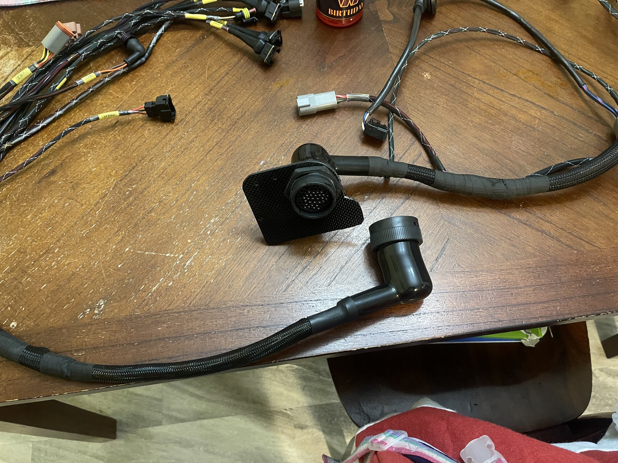

So I finally got the Haltech / engine harness complete. Next on the list is to tap into the dash/gauge cluster harness and get that terminated for a digital dash.

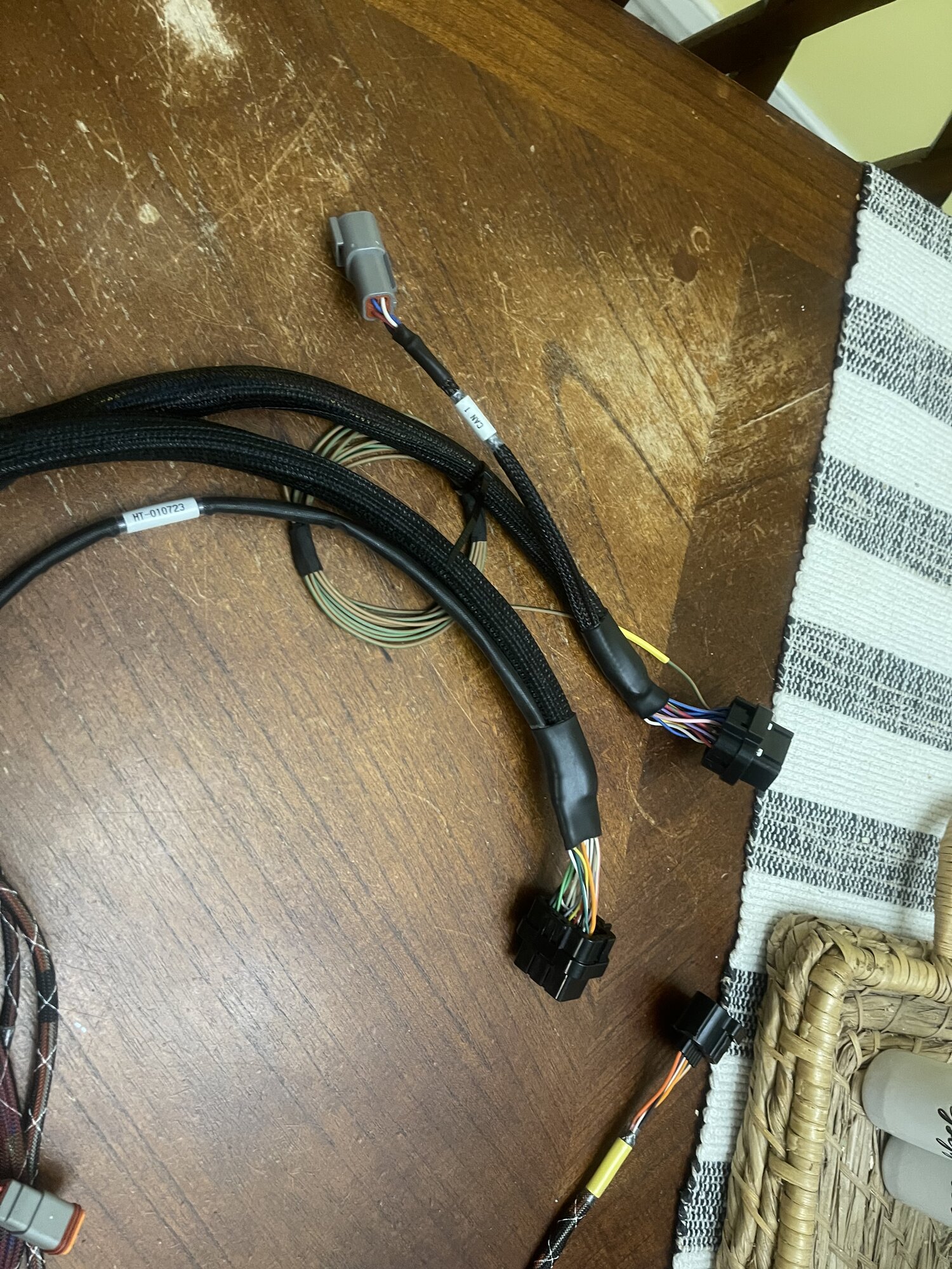

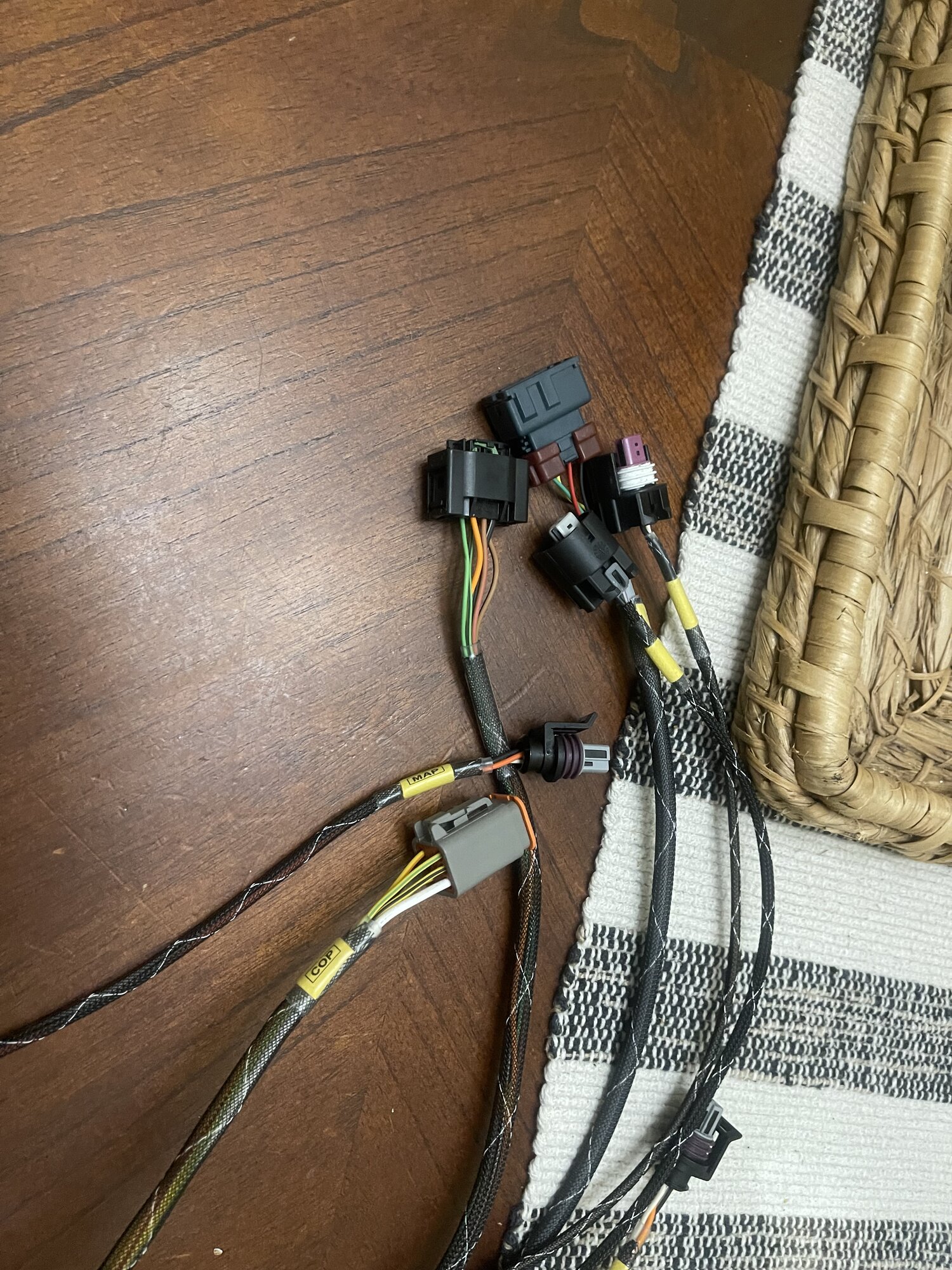

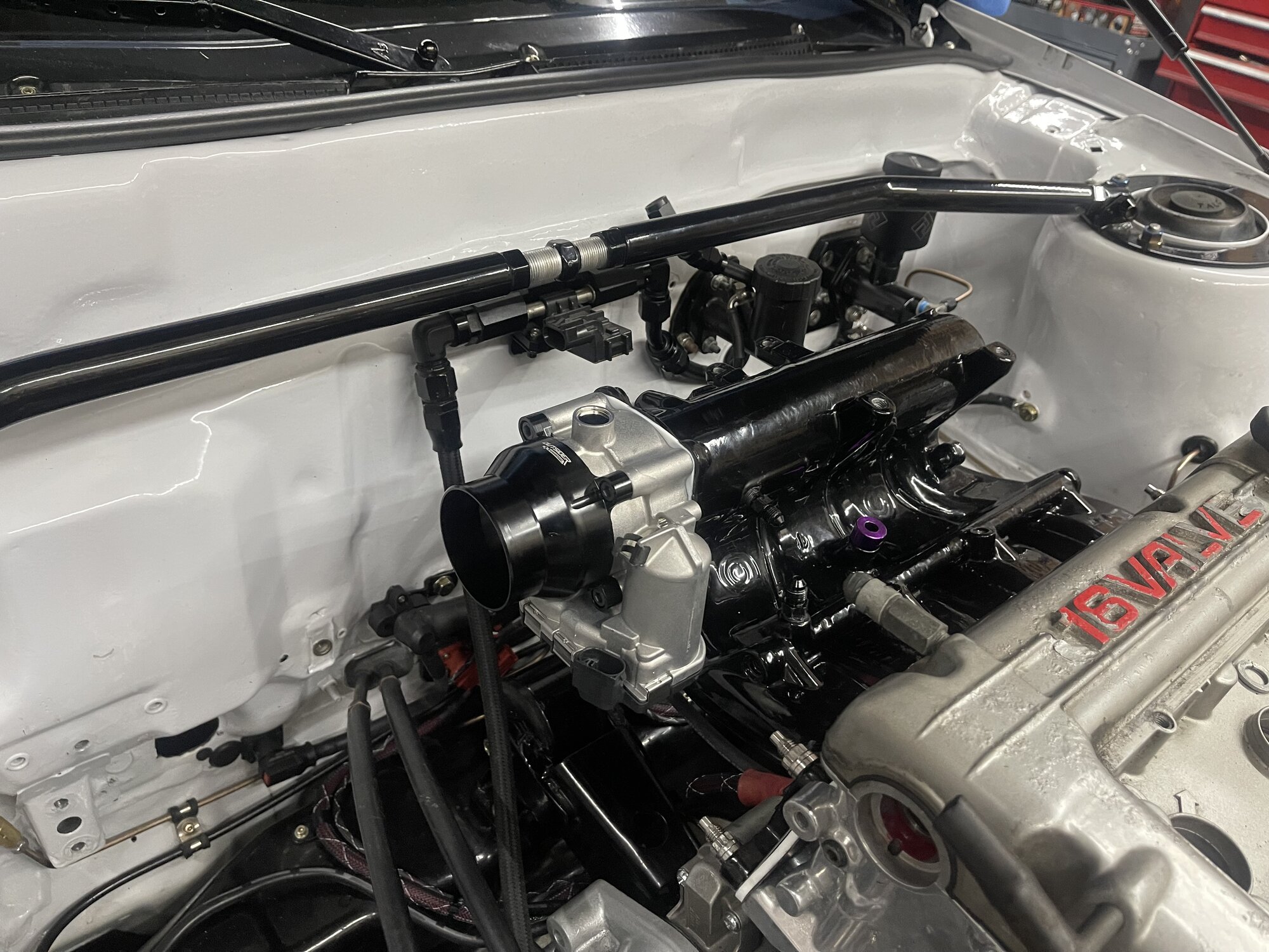

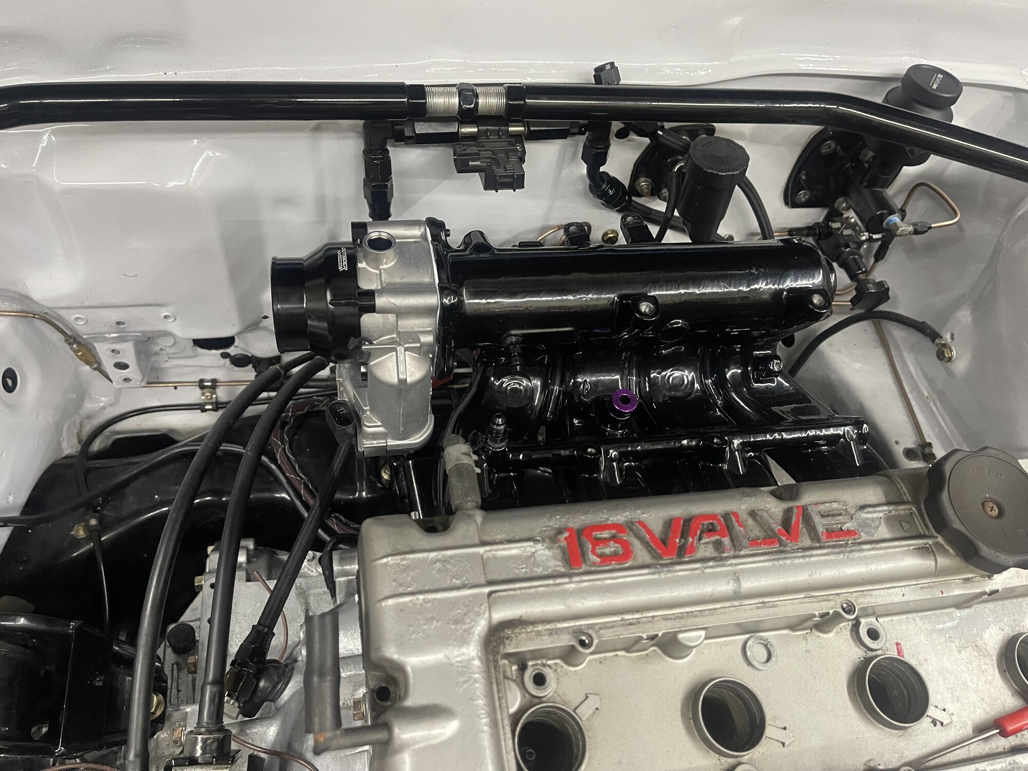

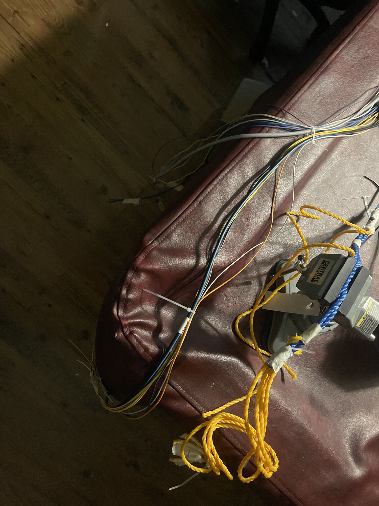

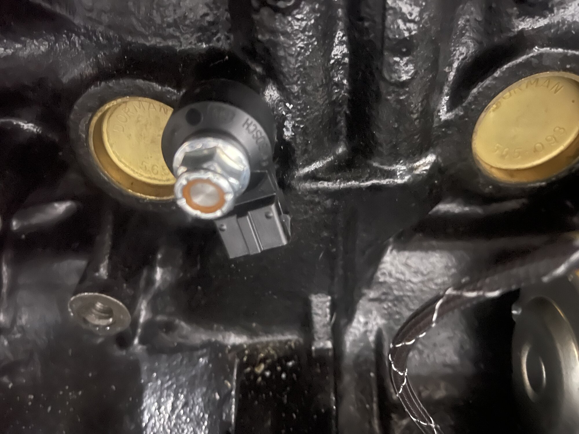

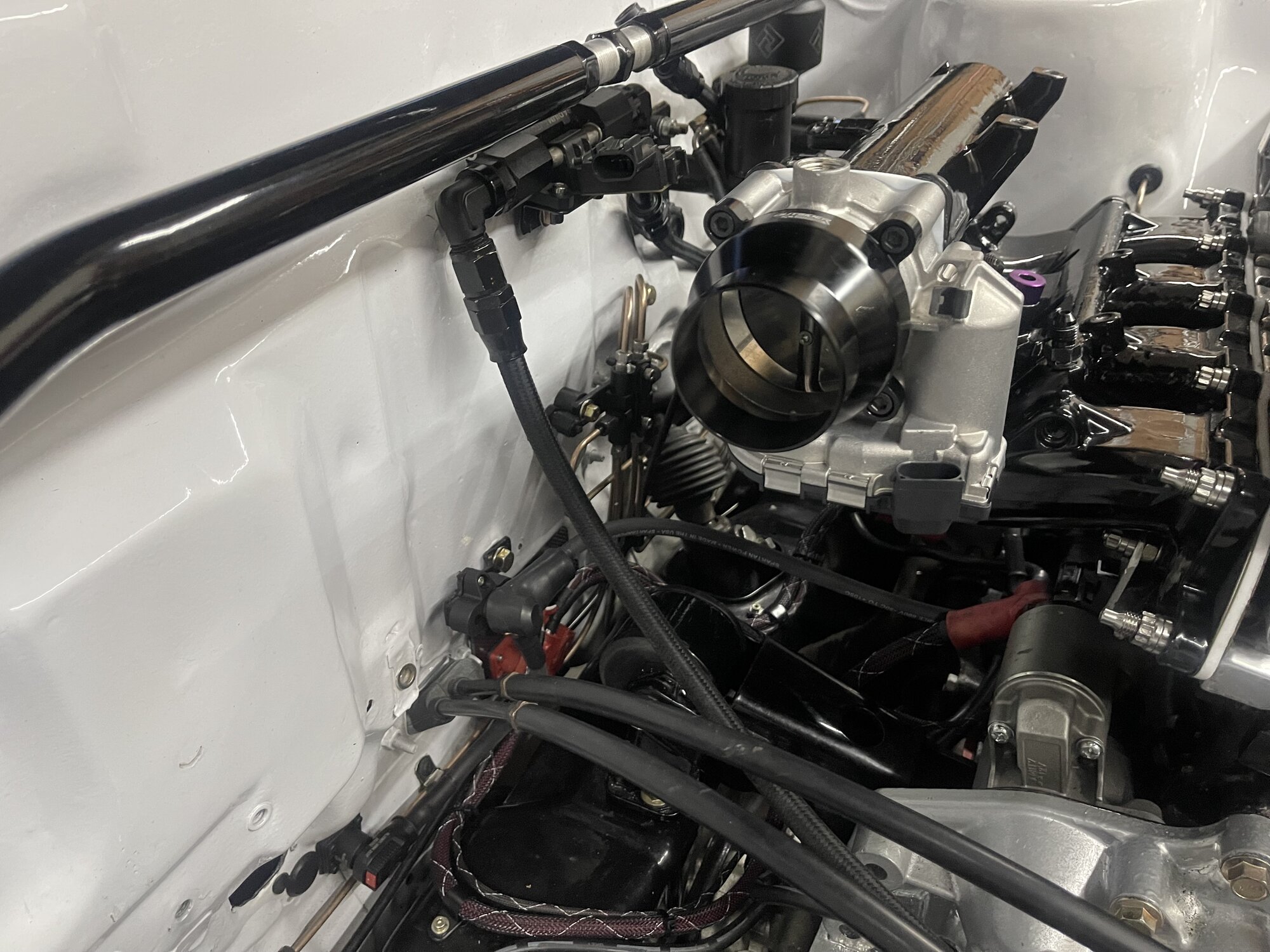

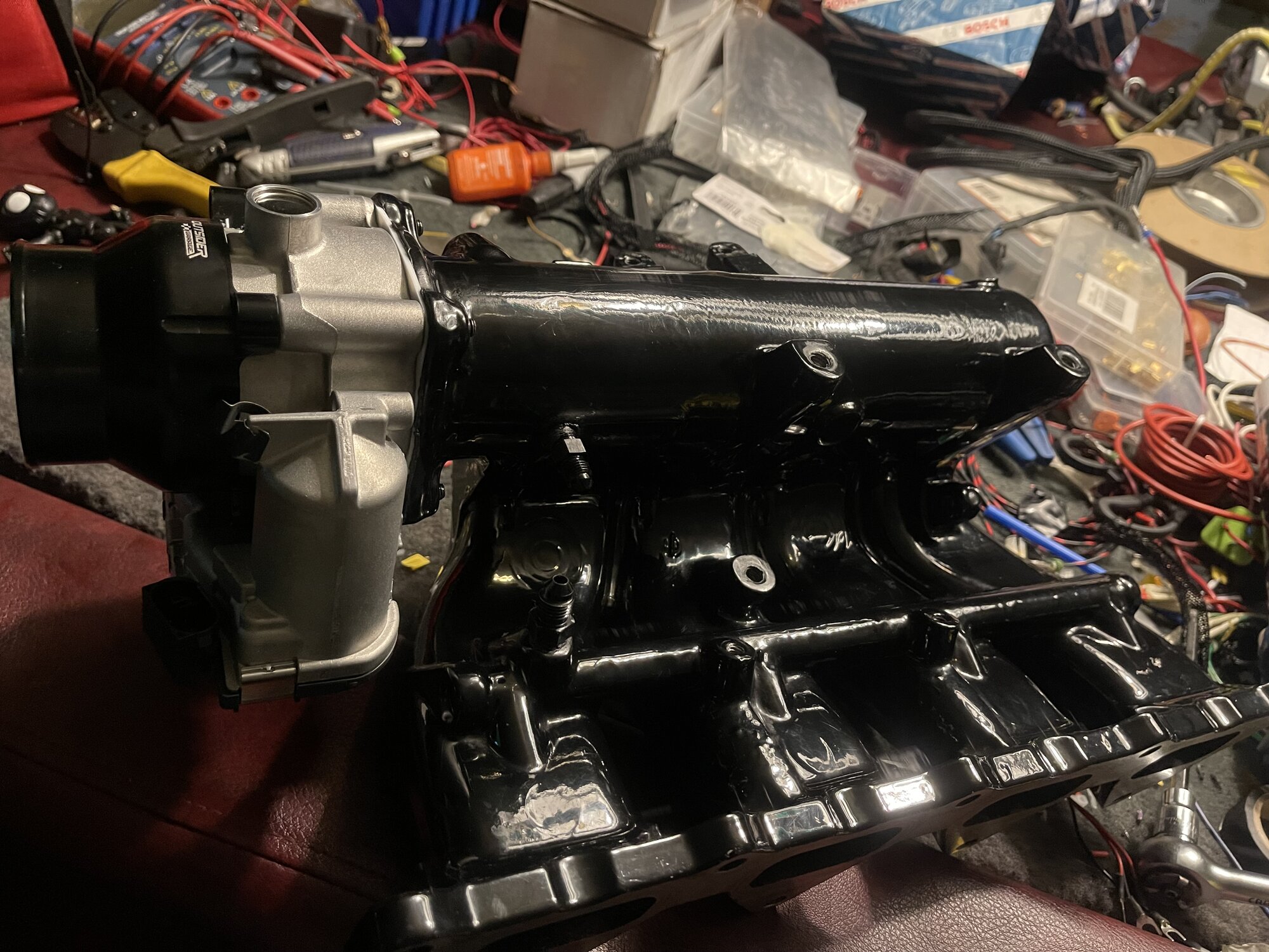

Update: So I finally got the Evo 2 manifold and Bosch 68mm throttle body installed with AO-Customs gaskets. I also got the Bosch knock sensor installed. I would have done more but the cold garage was unbearable. Instead I decided to help a friend out with his Haltech harness. I will say the Haltech terminated harness is well built and should be pretty simple to wire up.

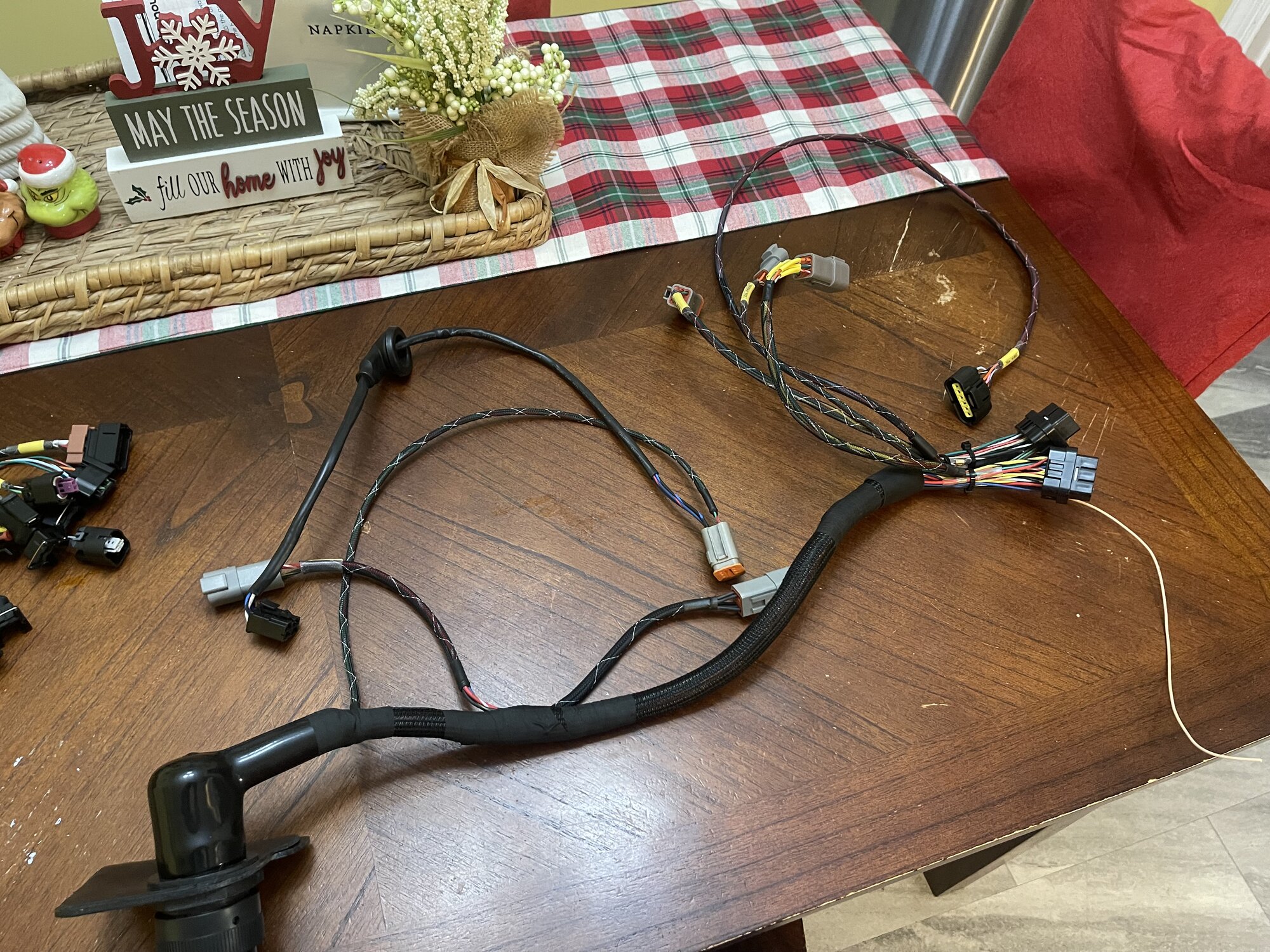

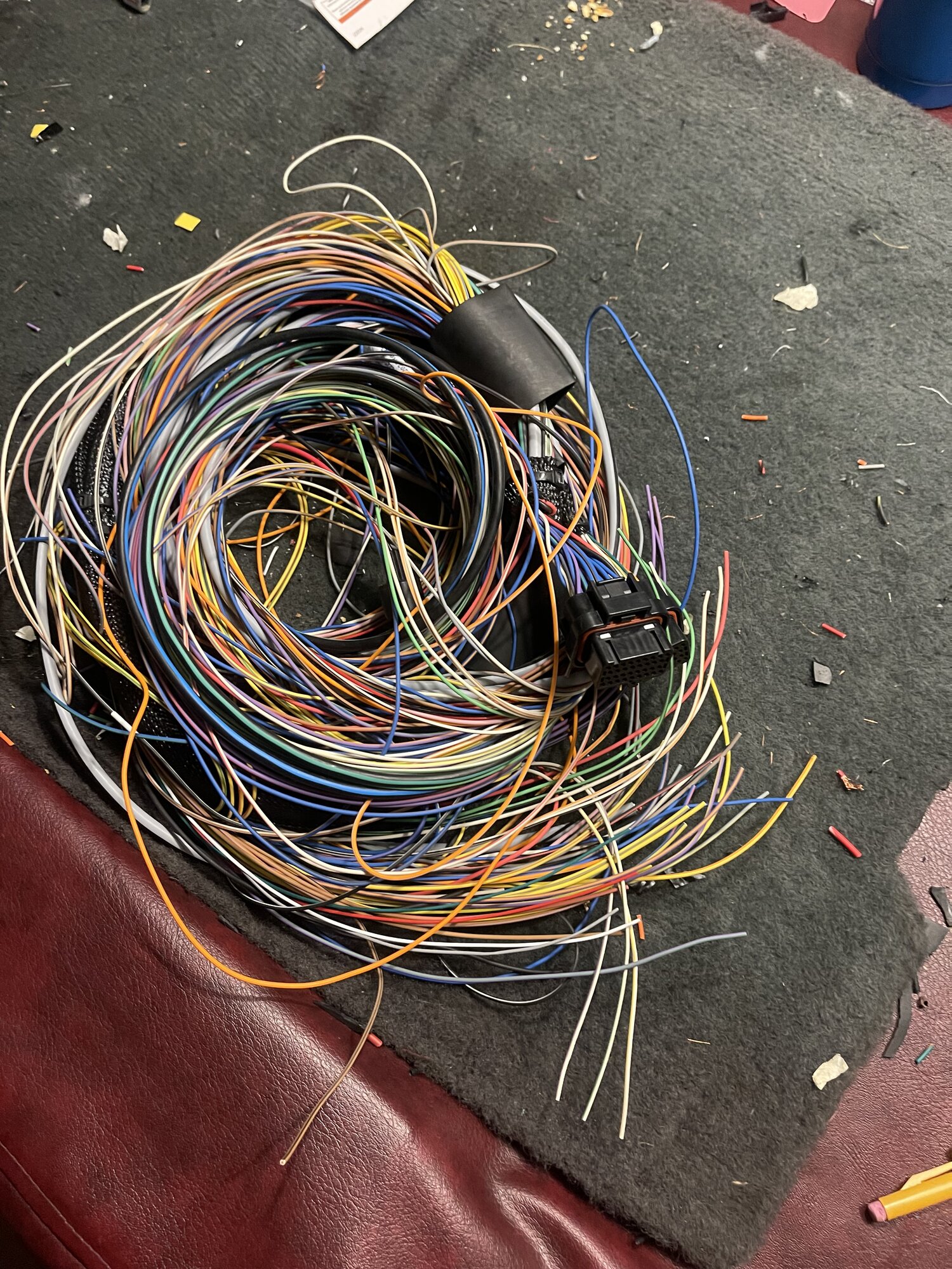

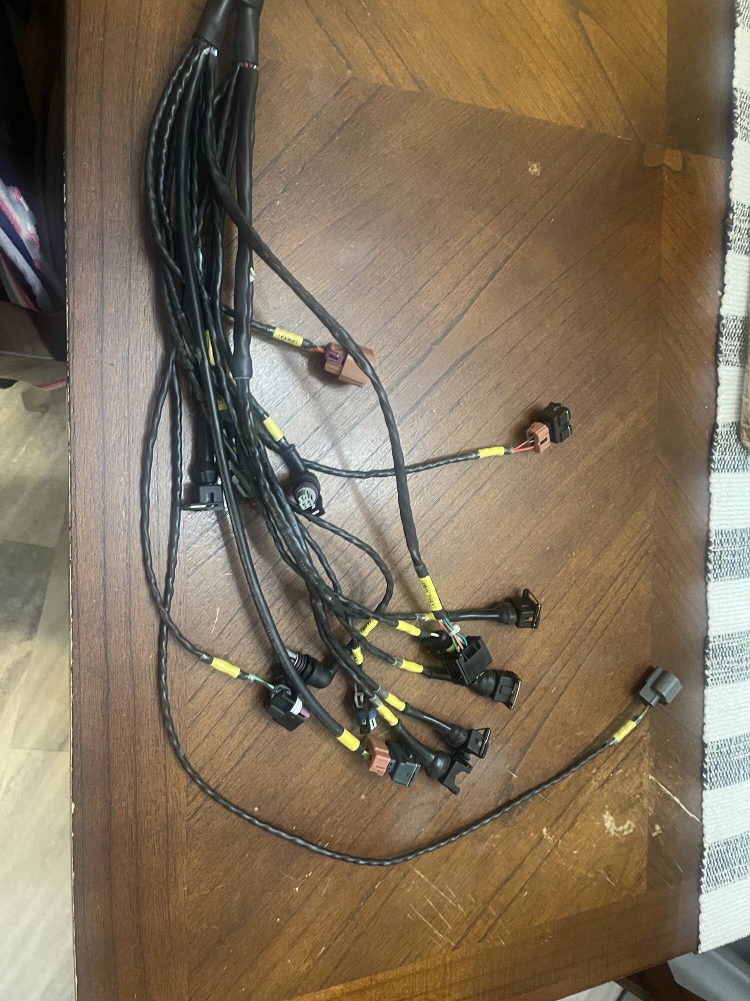

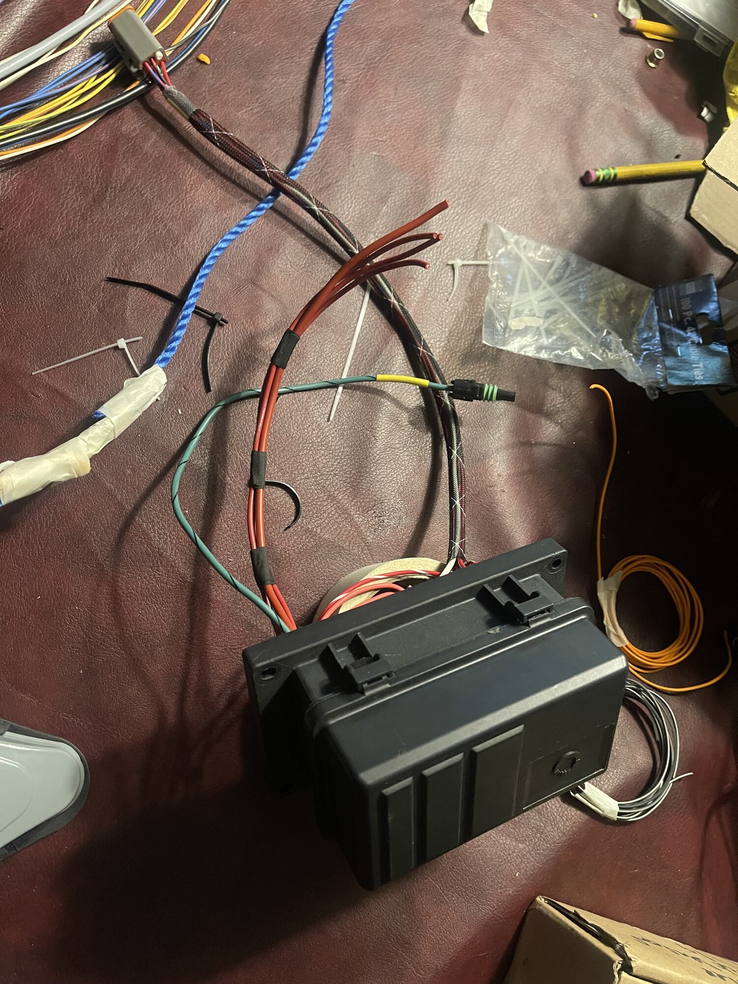

This is the start of Vic’s harness and fuse box.

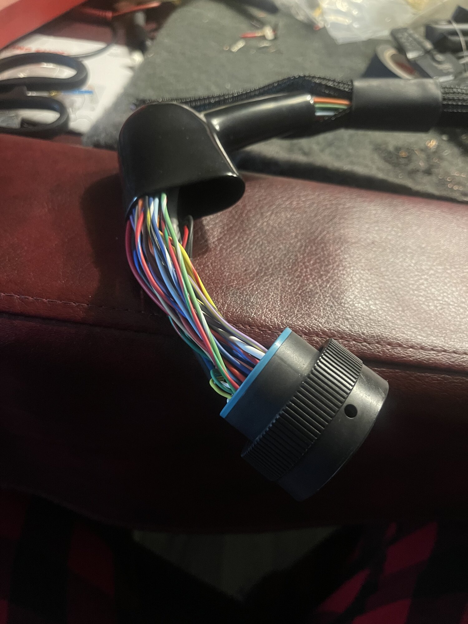

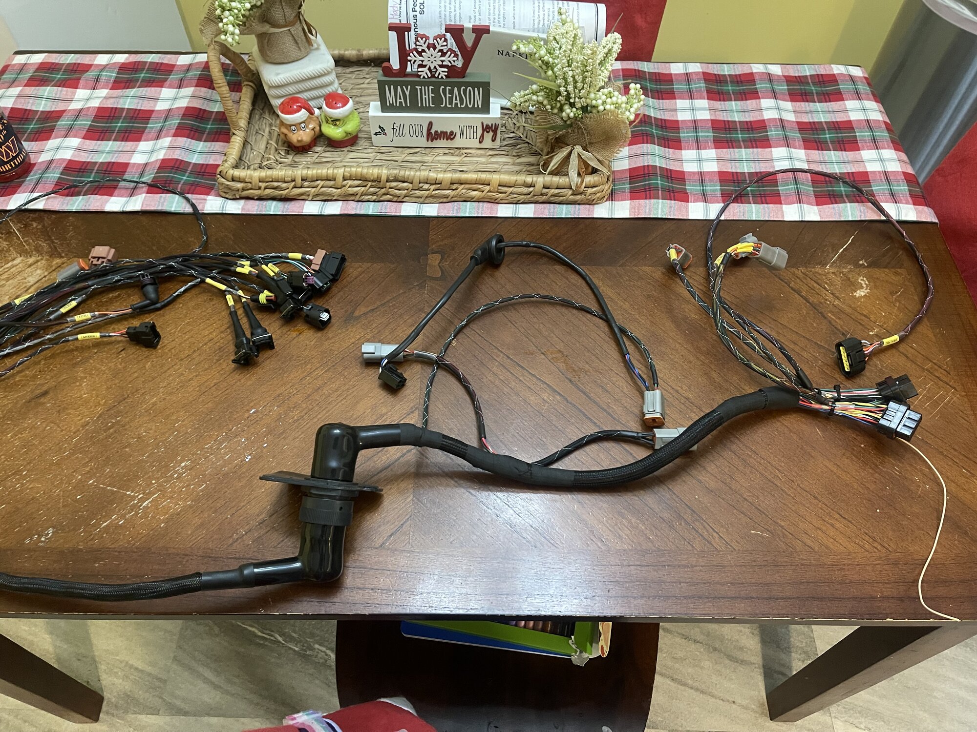

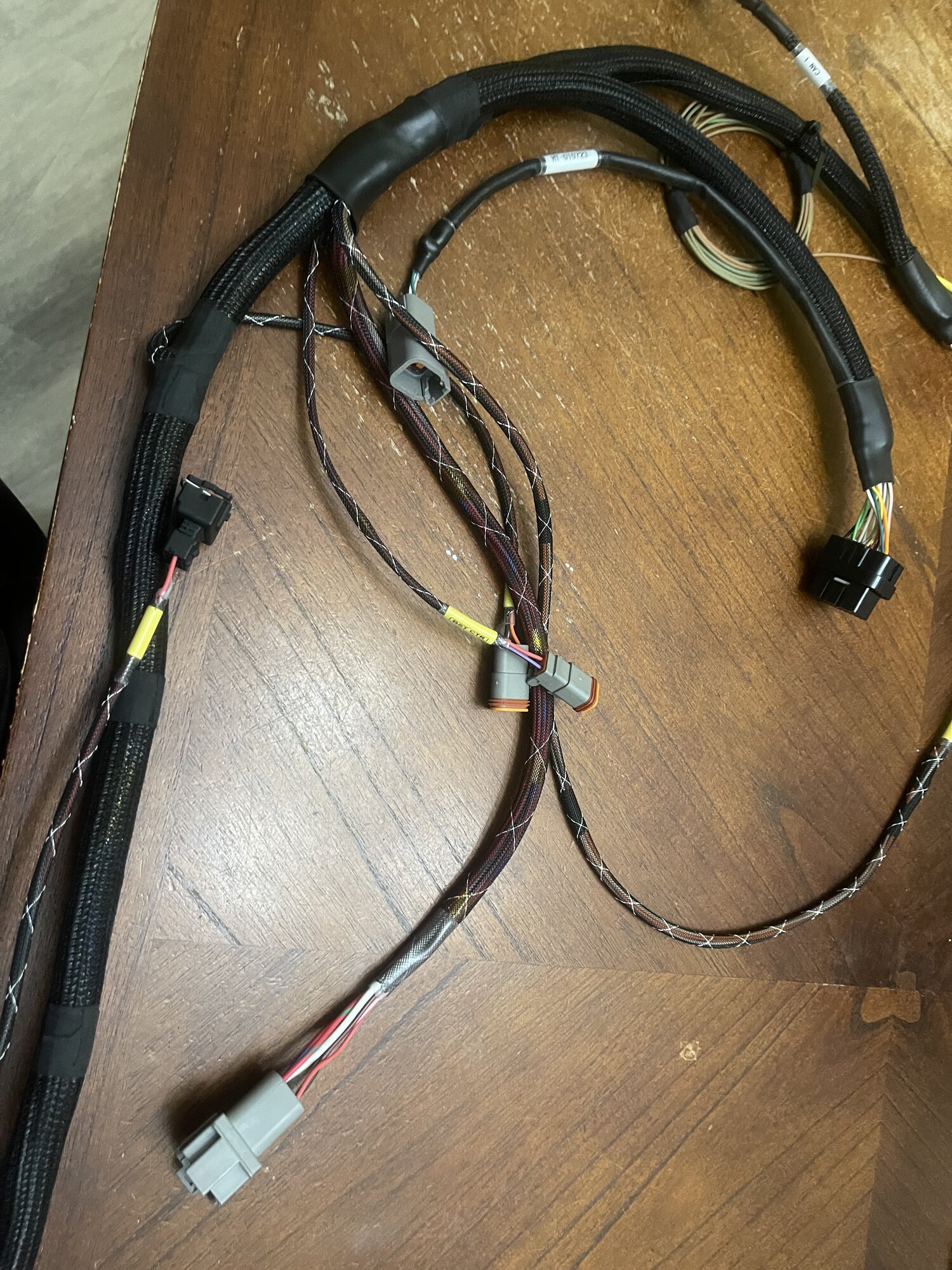

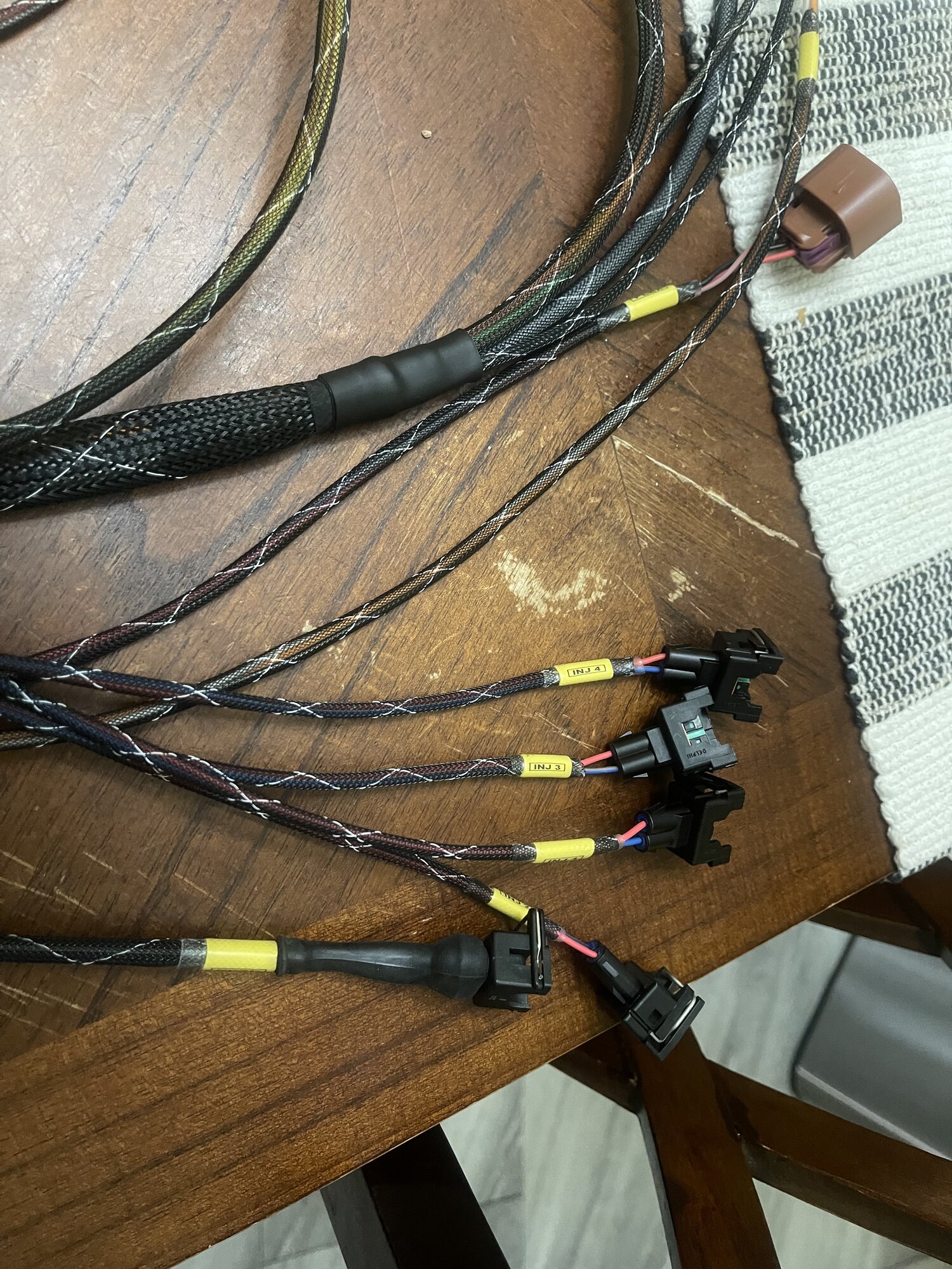

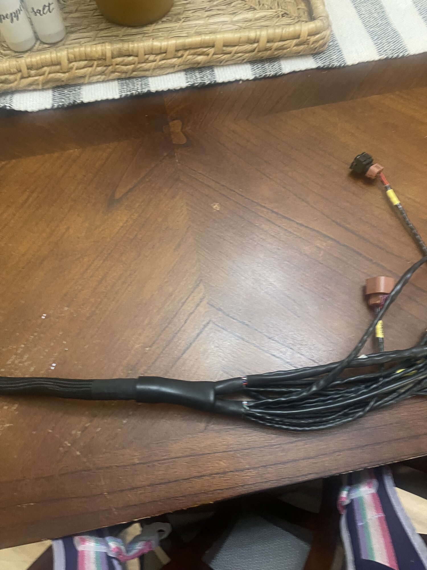

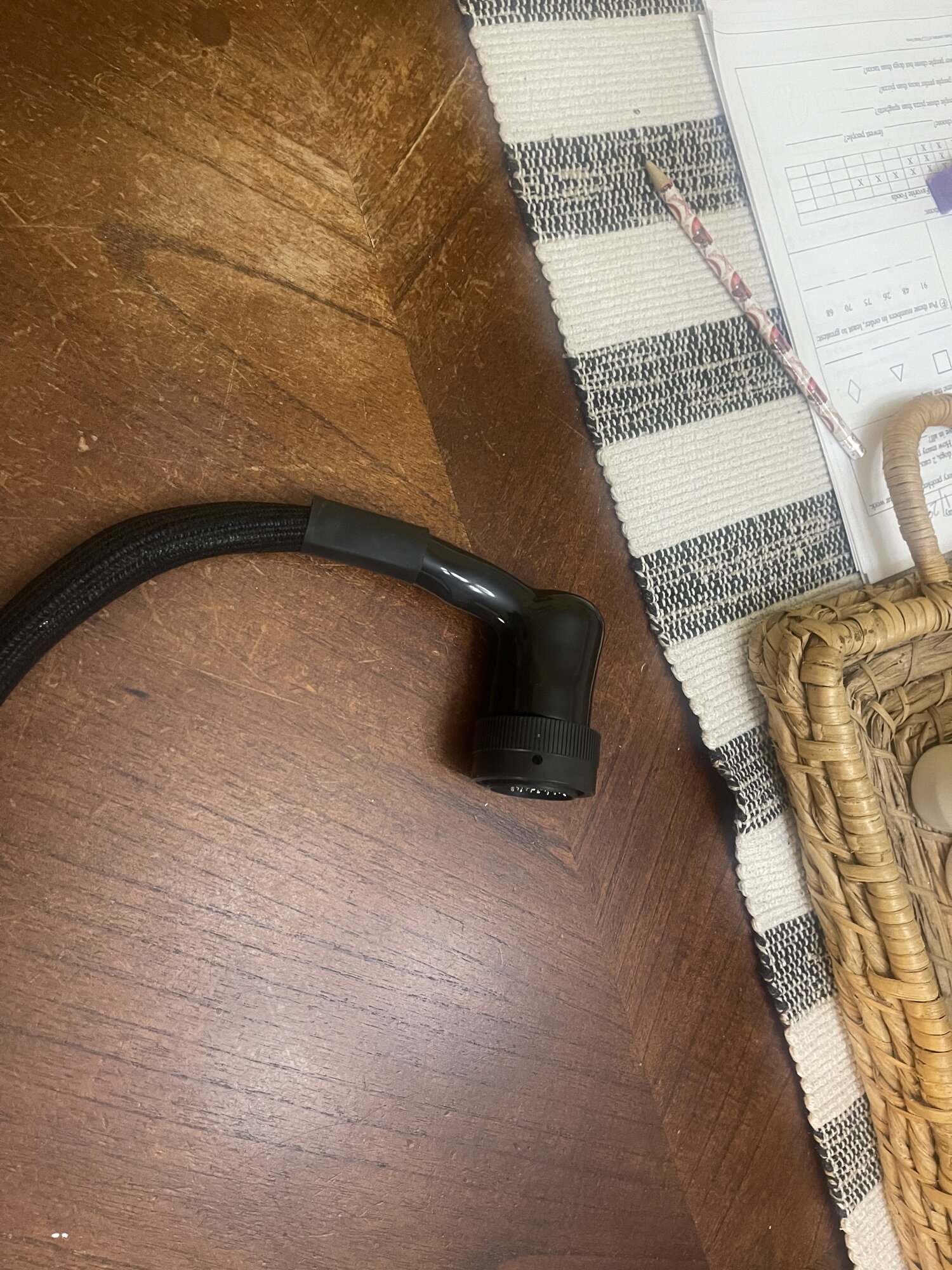

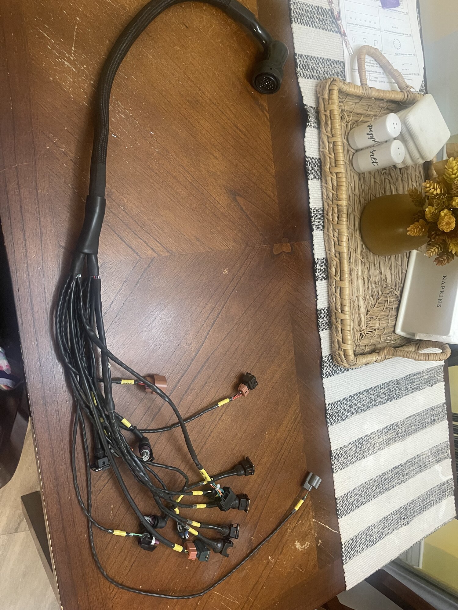

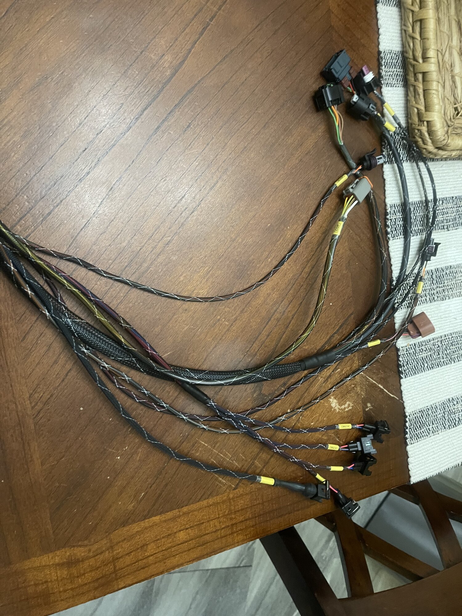

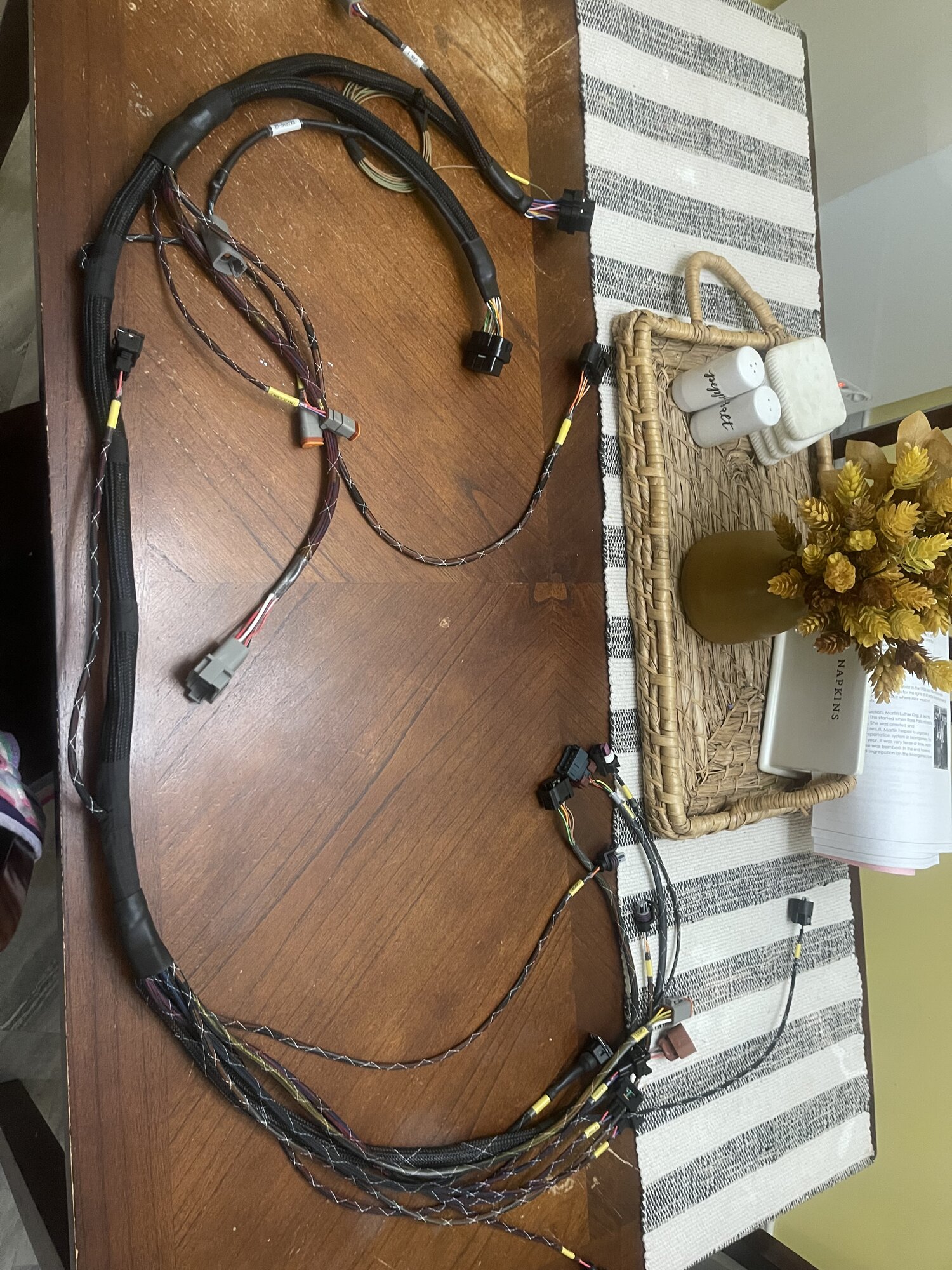

Update: So due to my boredom and this Virginia ice storm, I decided to work on the car . Only thing is the garage was unbearable and I wasn’t going in there. I have always wanted to try out ohm racing heat shrink that’s an alternative to ray-chem dr-25. So yes I built another harness. I will say the heat shrink is thick and does take some heat to form, but remains very flexible. I am pleased with the outcome and will use again in the future.
Another one from scratch or just wrapped it up with new shrink. Is the shrink lined with glue . It looks thicker. Perhaps more durable for the engine bay
It’s from scratch, yeah I tried out a transition heat shrink boot. That part of the harness is thicker, but it also cuts down on the flexibility. The ohm-racing shrink is not lined in glue, but fuel resistant.
Im boxing up your Haltech items, will most likely get them out next week. I will let you know the shipping rate.
I forgot you are building your from scratch. How was the different from mine from yours as you building two now. Any pros or cons

I need to finish ohm testing the harness. You should be good to go with the IC-7 since it’s wired for can bus. You will have to wire in the indicator lights etc.

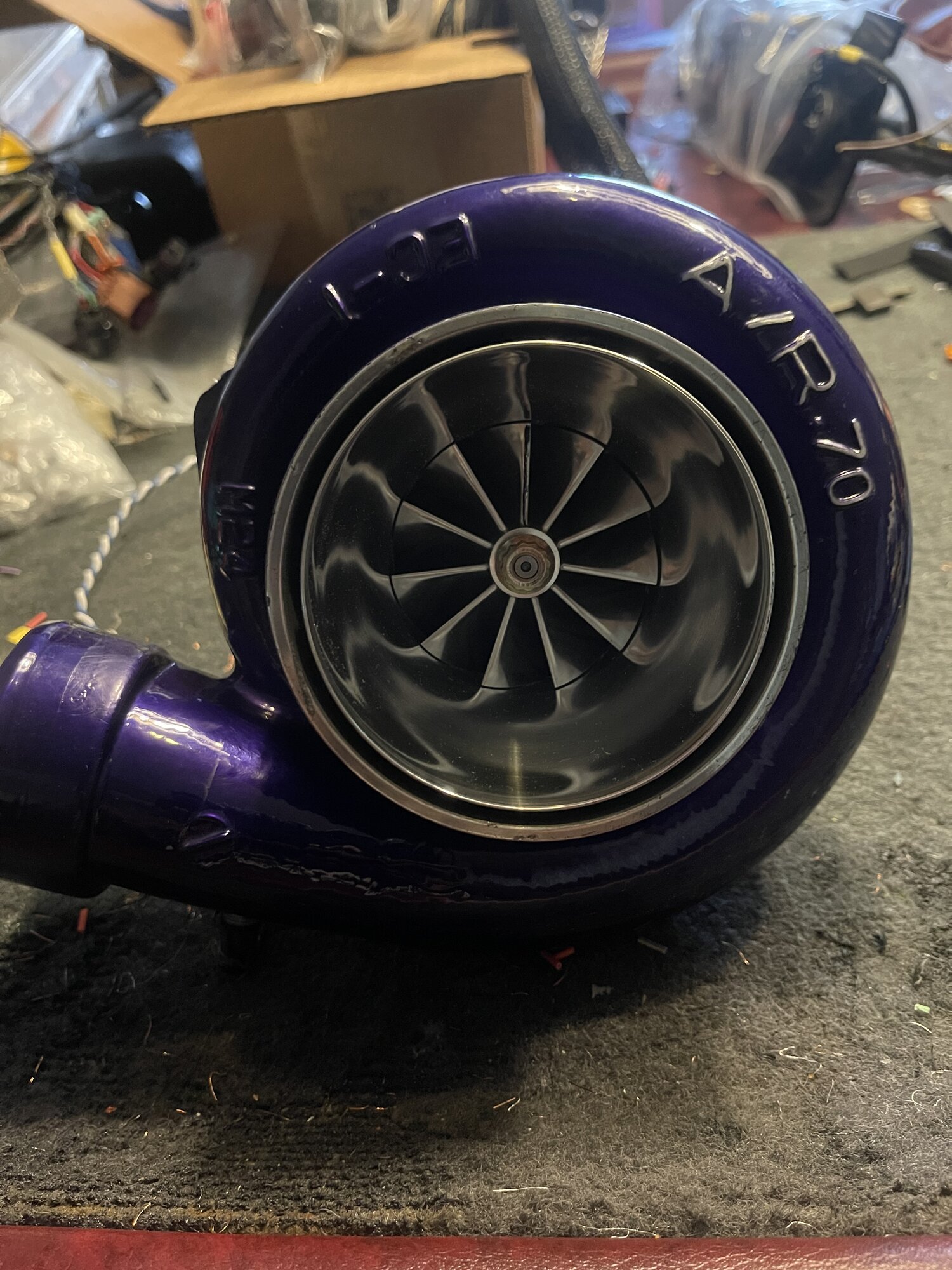

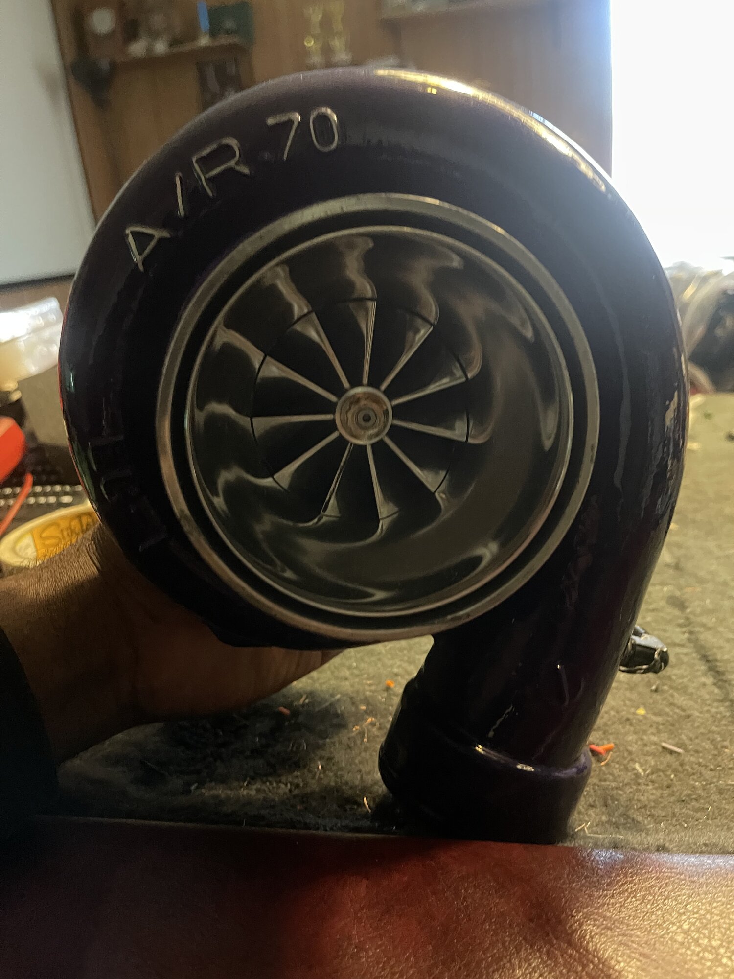

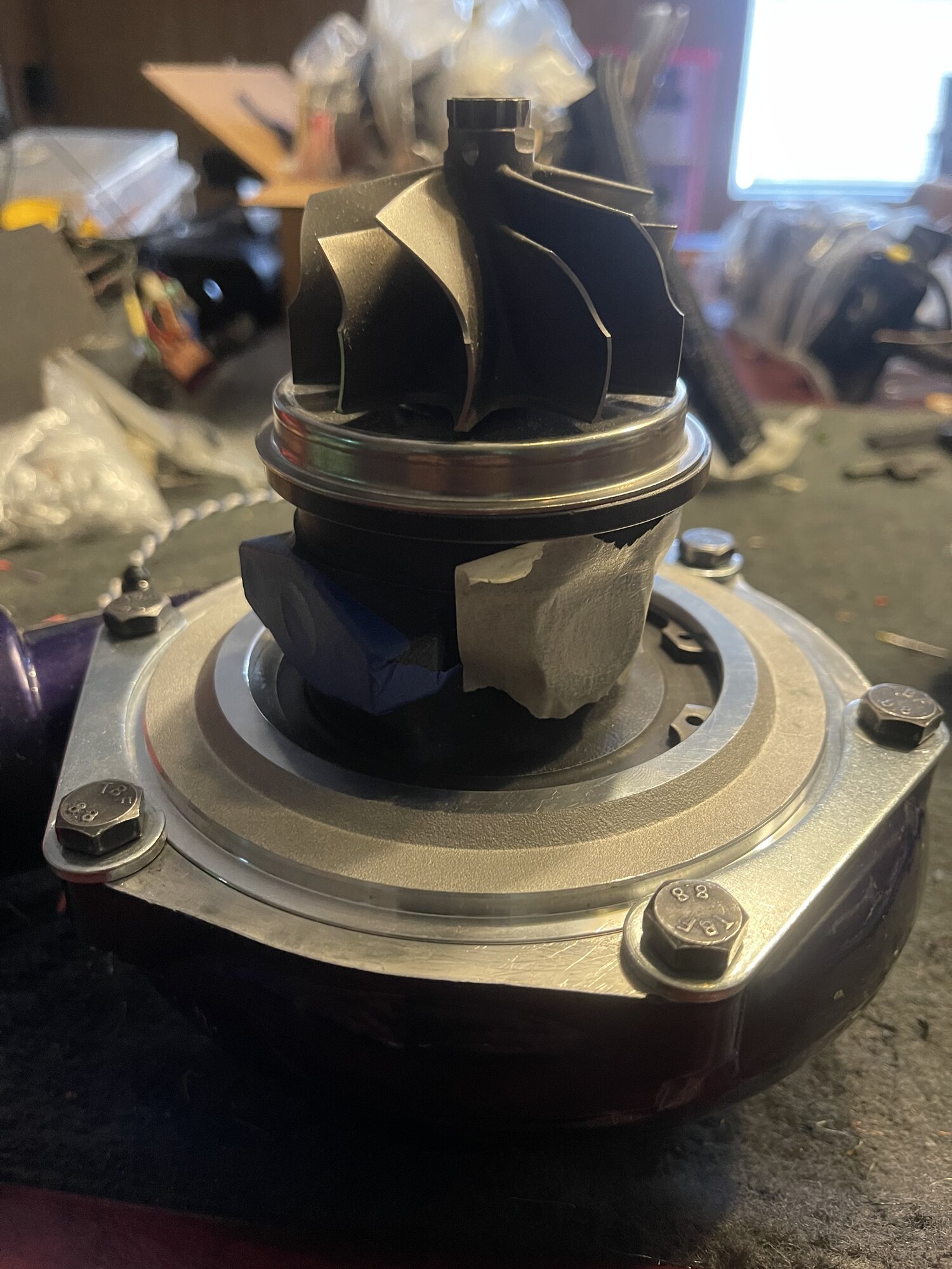

Finally got the FP DSM82 turbo back from Ian @Turbo lab of America. The turbo was smoking excessively , so I had a full rebuild done with some upgrades. The smoking was caused by the rear seal area of the turbine shaft being worn out too much. I also had Ian upgrade to a billet GTX compressor wheel and a D5 5+5 turbine shaft assembly. This should definitely improve the turbo efficiency. Time to put it all back together.
