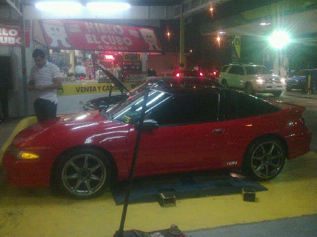

hi Im fom venezuela this is mi build to 11 , 10 and 9 seconds
9/19/2010 The car was a Eclipse gsx 93 syncro built for a friend by myself with
manley pistons 8.5/1
eagle rods
brian crowe 280
custom degreed
1mm os valves
ebay turbo manifold
garret turbo tuck 60/1 t3.63
tial 38mm
xtd cluch
non eprom stock ecu
1g maf traslator
evo 580 injectors
Methalon 1000cc injection
Precision intercooler
ugly huge no name fuel pump
THE car ran 11.90 with radial and pump gas metha @ 20psi

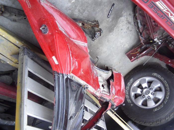

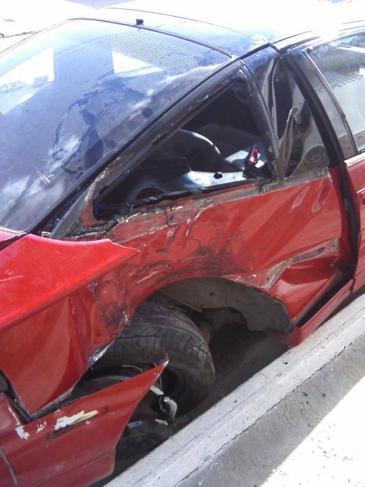

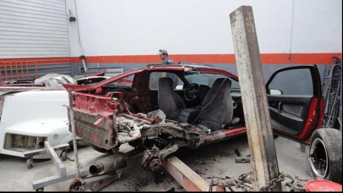

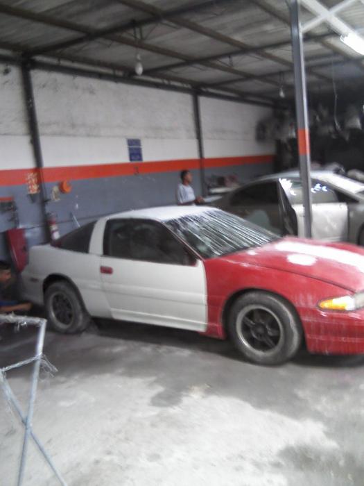

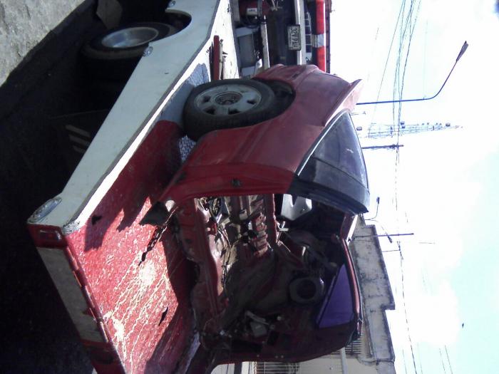

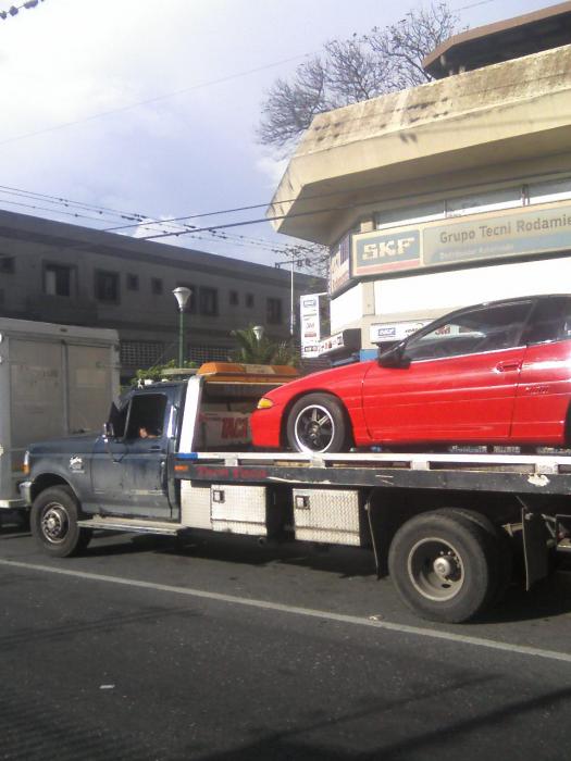

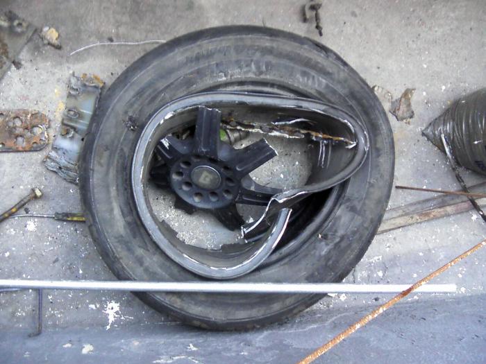

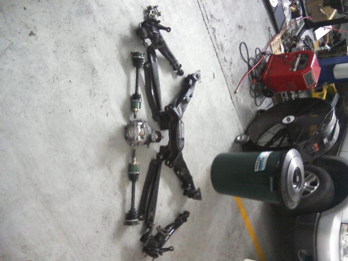

my friend crashed the car and I'll buy it and started the reparations

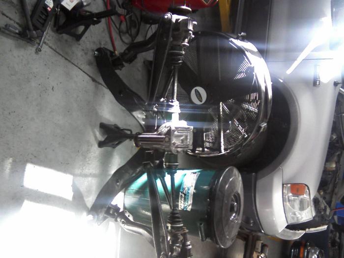

the car was repaired and ready to start looking for the 10 and IM THE OWNER:hellyeah:
same engine
precision 6262.63 jb
750 injectors
044 fuel pump
act cluch
new brakes shafts and read end 4bolt
aem lancer ecu
diy conversion harness
24/1 trigger disc
dual syncro second gear
weeld center diff
44tia wastegate
[/IMG]
second gear pull 30psi pump gas metha
blow cluch
blow drivesahft
blow transfer
blow second gear and shift fork
in one month
