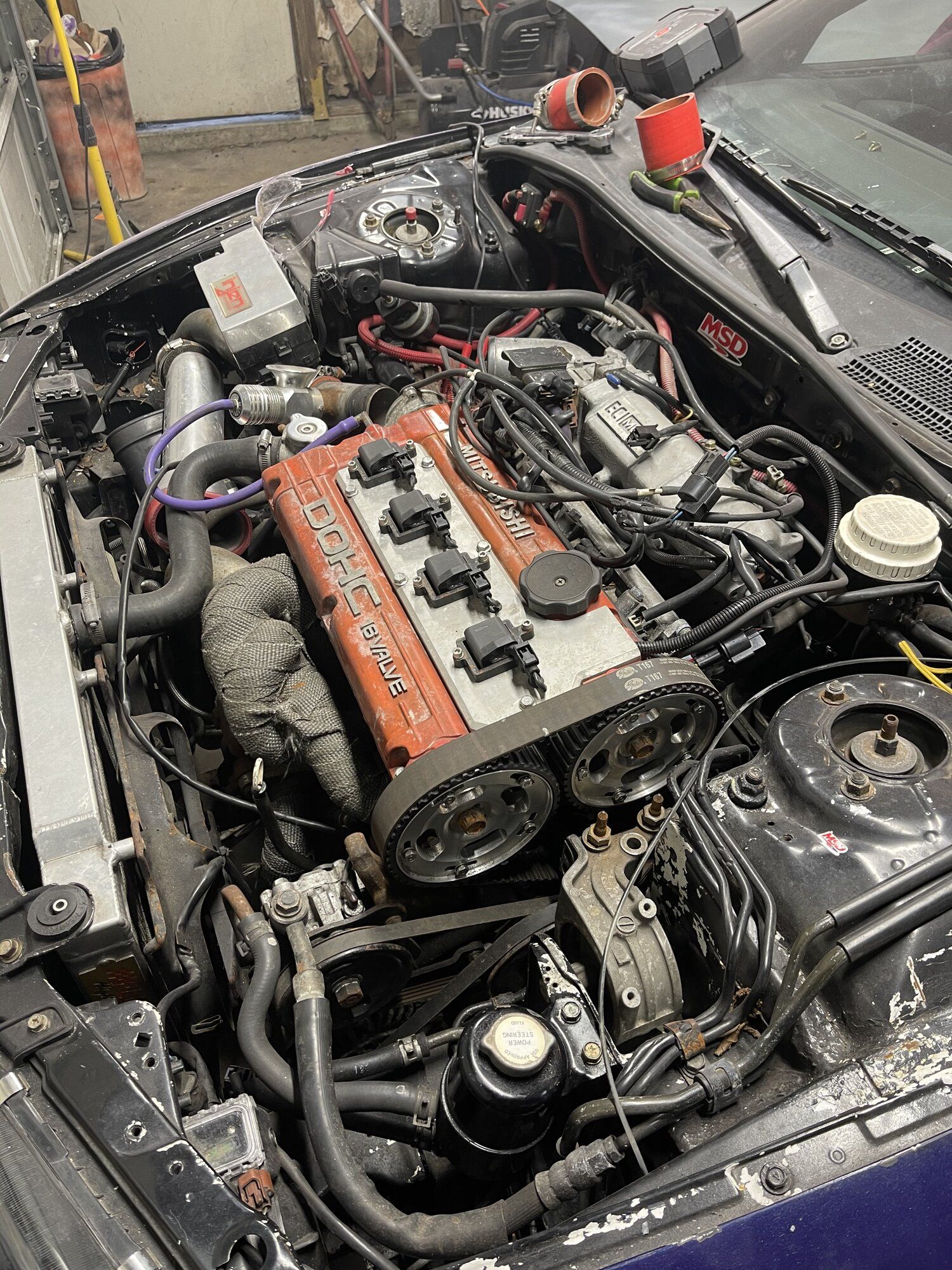

i appreciate it man, heres how i looked at it,
new “tucked” harness from ohm-racing is over $1000 id love one of these but i dont have my final set of injectors and so if i order it with plugs for my denso injectors they might not match when i order my final set of injectors
also i dont have a map sensor yet i thought i had a ohmi 4 bar laying around but cant find it
just a few things i still need before i can get my hands on a nice harness like that. unless mine does the job.
also i wanted to do the hands on of “making/customizing” a harness
i thought it would be easier to just used the stock harness since it was already “together” all i had to do was take away connectors and reroute them,

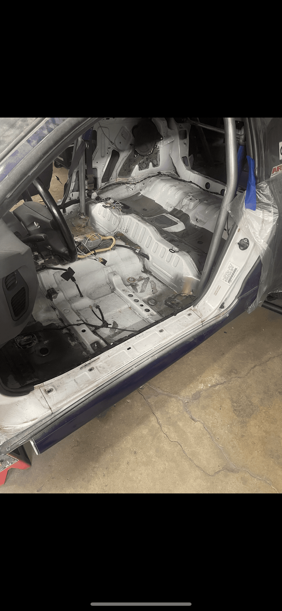

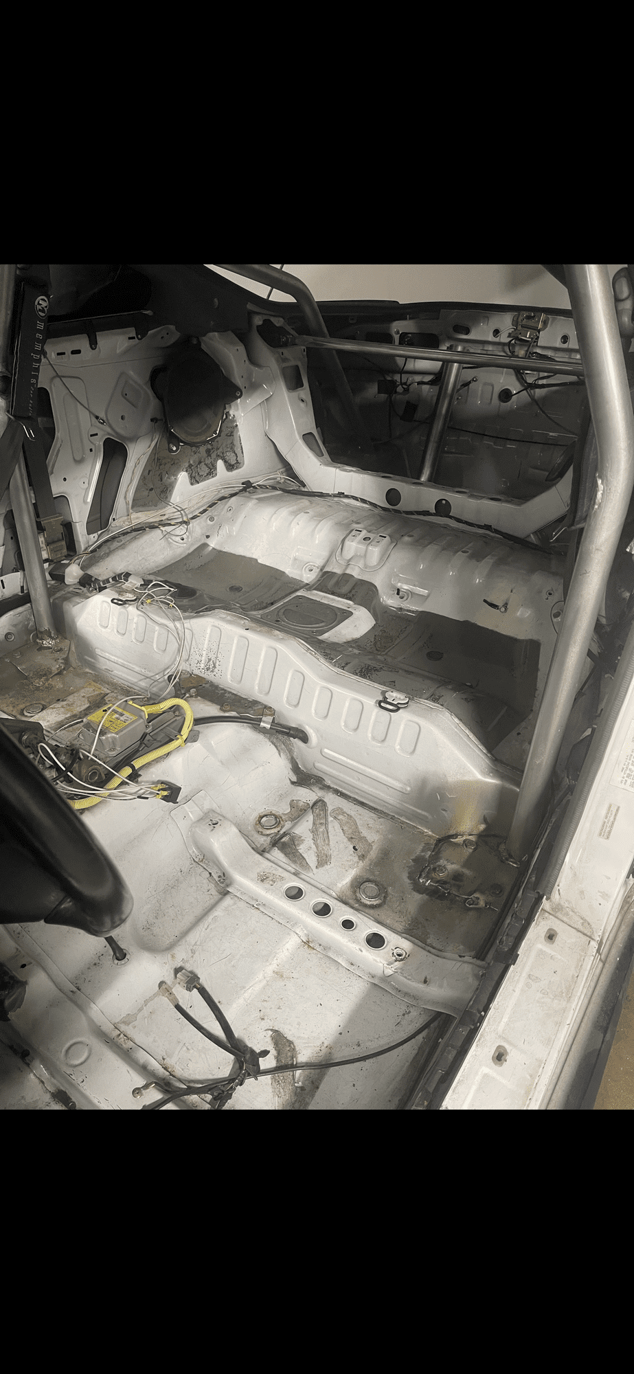

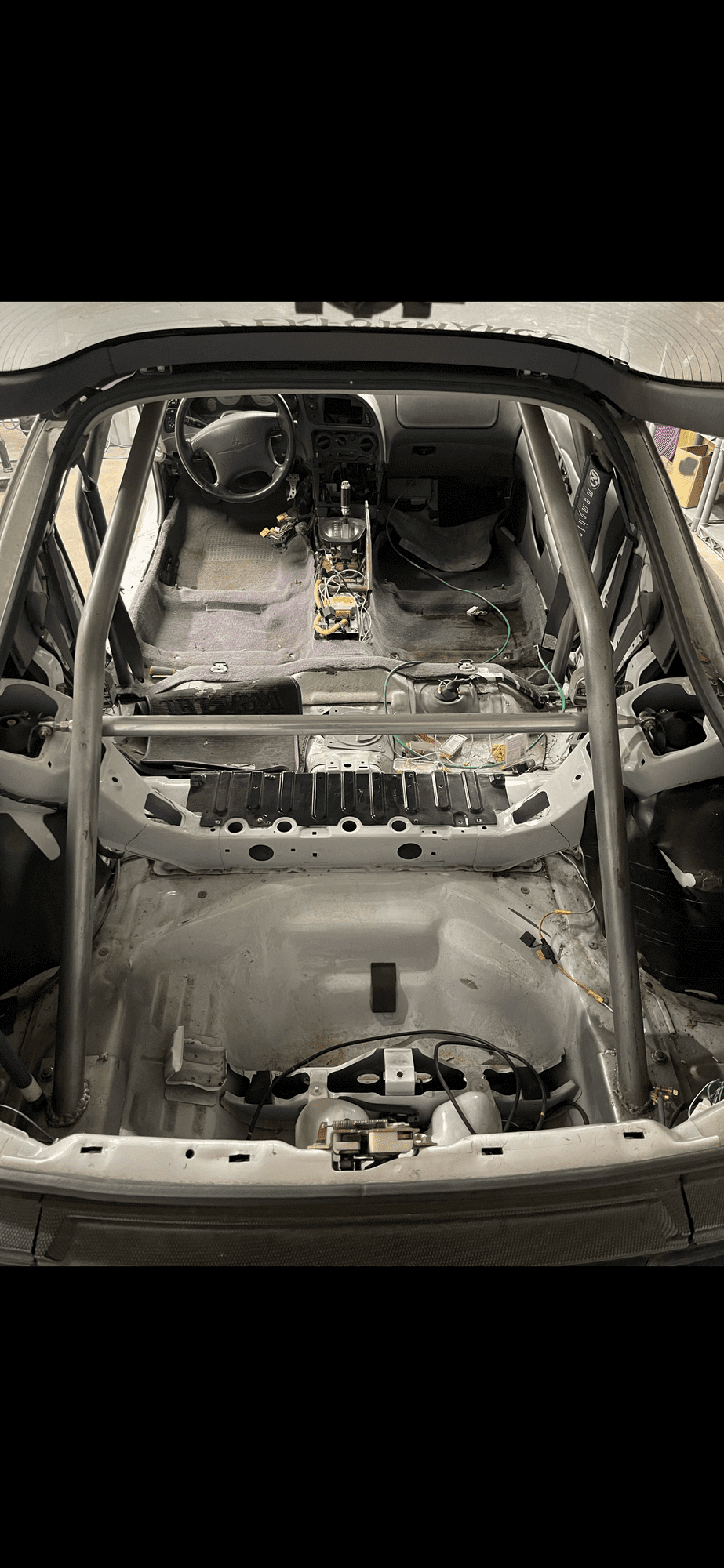

What roll cage do you have in there? Just a loop or do you have a 4 point roll cage?
this roll cage was a previous owner problem, id never let that stay in here, they couldnt weld the tops of any of the bars because they did it in the car and to close to ceiling the welds were shit, i ended up cutting it out, there was a middle bar too behind the seats but looks like previous owner also cut that out, i also see you asked what fuze box to use and you have to use the 99 gst one
(Shaking my head) Welds in a cage, to no specification, with no fabrication process. oh the horror
I’ve helped do it right, on an SCCA EVO. We lowered the ends of the hoops with an initial assembly through the floor, weld, lift and weld new floor plates. Glass out, roof stays right where it is. The acid etch and two part paint went on after.
oh man that sounds like a hell alot of work, im going to make a new one with all the right specs to pass and shit.
Make it to save a life - Our guy slid off the last turn at big willow at about 120mph, on fat Hoosiers, Hooked up just long enough to launch himself into the infield, went end over end 3 times. That car never drove again, but he did.

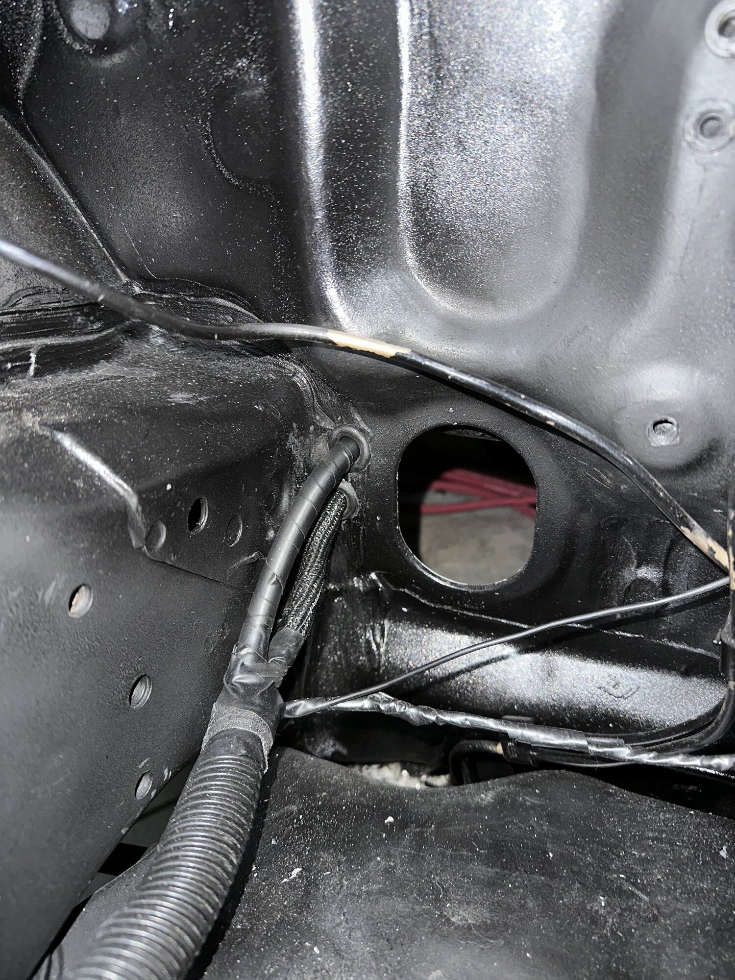

finally got around to adding rubber grommets for the wires i added, looks nice
under side looks so nice with no rust 😮‍💨

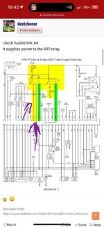

found where my short is, its the famous room fuze under the hood, havnt figured out whats causing it yet tho, it isnt my engine harness i made, its in the fuze box harness that i haven’t touched yet, leading me to be another f***ed wire somewhere ill have to search endlessly for again, i have unplugged everything and door chimes to dome light ac switches the whole 9, ecu blah blah, still hot.
anyone know exactly whats on that fuze and where it leads to first? i cant seem to find a diagram for the fuze box itself showing where the 2 wires go. or if they split off in the harness and go to other things yata yata. ya get the jist f*** this thing 😂💀

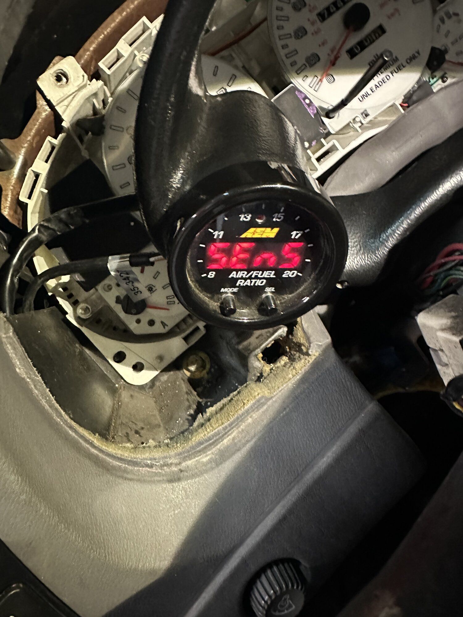

my wideband is still stuck on “sens” have checked all connections everythings good gotta be the gauge or sensor. i bought the gauge second hand so i think im just going to get a new one any suggestions that isnt aem?

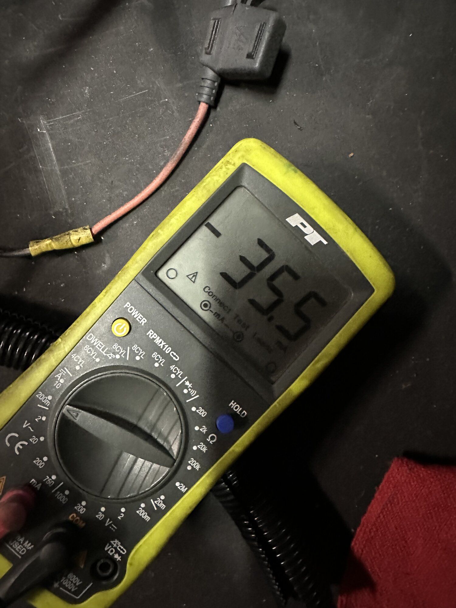

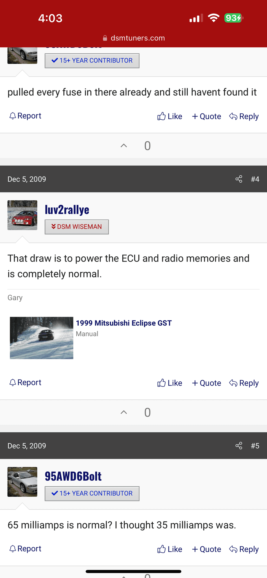

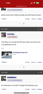

i was searching high and low as to why the one wire still had a 35 amp draw on it thats connected to the “room” fuze seems like its normal?

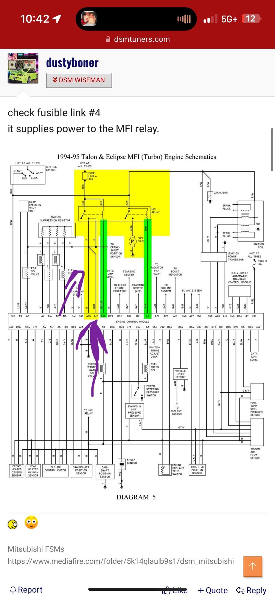

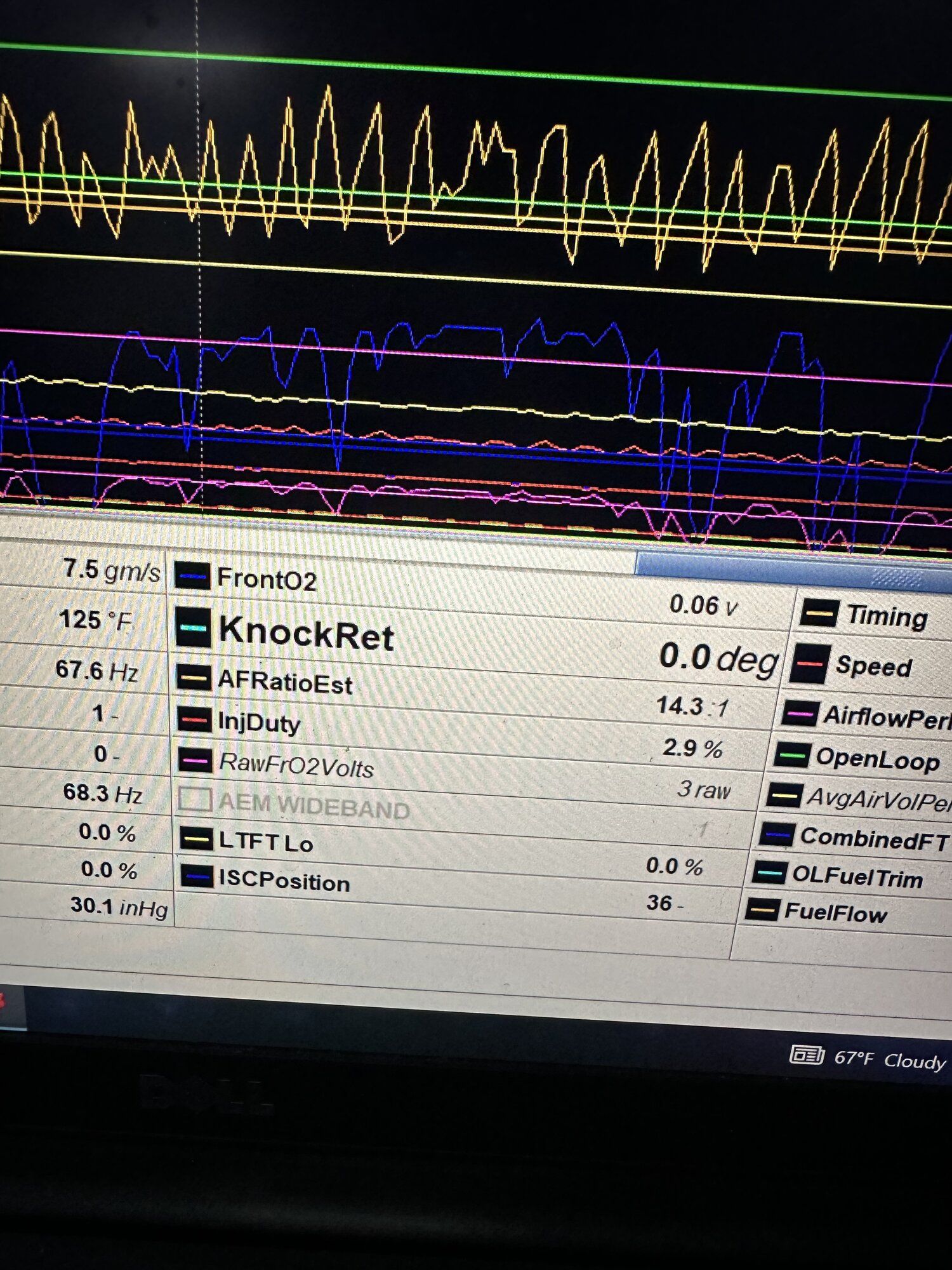

next i got it running i had to see if the wire harness i made was going to work and shit look at that it did 😮‍💨 everything reads in ecmlink as normal 😩😩 my temp works my o2 was cycling everything was working i finally got it to go into closed loop by itself now the idle comes down to 900-1000 heres the only problem i have with that, to get it to start or the check engine light to come on in acc i have to jump the red wire on the mpi relay, the red wire tested only for 0.74 volts weird.

I run this one: https://zeitronix.com/Products/Zt-3/Zt-3.shtml
I had his 1st product - ZT-1, built for the DSM community in SoCal California and sold through Road//Race engineering and then it took off! He re-built the controller for linear 0-5v output with the ZT-2 for mass production, and now so many years later he has the ZT-3 with CAN bus technology for compatibility.

i appreciate you, do the readings match from gauge to what ecmlink is showing? ah and it looks like i can get that to work with this said here aem gauge i have?

Yes - if you setup ECM Link correctly for the sensor, the gauge and the data in the logs should match. You should be able to do the same for the AEM.

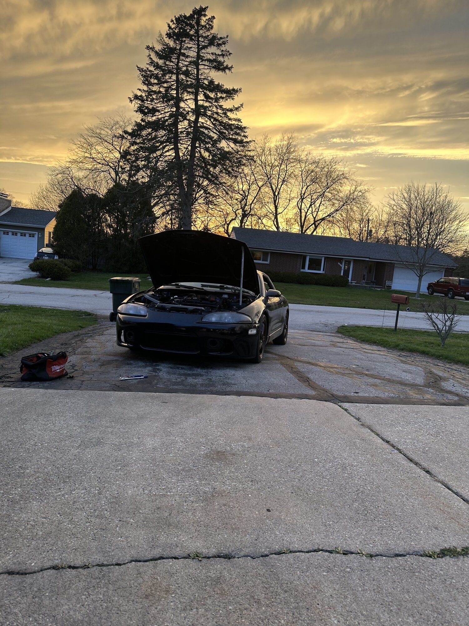

well boys i did it! i drove her today she stopped, she went 45, she turned, she boosted when i had gotten into the very few times that i did, the gauge said 12psi, she turned on and off, no dying, thru out the day. im pretty happy with it actually im pretty positive the oil was being pushed out by to much crank case pressure, i got to the shop cleaned up evrything that had leaked and ran the car again, but before i did i took out the bolt and tape i used to cover the holes that were for the catch can and what do you know no more leaks ran all day. again i dont have a pvc valve nor was my catch can vented to pre turbo it doesnt have any vacuum on it so maybe i need to add those. heres my log anyone want to look thru it and tell me what i need to adjust to get it to run better?

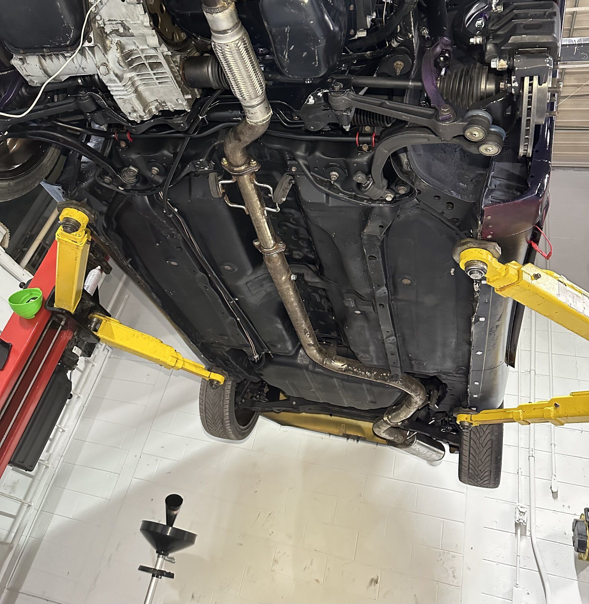

positive my trans is .t.o.a.s.t. 🙃🙃🙃 lost all gears while driving. no leaks, no line kinks, wont shift out of first gear if it does grab gear 20mph at 6k rpm barley nudging along. tranns temp never seen above 118 on the gauge, trans fluid was checked, smells burnt 🙃 pray for me.
