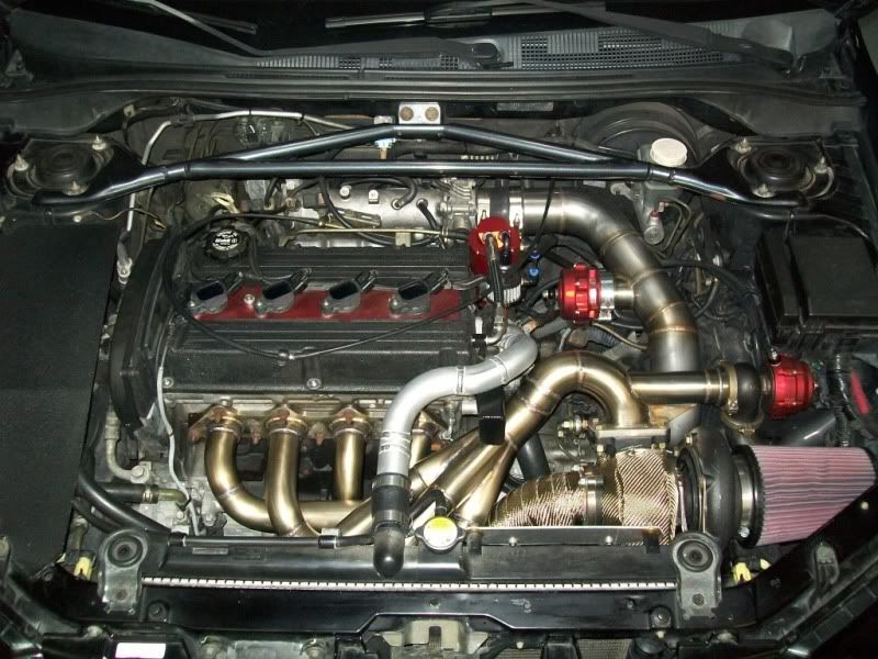

Hey guys this is my first dsm/Evo car always been into nissans. bought the car with a couple of upgrades nothing major. Then started to rip some factory and after market parts off.
A good friend of mine that i work with took some time with me and spent a weekend in his garage and come up with this.

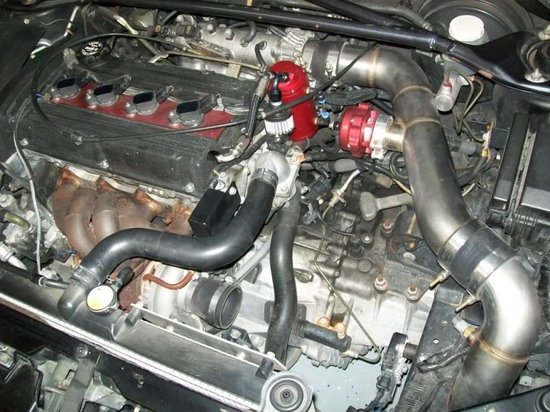

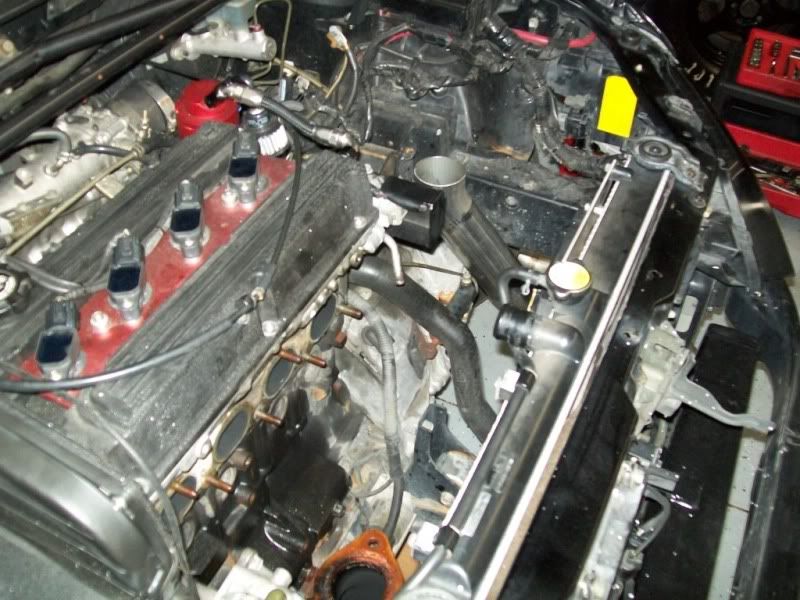

Well now since we have everything out this is where the fun begins.

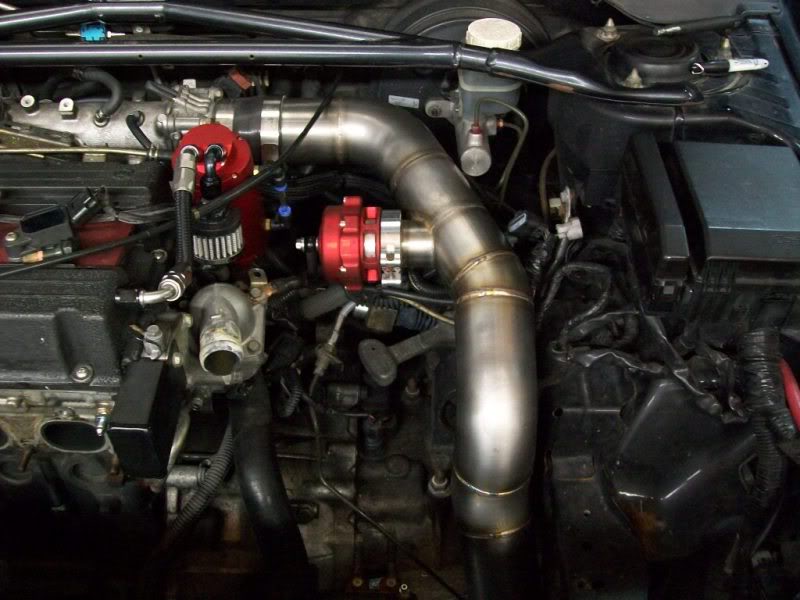

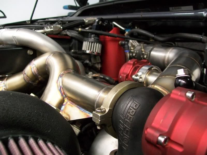

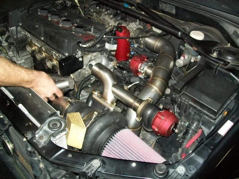

we had to remake the intercooler pipe to make room for air filter.

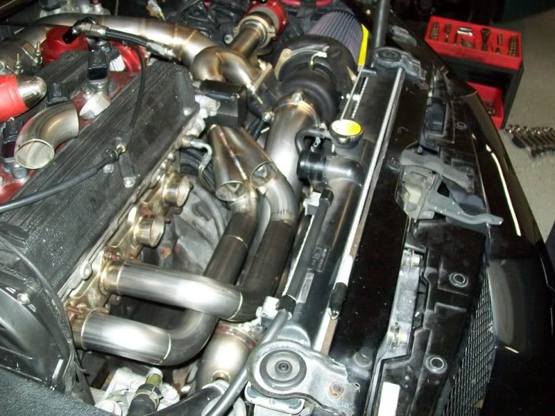

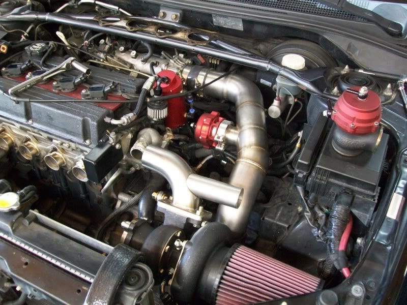

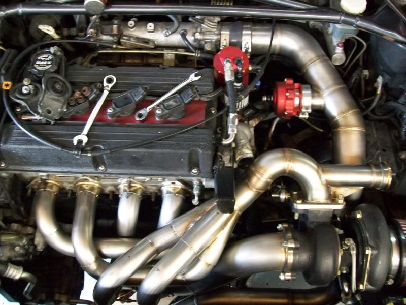

Then we started to locate the GT3582.
Locating wastegate placement.

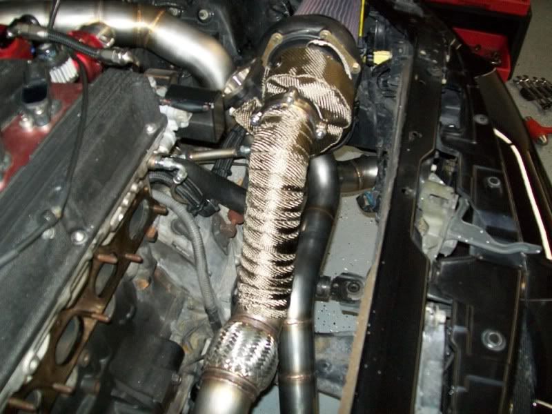

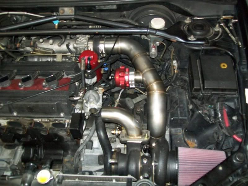

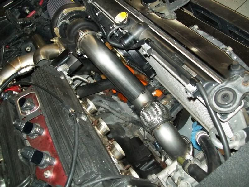

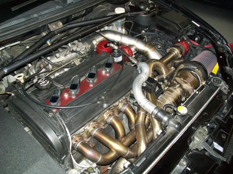

Then we connected the 3 inch downpipe to the existing one that we had to modify.

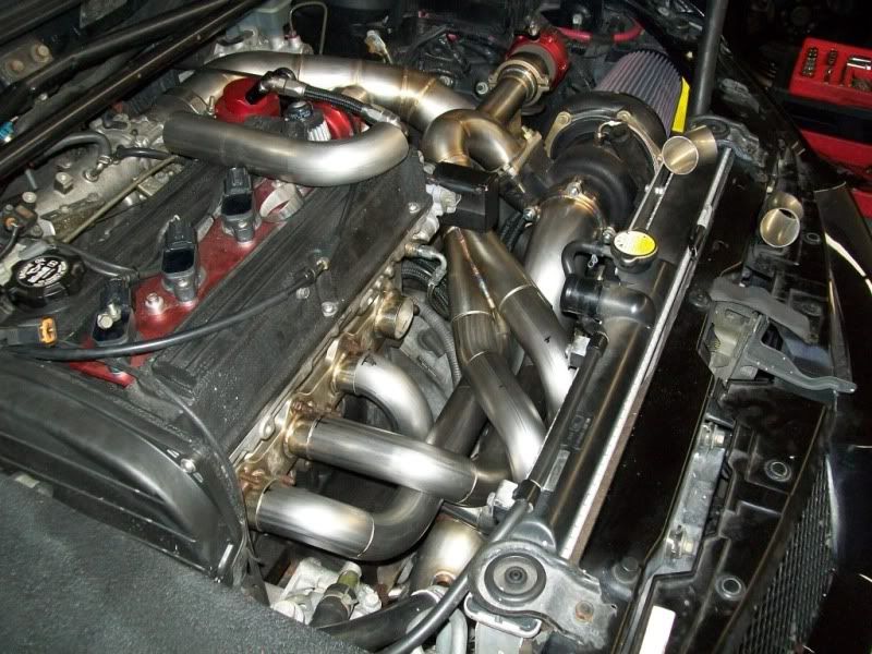

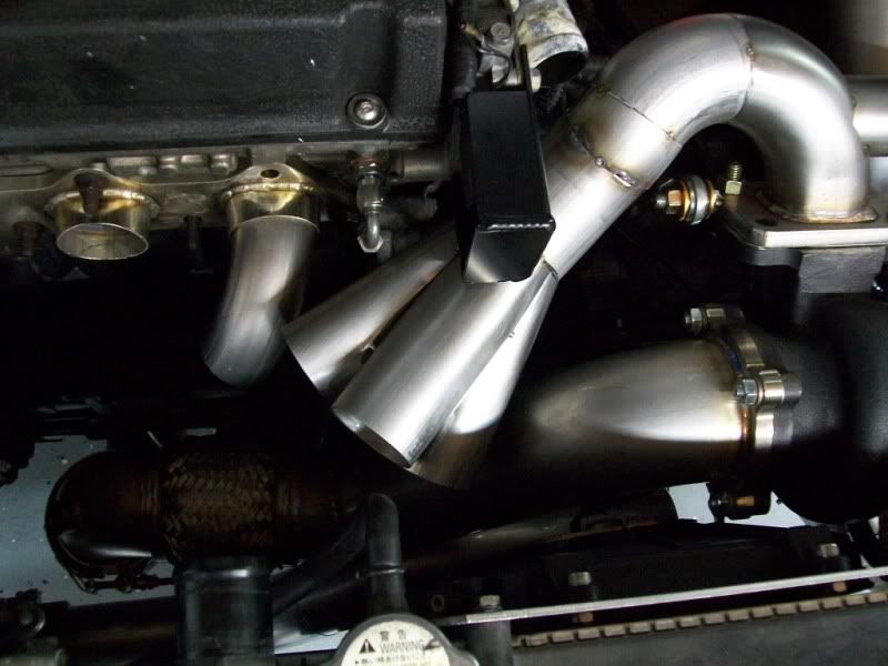

Now we have the downpipe in. Time to start the secondary to the runners.

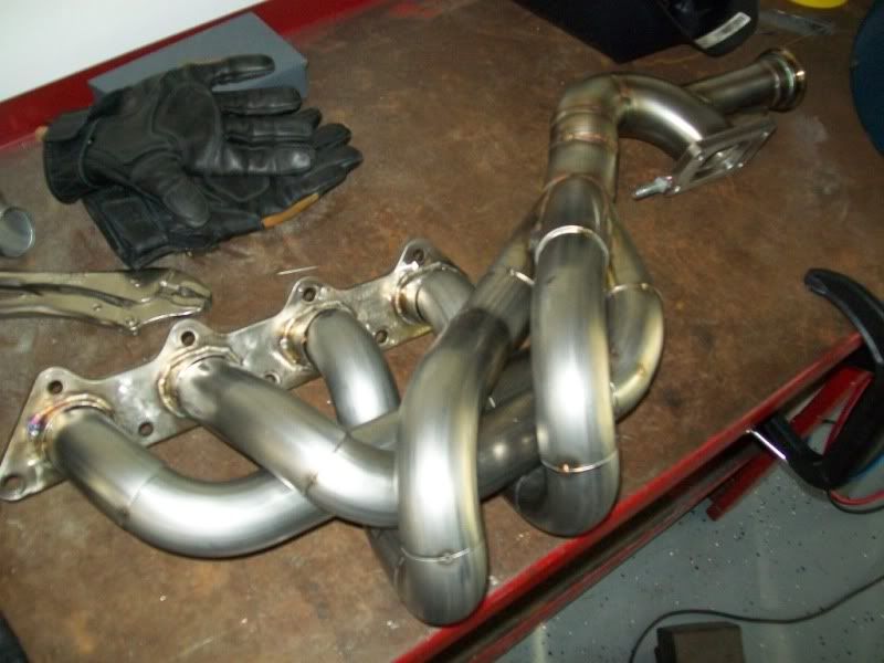

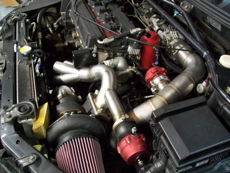

Here we ended up making the collector our selves saved alot of money but damn what a pain.

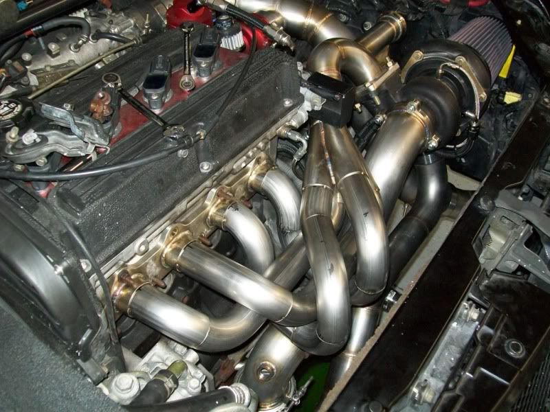

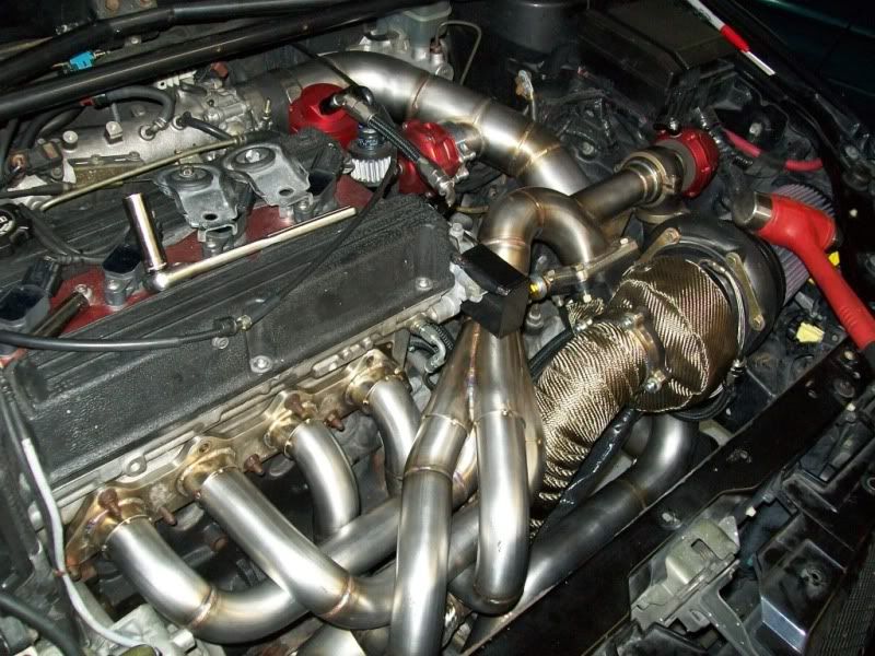

Time to start tacking the runners.

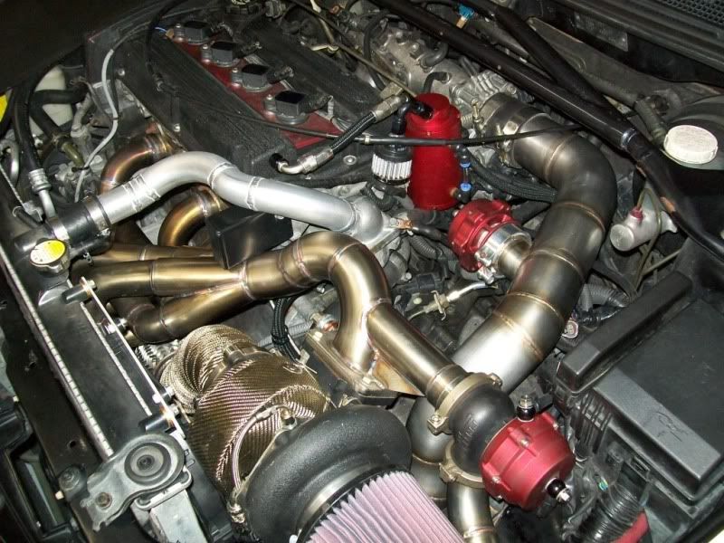

Time to weld it all up.

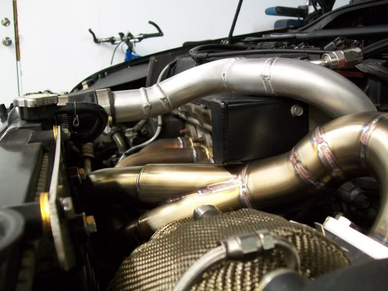

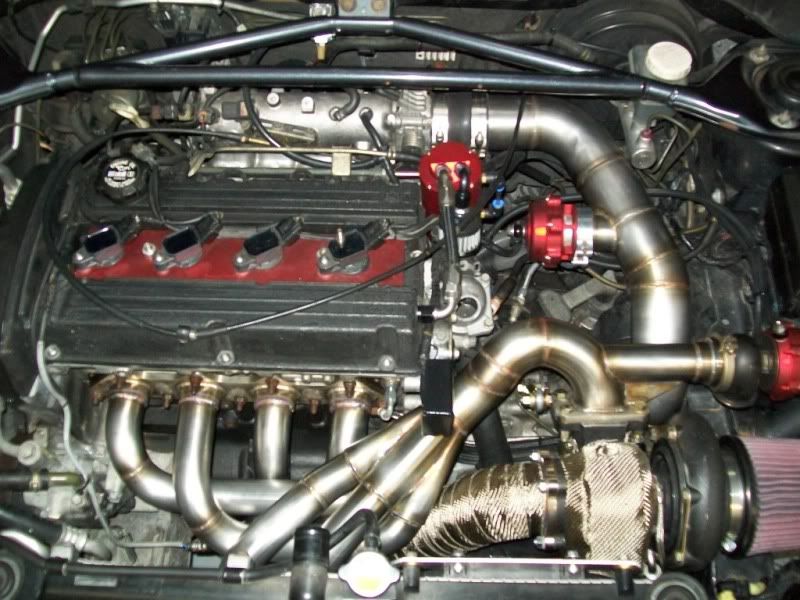

will it was cooling down took some dei wrap and wrapped the downpipe and used a dei turbo blanket.
Was a long weekend but we managed to get it done.
