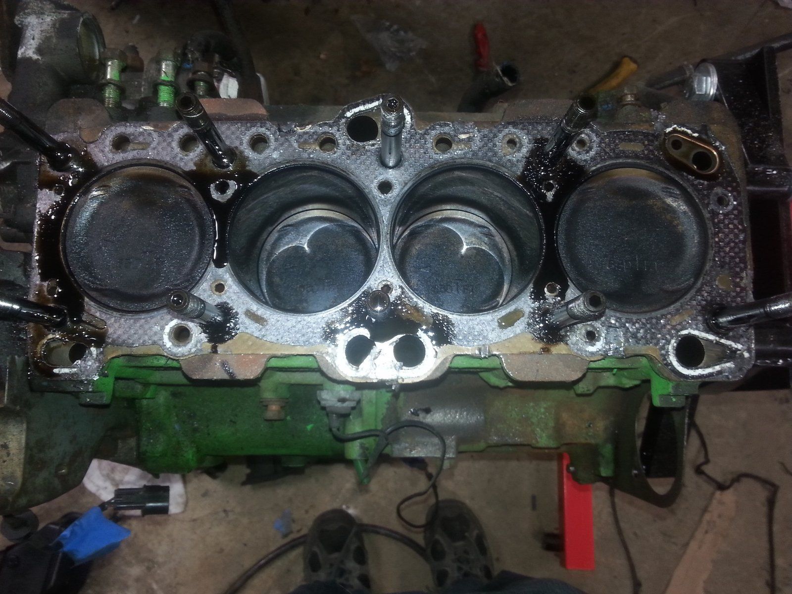

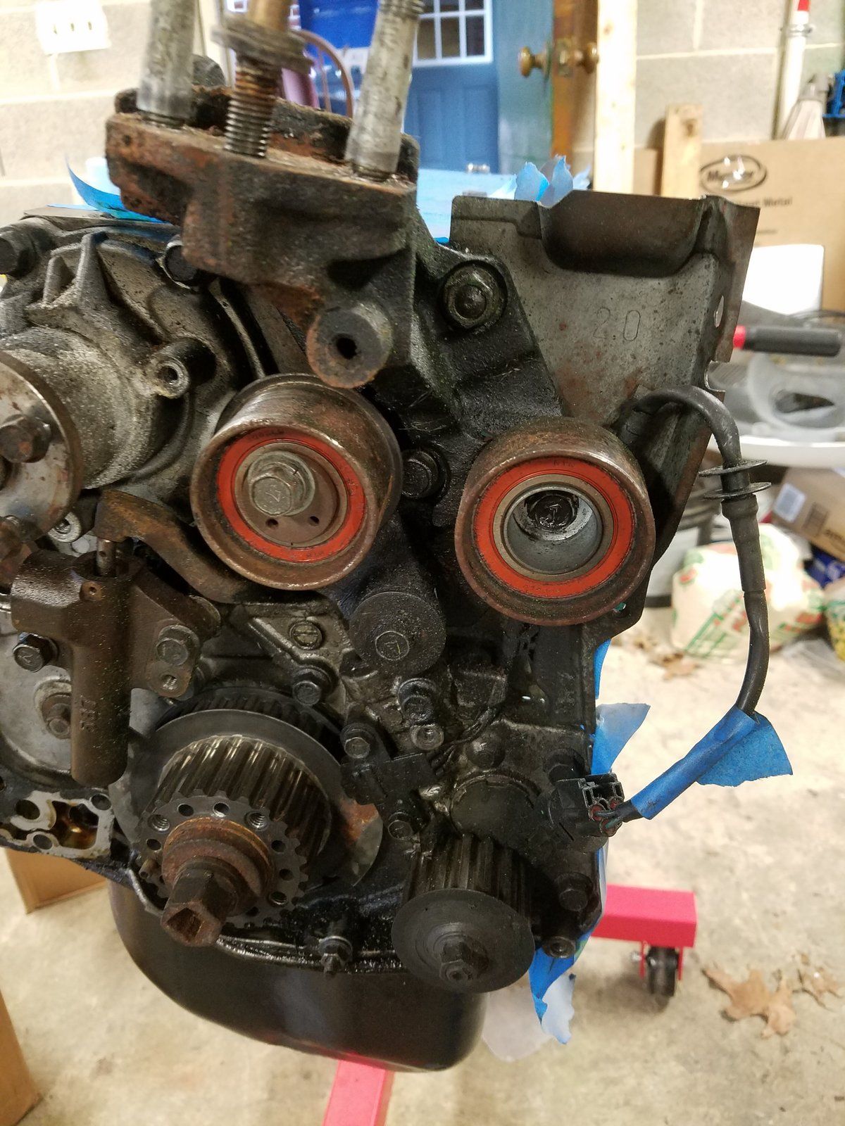

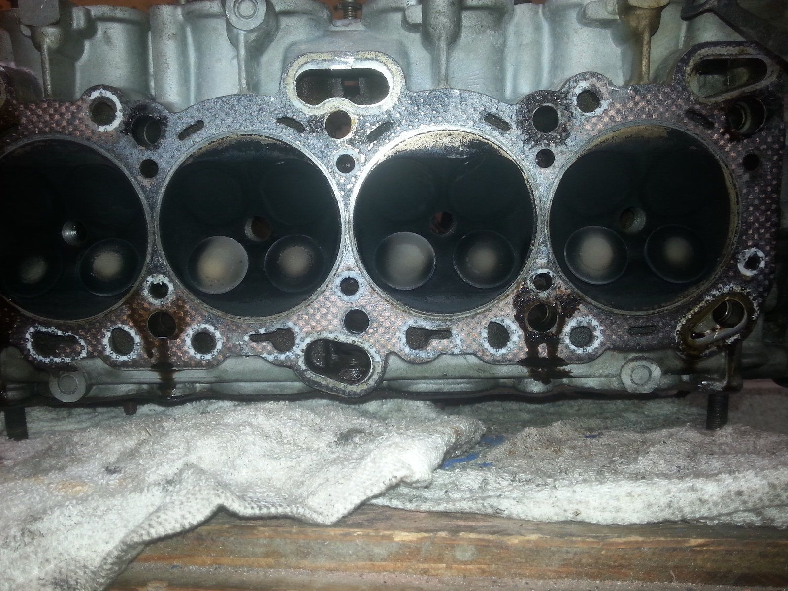

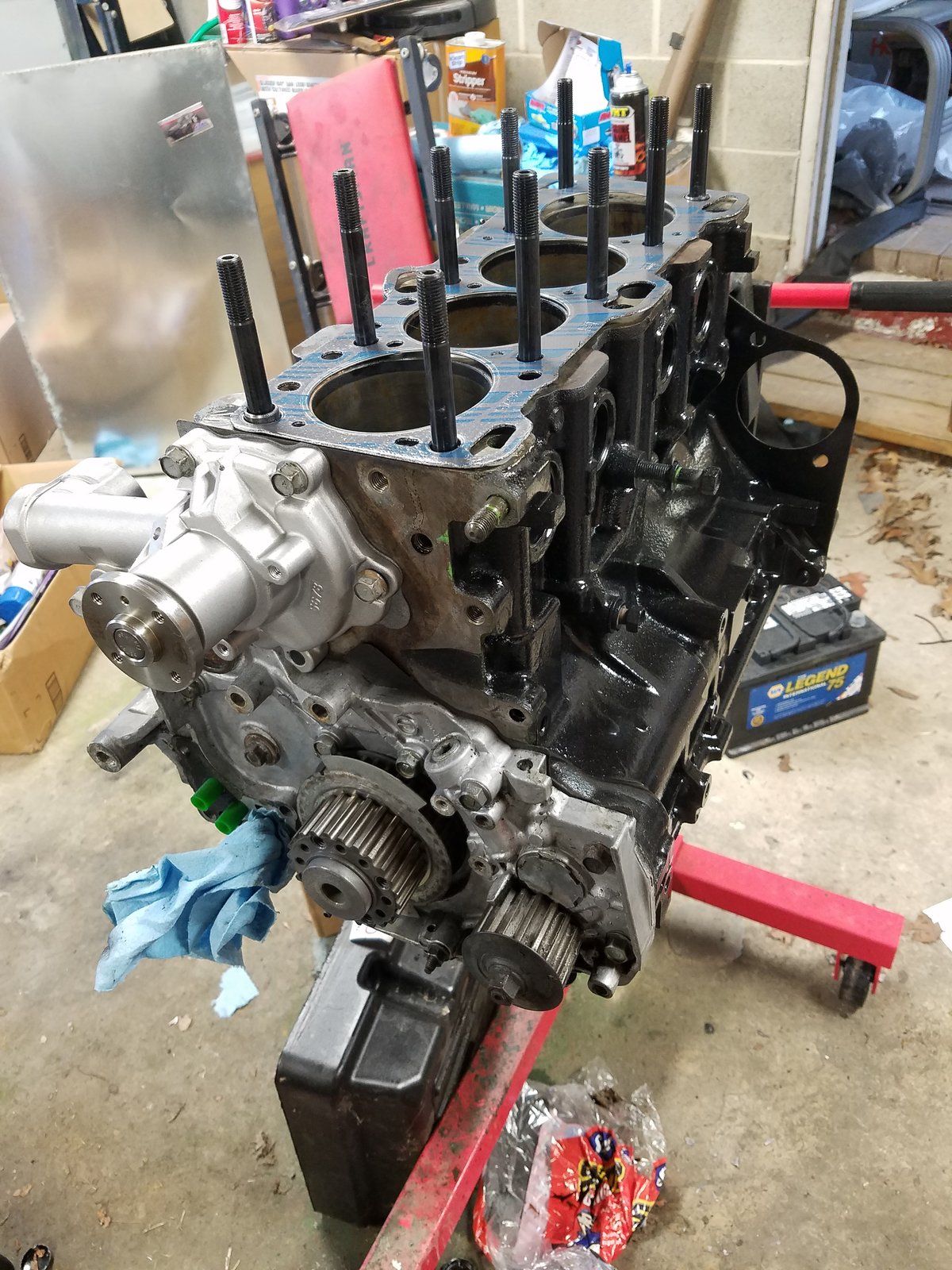

Was able to get some work done today. ARP head studs, Gates water pump, fel pro composite head gasket. Cleaned up the crank sprocket and front case.

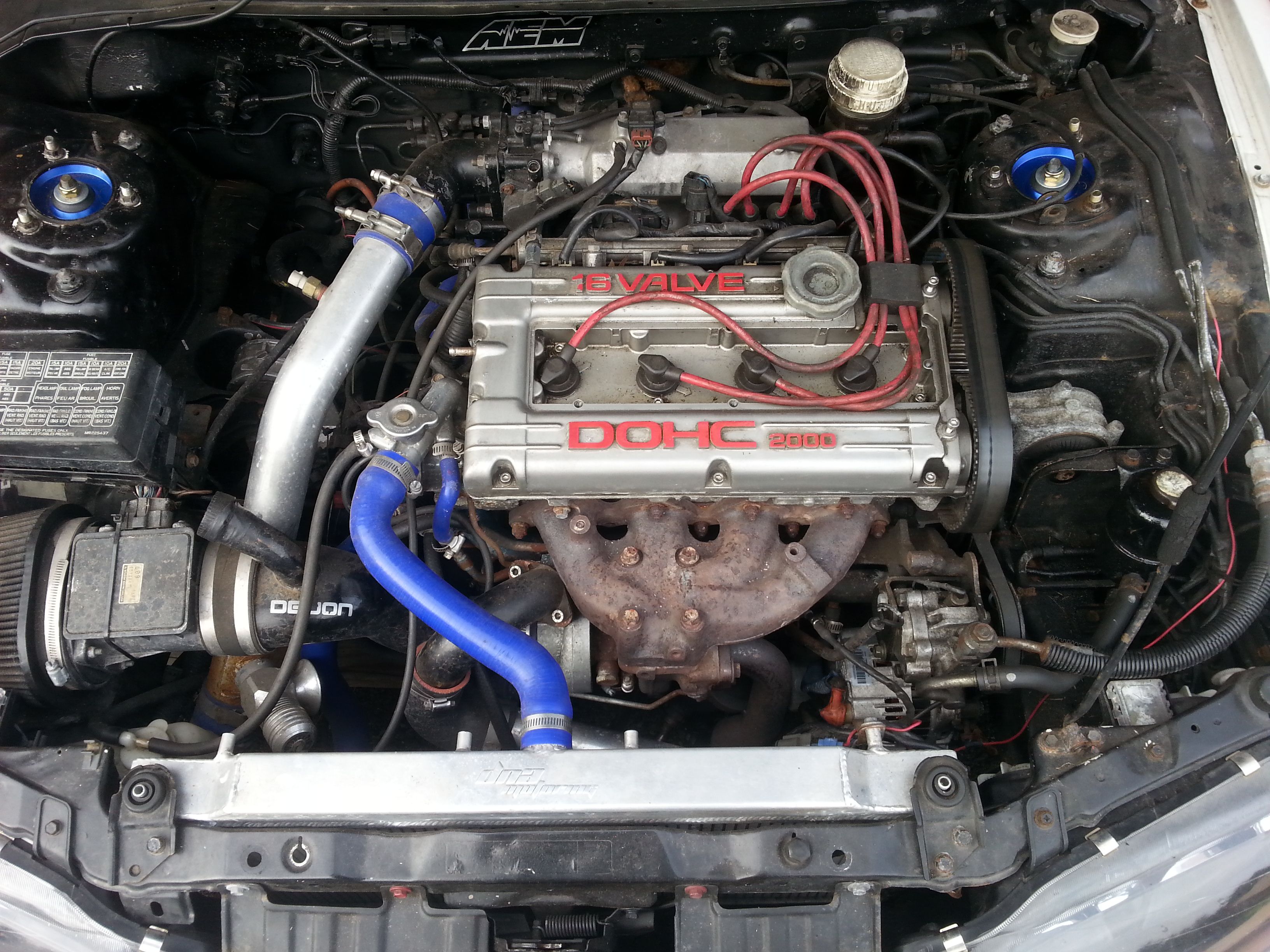

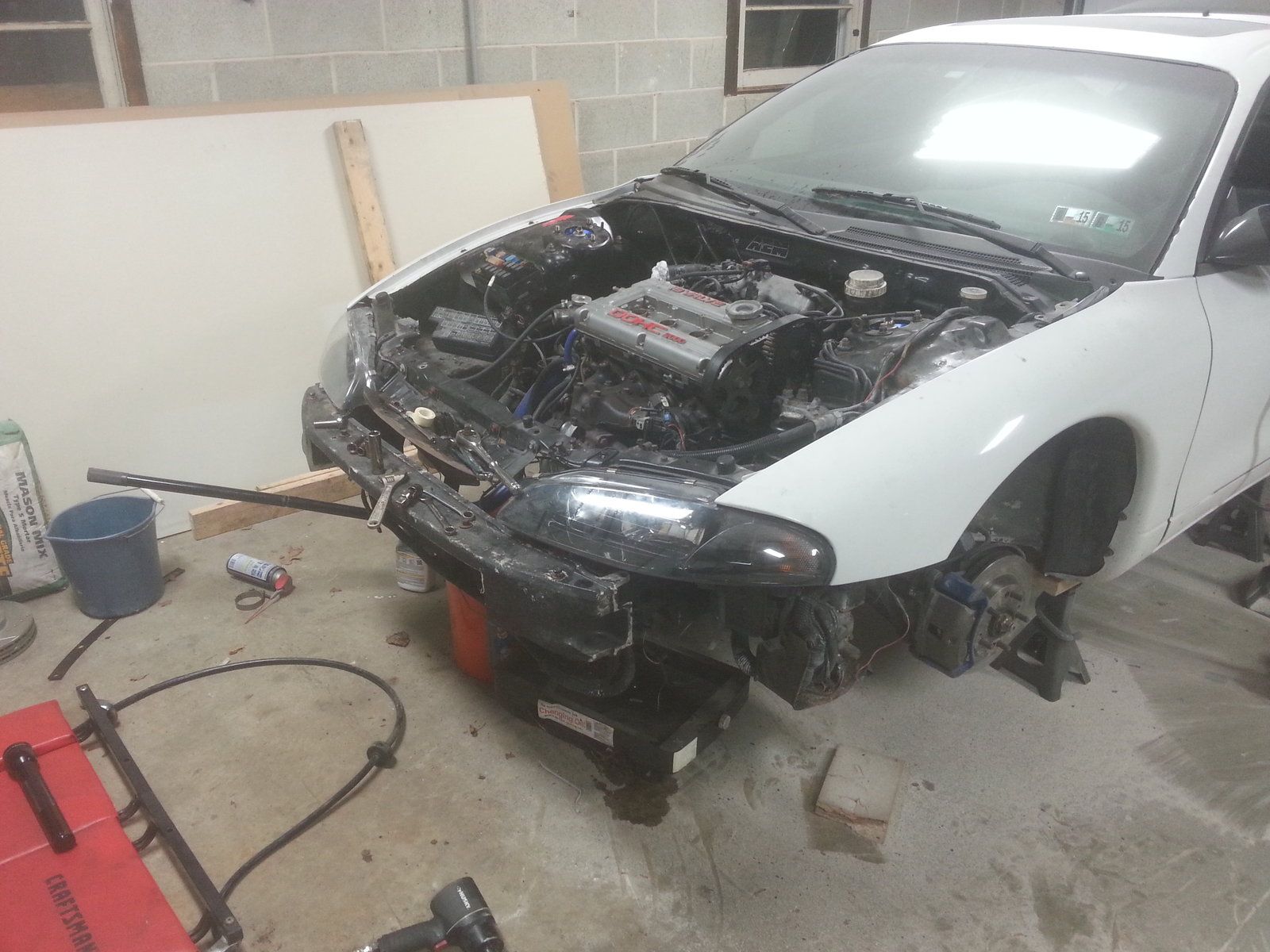

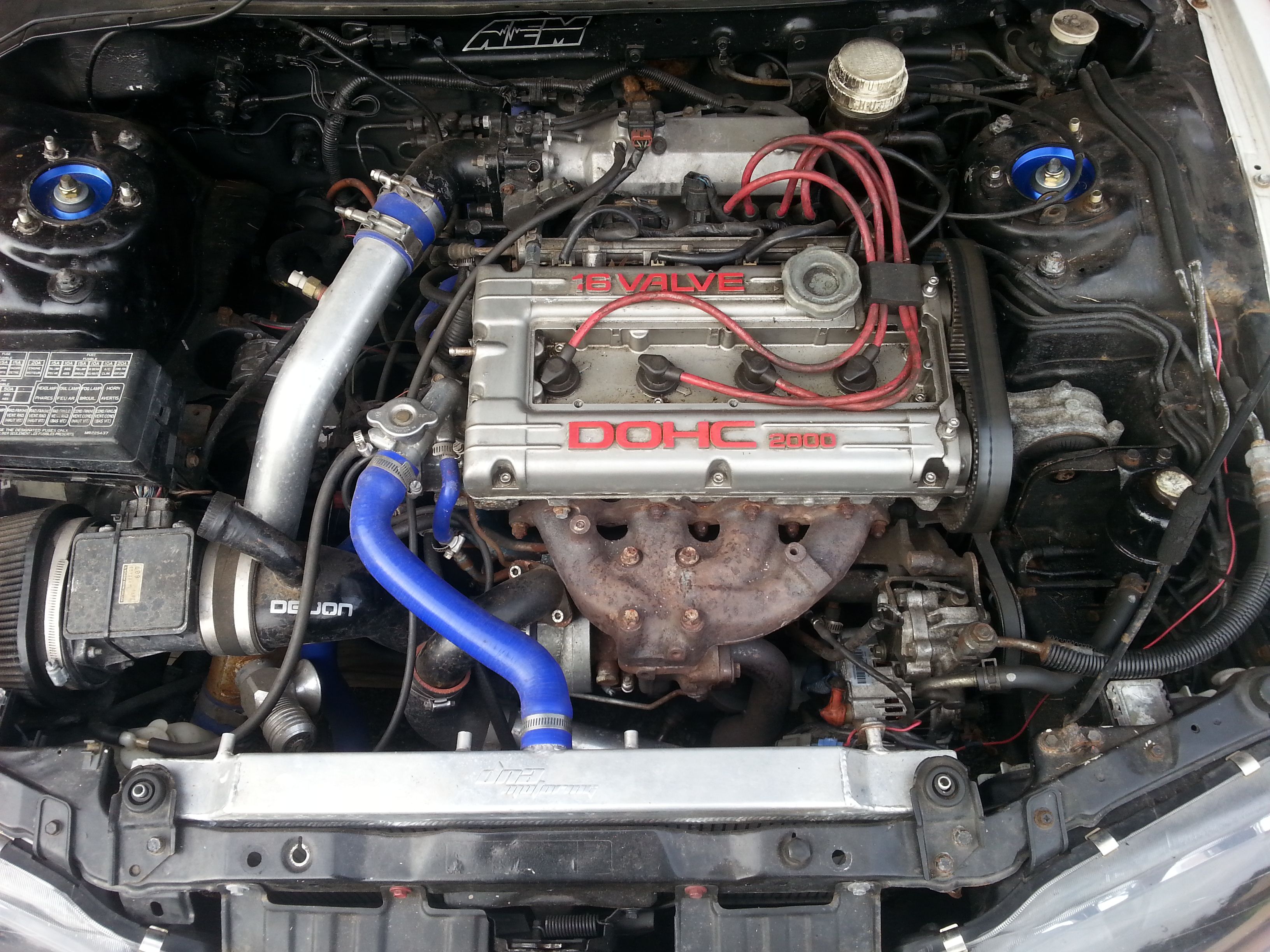

Two pictures of the engine before it started its make over.

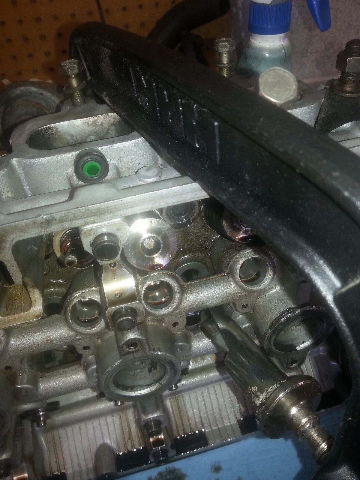

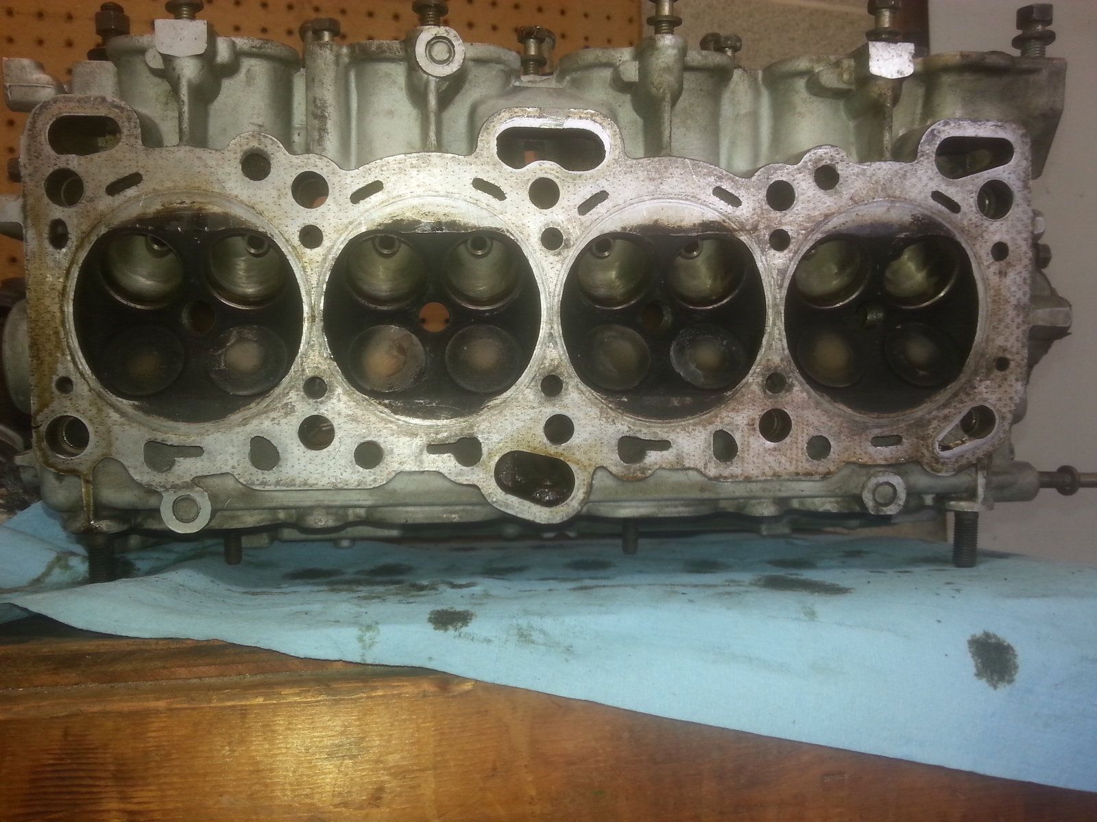

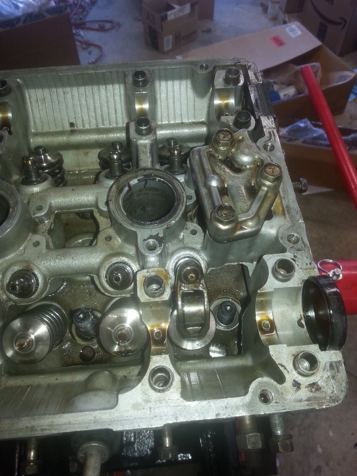

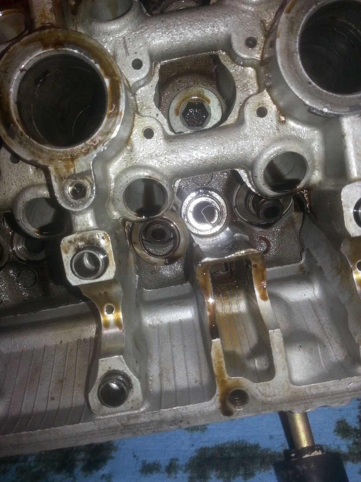

Yesterday was a busy day, I started work on the head. This will be getting new Stainless steel valves from ebay (engnblder), supertech single valve springs and retainers, and 3g revised lifters.
Cam towers and cams removed.
removed the lifters and worked on removing the keepers, springs and retainers. I used a home made tool of a 8" C clamp and a 5/8 deep socket with a window cut in it.
Removed the valves then pulled the old stem seals off.
End Result, intake valves out, rinse and repeat for the exhaust side.
Ready for oil port mod #1 and a good cleaning. End plans are for crower 264/264 cams and fidanza adjustable cam gears to complete the head rebuild.

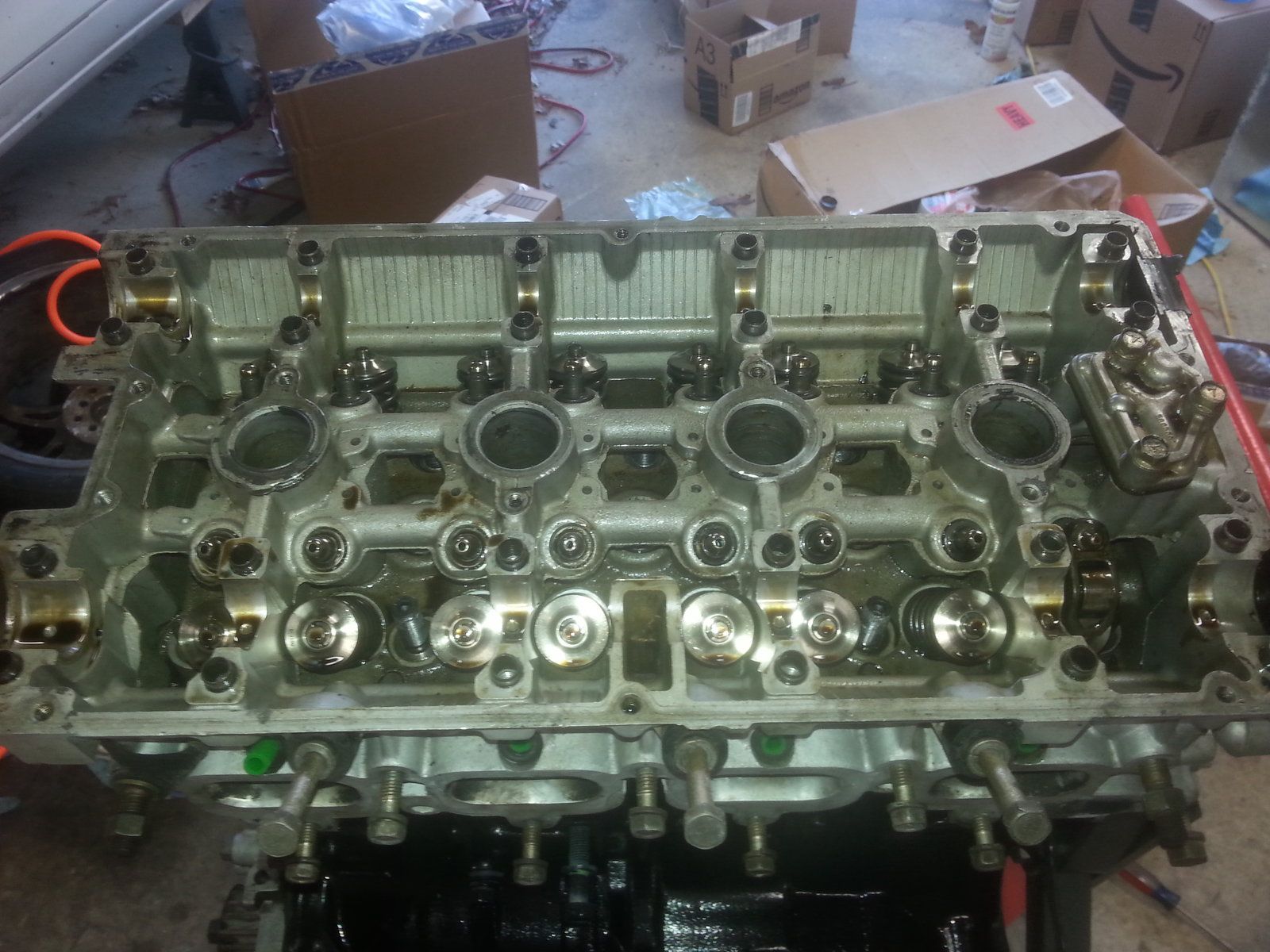

Well I have made some progress since my last update. I rebuilt my head with supertech single springs and titanium retainers, revised lifters, a set of stainless steel valves, new valve stem seals, and crower 264/264 cams. I was installing the Cam caps and I stripped out one of the bolt holes, so I ordered a time-sert set to repair the bolt hole. I also bought a pair of fadanza adjustable cam gears. The head is mounted on the block with a new felpro composite head gasket and arp studs. I also ordered myself a inch pound torque wrench so I can get the lower value bolts to the right specs.
Once the bolt hole is fixed i'm going to get everything torqued down to spec and how well my cams move in the journals. If everything is good I'll install the rockers, cams and torque everything down to spec and move on to the timing belt.

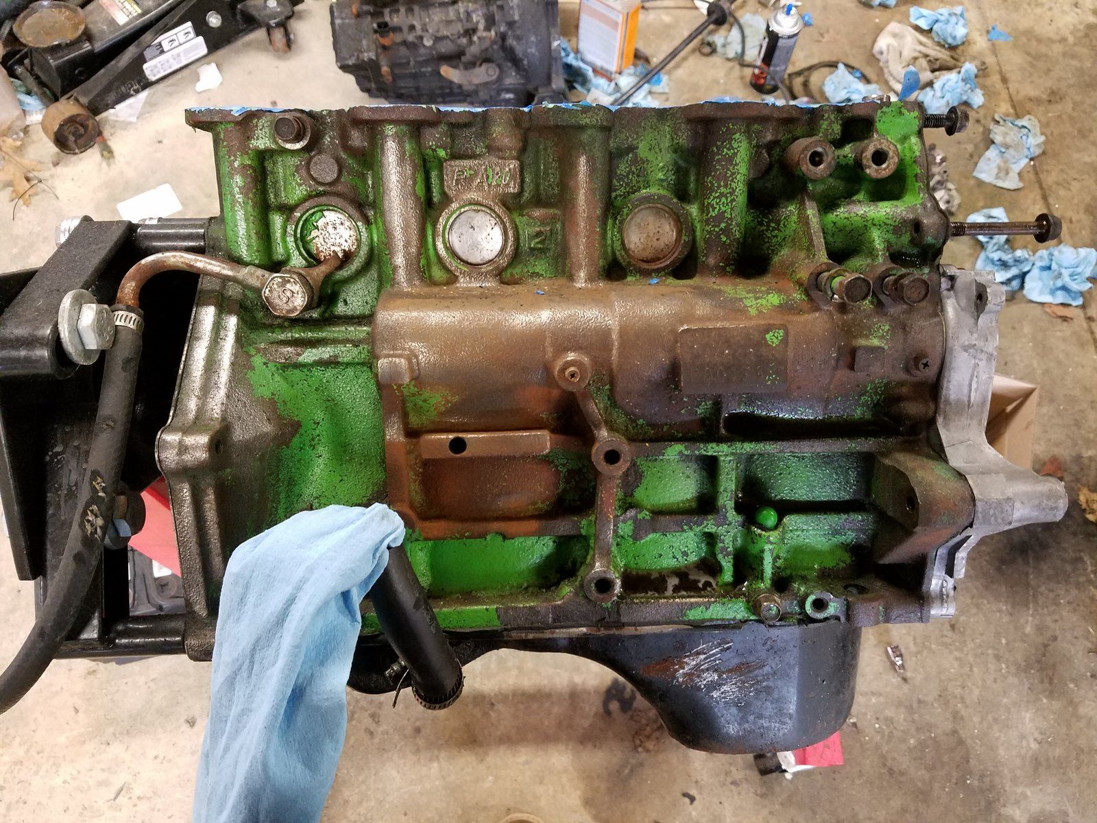

Wow, i've been so busy with work and haven't even had time to think of working on this. Things are finally starting to slow down at work, so I have some more time at home now. I was wondering, should I go ahead and replace the oil pump while I have the engine out, the car has about 120k miles on it.
