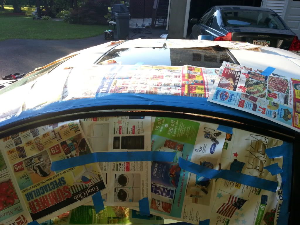

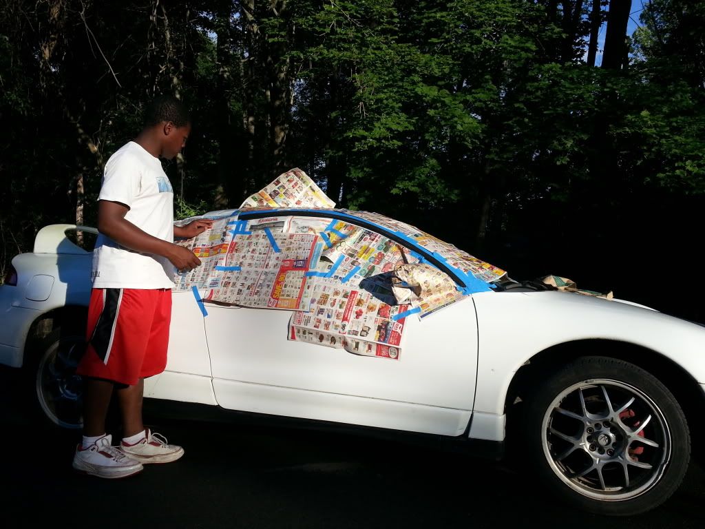

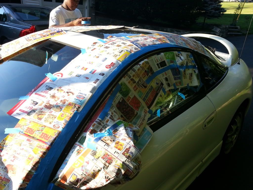

I'm absolute Plasti Dip fiend, I redid the gray trim around the car and the rain guards. Looks great.
Shout out for my friend Jonel in the picture for helping me.
This is how it looks today. (All pictures taken with my amazing Samsung Galaxy S3)

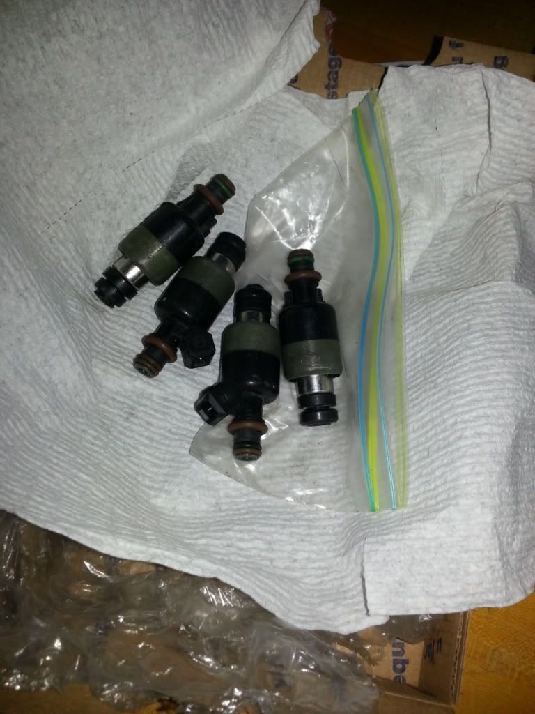

PTE 780cc injectors - one needs new seals

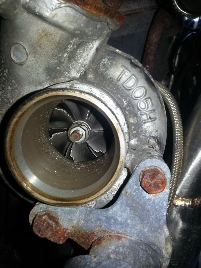

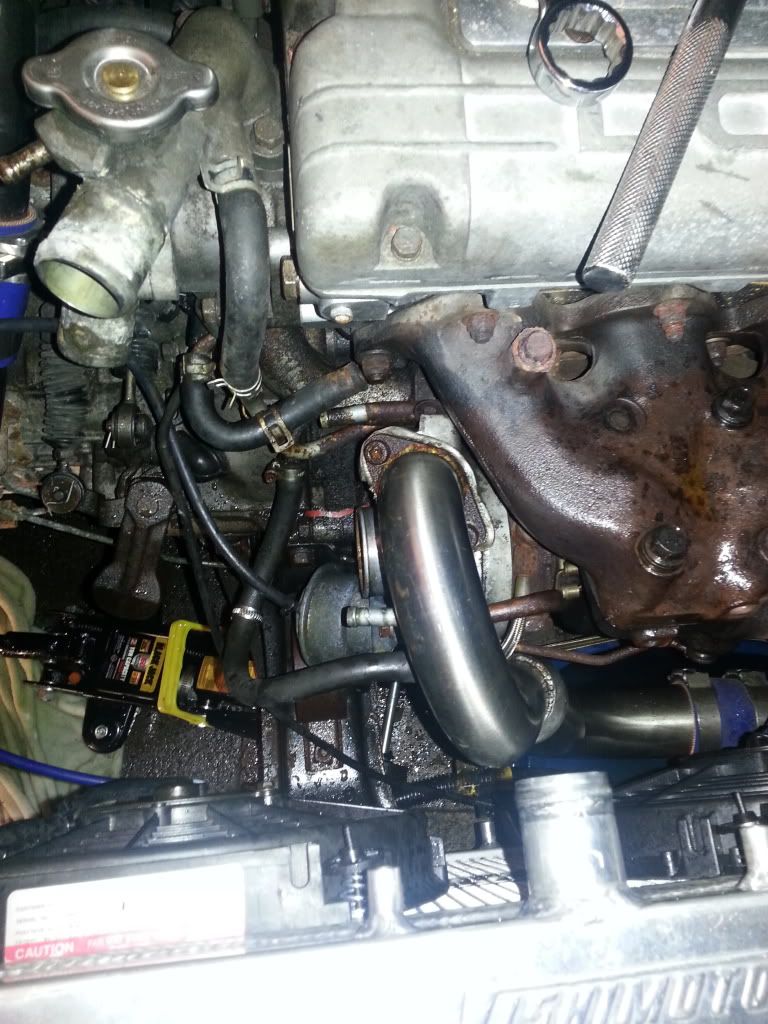

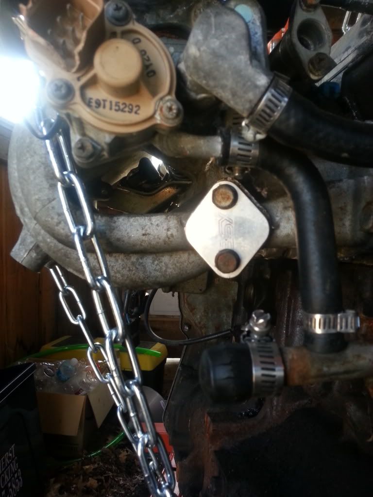

Started taking stuff apart and found this
So im deciding to put in the 14b turbo in until i can buy 20g bastard kit. While I was taking the turbo bolts 2 snapped. I soaked them in PB blaster and will attack again tomorrow. Thats all for today. Stayed tuned for daily updates!

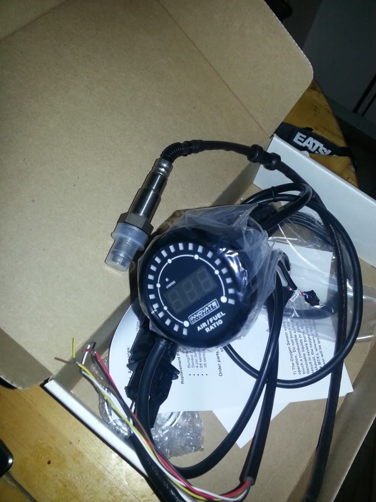

Innovate MTX-L came in

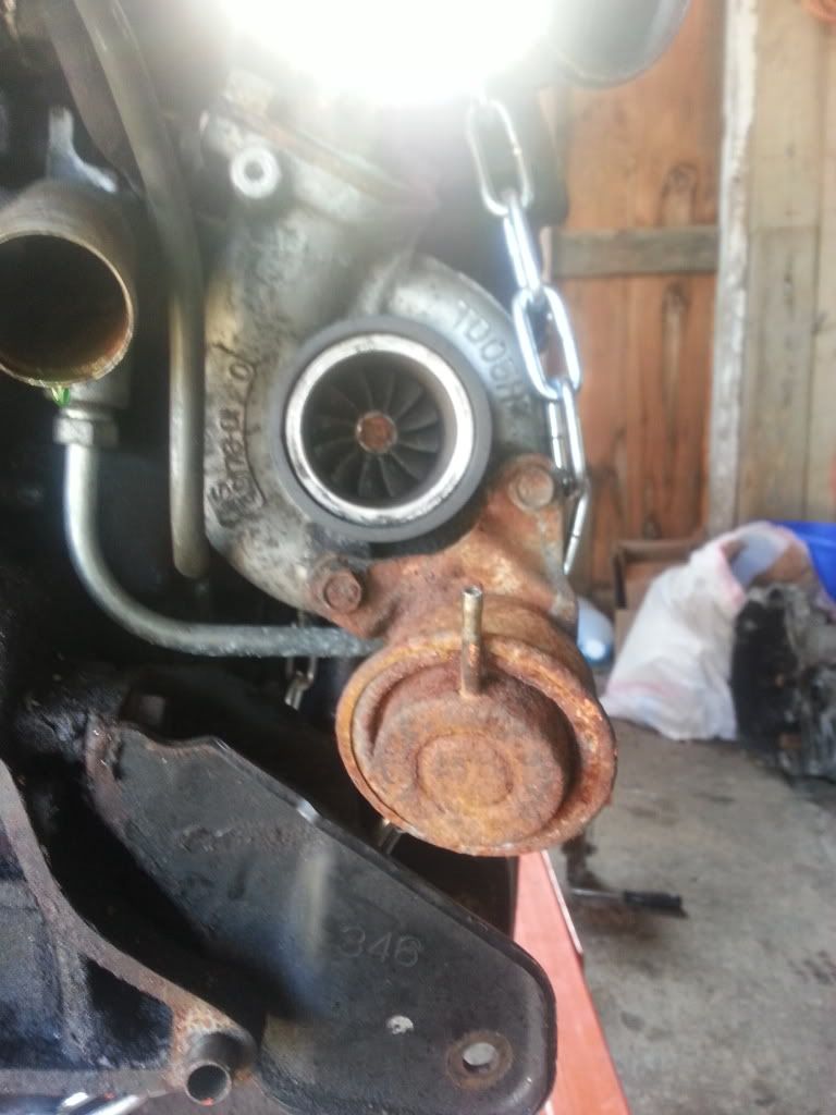

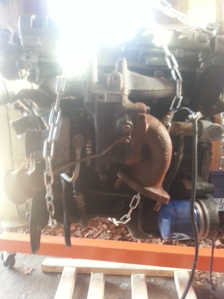

Working on pulling this turbo. Allen bolt are stuck and I think i need a socket allen wrench tool. Oil drain and feed needs to be removed. I soaked everything in PB Blaster, going let it soak overnight.
I will attempt to remove the turbo tomorrow it its not coming out easily, I will continue removing the entire engine and will deal with it later. Like I said before I will throw the 14B on for now until I can rebuild turbo with 20g compressor wheel etc.

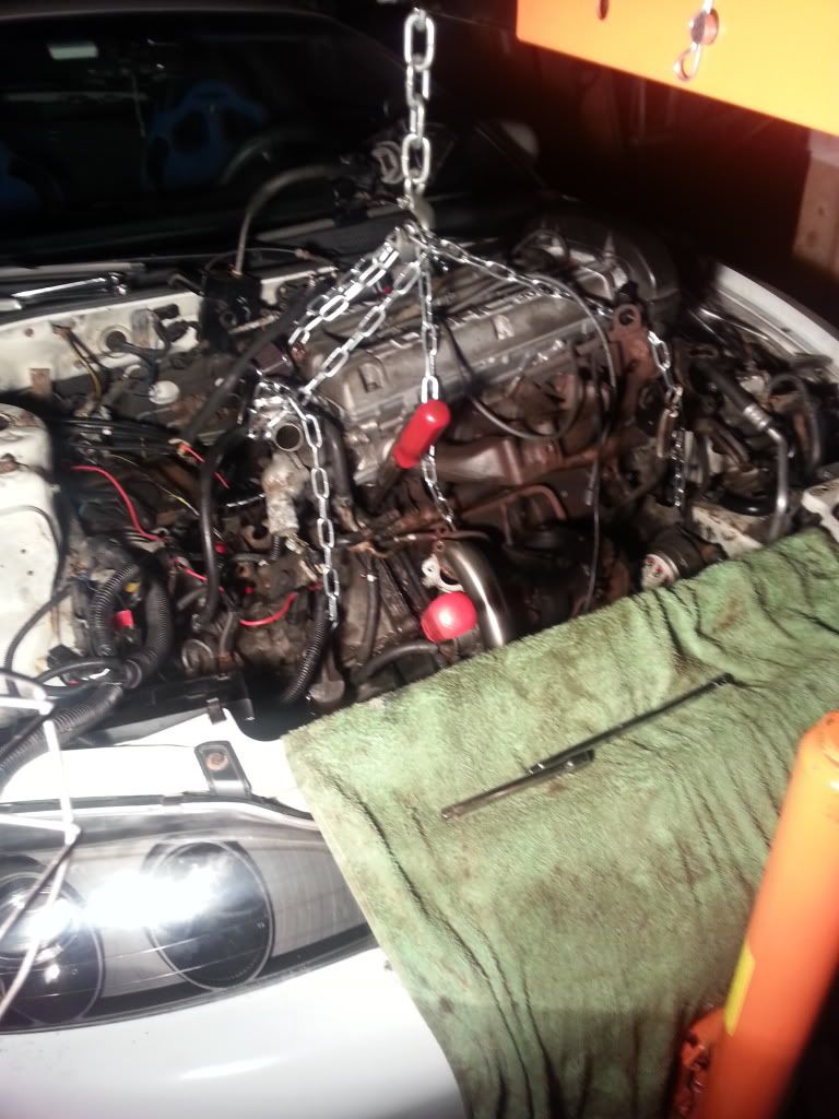

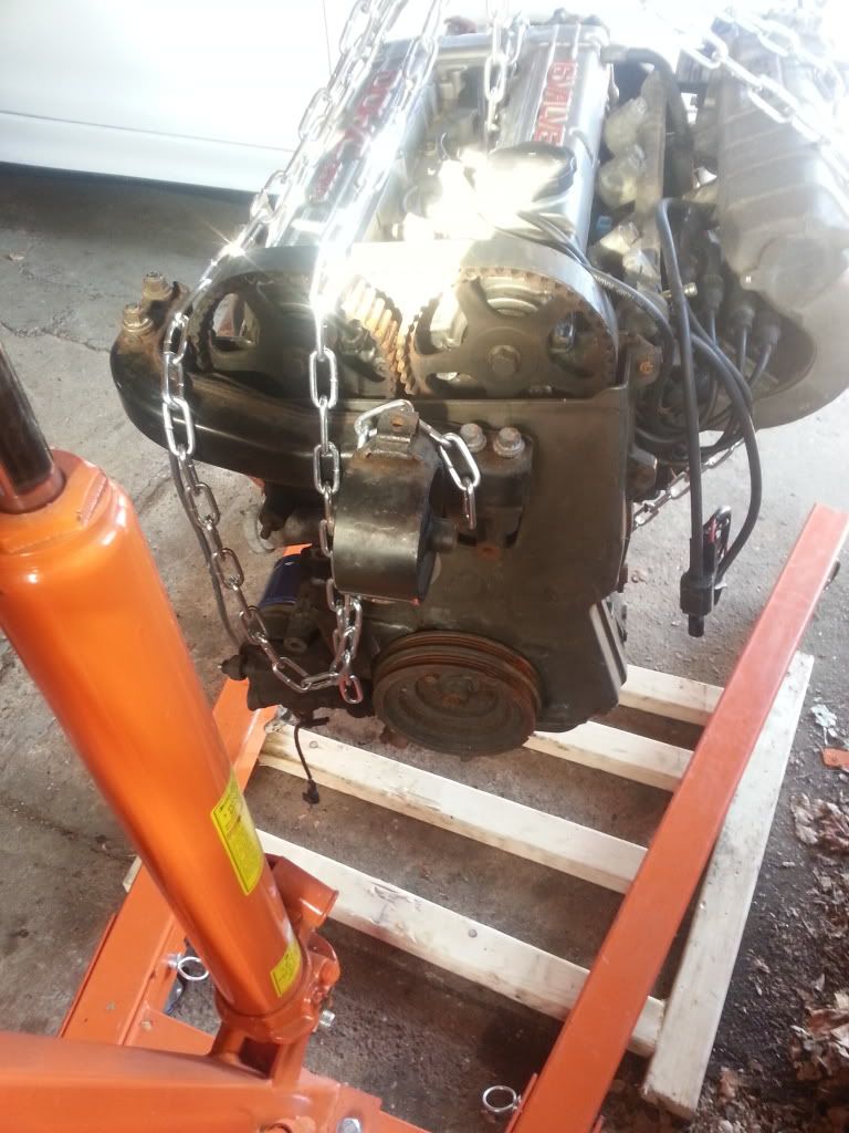

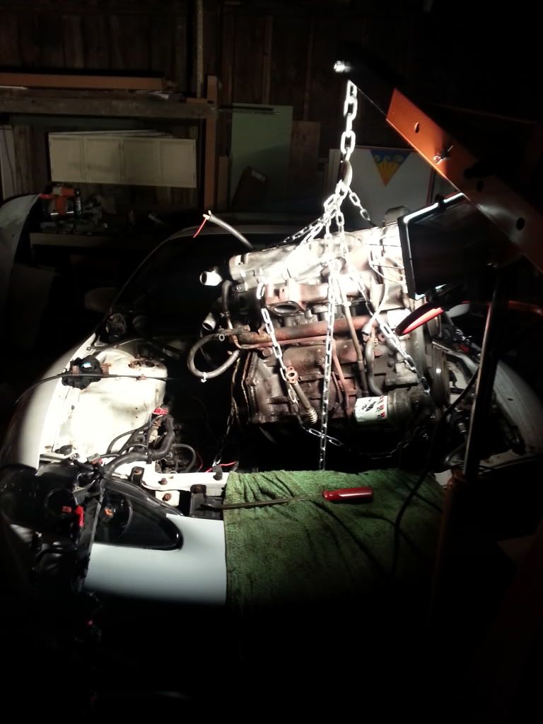

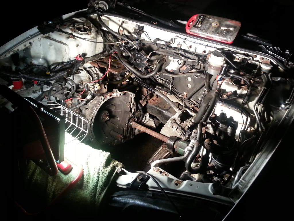

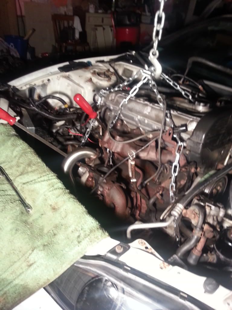

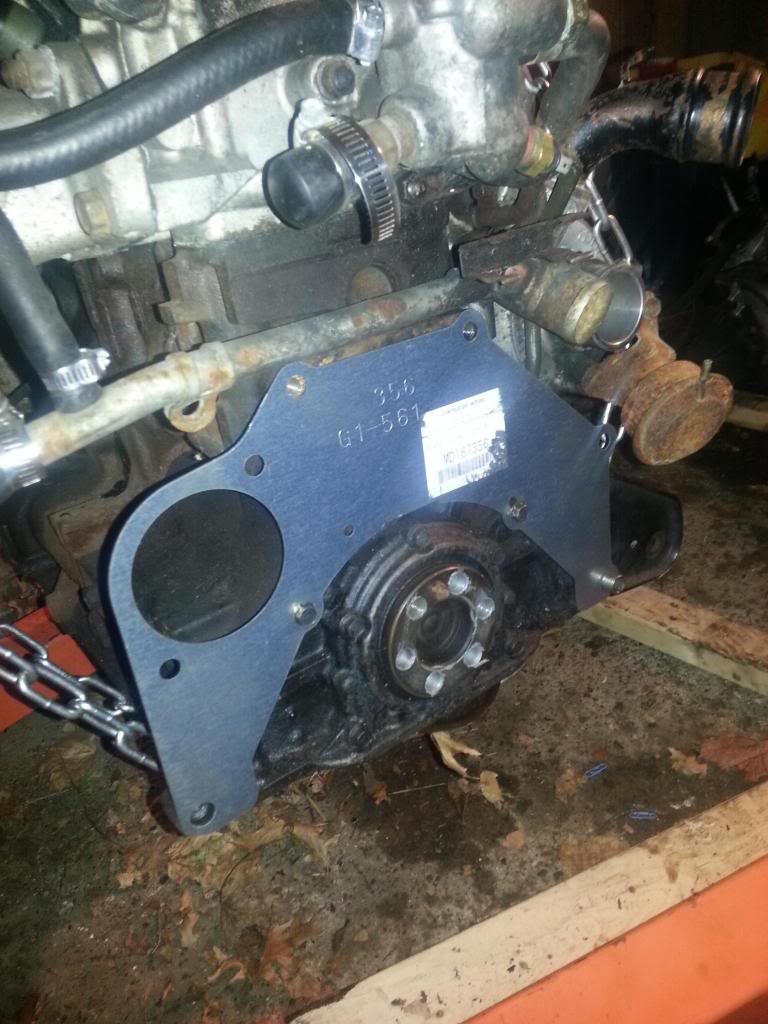

No pics (been getting lazy) Got more stuff disconnected. My order went thru RRE, gettin more goodies in the mail next week. Im hoping to have the engine out by Sunday the latest so I have ample time to install 6bolt and troubleshoot (Theres always problems, nothing is ever easy with my car)

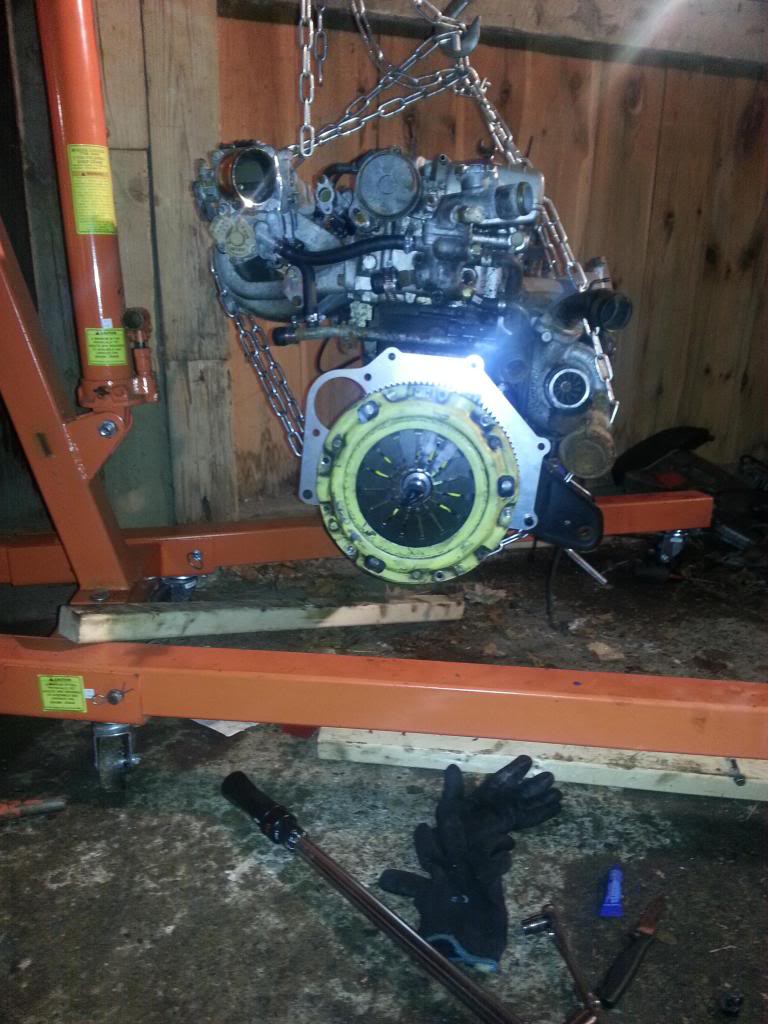

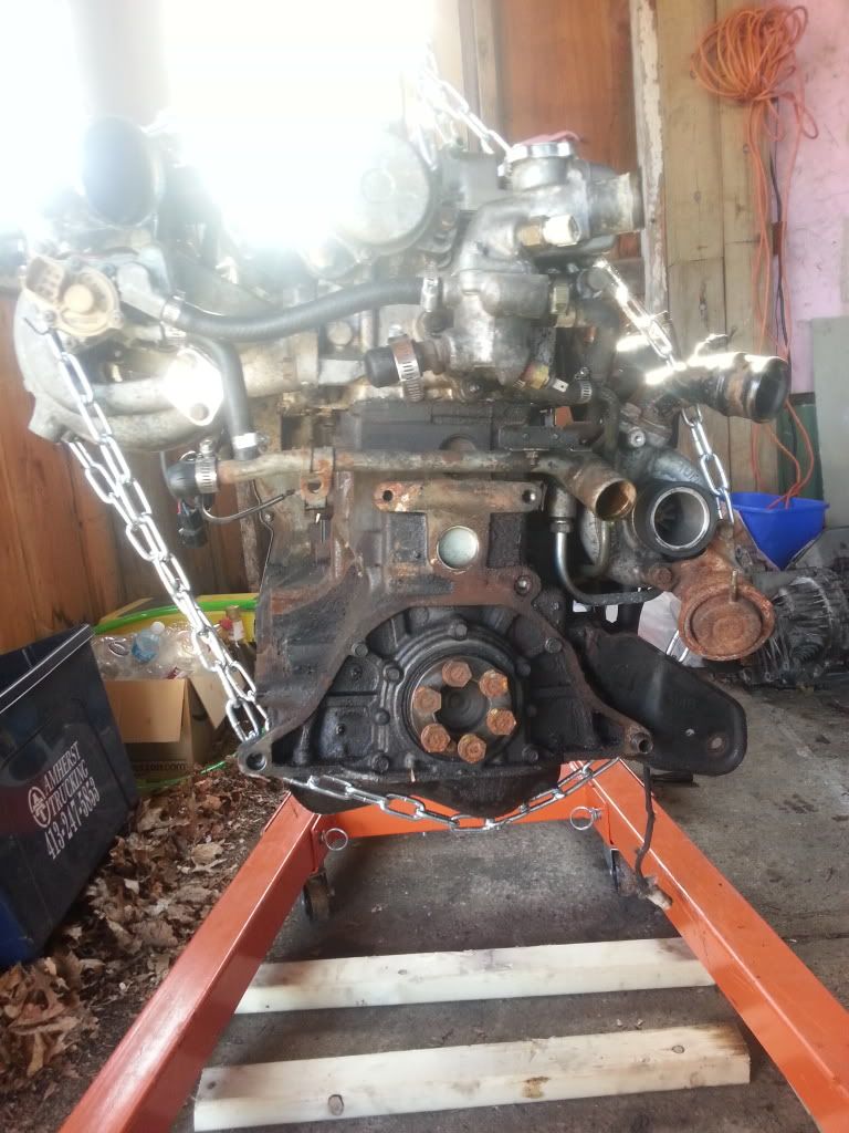

Big update. GOT THE ENGINE OUT!

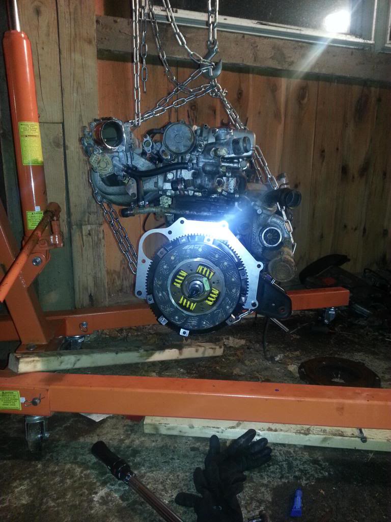

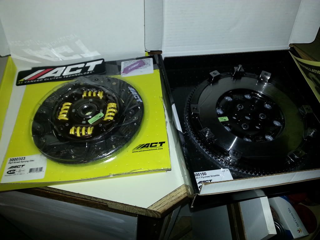

ACT Street Disc and ACT Streetlite Flywheel came in

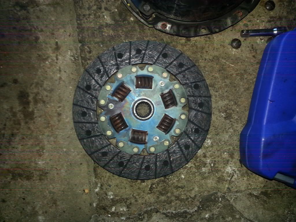

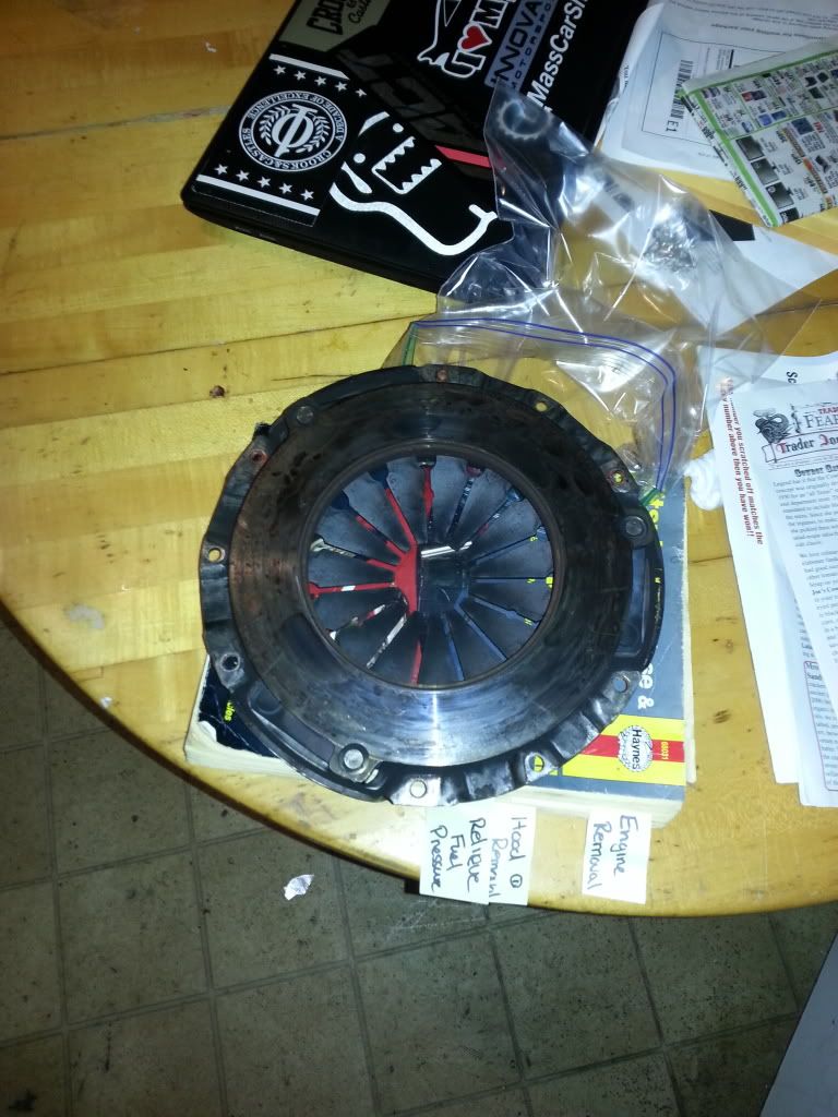

Old Clutch/Flywheel/Pressure Plate
Im going to reuse the PP, sand it down a bit.

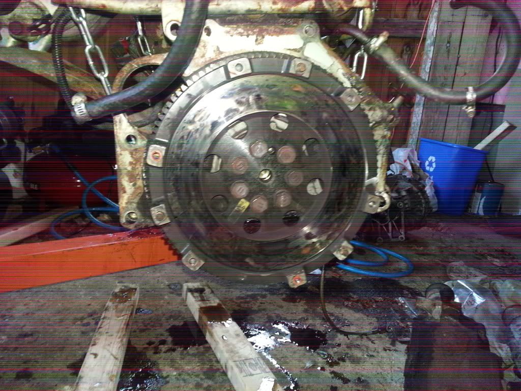

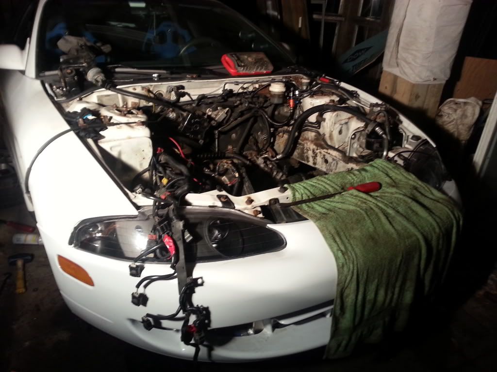

-Got O2 Housing off DP
-Timed the car
-Installed Starter,flywhee;, clutch and pressure plate.
almost there! pic time
