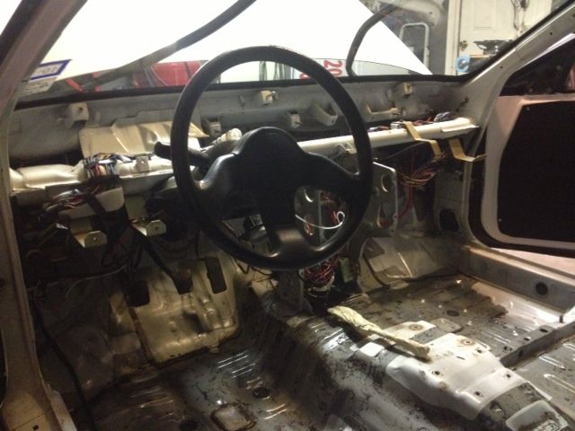

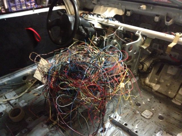

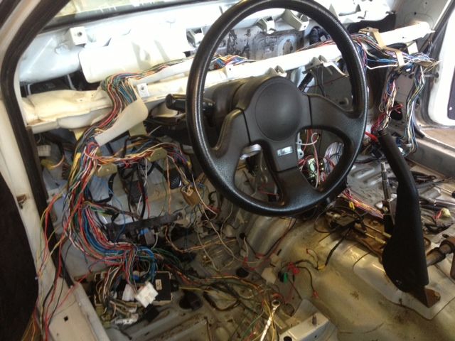

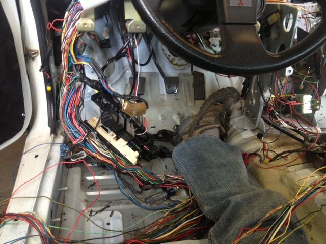

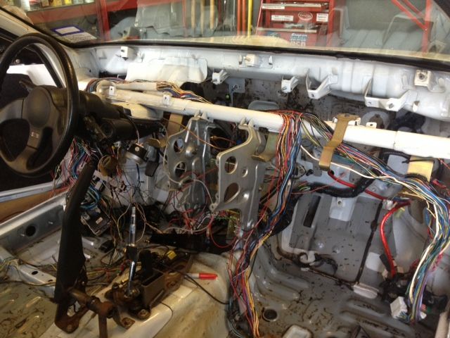

Yesterday I decided to remove the automatic seat belts and start tackling the interior wiring harness. I got a lot more of the harness done today. Basically I am removing every wire, from pin to pin, that went into the doors, to the seat belts, to the radio/speakers, to the AC/HVAC system, front and rear wipers, etc. It is a mess right now but it has to get worse before it can get better.
After the wiring is done I am going to finish stripping out the last bits of the sound deadening from below the center console and behind the dash areas, prep it for paint and spay all of the interior white, and by then I should have my summit race seat and 5 point harness to reinstall. As of right now I will be reinstalling the front carpet, center console, and my lightened dash.

Removing the old plastic wire loom and that yellow plastic wrap sucks, the interior harness shouldn't be as bad because it's not exposed to the elements but it's still over 20yrs old. Are you doing it with it still installed on the car or are you pulling it too?

It's partially removed. I have room to work on it but I'm not pulling it all of the way out. The pile of wires is growing and I will weigh it when I'm done.

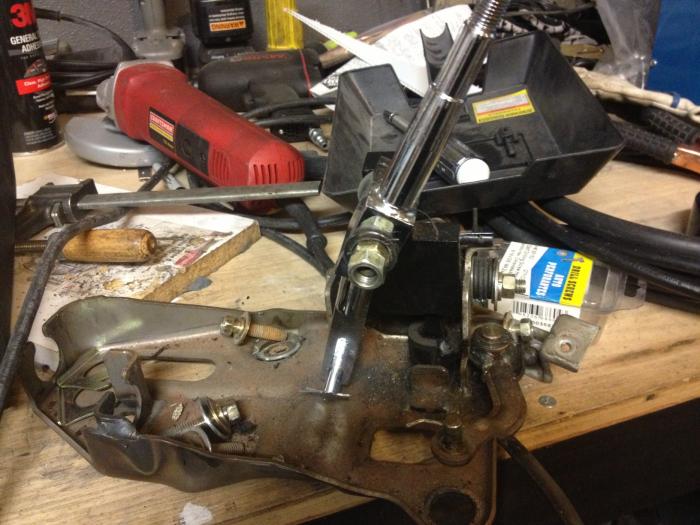

Is that a short throw shifter I spy there as well? Do you have any sort of stopper on it?
Good eye, it's a Fidanza short throw shifter I installed many, many years ago.

Don't mean to steer this off topic, but do you have any sort of stopper on that thing? I ran a fidanza like that years ago until I overextended a few shifts and trashed 2 transmissions by breaking shift forks due to having no stopper. Just a thought! I'd hate to see anyone else go through what I did.
No, I just installed it as it came. I've had it on there for a good 8 or 9 years, daily driving, drag racing, autoxing, and road course racing. So far no issues. Here is a close up picture:

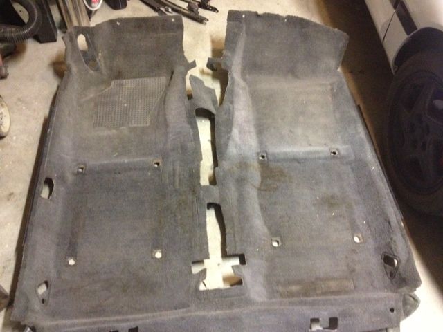

I also was planning on deep cleaning the carpet and reinstalling it but now my wife is trying to talk me out of putting it back in. I'm going to have to do some thinking. Sure it will weigh less and will still look nice with the fresh paint but I was planning on carpet and console. :hmm:
