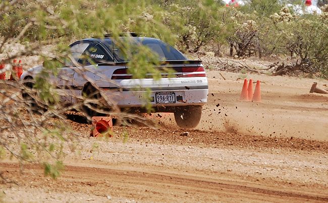

It was great seeing you and Becky again Nate, hopefully we'll be able to drive down to at least one more of these before the seasons up. Maybe I'll cover my car in blue painters tape and drive down and see how well I can do too. No dog next time. :D
You missed this one, too bad you were behind the tree when it happened. :cool:

It was great seeing you guys as well! I just washed the Eclipse today and it cleanup nice. I didn't see any damage to the paint at all. By the next event I should have some homemade mud flaps. Plus there was that C6 'vette racing. If he could do it I think your GSX would be alright!
Yeah Buddy! I got some air!!

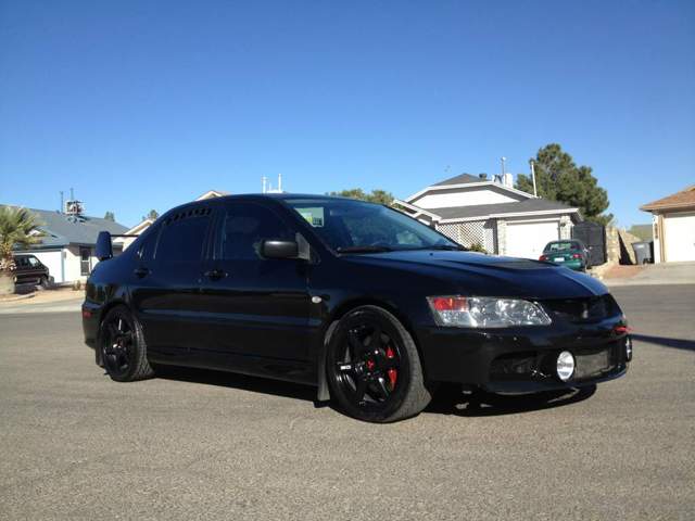

You got rid of it with less then a 1000 miles?!?!? Do you still own an Evo?
Missed this.
Yeah, I did. Wasn't a great decision, however, I would have most likely sold it by now anyway. My '05 SSL is gone too. As great as the Evo's are, I disliked it as a daily driver, and the blue was just too 'hey look at me.' So I let it go.
Cool vid too man!
Ahh man, you cleaned the hell out of that thing just to go beat it through the dirt!!
Missed this.
Cool vid too man!
Ah ok. I love my DD Evo but its tarmac black, I know what you mean by the blue by you being too much! Thanks Phil!

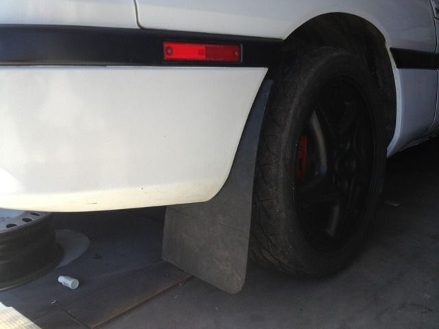

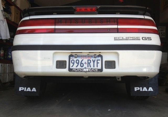

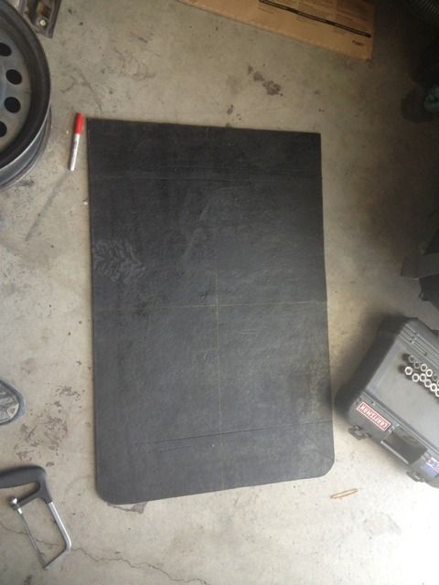

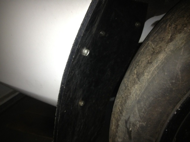

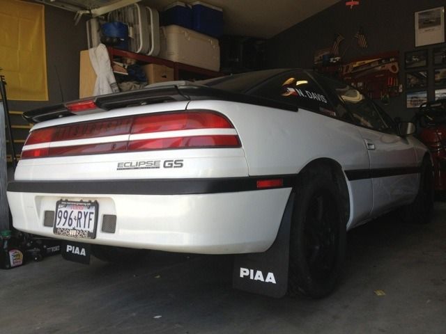

I decided to make some rear mud flaps today. Since nobody makes any for the 1g's I had to do it the old fashioned way. I found a neat idea on dirtyimprezza.com using a tractor trailer mud flap from NAPA and cutting it into quarters. I got a 24"x36" mud flap, part number 823-5076 for $18.07 after tax. I cut it into quarter using a pair of tin snips and then marked the existing holes for the rear fender liner and drilled them out. I had to use slightly longer bolts along the top and I used nuts and bolts where the plastic fasteners were previously used. I will be adding some large fender washers in the future.
Once I was done I threw on some PIAA stickers just to give them some life. PIAA was always a sponsor of the WRC Evo's so I found then fitting and I had them lying around.

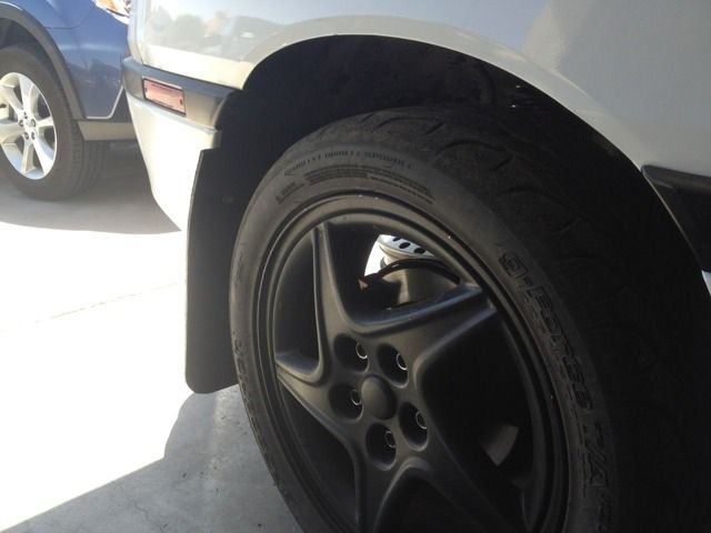

I have the front ones cut out, I will just need to get around to measuring them and getting them bolted up. All in all, not bad for $18 and about an hour.
I got lucky with a car I parted out. It had the factory Mitsubishi ones installed. I somehow lost the fronts but found the rears. Not very long though.
You can use the ikea ones too for even cheaper...haha
My main problem with those longer mud flaps like yours is when you reverse on the hilly stuff you run over your flap and rip it off...
Looks good as always glad your having fun in the dirt
Looks sick! I had the red Ralliart flaps on my EVO and took alot of heat from some on the way they looked. I always loved rally and of course WRC.
Good find! Those are quite rare!!
Thanks man! With Rallyx I don't see the length of the flaps being an issue. I could see that happening on a truck offroading perhaps, but not on a flat Rallyx course.
Thanks Phil! Im happy with how they turned our! Nice! I have the Rally Armor mud flaps on my Evo. Plus I custom fiberglassed a pair of 6" fogs into my front bumper, reminiscent of the old Evo IV's and V's.
