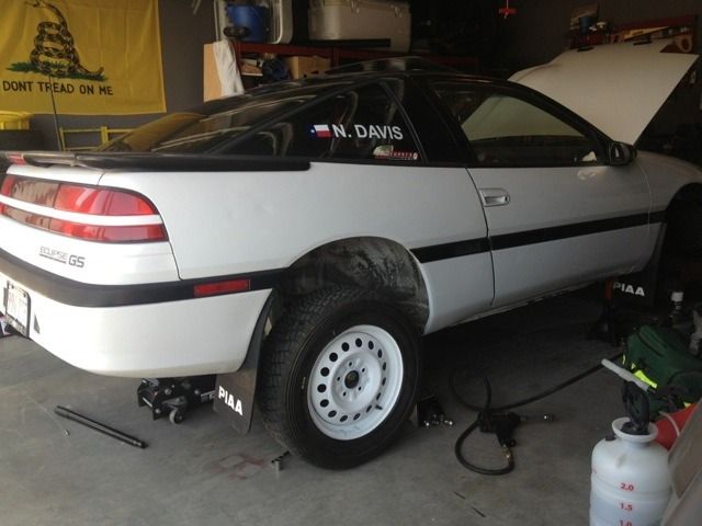

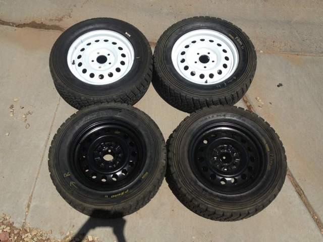

Hey Brian, thanks so much for posting! I just got my rally tires in and mounted today actually, Perrelli P-Zero's in 205/65/15's in K6, KM6, and K2 compounds. However I would love to have a contact (semi-nearby) for tires in the future!
(Rims were half white and half black so I could decide which color I wanted. As soon as I saw mounted them I knew I was going with white!)
Also today I started a swap from my previous suspension, KYB AGX's with Eibach Pro's, to the stock Evo VIII struts and springs.
The things left to do on my list at the moment are to get a better suited rally seat (currently using a summit racing drag seat) and a roof vent (as you know it's ungodly hot in Tucson and with bolted in Lexan windows there is no air flow). The next event is in Tucson on July 13th.

Big news, I got a set of used rally tires from jtmcinder. 205/65/15 Pirelli P-Zero Gravel tires! These are a perfect fit on my 15x6" steelies and should make a significant difference when it comes to rallycrossing.

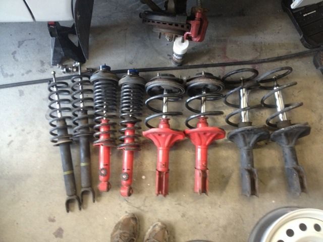

Next up I got an idea to use my old Evo VIII GSR suspension (struts/springs) on my DSM. I spent a few hours getting it done only to find out that it is super stiff and lifts it too much in the rear. I am probably going to leave it on for the next rallyX in July but I am already trying to figure out a better suited rallyx suspension. Here are a few pics, for the whole project check out my thread on DirtyEvo: Evo VIII suspension on a 1g DSM - DirtyEvo.com - The EVO and DSM Rally Forum!.

The stock Evo height is what you are seeing in the front and I think that is perfect. The problem is in the rear because the AWD struts (EVO or DSM) are physically longer then the FWD DSM struts because of the entirely different rear suspension setup. That is why it is twice as high in the rear and has that exaggerated raked appearance.

The other main issue is how stiff it is. I don't think there will be any body roll whatsoever. This suspension is designed for a 3,200 lb car and is now installed on a 2,100 lb car. It needs another 1,100 lbs pushing down on it to even do anything, LOL. So as long as the course is flat it will be fine, but if I get into bumps then the suspension will not be functioning adequately.

Couldn't you have the rod for the rear strut cut down and retaped? Might make the rear more stiff but should bring down how high the top of the spring sit and drop the height of the rear.
