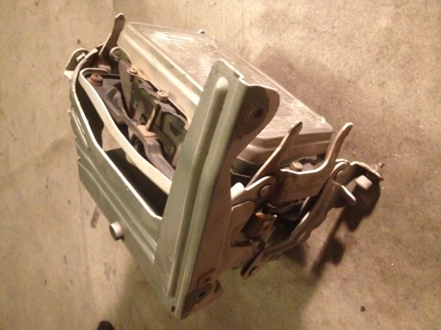

Close, the headlight system was 16 lbs removed and then about 2 pounds added for the new lights. Wiper system, which was just he motor, linkage, arms, and blades up front was 5 lbs. The rear system and the reservoirs were already removed.

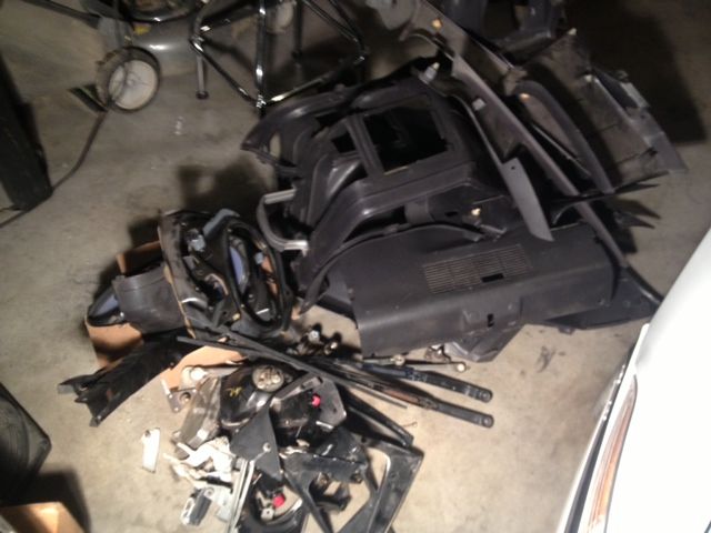

After I just posted today that I was going to keep the interior, my wife persuaded me to gut it (and she actually helped which was quite fun). Go big or go home, right? So what started out as "lets remove the rear speakers", ended up as "lets gut the rear and not put it back in".

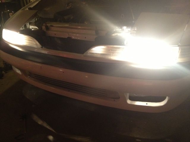

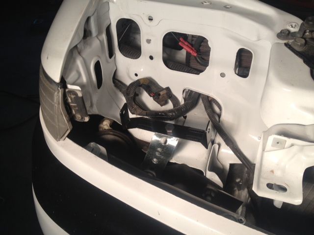

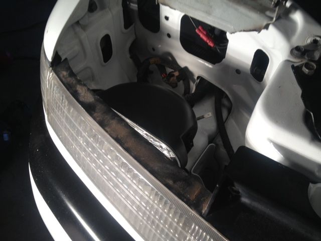

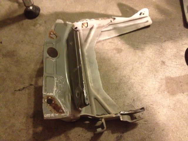

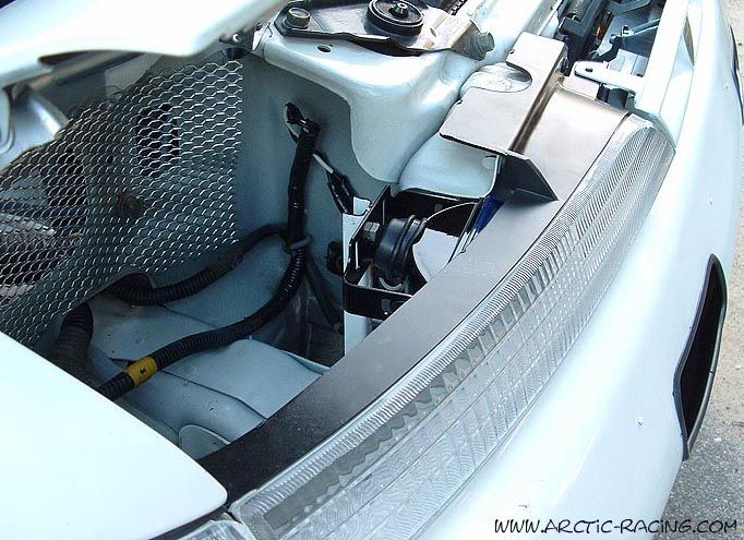

After that I got started on the headlights. I pretty much followed Jose's setup to a T. I got a set of Pilot 55w driving lights at Auto Zone for $25, removed the factory pop ups, made some custom brackets, and wired everything up to a switch mounted on my custom sheet metal console. :thumb:
Afterwards I pulled out the wiper which was quick and easy. Ironically it was raining while I was doing this. ROFL
New headlight installed.
Old headlight frame prior to cutting.
After cutting.

Let there be light!

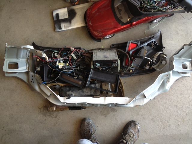

I pulled out 27 more pounds! This brings my total up to 111 and I now have 189 left to go!

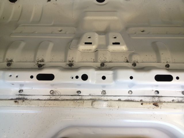

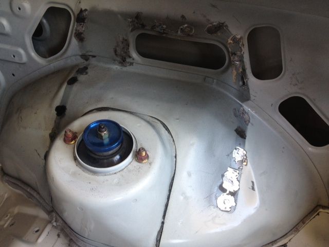

I bought a spot weld cutter and cut out the brace that runs side to side behind the rear seats and up by the rear speaker. That sucker was 8 pounds by itself. I also pulled out the third brake light and cover, headliner, interior lights, front and rear strut tower bar brackets, the wiring for the rear wiper, rear defroster, rear washer reservoir, power antenna, rear interior lights, and rear speakers.
So far I'm over 1/3 of they way to my goal and it took less then a week and was pretty much free. I spent maybe $50 on miscellaneous supplies. Now I'm going to have to start spending some money to get the rest of the way. Lexan, sheet metal, lightweight seats, harnesses, fuel cell and pump, and exhaust piping and v-bands.
Cutting out the spot welds.
Before grinding.
After grinding. Everything is going to be repainted white on the inside.

Pile #3. 27 lbs.
