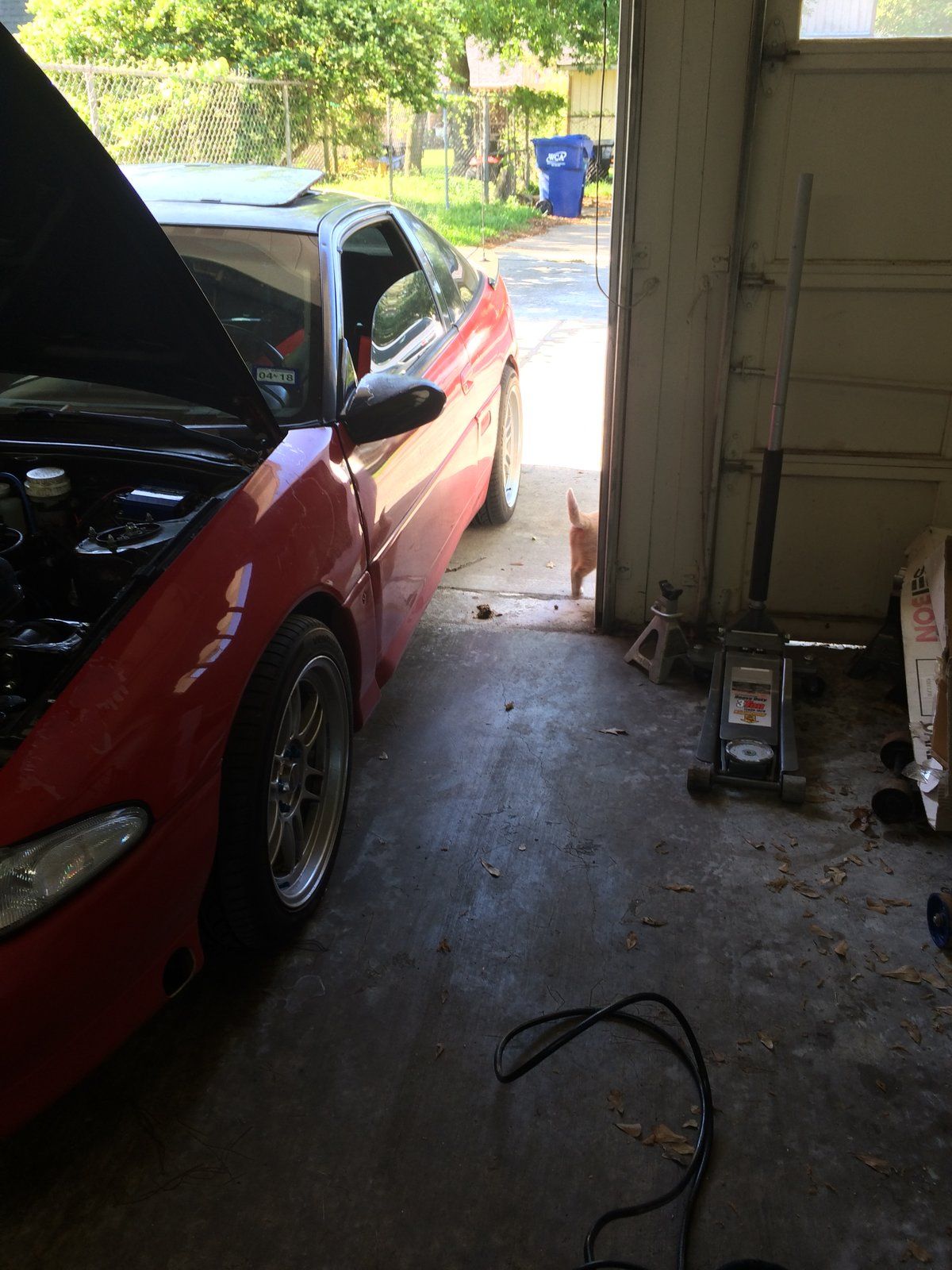

Looks alsome. Love the wheels. Post 163---cat is having a blast. Haha
My cats are always having a blast when I work on the car. They hate each other in the house but are best friends as soon they get in the yard. I've recently found out that the yellow female has been napping on my passenger seat at night as sometimes I leave my windows down.

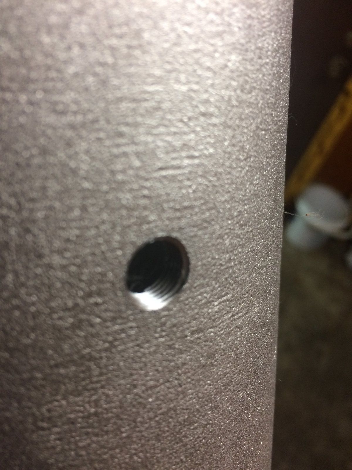

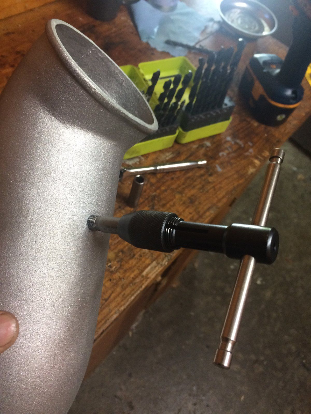

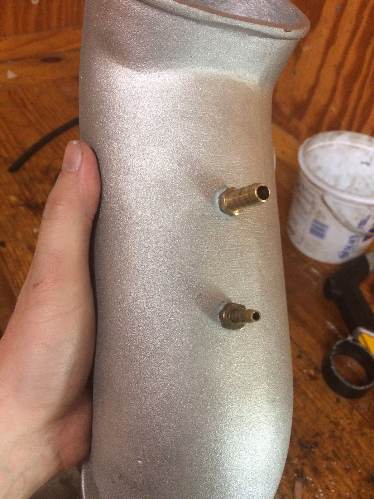

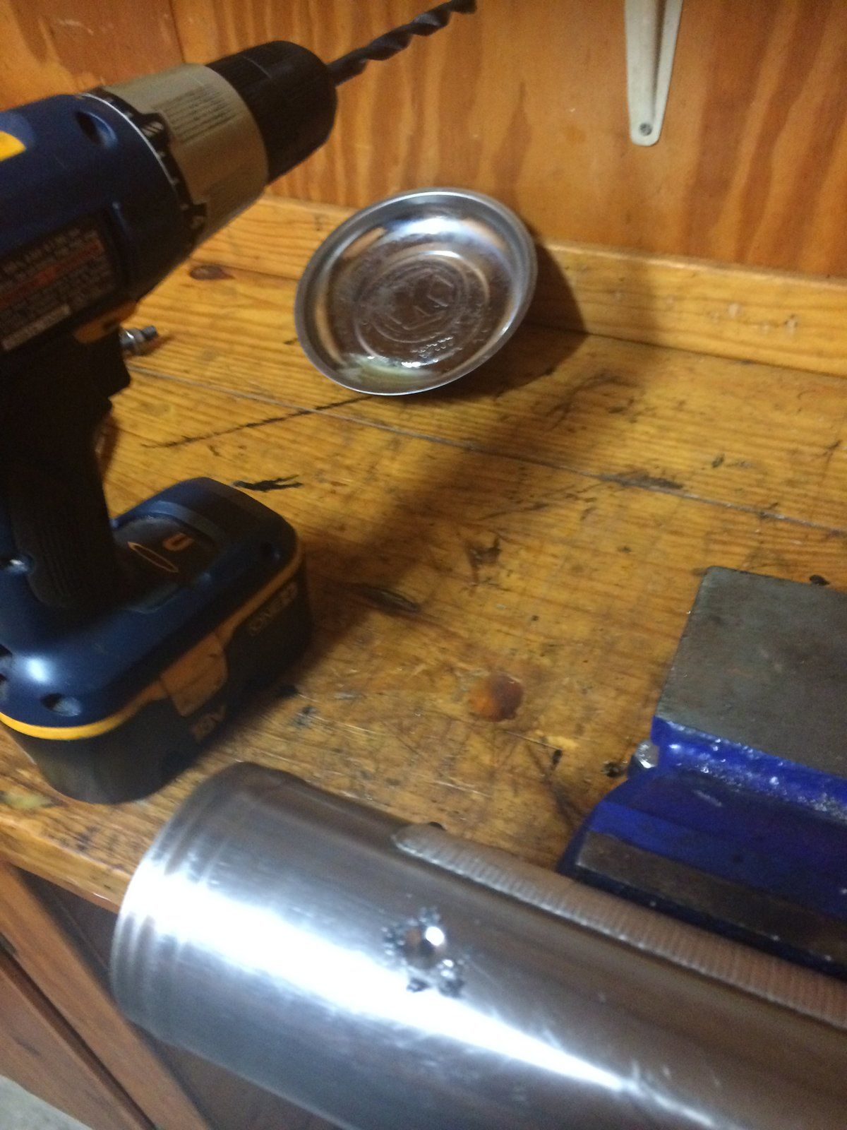

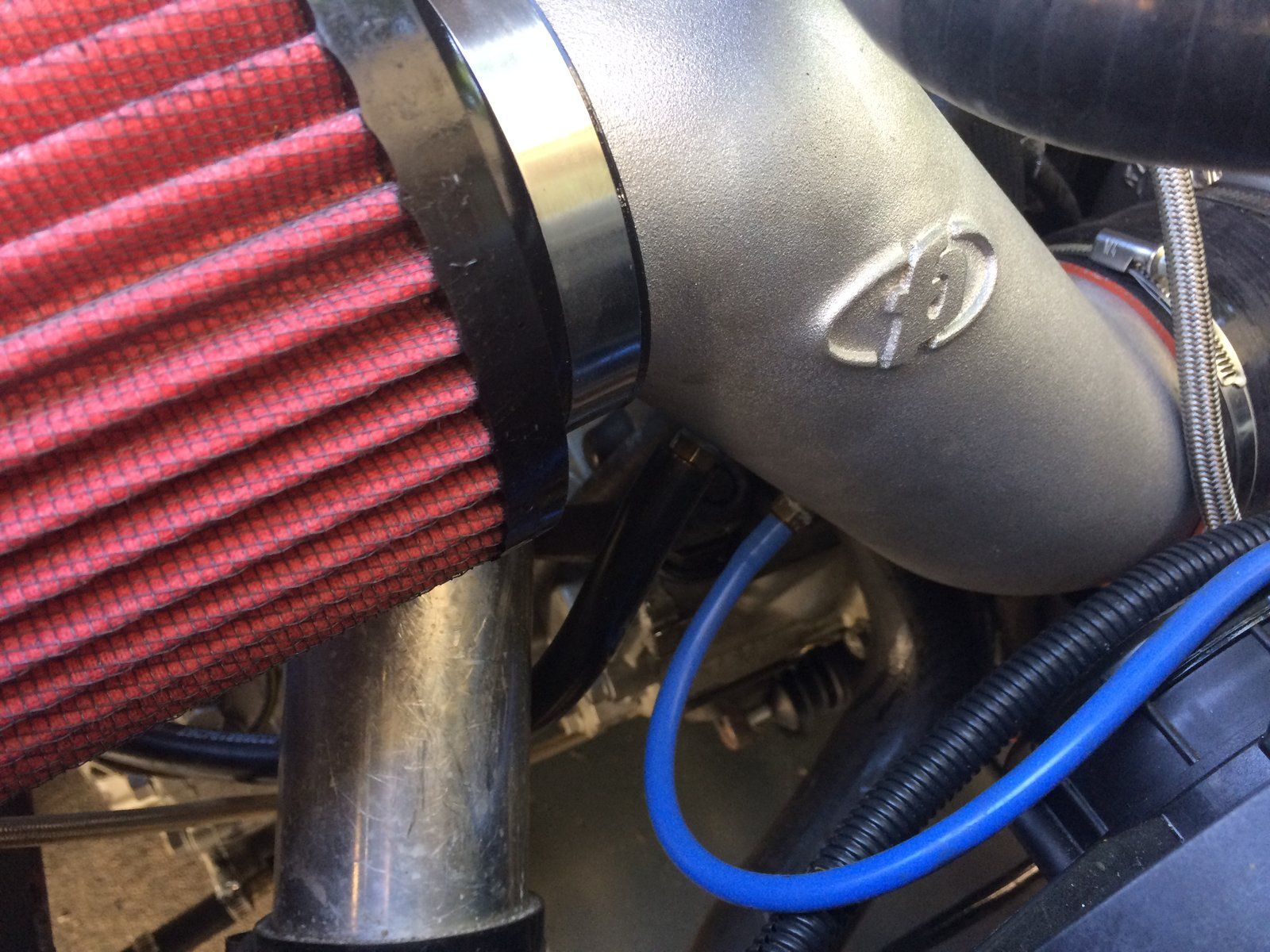

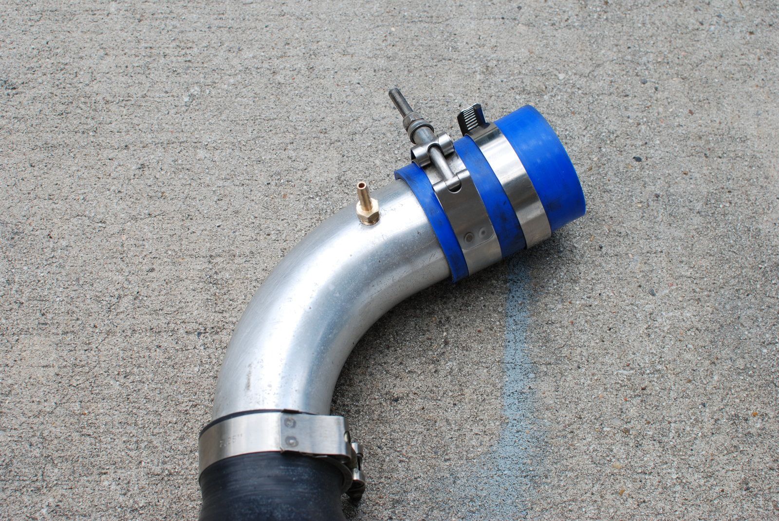

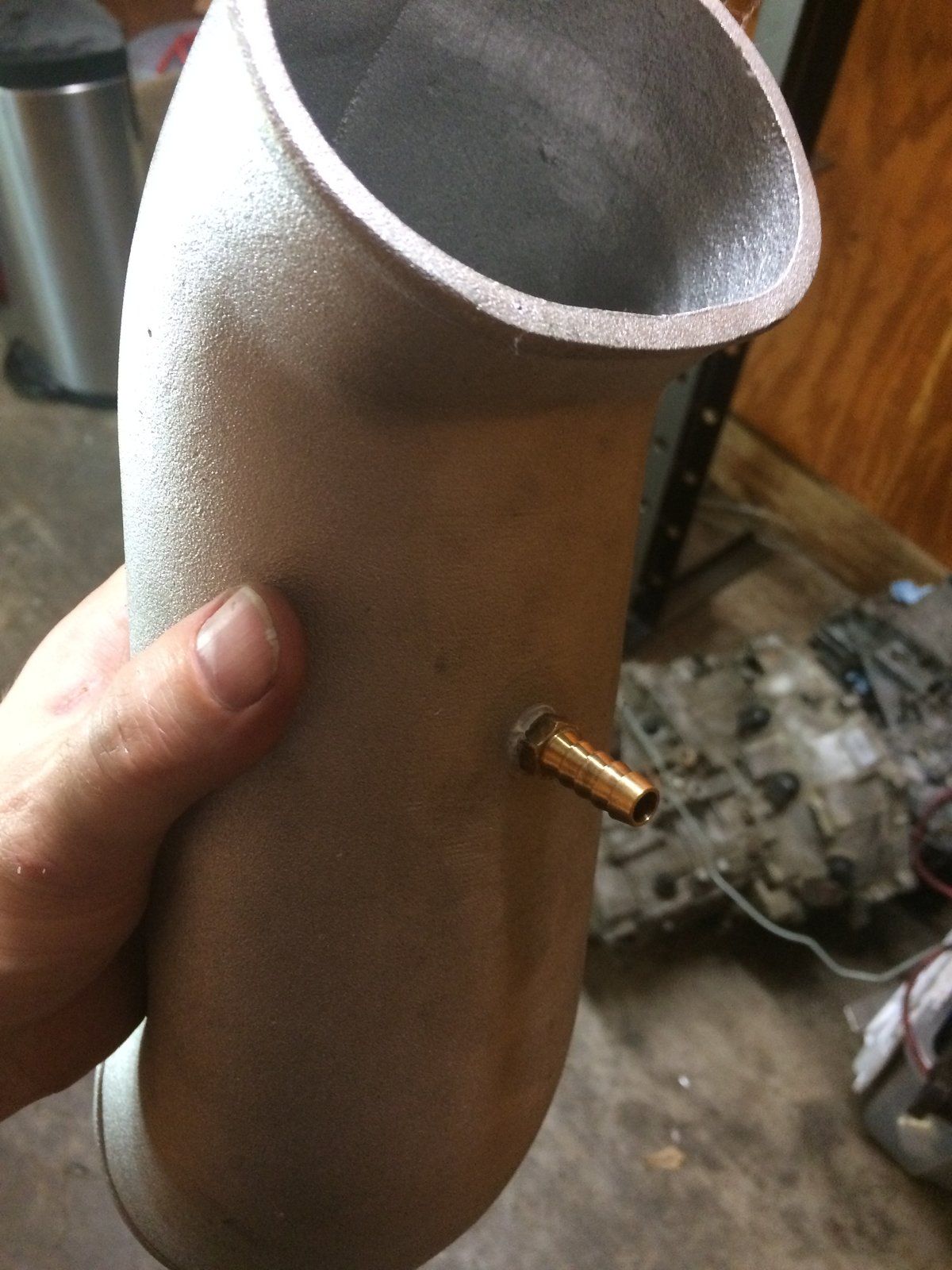

I built myself a little could air induction pipe. I actually got the idea off the intake pipe that came with the car as I'd never seen anybody do this before. However, the original pipe was only 2.5" with a small, old filter that needed replacing. I wound up buying a new 11" K&N filter and putting it on a 3" pipe with a 45* bend. I drilled and tapped for my catchcan vacuum source. I made sure to get the nipple in at an angle parallel to the turbo blades as that will pull in air better. I also installed another nipple for my electronic boost controller. So far it's working great. Old pipe is pictured first.

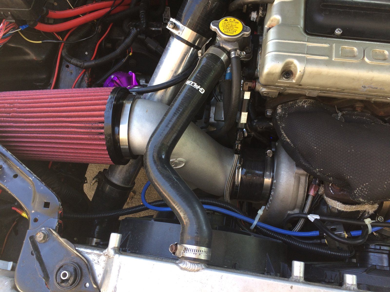

What is on the end of the intake?
I'm not sure what you're referring to?
I couldn't see where your air filter ended up being at is what I was getting at. Sorry for being vague.

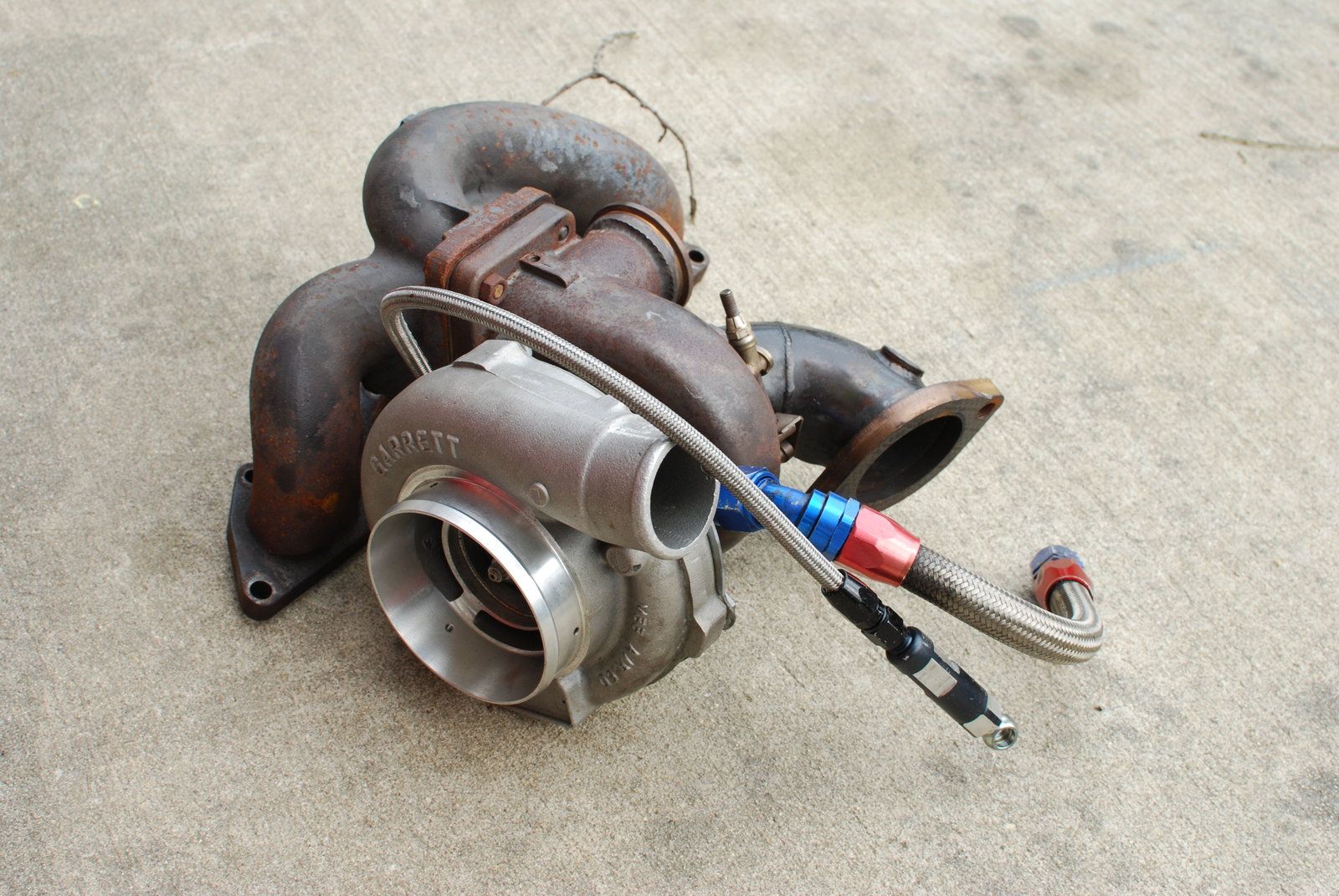

Going back a few months, I bought a V1 hta68 from a local for a great deal and installed that puppy and sold the 18g. That turbo was great and I ran it for a few weeks then came across a deal I couldn't pass with my buddy who was selling his car.

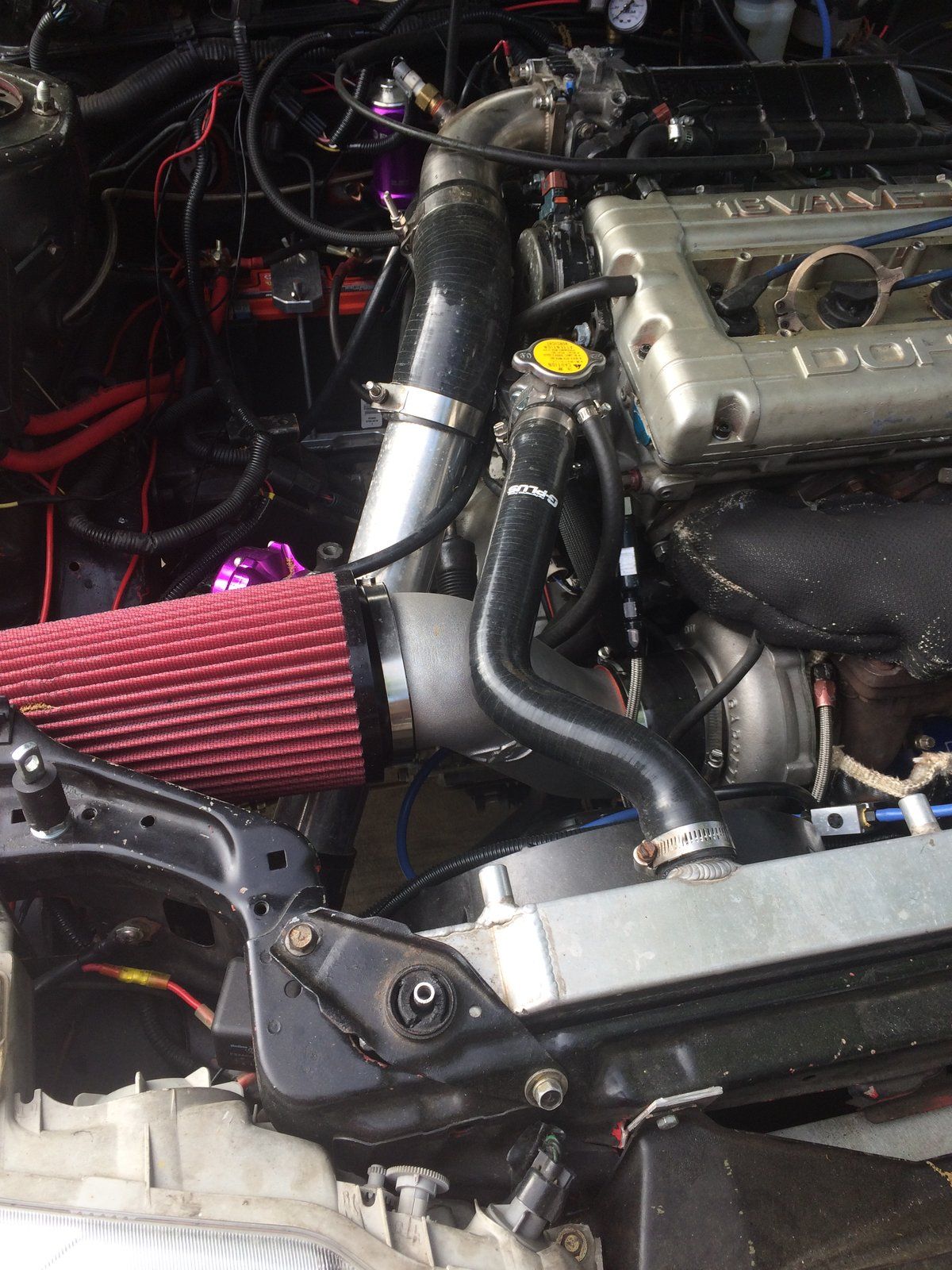

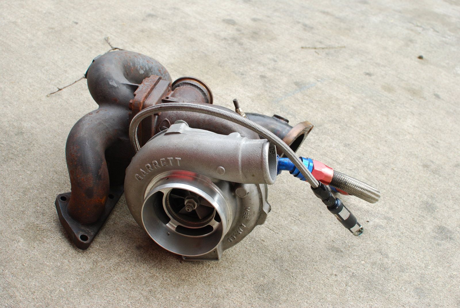

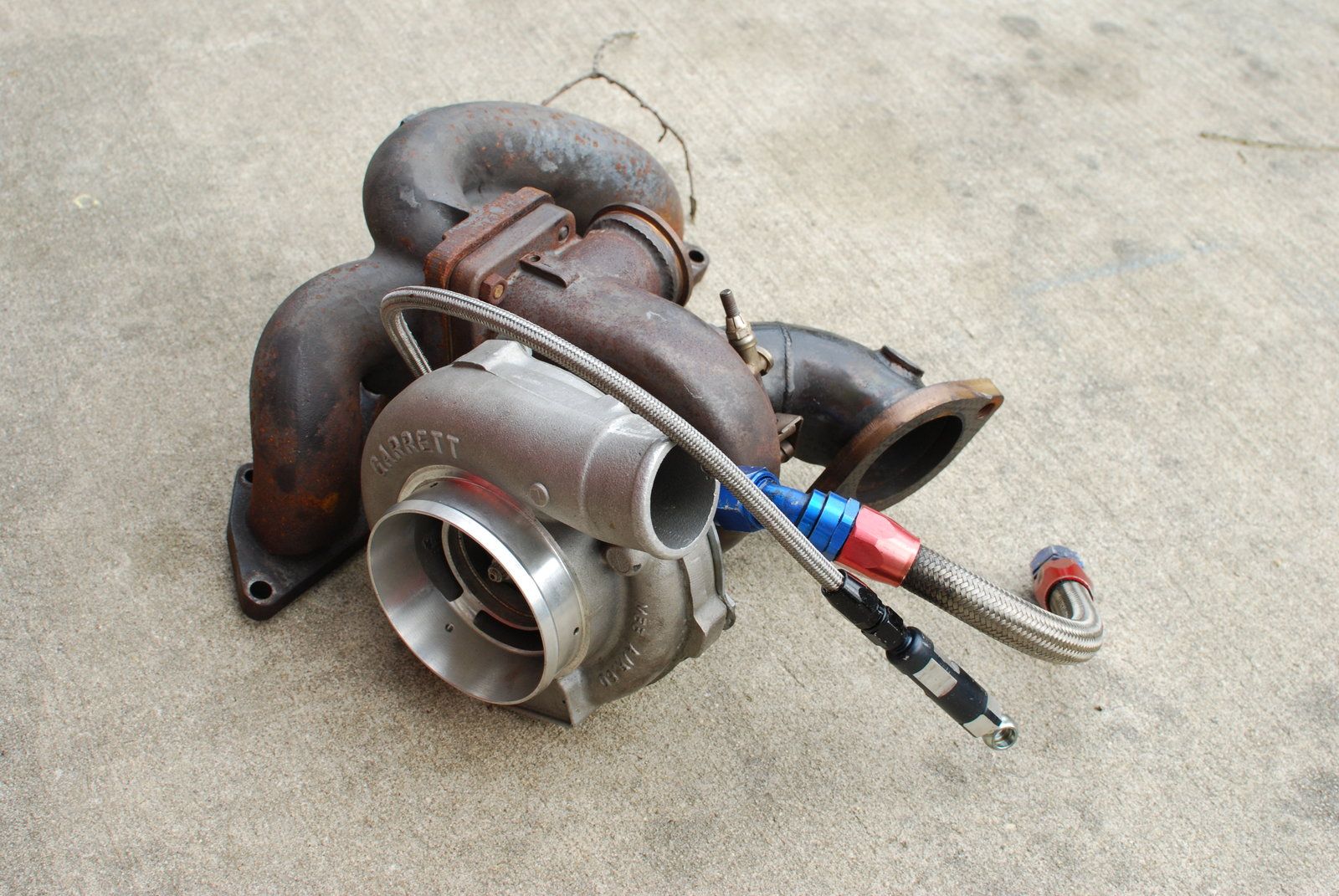

Onto the new turbo: an FP 3052!

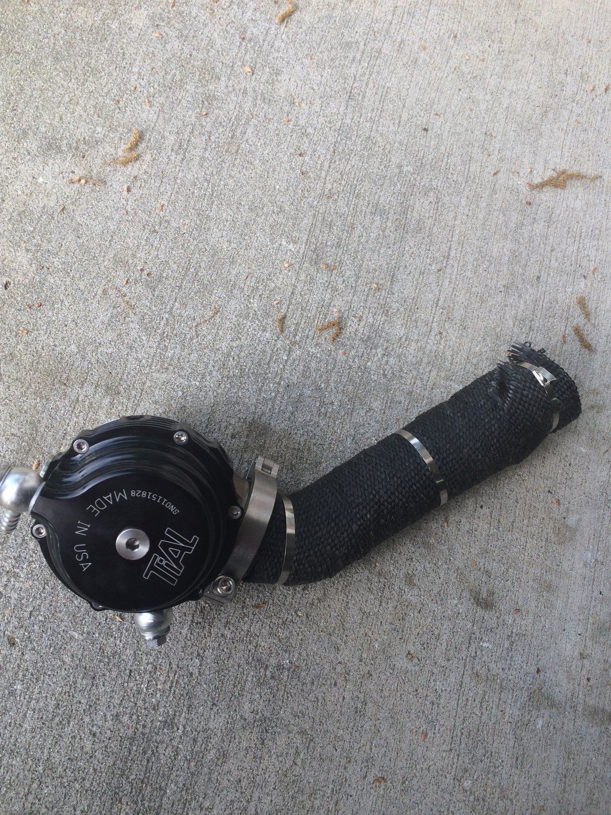

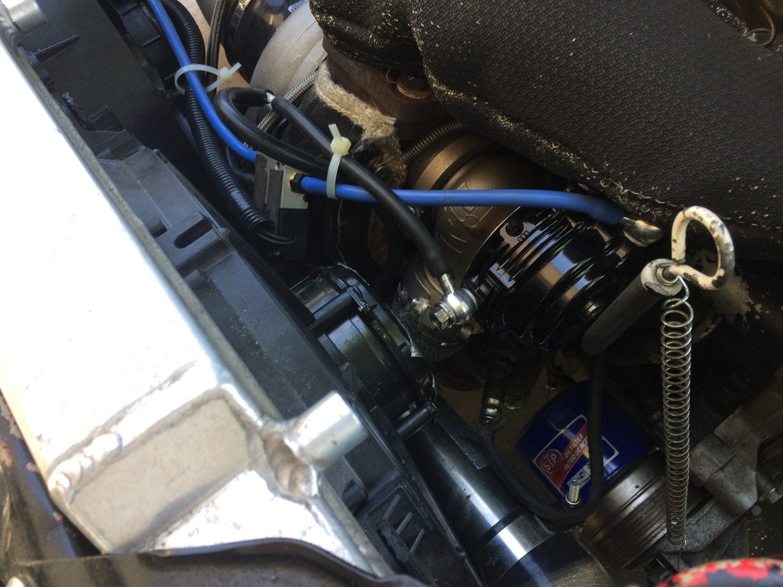

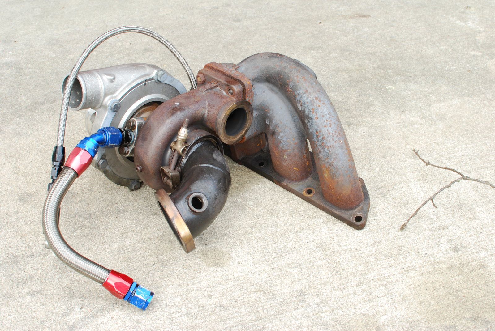

I had to bite the bullet and get a 44mm Tial MVR, an FP intake and filter and some custom coolant lines (couldn't get stock ones to fit although some people claim they fit).

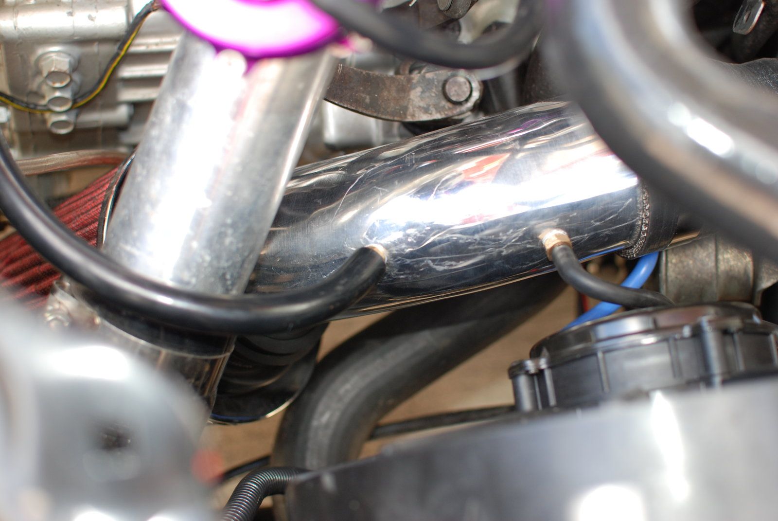

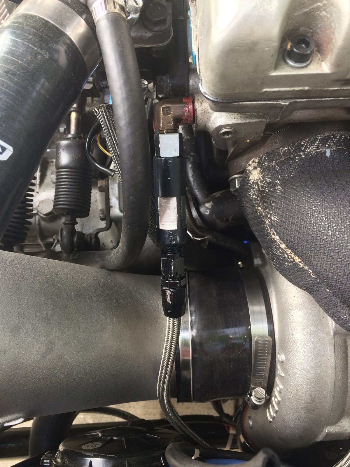

It took me a while to figure what all I needed for the coolant lines as I've never used AN fittings or made my own braided lines but it was all very simple and a lot less complicated than I made it out to be. I tapped the intake pipe for a vacuum source for my catch can (as recommended by FP) and tapped for the third port on my Ingersol Rand BCS. Also. I had to tap my lower intercooler pipe for the BCS as well because I didn't wan't to tap the compressor housing and screw it up.

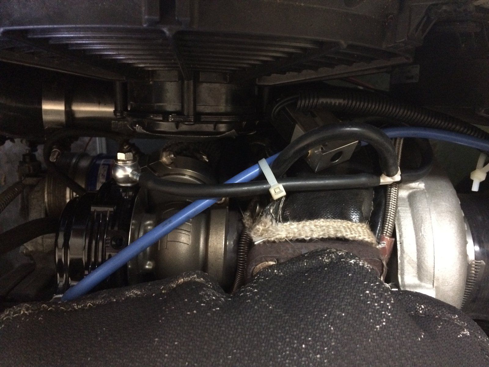

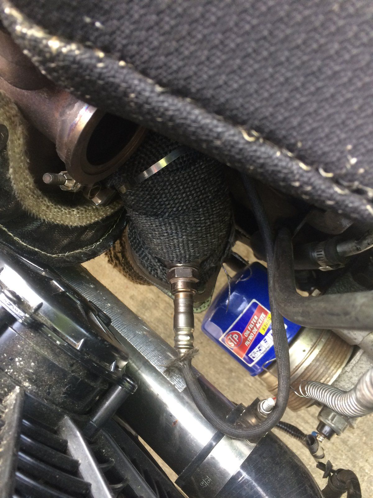

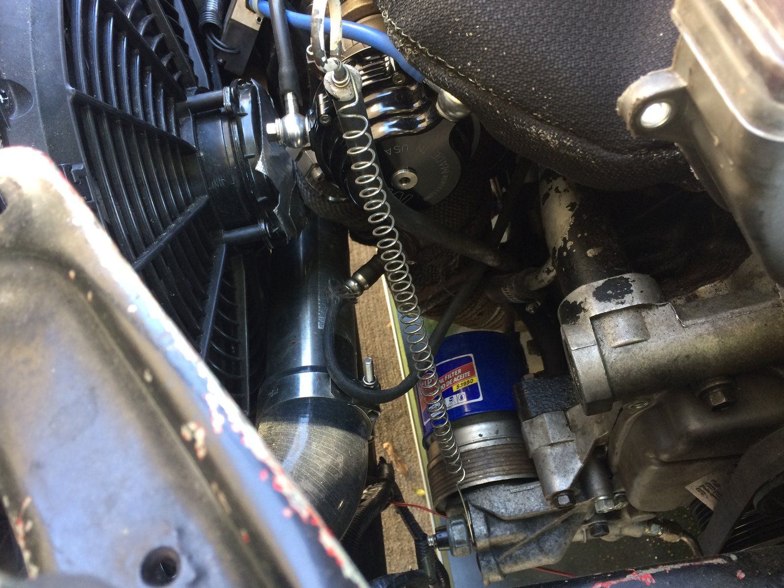

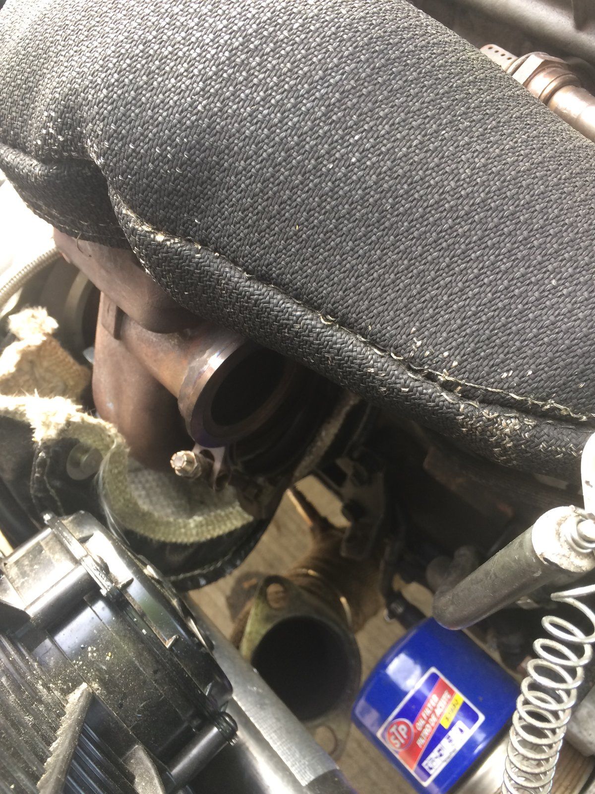

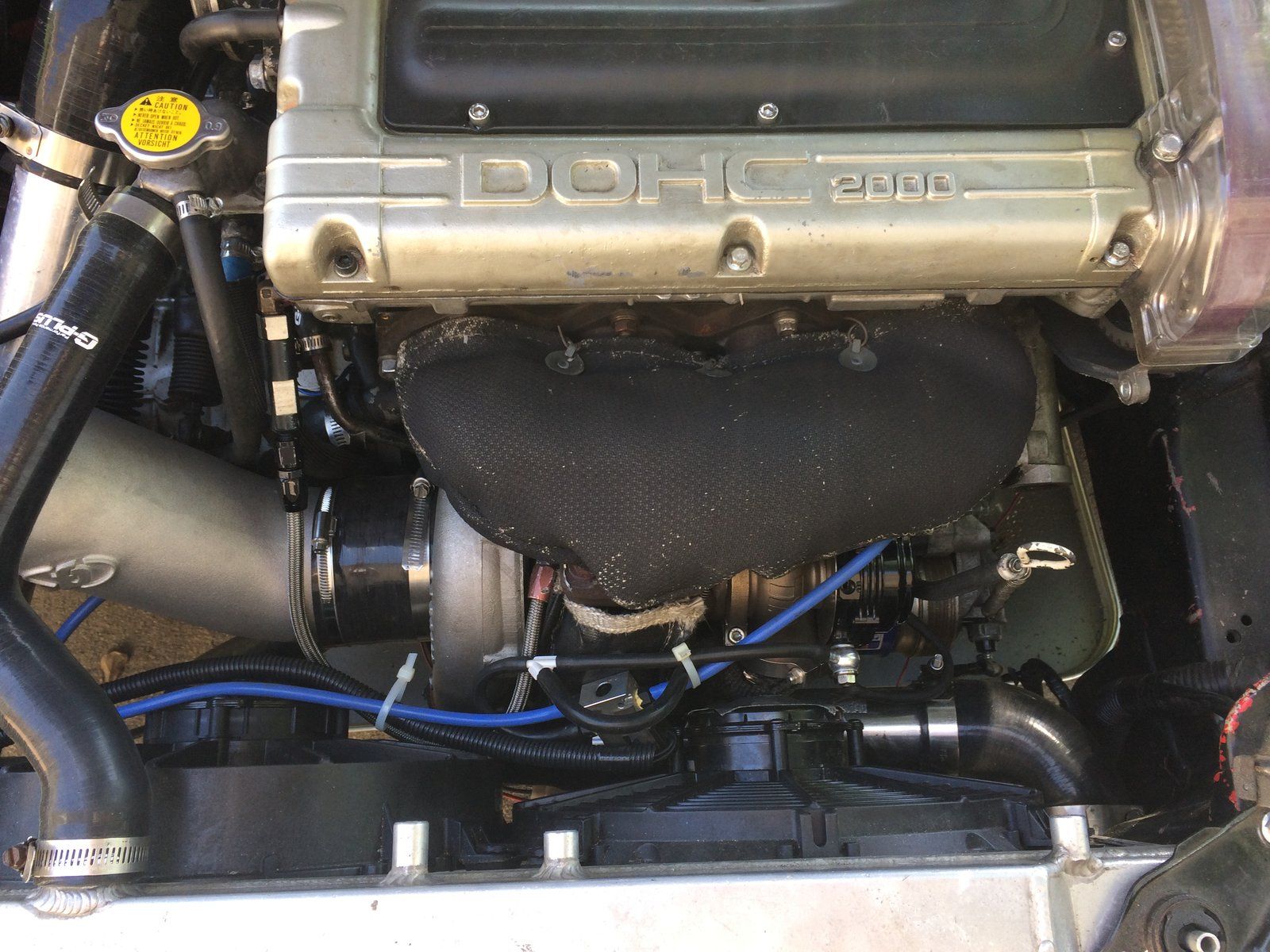

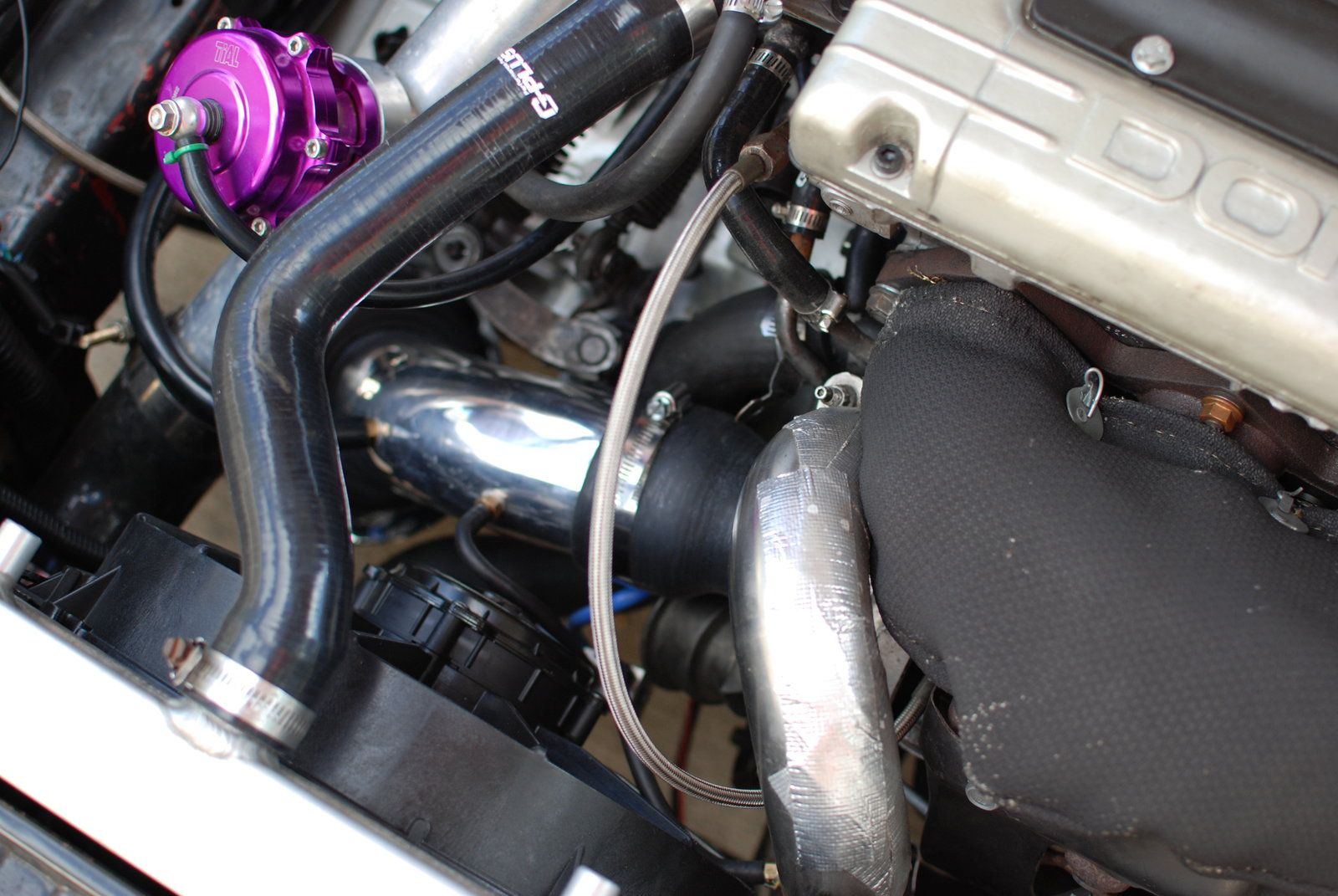

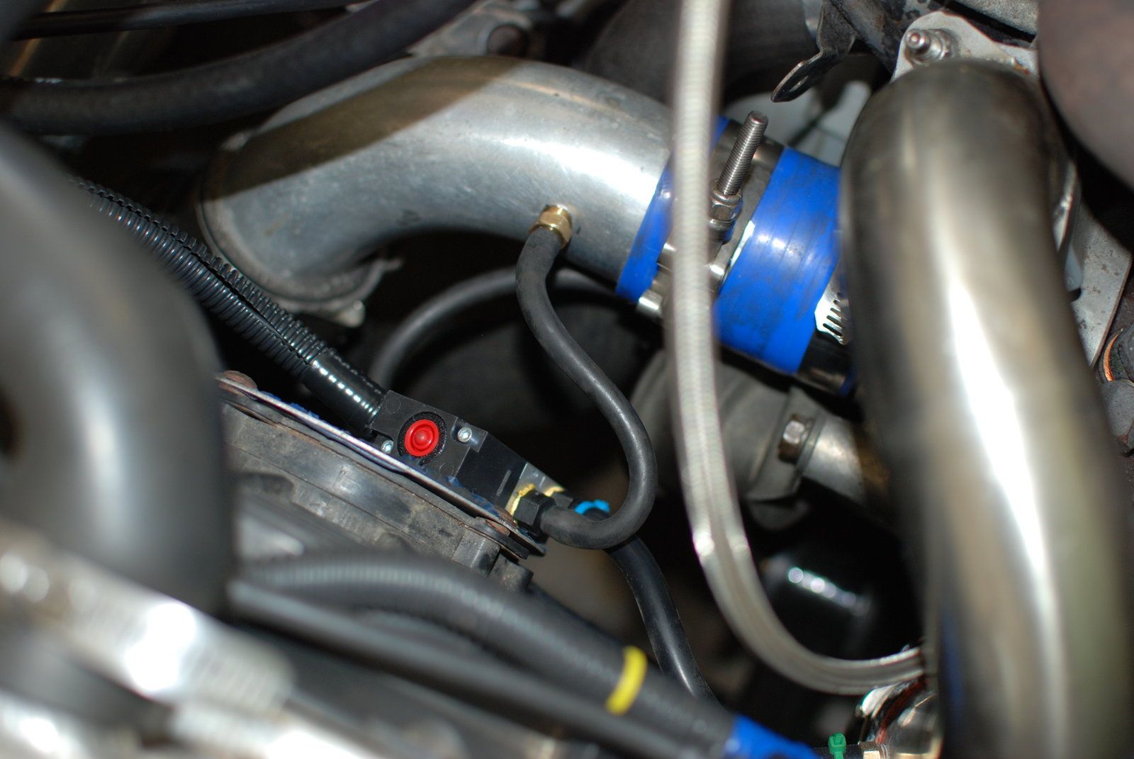

Finally got the turbo finished up! I'm really big on exhaust wrap and heat blankets as I almost melted my wideband connection last year. The engine bay is super cool with all the wrapping. I even bought a lower PTP turbo blanket even though you aren't supposed to use them on top mount setups like the fp 3052 (then why fo they even sell them for fp 30 series turbos? Anyways...). I'm still trying to decide how I'm going to run my BCS/wastegate lines to make them look as clean as possible. I may wind up running some ss lines with AN fittings for the wastegate as it sits RIGHT under the manifold (doesn't matter though as I have a damn heat shield!).
Initial impressions of the turbo:
Creates a lot more power at low boost than my 18g and hta68. I've always driven slow in my DSMs and never been one to go hotrodding around but lately I can't help that the car is so responsive down low that's it's just begging for me step on in each gear. I've gunned it a few times in 2nd gear after a light and then I feel bad that I probably scared some old woman but oh well, I'm sure she understood.
I haven't even pushed the car at all (I'm installing new cams next week so why tune twice) but I can tell it's going to be ridiculous on 30lbs and e85. The car is just a beast right now being so light, running well and looking great. I've been putting a lot of work in so I'm super happy at the moment. I have Kevin Jewer on the hook to do a remote tune for me soon so I'm super excited to have his help. Updates to come!
