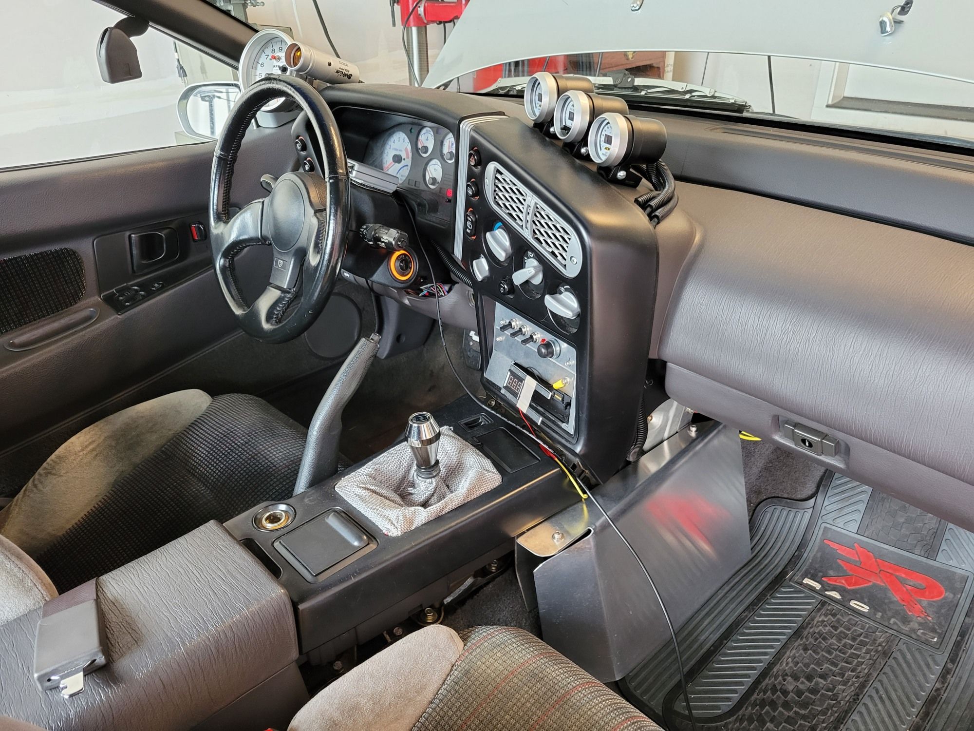

Here’s a pretty good shot of the interior. The ecu relocate to the passenger footwell was done by me, the switch panel in the center stack with the starter button and voltmeter was done by me, the 3 AEM gauges up on top were put in by English Racing, and the Autometer tach was done by the PO.

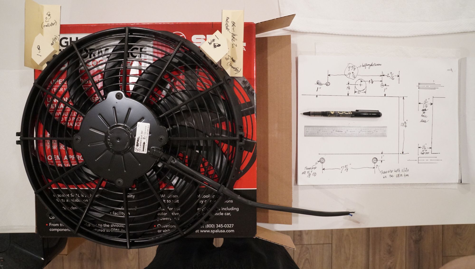

Putting my kitchen to good use mocking up a new main cooling fan for the Talon.
This SPAL VA10-AP50/C-61A (SPAL part # 30101522) is going to replace a FAL (Flex-a-Lite) that had only been on the car since 2016. The FAL quit working, and its motor case is so glued together I couldn't get it apart to look inside.
The FAL did have a nice shroud that used the factory type mounting points (6mm bolts to standoffs on the radiator).
For the SPAL, I'm making my own brackets from aluminum angle to bolt to the same 4 radiator mounting points.

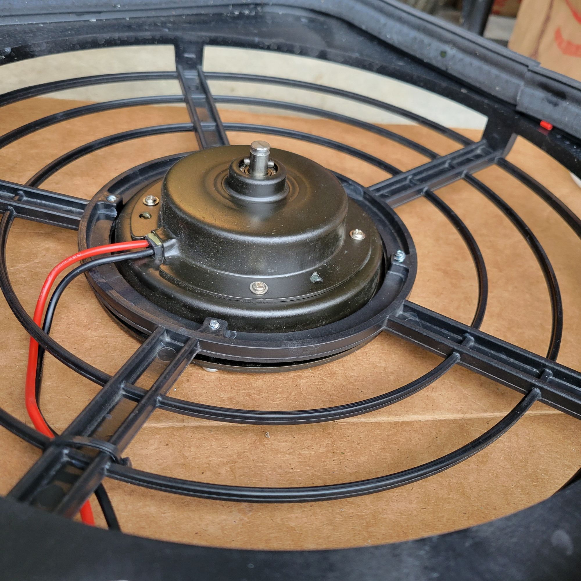

Here's a pic (below) of the FAL from when I was trying to get into the motor case. You can see that the whole thing looks practically brand new. The failure is just broken conductor in the wire somewhere, either right where the wires go through the rubber grommet that you see here glued into the side of the motor case, or else a conductor broke just a little further inside the case. The motor runs if you push or hold the wires a certain way.
In my pic of the SPAL (above) you can see that SPAL is a lot more serious about how they do this wire that comes out of the motor case. It's all nailed down and in a fairly stiff cover that can't really flutter around in the breeze.

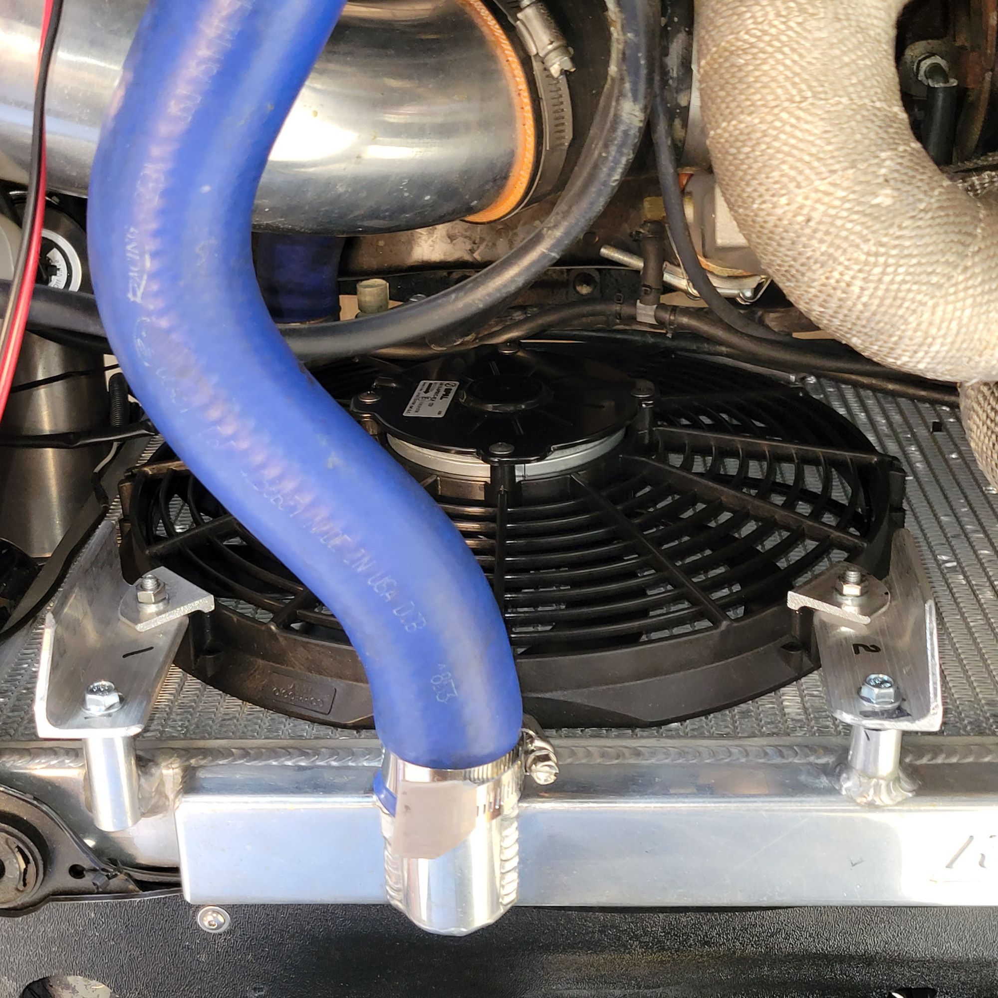

Thought I should show the result of my 12 inch Spal install, since people have been asking about fans a lot lately. You can see I made an aluminum fabrication project out of it instead of using skewers through the radiator.
You can't see in this pic the 2 brackets on the bottom of it. They are completely different. These 2 brackets on the top go into the T-slots on the fan shroud. The 2 brackets on the bottom just sort of cradle around the outside of the T-slot moldings but don't go into the T-slots. If I unbolt the 2 upper brackets and take them off, I can then just lift the fan right out of there without doing anything with the 2 lower brackets. They just stay right where they are.
Online Metals is a fantastic place to buy metals like this in small quantities. 6061 aluminum is pretty cheap and is available in every common shape (angles, bars, sheet, plate, tube, etc).
You forgot to plug it in........I see the connector at the bottom of the radiator. ROFL
Spal's pull/push A LOT of air so you should be very happy with the install. I run twin Spals on 2 of my 3 DSM's and we also run them on the Z28 with the 400.
Yeah the Spal is working real nice so far! I've driven it 10 times so far with it like this.
That white thing sticking out of the bottom of the radiator unplugged is my old thermo switch, I think. Or else it's just something ER screwed in there to fill the hole, because they didn't want to use the thermo switch. The actual Spal fan wires are inside a black wire cover that you can see on the left side of the picture exiting to the left.
There's always something!

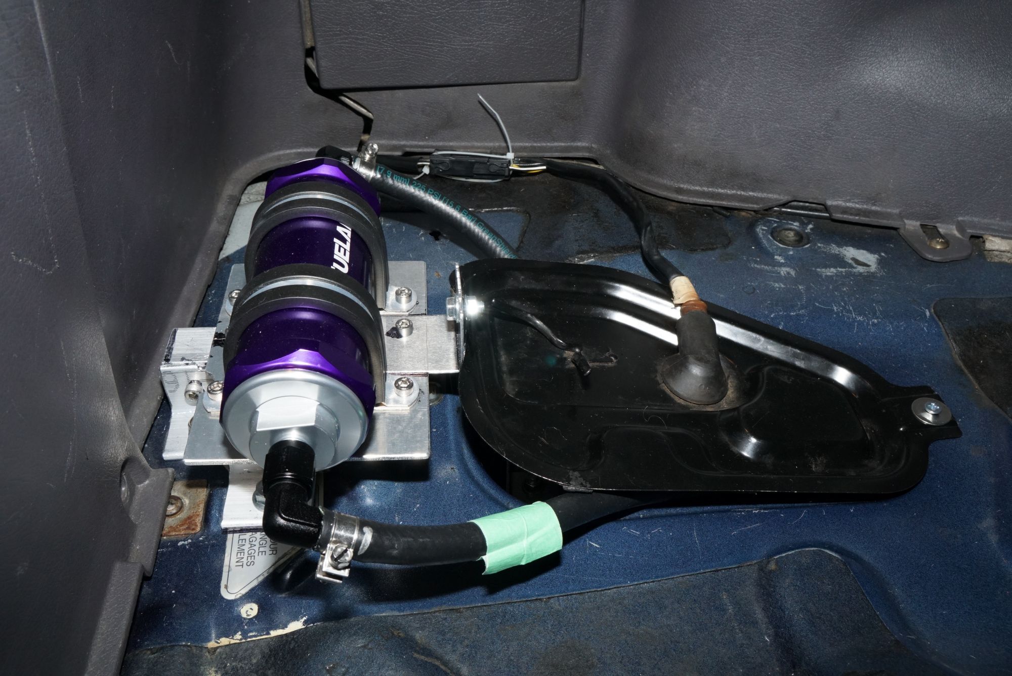

The dipstick hold-down and the Fuelab fuel filter was done mostly in August.
Fuelab 828 series fuel filter with 6 micron micro-fiberglass element, -6AN fittings:

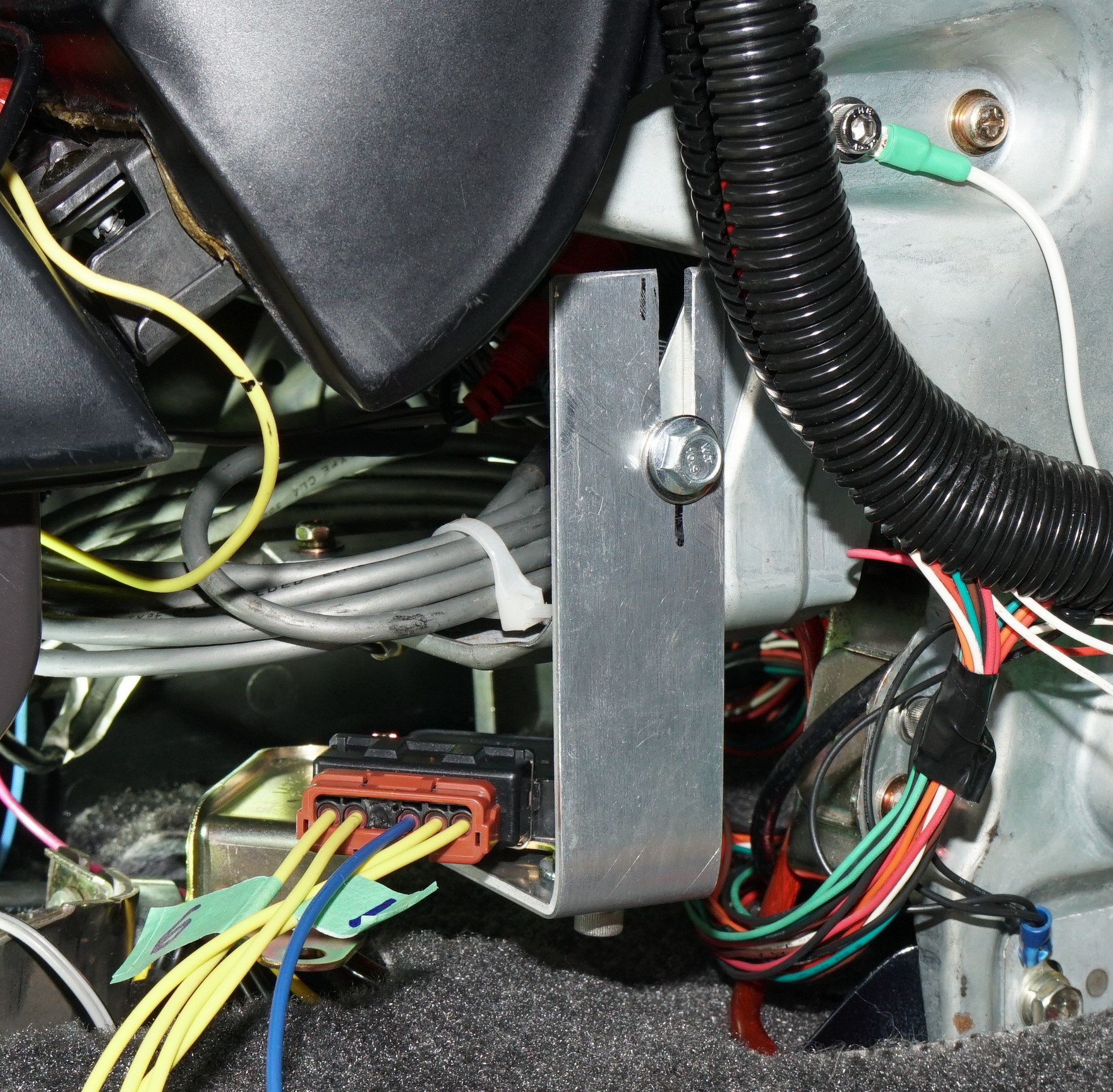

Power Transistor relocated to underneath the center stack in the cabin, with new connector:

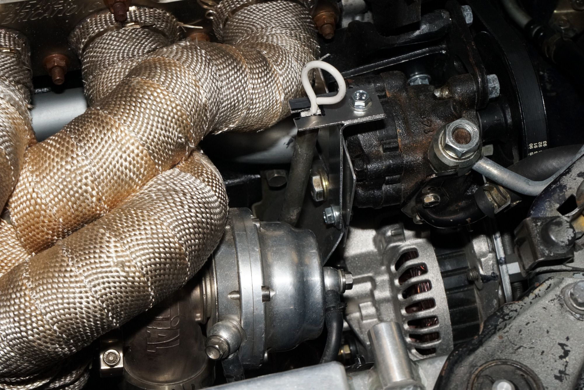

Very secure dipstick hold-down. Yup I have to undo that upper M6 bolt to get the dipstick out!
It is bolted at the bottom to my alternator heat shield which I've had there for a few years now.

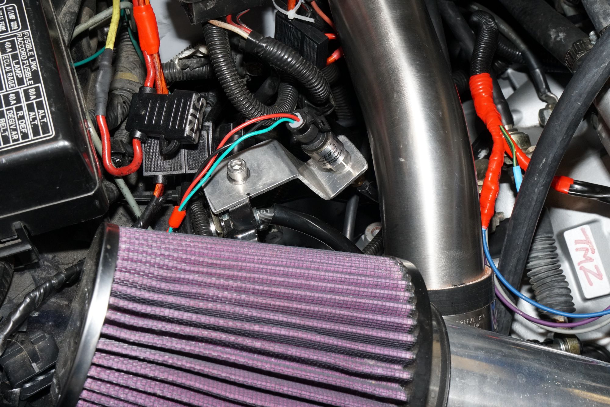

AEM 5-bar MAP sensor in a bracket that is bolted to a handy 8mm threaded hole in the OEM bracket that, as I remember, was for the cruise control. I have the sensor angled mostly downwards so liquid can't accumulate in it. The hose run from here is lower than the sensor for a couple feet for the same reason, before coming back up to get onto the hose spud on the back of the intake manifold.
