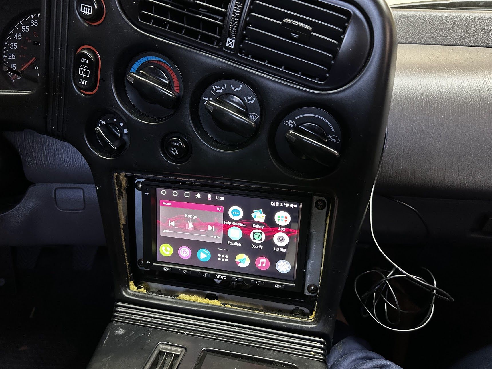

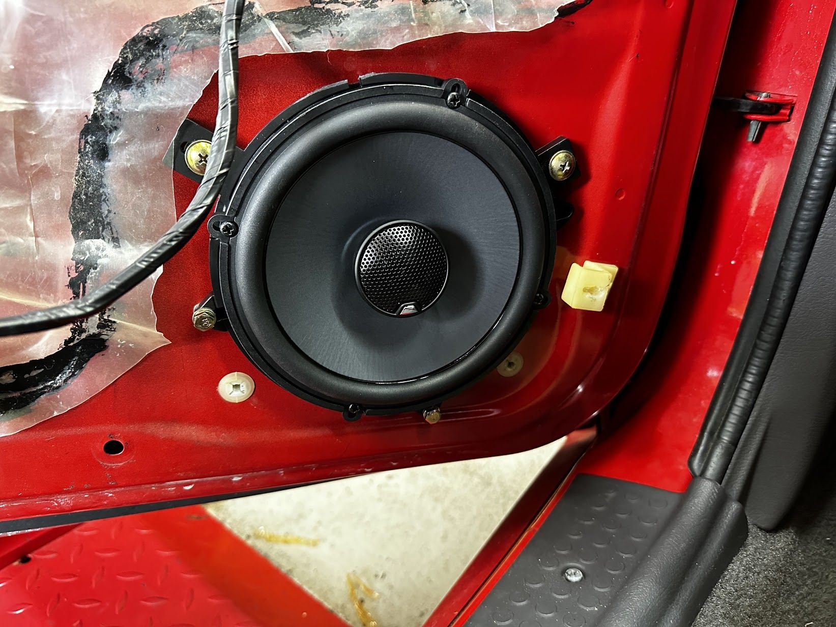

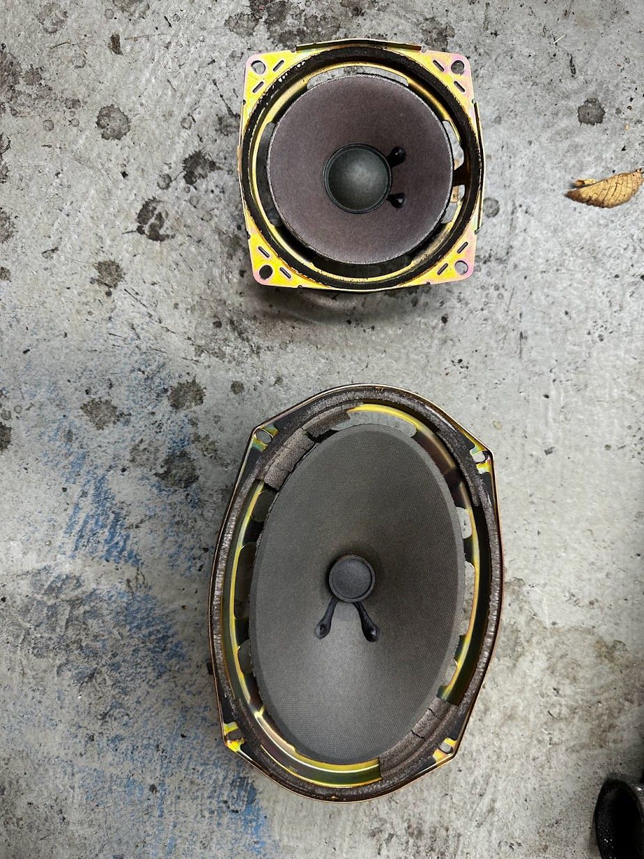

Got a android headunit and also replaced all the speakers.
Stock ones are a bit destroyed.

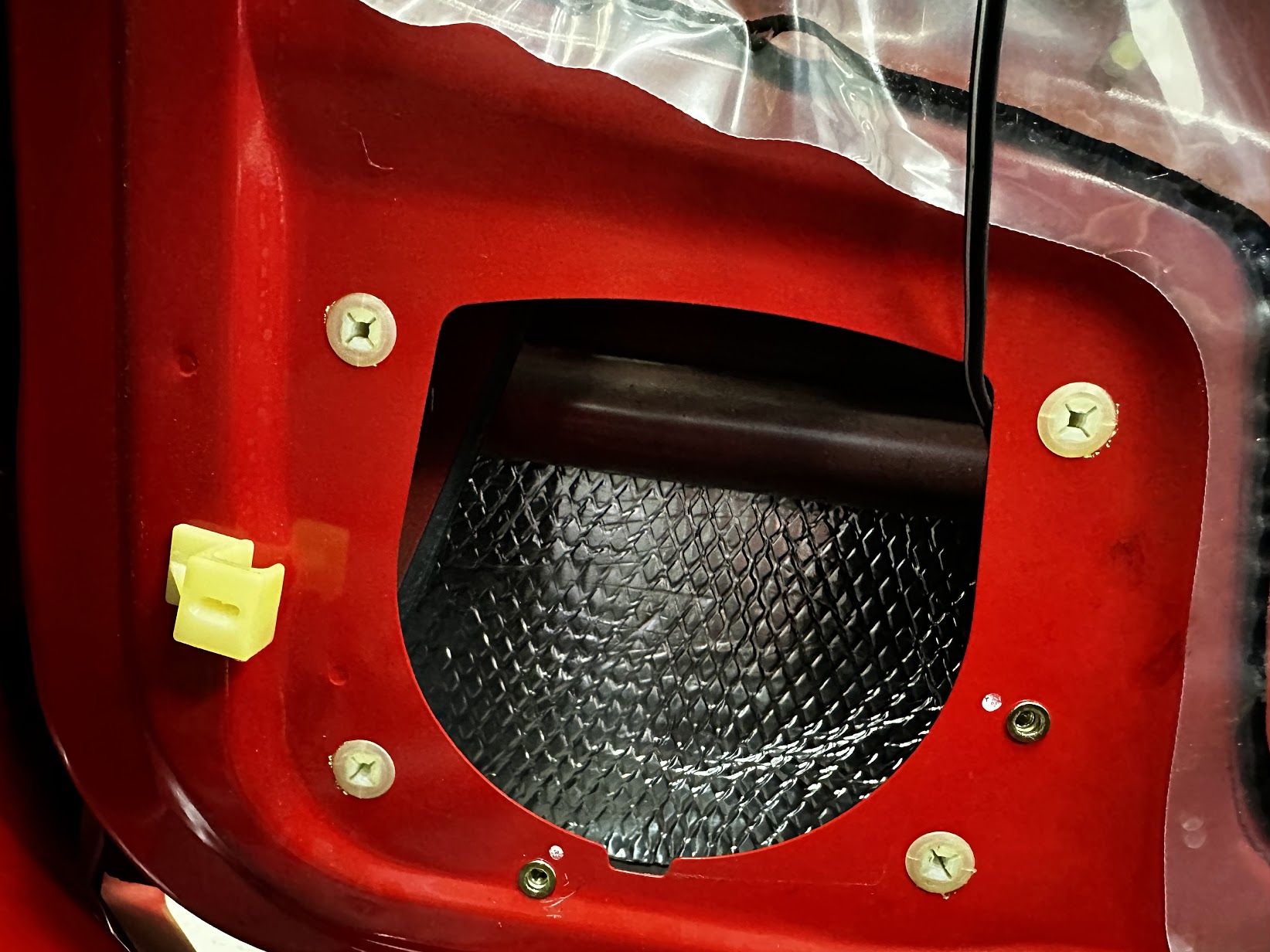

JBL for door and dash. Used nutserts to create mounting points. Upgraded fronts to 6.5, put some mass dampener behind as well.

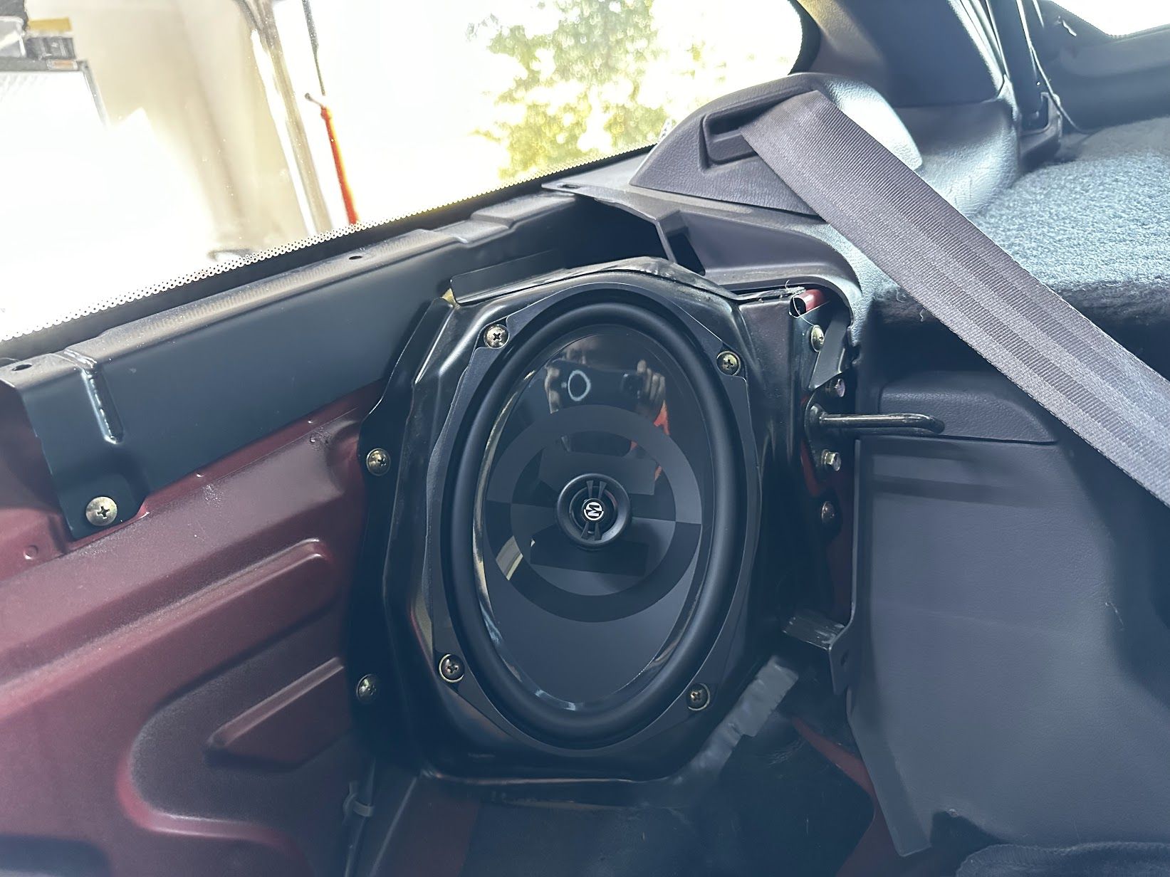

Rears are Shallow mount Memphis Audio. The JBL's would not fit :(
Sounds pretty decent for basic audio stuff. Car is very loud anyway, so no point wasting money on high end stuff.

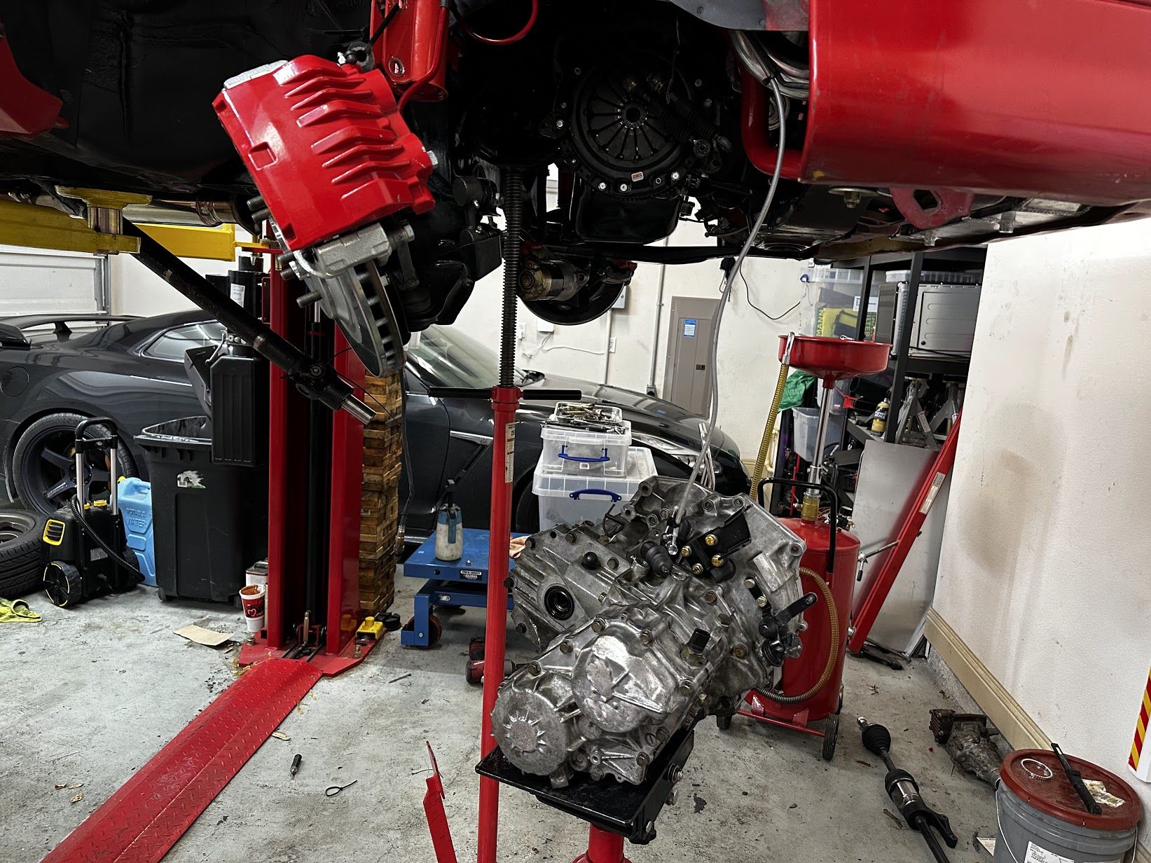

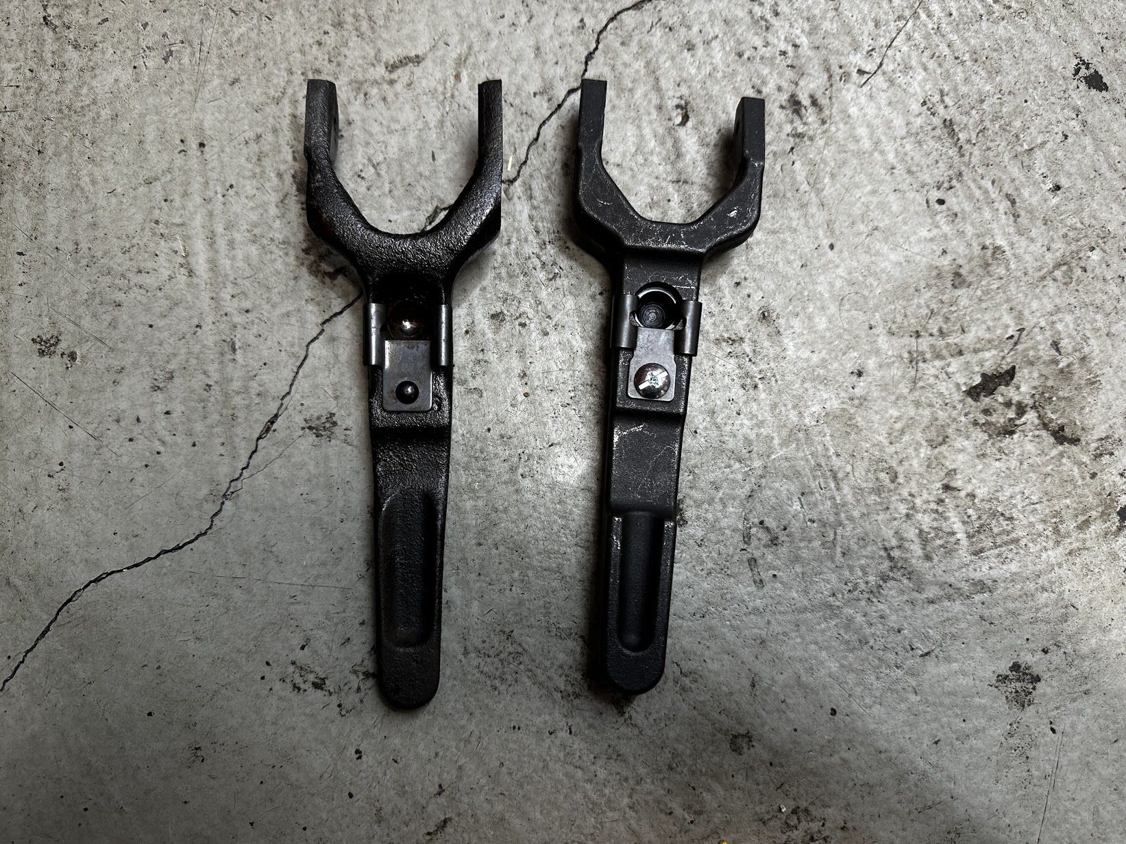

Second project was to tackle the clutch engagement. Decided to get a new competition clutch work and pivot. I pulled the trans and compared the old fork vs new, there was a bit of wear on the pivot side, also the hole that the slave pushes on is less shallow on the competition one, so it will have a bit extra engagement.
Haven't driven it yet, but it does seem a tad better.

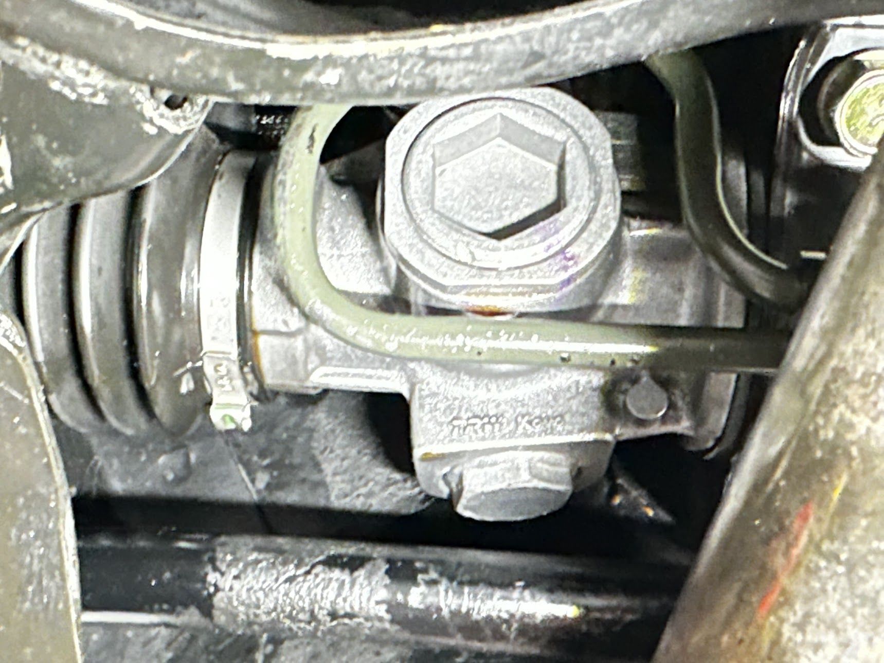

Still dealing with some leaks. Power steering hoses were all leaking, so I replaced them all.
Now the reman rack is leaking from the driver side seal :(, so ordered a warranty replacement.
