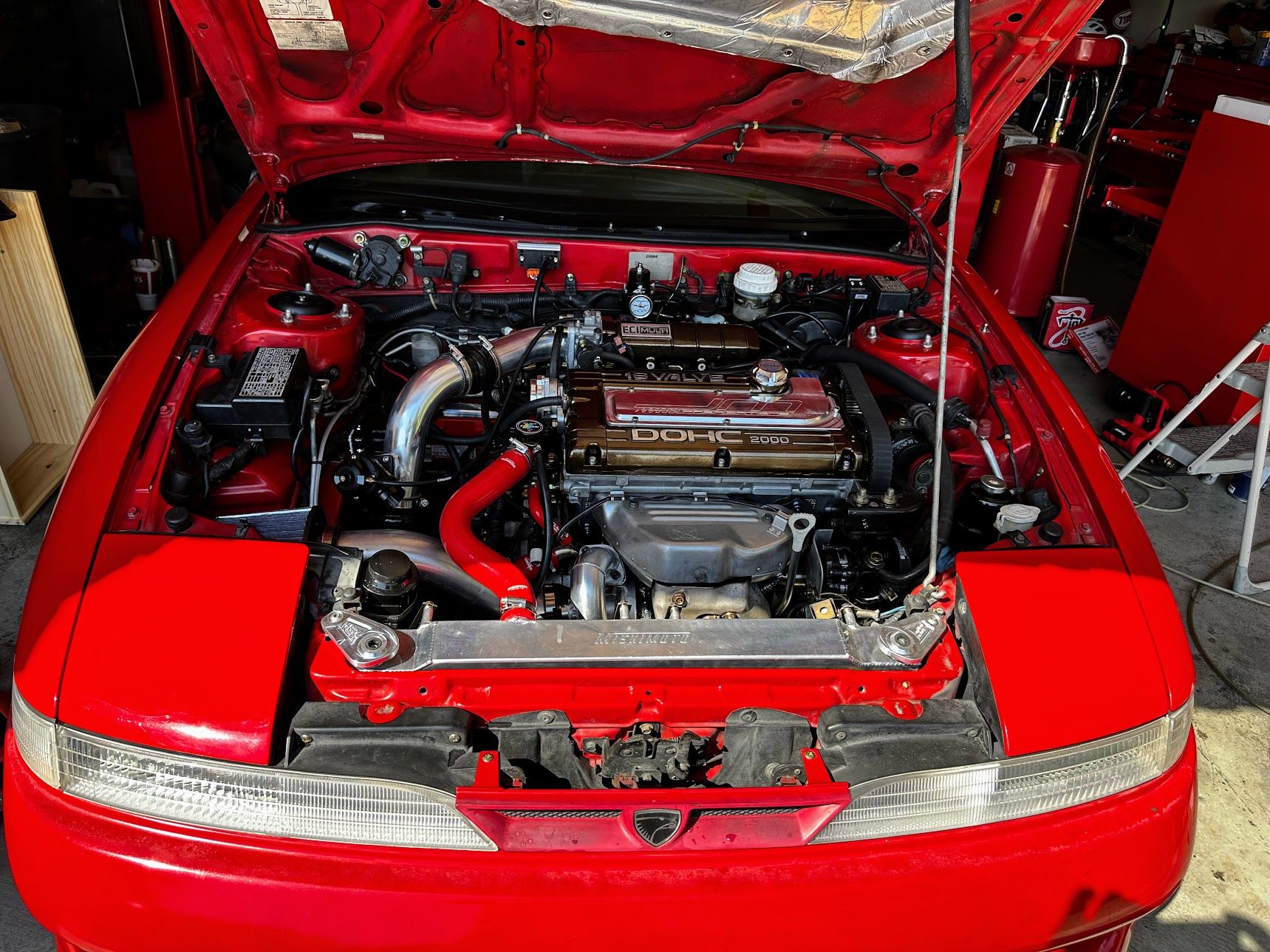

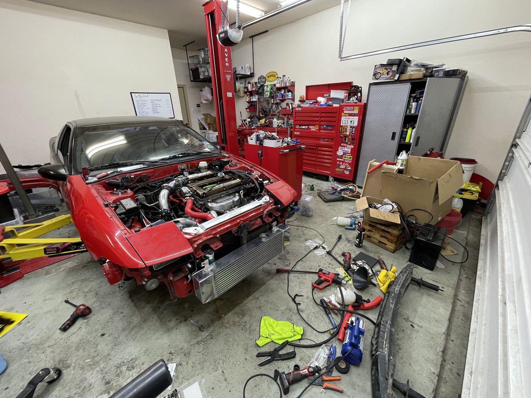

Got it fired up. Still had few minor things to finish.
Got wideband / boost gauge installed.

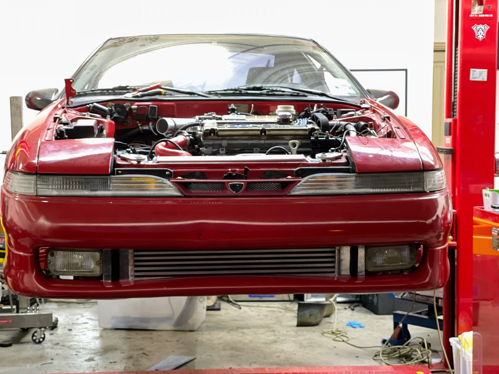

Got a bracket for MAP sensor and got new overflow bottle. Under hood all finished.

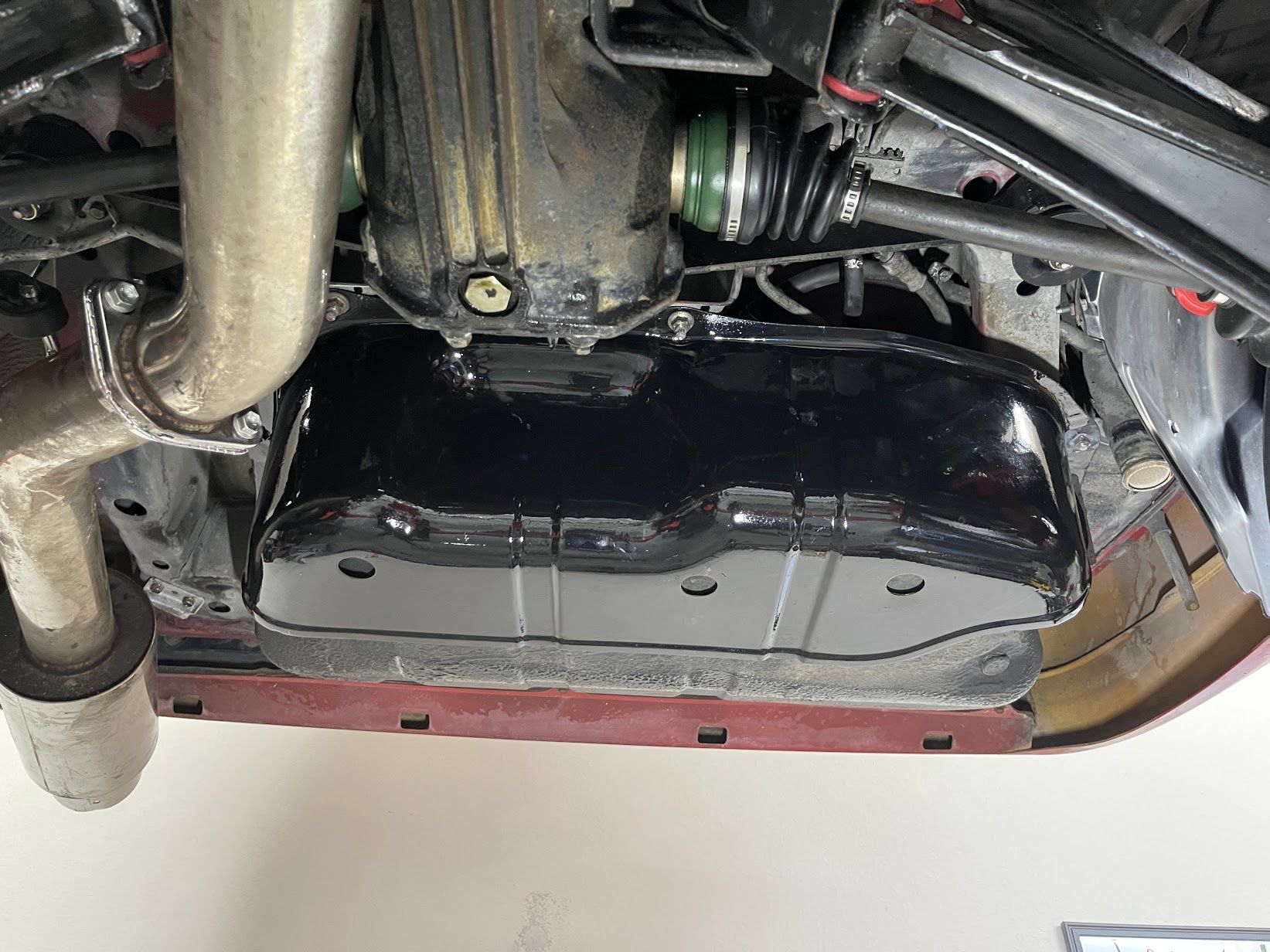

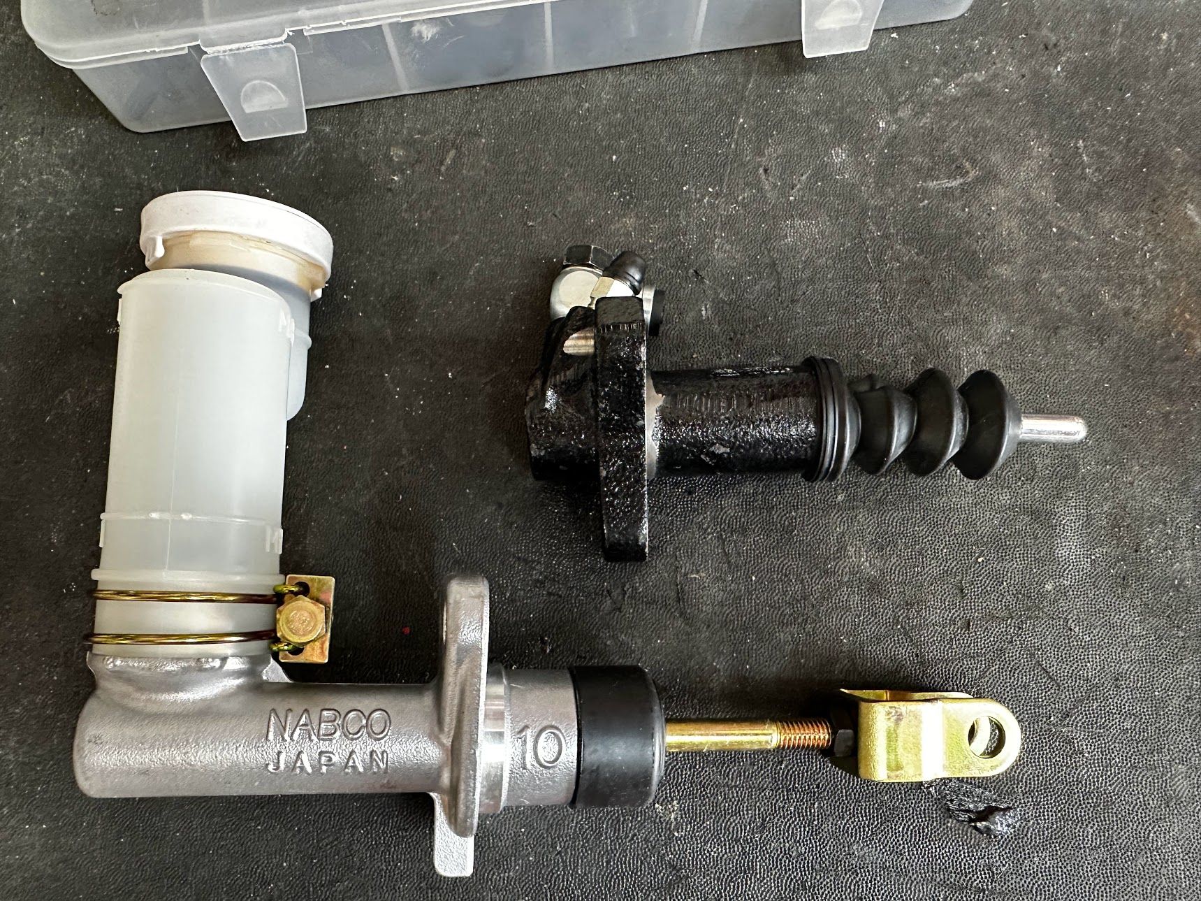

Car runs, but clutch engagement is shit. Grabs right of the floor. I bled it, but i used aftermarket slave and I think its crap. The fork is centered, master is adjusted. Bled slave as well. Will probably order oem mitsu slave. Also oil pan is leaking from both the drain line and around perimeter in 2 spots, I guess not enough RTV :(

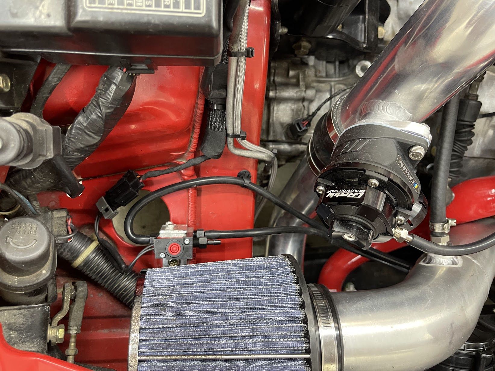

Went for the first drive. Put some E85 and had Rix Racing do some remote tuning. Did first pull and insta hit fuel cut and 42psi of boost LOL. The nipple of the wastegate was to close to the intake pipe and cut the line. Bent the nipple a bit and put a braided line and went for another pull. Not too bad, boost control is not dialed in, so only around 22-23 psi, but it's moving. 37lb/min airflow. AFR after some tweaking was 11.8 with E70 in the tank.
I still dont like the clutch / shift feel. Have an OEM master and Slave to install. Got an oil leak around the CAS, probably oring. Overall pretty happy, rest is minor shit.
