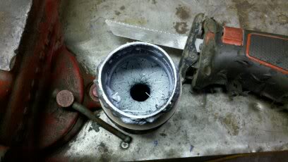

If you have enough exhaust back pressure post turbo your iMAP will be impacted too. Have you ever seen those collapsed flex sections? Could be something that simple.
97507d1432254415-why-do-all-aftermarket-downpipes-focus-have-flex-sections-x4kmqv-jpg.341998
I have open exhaust Cory, I blew the flapper out of the electric cutout....OMG but thank you for the information. I don't have that flex section, I have a Morrison Fab flex section that is hard piping.
