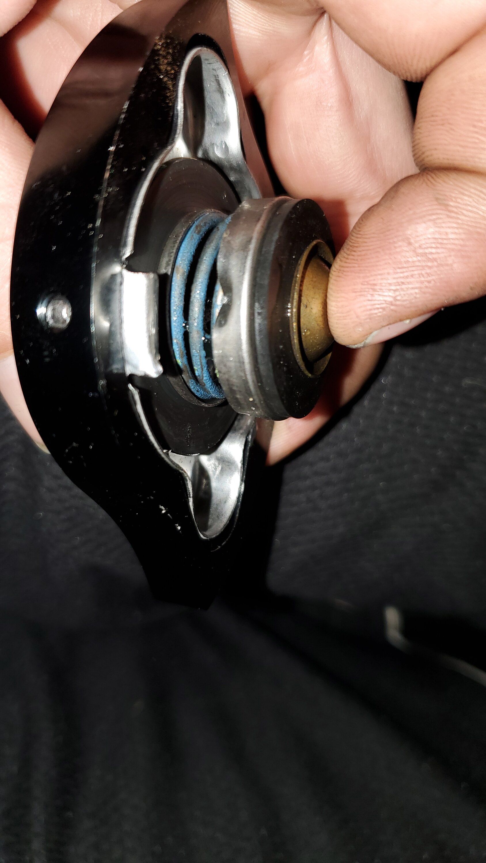

The cap has a plunger with spring responsible for creating the pressure in the cooling system. The pump just makes flow. If the cap plunger is pushed up by a pressure greater than the rating of the spring, it allows coolant past the plunger and through the small port on the water neck connected to the outlet hose for the res. tank.
If I am misunderstanding this... please clarify what I am not understanding properly

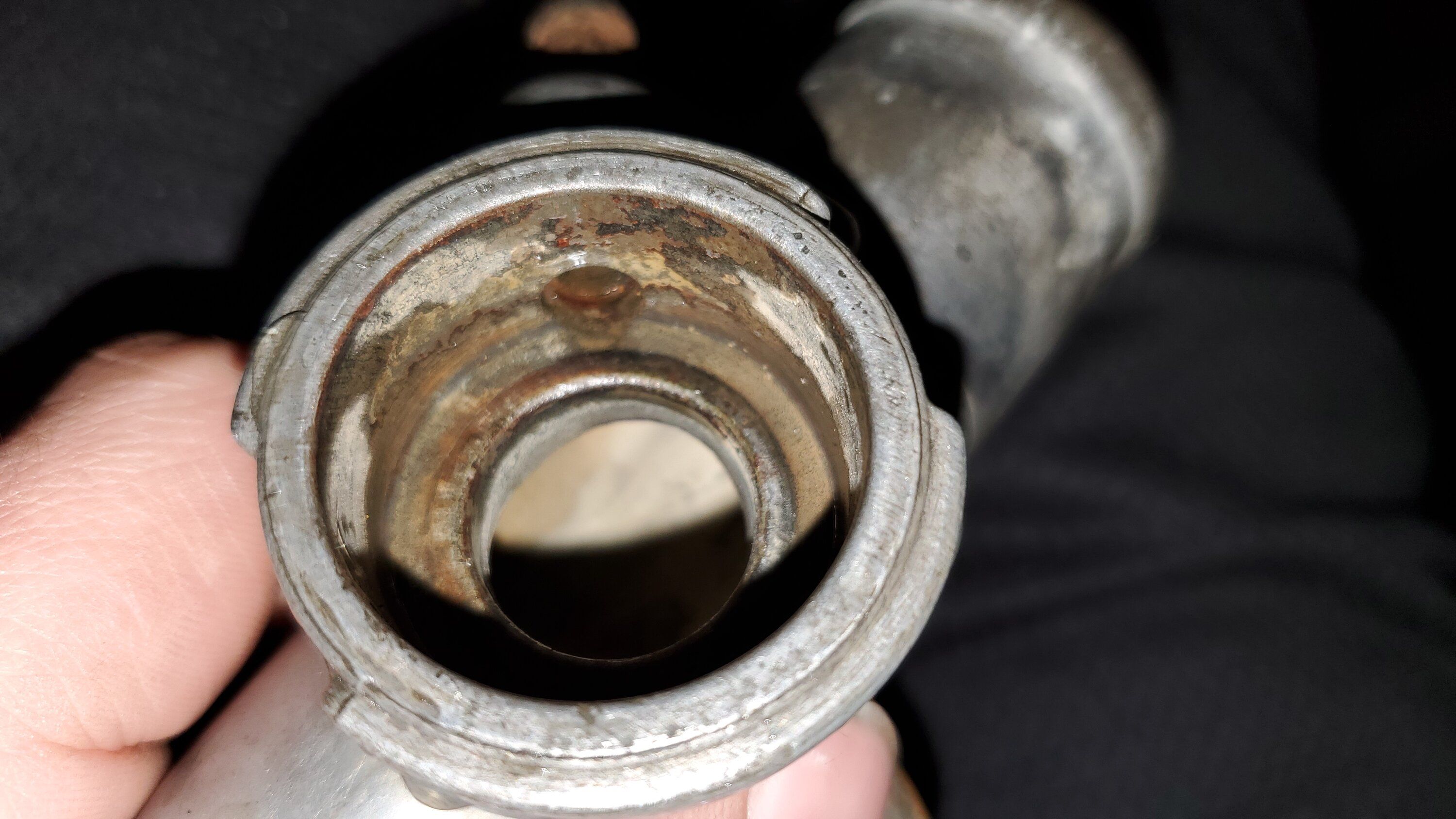

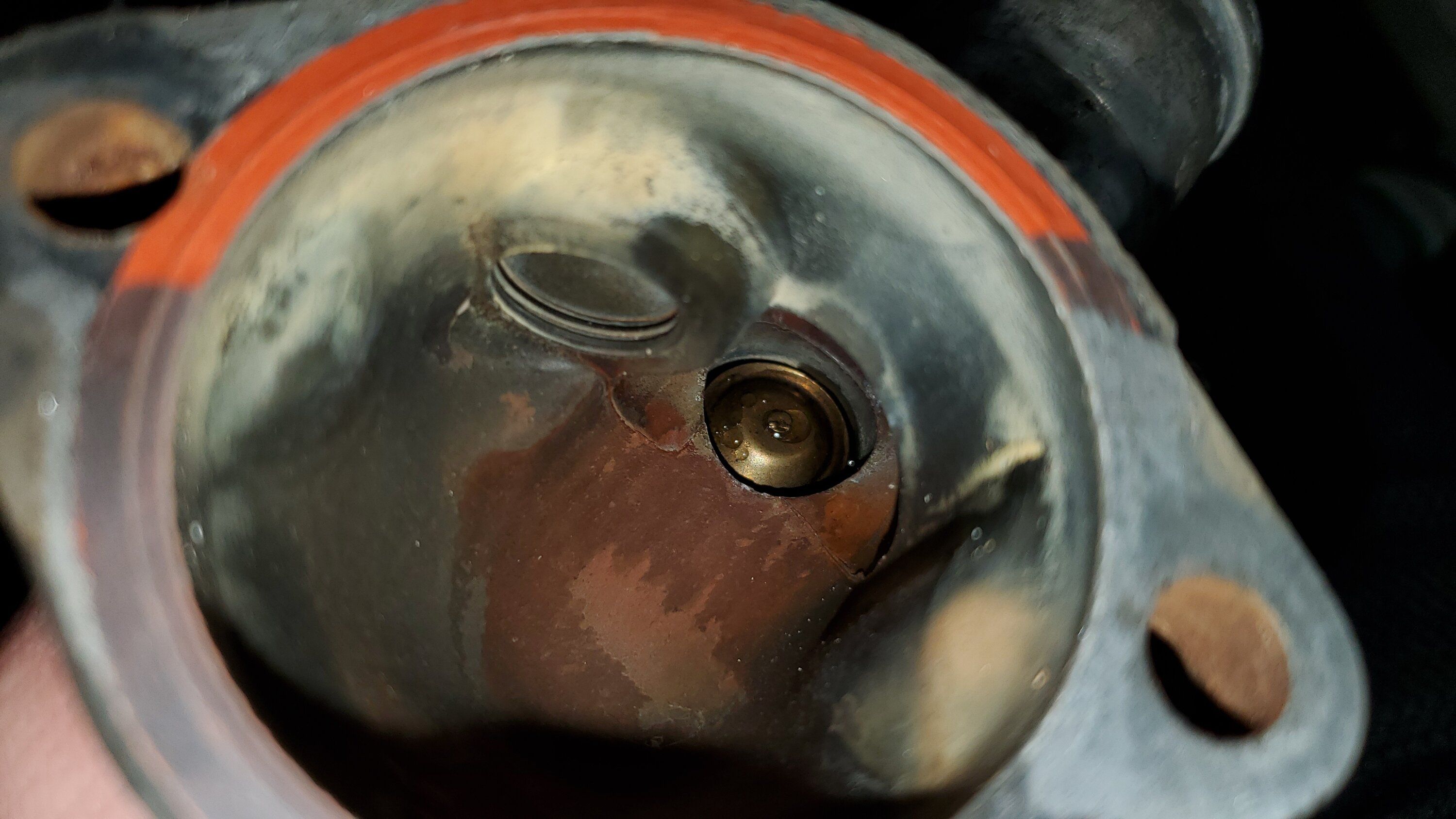

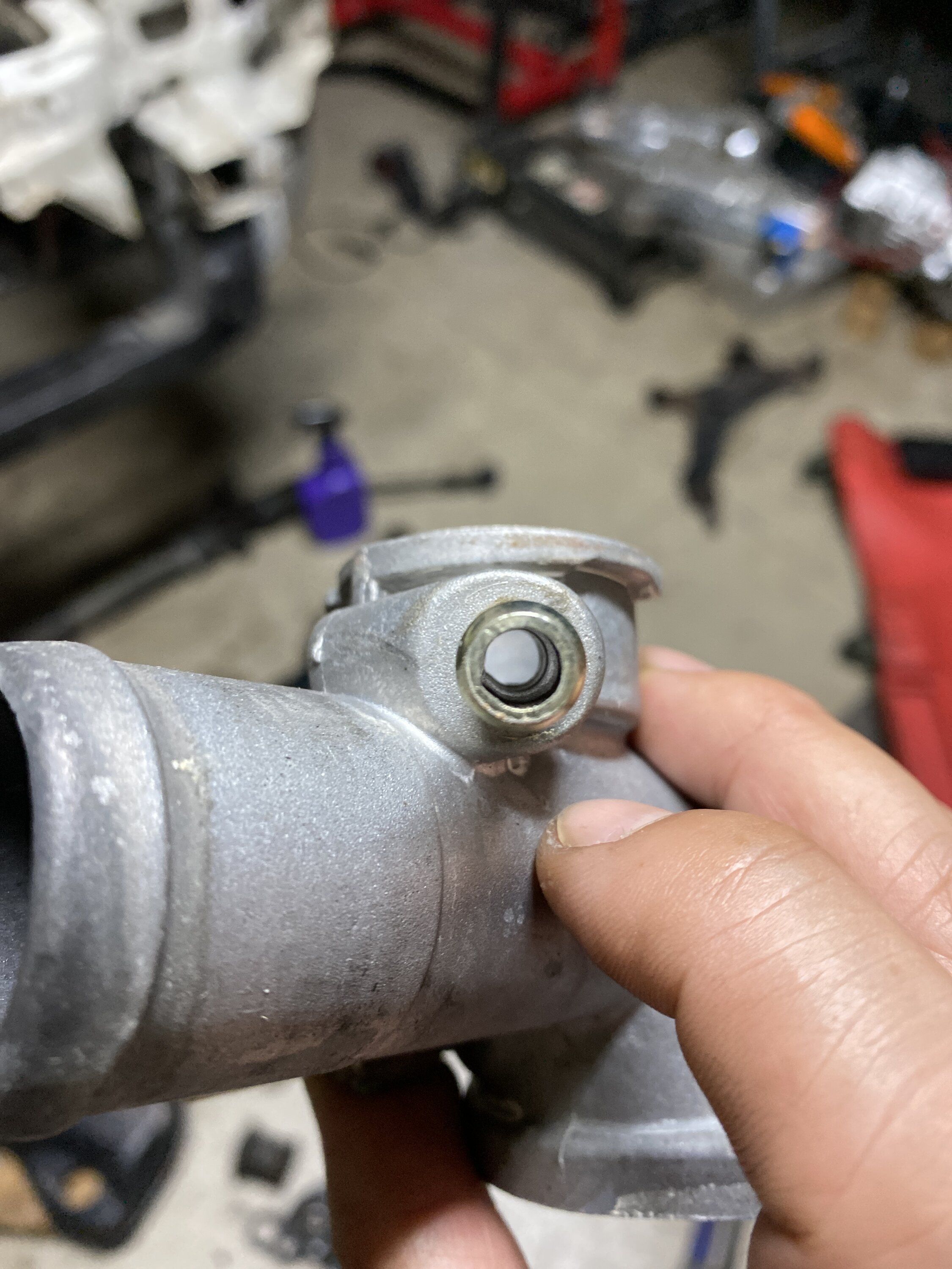

Here's a pic of the port, and from the other side, the water neck with cap installed showing the port blocked off when the cap is installed. The port should see zero pressure until the spring is overcome.
okay cool... I appreciate the sanity check anyway! I make lots of assumptions and have nobody to keep me in check but you guys LOL
Its weird that the cap is bypassing at 2 psi, because the cap tester adapter says it is sealing to 19 psi. So I am going to buy a new water neck and see if I can get a cap to seal better on it. This one is between 26-30 years old... so it might just be worn in a way that isnt allowing the cap to seal. I dont see any obvious trouble on the one I have installed right now, but clearly something isn't right.
If 2 psi is pushing coolant into the res. I def need to fix that issue before I do anything else.

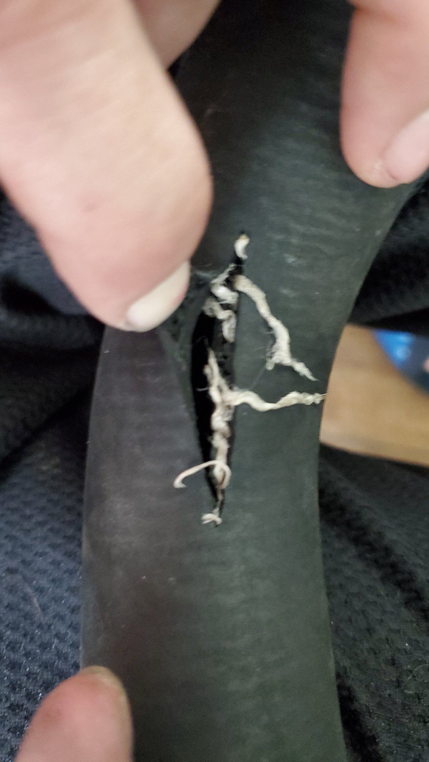

Blew a 2 inch slit into the lower rad hose... Something is very very wrong with this car LOL
This hose was new this summer... There must have been a ton of pressure to do that. Holy crap... I am not even sure this is a hg issue but I cant drive it around anymore... Time to park it until I figure it out and fix it with confidence. Going to repeat the leak down test when my buddy drops the car off... still on his trailer...

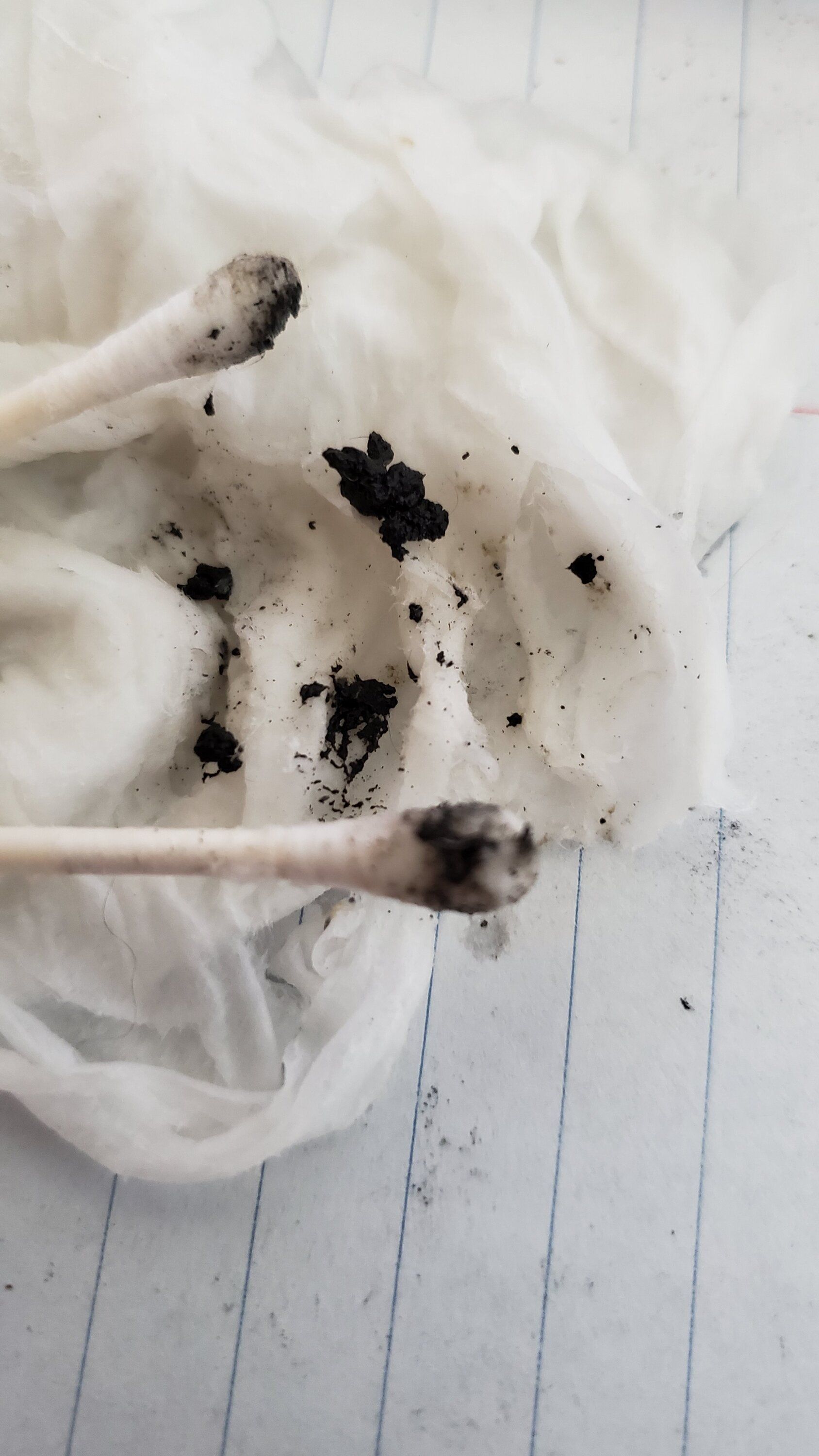

Today I used some degreaser on the inside of the radiator, letting it sit for a while then flushing repeatedly. I ended up getting a LOT of what looks (and smells) like dissolving rubber inside the rad. My initial tests were all from top to bottom, and I never saw much come out of the rad but water. But in my flushing today I turned it upside down and was appalled to see a shitload of black shit flowing out of the rad. There was way too much to think about re-using this radiator, and I am confident that EVERYTHING needs to be flushed really well. Even after all my efforts trying to flush it, it still has blocked tubes requiring turning it over to get the last of the water out...
Going to borrow the rad from the other 2g for a little while. I am not going to put the L19s in until I confirm this wasn't all just a really bad flowing radiator issue (and with blocked tubes - potentially trapped air issues). If I do both at the same time and it fixes it, I wont know if the radiator being plugged was causing issues or just making things worse!
The black shit:
The hose that split:
I cut the hose down the length to inspect the inside and saw zero signs of imperfections... based on a reverse flush getting the rubber out, I'd assume the top hose was the deteriorating one anyway.
