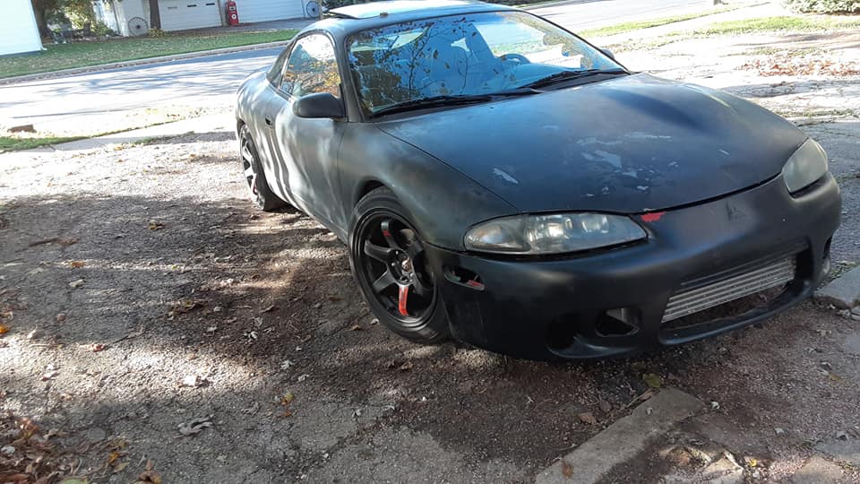

It is complete. It does run - rough. Owner parked it 2 yrs ago due to "weird noises at WOT". I have to assume the motor is junk - if its not, BONUS! The car is a red eclipse spyder GST automatic. Clean bodied minus some strut tower rust. pretty clean black and tan interior! It has some minor mods, nothing crazy. Lots of little go fast parts that are still good, but I dont need them.
I may use the turbo off of it to make the black car complete/running. It is just a 14b and the black car came with a blown 50 trim, so its a downgrade, but if it works...
Still hard to say what the plan is on either of them. I just know that I couldn't pass on the price of either.

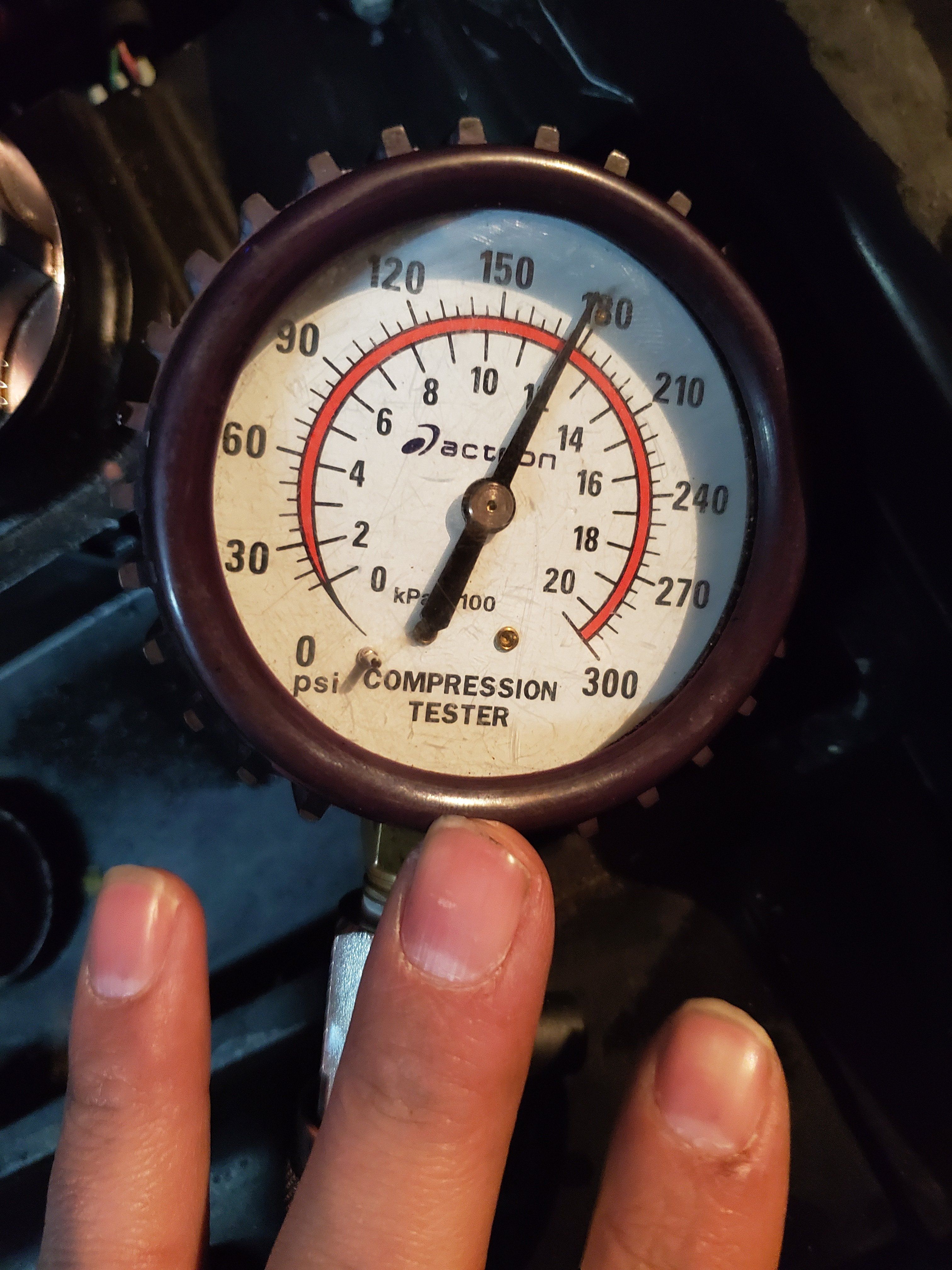

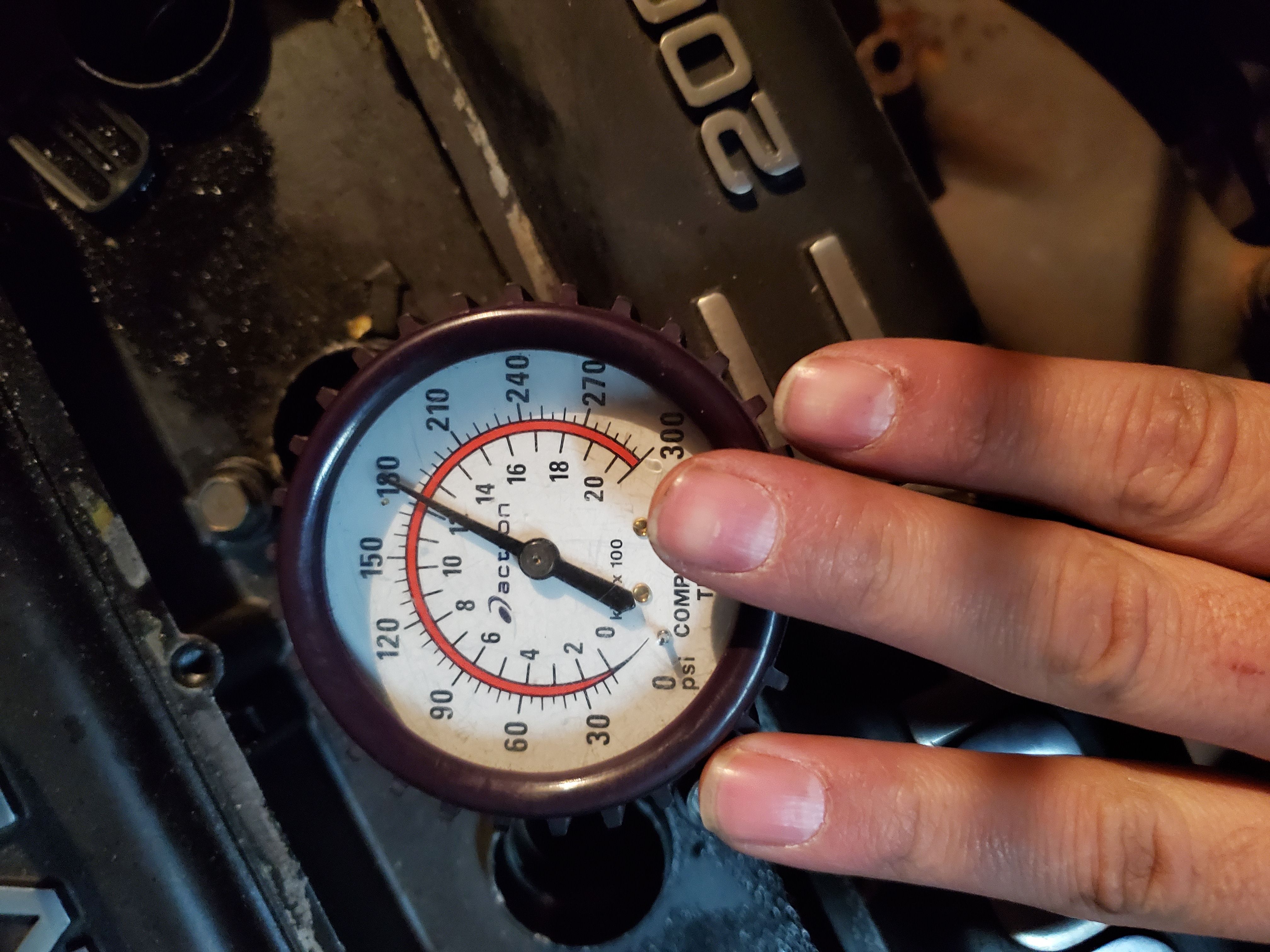

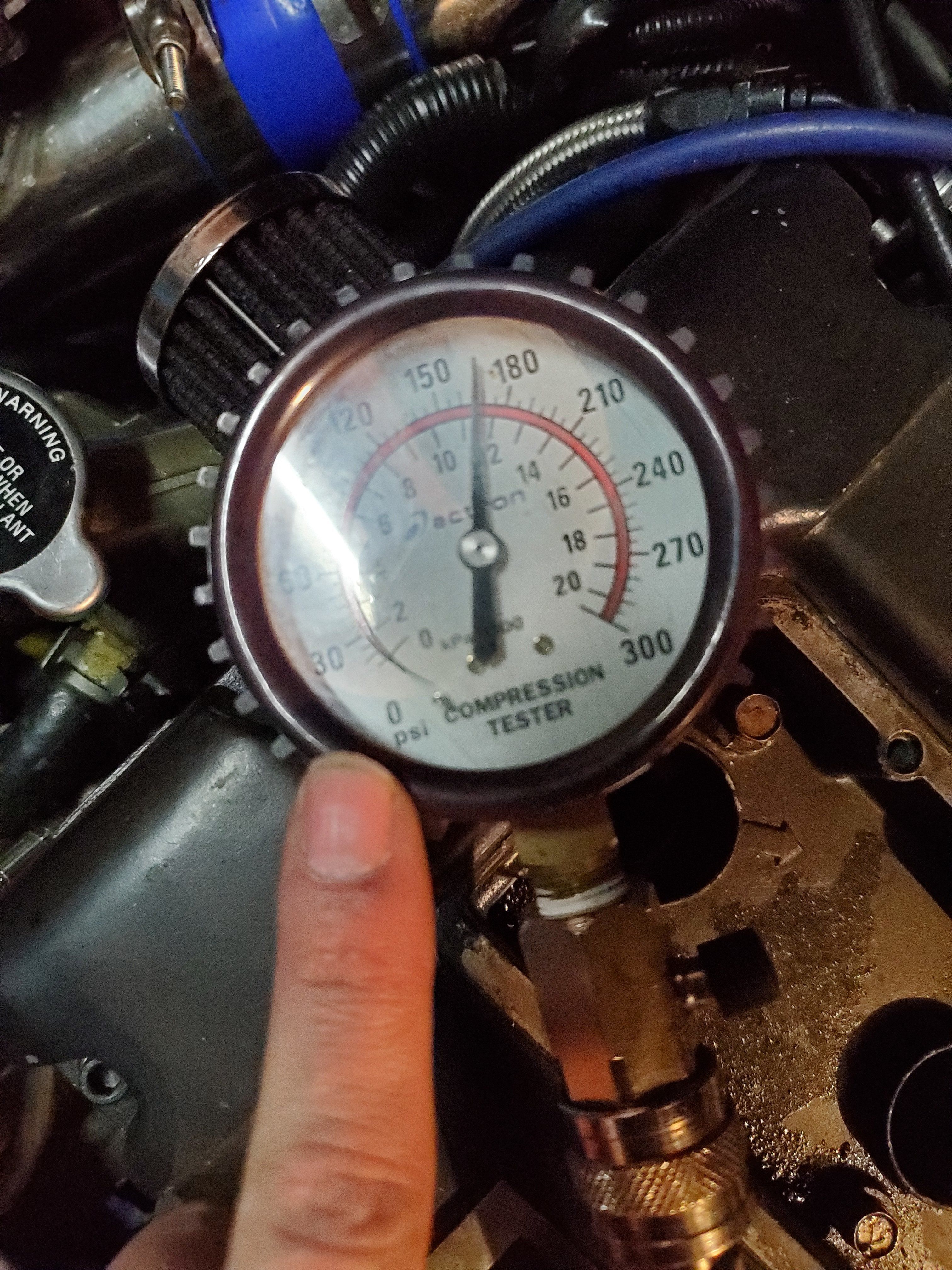

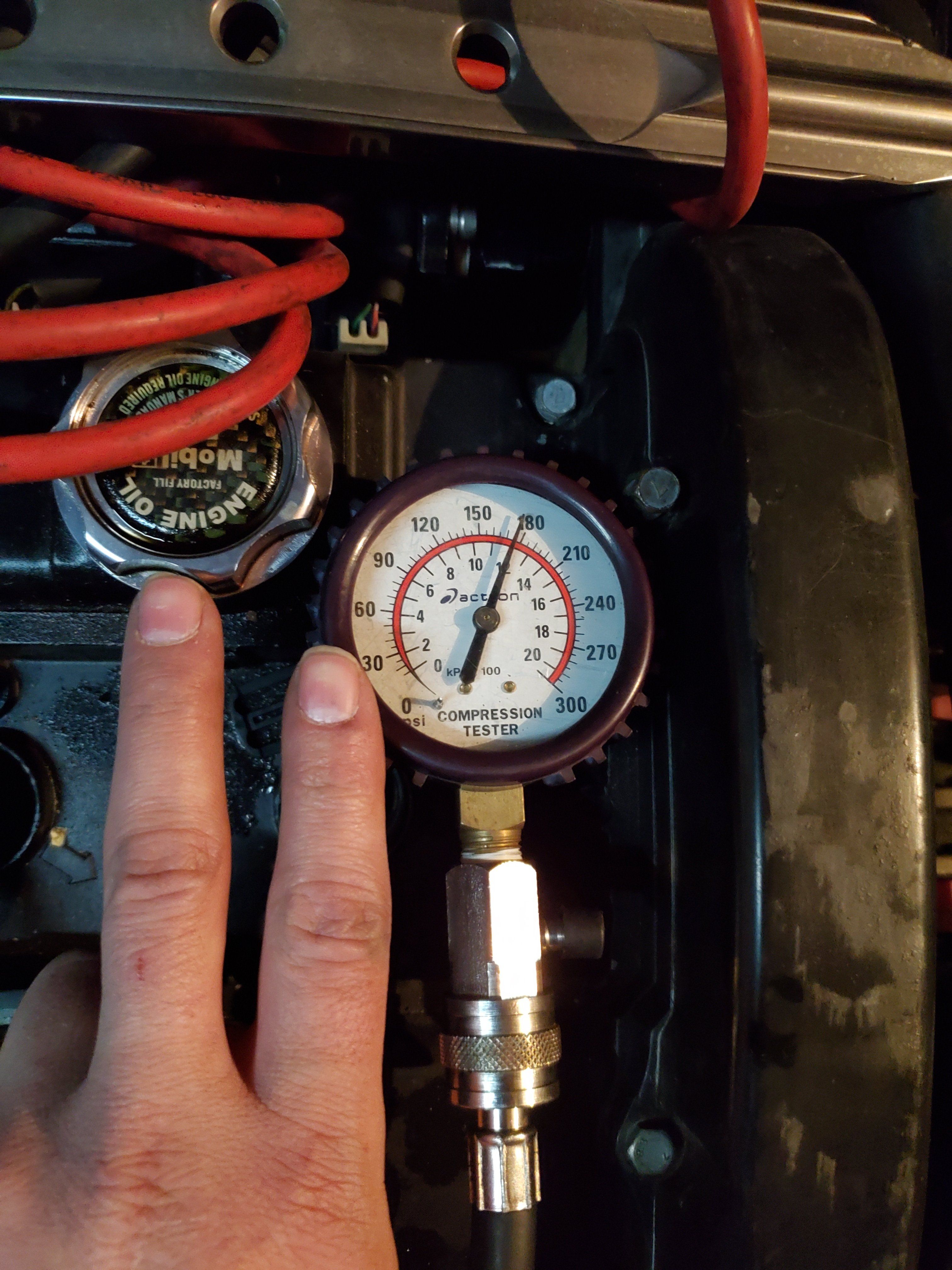

I managed to do a quick compression check on this thing and I am pretty okay with the results. The pics are attached. 180ish on 234. 166 on cyl 1. These are cold numbers. I would prefer to see 180 across the board, but the weak cylinder is only down about 8%. Not too bad if the 140k odometer is correct. I plan to do a leakdown test tomorrow.

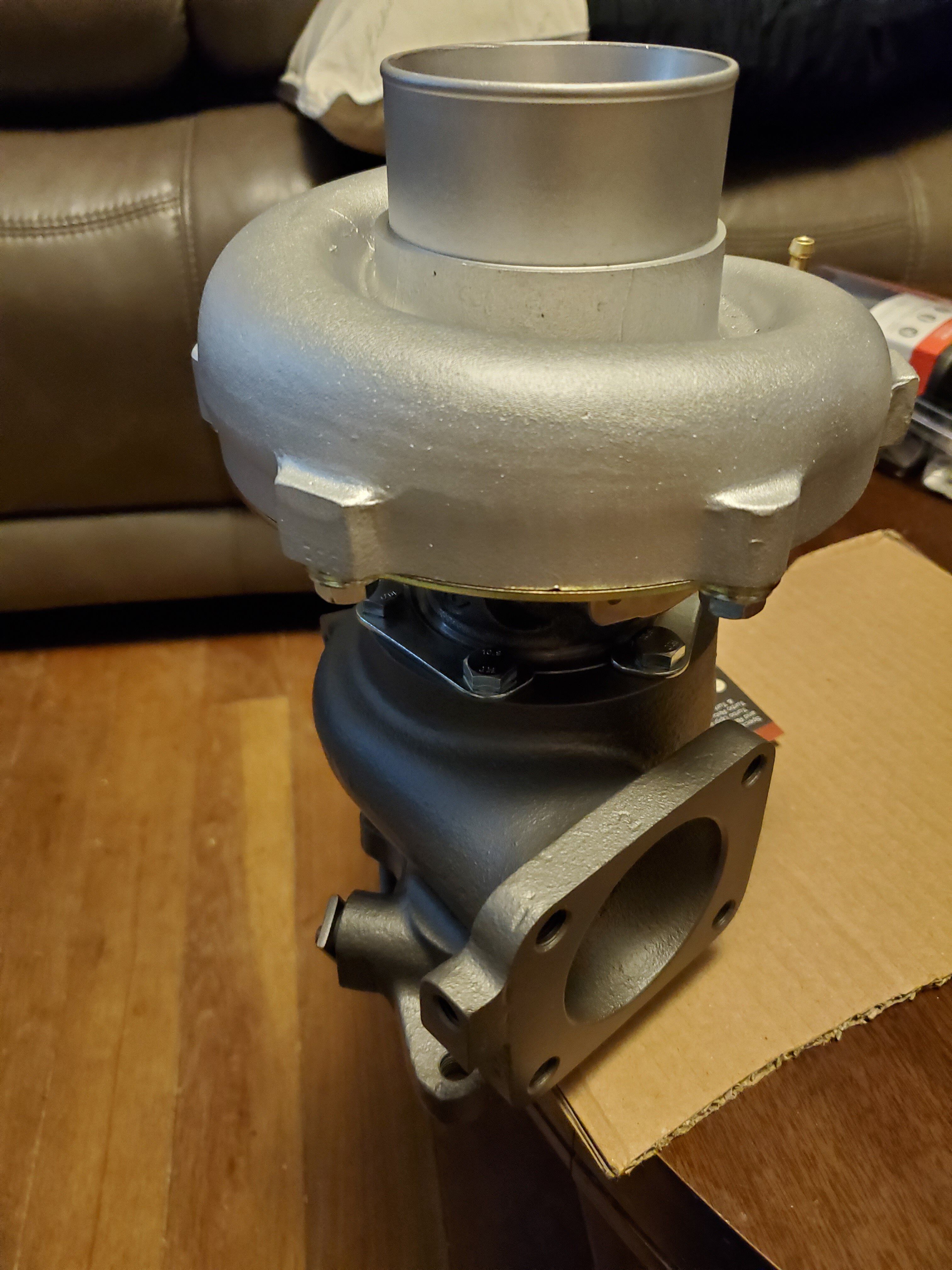

I didnt get anything else done really with the exception of a closer inspection of the turbo. The compressor fins are chewed, but the housing doesnt seem all that bad. Its bad tho. I am going to pull off the turbo tomorrow and rip it apart to see what it needs. its a precision 50 trim with dsm flanged hotside. From my google research I can use a standard 6.35mm shaft t3/t4 turbo rebuild kit designed for precision turbos. But that is assuming there is anything worth saving on this worn out old turbo.
Sorry for no interesting pics of turbo carnage! I will take a few tomorrow when I rip into this turbo. I expect to find a mess, and consequently may "downgrade" to an evo 16g. I DO NOT want to build this car right now. I DO want to stop it from smoking so bad when I play musical cars. Its like the oil feed hose could have skipped a step and plumbed directly into the exhaust housing... :ohdamn:
The pics were suppose to be labelled by number of fingers, but number 4 cut off one. The horizontal 3 fingers is 4. The more vertical one is actually 3.
