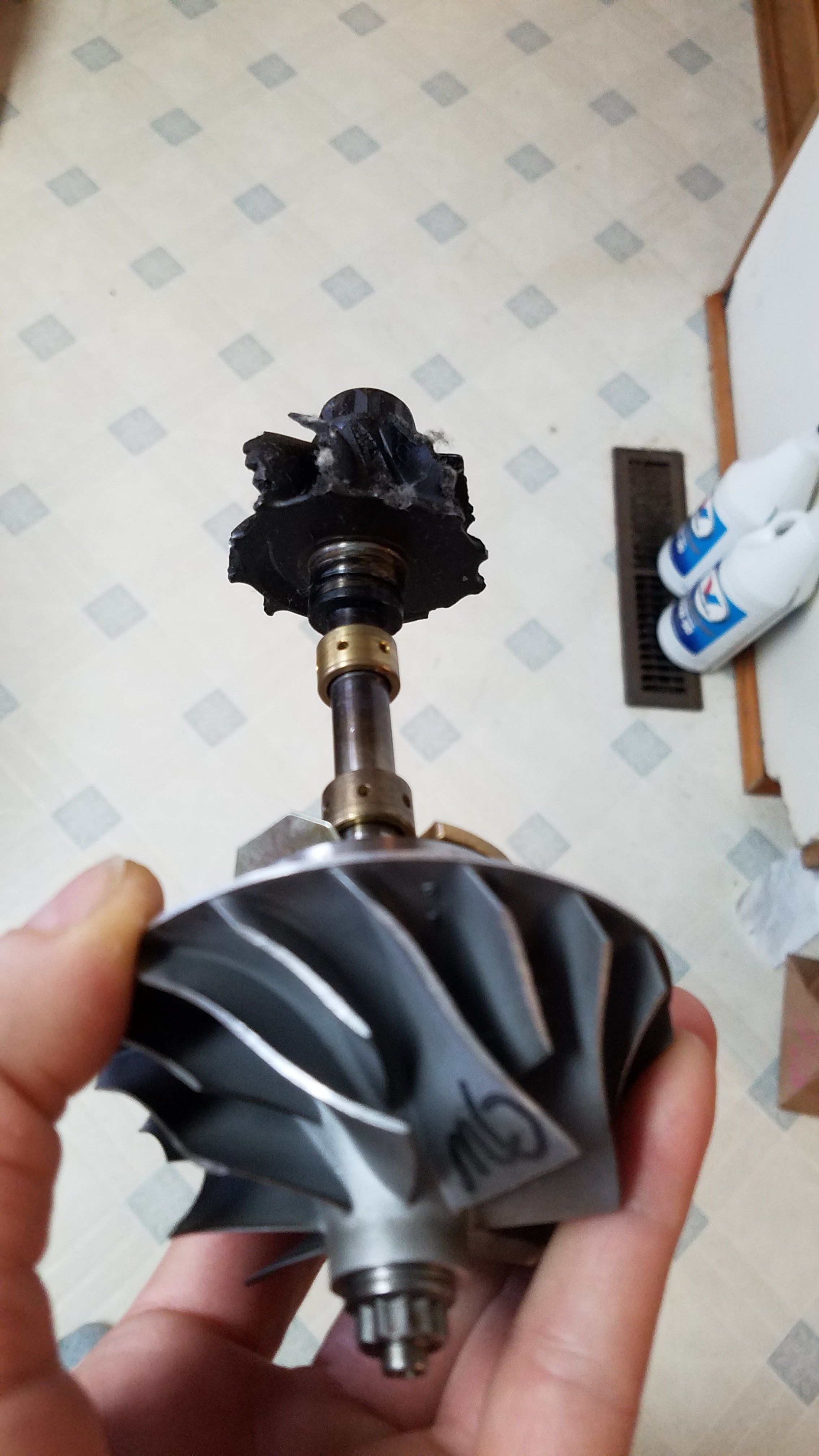

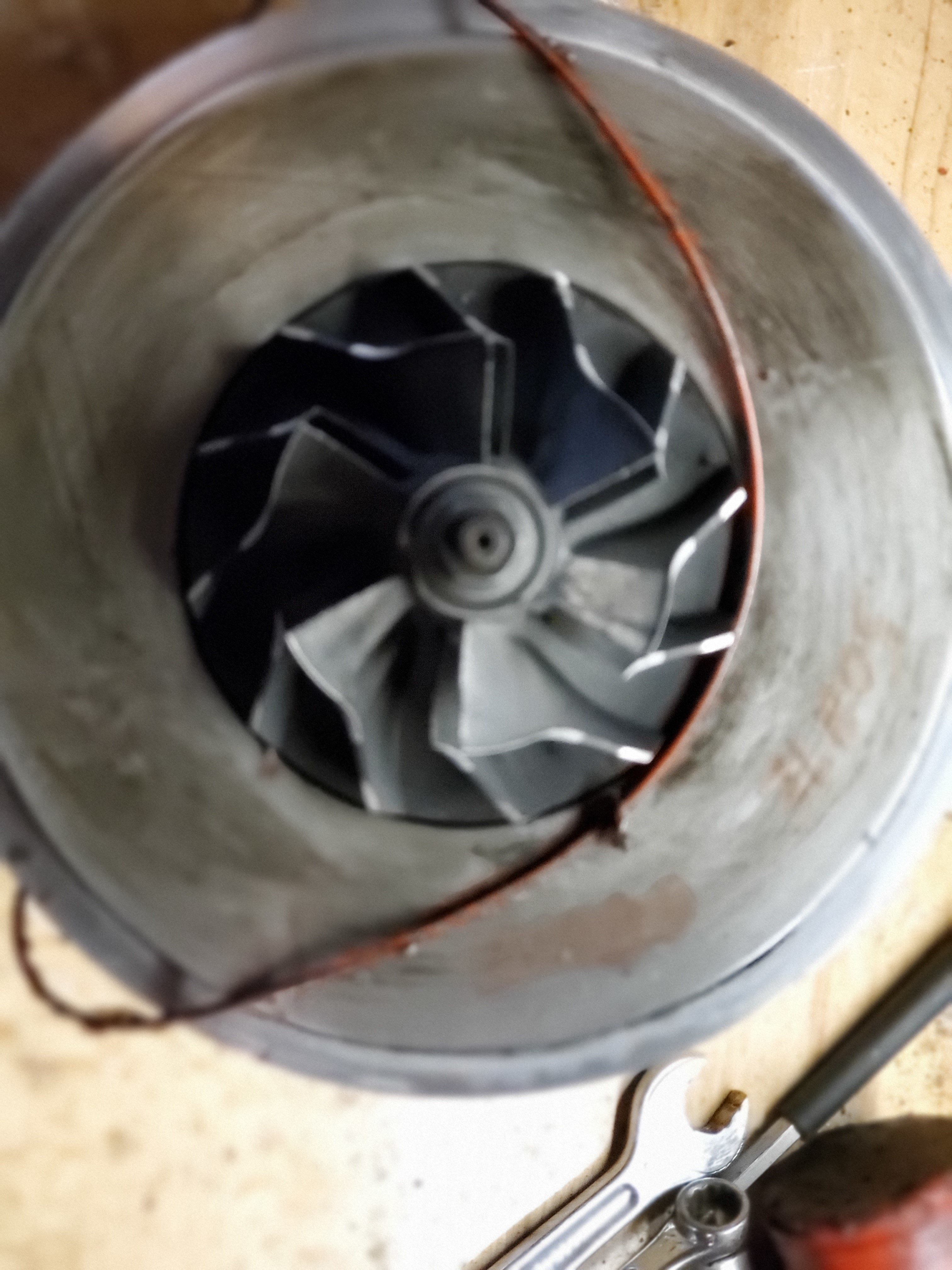

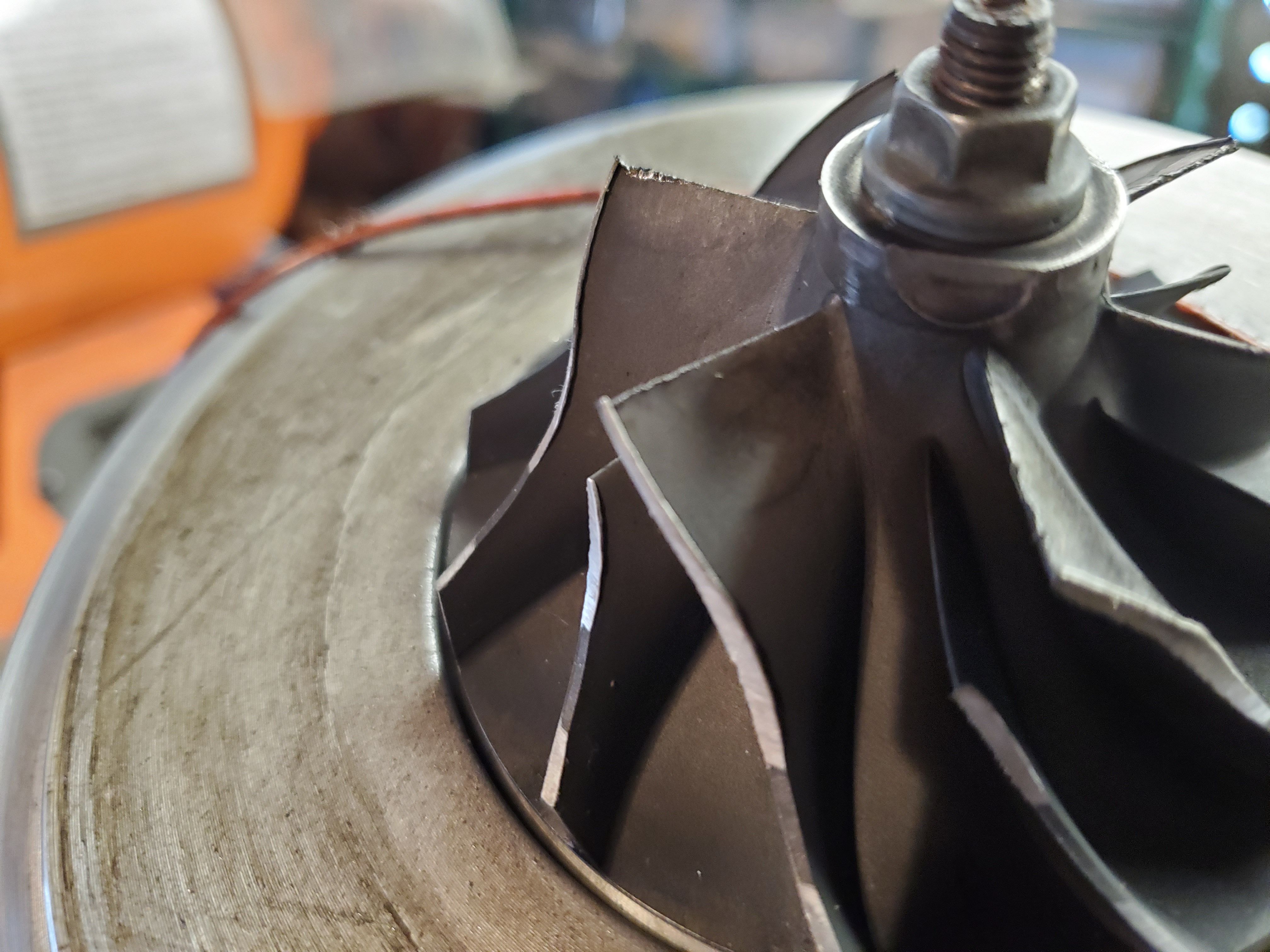

Okay so I pulled the turbo. Oil and dirt and grime.
The comp wheel is toast. Housing isn't great but probably usable. I can still see machining lines under the contacting area. I am trying to find a new shaft/turbine wheel, because it has some minor contact as well. It's probably usable but not ideal.
If I can't find the turbine shaft I will probably clean it up and put a new comp wheel and rebuild kit into it. Should work okay, but it wont be perfect.

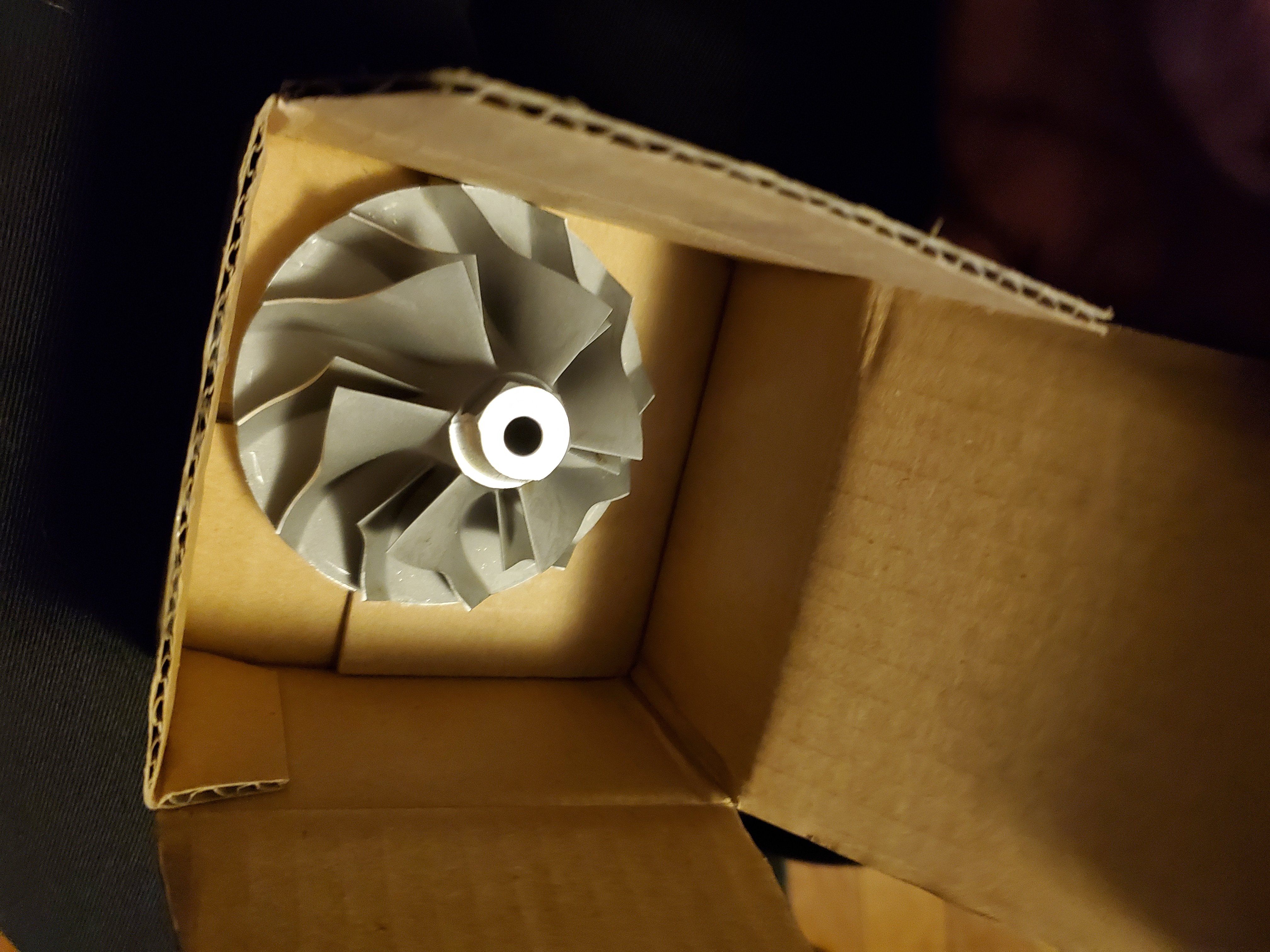

Ordered: 1 kinugawa t3 turbine shaft, 1 kinugawa t04e compressor wheel, 1 turbo lab America rebuild kit. Looking for local places to balance it. There is a place in northwestern wisconsin that does it for $55, but that means another week probably.

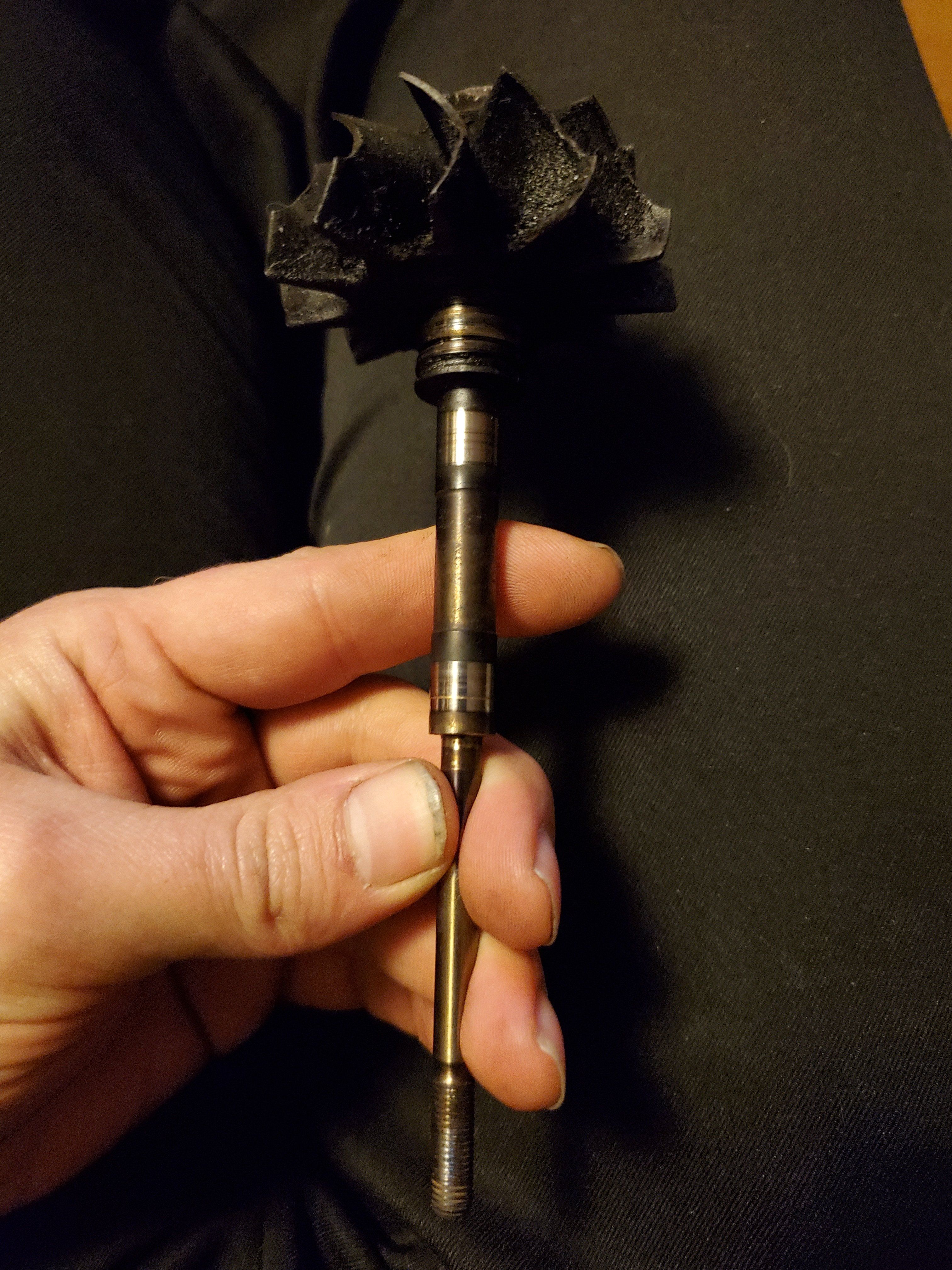

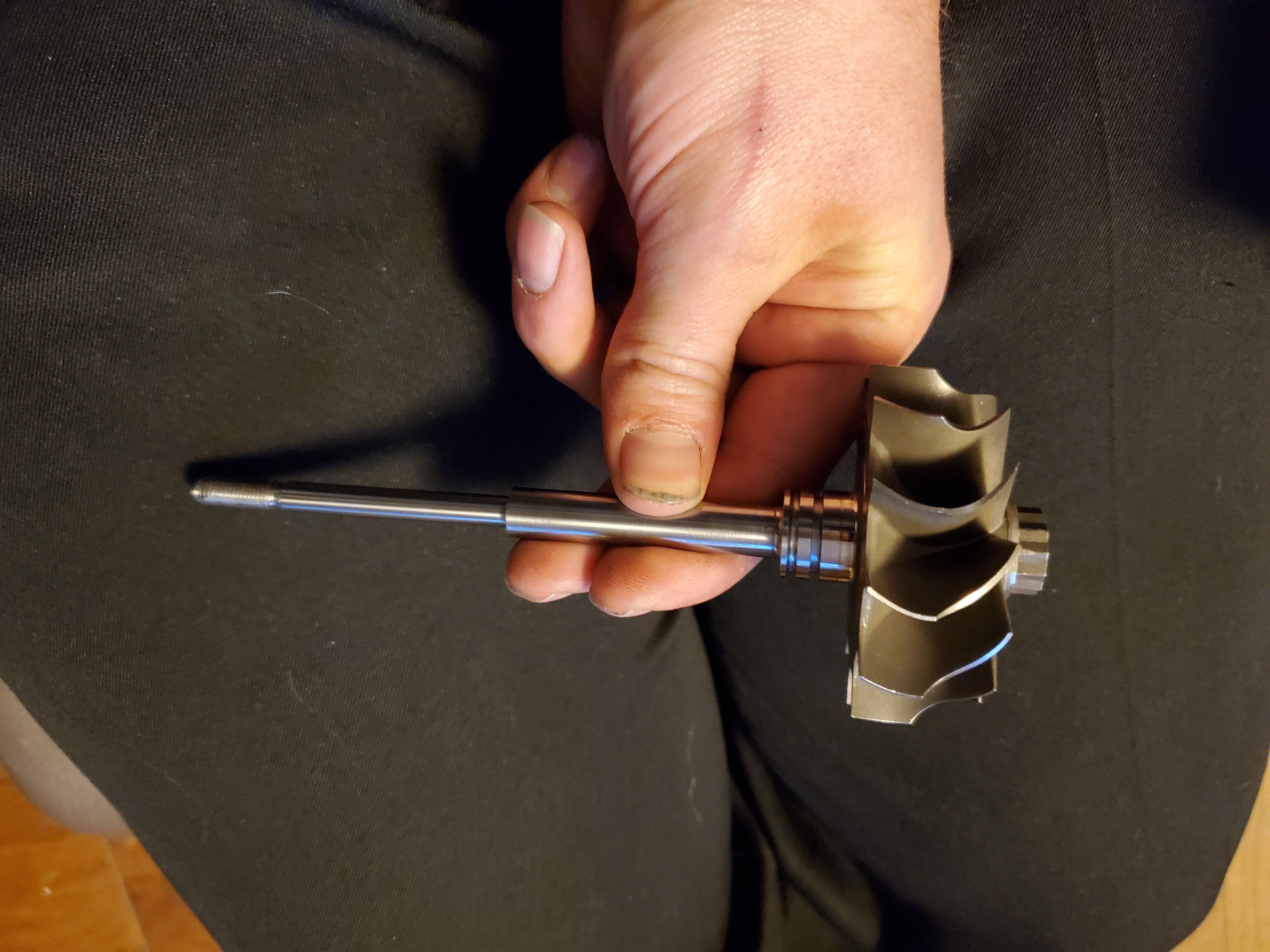

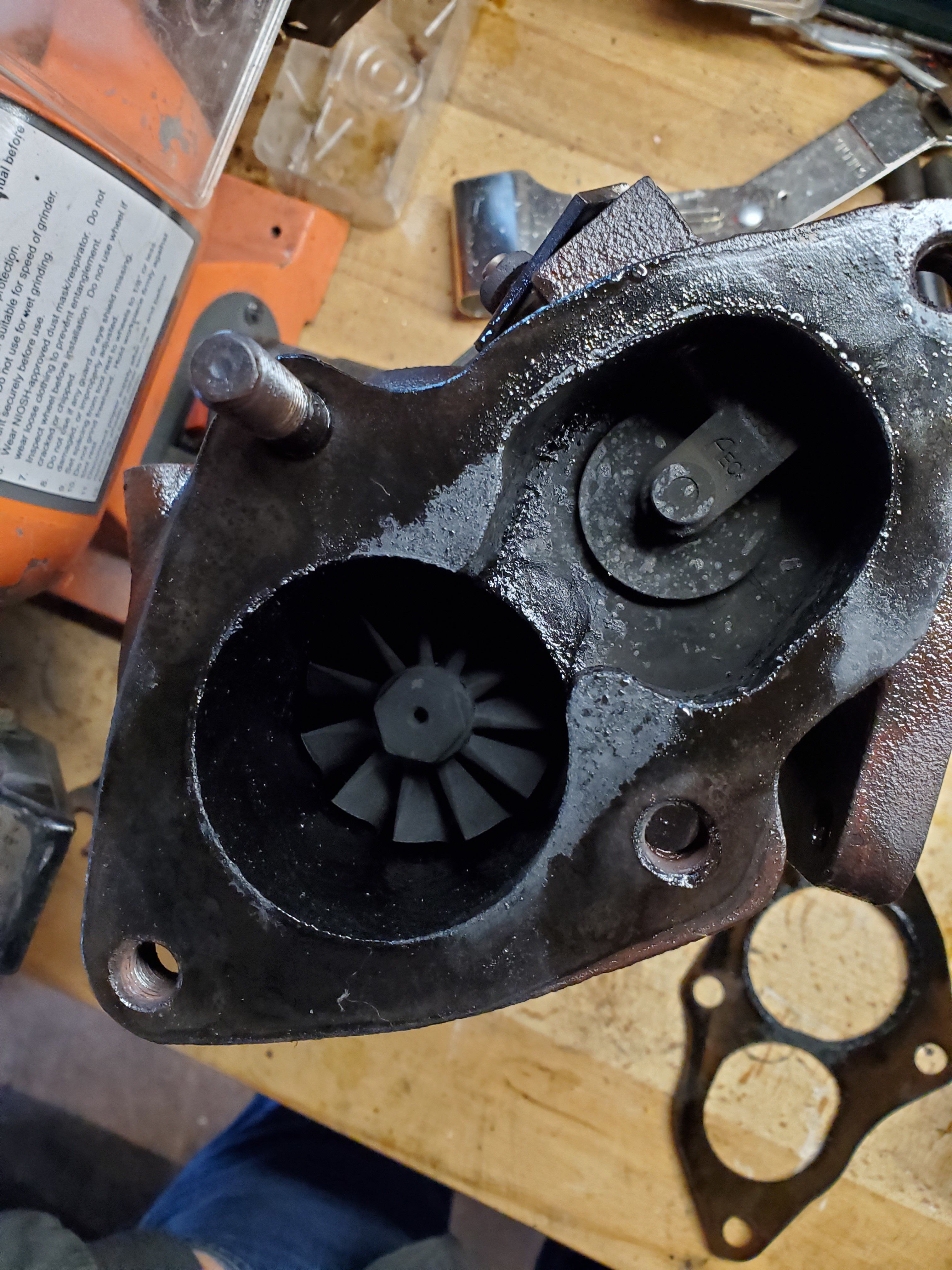

It's a Precision DSM flanged turbine housing, 50 trim compressor.
I ended up with the wrong turbine for this turbo when sourcing components for rebuild. Now I am trying to figure out if this housing can be machined to accept the turbine wheel I have.
Alternatively I could swap it to T3 housing of proper size, but that would require a new manifold, o2 housing, and likely some exhaust rework. Also considering cutting my losses and buying a used 16g, which should be an easy swap.
The compressor wheel I found is correct, as is the rebuild kit.
This turbine is 56x65 and the original is 51x65. Shit!
After speaking with G-pop shop the best plan of action for saving this turbo is likely going to be sending it off to them. I suspect some material from the turbine wheel has deposited itself into the turbine housing bore (it doesnt seem to match any available wheels and seems possible judging by surface finish inside the bore). They said that is possible, and it can be cleaned up on a lathe. They also carry the replacement turbine, so they could do all the work needed to "save" this turbo.

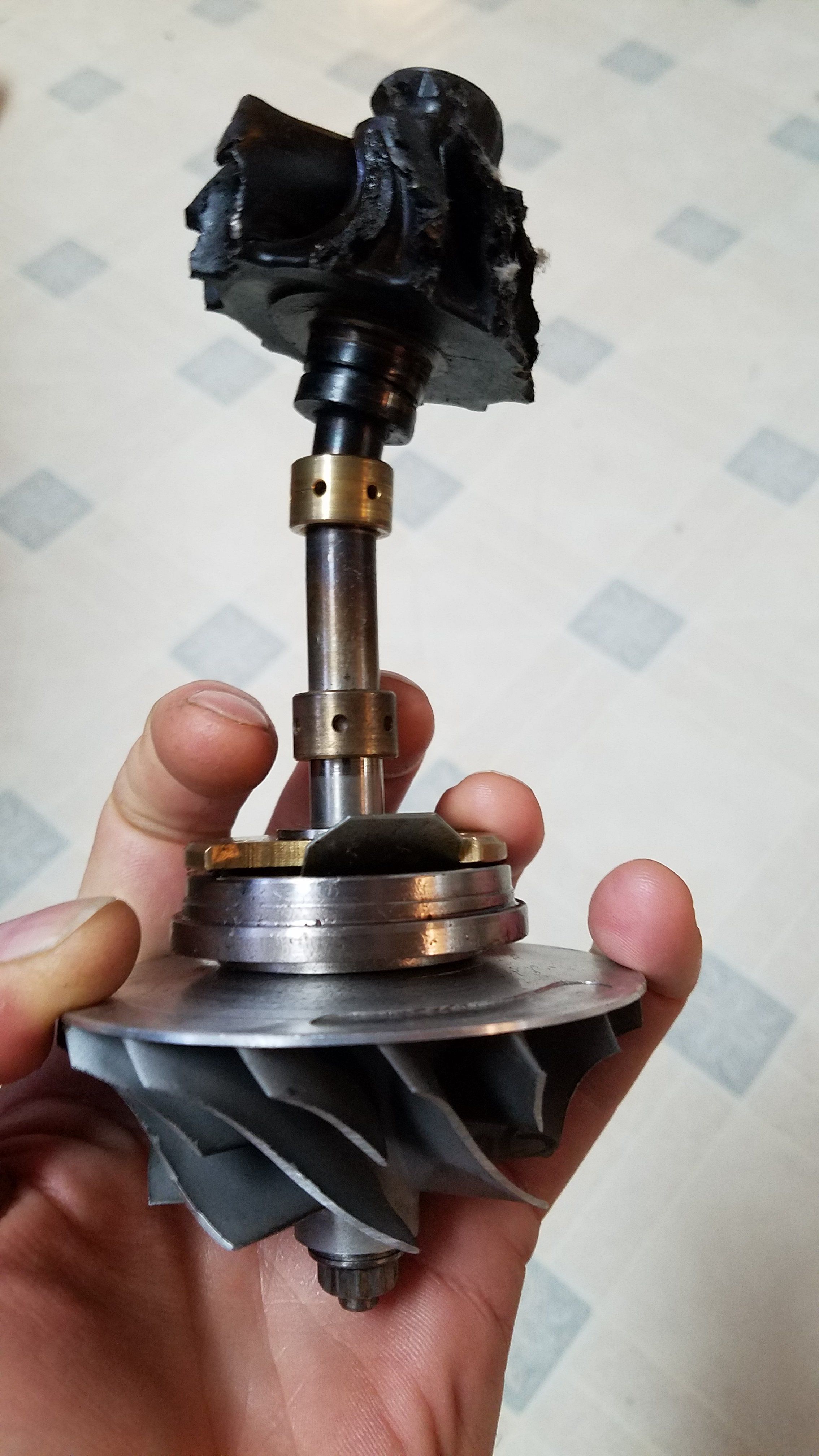

Sorry for no interesting pics of turbo carnage! I will take a few tomorrow when I rip into this turbo.
Heres some turbo carnage so you have a picture....ROFL
Jesus, that is incredible!
