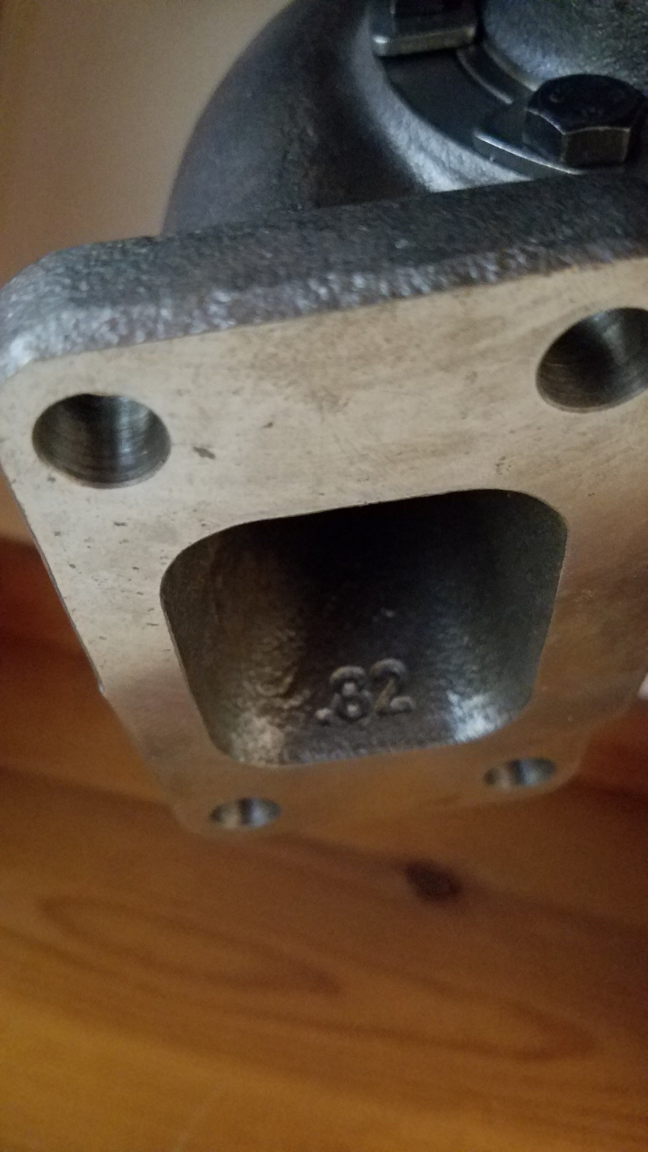

Wait, I see fp manifold in your pics, correct? So that's the DSM bep housing? I only see those in .55 a/r. The t3 bep is .70 a/r. Are you sure your housing is .70?
If its .55 dsm bep housing I am worried about it being late still... how late?
.82 T3 open.

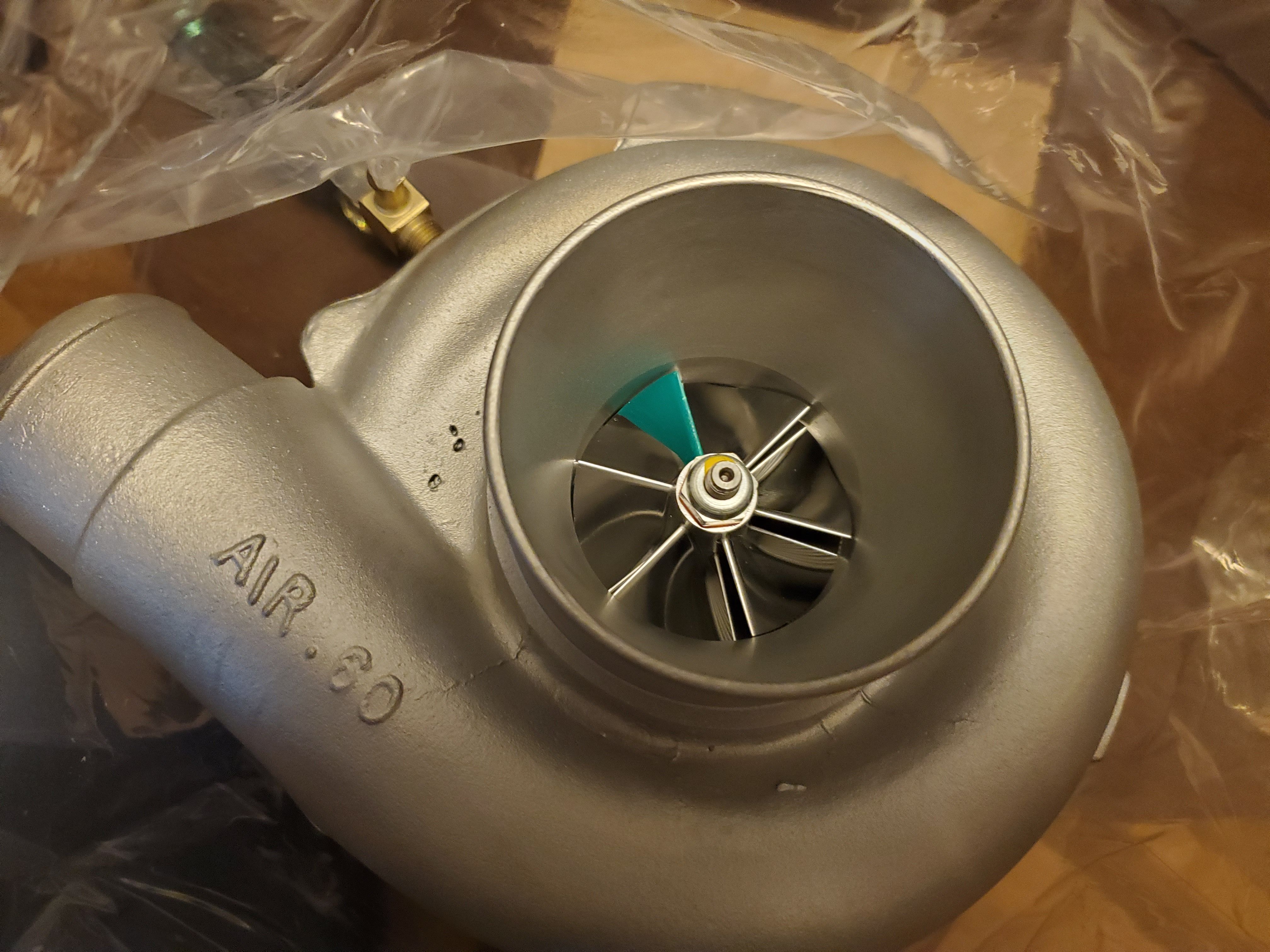

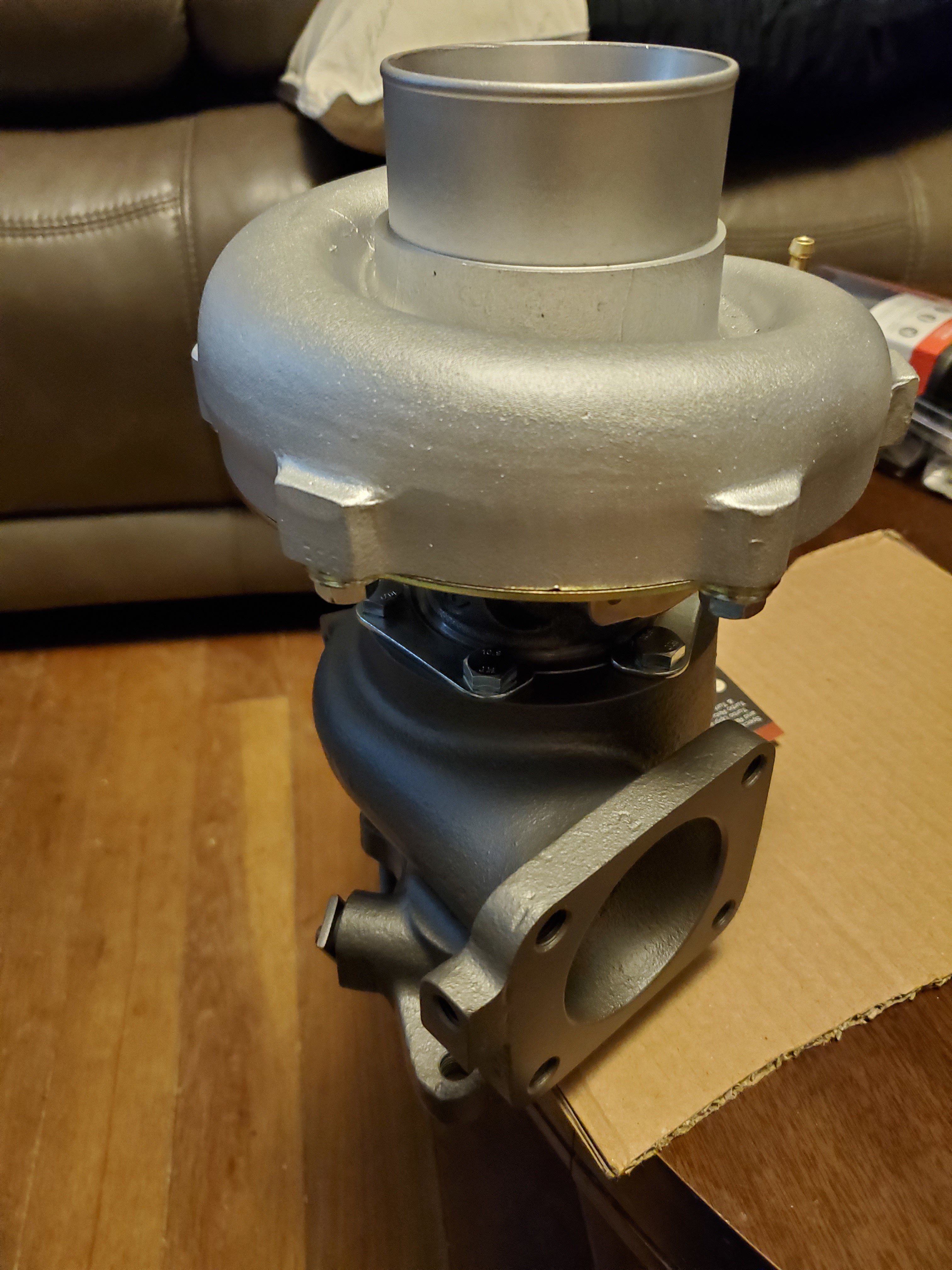

Awaiting the return shipment from g-pop shop for my pte 50 trim that came on this car. I went with the new chra and billet compressor wheel on my end housings. Can't wait to see it.
The holset appears to be a fake so I am starting the paypal dispute. Oh well. I'll keep watching the classifieds.
I have had an ebay side business for many years. I am very familiar with dealing with paypal. I dont suspect any issues unless he gets someone from holset china saying it is real, via a verifiable line of communication, in which case I will back down and just keep it. LOL
Checked the tracking on the G-Pop Shop rebuild of my PTE 50 trim and its due on the 24th! Merry Christmas to me! I wonder what the billet wheel will be like!!!
Now I have a backup for the ball bearing 50 trim on the silver car if I decide to go bigger on this car for drag only. It has been running strong for over a decade, but it has a lot more shaft play than it used to.
Turbo Lab America says they can rebuild it even though they "can't be rebuilt". He doesn't have the best rep, but it may be worth the cost to try. I love the Garrett 50 trim.
Got the pte 50 trim back. GPOP shop appears to have done an excellent job cleaning up the housings. Now featuring an all new chra with billet compressor wheel!
