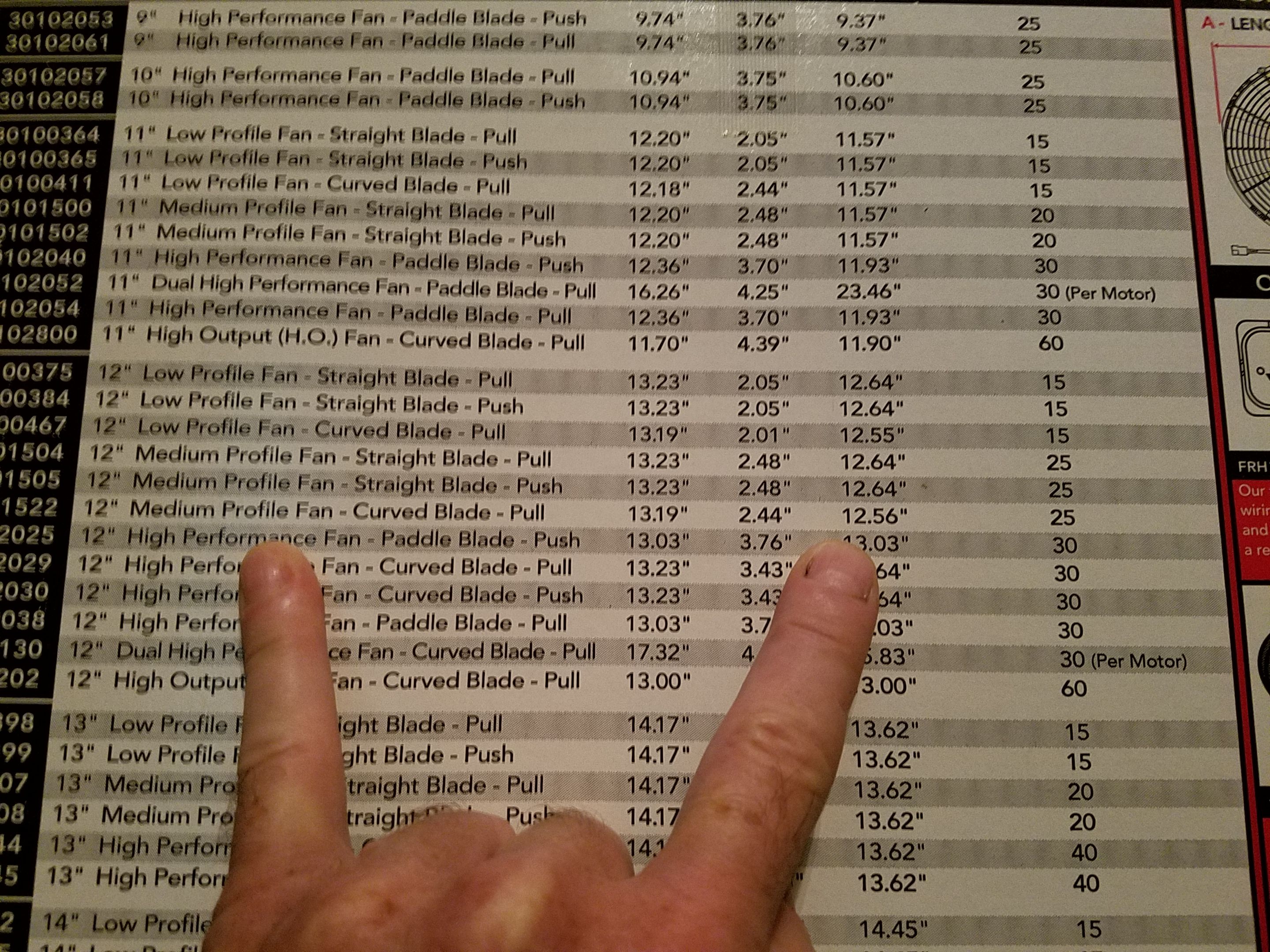

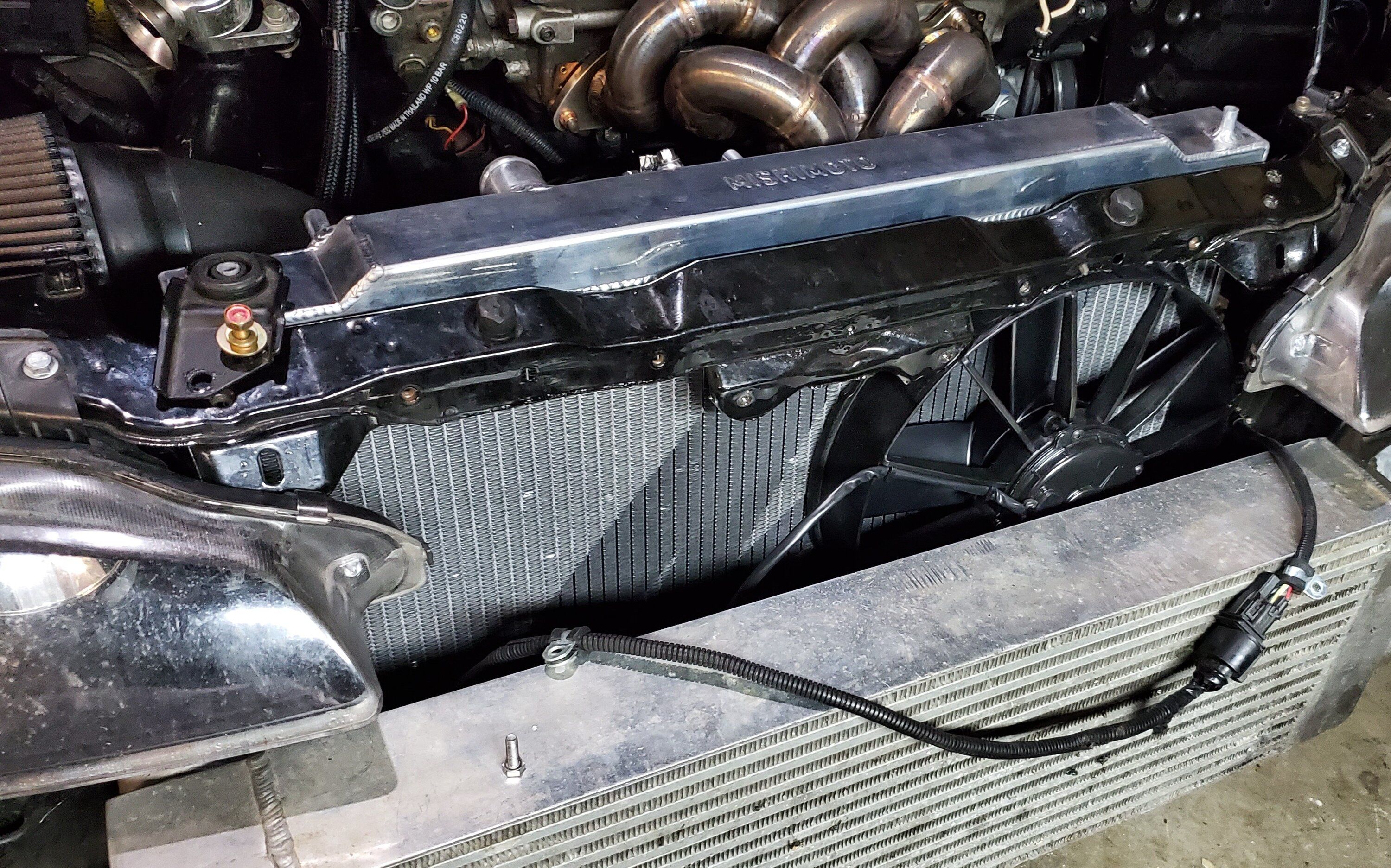

Started getting the fans laid out in the push orientation. SNUG fit. Took some cutting of the fan's plastic housing. See what I mean about this model not really being a slim fan?? These suckers are 5 lbs 1.5oz EACH. I mounted both, and got them trimmed, but my phone died so this is the only pic I got tonight.
Pretty happy with the minimal trimming it took to fit such substantial fans in that location. I didn't get anything closed up/ducted but I will spend some time on that tomorrow. The main place I am worried about is between the IC and the lower rad support, and that should be a fairly easy area to close off. The sides could use some "flaps" but I dont think I want to spend the time doing it unless I need to.
I also was reading the box the fan came in and noticed it says 40A @13V for these fans. The graphic I found online said 30A @13V ???!?! Def going to need a bigger fuse in the block (abs fuse slot) where I hijacked power for the relays.

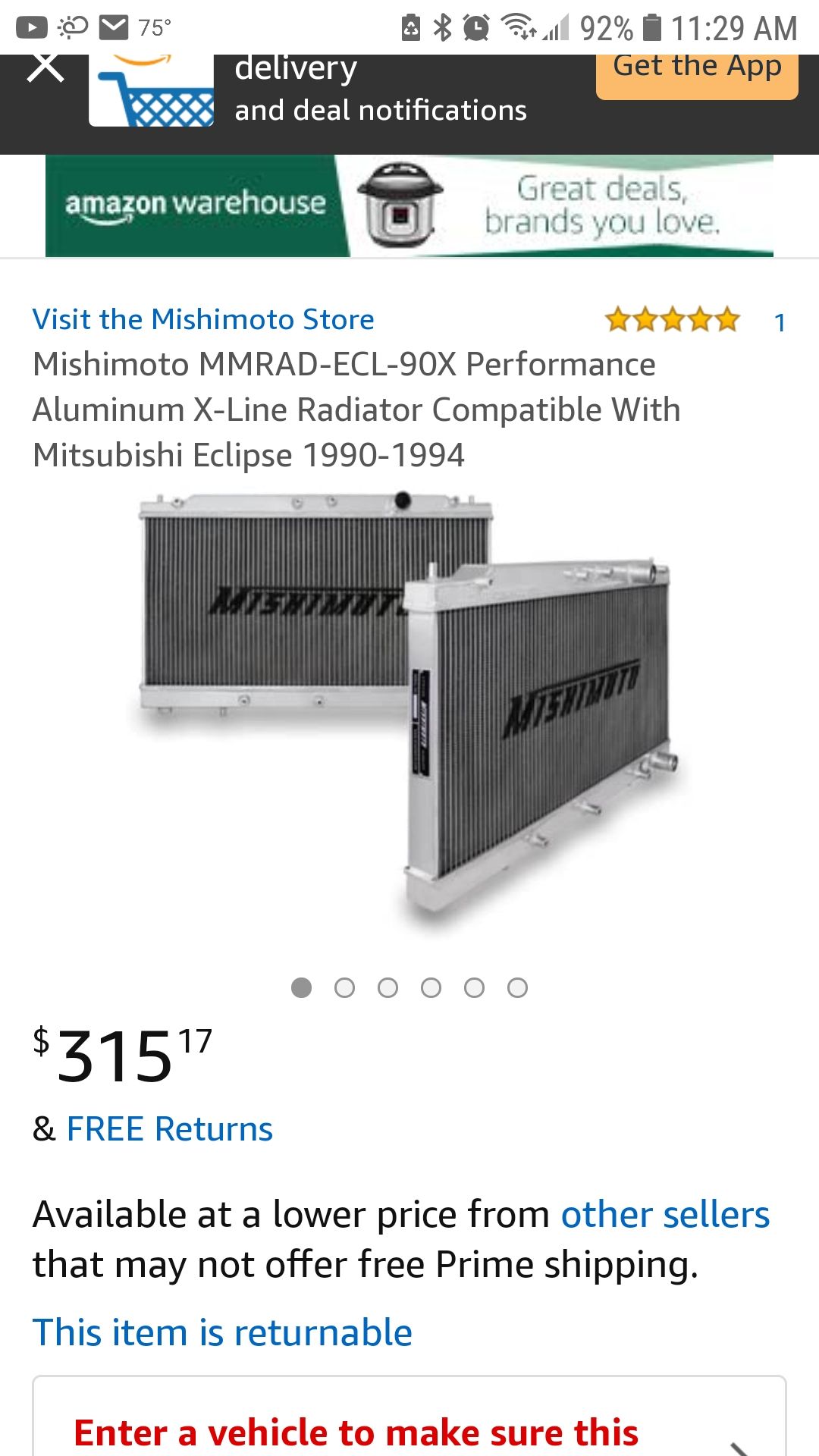

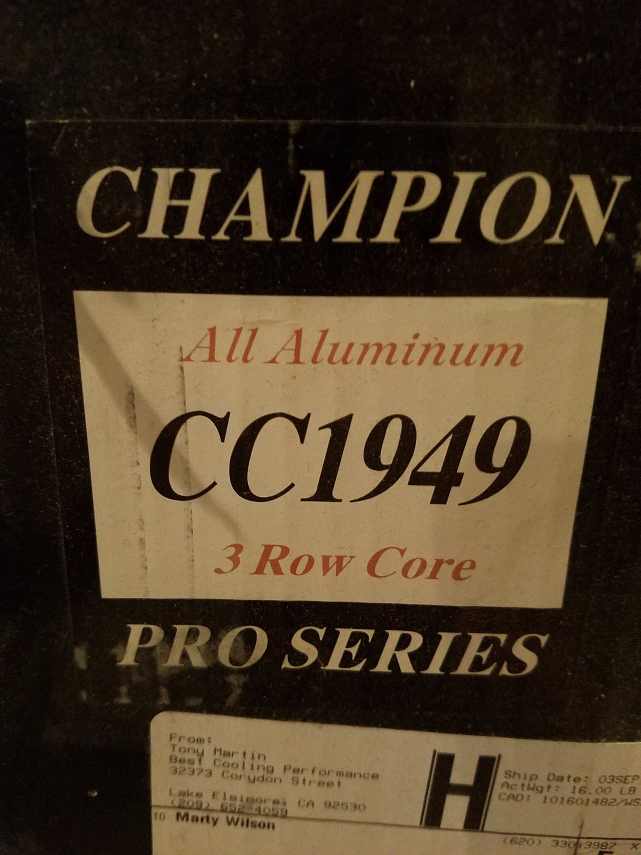

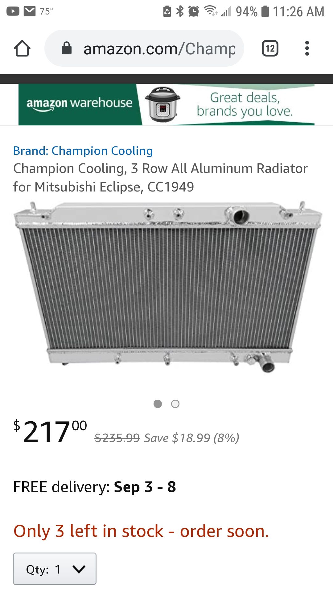

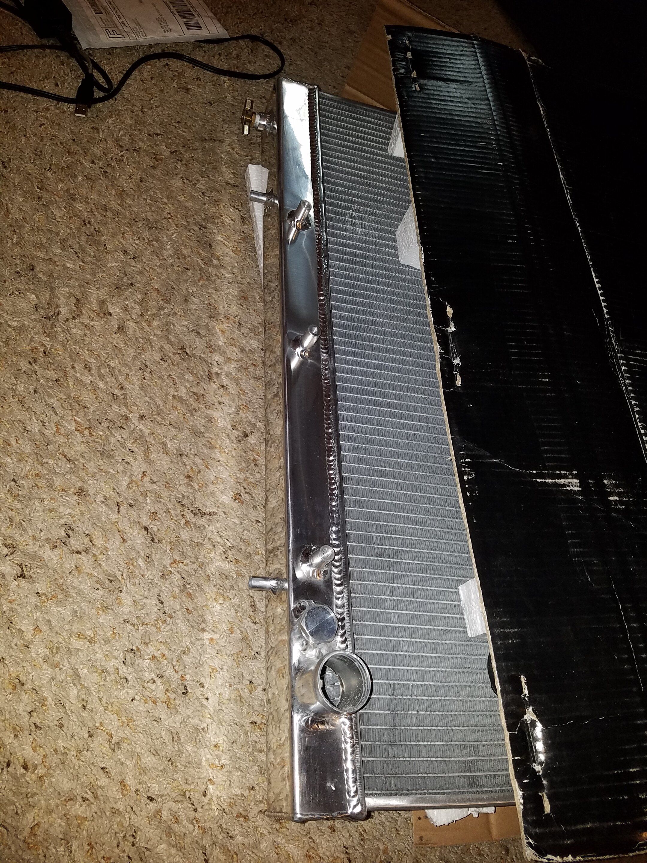

Have you seen the Champion 3 core radiator?
I stole that Mitsumoto X out of my 90 that is down currently so I bought a replacement that is from Champion. It was about $100 cheaper but looks identical except the top tank is not embossed, just pretty, flat aluminum.
Just putting those out there for all of your followers Will.

@1990TSIAWDTALON great find on that radiator man! I wish I had known about it because I dont really dig on logos and labels. Nice to know about though, who knows what the future holds LOL

Drove about 100 miles and had 5 solid WOT pulls. Zero overheating, no overflowing/bypassing the cap. It doesn't like to cool as well at speeds less than about 40mph now, so I will be tweaking my settings for the fan triggers until everything is where I like it. No big surprise because there's a fan trying to block the airflow now (downside of push fans). I am currently testing with one fan relay disconnected, and with the one (1) fan on at lower vehicle speeds it cools very well, which leads me to believe I need better ducting, but could just supplement with the fans if I had to.
I am super impressed that one fan kept me under 203F after 15 mins of idling upon returning home. I am also shocked that it is so loud that I can hear it when the car is idling. I am going to plug-in the second relay and see how it performs tomorrow. In retrospect, I wish I had bought the 10" paddle version to save all the hassle of mounting these 12" fans. Two 12's is certainly going to be overkill!

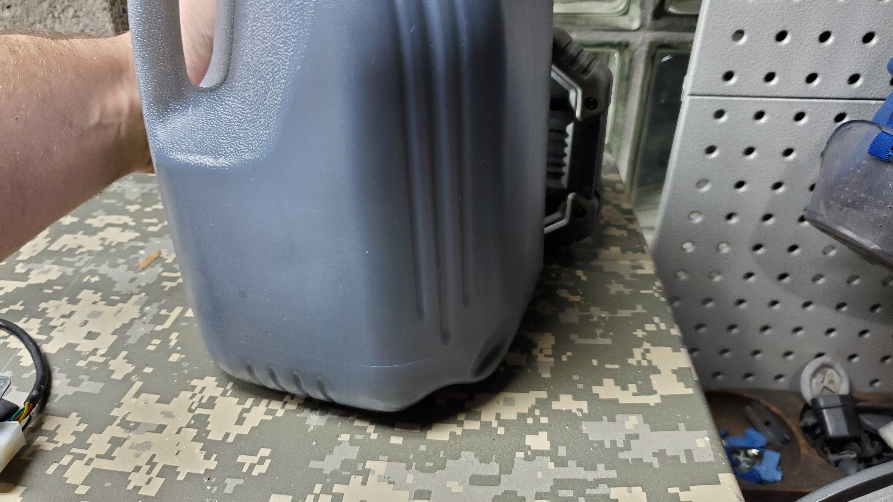

Drained the coolant flush out and it came out straight black. Nasty smell! I wish I had taken before and after pictures of inside the head, but essentially it now looks like fresh aluminum. Pretty happy with the results of the flush, so I ran the hose thru it until it came back out the lower t-stat housing nice and clear. Then refilled it to 70/30 mix with a bottle of purple ice additive. I used the lisle spill free funnel setup and allowed the car to cool before pulling the funnel and capping it. And yes I squeezed the air out.... You cant tell in the pic, but I am holding a very very bright flashlight behind the bottle... nothing showing thru...

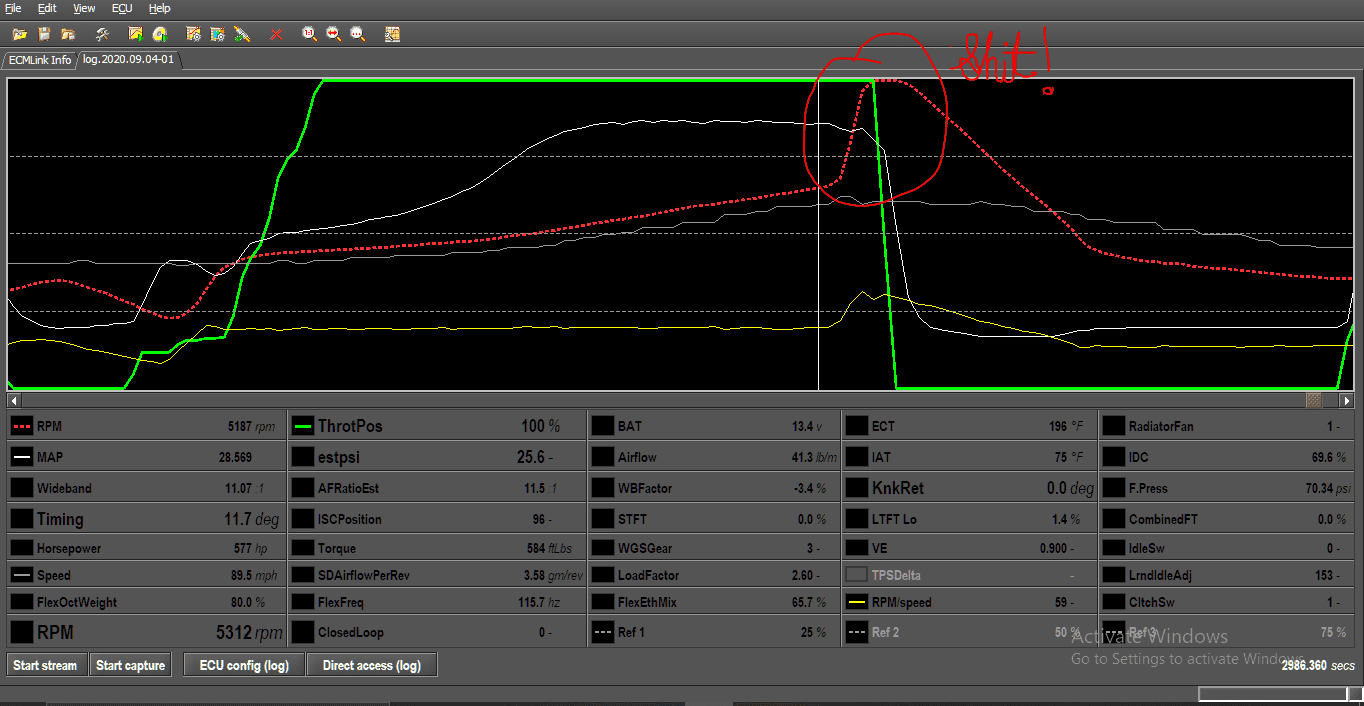

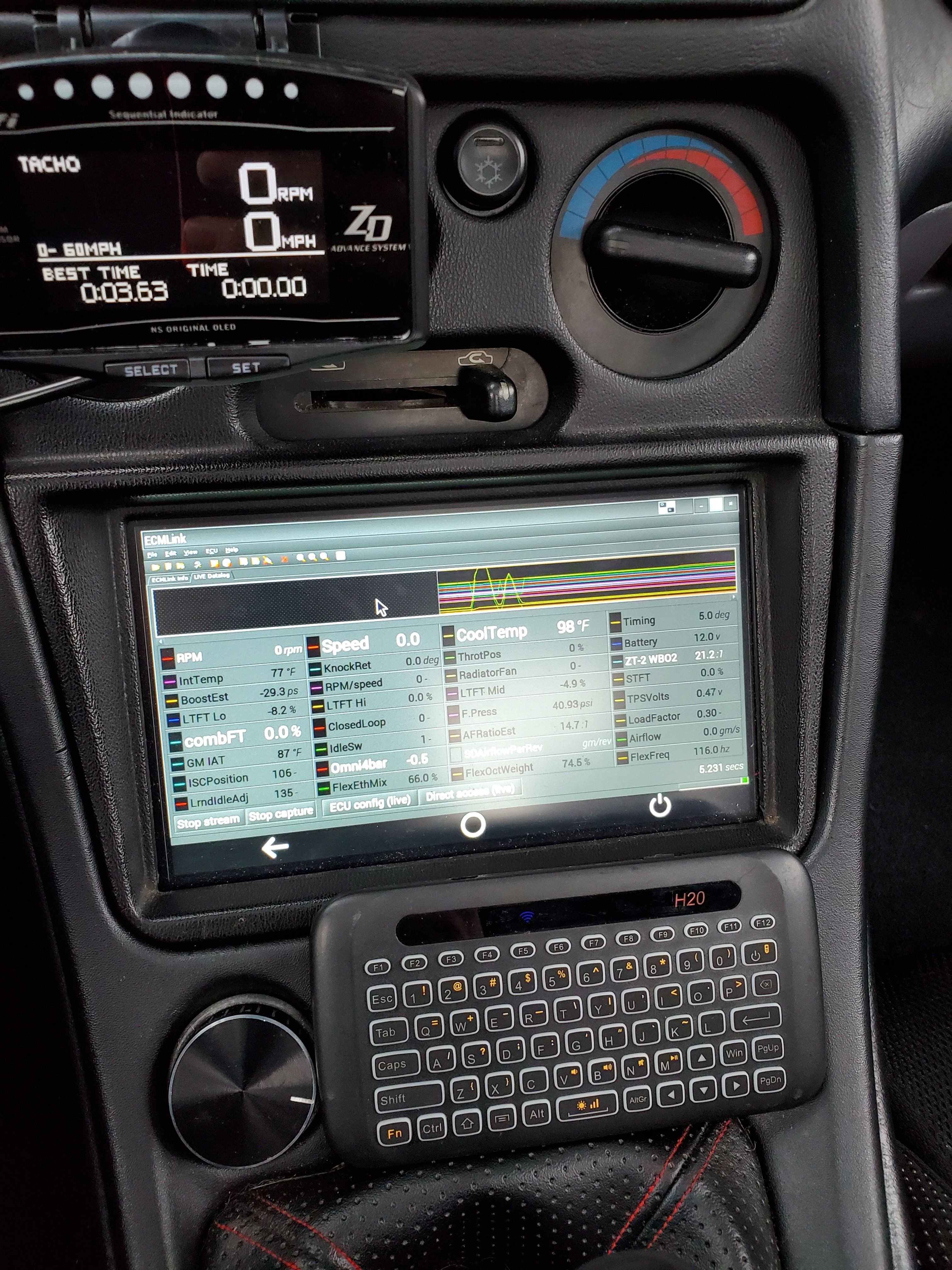

Took the car out and its not bypassing any coolant into the bottle, the level hardly changes at all. It does seem to be spiking ECT during pulls though. Tonight I made a pull starting at 200°F and by redline it was 226°F. As soon as I let off it dropped back to 206°F, then quickly back down to 200°F. Nothing funny with the wideband, so its not excessive heat from running lean.
I noticed this behavior before, but it was only after it had bypassed enough coolant thru the bottle to run the system low. Not real sure what the problem is now, but I am still on the MLS HG. On my previous t-stat I had three 1/8" holes drilled to allow coolant to bypass the t-stat. This was to simulate the deleted FIAV, oil cooler, and heater core. Without them installed the system has no way to bypass except through the rattle valve on the t-stat.
First thing I am going to try is swapping the other one back in. It was a cheapo Stant, non-superstat line 180°F. The one on the car now is a motorad ultrastat, 180°F, with no holes drilled. Maybe its not going through the coolant passages quickly enough because it all has to flow through the small opening on the t-stat??
I am getting a new pressure sensor for my defi setup and will install it in the lower t-stat housing to monitor system pressure during pulls. I can just plug it into the fuel pressure sensor input as long as I use the same sensor.

With the other t-stat in (the one with 3 - 1/8" holes drilled) the car likes to hover right at 180F. Full pulls raised temps from 180 to 200F. Still feels like a sharp temp rise, but I never watched for it before...
I checked a log from 2017 and a log from last summer, and both show increases in temp of about 14-20F during a full pull.
Does anybody else see this in their logs? Or have I had a problem for a long time??
EDIT: I searched on here "WOT log" and looked at a bunch of them. None show a sharp temp rise like this. Finally HG time?

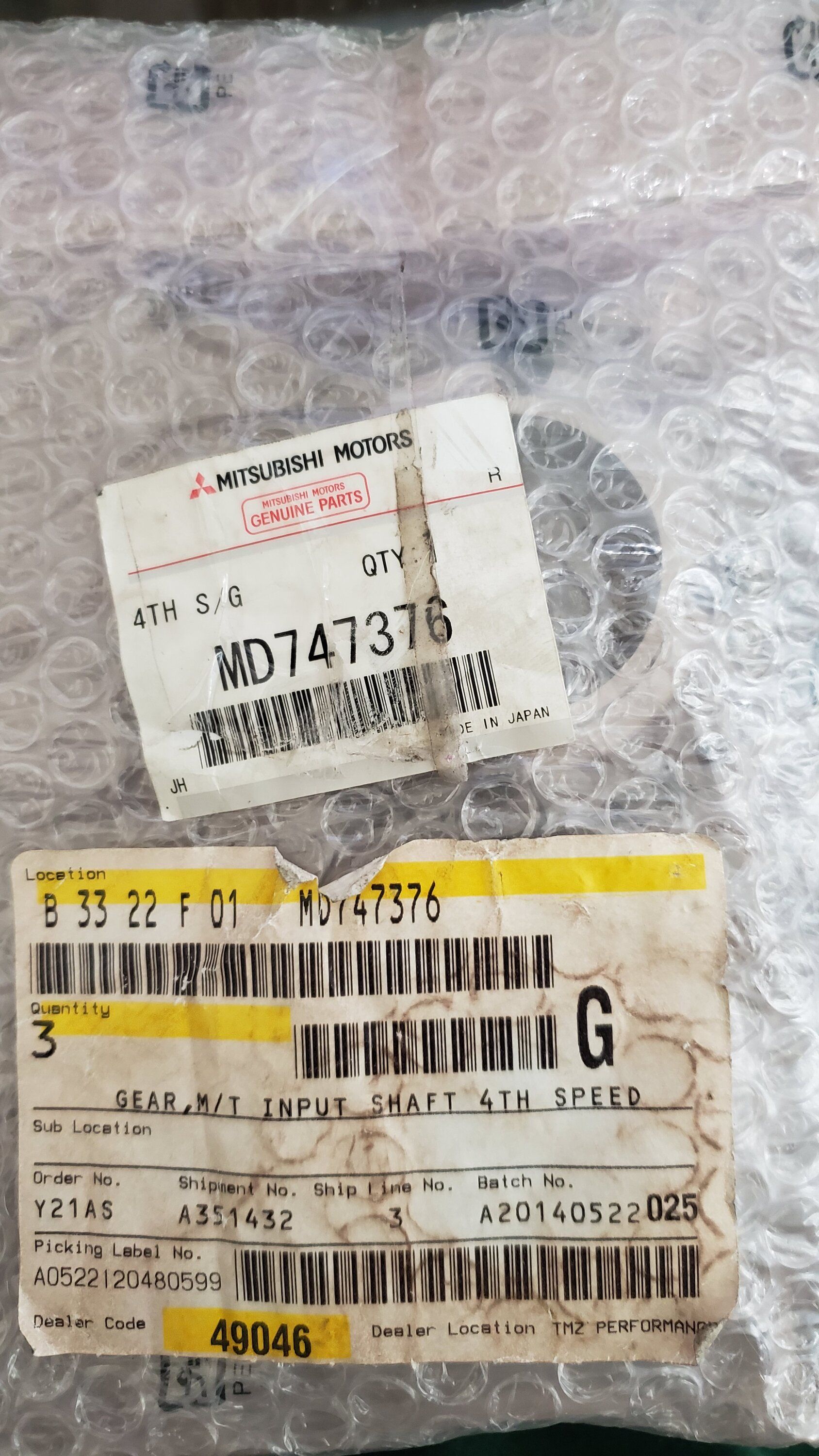

The hx40 car. Popped out of / or sheared off 4th. Free revs in 4th now.
Its either getting auto swapped or I might part them both out and build the evo

That's the opposite of my symptoms. The temp is high during the pull and goes down instantly when I let off.
