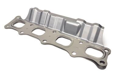

I am looking at adding some reflective fiberglass sleeves over the water pipe and possibly the intake pipe and IC pipes. The stuff isnt cheap for 4" pipes tho! I also want to build a cold-air enclosure to keep the filter from drawing all the hot engine bay air in. Lastly I want to make a small heat deflection shield that goes on the manifold bolts, and goes between the valve cover and the manifold (similar to what is built into the EVO X exhaust manifold gasket. This will just help deflect the heat a bit, which looks like it will help the valve cover gasket survive a bit longer before cooking LOL
Edit: the more I think about this little heat shield, it would also benefit the cylinder head, as there would be less radiant heat exposure from the manifold. I am def going to make a small shield similar to this....

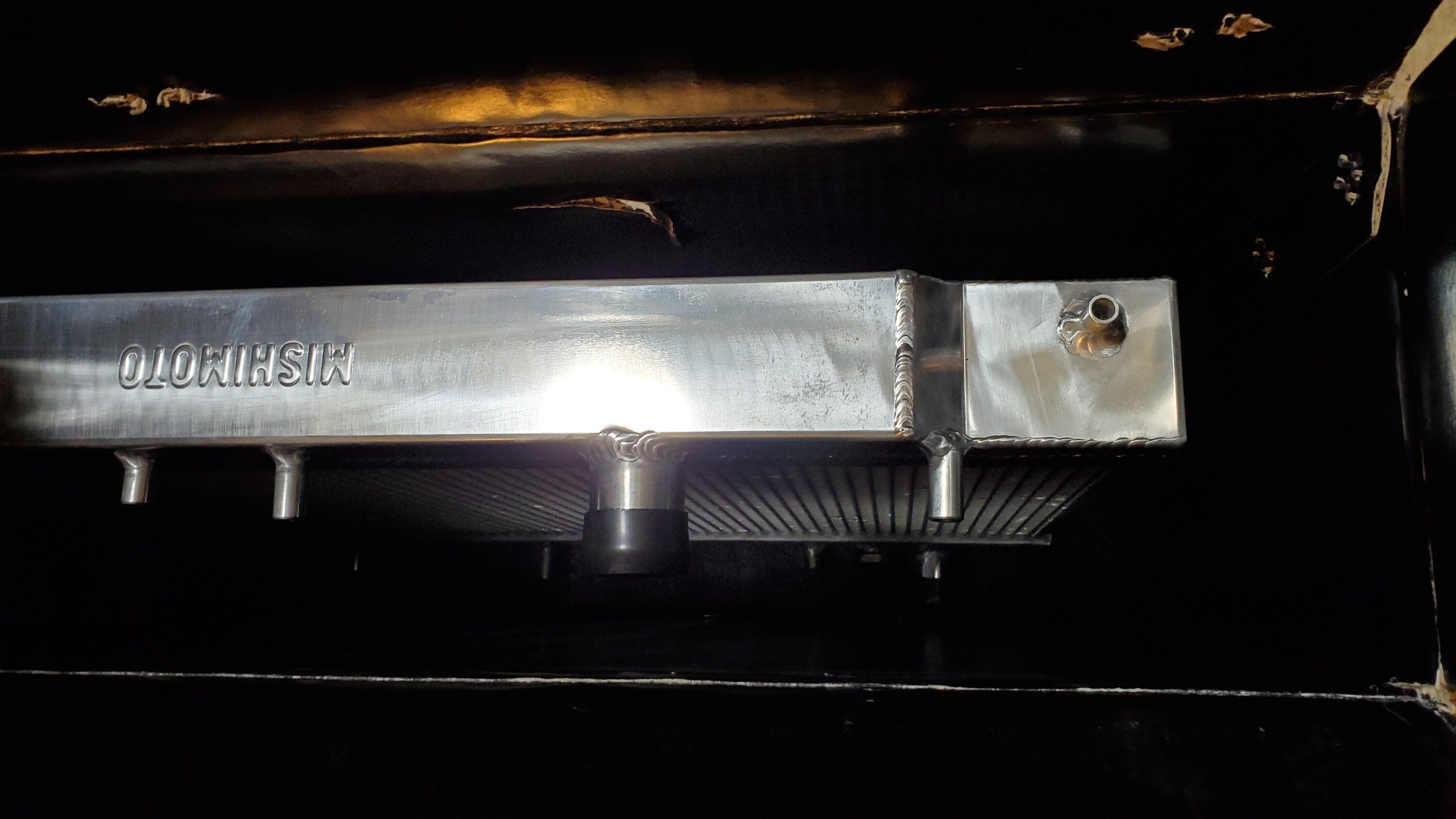

I got the radiator today, and it looks 100% usable. I dont see why they would have returned it to amazon unless they just didn't like it. It seems a bit weird that the stamping on the tank is the old style (like the one I had almost 10 years ago) but a quick look inside the outlet shows its def a 3 row core. Its also very thick! The one coming off had the mounting pegs centered front to back, look how far offset this one is, and how much space ill lose for fan on the front side... glad I went with two pushers!

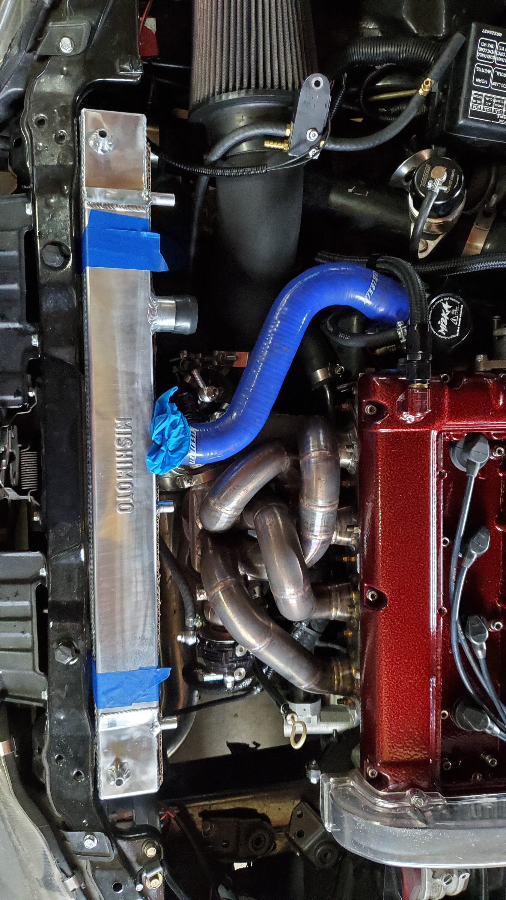

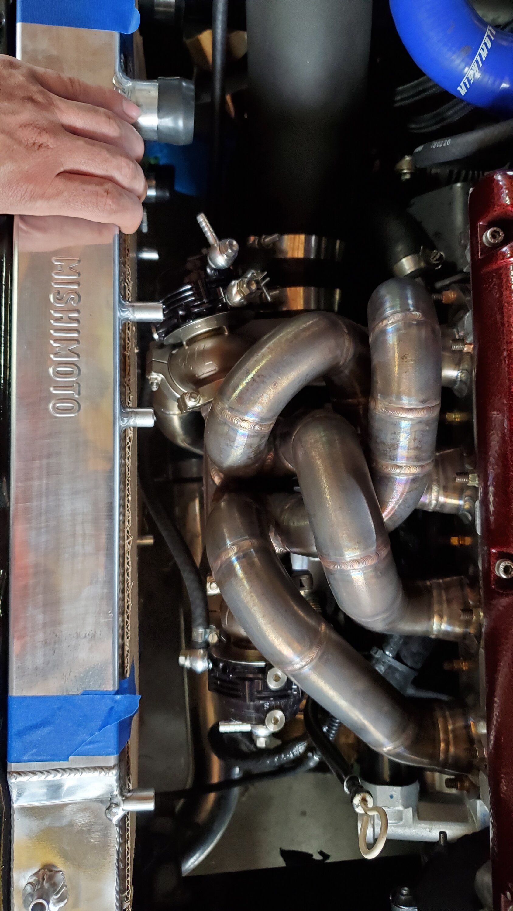

Really surprised that fit! Those X-lines are extremely thick. The extra space from the more compact design ended up paying off :)

That's where I am at as well! I truly appreciate the backup in making that one feel justified!! I am not totally sure the studs fixed it, but I did need a new rad either way. I was going to buy another cheapo "ebay" core, but I stumbled across the open-box x-line and couldn't refuse the price. I knew they were thicker, but I didn't realize just how thick they are! I think it may not have worked out if we had gone a different direction with the manifold. I love the way everything is still managing to play nicely together!!

@1990TSIAWDTALON does your x line have the logo like mine or the newer logo? Should be the same rad bc this is a 1g

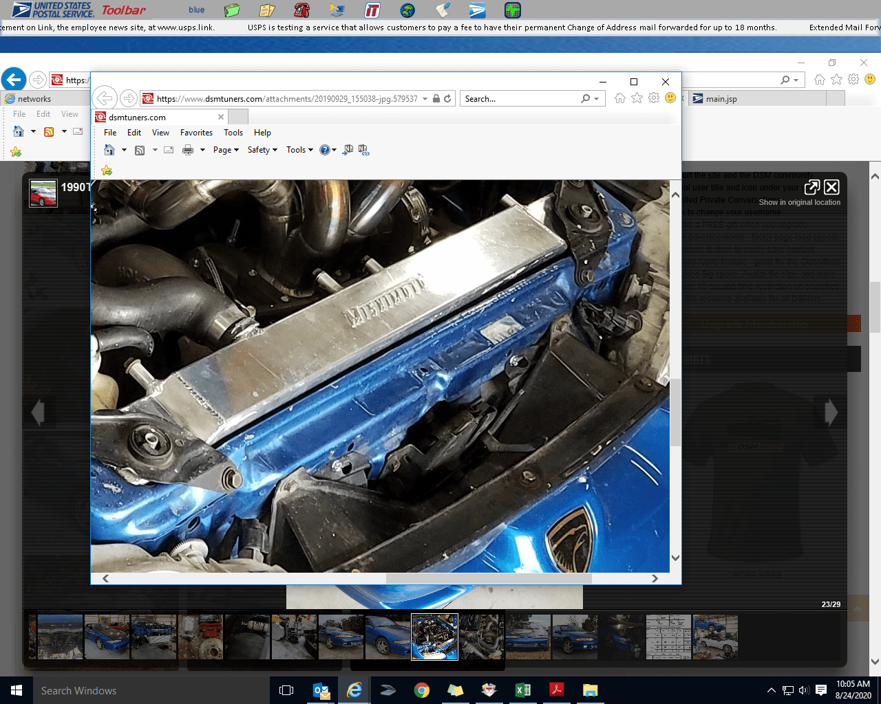

Pretty sure mine is exactly like your is Will.
Here is mine.

Is it the newer one? It certainly isn't a new radiator, I bought it back in 2014 I think :)
That is why its so strange this one has the old logo.
I wonder if this is NOS (New - old stock) or something? I don't care which logo it has, and actually wish there was no logo, but it seems odd.
Maybe its a counterfeit! even so its a 3 row core and super thick. I'm going to run it! LOL
My car ran considerably cooler with it over a regular Mitsumoto. I do have to say, and something to think about, that aluminum sure picks up ambient temps EASY which is one reason I wrapped all the hot parts that I could so I wasn't heating up the radiator with my exhaust.
