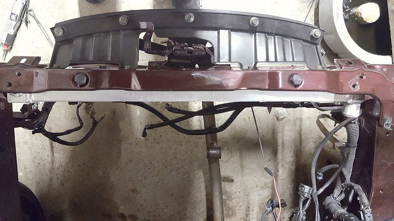

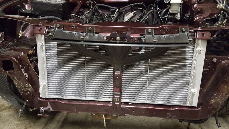

I switched over to a VW Golf MK3 radiator and SPAL pusher fans. It fills the core support nicely, giving me more room to work in the bay and I can go to a bigger turbo without having runner inference with the radiator hose in the center of the stock style 2g radiator.
This is a great idea! This is a great addition to my current build. Definitely will help with my engine bay shave and tuck.

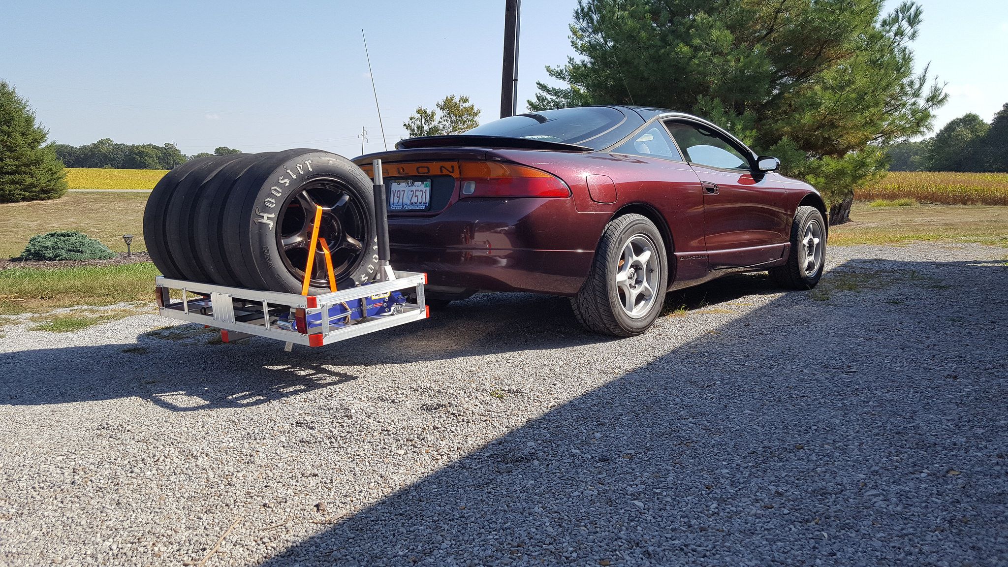

I went ahead and added a hitch to the car so I could swap slicks at the track and not have to put so many miles on them. Its a draw-tite 24602 and was a direct bolt in.
Just need trailer wiring and a small trailer
It tucks under the bumper cover nicely.
Strapped down and loaded with tools in the hatch!

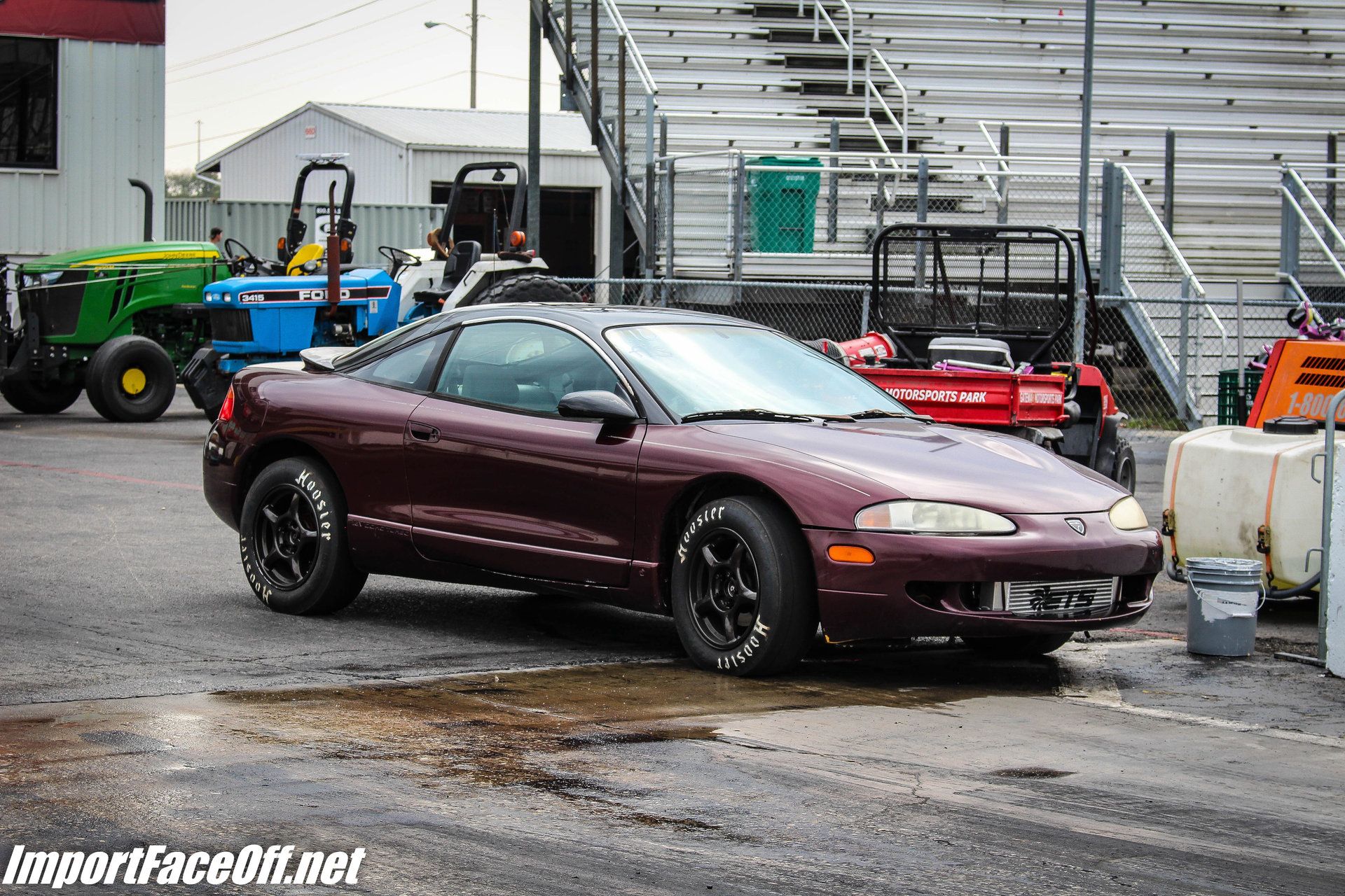

It's been awhile since I've updated this. This summer has sure had its ups and downs. On Friday May 18th I went to Neglection 2.0 which is a no prep event held at Wagler Motorsports park in Lyons, Indiana. This was their 2nd annual event and it was a riot. It is a 2 day ordeal, Friday night they host a hard tire class which had 47 cars entered. $10 buy in, only rule was it must be a true hard street tire, no drag radials, slicks or anything and $1000 to win. Then Saturday was a small tire and big tire class. I unfortunately couldn't stay for Saturday due to family events.
On with Friday night. I made the trip by myself since my friends had plans and the girlfriend had to work. I was a little skeptical about going since there was a lot of rain in the forecast. It didn't rain at all during the drive but sure enough as I was pulling in the pits it started sprinkling. It rained for about 30 minutes and sprinkled on and off most of the evening. About 8pm the rain had stopped and they dried the track. More rain was coming in and they wanted people to get their two test runs in as quickly as possible. As luck would have it, it started sprinkling again before my first test run. They were really trying to get the event in tonight so we were making passes on a wet track. It was NUTS. The car spun so bad I thought I broke something the first pass. I learned real quick how to pull power out of the car and add it back in as after the first two test passes it had stopped sprinkling. They dried the track again and it really came around after the first couple rounds of eliminations. We were paired in the staging lanes by pulling 2 out of 4 cards when you were next in line to pull on to the track. To make a longer story short the car ended up going 7 rounds to win, and one was against a very built Cummins in semi finals. The semi finals video is here

On Sunday May 27th there was another no prep event about an hour and a half away in Sikeston, Missouri. It had the same three classes, Hard tire, Small Tire and Big Tire. This event was much smaller but still was a blast. There were 6 cars in the hard tire class (I didn't bring enough fire power for the small tire guys) that I entered. A very quick 6.70 diesel pickup was supposed to run in the hard tire class but was a no show so this was a pretty easy win. I was the only AWD car there, which must not happen very often. A track official came by when I was loading up and had no ideas what the car was or how it was capable of getting down the track on a true street tire. This was the first event my girlfriend and her daughter were able to make with me this year and they enjoyed it a lot even in the 95 degree heat.

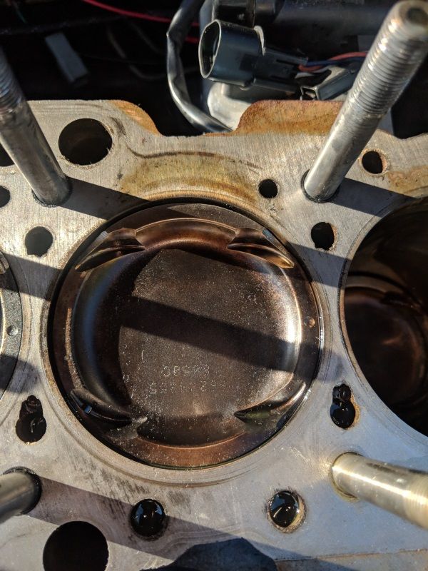

And a shot cleaning the car for Street Car Takeover St. Louis on Saturday June 2nd. Ultimately SCT did not go as planned. First test pass the FPR reference line had cracked and blew off. I made a clean 2nd pass but the car was low on power it seemed. It was running high 10's so I signed up for 10.0 index class and made a few changes. First round I paired against a GTR who ran an 11.0 and I went 10.9. The car was way down on power even after adding 2psi. It started raining and they called the event which ended up being a blessing in disguise. I noticed that the coolant overflow tank was full. I loaded the car and went back home. I did a compression test and the results were 150-125-150-120 cold. I went ahead and pulled the cylinder head and found the gasket was blown into coolant ports on 2 and 4. Which explained why air was coming from cylinder 4 back into 2 when I was doing a leakdown test. I couldn't pull the radiator cap at that time since the motor was really hot. I ditched the cometic MLS and installed a Felpro.

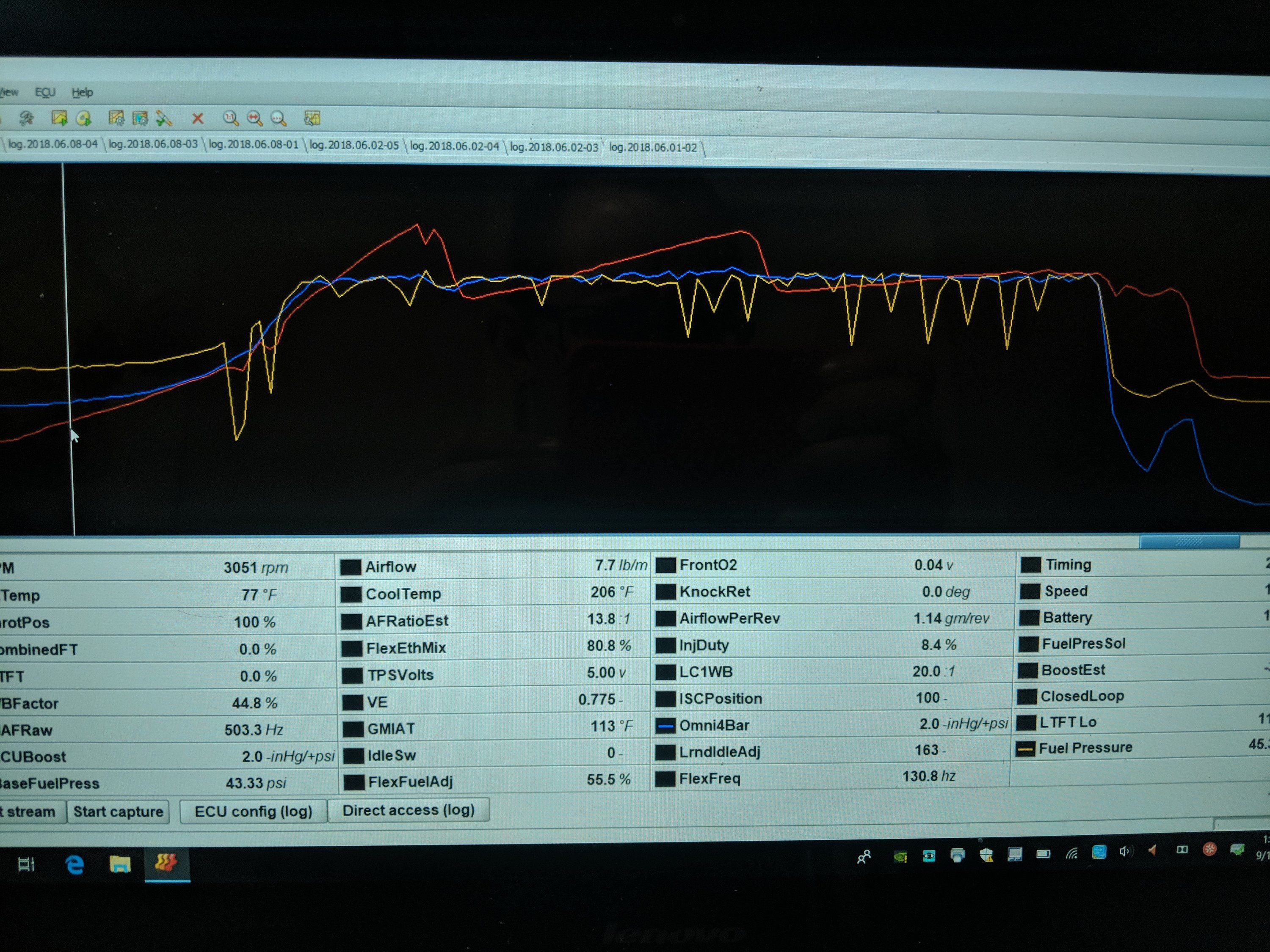

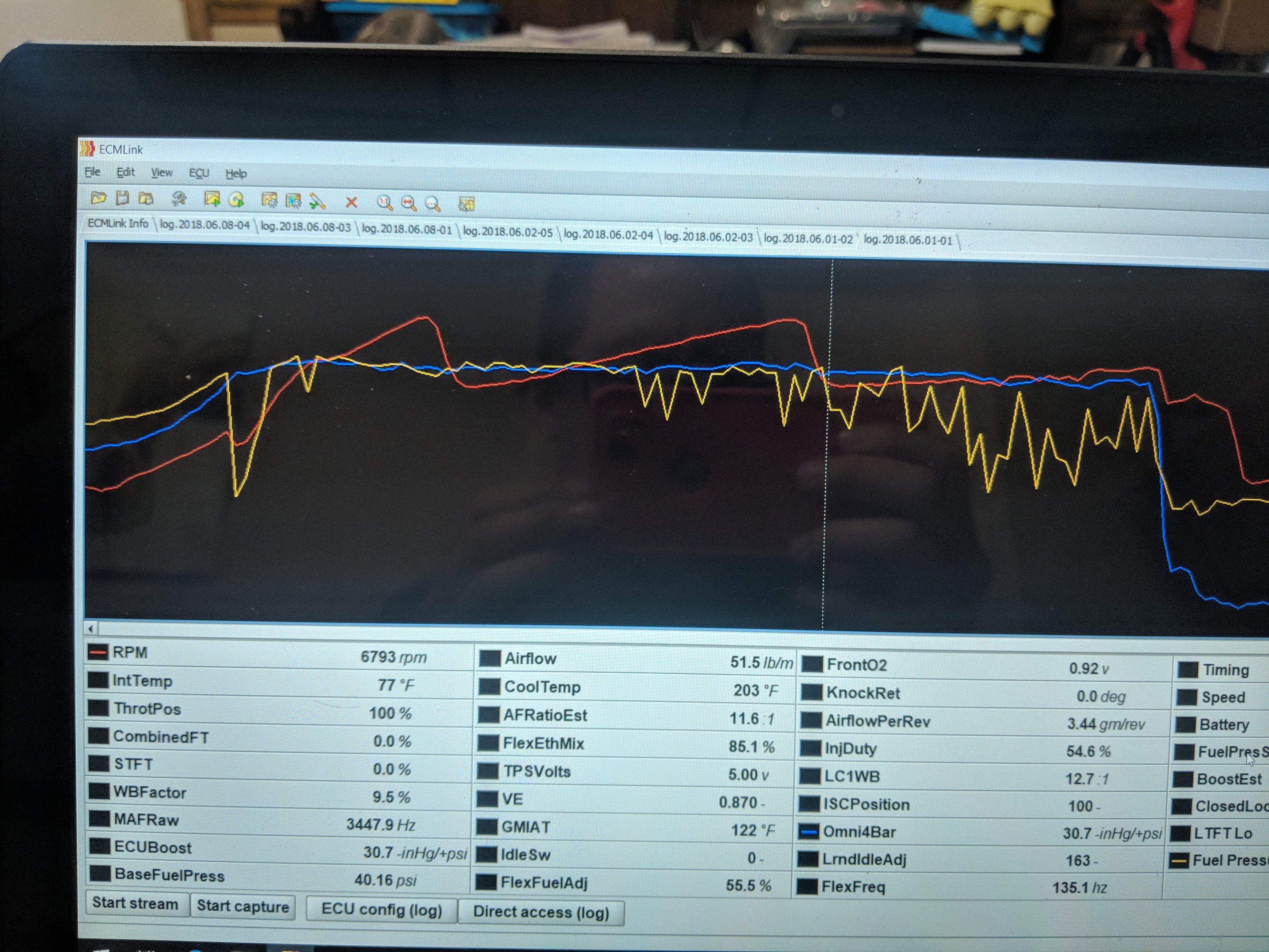

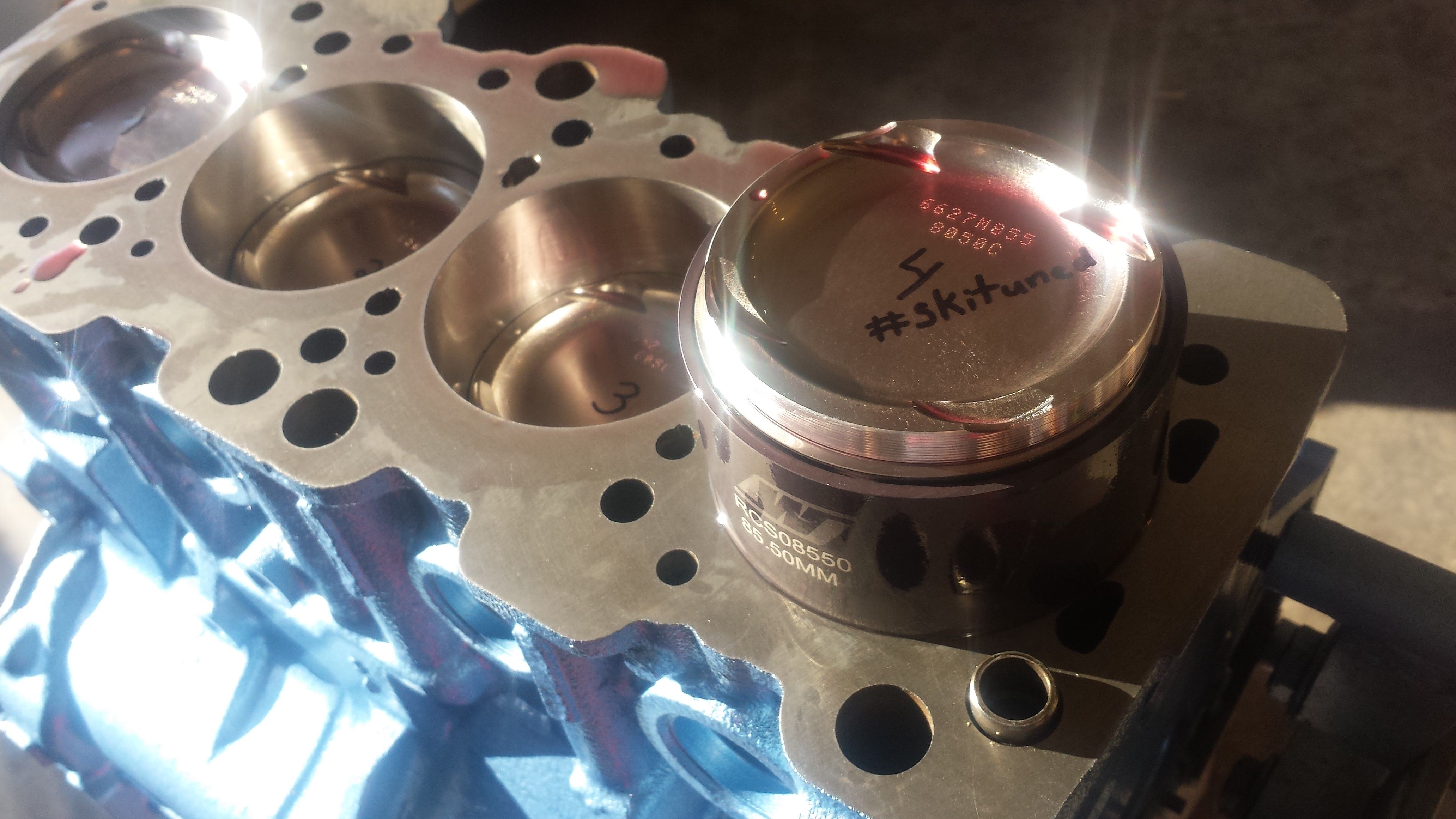

The next weekend I went to North Alabama 247 drag strip with some family and ran at their Cash Days event. The first two test passes seemed ok after the headgasket failure. I turned it up a little and went into round one eliminations. It bogged bad right after launch, I was able to get back in it and get the W. I reviewed the log and it lost fuel pressure.
Went into round two against a very nice turbo Mustang GT500, he treed me big time so I loaded the car back up. It was a fun time out there and met a lot of very cool people.
I attached some logs of the fuel pressure dropping during passes (yellow line). I believe this contributed to the blown headgasket earlier.

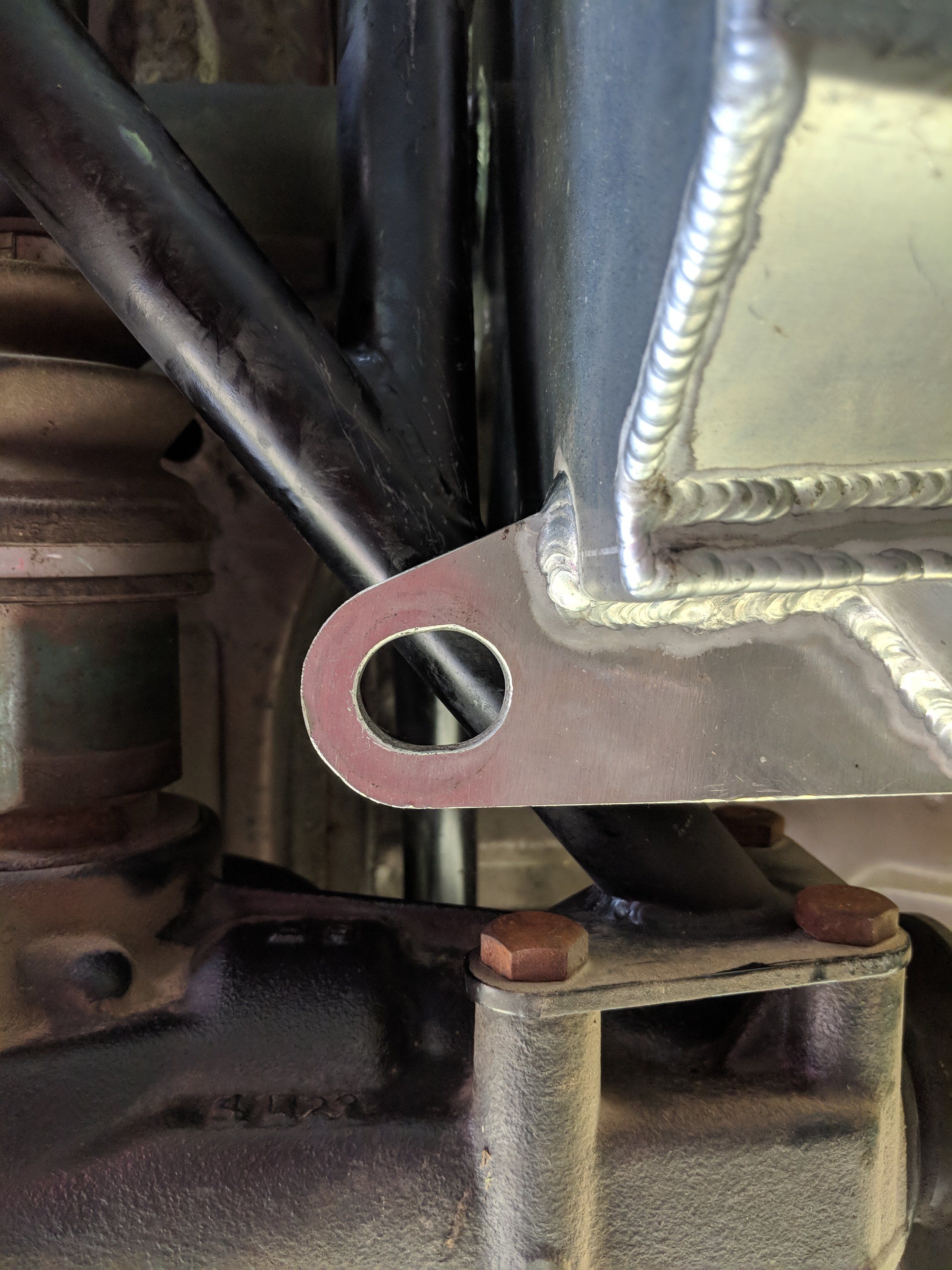

I decided it was time to upgrade the factory tank and internal pump to the Frontline Fab bolt in cell and bosch 044 external pumps. I mocked it up and it was extremely tight fighting around the Volk subframe but it fit!
