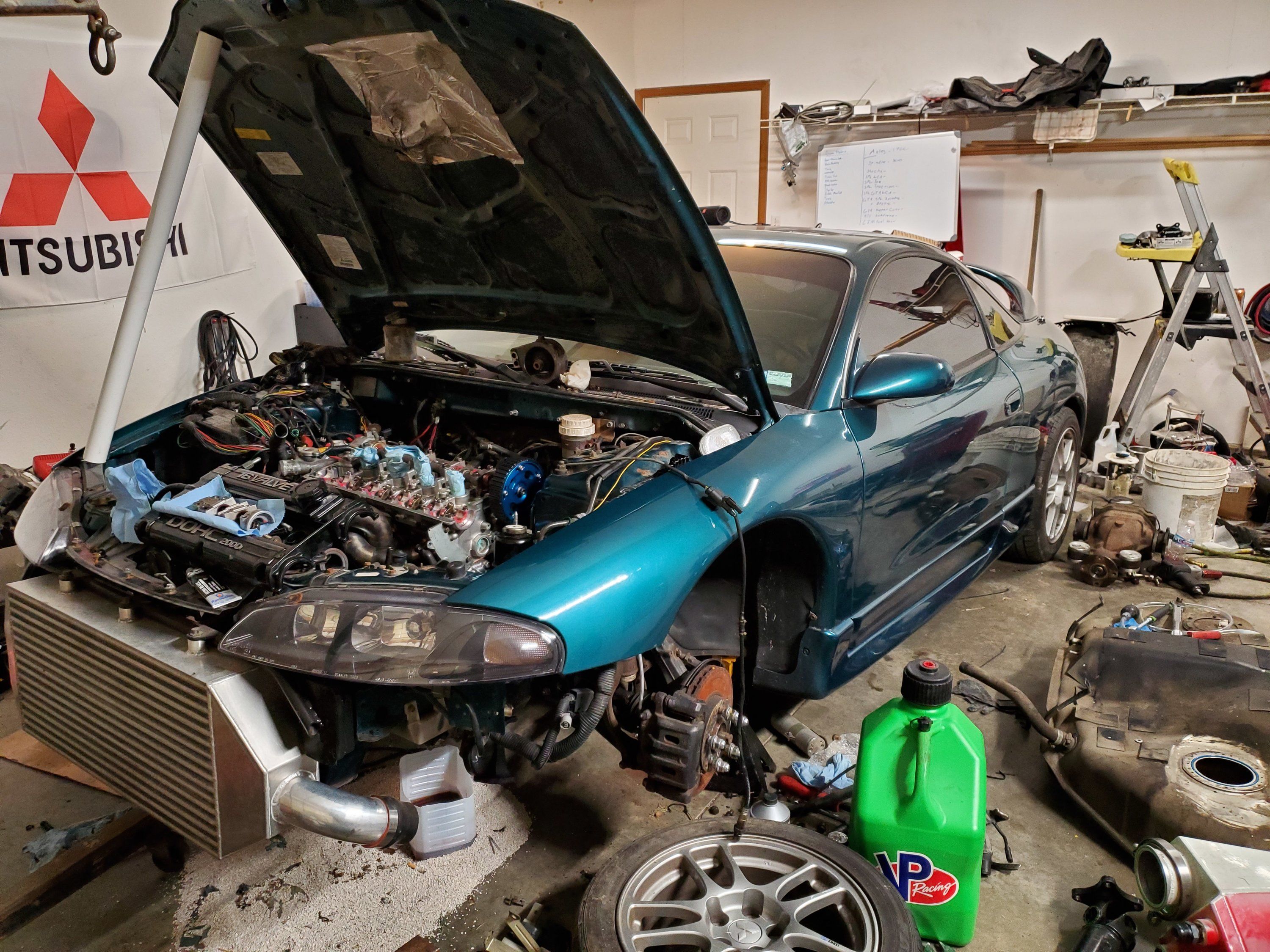

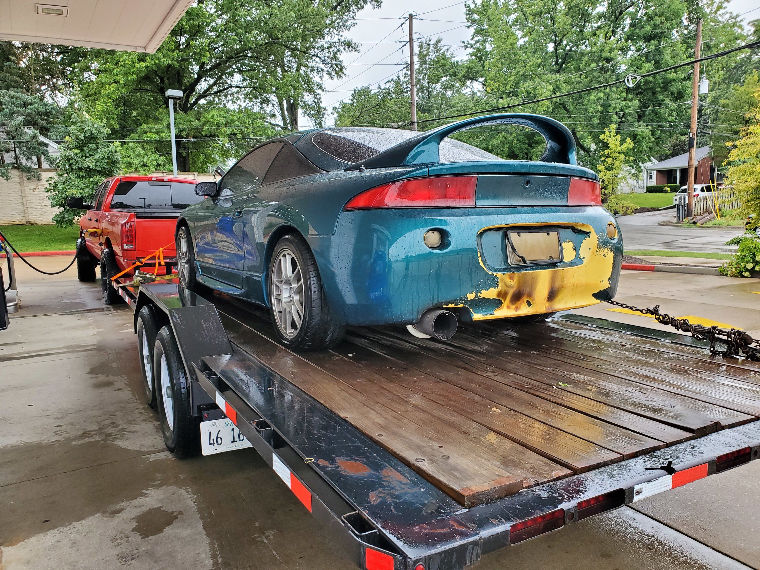

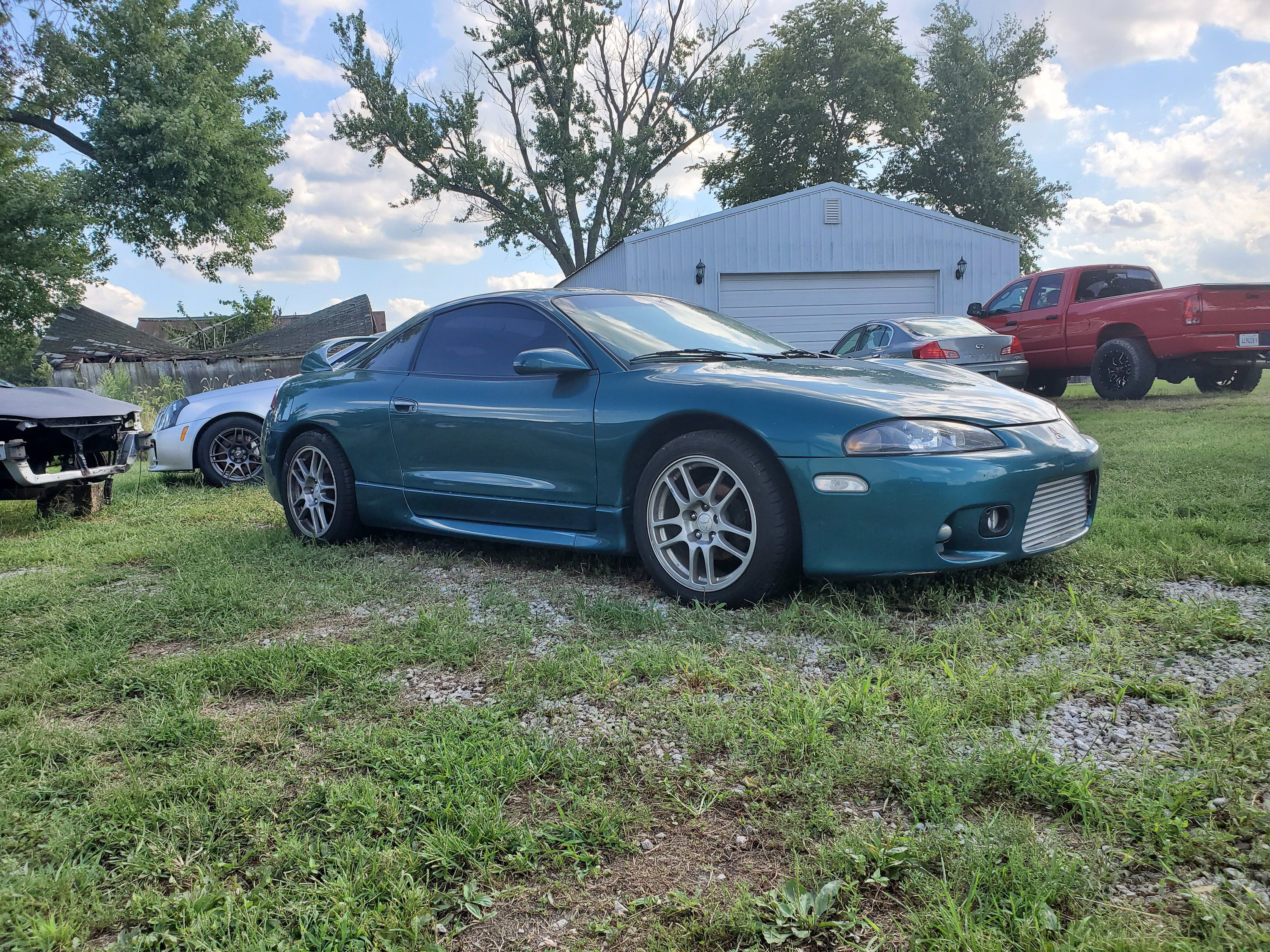

I picked this car up from a local DSM'r on 8/25/2019. He had to let it go since he was moving to California for new job opportunities and couldn't bring the car with him. He reached out to me asking if I would be interested in purchasing it and immediately I said yes as I needed to replace the purple car chassis from rust issues. The car has been sitting for ~8 years. The previous motor threw a rod and windowed the block. It was taken apart and the previous owner had a new engine to go in it that he bought several years ago but never got around to putting it back together.

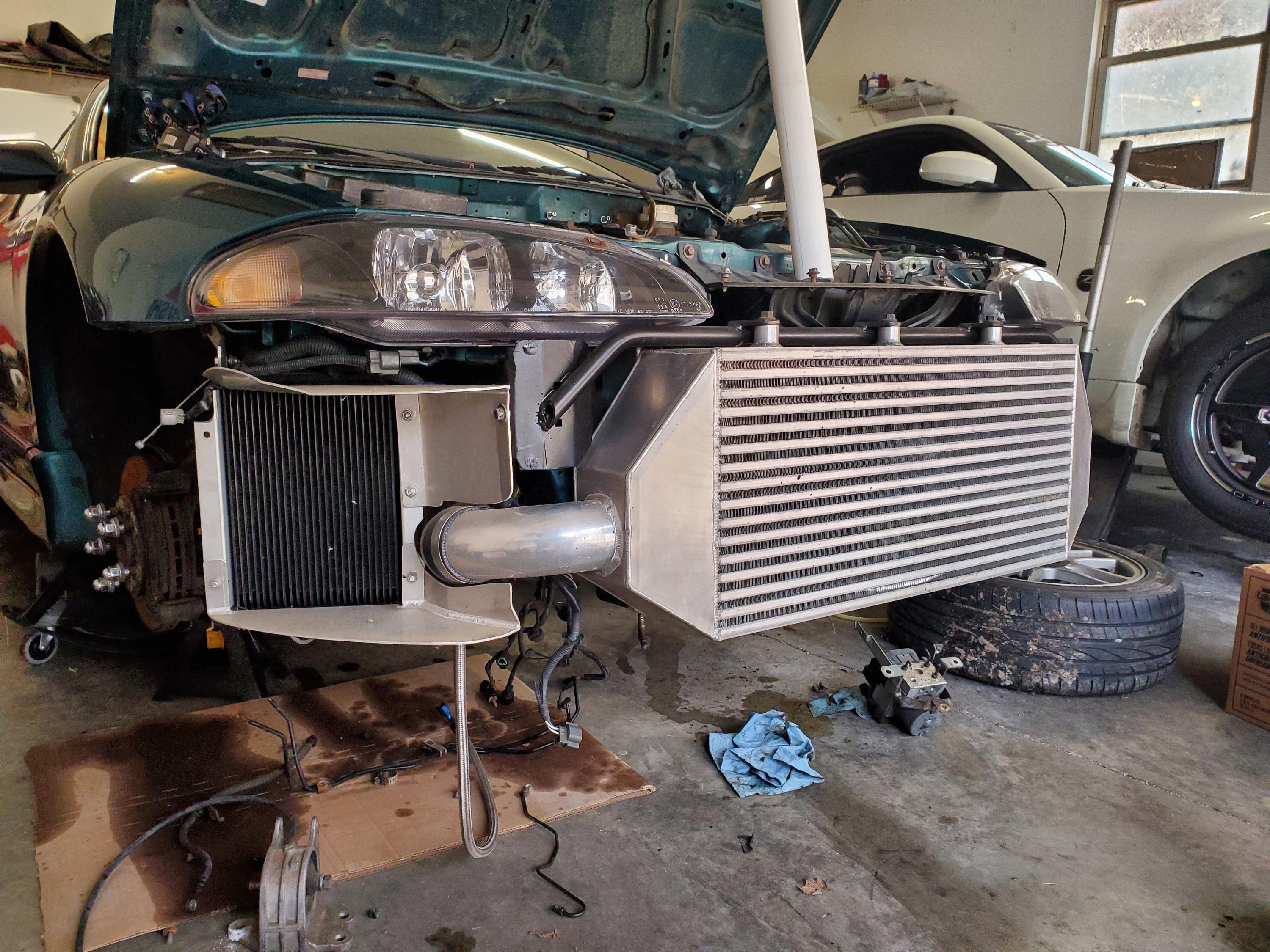

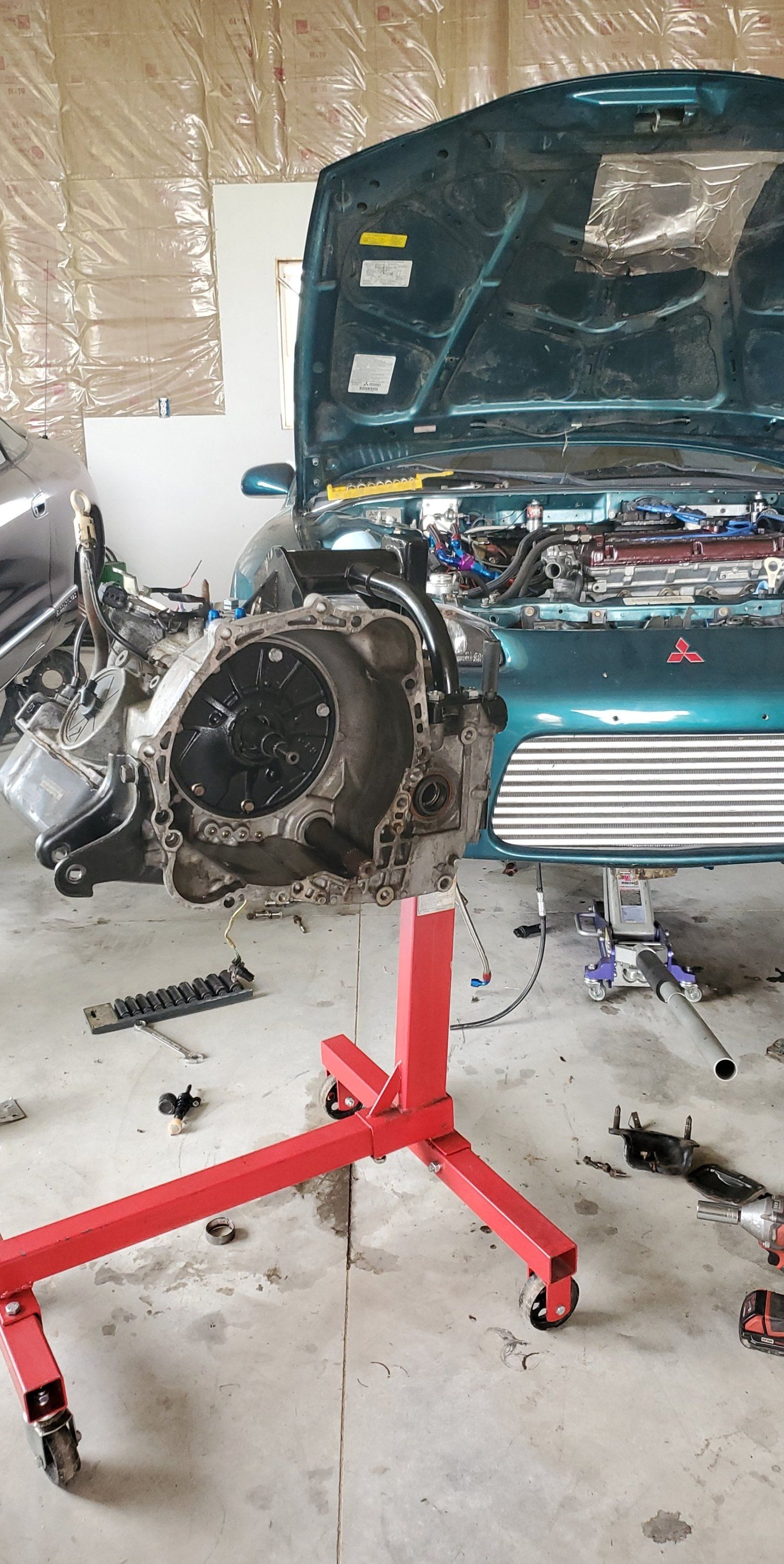

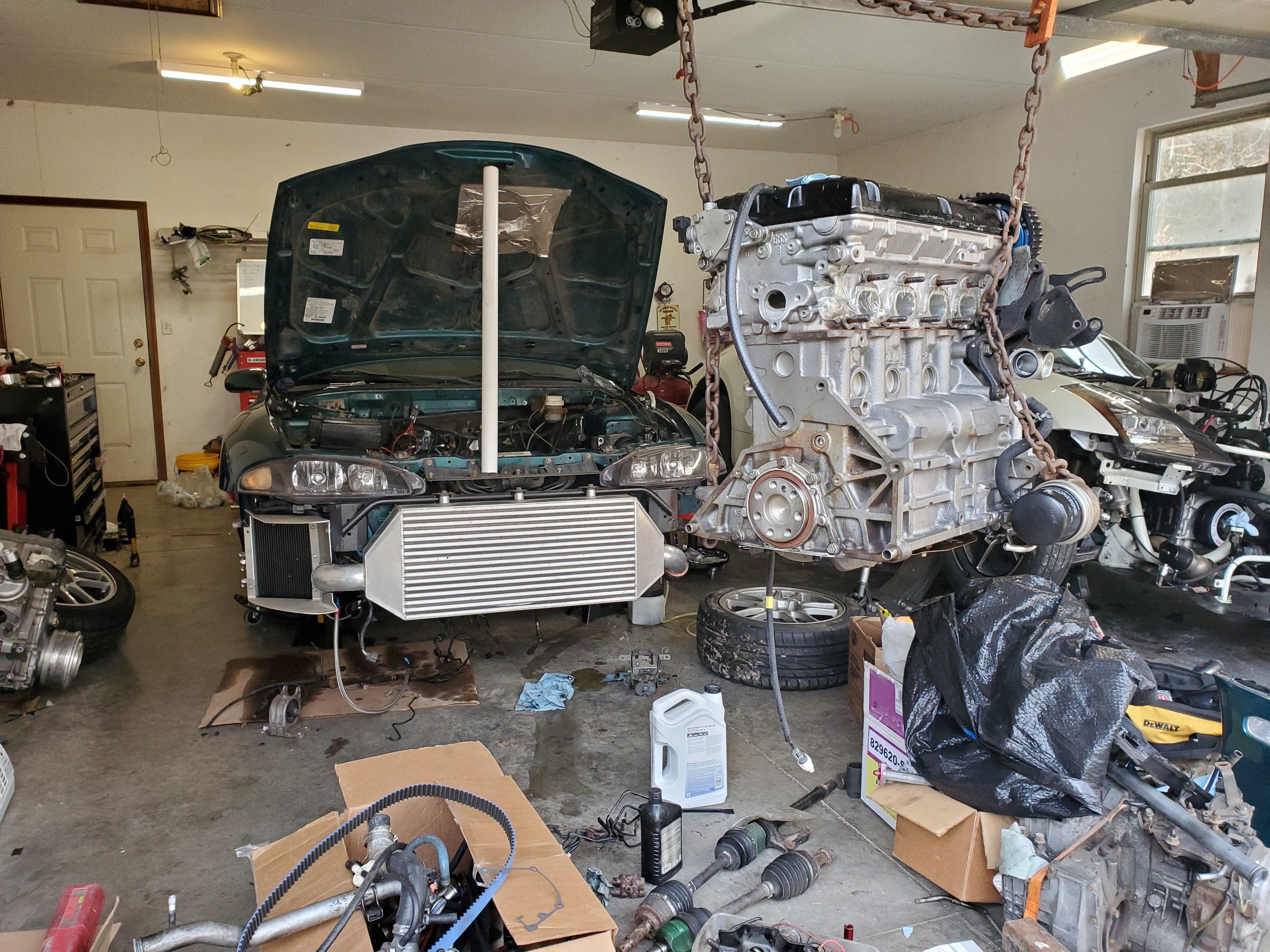

Over winter I was able to take it to a friend's house and piece it back together as I still don't have a heated garage yet. There were a lot of little pieces missing so there were many nights where I made it out to my friends garage and I ran into an issue where I needed a specific part, bolt or tool that I didn't have with me there.

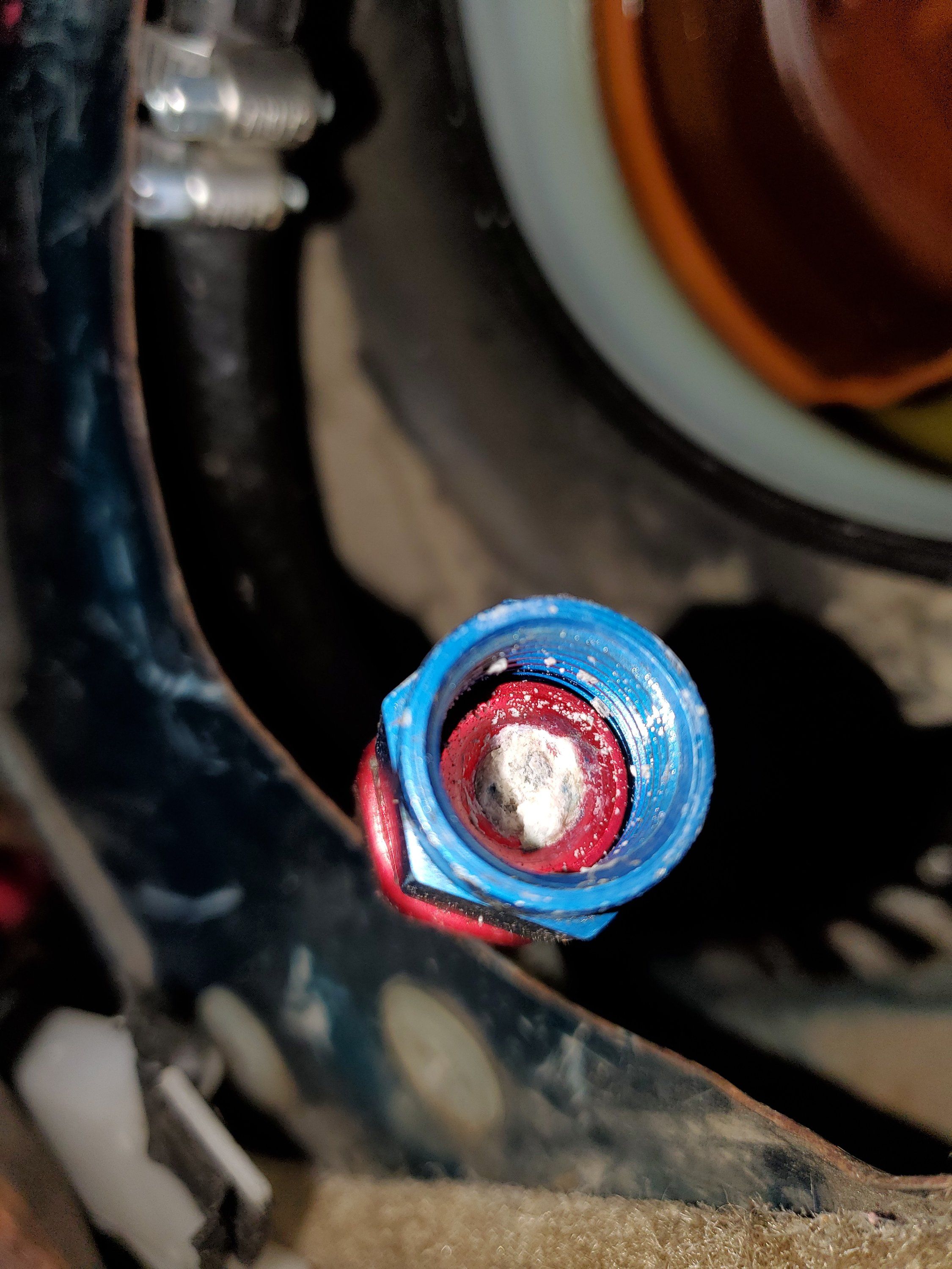

The fuel feed from the pump full of corrosion from e85 sitting in it for years. The rest of it appeared ok.

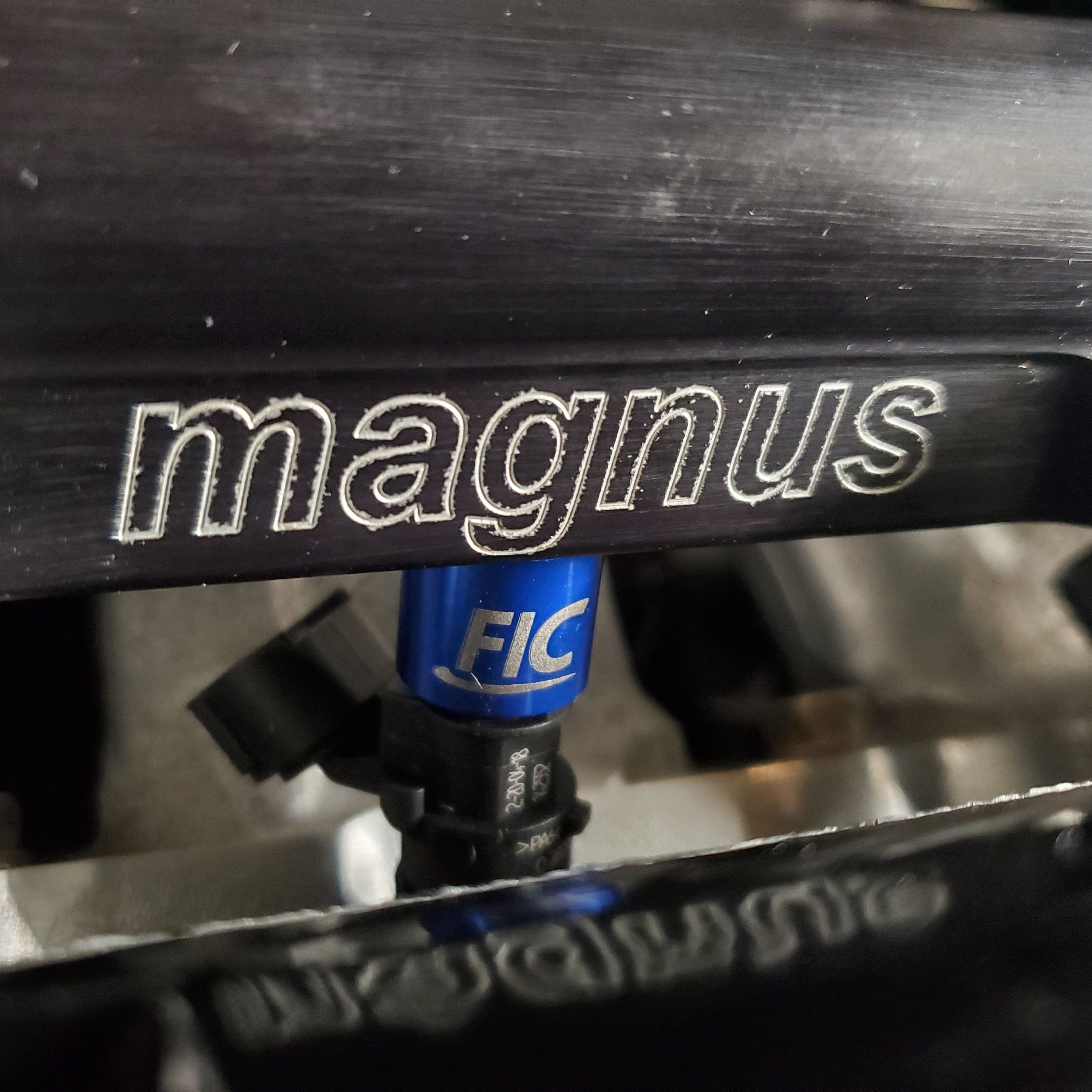

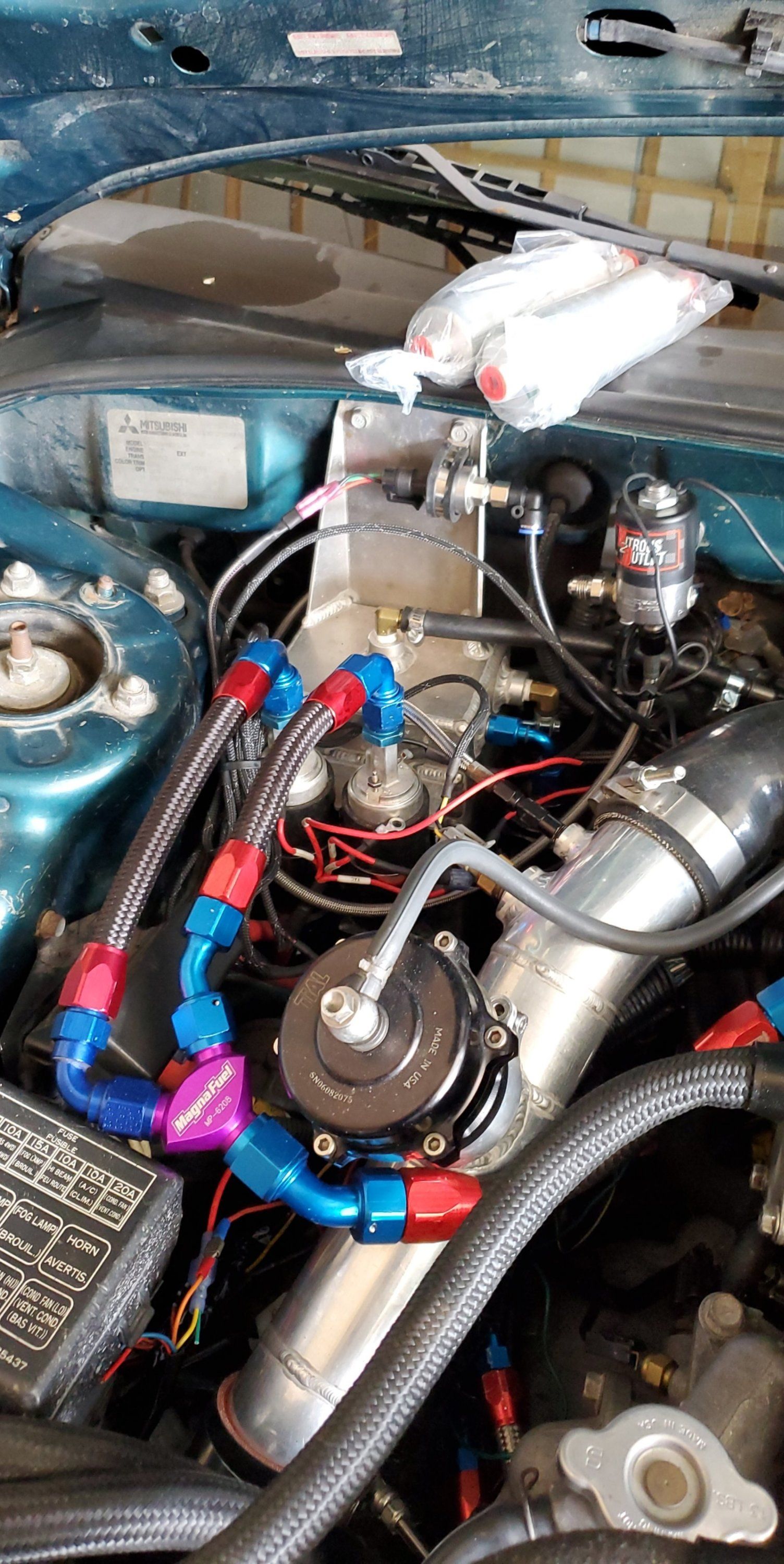

FIC 2150s installed

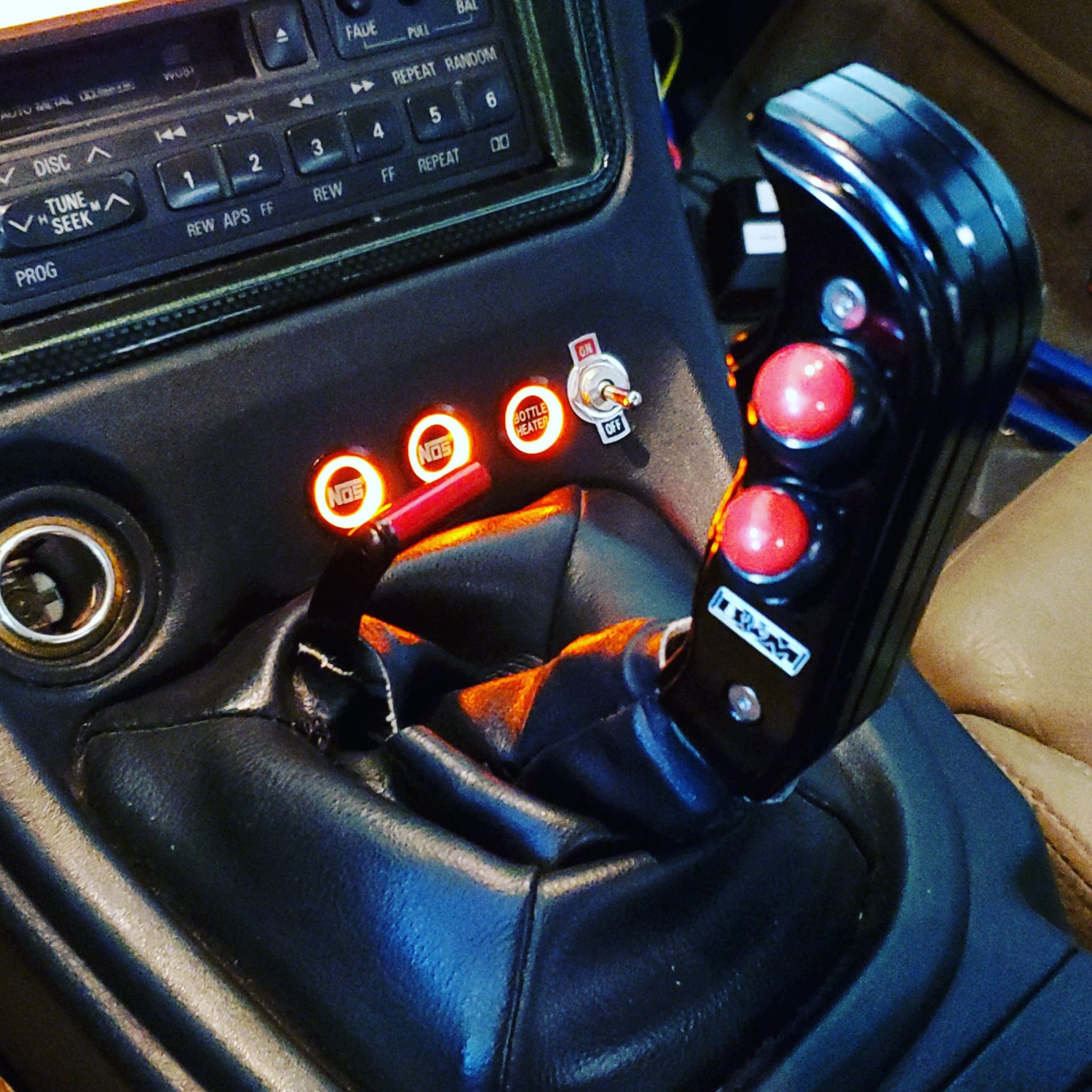

Nitrous buttons installed on shifter and arming switches on the console. Huge thanks to my friend for helping me wire these Billet Automotive buttons.

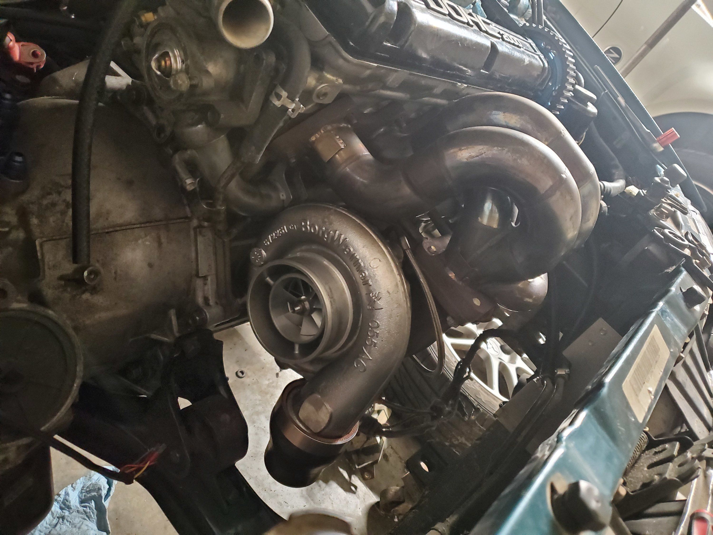

After several months of work the car runs! I found one external 255 was completely dead/locked up and getting hot with power applied. I went ahead and replaced both 255s

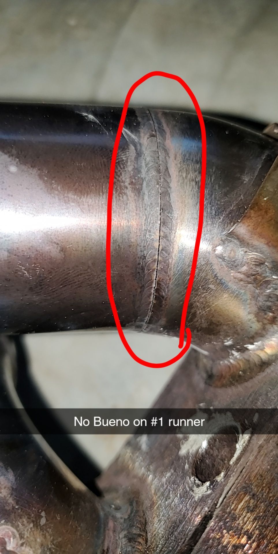

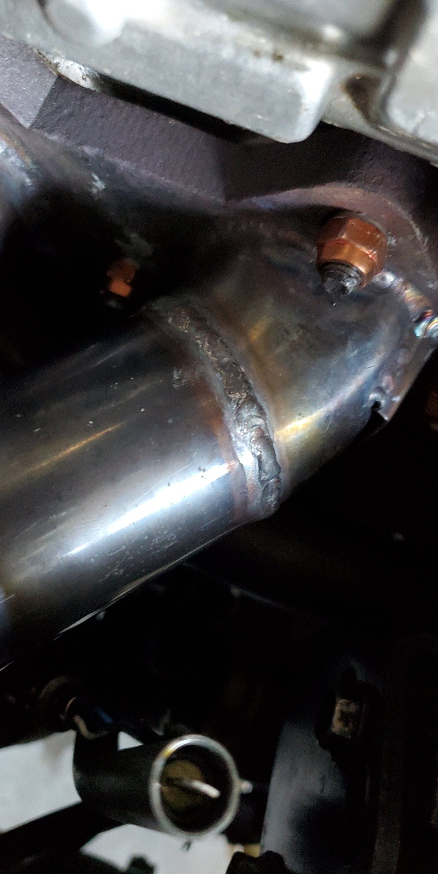

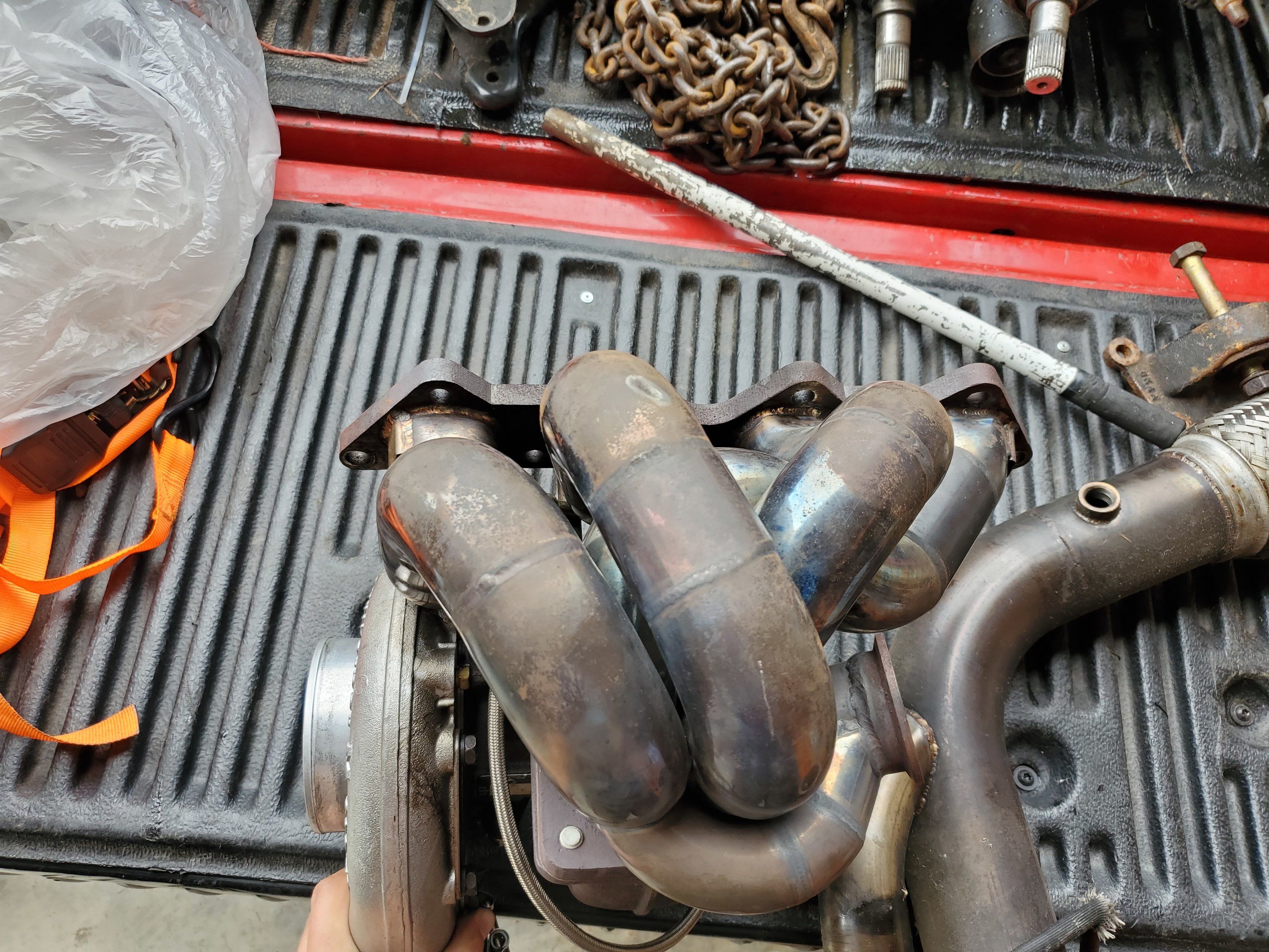

Then the manifold cracked. Luckily a guy about 50 miles from me was able to weld it up within a few days and it was back together.

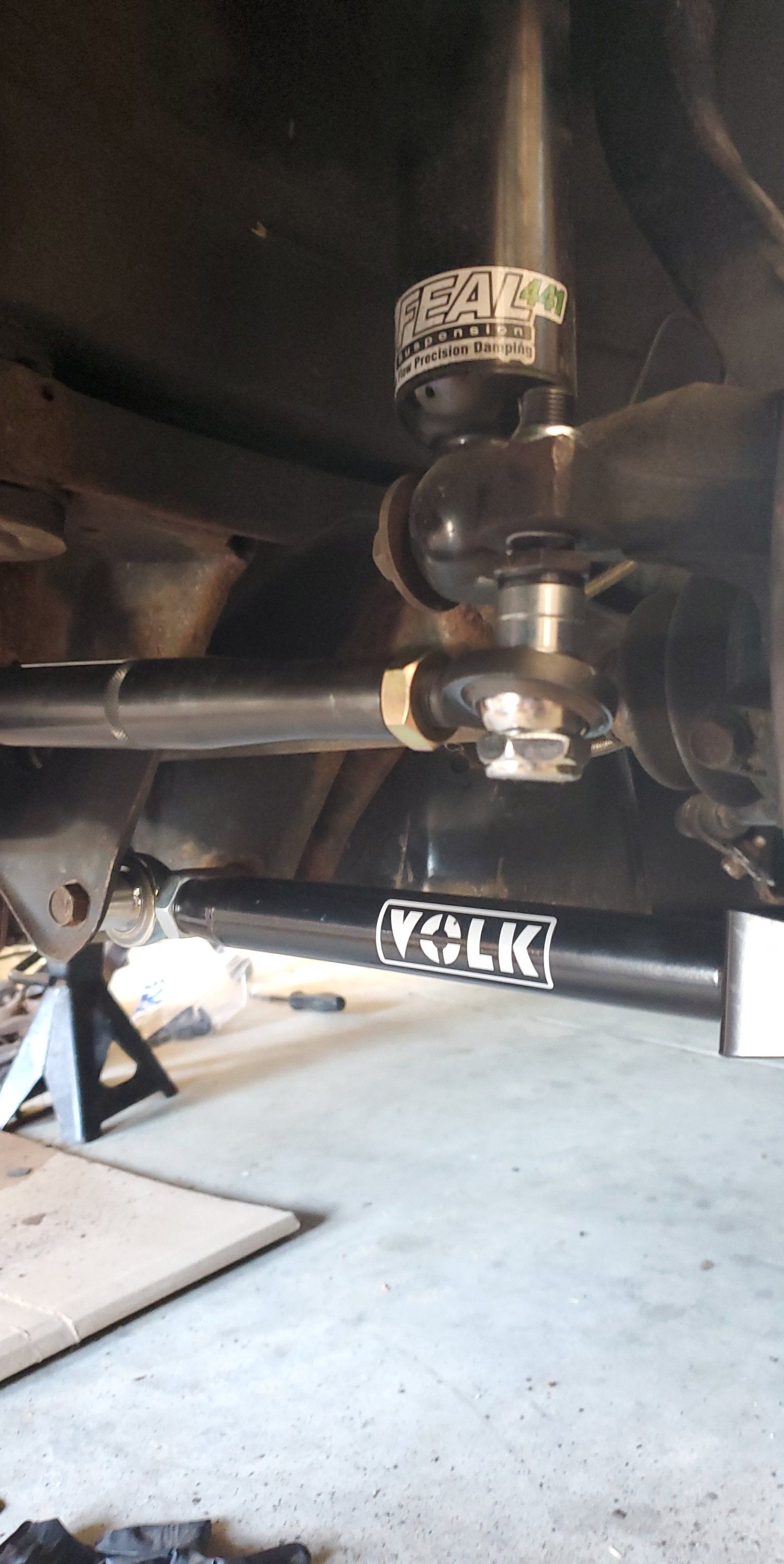

I swapped a set of Drag spec Feals on the car from my old purple car. And Volk Metal Craft rear lower control arms and toe rods

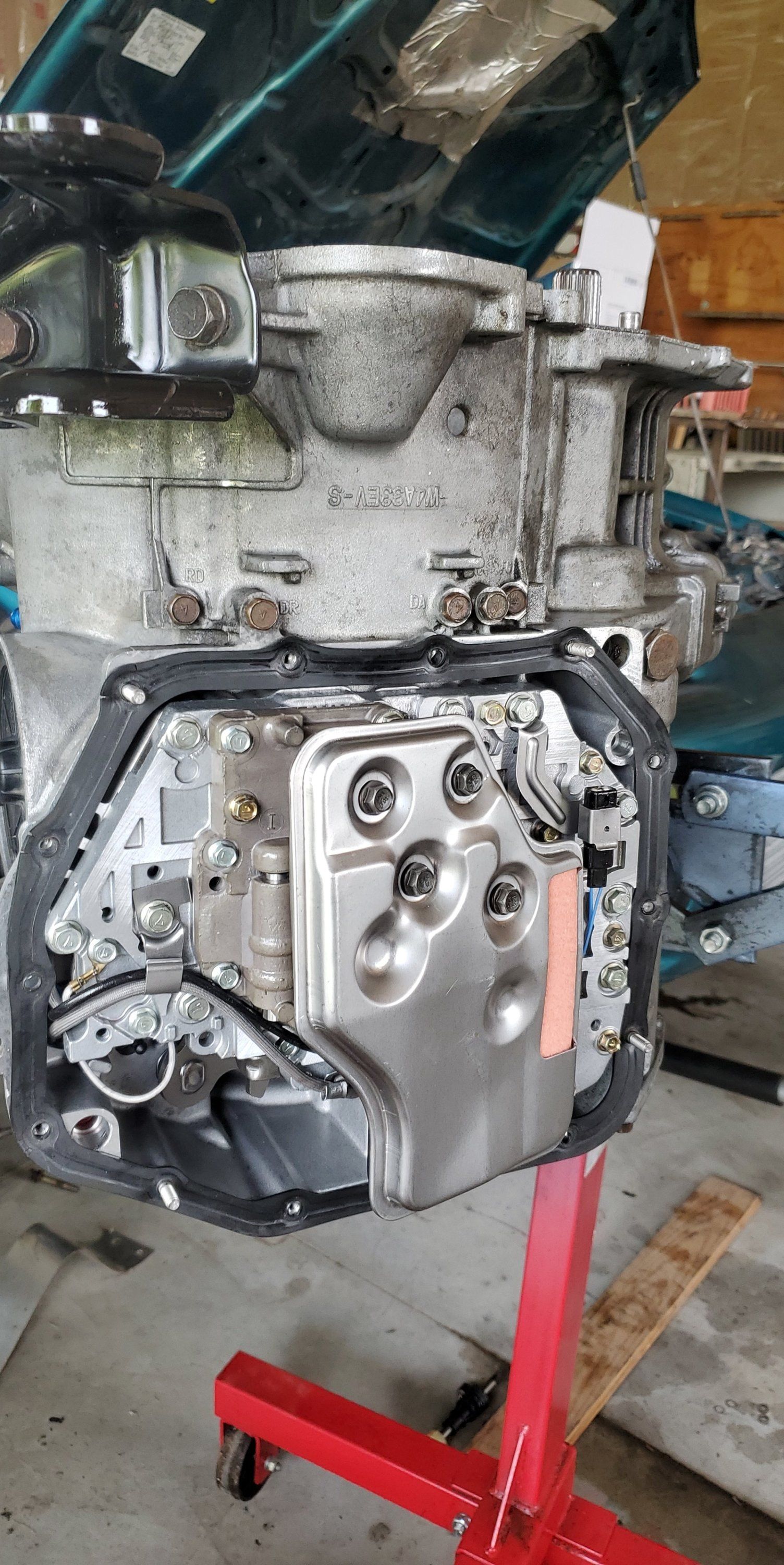

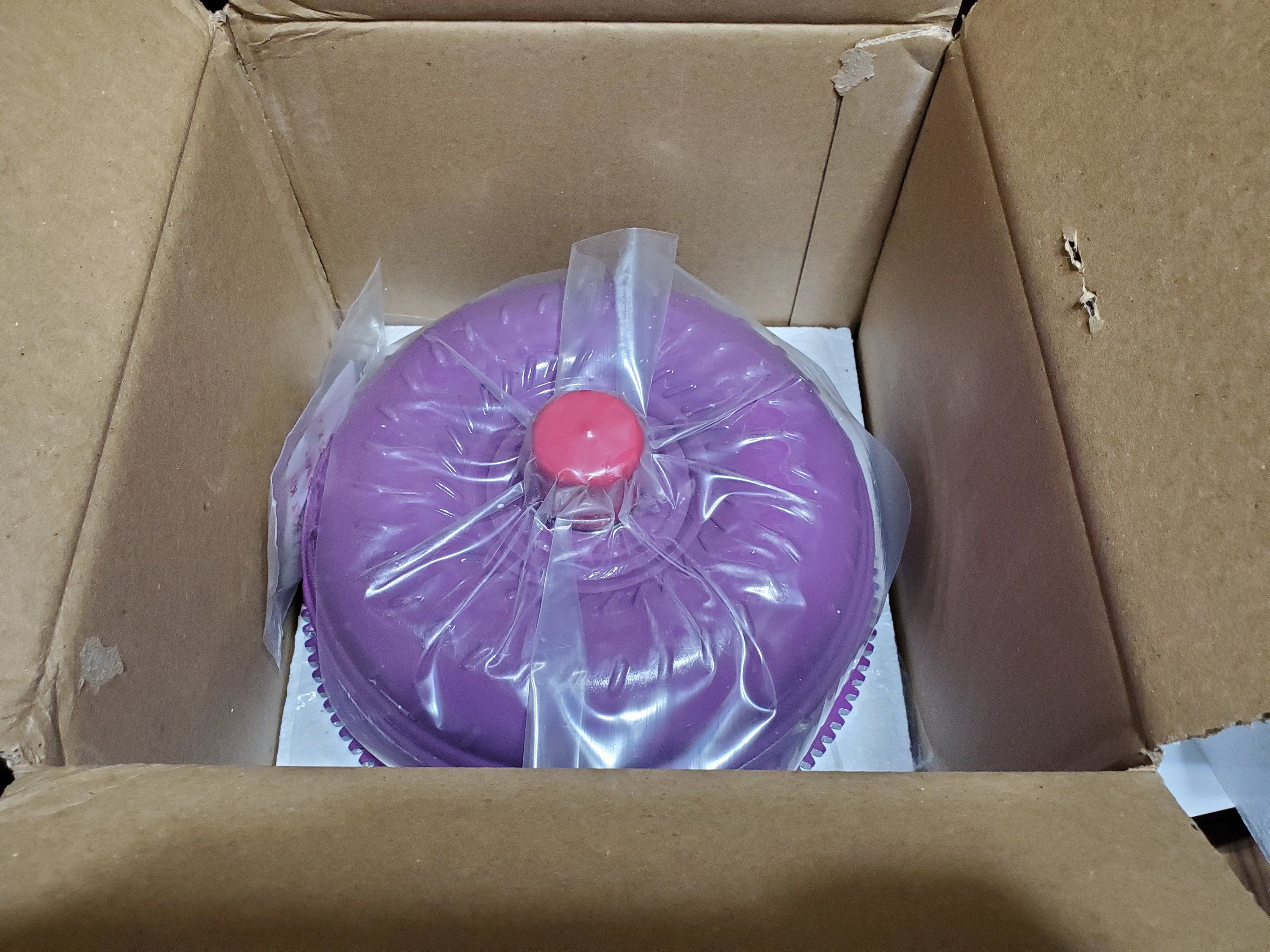

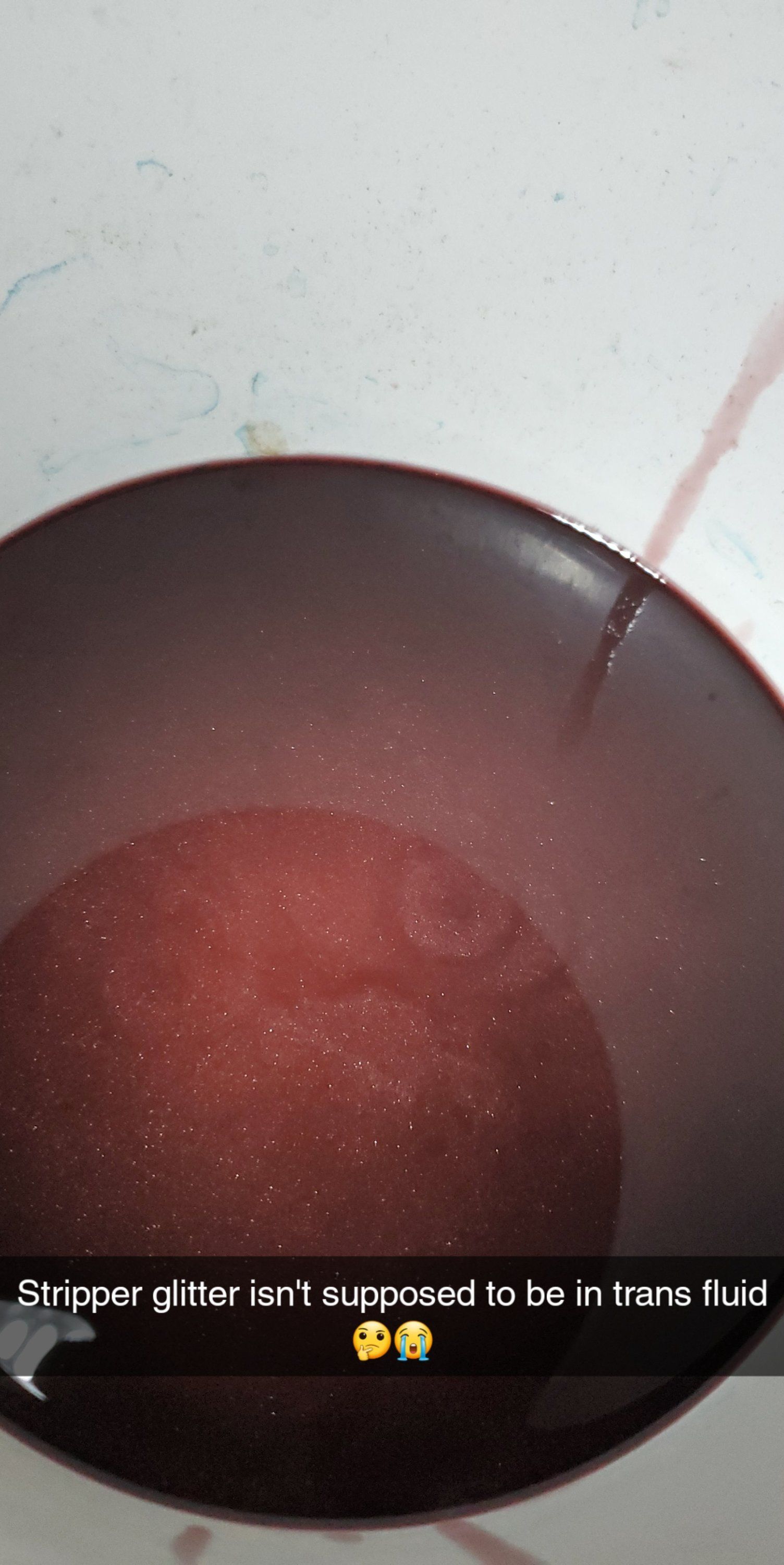

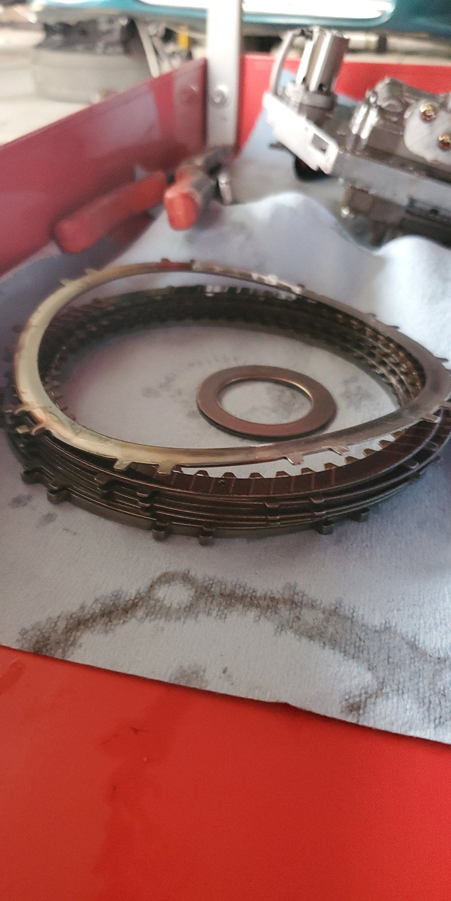

I spent some time the next day diagnosing the car and found the trans was slipping something awful. I pulled it apart and the converter was making a racket with noise and would bind up when spinning it on the input shaft. I sent it back to Precision and they called me within a day of receiving it. They were super apologetic and said that everything is furnace brazed on the converter, but they missed furnace brazing a fin on the turbine. That fin folded over and was causing slippage. Everything was covered under warranty and I just received it back yesterday.
Fluid was full of metal

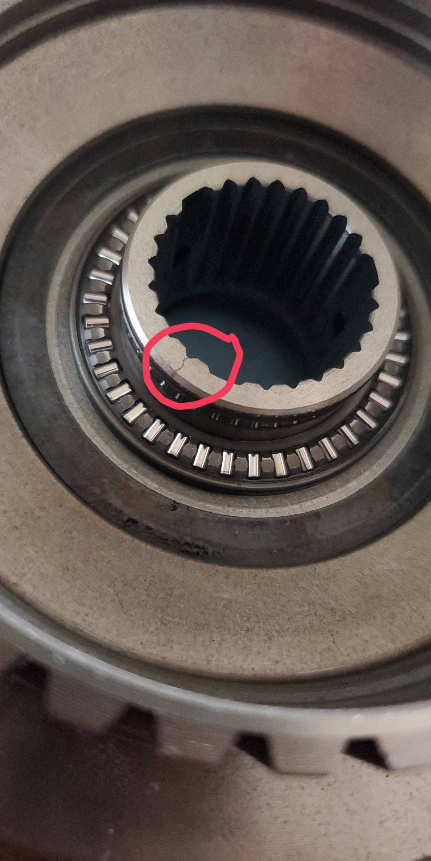

Forward drum was cracked
Warped clutches
I ordered an Alto Eagle rebuild kit, cleaned everything including the valve body and am currently waiting on a Jeff Bush Forward drum to come in to replace the factory drum that is cracked at the splines. Then I will be able to put it back together
Also right before I tore the trans out of the car I took my brother for a ride in it (also logging to see what was going on), it felt like it was down about 200whp from before. The trans parts definitely explain why!
