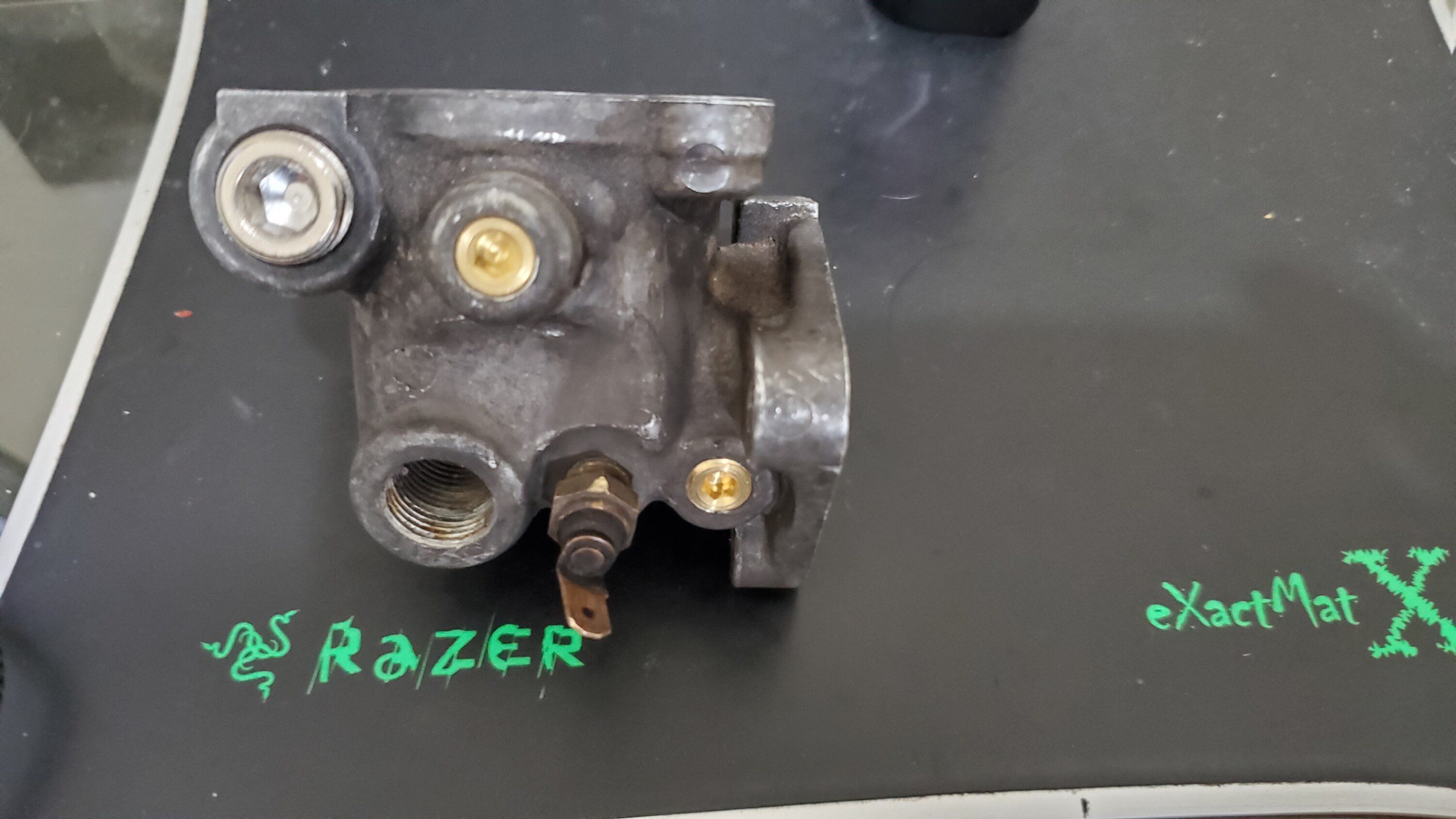

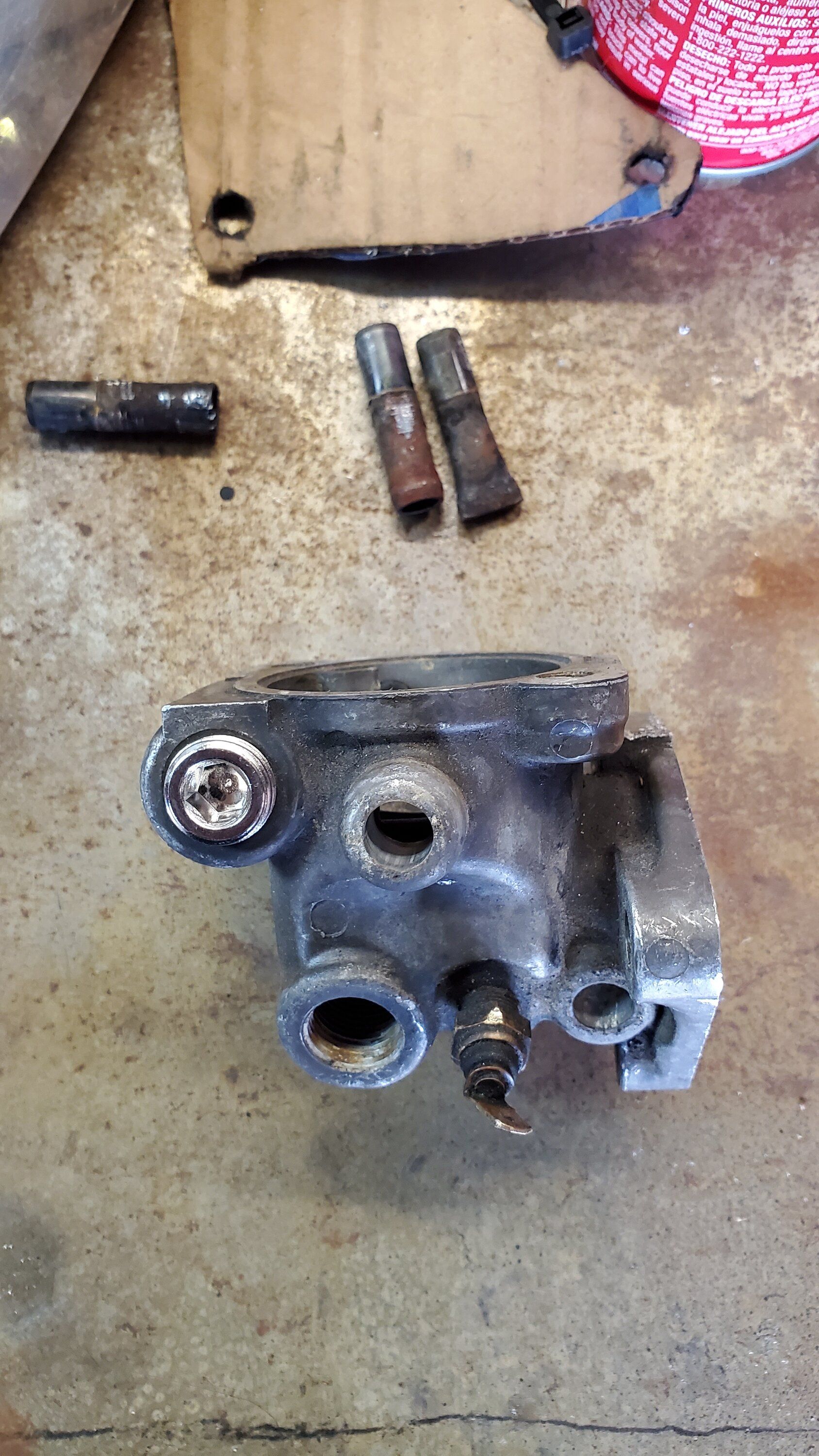

Got some miles on the car... and unfortunately I think it might be lifting the head. I have a high coolant pressure issue at the minimum. I dont yet know if its a head gasket issue or what. The t-stat seems to be working fine. I knew there was an issue when after making a pull I smelled coolant. Pulled it off to the side and found two coolant caps on the t-stat housing weren't holding coolant. One is for the heater core, and I had a 5/8 cap and clamp on it. They were missing, and the port was naked. The other was the 3/8 port right above it that goes to the throttle body. This is the concerning one. The brand new cap had blown the tip off, and the remaining portion was still clamped to the nipple. So I might be saving for an engine refresh before long...
There was def a lot of pressure in the system. I pressure tested the cooling system to cap pressure prior to startup, and had no hint of issues with those hose caps. I am currently running the small water pump pulley, so its spinning faster than it ever has before. That makes me think maybe I should just buy the evospec pulley. The oil is still extremely clean.

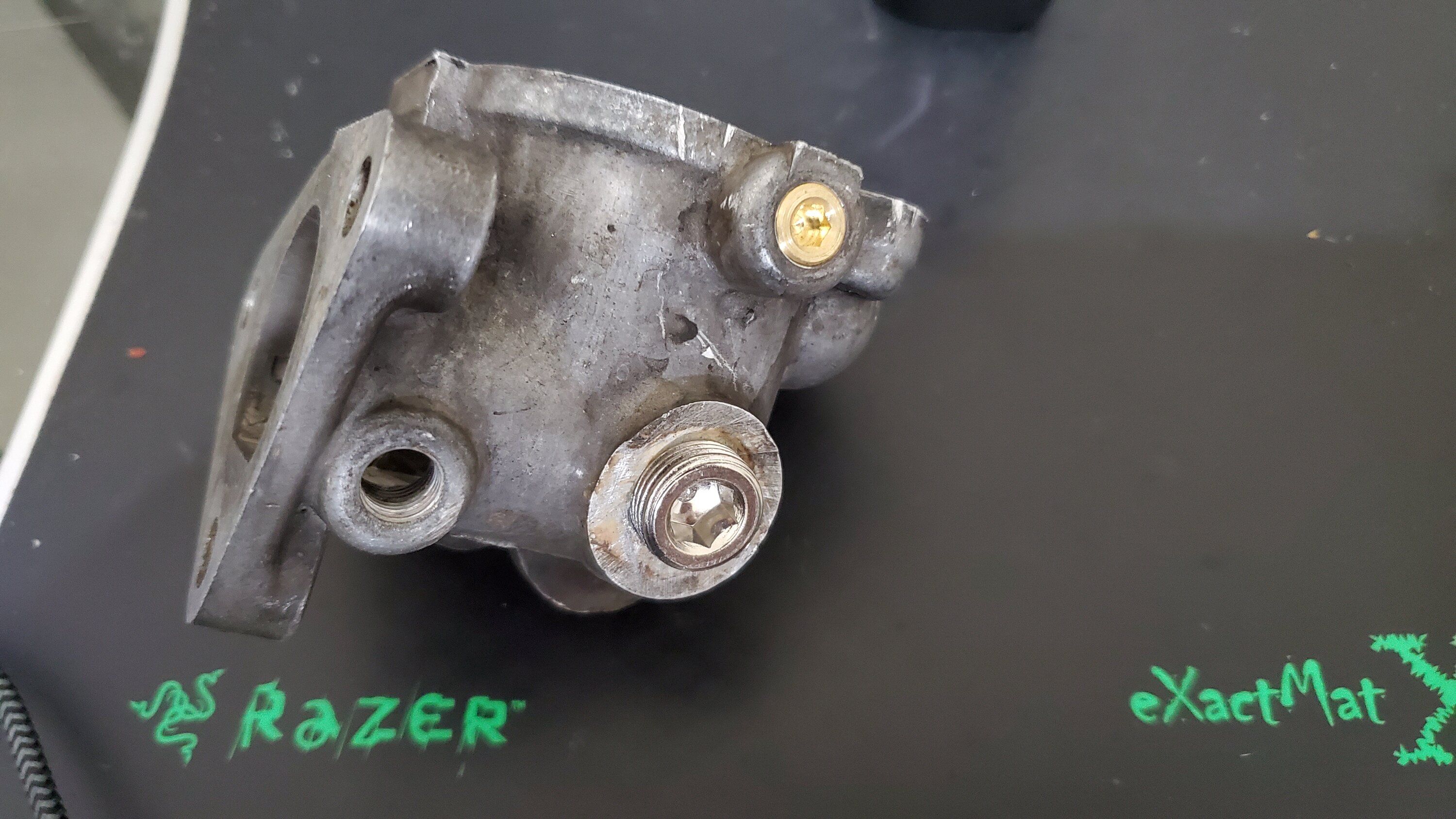

To avoid issues with stupid caps in the future, regardless of the source of high pressure, I removed all three press-in hose barbs on the t-stat housing. I then tapped the holes with a 1/8NPT tap and put plugs into each hole. I also put 3/8 BSPT plug into the heater core fitting. The open ports in the photo are where the ECU and gauge sensors go. To complete this, I am committing to ditching the factory oil cooler, because one of those ports is now going to be plugged. that means I have to deal with the water pipe as well. I figured I can probably get away with a plug on the inlet side of the system, but I might pull it off and weld the tip of the barb shut. I also have to deal with the heater core portion of the water pipe. I would like to put hoses back on once I fix my leaking heater core and figure out the cause of my high pressure, so I am not sure what the plan is. Might hack a spare water pipe down to bare minimum or try making one from scratch.
