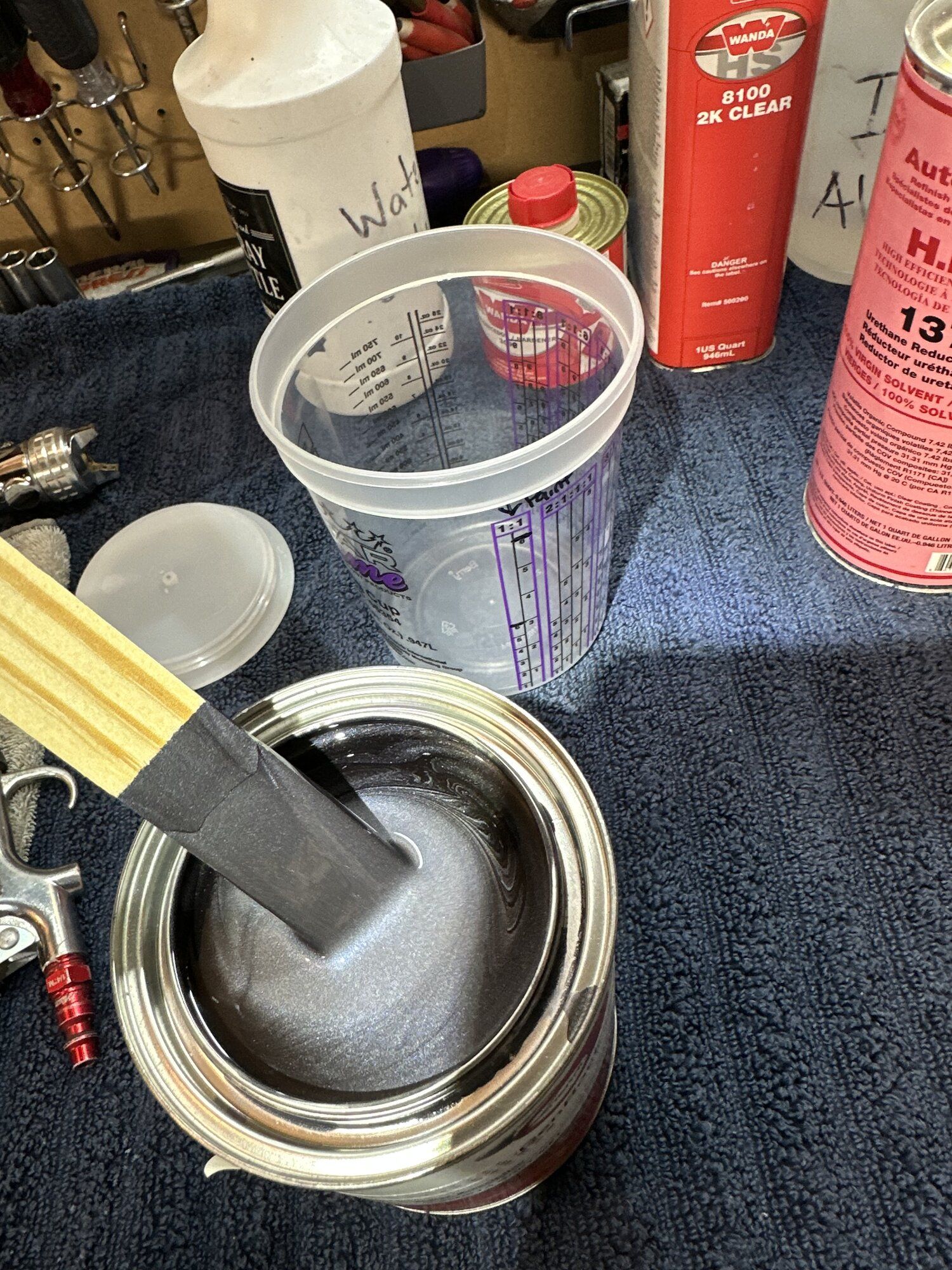

More of the photo dump. Guys at the paint shop I used here in Denver area were amazing and hooked me up with everything I needed and were so patient with all the questions I had. Also thanks again to Raf @PLDSM for the recommendation on the spray guns to use. They worked perfect with the regulator on the gun and the water separator.
Used one gun strictly for clear coat and the second for the primer/sealer. Cleaned in between primer and base of course.

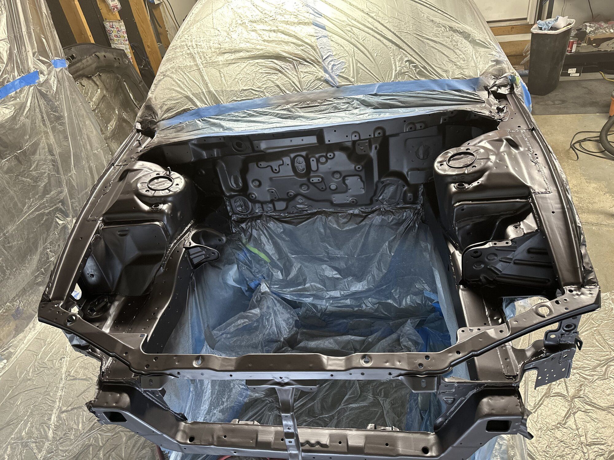

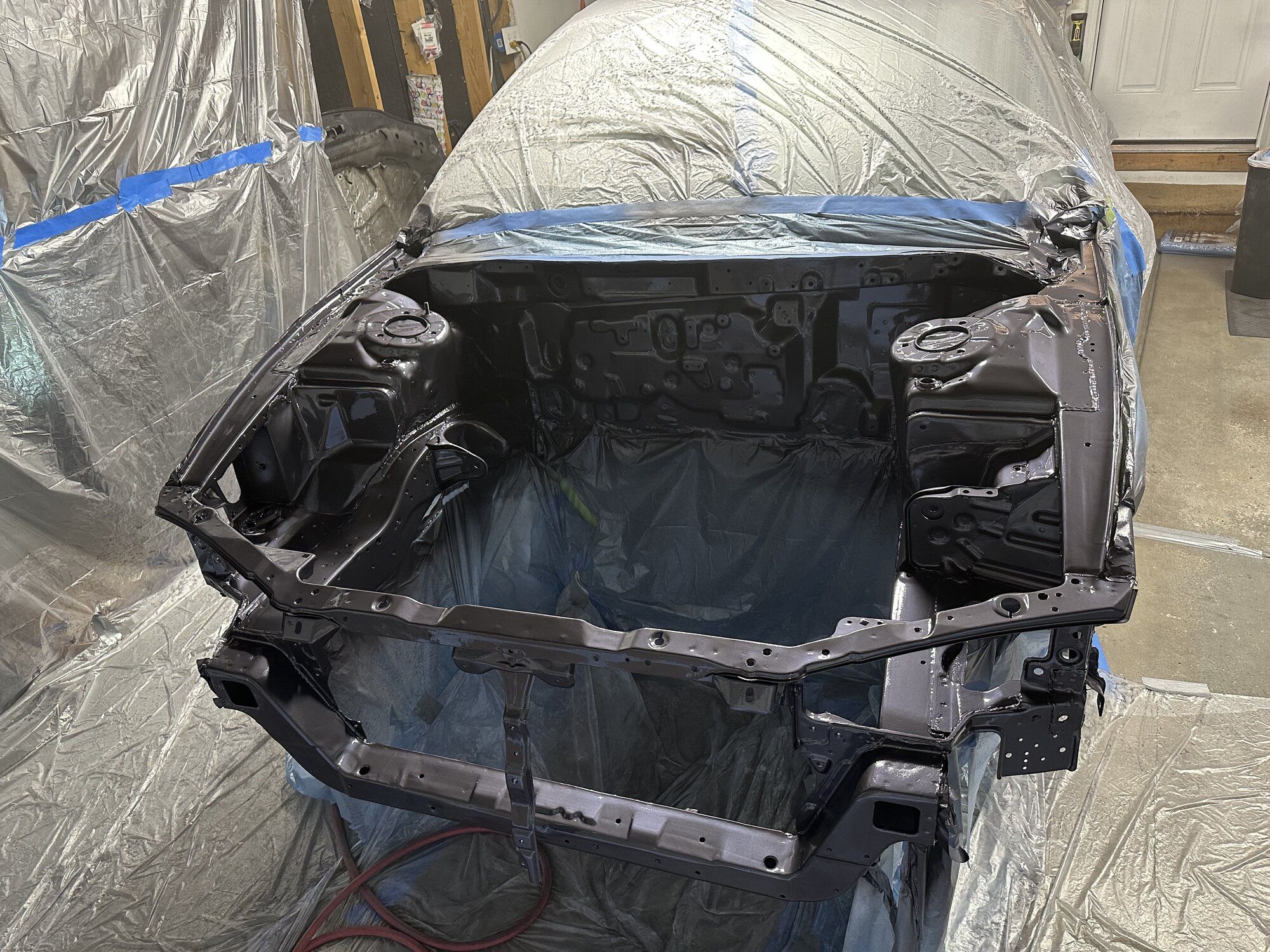

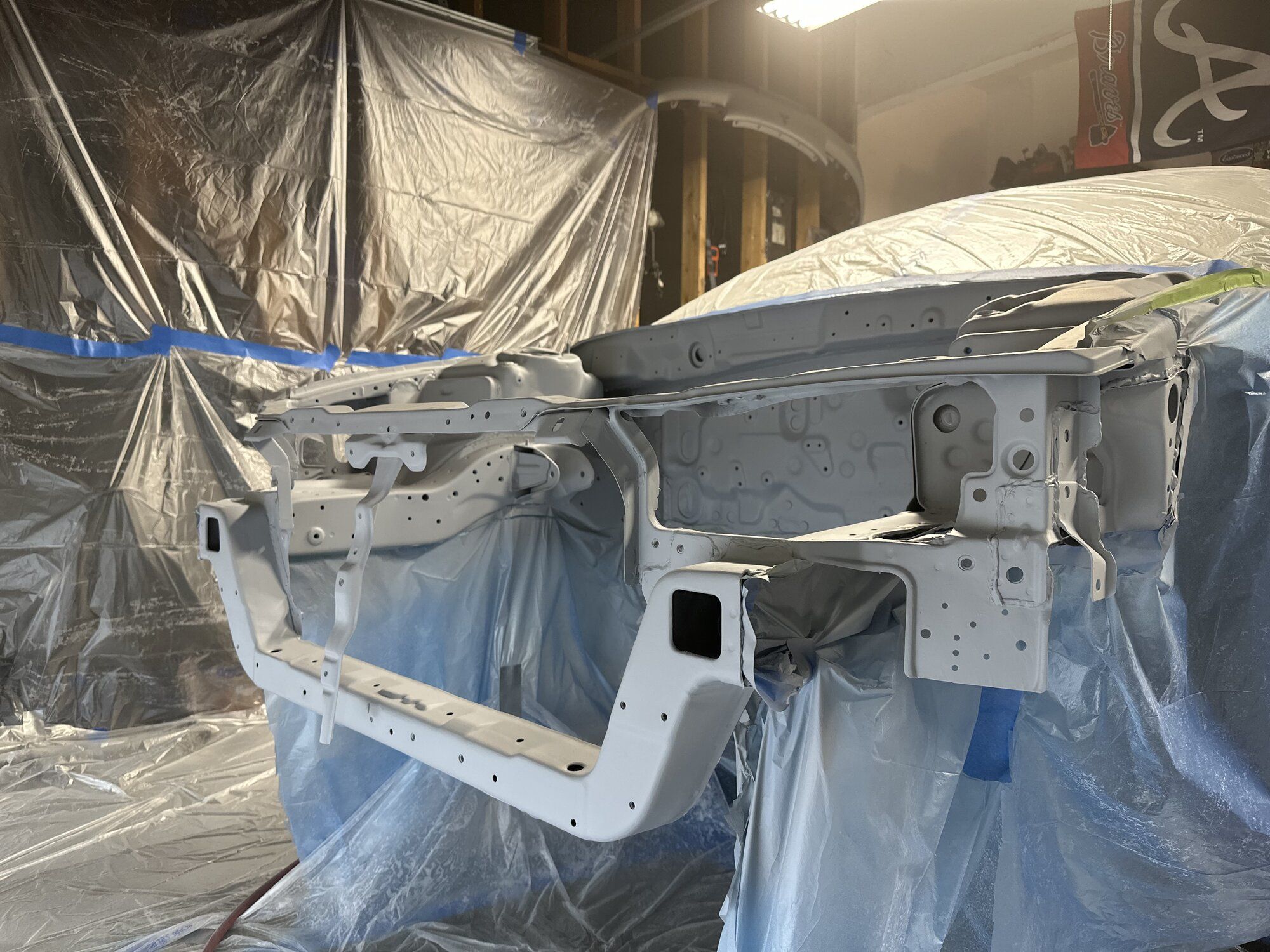

Here is the first steps of primer.

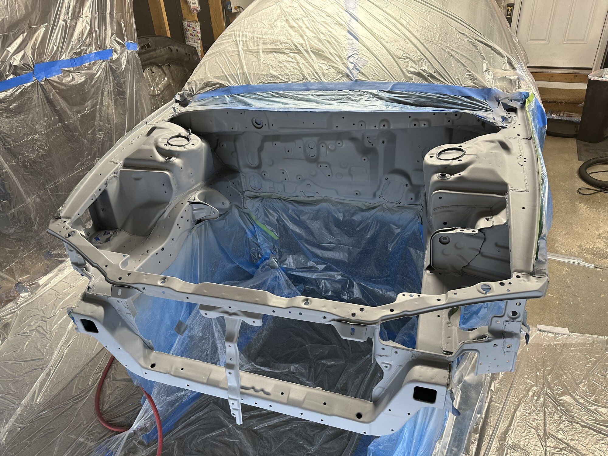

And then base. I LOVE this color sooooo much. Can’t believe I found the exact color I wanted and in such a clean shell.
Clear coated pic coming soon! Want to get it fully cured and wheel it as far into the sun as I can first LOL. But here it is in the “booth” still.

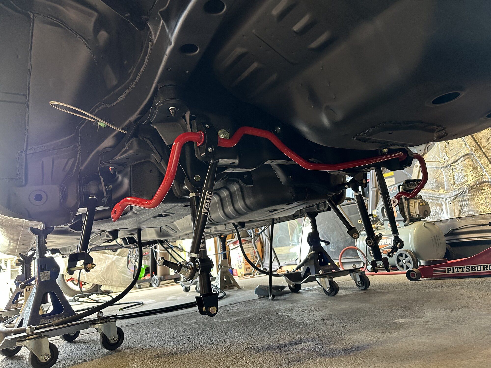

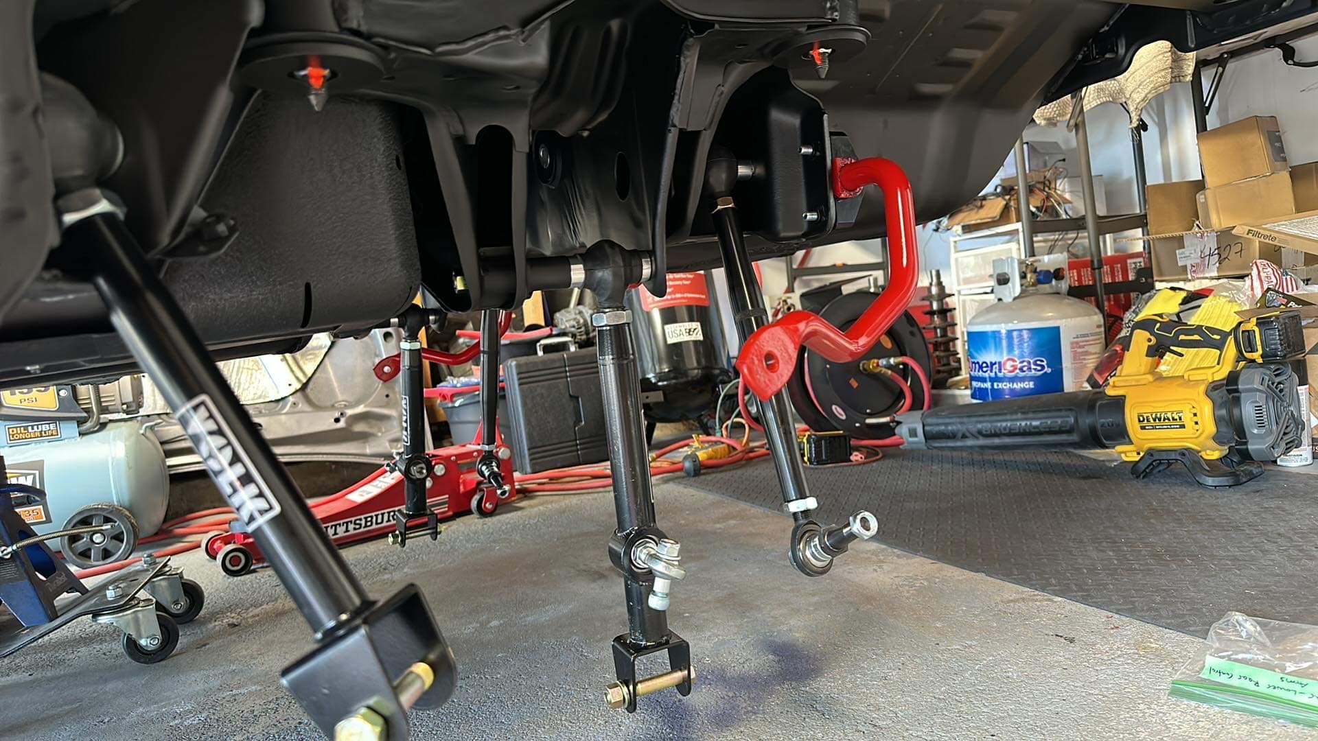

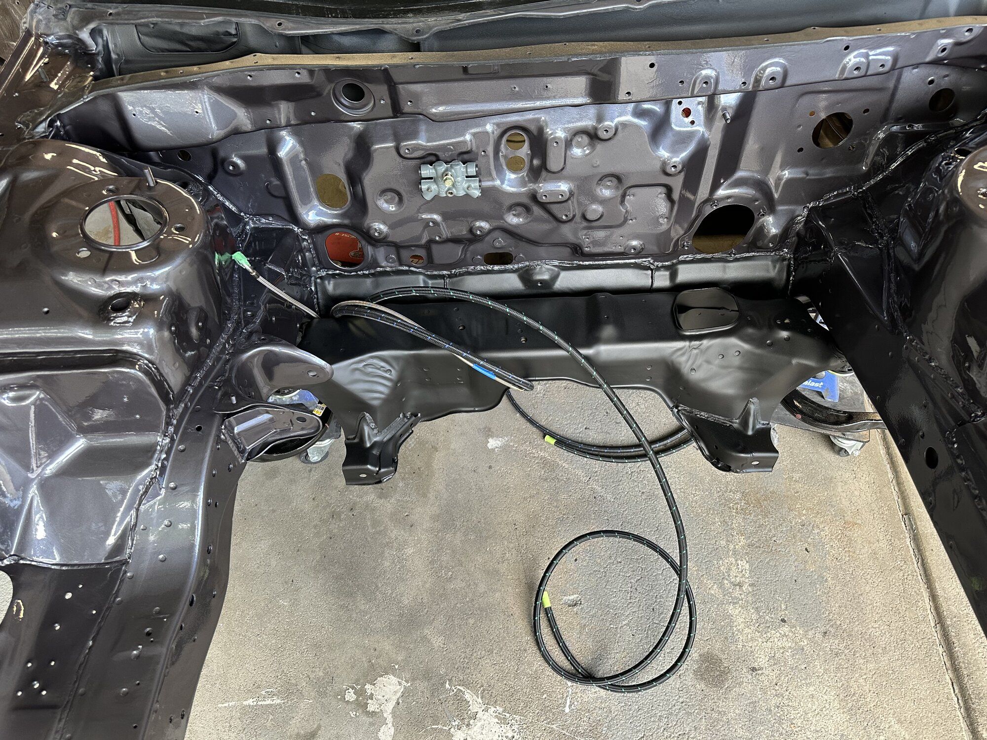

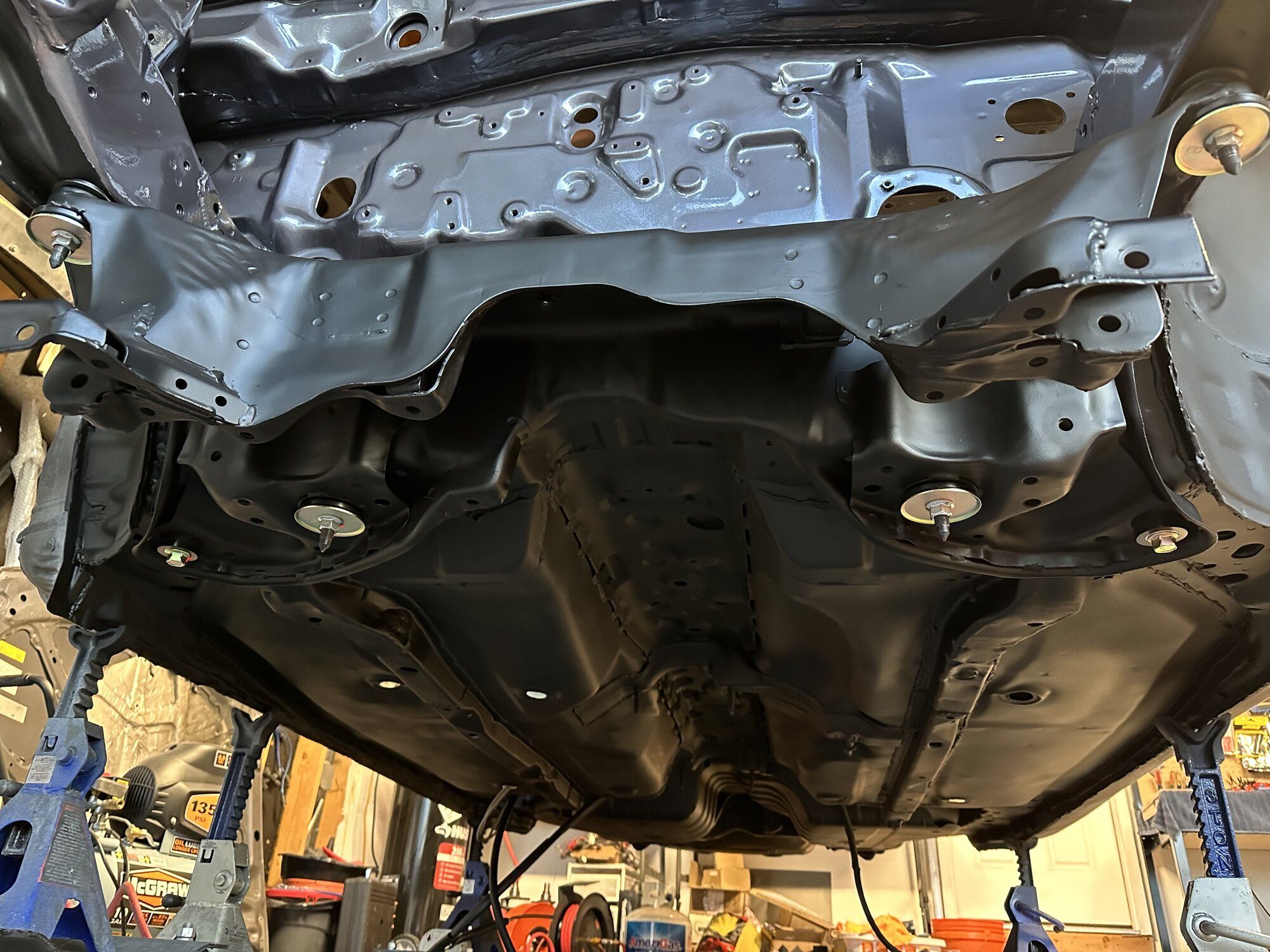

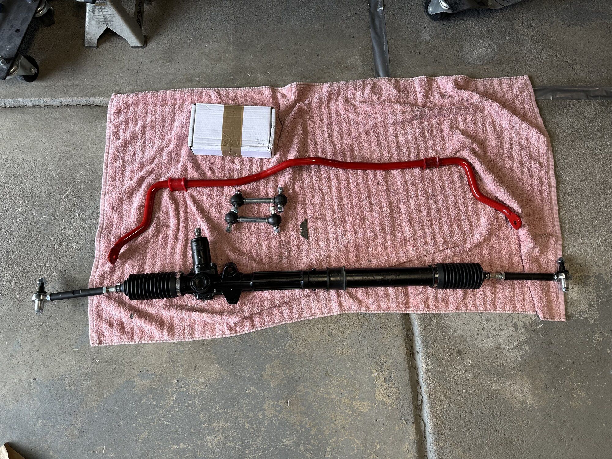

More work completed. Things are starting to go a little more smooth and better now. So far nothing has fought me too hard and luckily I had already planned parts ahead of time so not much down time waiting. MachV sent me one wrong bushing for the swag bars so have to wait on the front bar.. but not too bad. Already had the Quaife rack and @EC17PSE bump steer kit so was a piece of cake to get manual steering rack together.
Shoutout to @Kai Hefner for the fuel/brake line holders custom to the sizes I need when finishing up the lines under the car.
Also using @EC17PSE billet sway bar brackets too. Everything he makes is amazing and high quality. Can’t thank him enough.
Also huge shoutout to @99gst_racer for the #racecar parts that are also amazing and top quality.

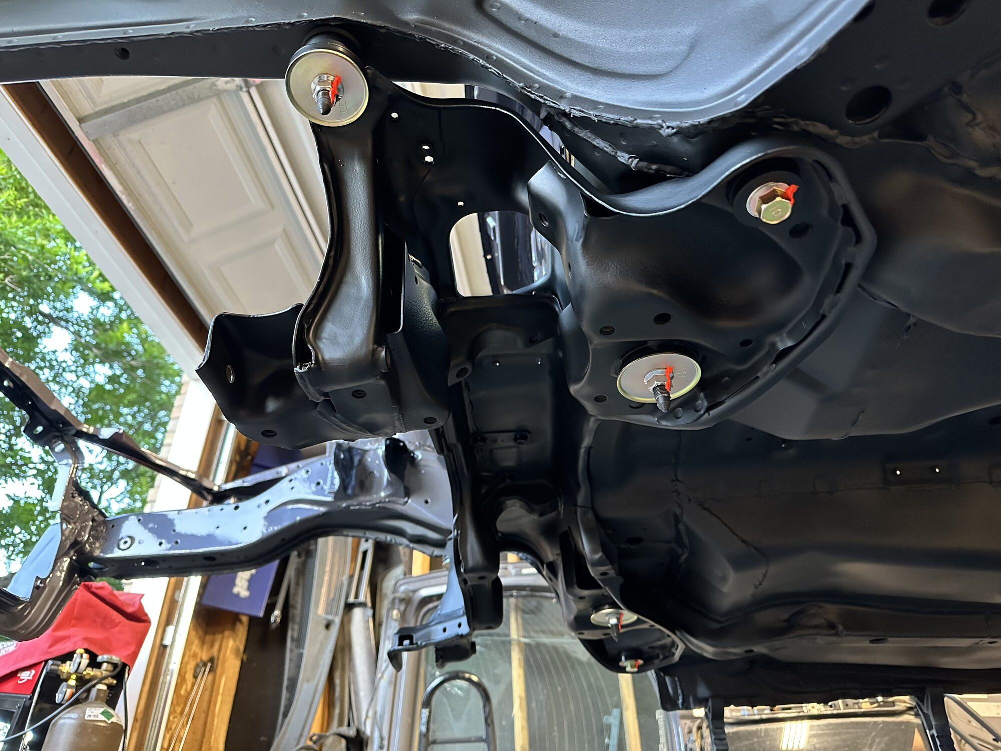

Suspension going back on..
Rack almost ready to go on.
And lines ran through the front subframe
Now for a break LOL.

Looking great! Those jacks still concern me though, LOL. Please be careful.
Yeah they are definitely not ideal, but they work well when I need to get the car out of the way so the Tesla can be in the garage. For the next one, I would 100% get a rotisserie for sure. When I am under it I also put a second set of stands up just in case.
