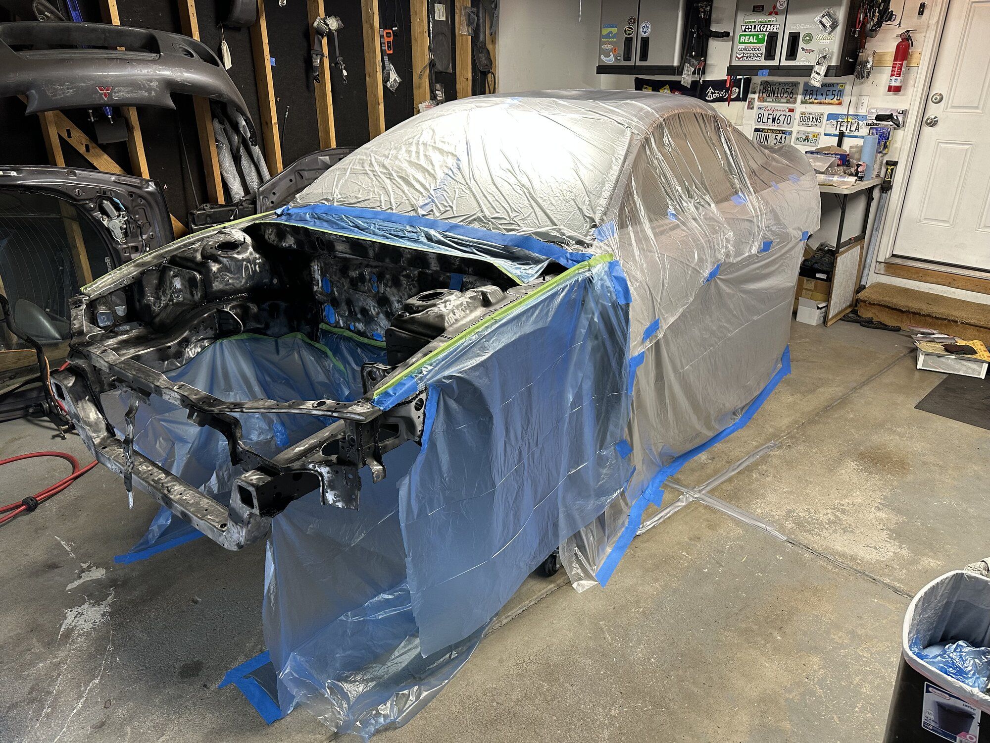

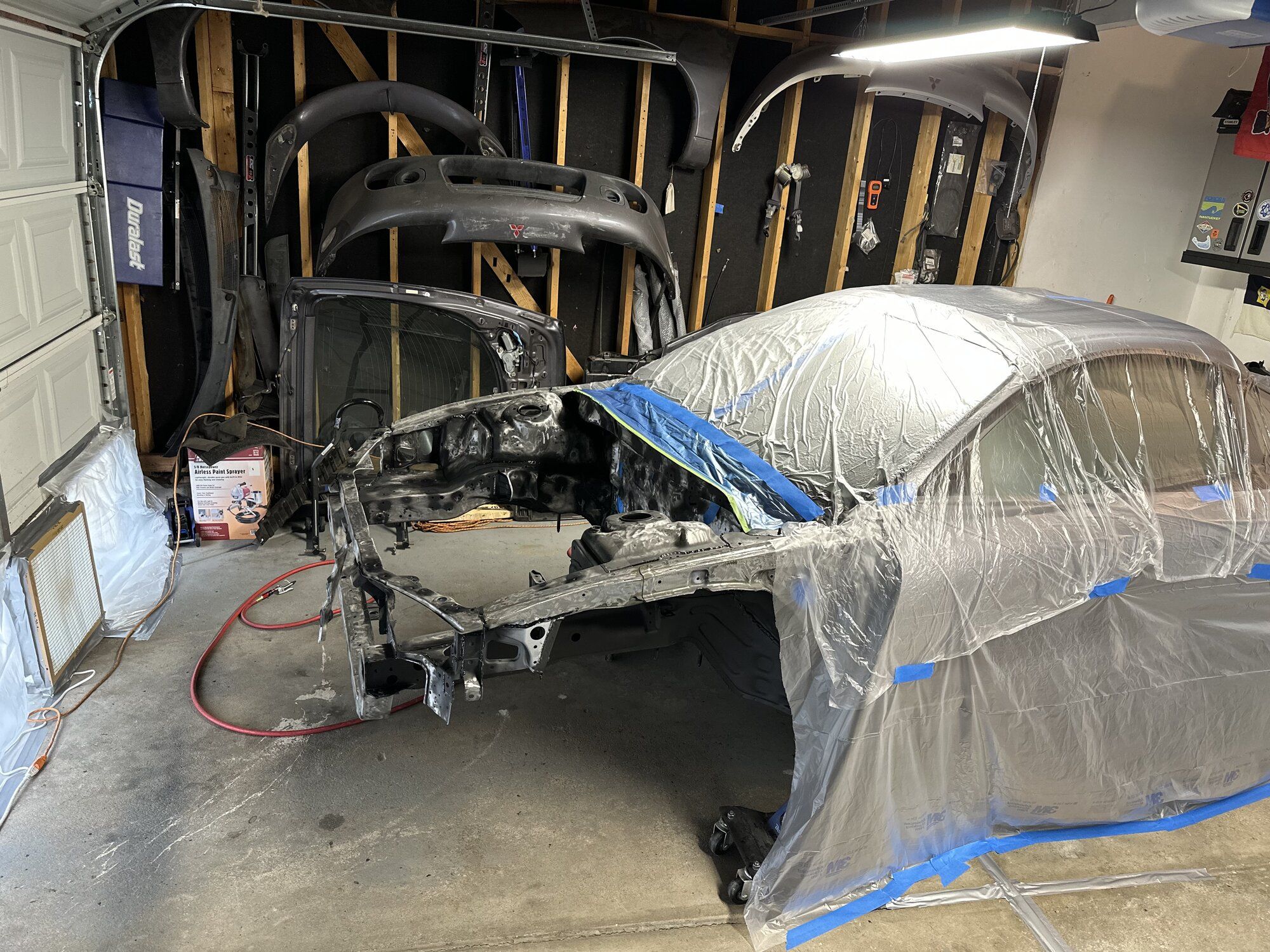

Well everyone.. I finally sucked it, had three days off without the wife at home, and avoided painting the bay long enough. So here is part of the process and let me be first to say… if I had to do it all over again, I wouldn’t. Sure I learned a new skill and I can say when I open the hood I did everything myself.. but the hassle and cost of doing this was almost unbearable. Hours and hours and hours of prep/sand/sand more/clean/treat rust/sand/sand more/seam sealer/seam spray/sand. And that’s just to get to start seriously prepping to begin to paint. AND not to mention, this is my first time EVER spraying before, ever. So of course it’s not perfect because by butt decided to hit some spots and one tiny weeny run.
BUT! It’s done!! One step closer to shootout.. huge photo dump coming and I want to try and be as clear and open about the process I used as I can. Also HUGE and I mean absolutely gigantic shoutout to @PLDSM for putting up with my annoying texts and calls and calming me when I was panicking LOL. Most solid dude ever.
Ok so here is some sketchy shit first..
I has to rotate the body around to be able to spray the right away so here is the process LOL. It worked and no issues but it was slow and had to have help to make sure it didn’t drop.

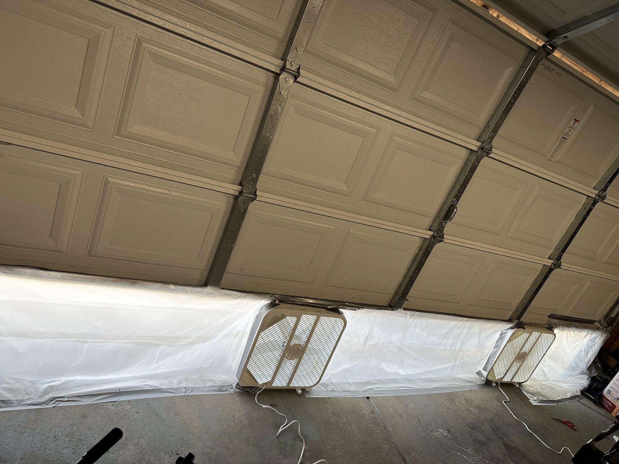

So now begins the prep work. First I went back over everything with a green scotch brite and then again with the red scotch brite. Cleaned and cleaned again, then started taping and masking everything off. Also had to make the filter/fans to pull everything out.

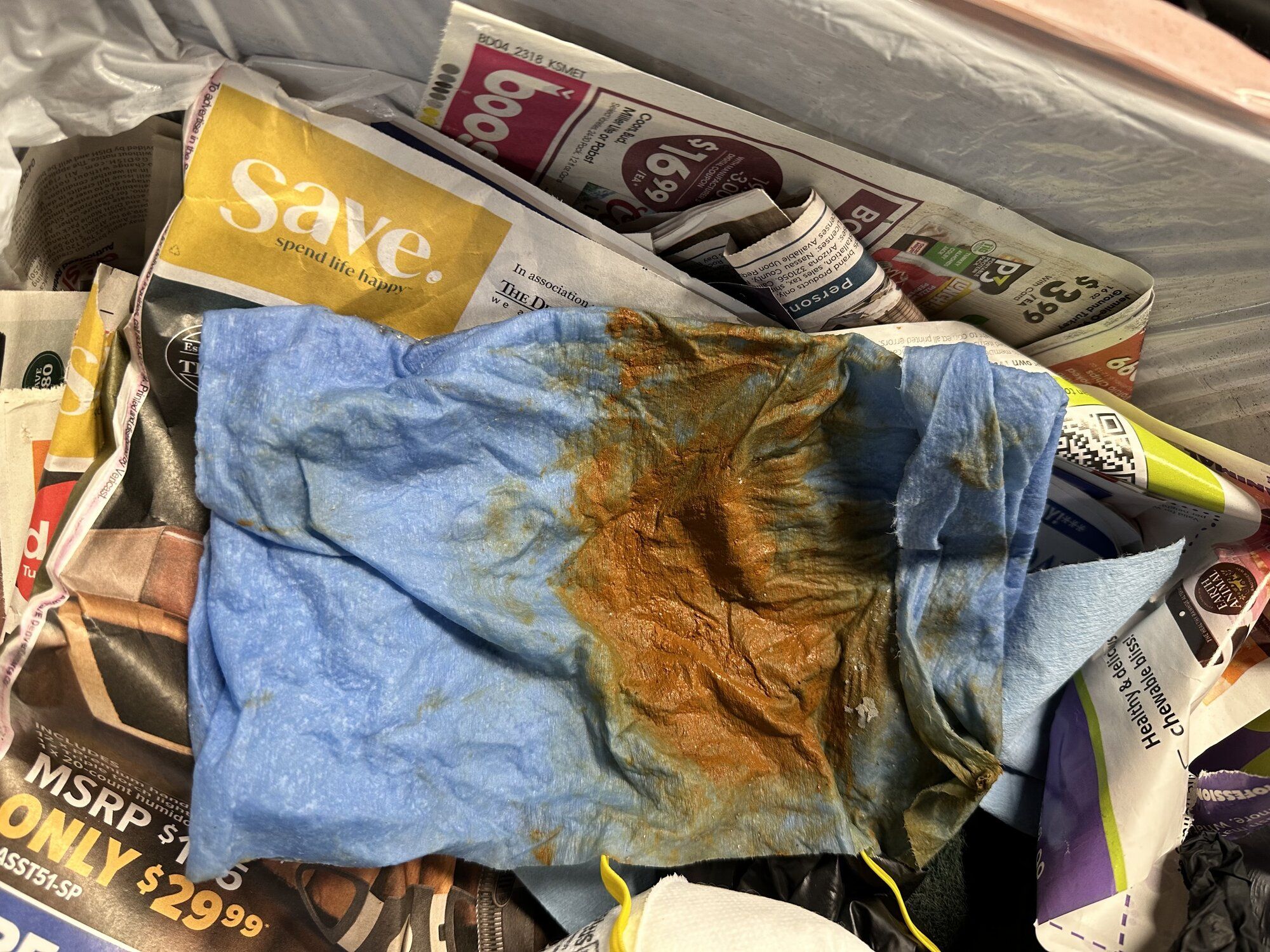

Also almost forgot, for people that find this and are thinking of doing it themselves, DRAIN YOUR COMPRESSOR. I would have not done this if it had not been for Raf and here is what came out. That is the shit that could end up in your paint!
After the drips stopped I still took a shop vac and left it on to evac the tank of anything else.
Yah dude I feel your pain with the prep. Still working on getting to the point where I say good enough to paint, working on 80 hours between undercarriage and engine bay.
I had sorta the same idea in mind with the garage door and filters and fans. We’ll see what I wind up with, glad to see it implemented LOL.
As far as the compressor goes I wasn’t taking the chance with moisture and rust especially here in humid Florida. My tank is coated so no rust comes out just clear water. (Leave tank drain open when not in use will minimize rust water build up). I finally ran an air management system throughout the garage and got a CFS filter system from Eastwood. (Very economical compared to others). They have a special filter you change out when it’s time to spray paints. Well worth the money!

That is a really good idea to just leave it open when not in use. I think I will be implementing it into my every day use now and not just when painting. IF I even paint more haha. Little secret though is that I do plan to paint the floors inside hahah. Had paint left over and been bugging me so just going to do it haha.
