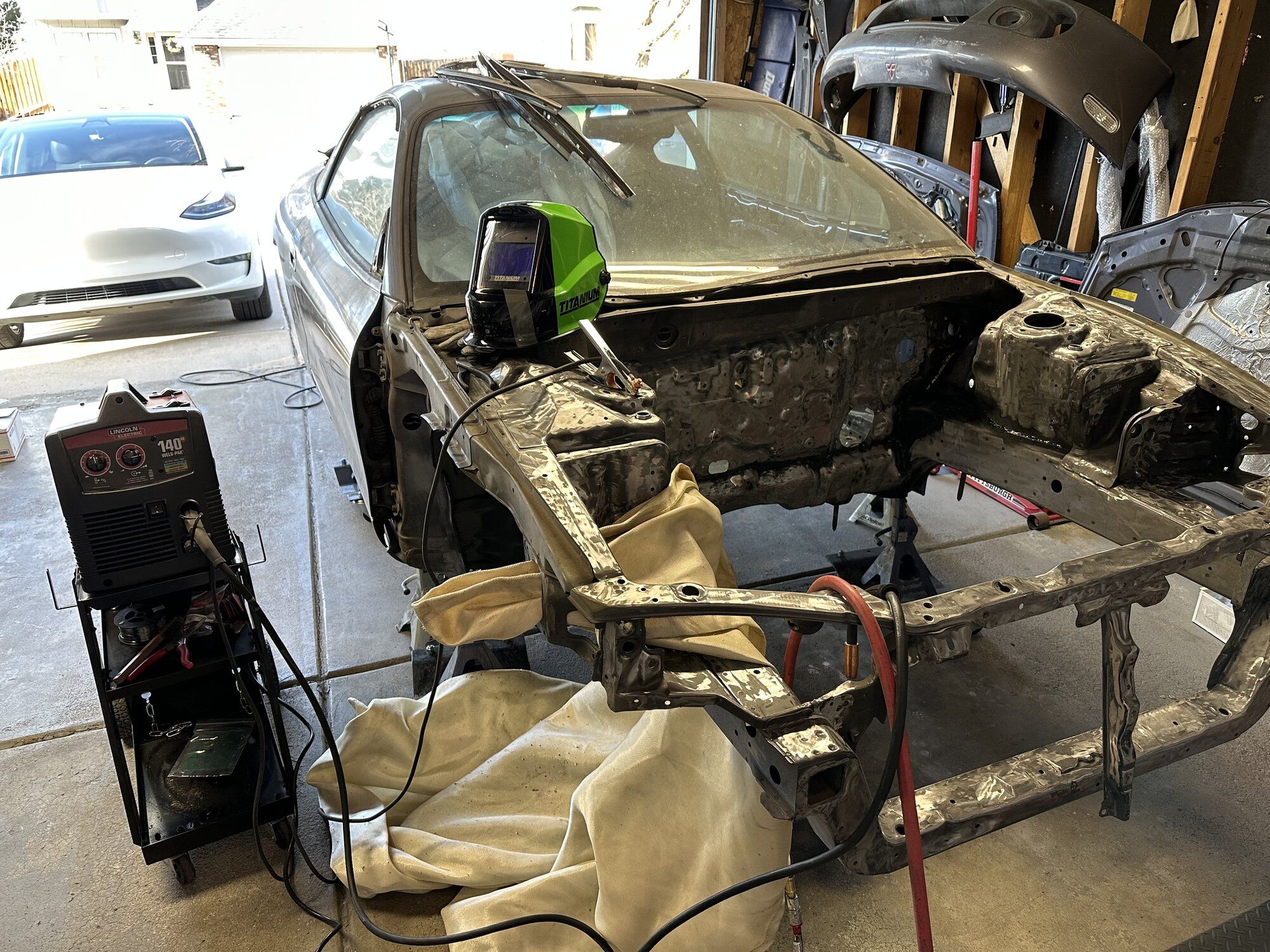

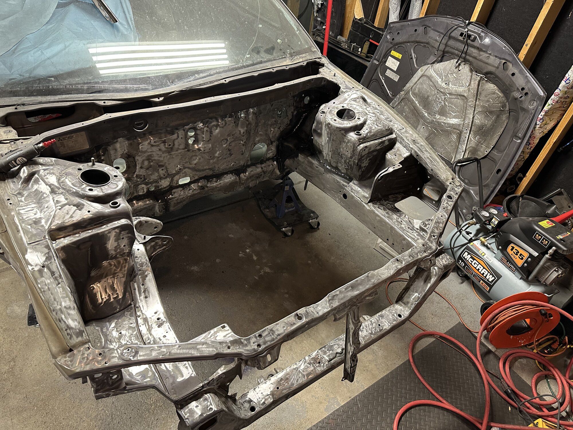

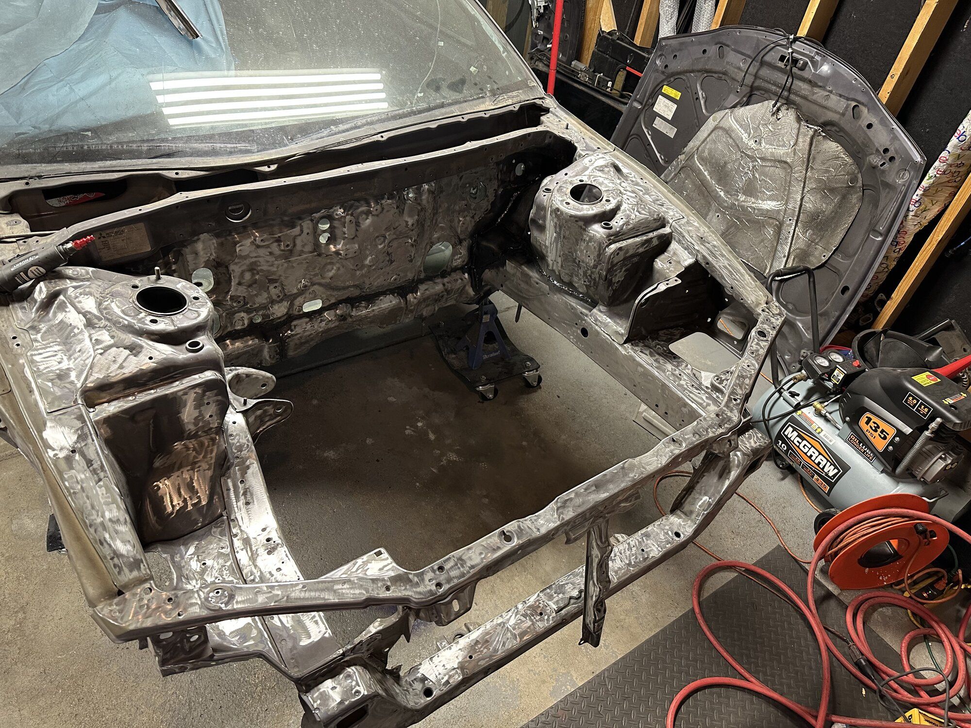

So started on the engine bay, huge pain in the butt as well hahahaha. Just so much work to get everything down to metal and clean. Still a lot more work to do but so far no more rust found and the towers are really clean.

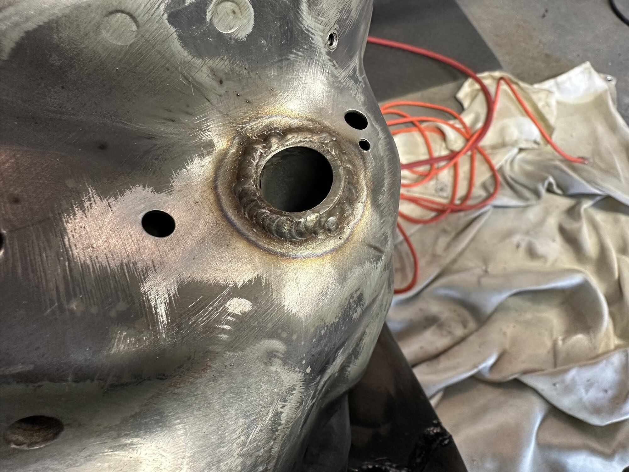

While you are here you will want to consider welding the seams a bit more and upper arm tubes. These tend to be a weak zone and although racers pull them you dont want them getting weak on you later and moving with nice coatings on, while its raw a bead of weld around the tubes will help protect for a long time for you.
Good advice Bobby. Would you recommend a continuous bead or would additional spot welds suffice at the seams?
So since this is now the second trusted person I know to suggest this, I am def going to do it. Jesse also recommended the same thing. As you know I am planning to track the car so now would absolutely be the best time do to it. I am thinking a continuous bead on the top might be best. Although knowing my skill, it will be in three start and stops.
I know nothing about welding but it's something I considered trying so it's on the list. My only concern would be warping the shit out of it.
For sure! I am going to stick a spare set of upper control arms I have up into the sleeves while I weld around the outside to help with that. Just control heat based on material thickness and wire feed with the machine and should be ok.
As long as the whole tube is welded you will be ok and it dont matter if its in 3 or 4 sections. Just however you can do it, smaller spots might be good as it will control heat better without burning through the towers thinner material

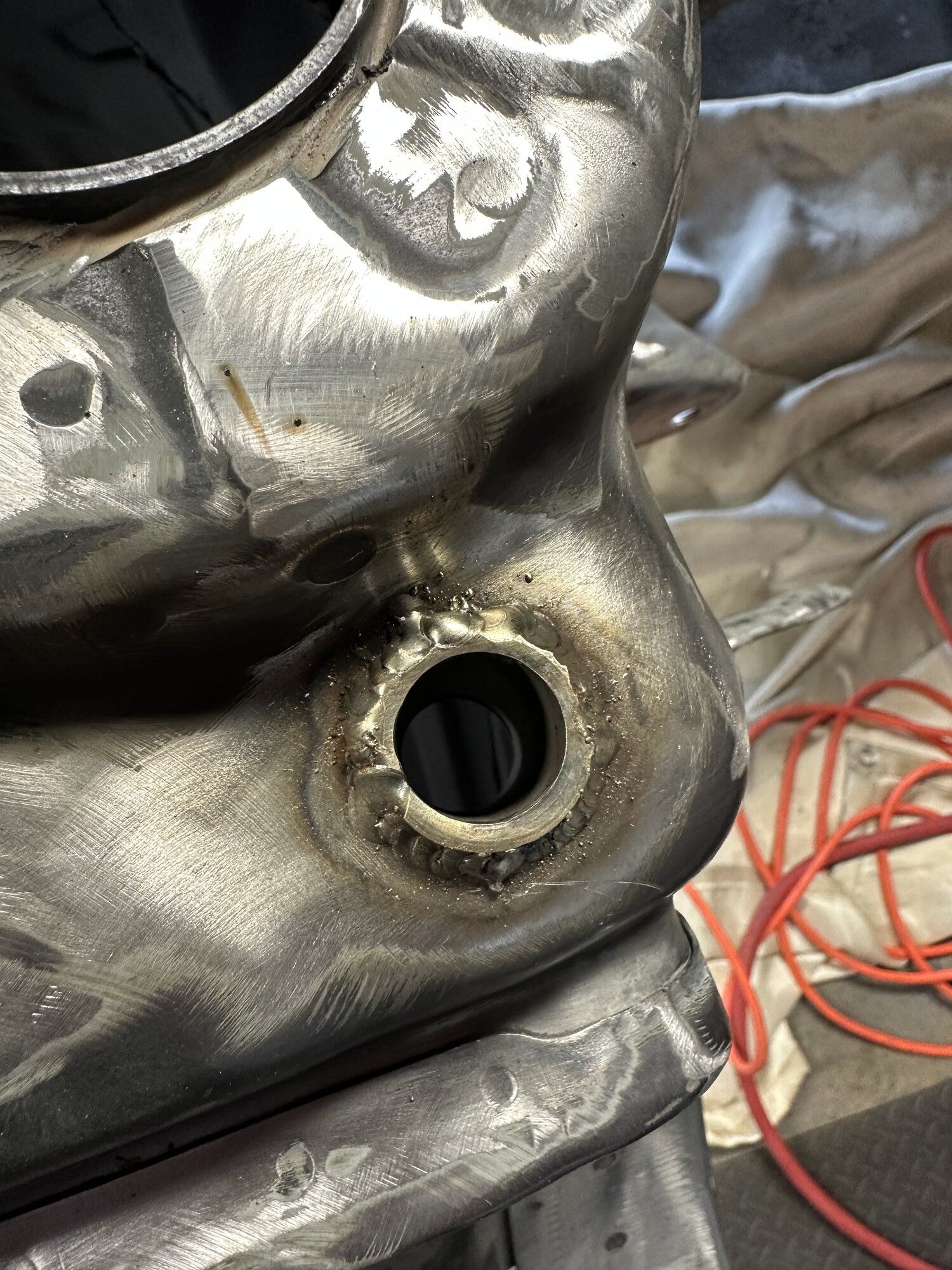

So knocked out the strut tubes today! Did some testing to see which method was best and it absolutely is to slowly tack weld around. My first tower rod I tried a bead and it starting blowing through the tube so I stopped. Not super happy with the look of it but the rest of the tubes came out decent. I actually ended up turning the heat down some and wire speed up just a touch from what the machine recommended. Once that was dialed in it was a breeze. Going to slap some sealer over everything and then get back to stripping the bay. Thank you so much @EC17PSE and @gsxitement for the push to do this.
Tried bead..
Now with tacking over and over and cooling it with air then again with tacks.

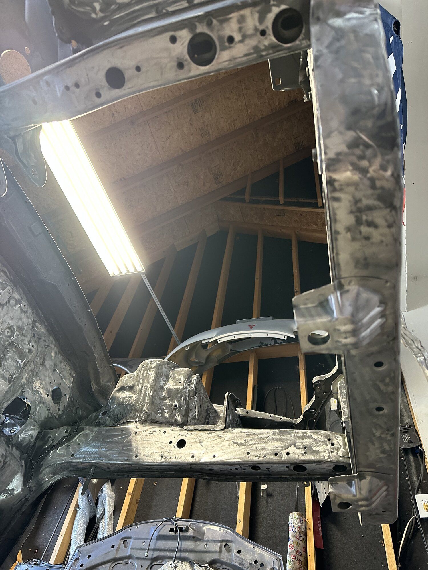

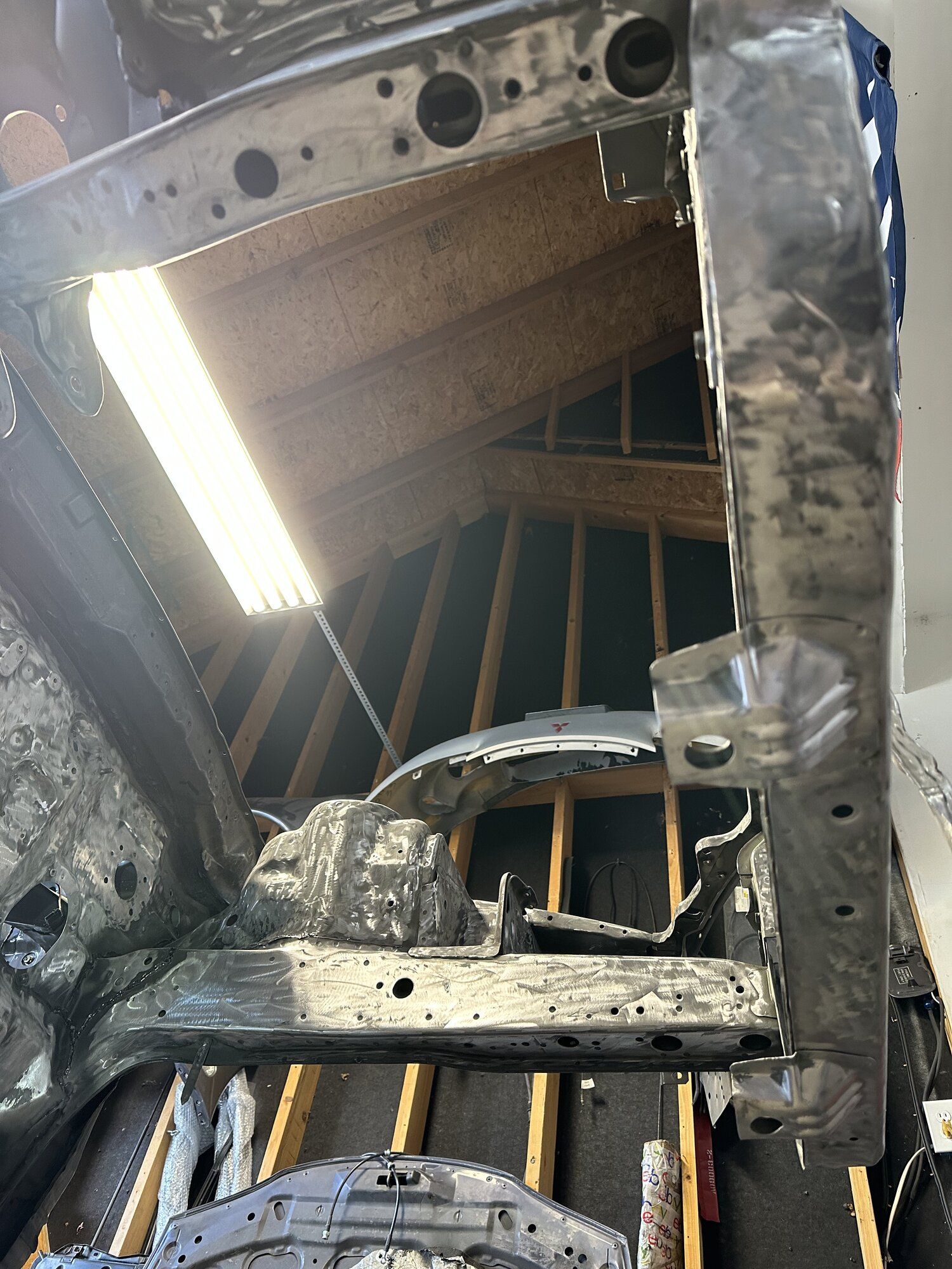

More grueling process today LOL. Can’t believe I am doing this to myself a second time. This is def one of the hardest parts in my opinion as well. But it’s done!
Getting so close to being done with the engine bay.. then paint and then engine!
Love the angle. No one shot fully grabs all the work involved does it?
