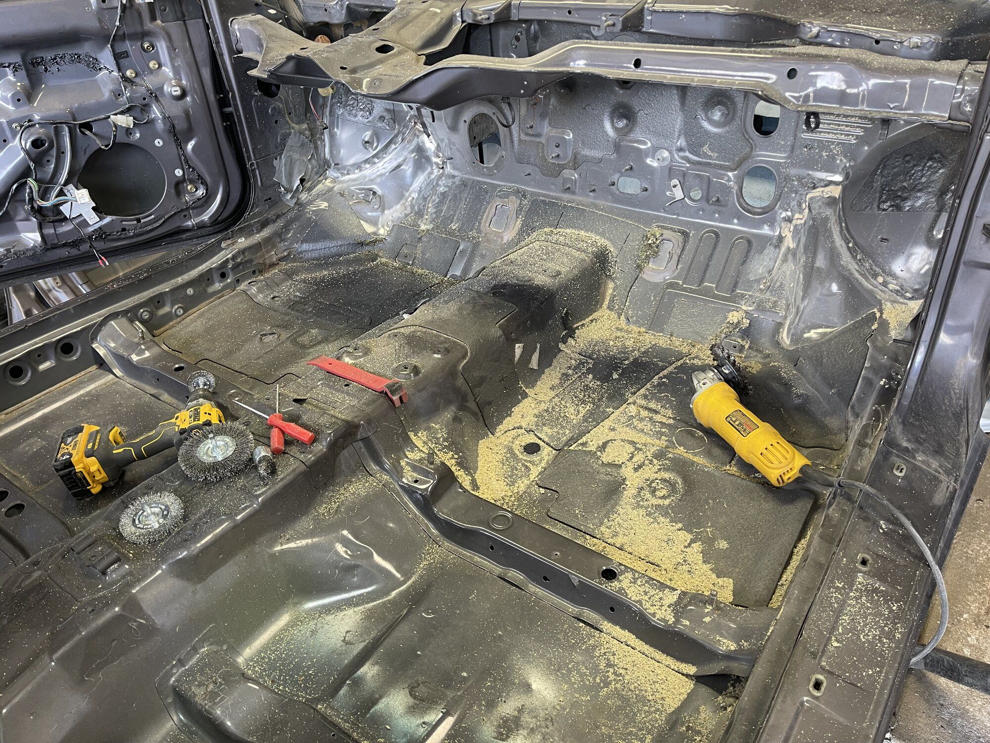

Any suggestions on getting the majority of crap out of the underneath “channels” on the 1g? What a b@$th! Would like to get most of the loose stuff off before the internal frame rail spraying. Need like a small 360 wire device on the end of a flexible extension that hooks up to drill or something.
I’ll see about taking one this weekend. Lol
Sure do LOL! I used different types of "shotgun" brushes. Got someone in steel brush type and some plastics as well. Using small ones is also how I clean up bolt holes and other holes on the bottom before spraying too. If you use them in a drill though you pretty much only get one good use out of them before the bristles bend over. Works best just done by hand.
I already tried some round wire brushes with long handles in assorted diameters but didn’t work great. Have to go through these small holes in the bottom of the channel and basically turn 90 degrees immediately then down the channel. Gonna try some flexible extensions for the bore brushes, time to buy more stuff.

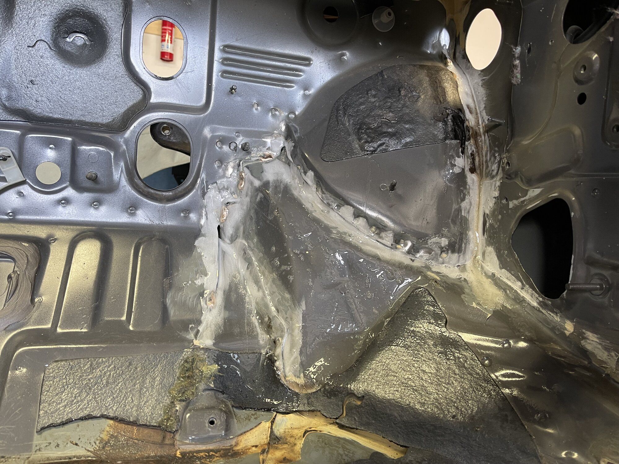

Huge update!

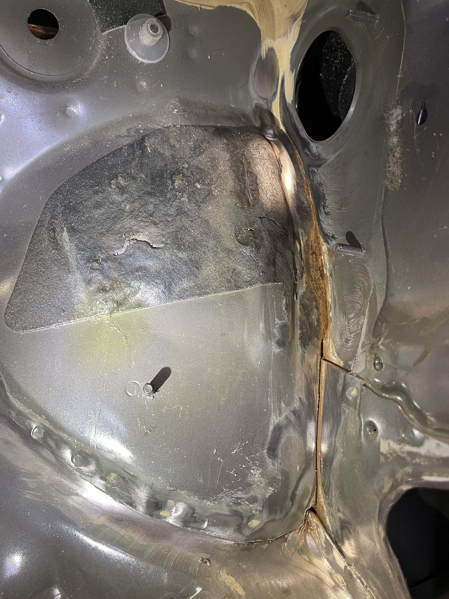

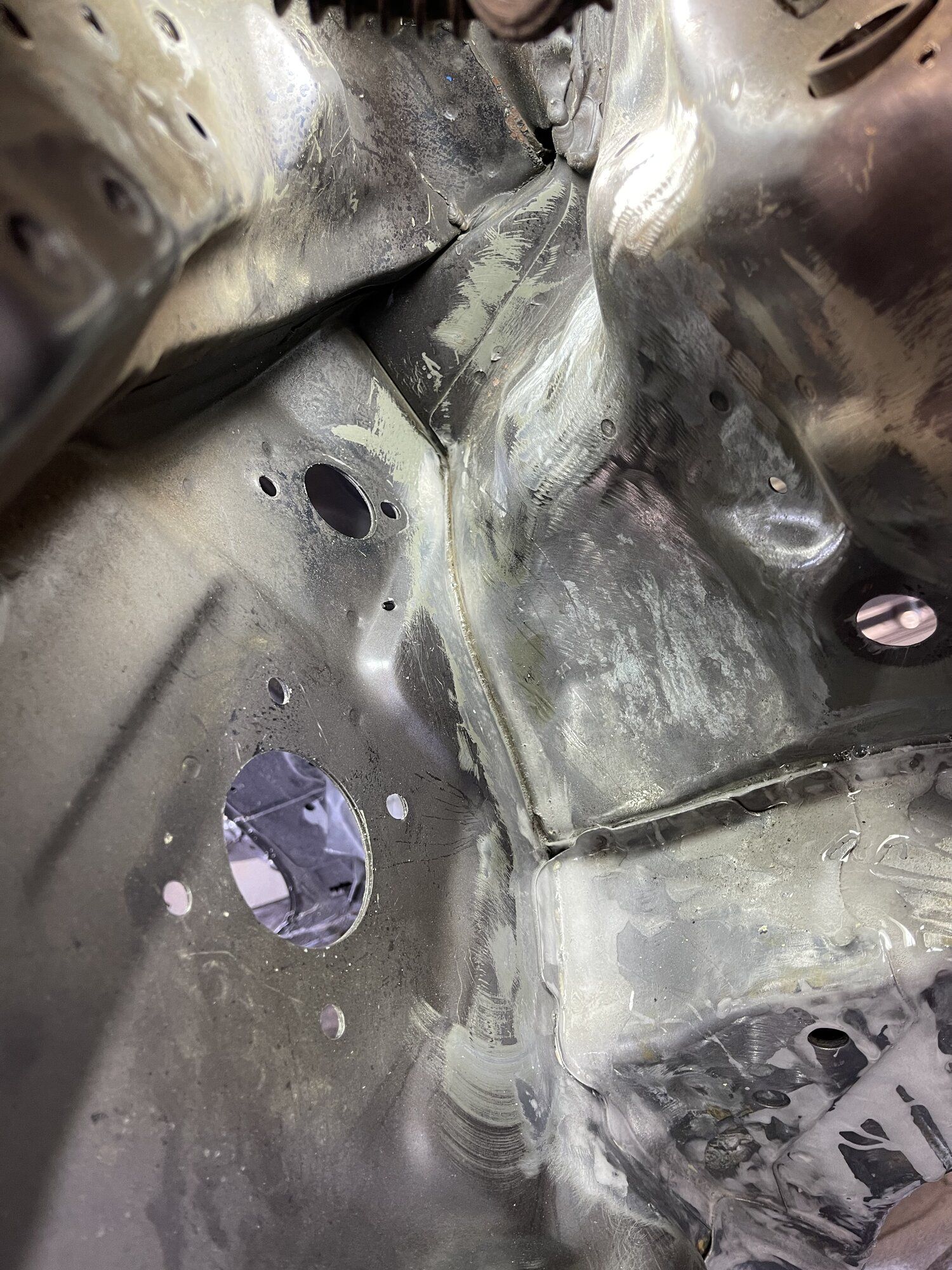

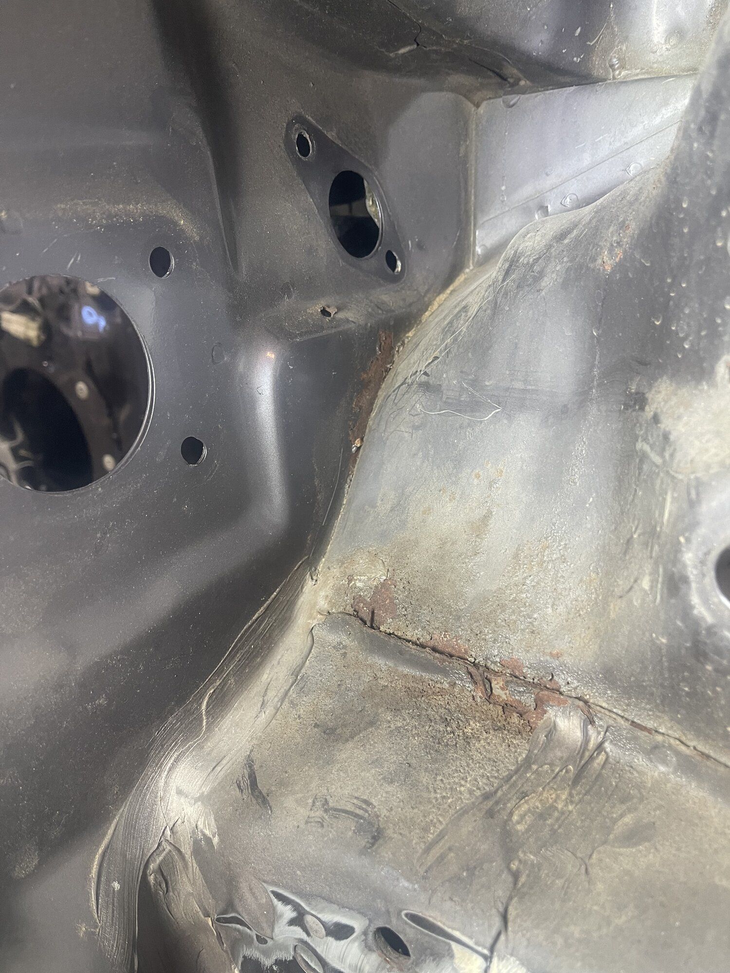

So I began working on the front and the engine bay seams, aaaaaand found some problems. Didn’t get as lucky in the front as I did in the back. Starting stripping everything and noticed little brown spots peaking out from the seams. Further I dug, the worse certain spots got of course. So then started the really long process of treating and digging out all the rust and junk and killing all of it. Here are the results and still a lot to do, BUT rust is eradicated! Enjoy the huge photo dump!
Before…

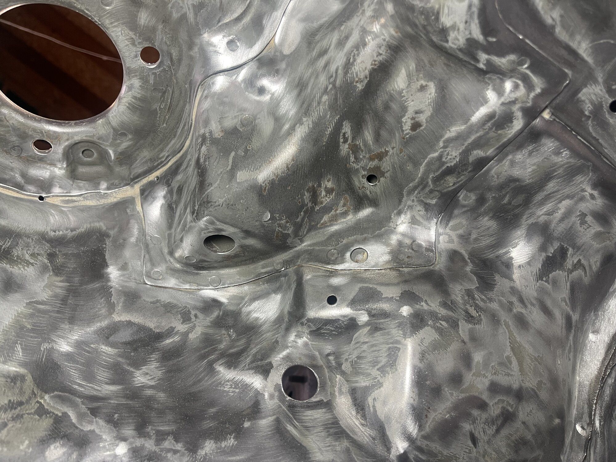

Wire wheel as much and far as I can..

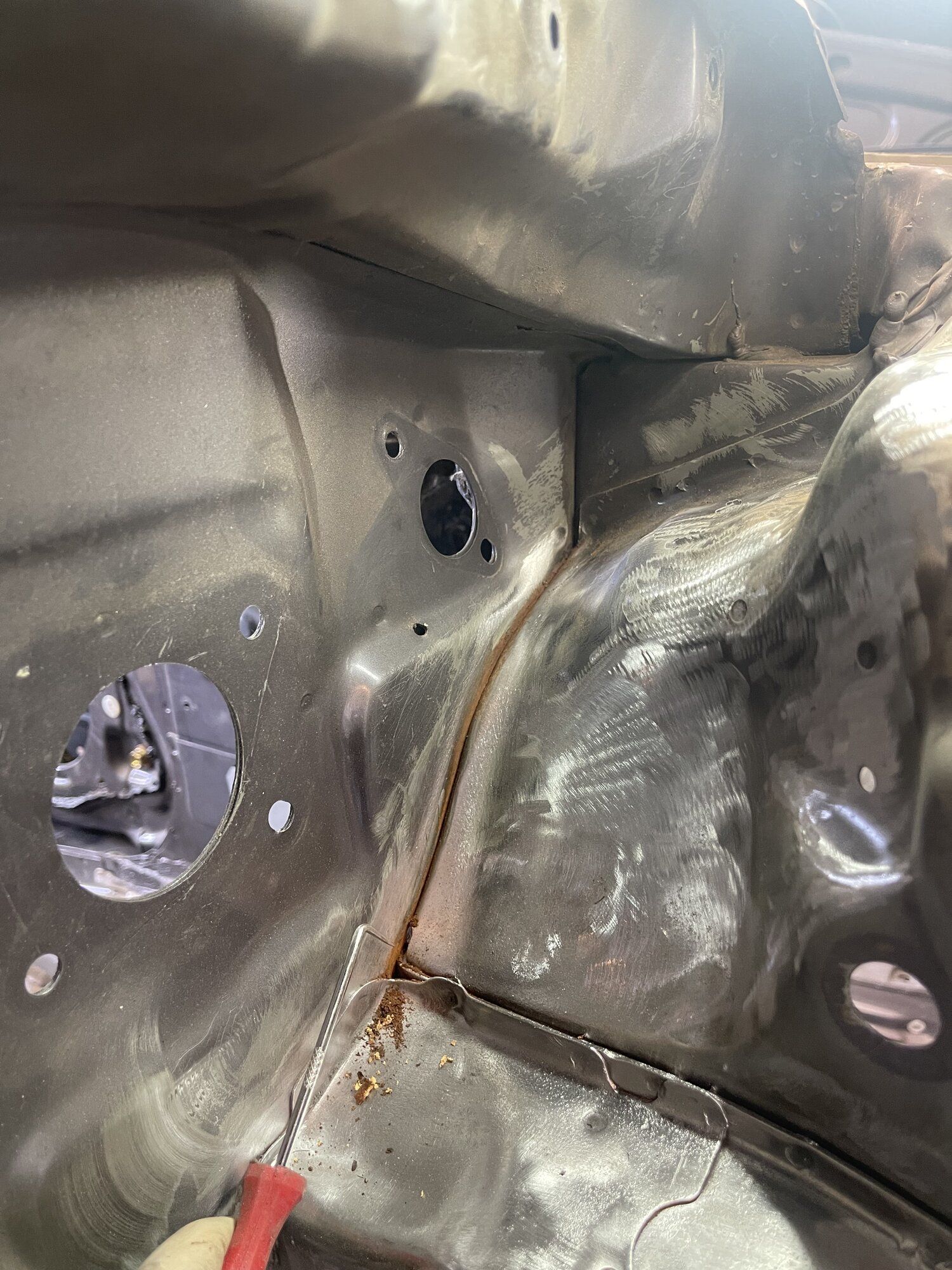

Had to break out the manual hand tools in tight spaces..

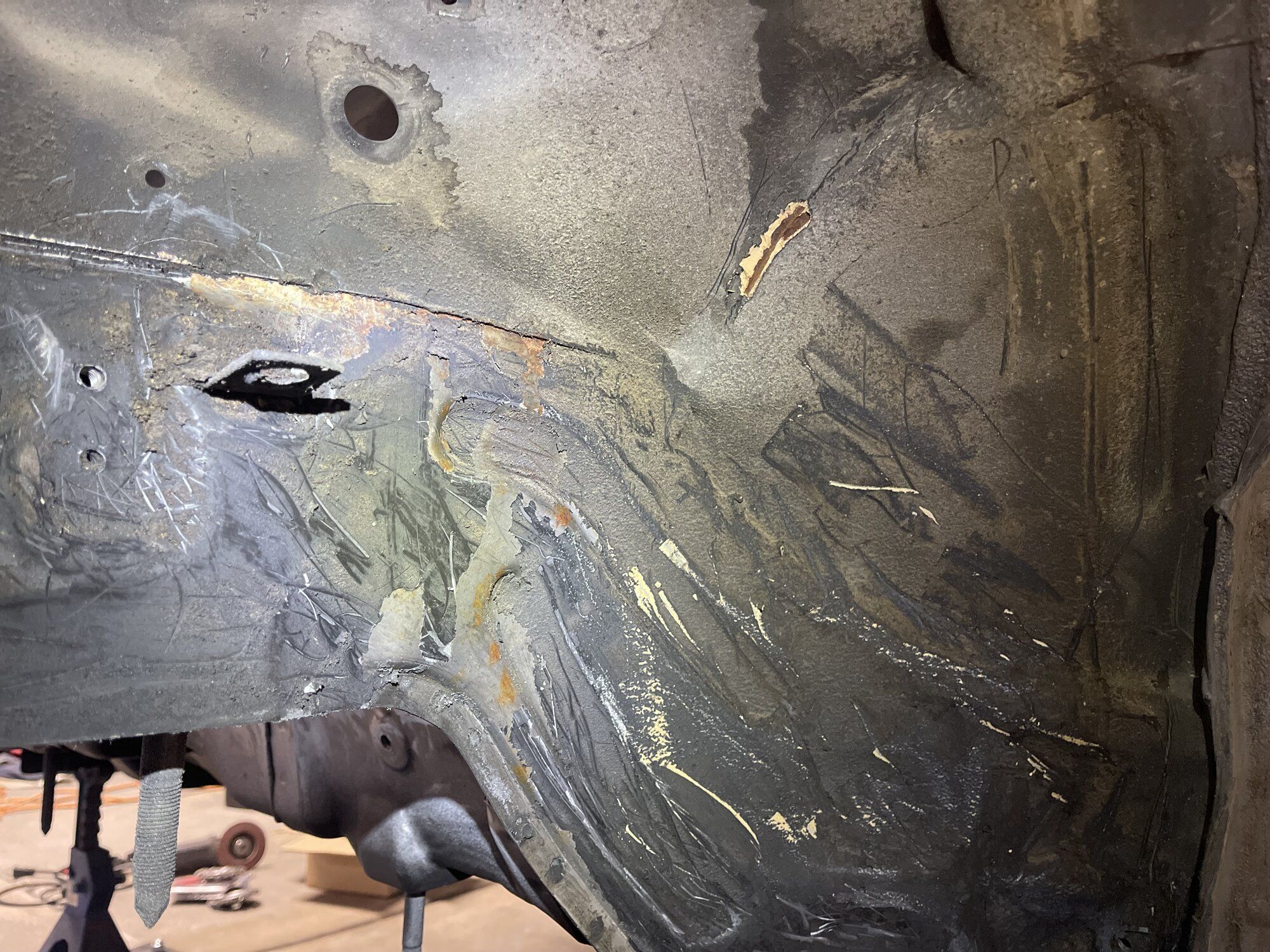

Dug into the inside seams and found a really bad spot…
Chemical warfare…
More to come and results!

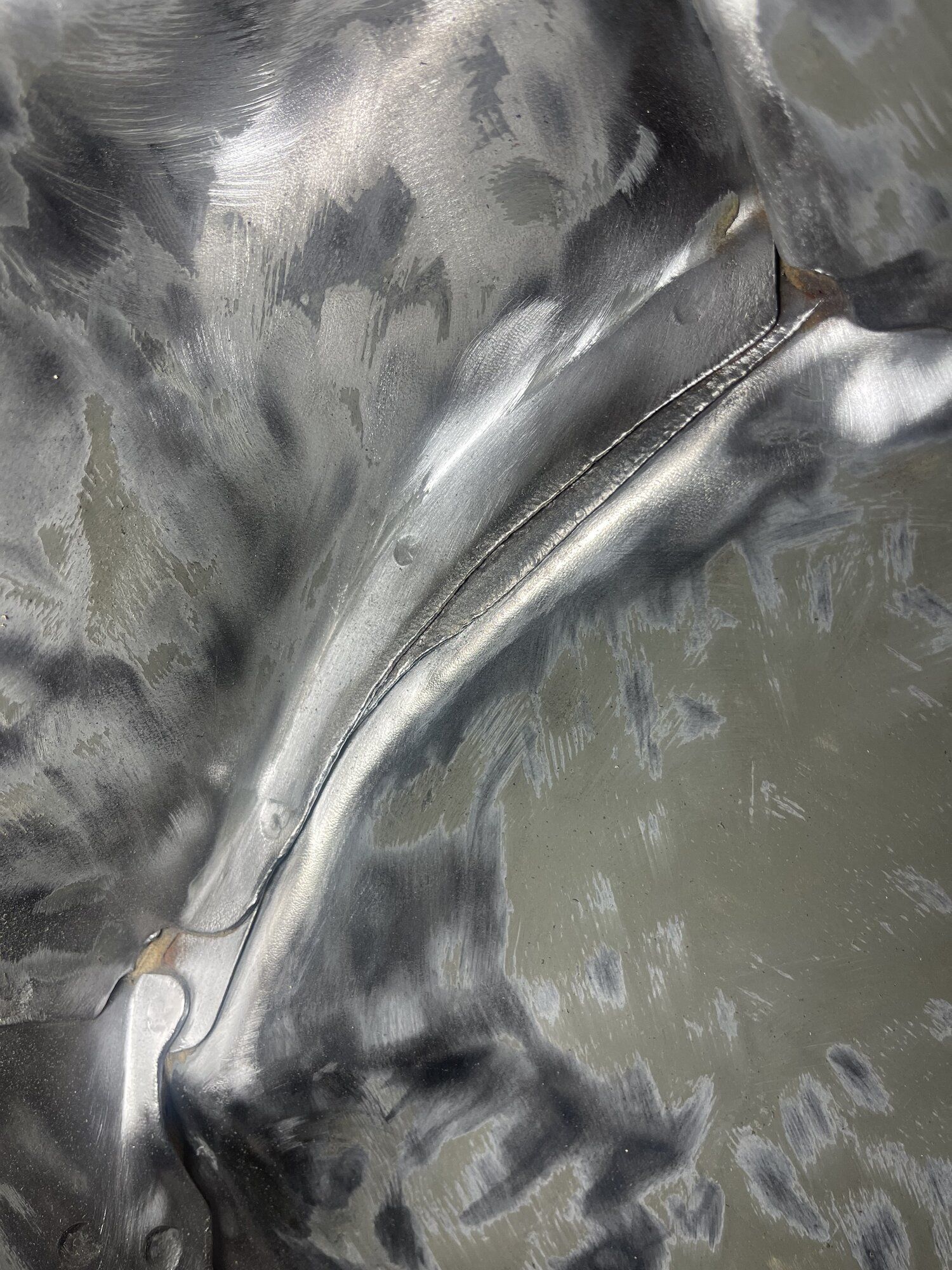

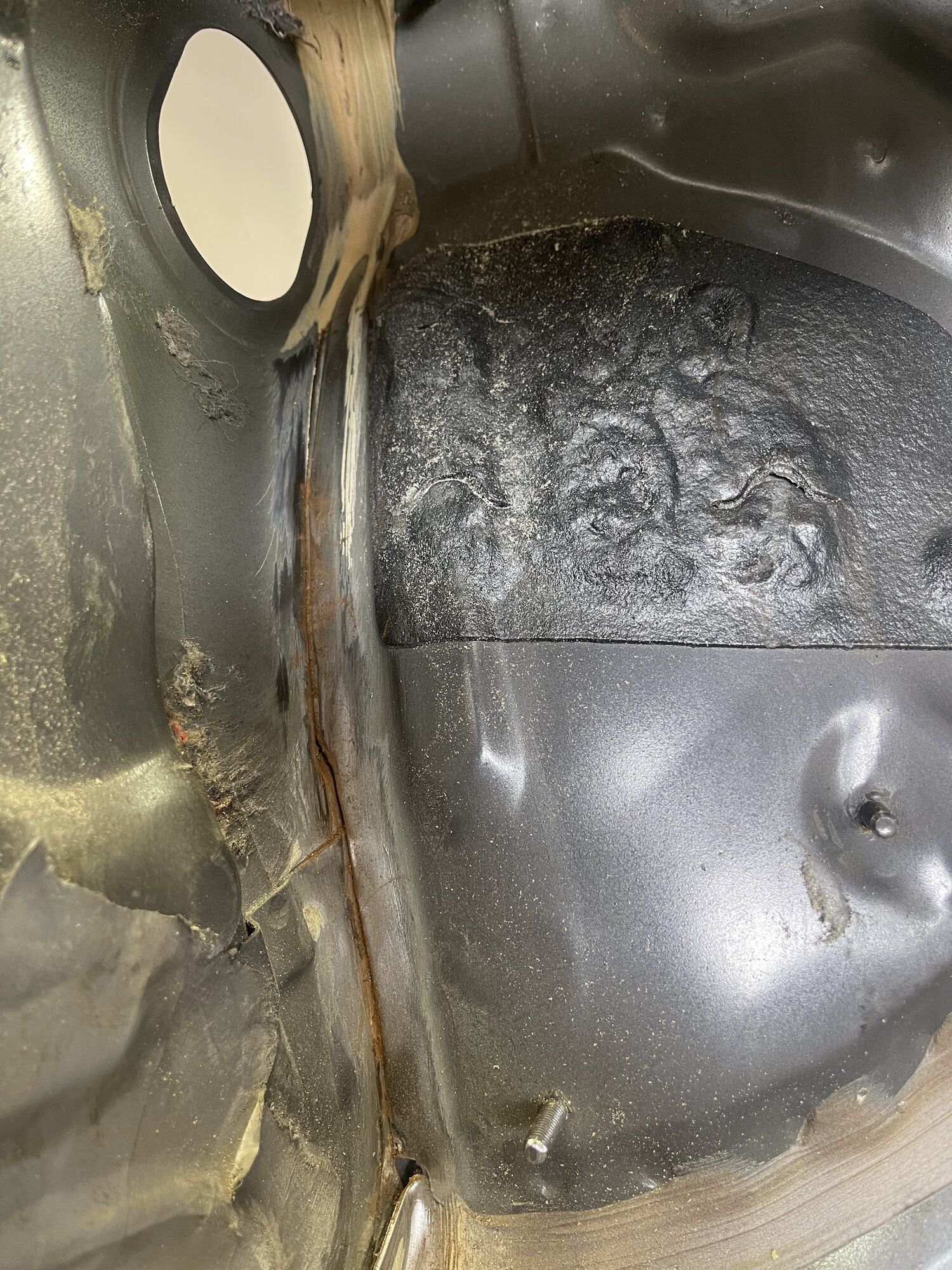

Alright, so I switched back over the the por15 metal treatment and I liked it way better than the Krud Kutter gel rust treatment. The gel stayed in place better but it did not work nearly as well as the por15. Just keep the metal wet and it works sooooo much better.
Rust is completely gone and seam is clean. Sprayed the seam and then seam sealer!
Pre-spray and sealer…
Seals sprayed and sealed now. Sealer takes 96hrs to fully cure. Then can move on to the next of 382742 steps I use.
