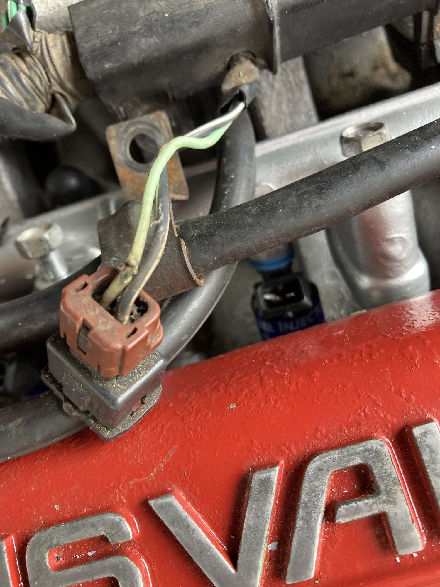

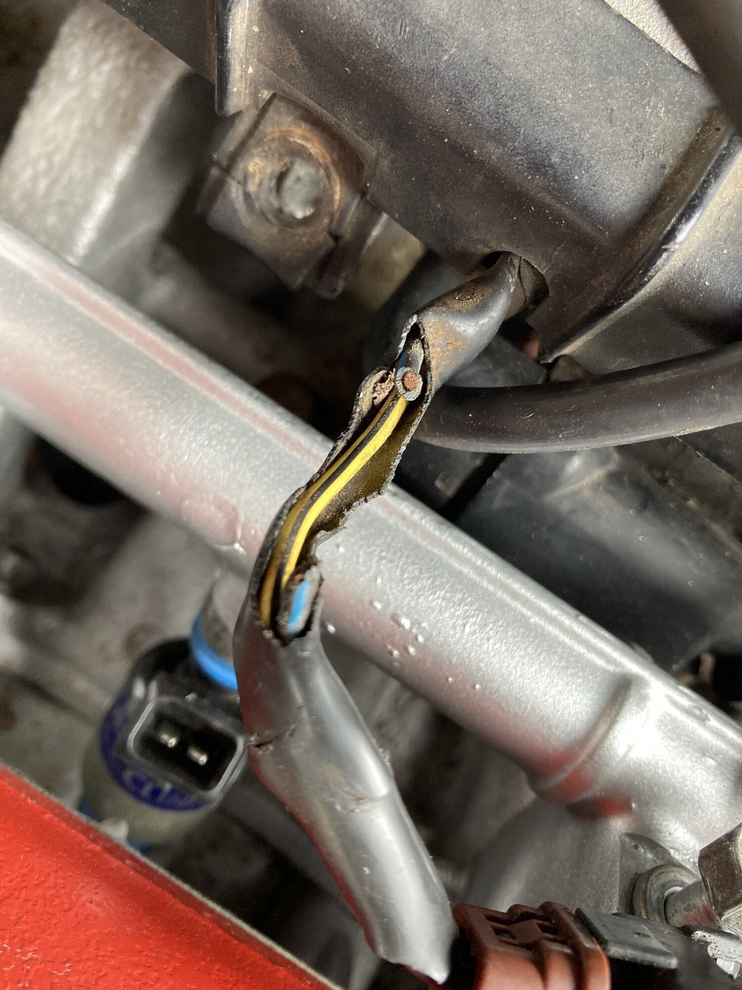

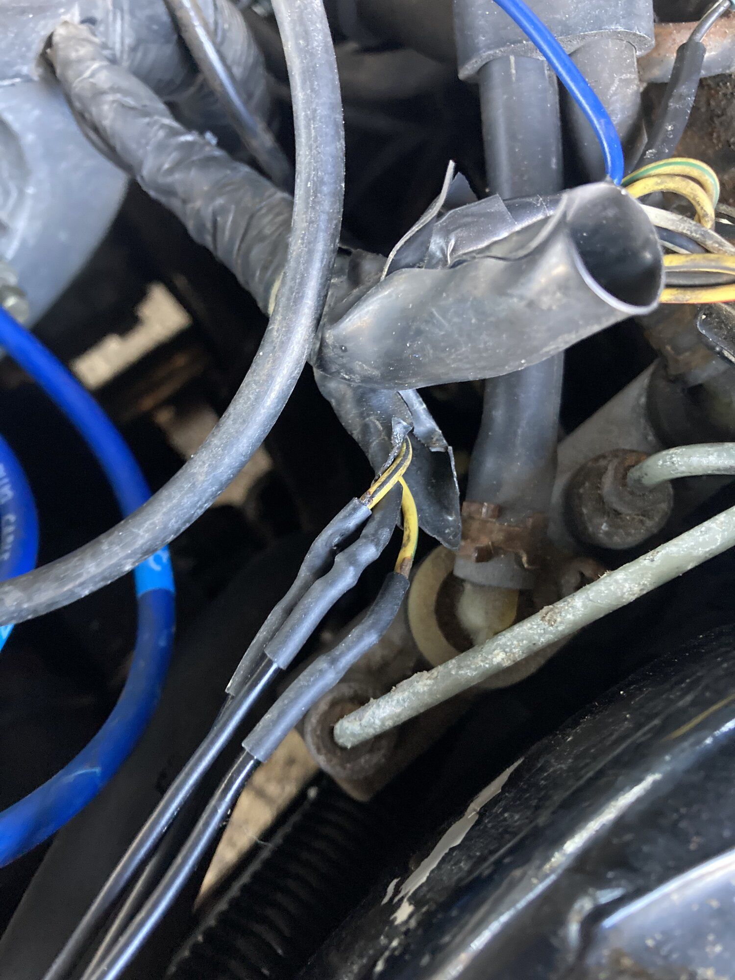

Really don’t know how I missed this the several times I was in the engine bay.
This ladies and gentleman is the injector wiring for cylinder 2. It has the single wire mod apparently. So glad I went to rewire it just now.
I had the same issue with my injector wires. I ended up cutting all four off inside the loom where the wire was still somewhat supple, and splicing (crimp) new wires to new injector plugs.
That’s 100% what I’m doing right now. Except I’m soldering and heat shrinking. Same difference though. Man did it need it.
It seems like if I solder, I unintentionally shrink my heatshrink before getting it in place and I'd need to grow a third or fourth hand to hold two wires together, hold solder, and hold soldering iron. Sometimes if I'm not careful the wire would wick the solder under the insulation and then it's stiff and somewhat brittle.
Instead I invested in the Hozan P-706 crimp tool and some crimp connectors. I needed a crimp tool anyway for new Sheridan connectors. I took a page out of Jafromobile's custom harness video and folded each wire over on it's self before crimping. That produced a really strong crimp, then I'd heatshrink. Was much faster and easier (especially in tight quarters) than solder.
I probably don’t solder the textbook correct way, but the way I do it works extremely well. I’ll twist and entwine the wires kinda like folding two phone books together. The way I do it holds the wire firmly in place so that all I have to do is hold my butane soldering torch and a little solder. It melts right in and makes them permanently a single thing. Then I heat shrink it and electrical tape it over that. The end result is satisfying. It does take some time though, and God does it hurt your back having to hunch over these damn low cars. Lol.

If you can get some flux on the bare wire where you intertwine the strands, then twist or wrap them so they hold themselves together, you can use two hands to heat the joint and quickly flow some solder into the hot wire and flux mix. As mentioned, you don't want to heat the spot too long, or flow too much solder, as it does make wire brittle. Having a wet sponge handy to take the heat away from the insulation, and cool the joint will help.

Oooh. Flux is a good idea. I didn’t think of that/not sure where locally to buy some.

First up was going to get more shrink tube, since I didn’t have enough for all the wires. I could only find red, so don’t you dare judge me on my red heatshrink. Lol.

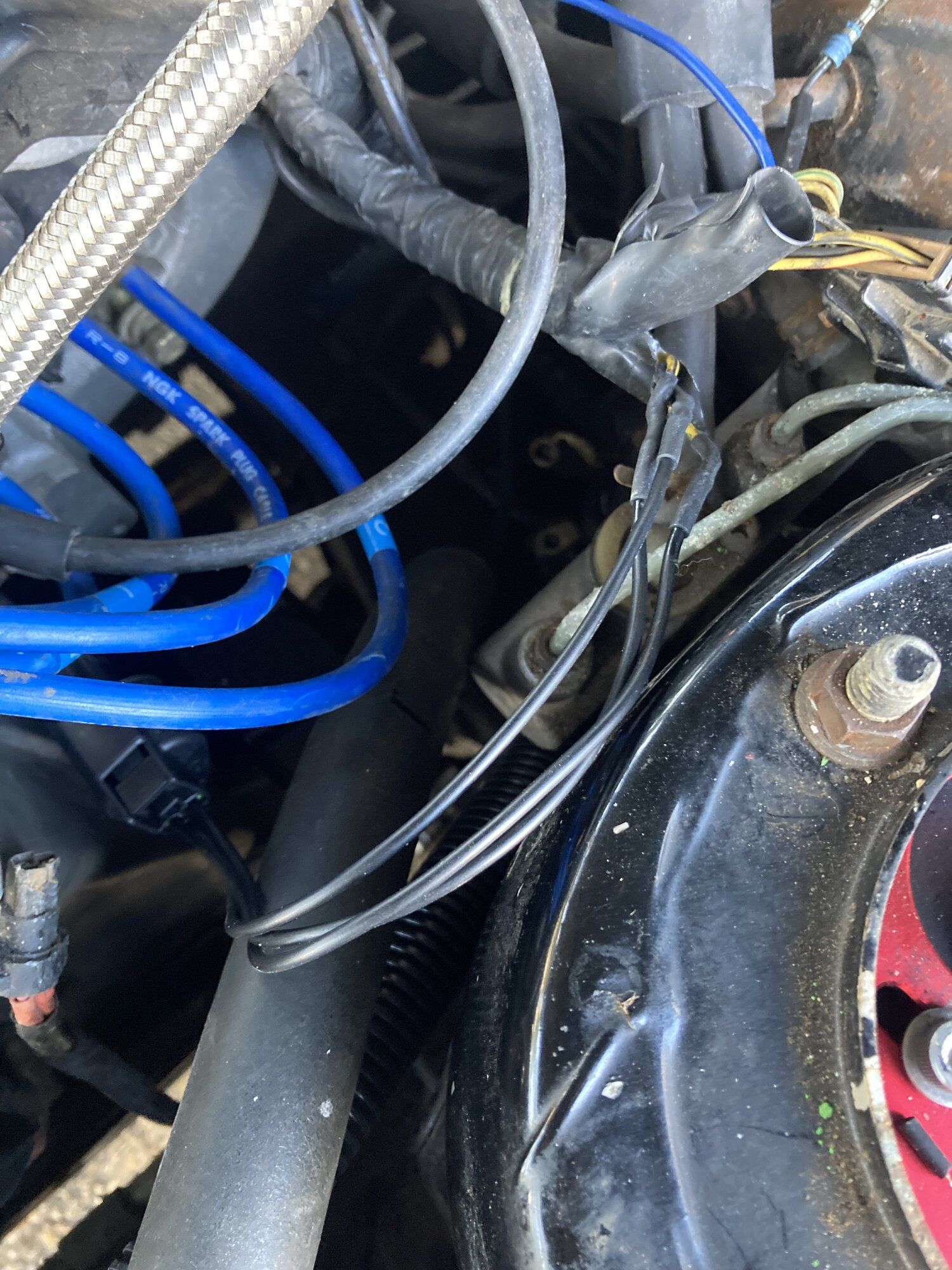

But, once I opened the engine bay and sank my teeth in, I immediately found this.
This is injector #2’s wiring and that’s a whole ass wire thats missing. If one wire is broke more is bound to be broke or sketchy, so at this point I’m raising my hands and happy AF I did this. Because I could cut into the harness further, add a new supple wire, and end up with this.

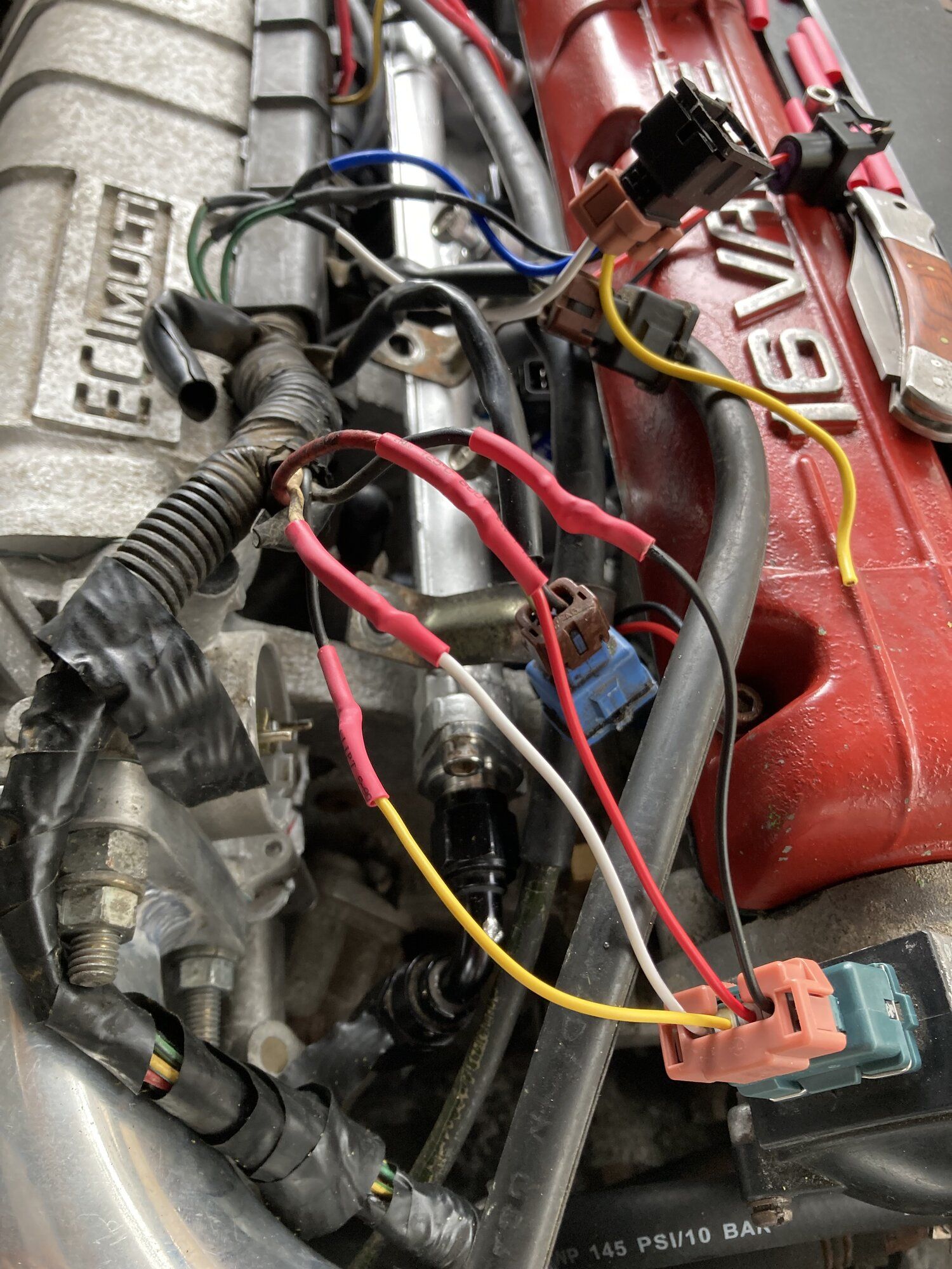

So much better. Don’t worry, I’ll wrap the wires too so they aren’t just loose. But from there I set my sights on finishing the rest of the injectors, and one at a time they all went great. I even found this too.

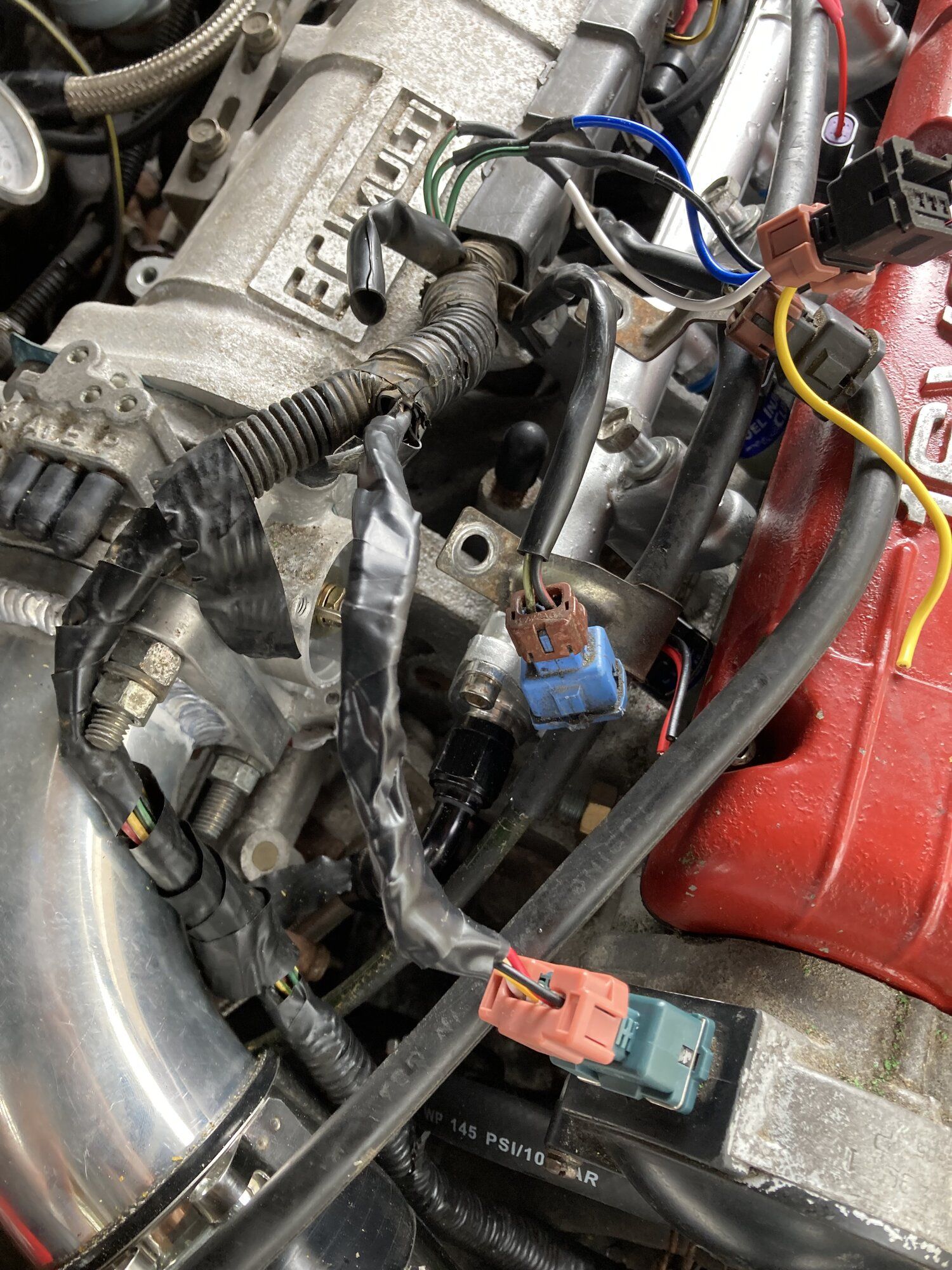

Might be hard to see but that’s another broken wire. And where it was, it was 100% touching metal. This had to have been causing issues. So glad I did this. I love wiring.
But, after a bit, it all looked like this.
Beautiful. And these injector clips are fantastic. The little silver metal clip is captive and you just squeeze it to slip it on and let go to anchor it. Nifty AF.

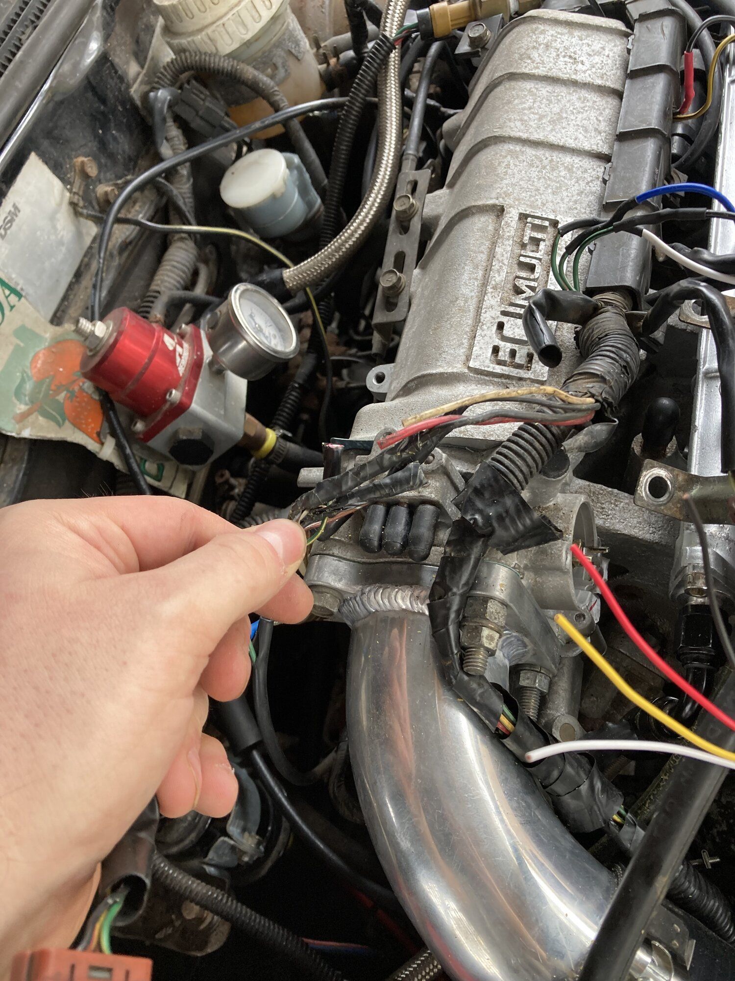

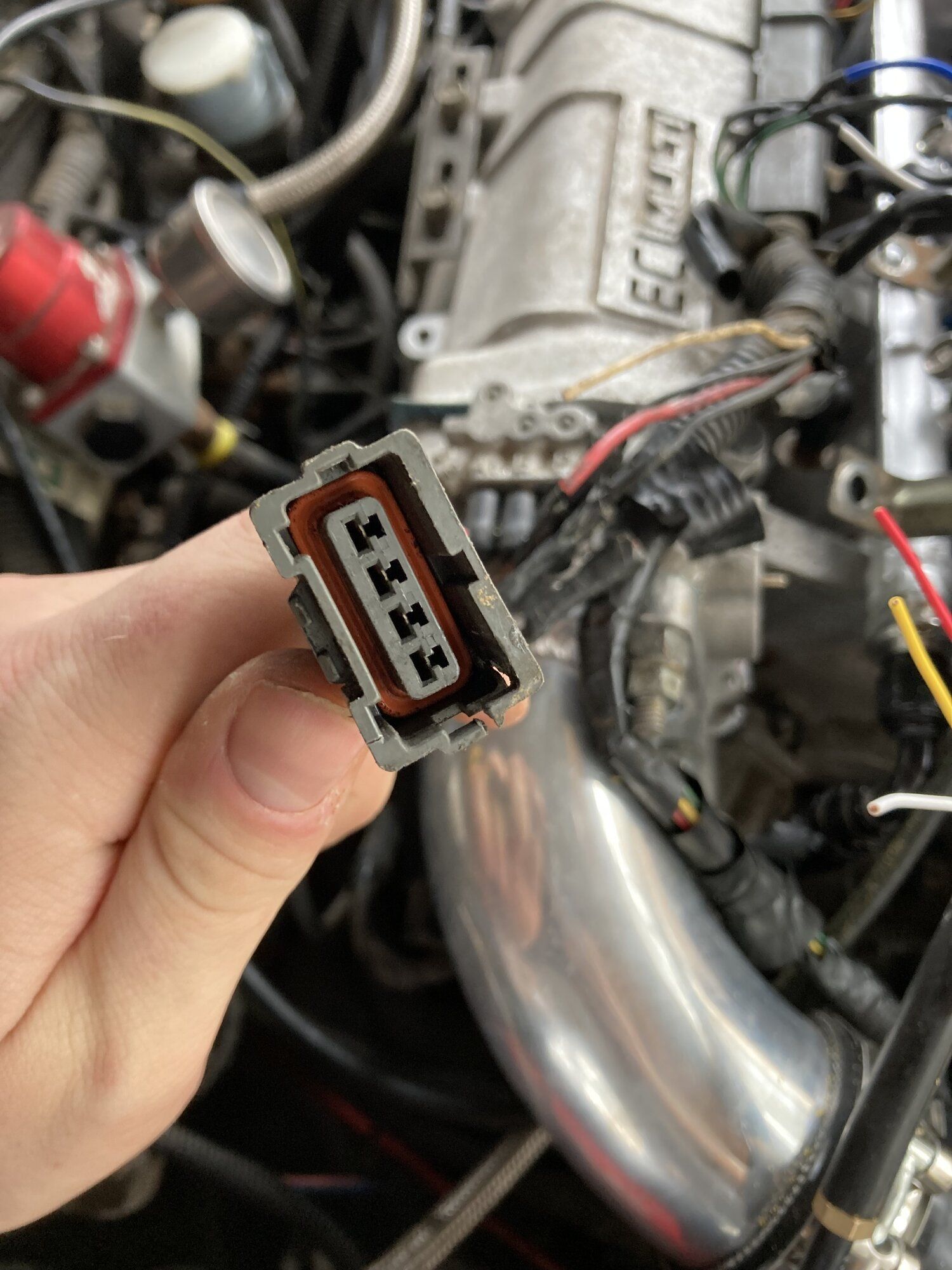

Time to move on to the CAS. Also found good stuff here. First was this.

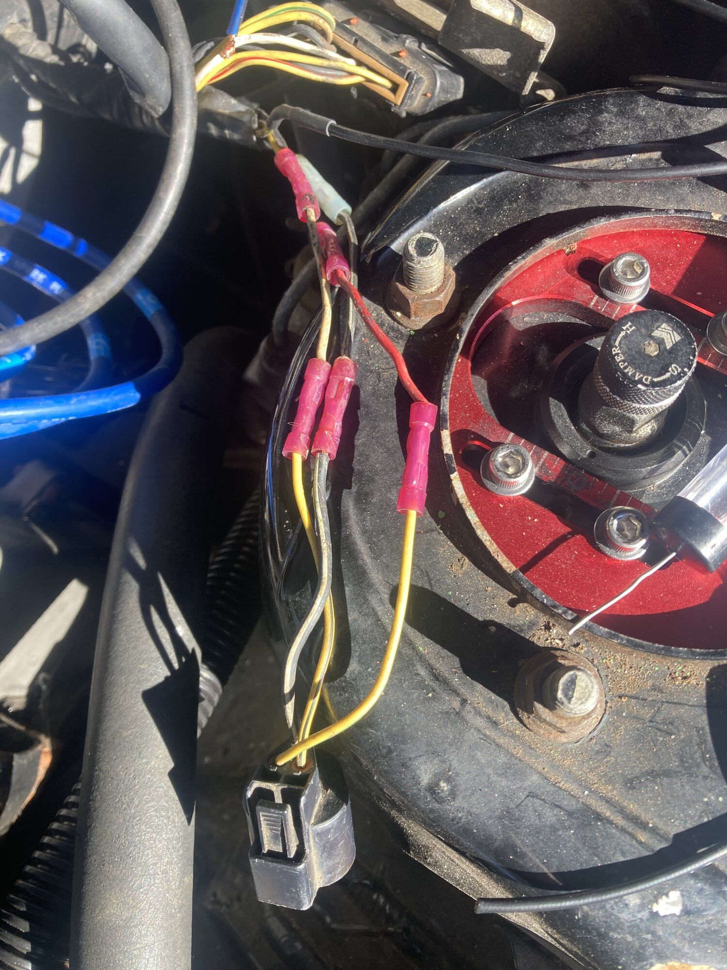

Wrong plug and a rats nest of terribly done butt connectors. Bleh. The plug itself is a TPS plug, and that’s why it broke when someone tried to slam it down. The CAS plug is slightly different on a 1G. Time to fix it.
Yeah buddy. And it slips on and anchors like a champ! Now it’s time to tape all these wires together until I can buy more sheathing to match the oem harness.

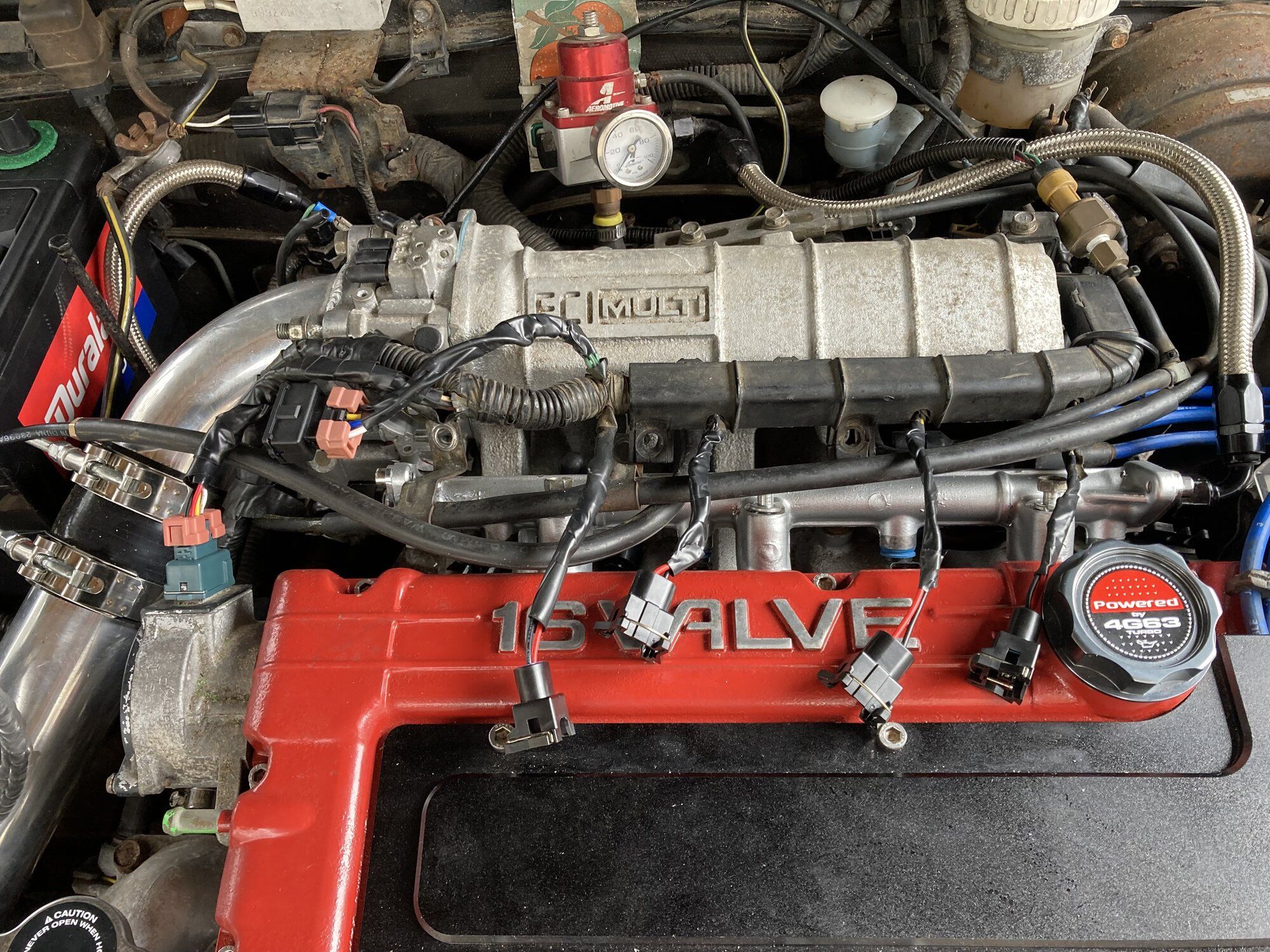

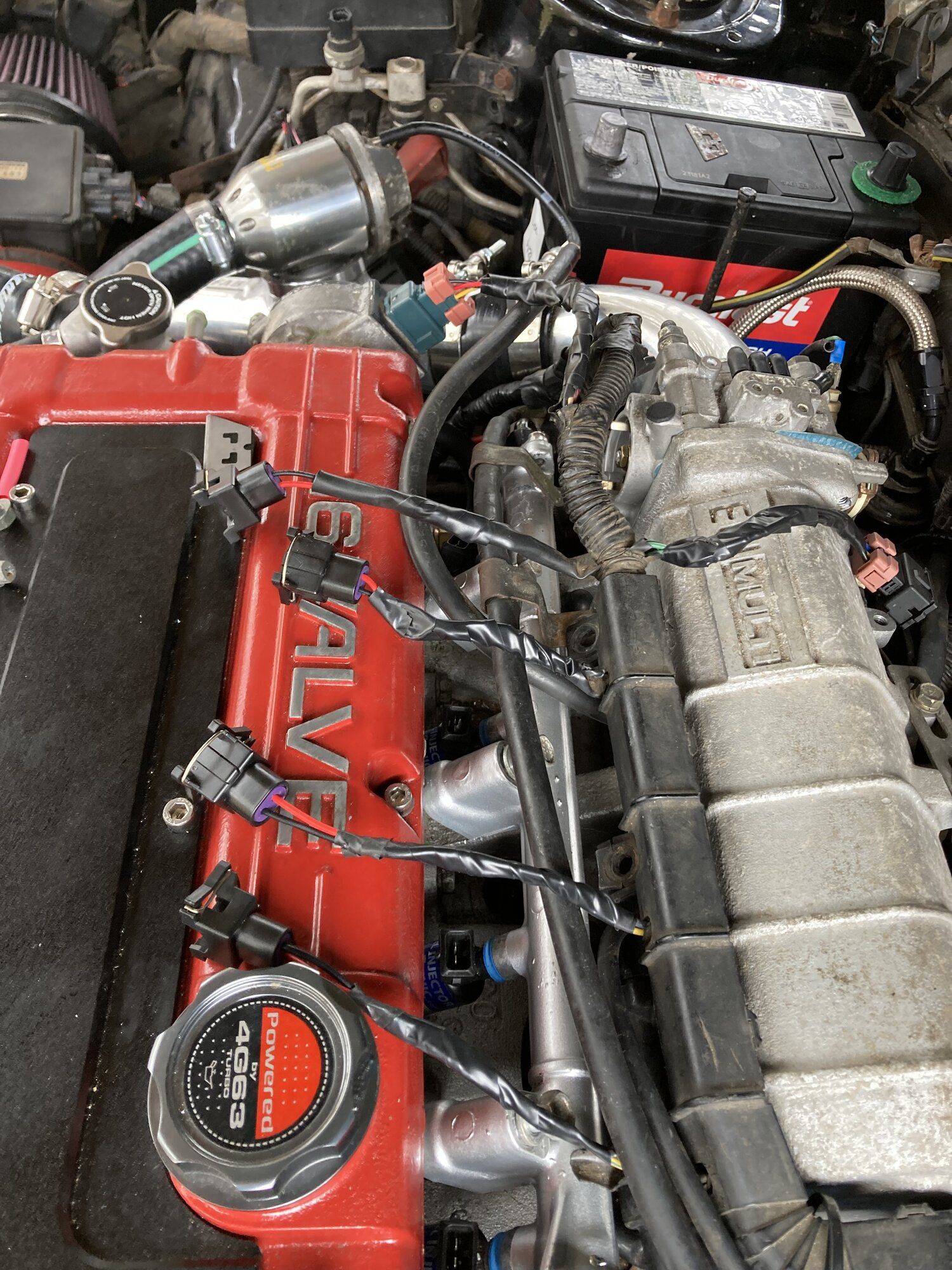

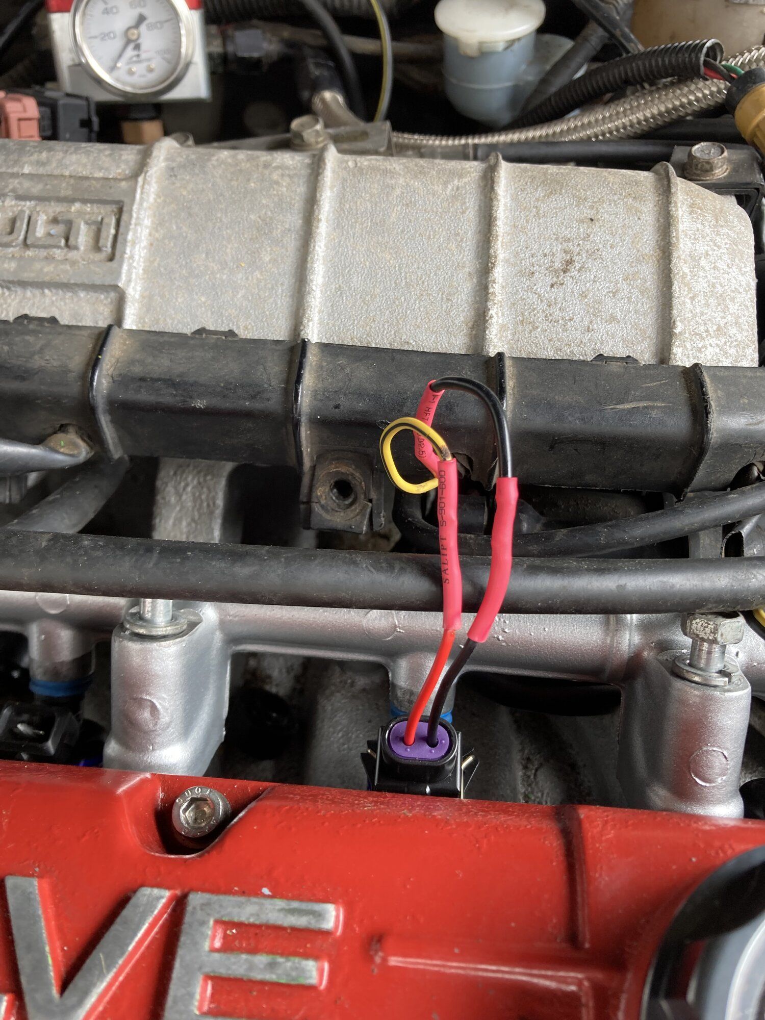

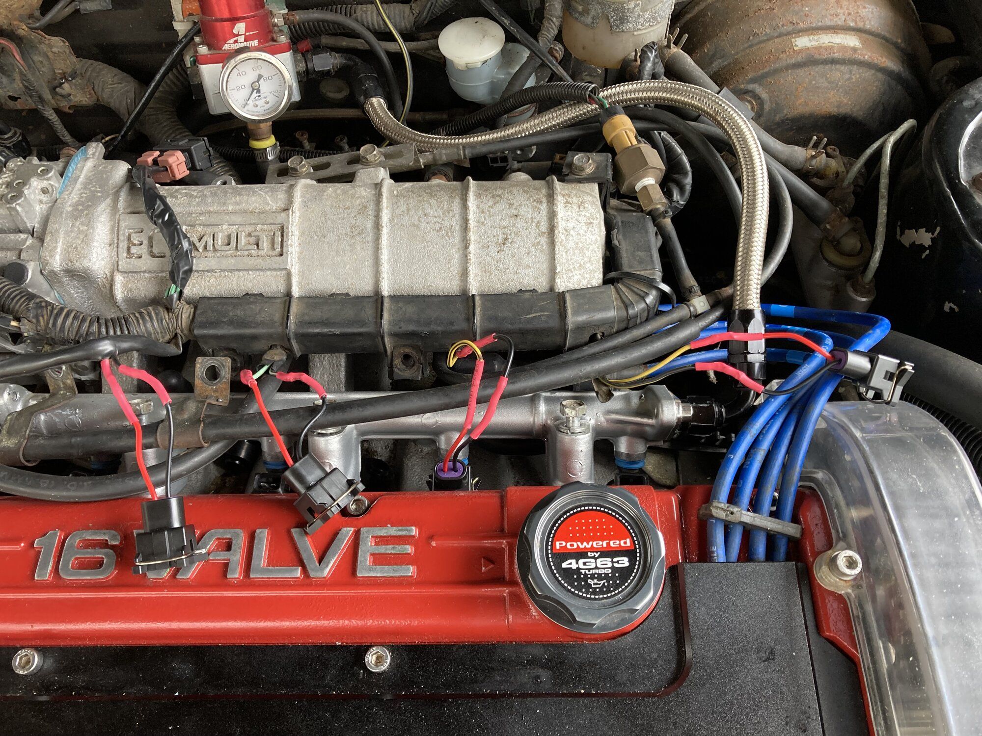

There we go. Time for the injectors.
Would ya just look at it. So much cleaner and new.
And the final pic. TPS plug, CAS plug, and injector clips are all brand new and OEM quality or better. Honestly I’m so tempted to start it without a TPS to see how it idles now vs before, but I shall resist. I wanna do things right here. This thing deserves it.
So yeah. Very pleased. However this makes me want to go over the entire harness to fix and find the f*ckery.

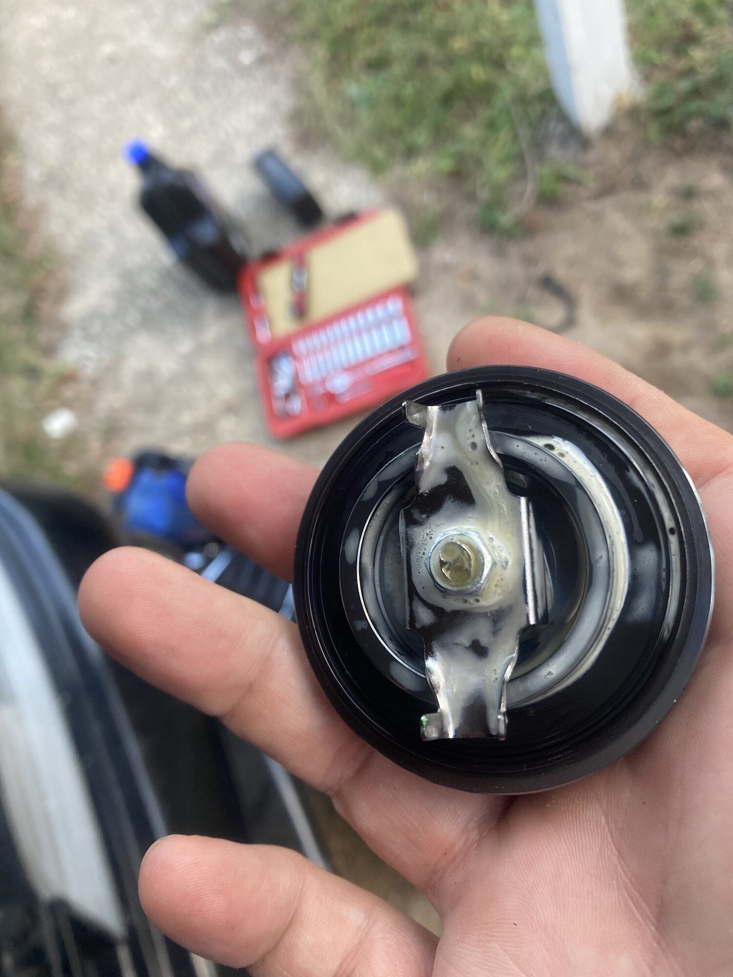

Other than fixing/finding the tachometer issue, I did the first oil change since the bearings are broken in now. Oil looked fine for what it was, but when I took the oil cap off(Cheap ebay unit) there was a white milk substance on the cap. My first thought was "SH*T, HG is gone or something else making oil and water mix", but after draining the oil it was fine. No milk, no sketchy stuff, just oil with some light gas smell. It was only on the cap and the cam cap directly underneath the oil cap itself.
See? Weird.
No funny stuff here though. Just oil.
So that's interesting. Maybe I need to actually plumb up my PCV/catch-can setup, or the oil cap seal for the eGay unit is junk(which is honestly equally as probable). Either way, that made my heart skip a beat but glad it was all good. While I had the VC off, I checked the torque for the headstuds and they're all golden. I'll check 'em again at 500 miles like ARP says.

That would happen when you have a short idle many times without driving the car and if the weather is cold/humid. Once you drive the car for long, it would be gone.
This makes a lot of sense actually. I have only broken in the bearings(let it come up to temp and hold it at 2500 for a few mins) and it’s been uncharacteristically chilly a few days I was working on it.
