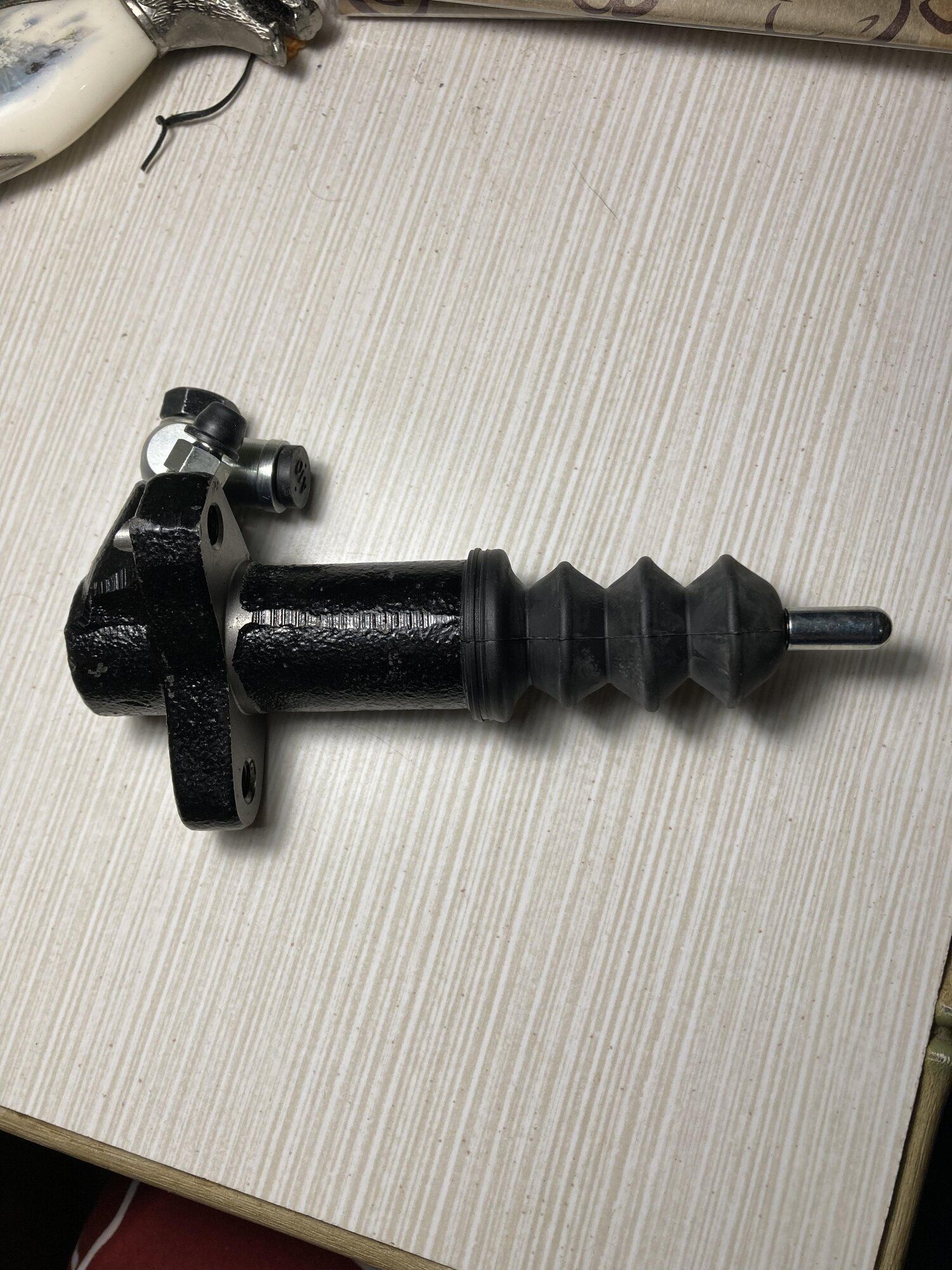

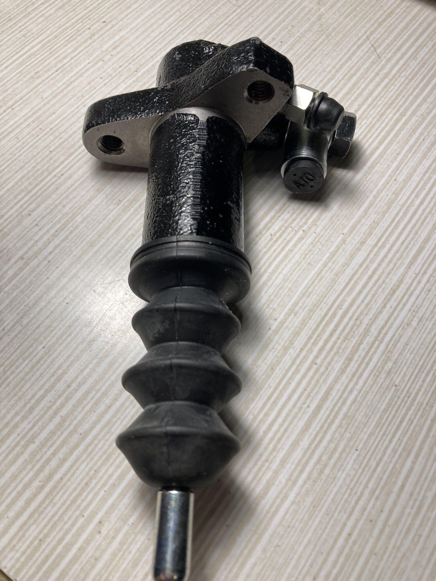

New slave came in from Jacks. God I love how these new OEM parts look, man. It feels just as tight as the old one, but hopefully this one doesn't leak. Lol. So after I drop the trans tomorrow(if it doesn't rain me out), I'll order a new clutch kit from TMZ Performance IF the clutch is the problem. Might spring for a forged clutch fork too. But yeah, after this literally everything in the driveline/drivetrain/that physically powers or moves the car, is brand new. Really hope I can drive this thing before the year is out.

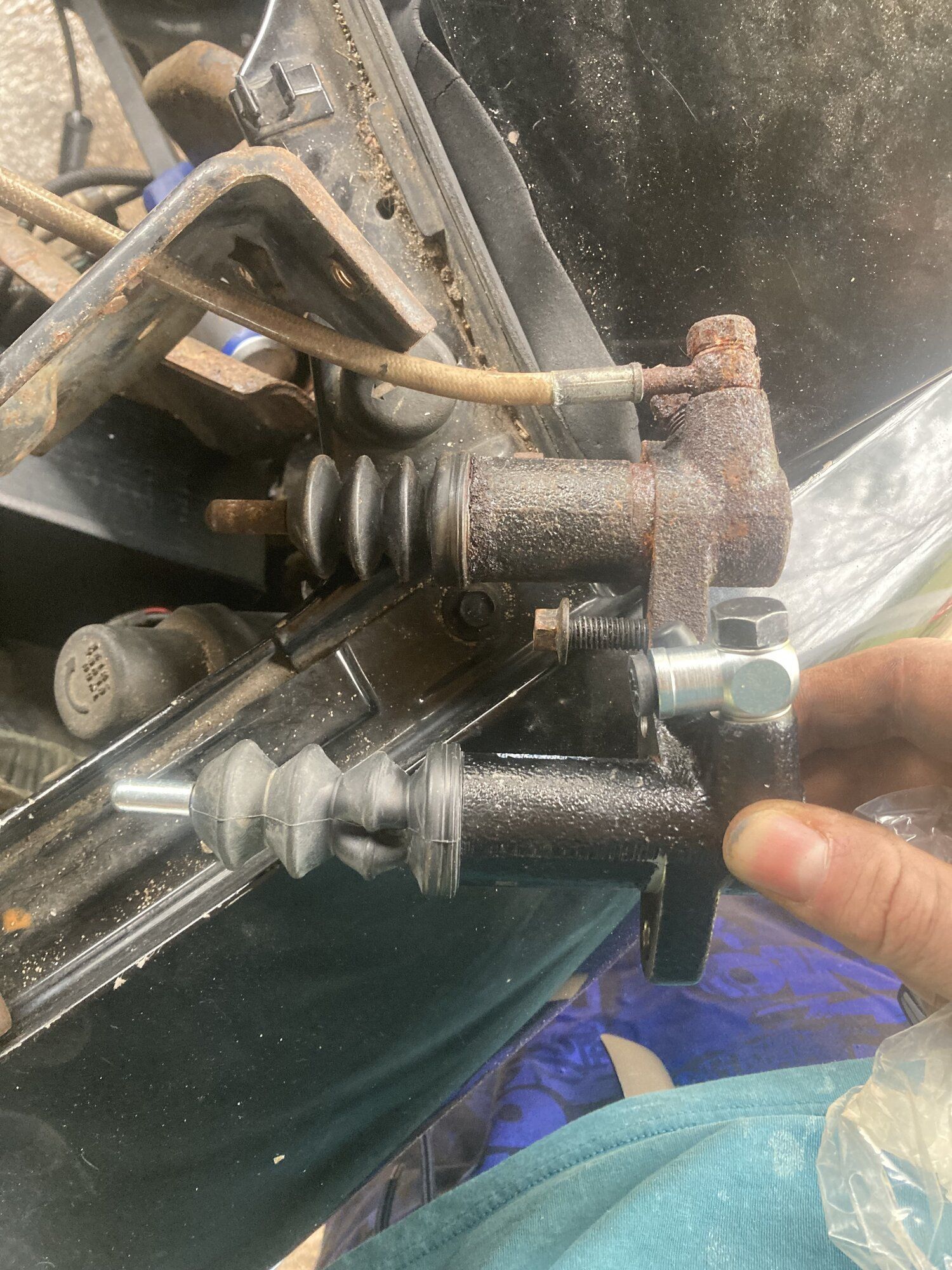

Legit think I found the issue.

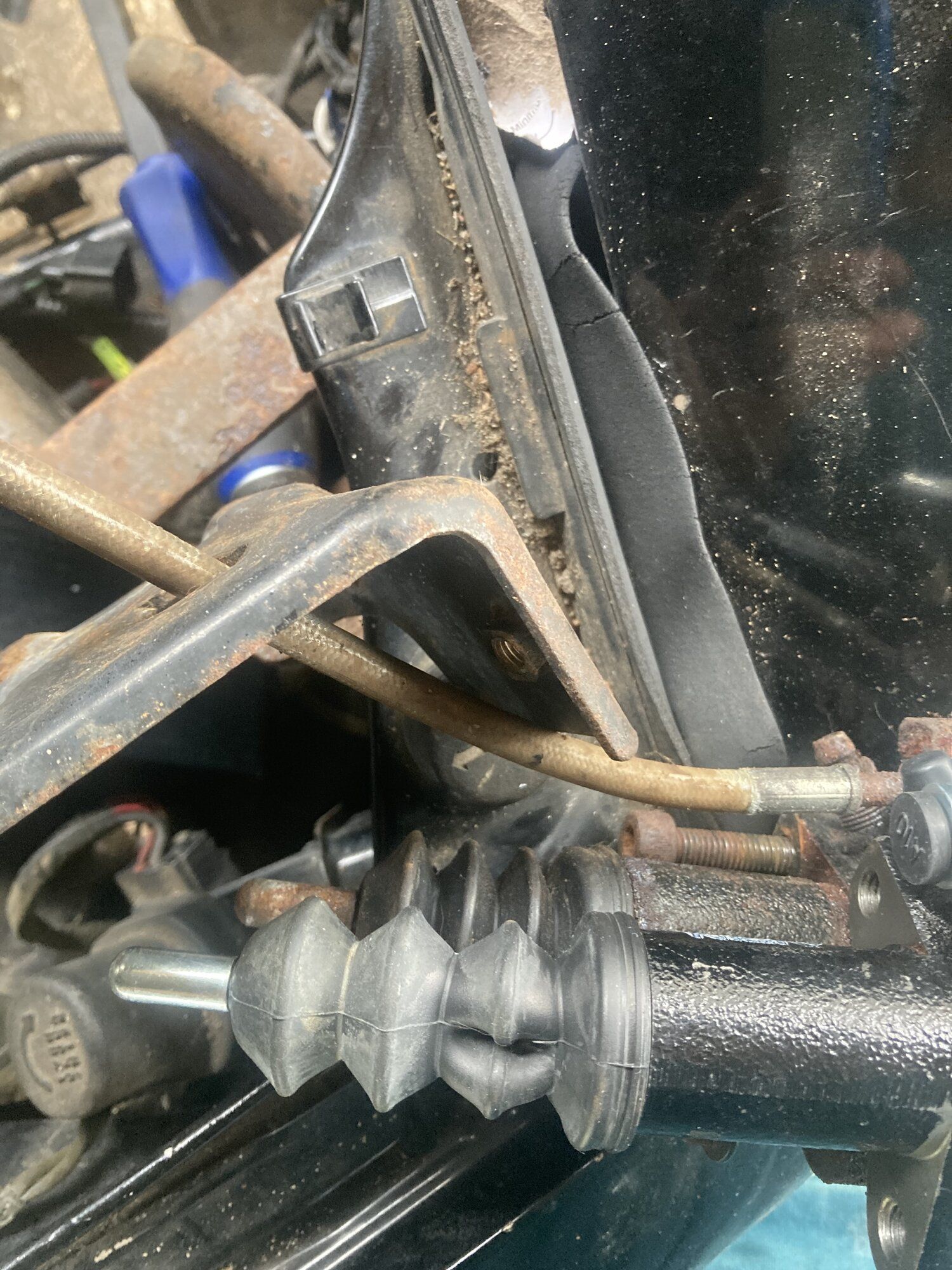

I think the clutch isn't engaging because it's an aftermarket slave with a much shorter throw/rod. I can pull the rod almost entirely out on the slave on the car now, and it's still roughly 1" shorter than the OEM one I just got from Jacks.
Pics to show you what I mean. And this is with the rusty slave rod pulled out as far as it would go.

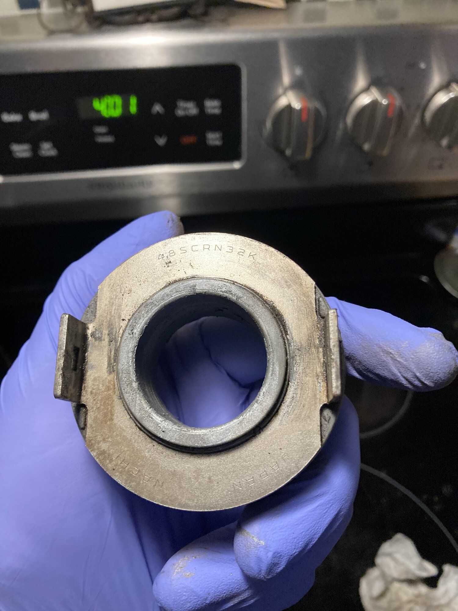

And then there's this asshole.

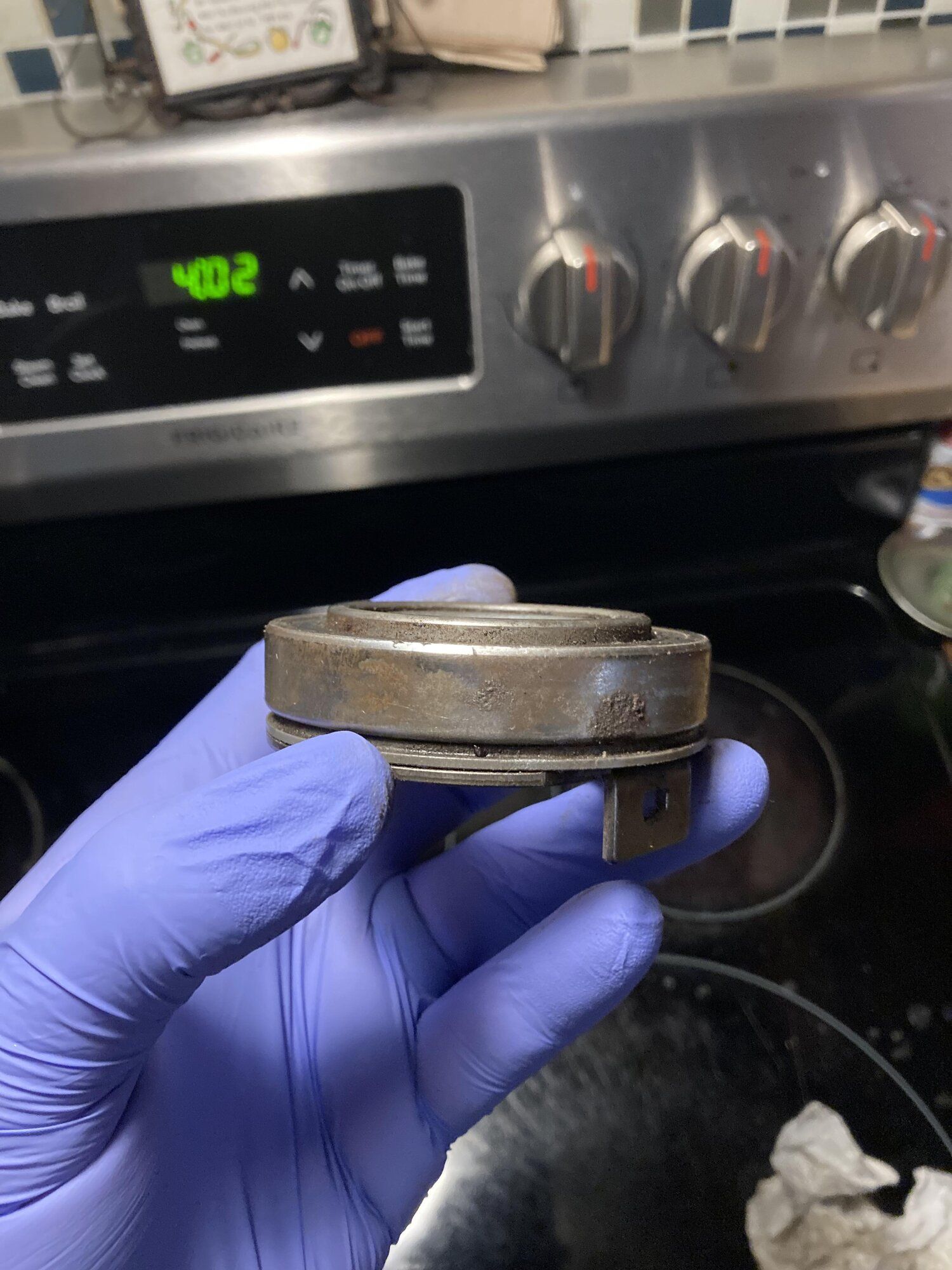

It's a non-OEM TOB, and it's in terrible shape. If you press against it and spin the bearing, there's an audible noise you can hear. Almost like a grinding sound. I can imagine how it'd sound if you put a crap ton of pressure on it and spun it thousands of RPM faster. It's not smooth and fluid at all.
At this point I'm pretty set on what I'm gonna do. I'm gonna order an OEM TOB and clip from Tim Z, and install the new slave along with the OEM TOB/Clip, and stab the trans back in. That will tell me everything I need to know. That way if it fixes the issue, I'll order the $700 southbend clutch from Tim Z and just break the engine/trans in on this old stocker.

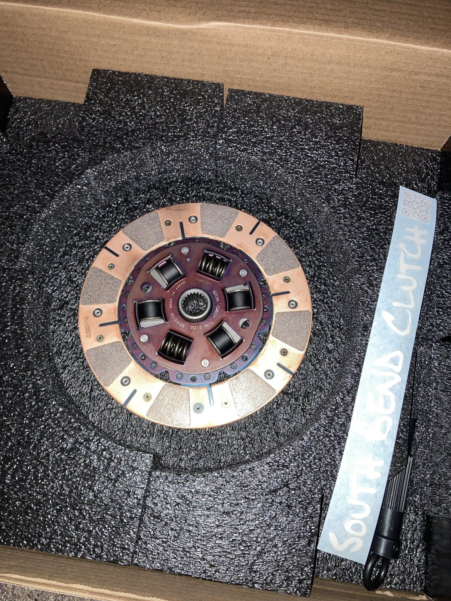

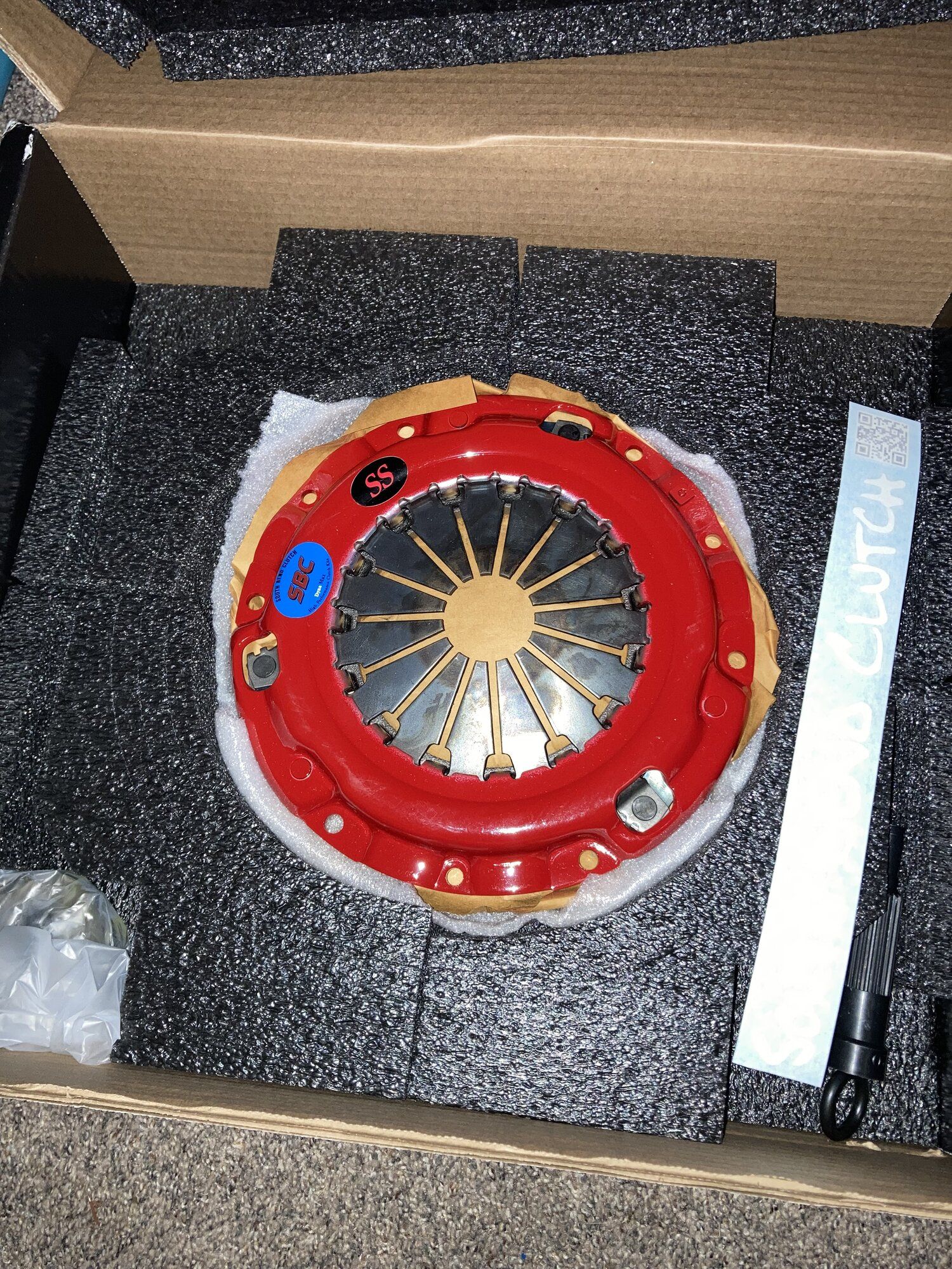

Woot. This came in from Timmy Tim Timiny aka @twicks69 today. So pretty.
Now I’m just waiting on the TOB, forged fork, and boot (slight delay on those but no biggie). Stuff is so pretty.
Have a few days off and I might use it to clean and paint the trans. Or I might use it to be a lazy POS and do nothing. We’ll see. :p
