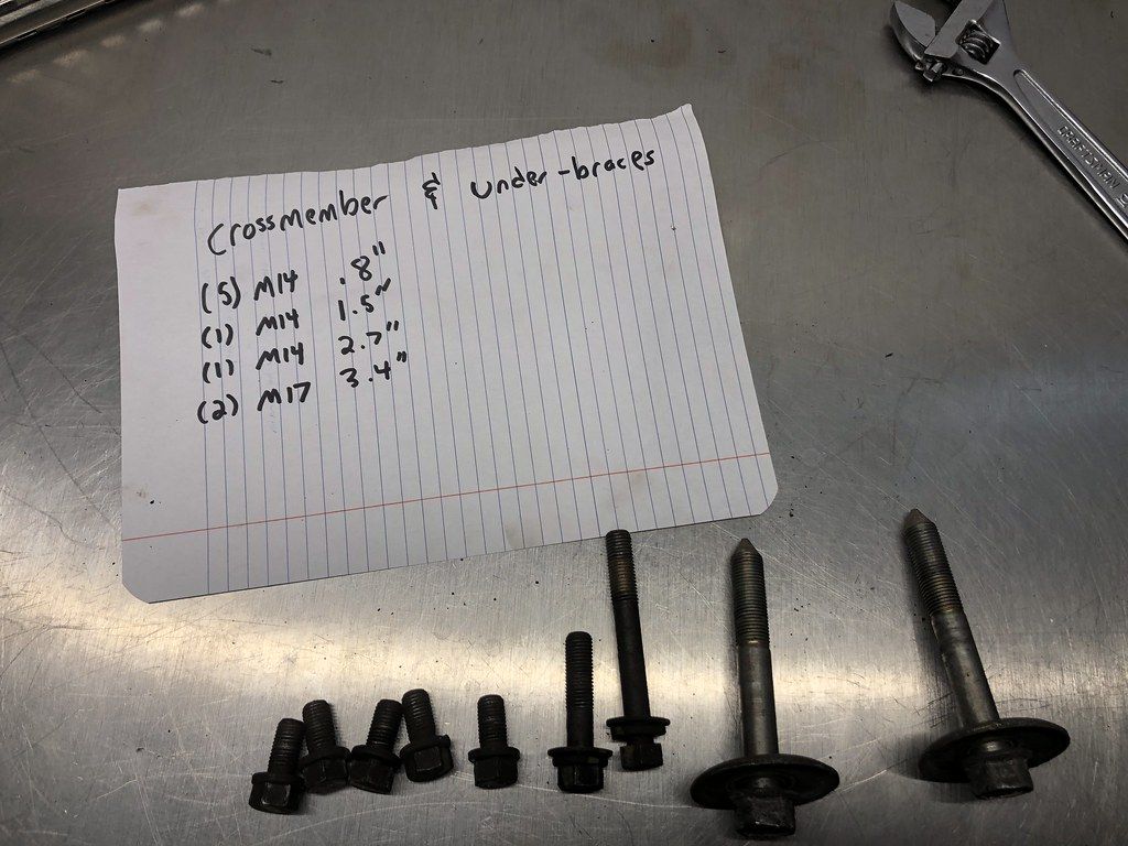

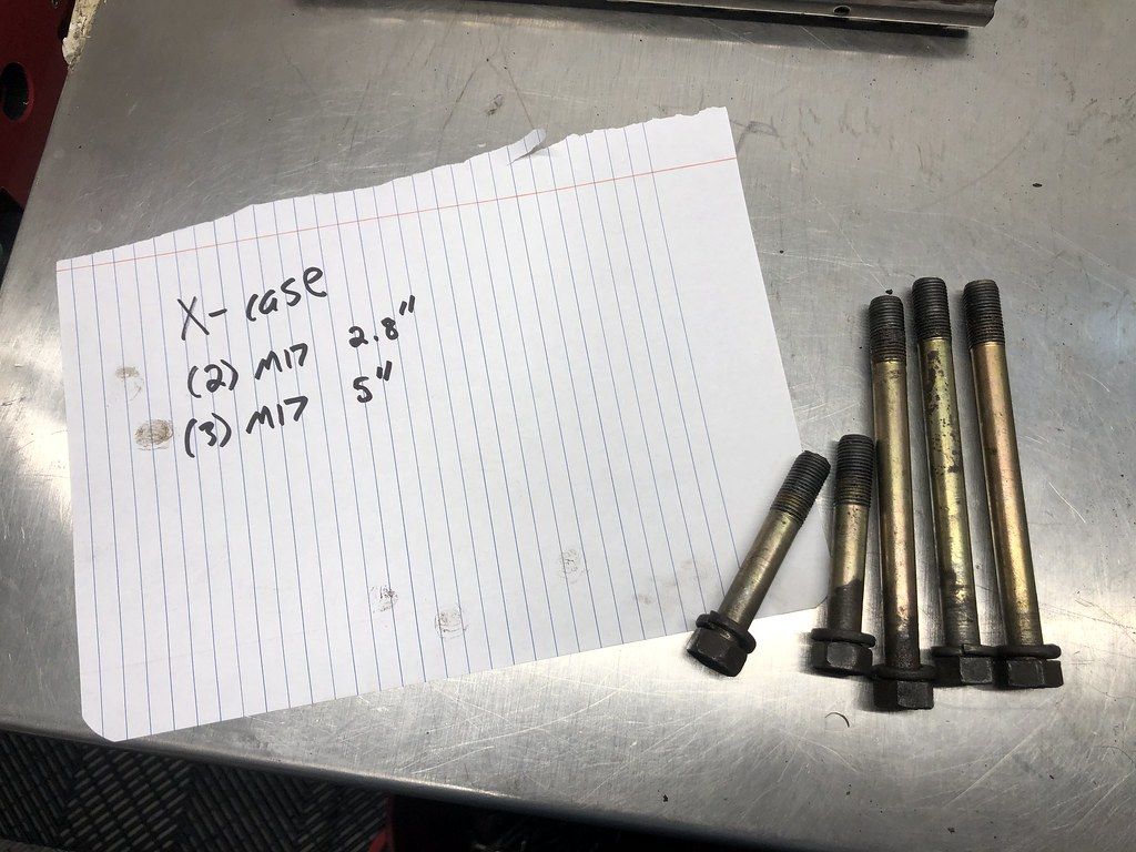

I'm also getting all of the OEM bolts zinc plated so I organized all of the bags of every bolt I have removed from the car. I just took pictures of the bolts, the size of the head, and the length of the bolt.
Basically did this for every bolt.

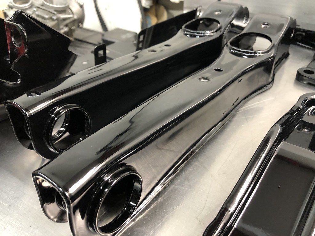

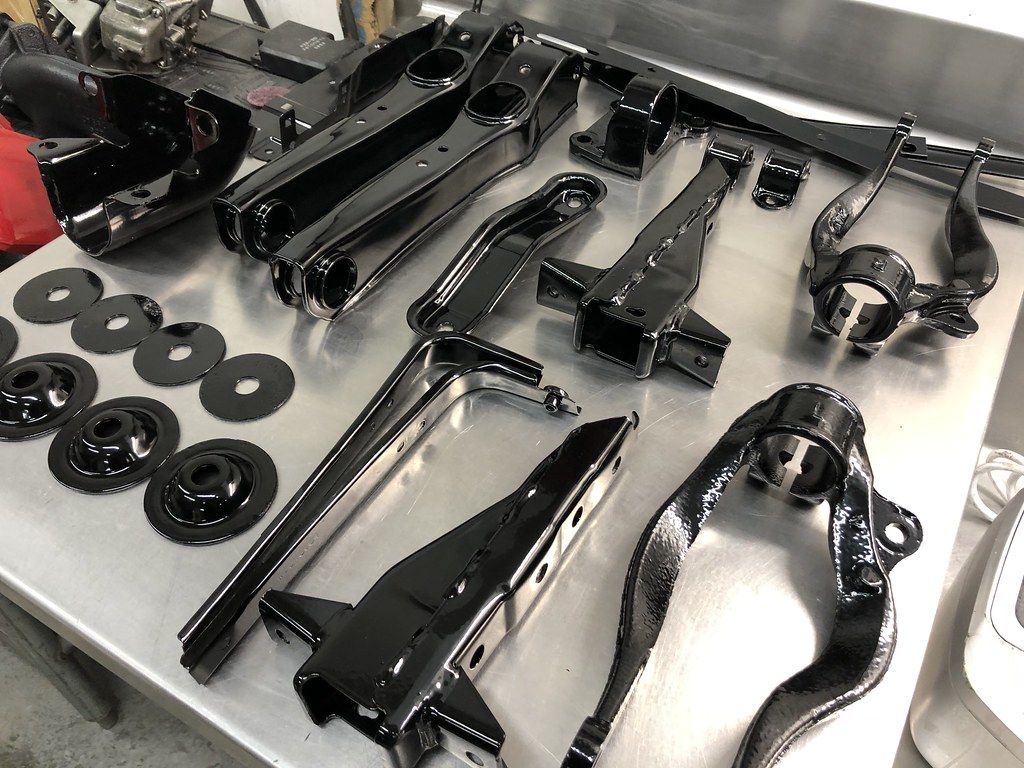

I picked up the first batch of parts from coating. Everything will be gloss black under the car, everything!!!. I did have some wrinkle black done, the water pipe and t-stat housings, but I think everything else I'll go with gloss black powder.
This batch included:
-Rear control arms
-Rear subframe bushing plates
-Rear Bumper brackets, all of them
-License plate bracket
-Fuel tank straps
-Rear sway bar brackets
-Front Shock Forks
-Diff mount
-Fuel Neck cover and other miscellaneous small items.
IMG_3844 by Brady Dingeldein, on Flickr
IMG_3845 by Brady Dingeldein, on Flickr
I have all new bushings for everything, can't wait to put them in.
Game plan currently is acquire parts, coat parts, clean parts, paint parts, zinc plate parts. Basically get as much of the small stuff done and off the to-do list!

Your sizes are wrong LOL. M17 is not a size on the car its the socket size so you might want to adjust that as it to me says thread size not head/socket size. The front bolts are m12x1.25 so thats a m12 but it takes a 17mm socket where the others are M10 and use a 14mm socket so just might wanna adjust the wording incase it does get lost
I promise I am fully aware of metric bolt sizing and socket sizes haha. Just quickly jotting down the socket used for all the bolts. These notes are only for me. I just took the pictures then threw the paper away.
I knew you would but i have been here before years ago with bolt sizing and socket sizes so i thought i would mention it. If one did get lost least you know exactly the details and threads etc.

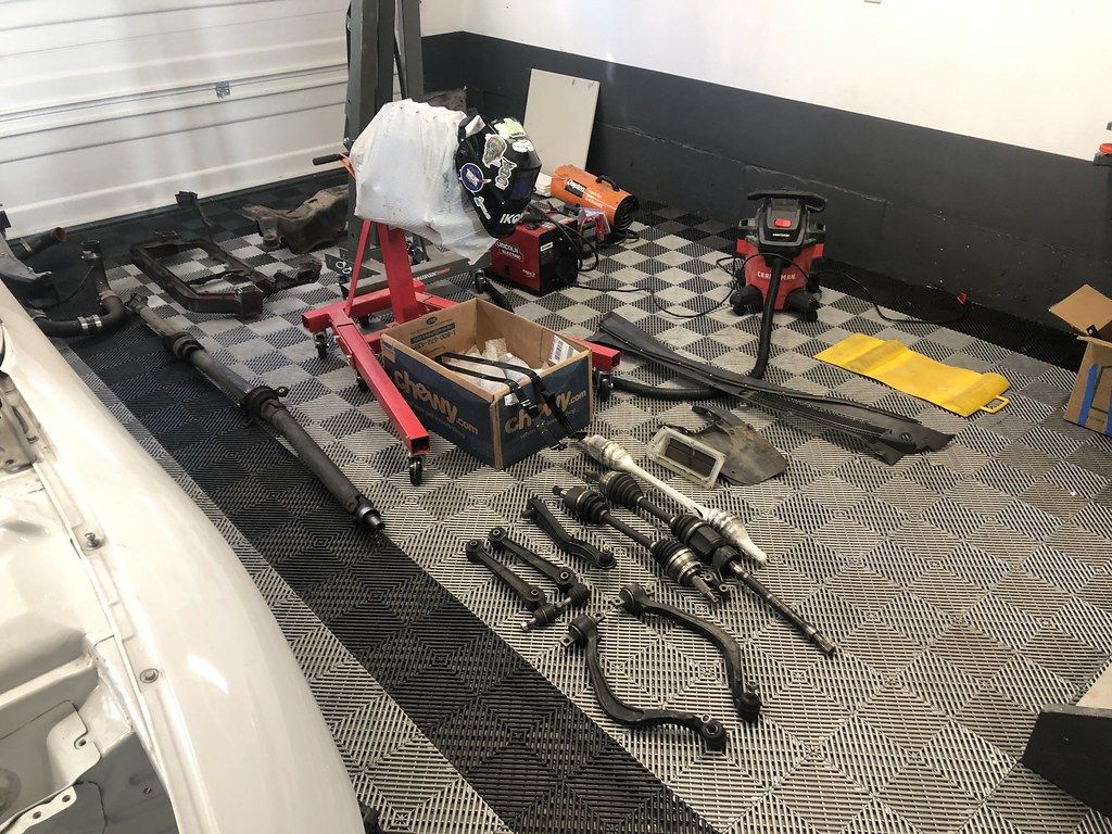

Abbie was gone all weekend so I didn't feel bad spending all weekend inside organizing and getting some stuff done to the eclipse.
I have been kind of taking inventory of everything, finding more stuff I want powdercoated etc etc.
Untitled by Brady Dingeldein, on Flickr
Also throwing stuff away like the wiper control motor/arms, sway bars and other stuff that I can buy new for cheaper than refurbishing them.

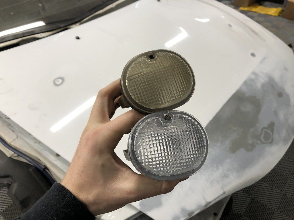

While taking inventory I came across the new rear lenses. Wow mine were f***ed up! LOL

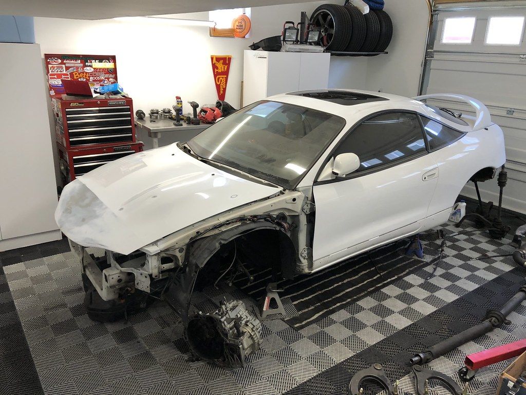

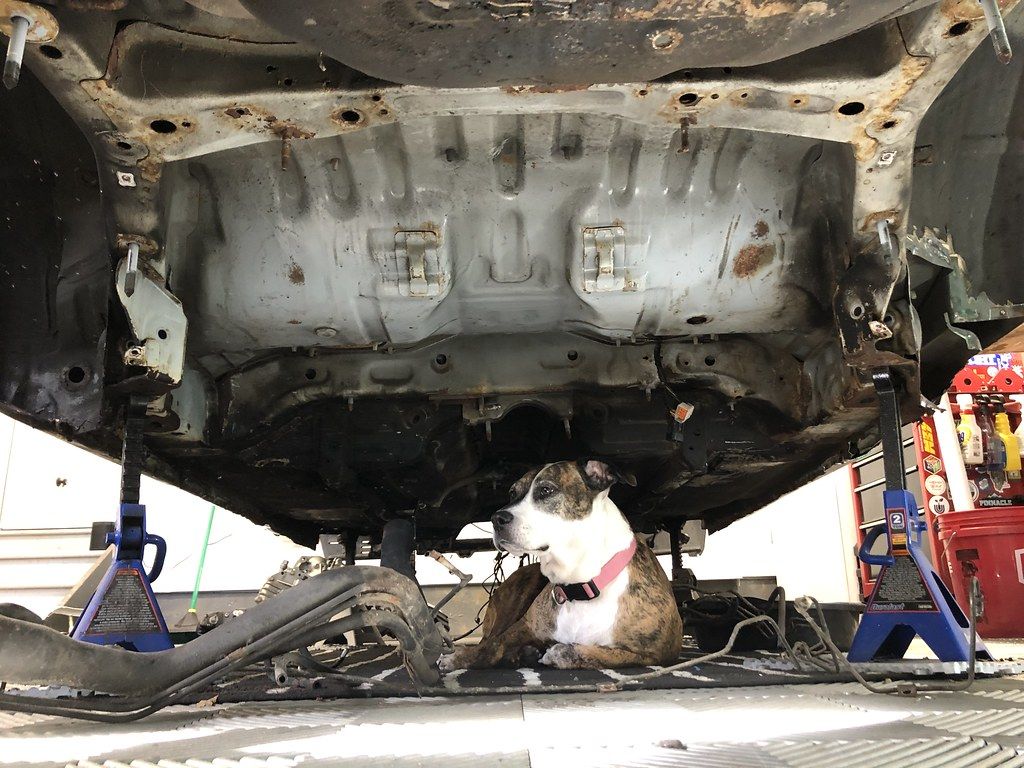

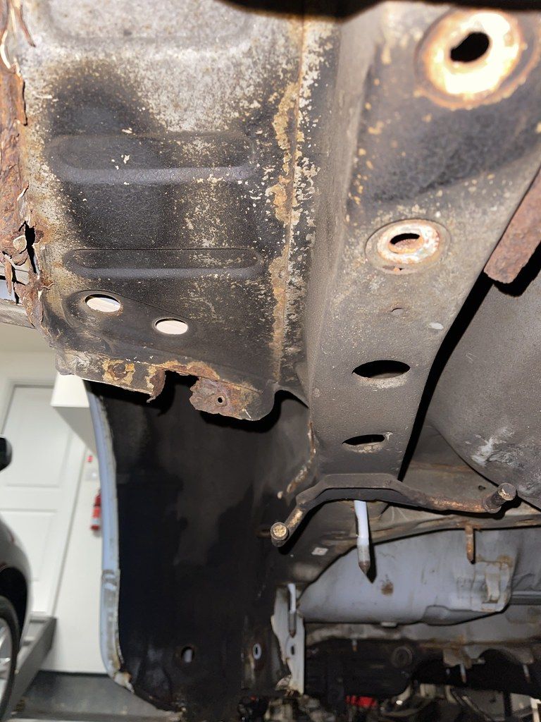

I know this will be super disappointing. But my shell will be getting scrapped. The rust was too bad, and would have cost thousands. Not including the hundreds of hours of my time to fix it all.
The shell needed new doors, fenders, front/rear bumpers( too spider cracked per the paint shop) and a new hatch. Let alone both rockers, rear axles, all new brake lines (rusted), about a dozen broken bolts underneath, radiator support and somehow fix the destroyed pinch welds and lower frame rails (completely crushed). Even if I completely fixed the rust, there was always a chance of it rusting through because of the hidden areas etc etc.

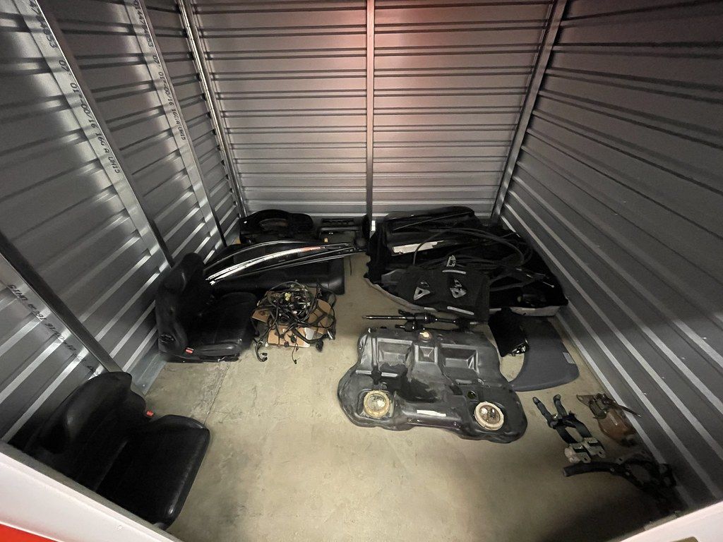

I've removed everything I'd possibly want off my old 99. Quarter glass comes out tonight, as well as the fuse harness/splash shields...
Everything is going into a storage unit for the time being.

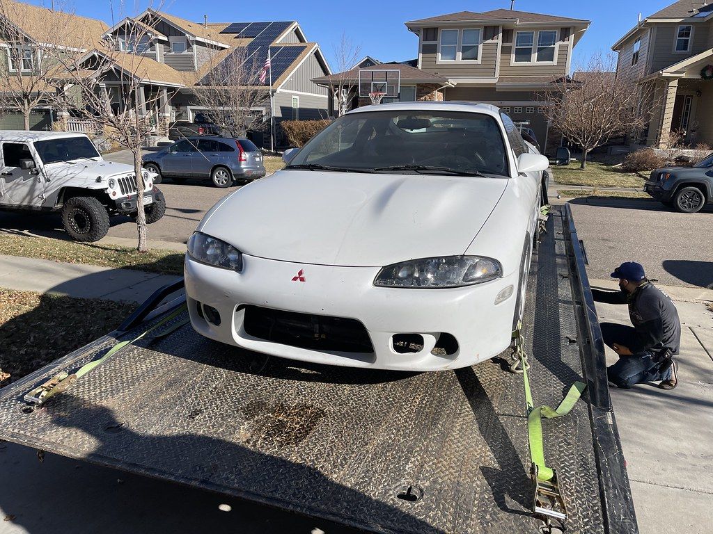

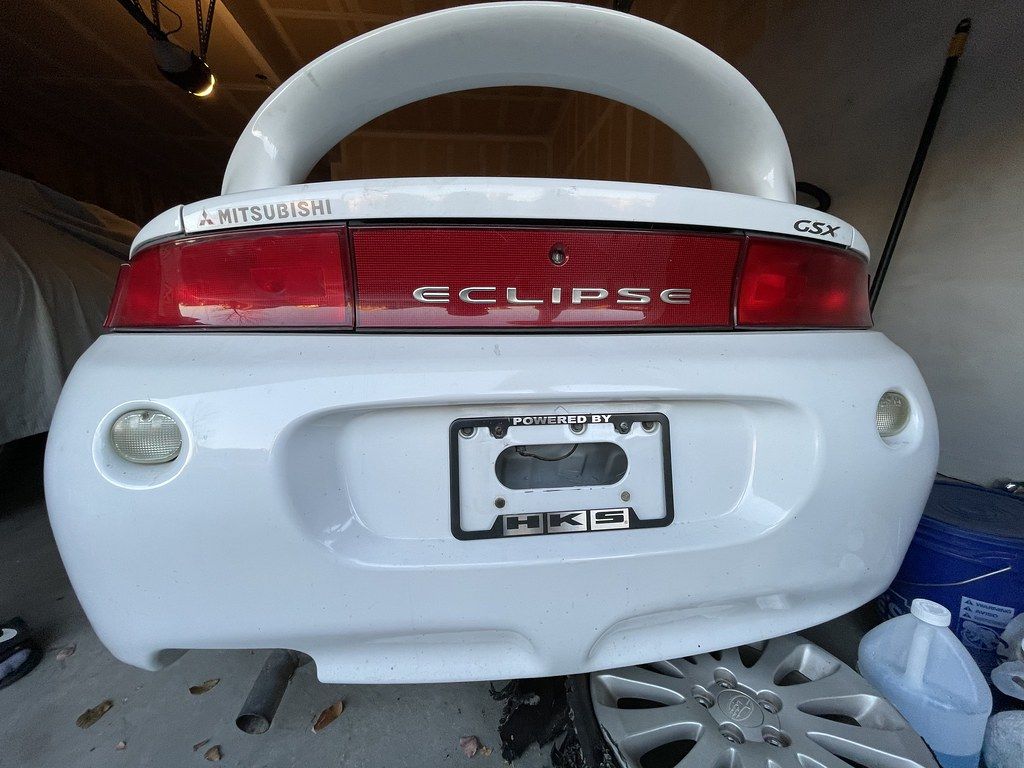

All because I picked this up.

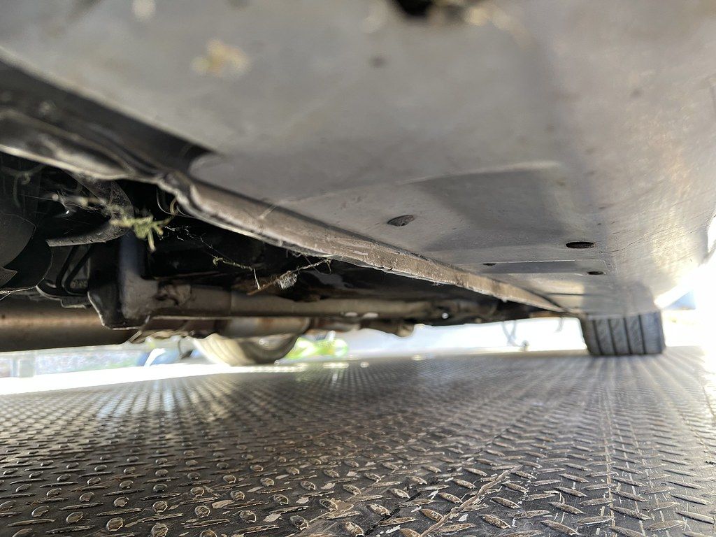

Pretty much untouched 99 Northstar White GSX. LSD, black leather, 5spd cali car. With the nicest underbody I've ever seen on a 2g.

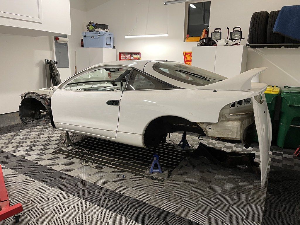

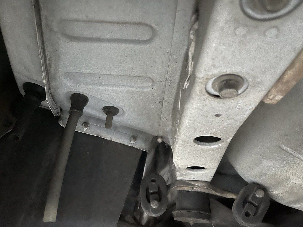

Here is a comparison of the rear driver underbody section of old vs new.
The pinch welds and frame rails are untouched.
This has all the parts I needed to complete mine, and at first I was going to cut the new one up, but just didn't make sense. So this car will be the new one I build from.

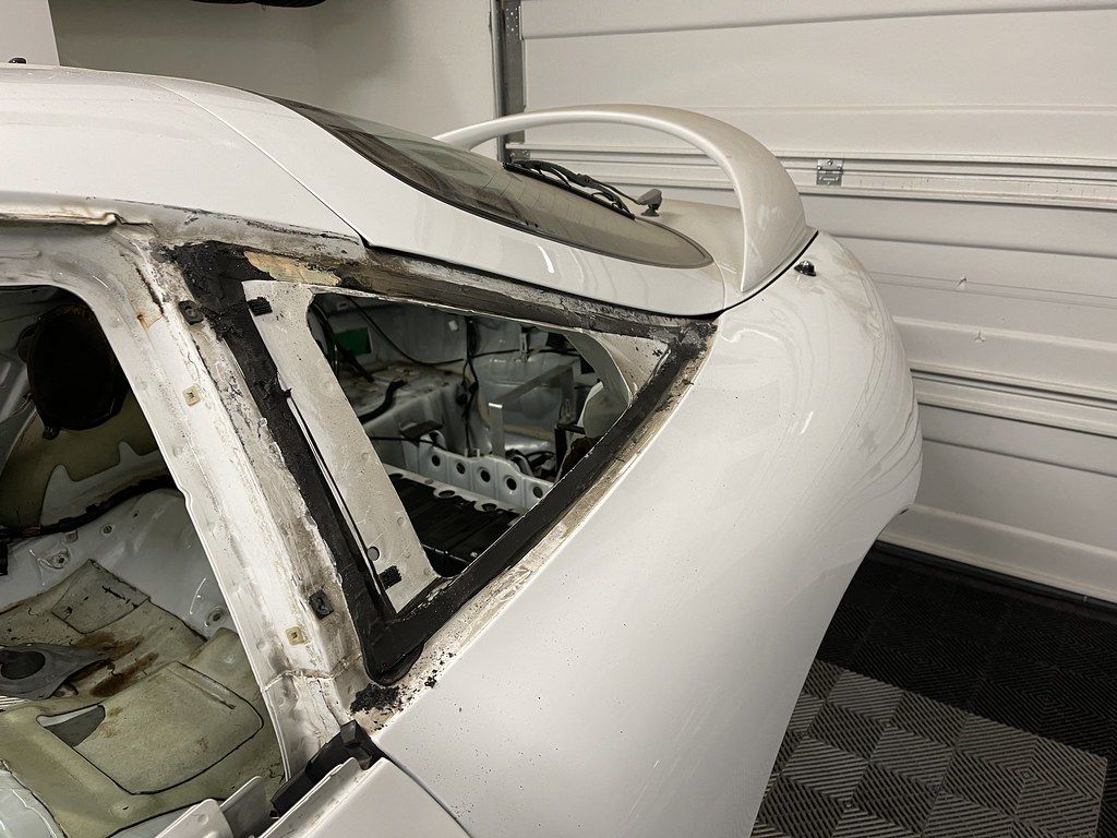

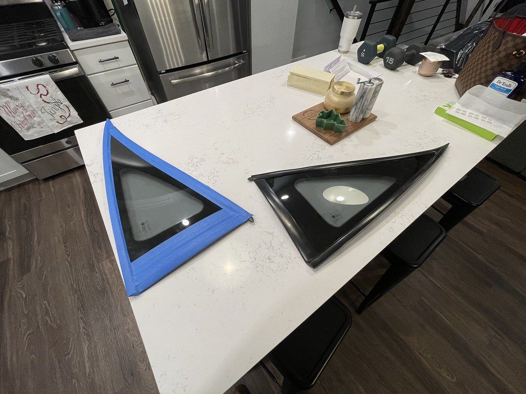

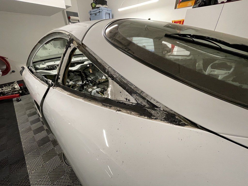

I pulled the rear quarter glass as they are in amazing condition and the new ones are not!
