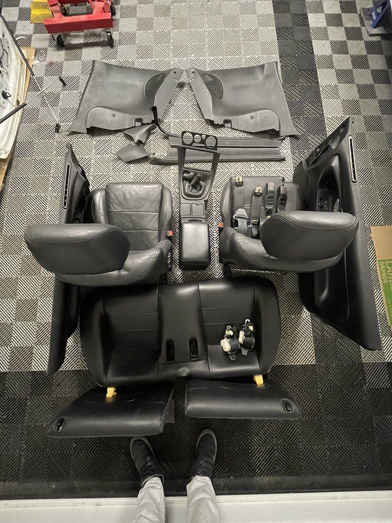

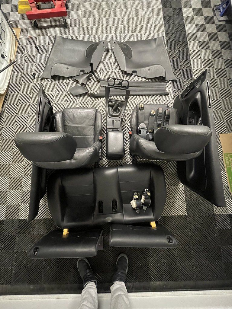

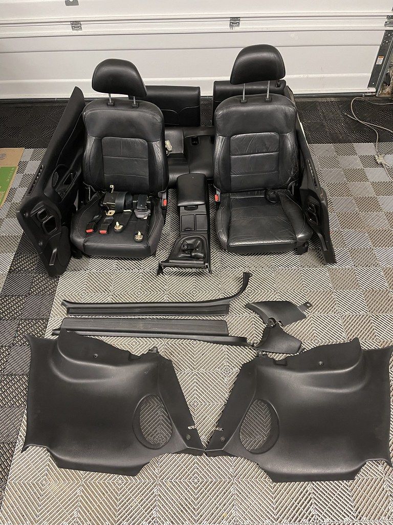

So my first goal was to get rid of all duplicate parts so I can stop paying for my storage unit. so I have compared every piece of duplicates and kept the one in better shape of the two.
That left me with the "worse" of the two, full black interior swap. Everything. Seatbelts, dash, everything.
Untitled by Brady Dingeldein, on Flickr
I've posted this for sale for $500 on facebook. I'm not going to ship this.

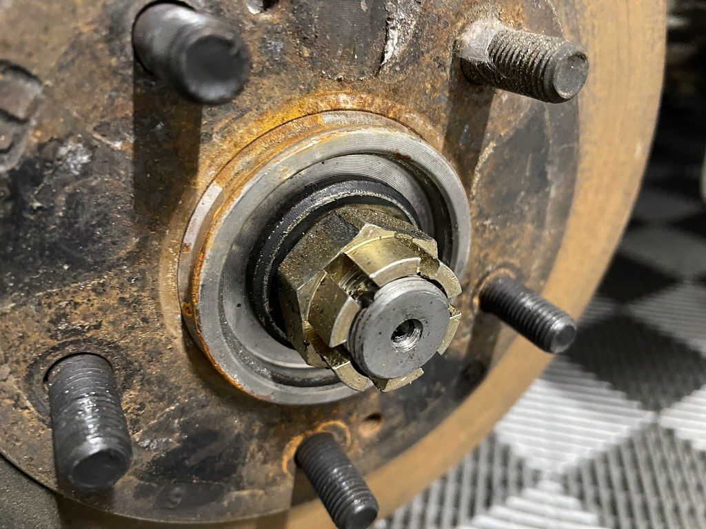

Another thing I wanted to do, which I failed to do in the past, is break loose all the axle nuts while the car is on the ground!
I popped the wheel off to be PLEASANTLY surprised with the axle nut looking like this.
All 4 axle nuts popped off without a hiccup.. amazing...

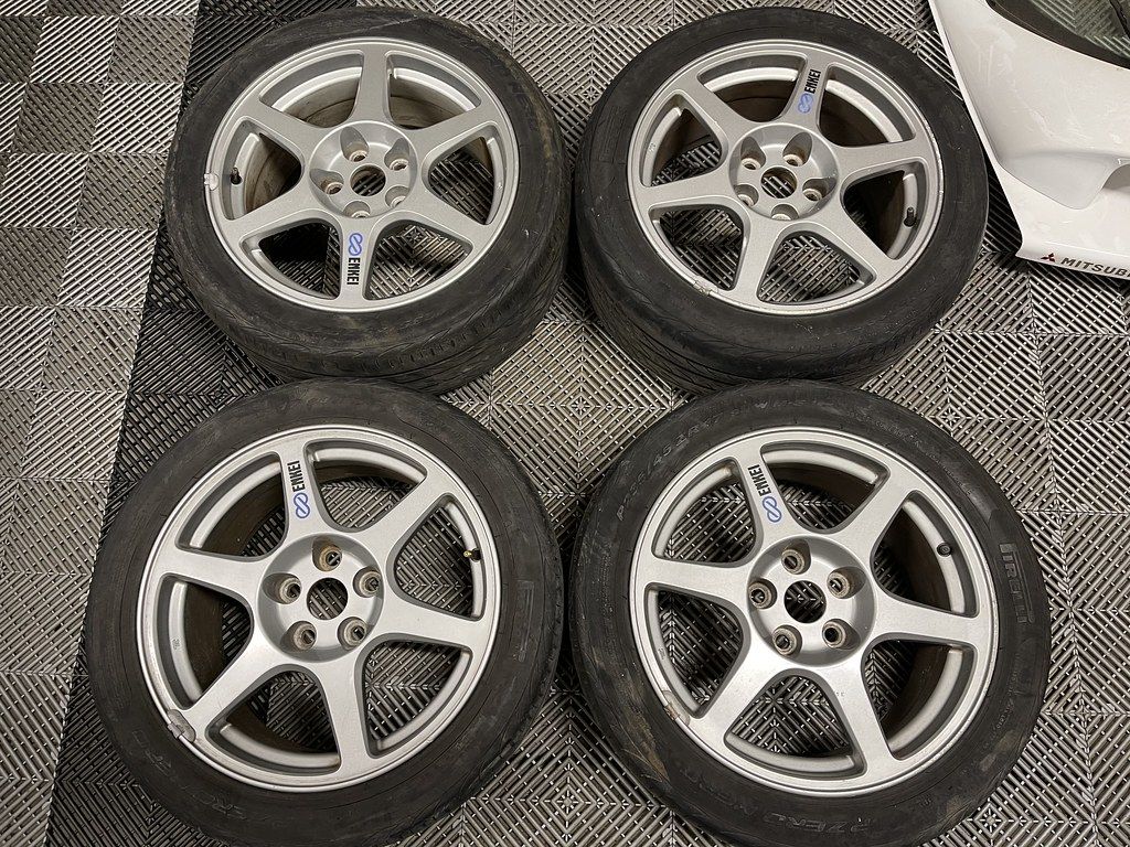

I then sold the evo 8 enkeis it came with. Someone showed up with $500 within the hour to pick them up.

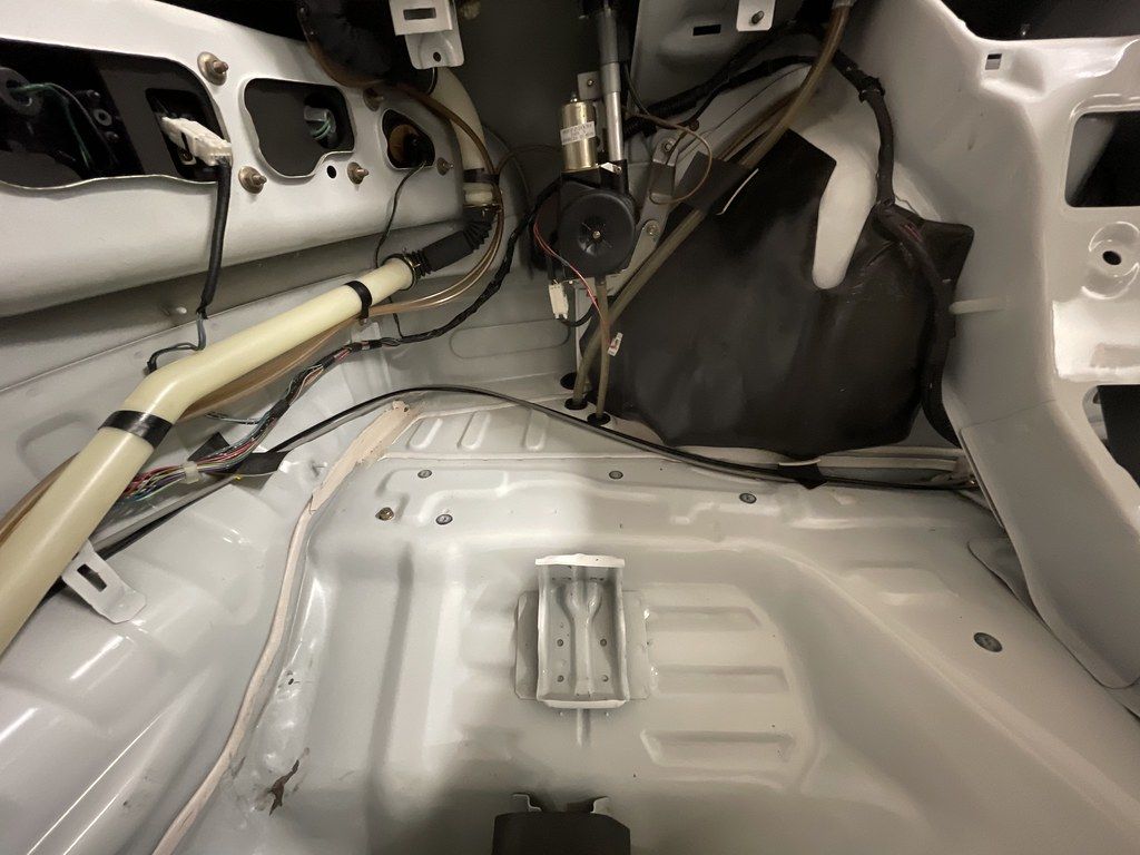

While I was back here I swapped in my old antenna motor as the new one was broken.

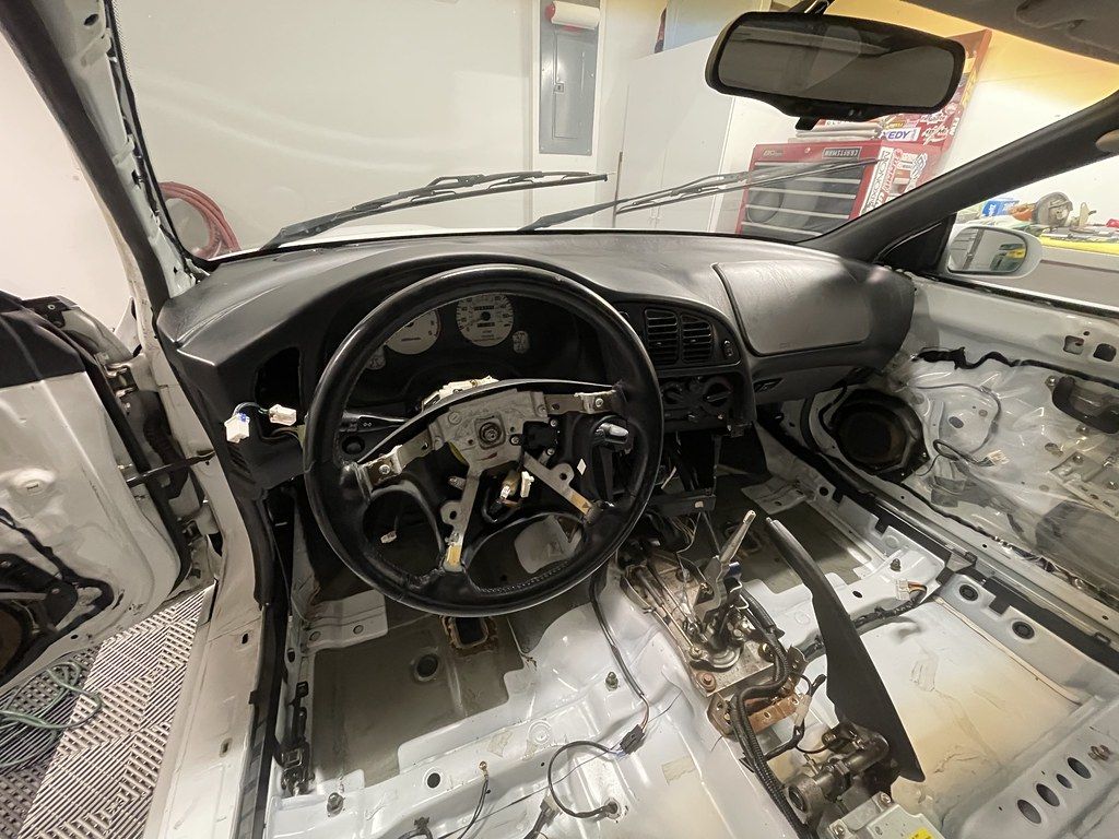

I got my dash back installed, with the gauge cluster.

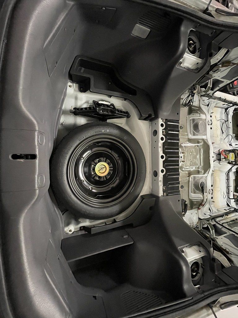

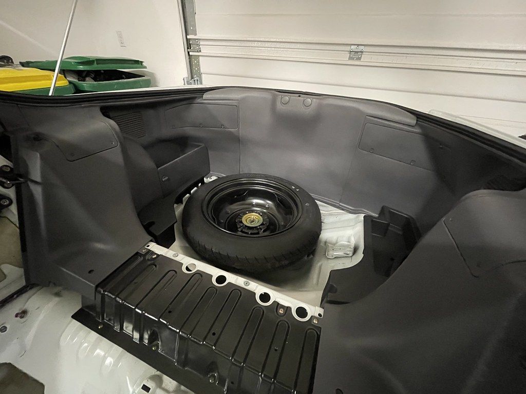

I put the trunk area back together completely.
I will keep the spare in the back to support the cargo floor.

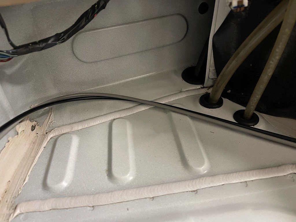

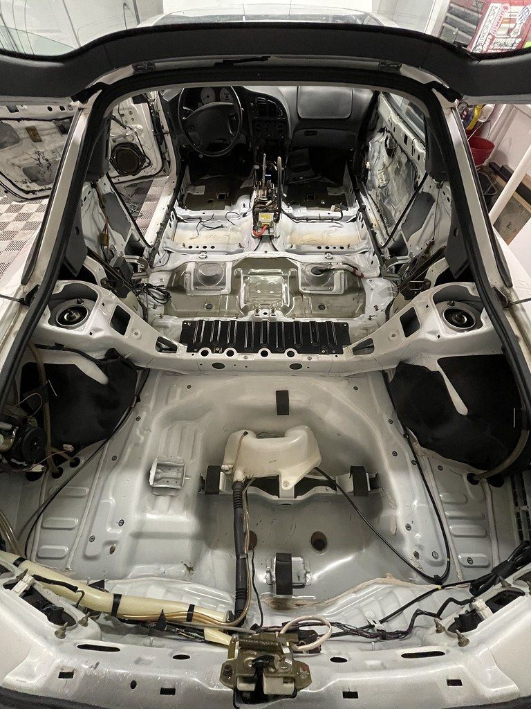

It is crazy how clean this shell is....

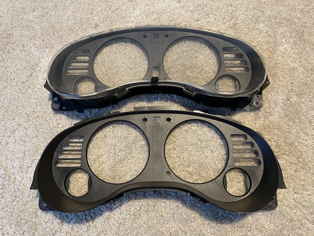

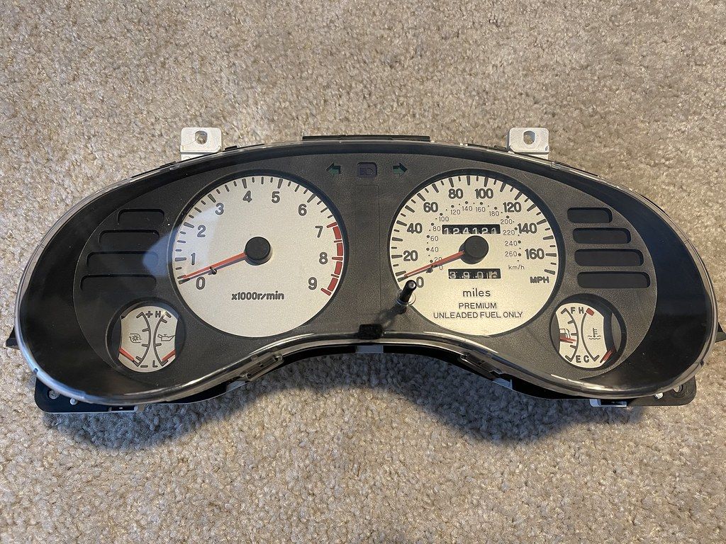

Another thing I did while I had the spare parts was swap my cluster into a 5spd housing so I didn't have to look at the A/T section in the center of the cluster. My car was originally automatic.
So now It is in a proper 5spd housing without the opening in the center lower portion of the cluster.
Even though I will more than likely be removing a lot of this in the future prior to some painting/wiring, I wanted to get the interior 100% installed and complete with all correct hardware so I didn't forget or lose anything. I also didn't want things to get damaged, so figured this would be the best route.

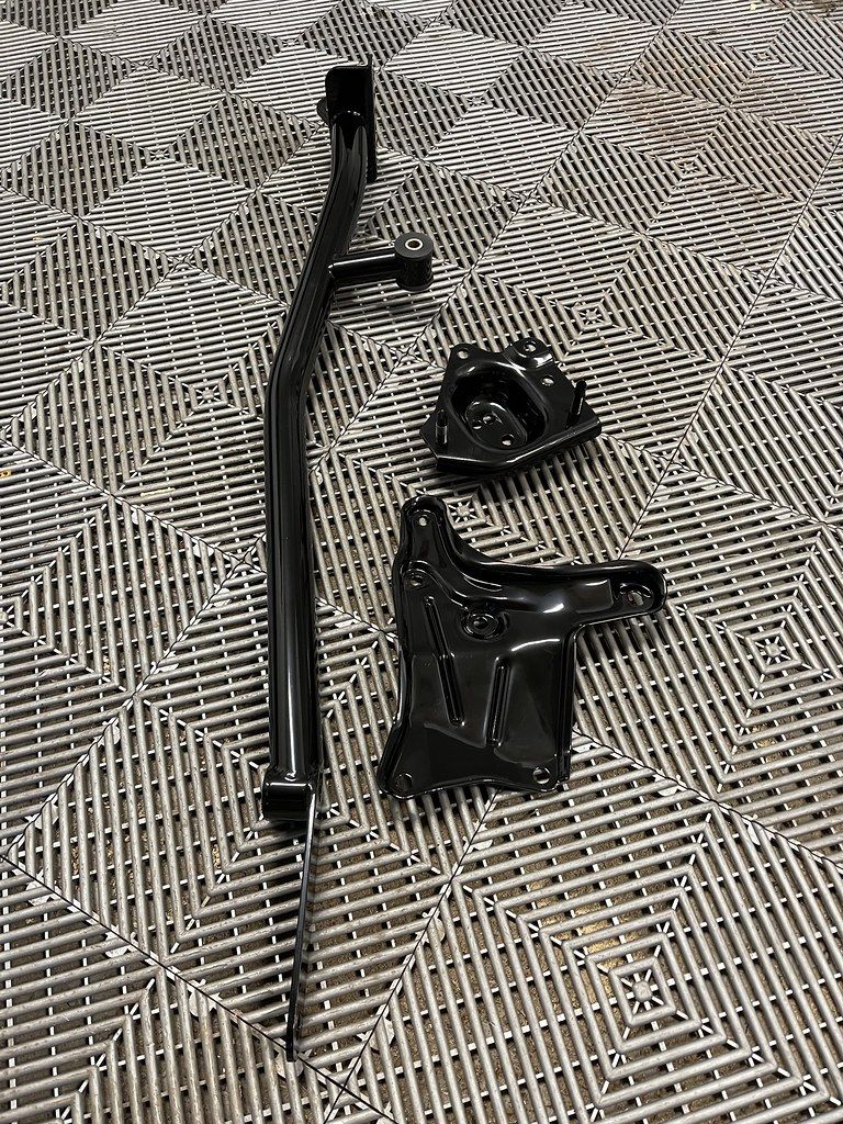

I got a couple more small things back from powder coating. This includes my bullfab cross member, lower brace, and transmission mount, all in gloss black.

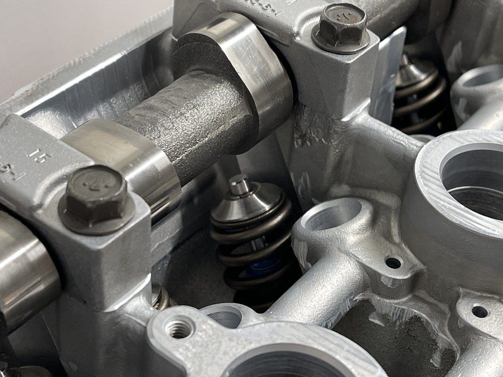

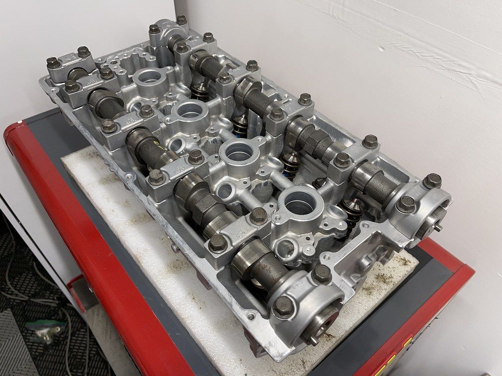

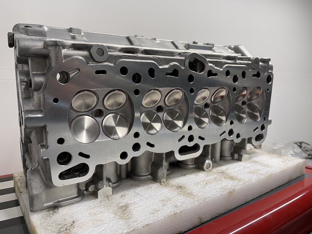

I picked up my built head from Icrave Boost as well.
I have been talking with I Crave Boost about doing a block refresh. Checking everything out, new ARP main studs, new rings/bearings etc. as well. I will probably pull the trigger and have them fully assemble the entire long block.

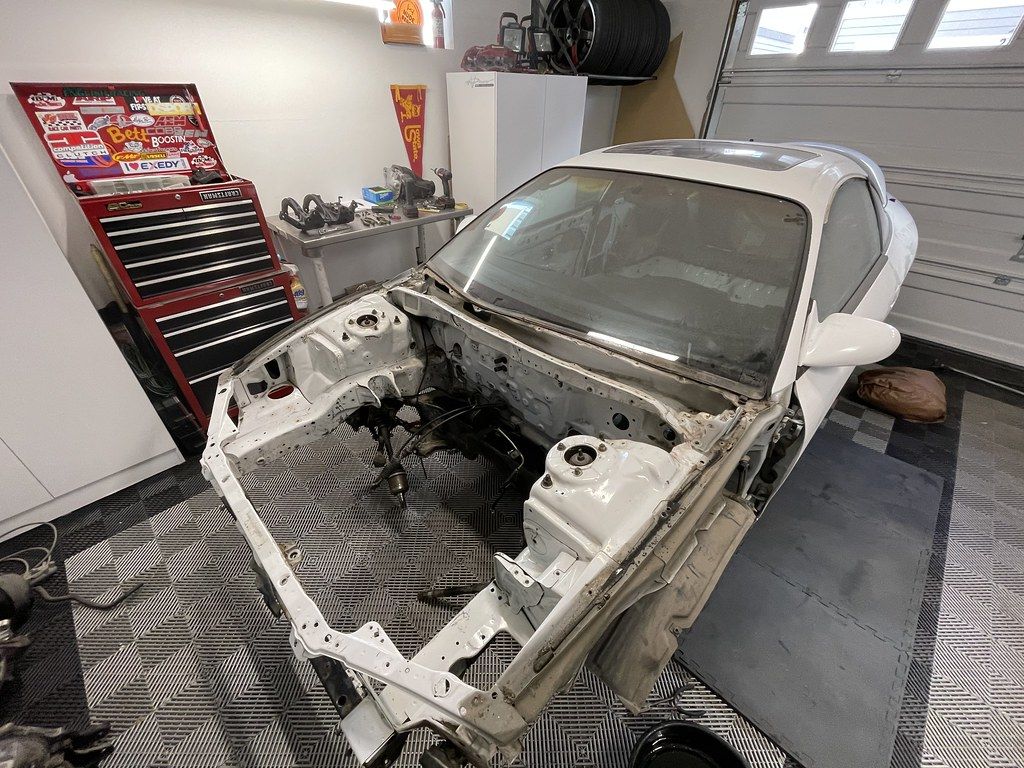

So I've still slowly been buying parts for the refresh/resto and slowly cleaning/disassembling the shell getting it ready for paint.

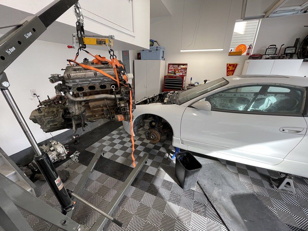

I yanked the OEM long-block and got that sold. I now have duplicates of the full drivetrain. Unsure if I will sell all the duplicates or not....
IMG_1323 by Brady Dingeldein, on Flickr
Gutting this thing and getting it how I want it. I'm filling every hole I am not using, and gutting ac/heat/abs/blower/wipers/washer fluid.

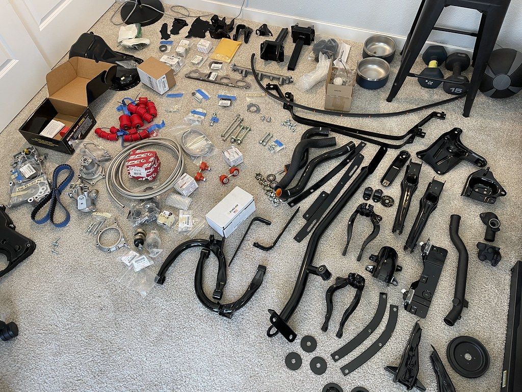

I wanted to take inventory of all my parts/powdercoated items to see if I was missing anything etc. I can't wait to put all this together.
IMG_1476 by Brady Dingeldein, on Flickr

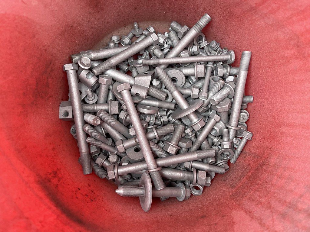

I finally got my bucket of bolts sent out to get media blasted. This is every bolt I removed from underneath the car all exterior panels etc.
IMG_1472 by Brady Dingeldein, on Flickr

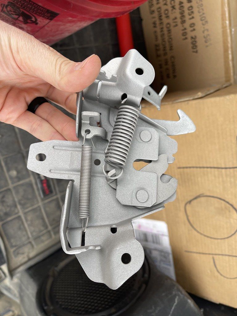

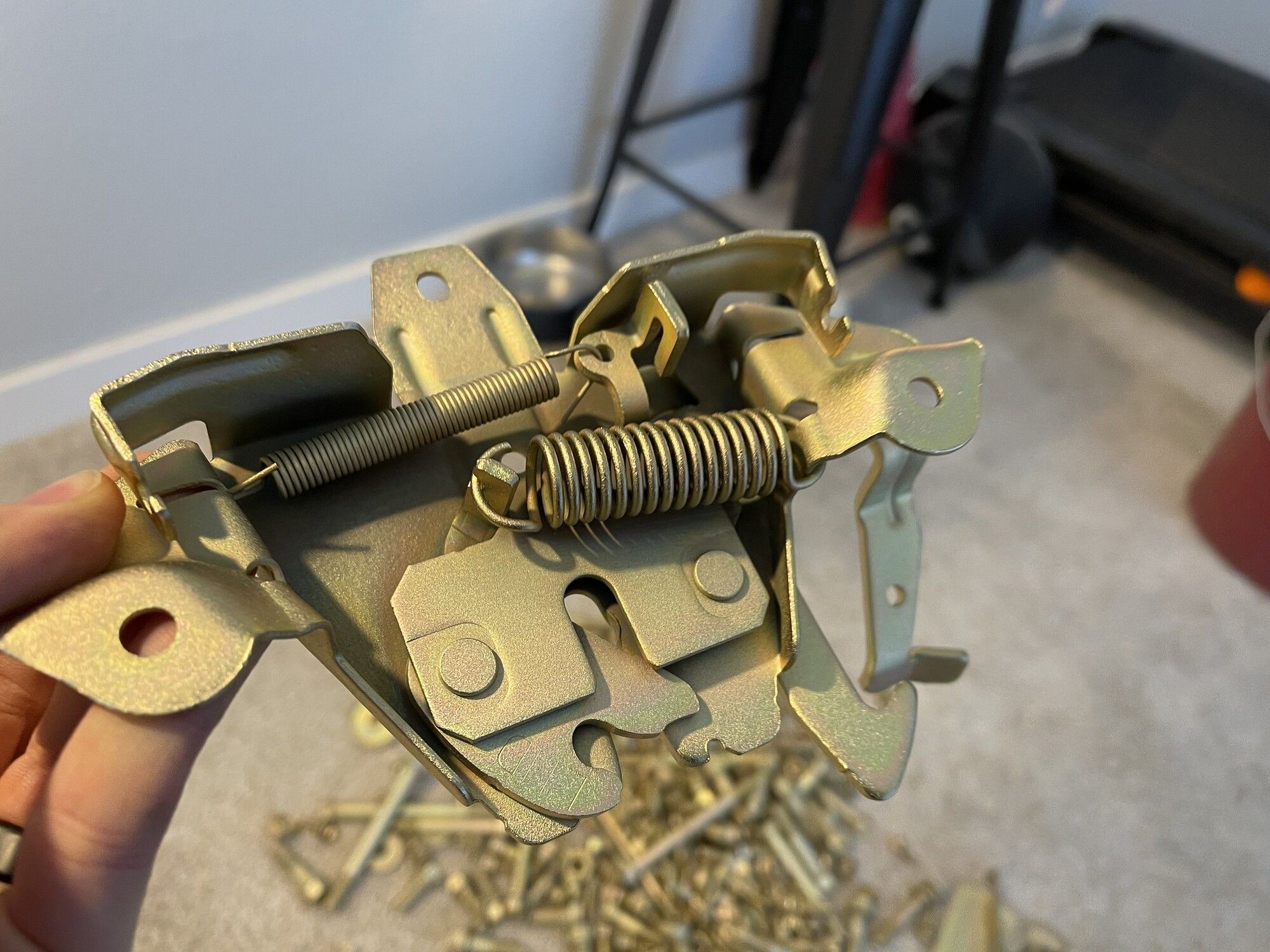

I went ahead and had the hood latch blasted as well. All these parts are currently at the plating company getting yellow-chromate zinc'd so they will all look brand new OEM.
IMG_1471 by Brady Dingeldein, on Flickr
Everything that is bare metal will be blasted and zinc plated.

Yesterday I pulled the trigger on my body shop deposit and drop-off date! Can't wait.
The following is being done:
-Underbody/wheel well are getting scraped/grinded/cleaned and then will be seam sealed and U-Pol Raptor lined in black.
-Glass is all being removed, windshield is getting replaced with new.
-All Jams, entire body and doors getting sprayed as well as bottom of hood OEM Northstar White
-Wiper hole and washer fluid holes are getting shaved and filled (not running wipers)
-Engine bay is getting completely shaved and sprayed
I will have to go and remove the subframes once it arrives at the shop for it to get the underbody completed.

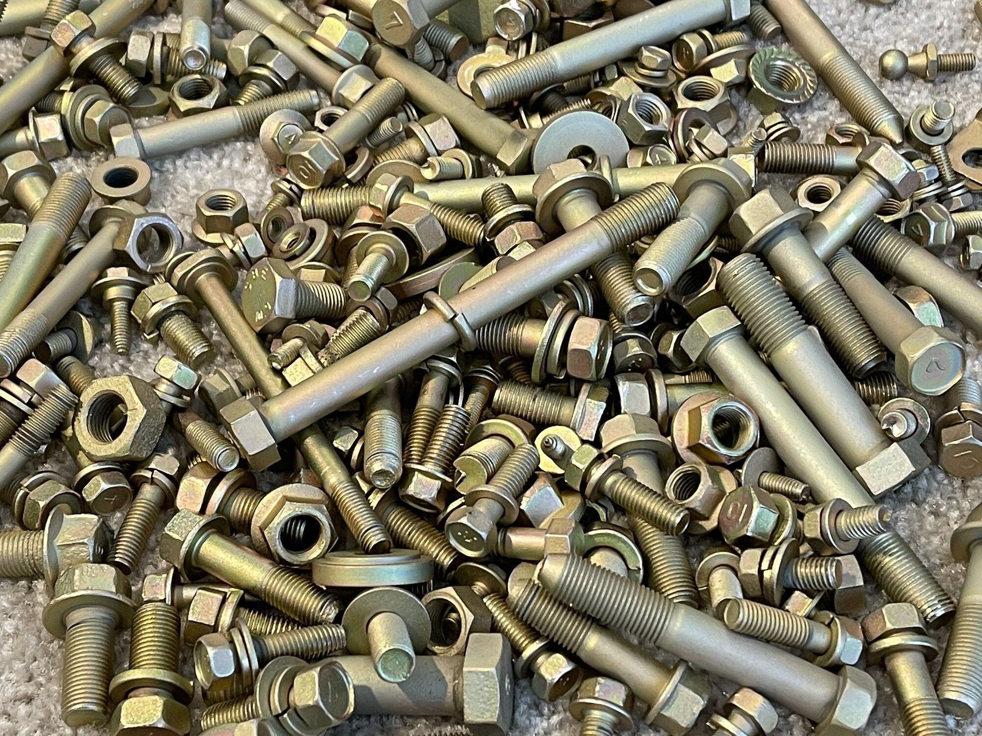

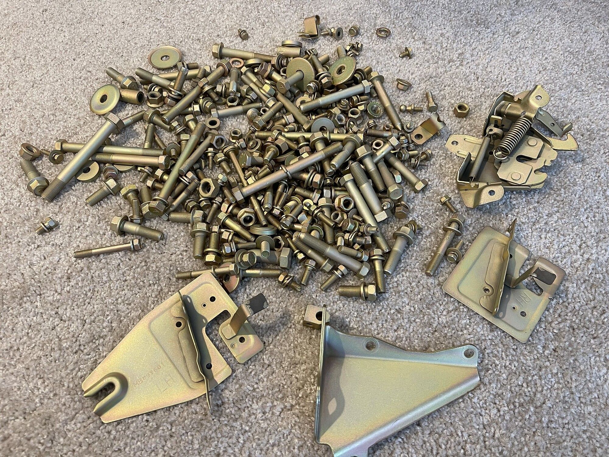

I picked up my bucket o' bolts from plating. So happy with the results!
I thought about possibly tearing apart junkyard dsms and providing this service. Label and tag all the bolts based on the part number. Since a lot of these bolts are not available, or crazy priced per bolt. Not sure yet. I will have duplicates of basically two whole DSMs worth of bolts I will start to organize here soon.
