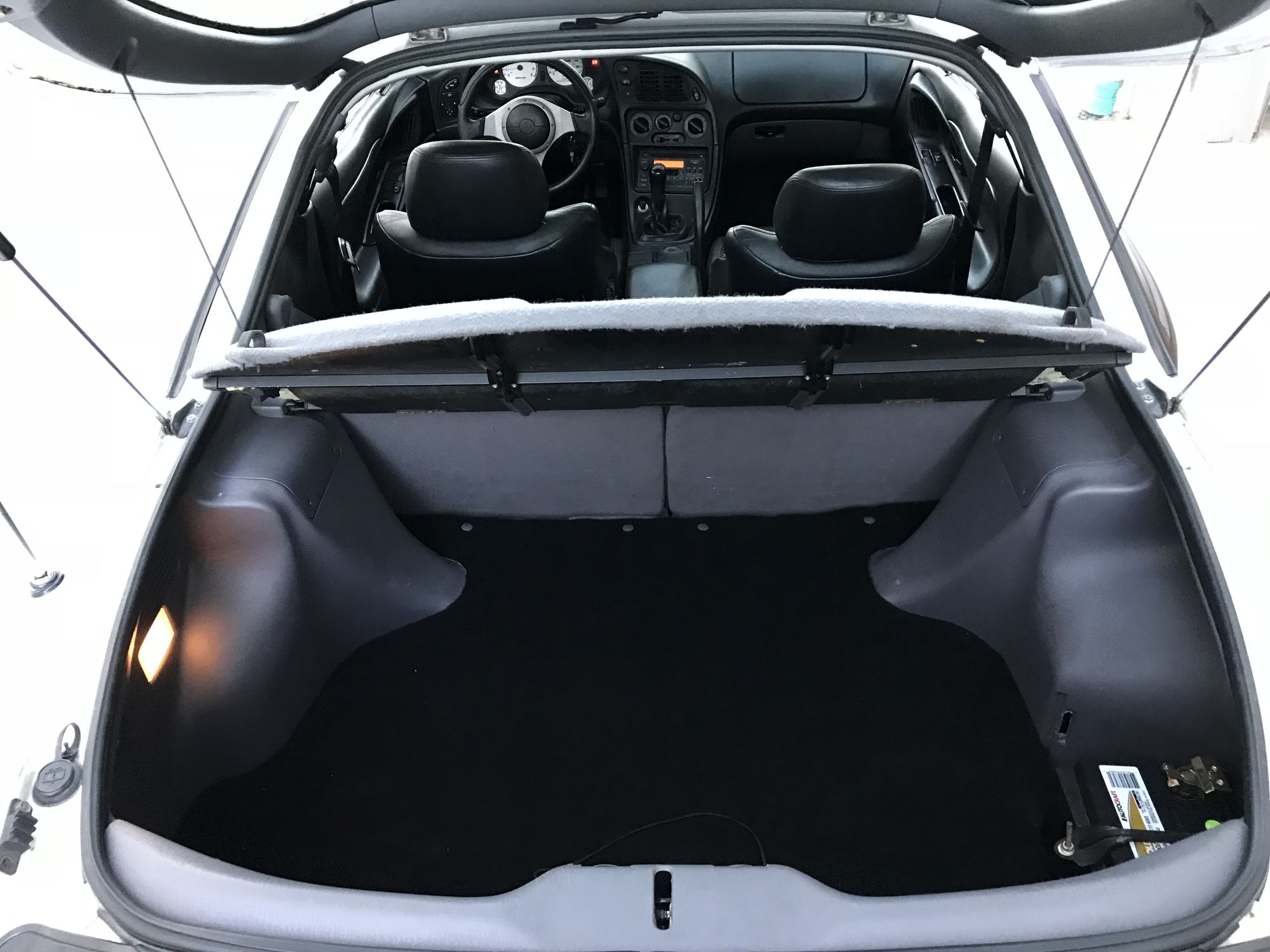

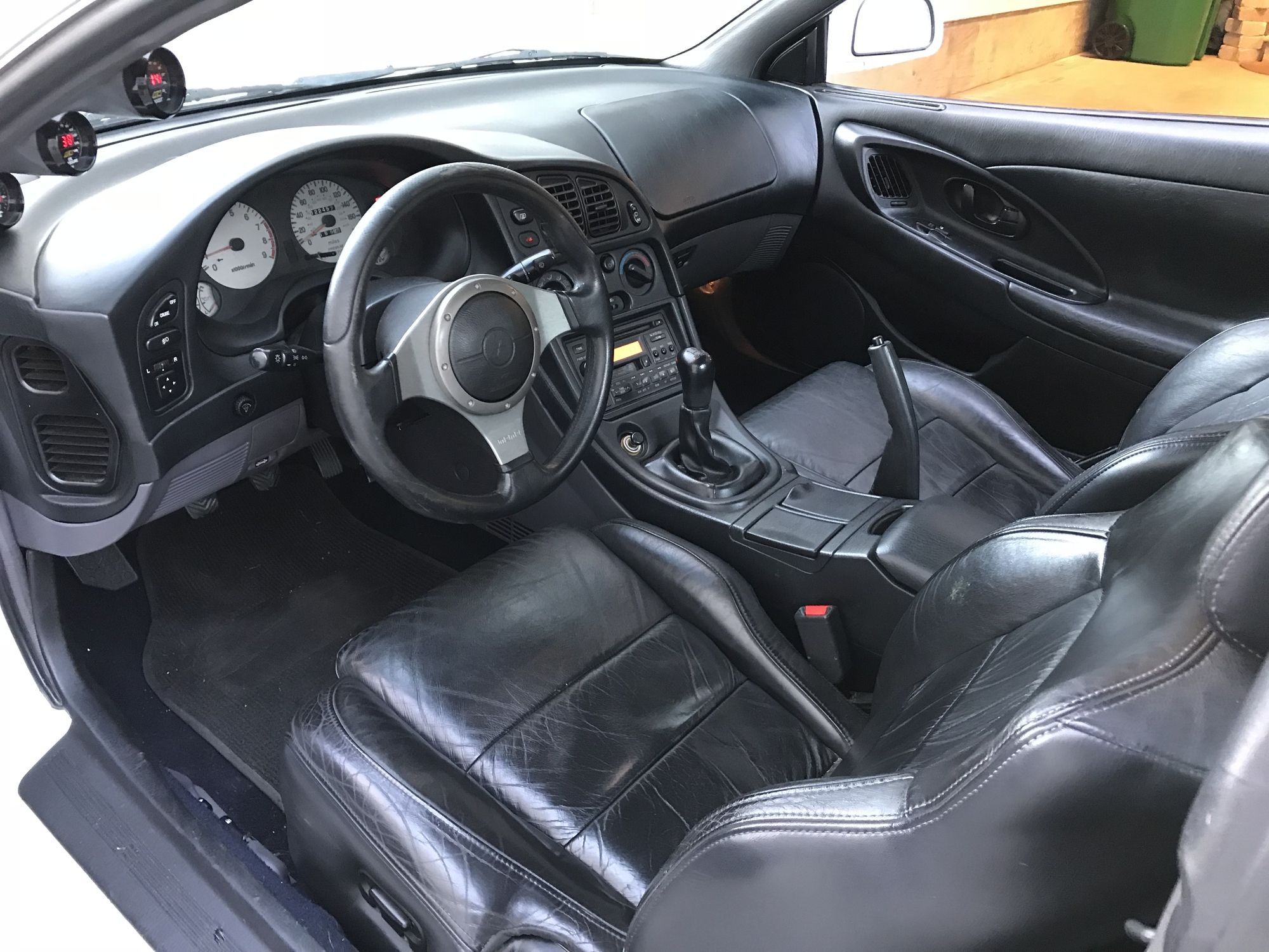

Figured I would take some pics of the interior.
I would really like to spend some time doing a full DEEP detail on the interior. That can wait until this winter I suppose.
Anyway, here are the pics.

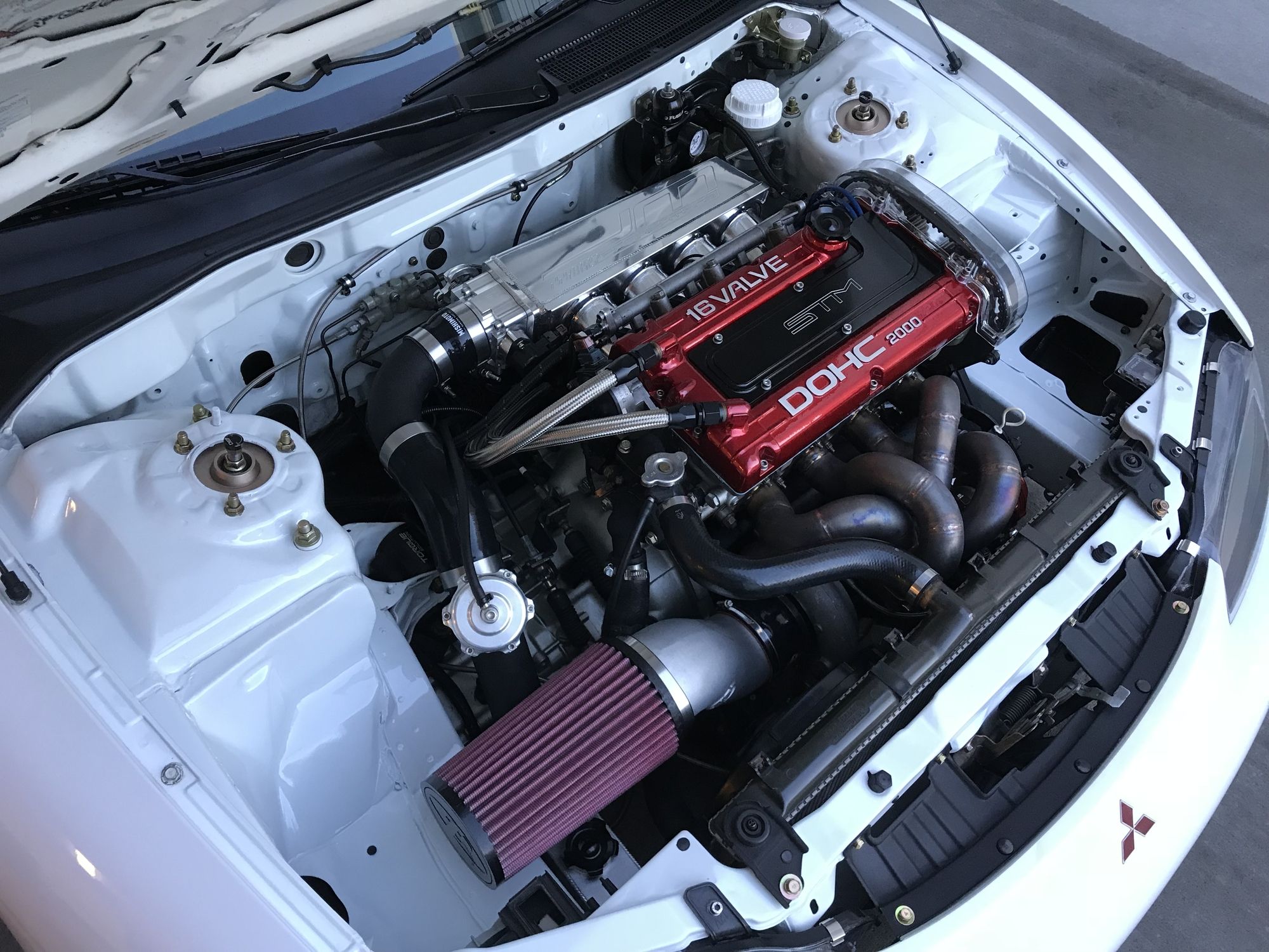

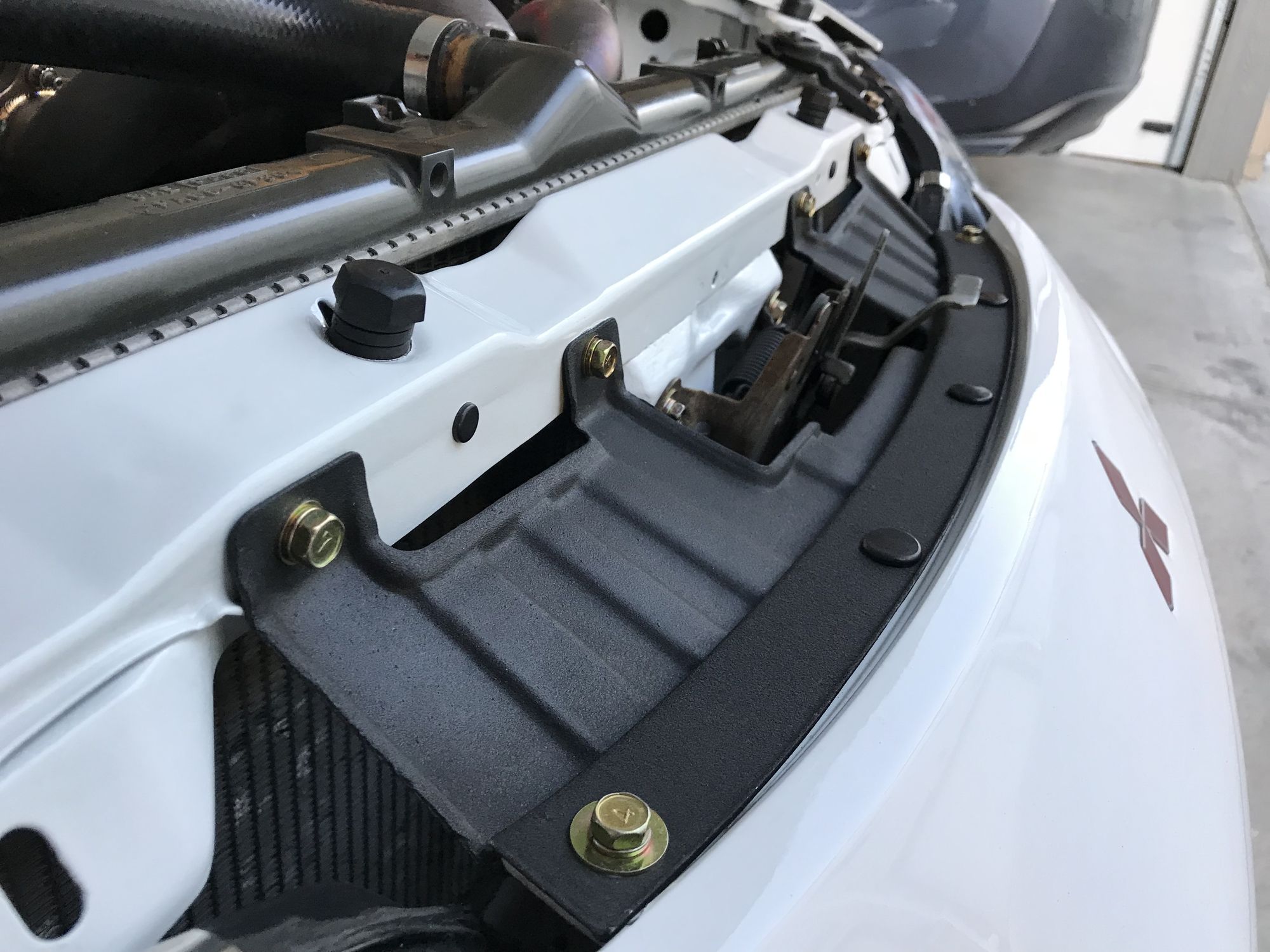

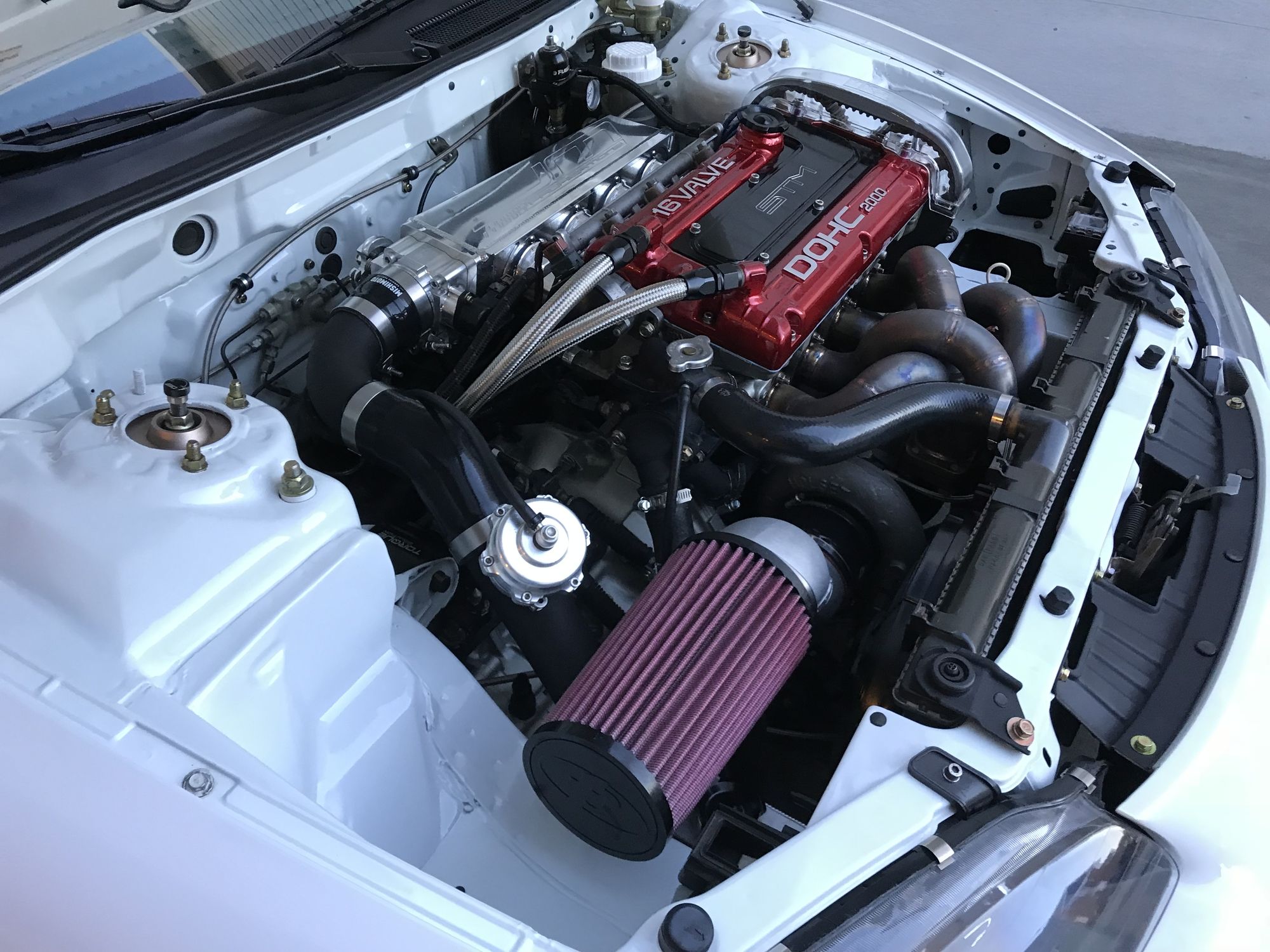

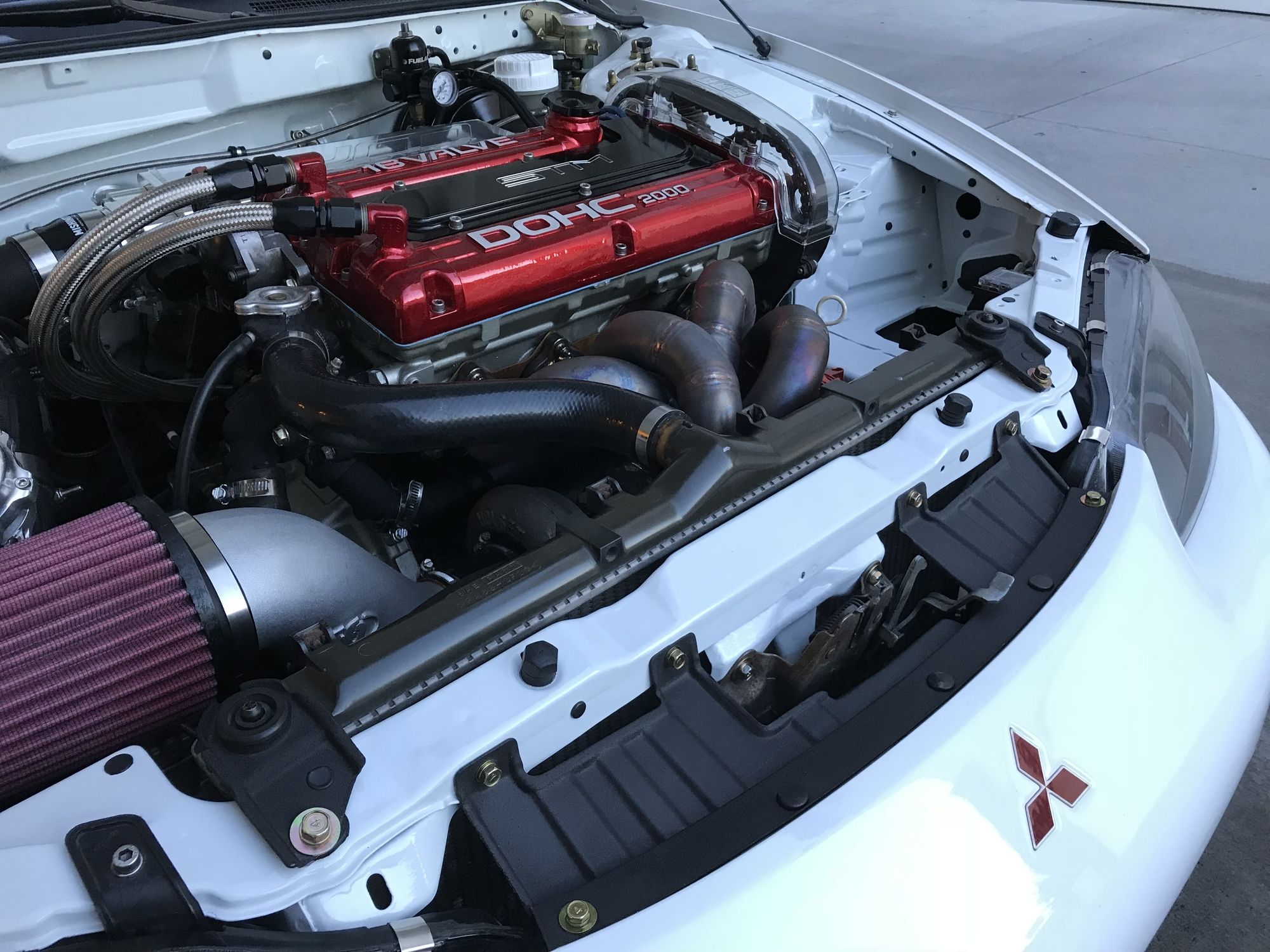

And an engine bay pic with the new VC lines on.

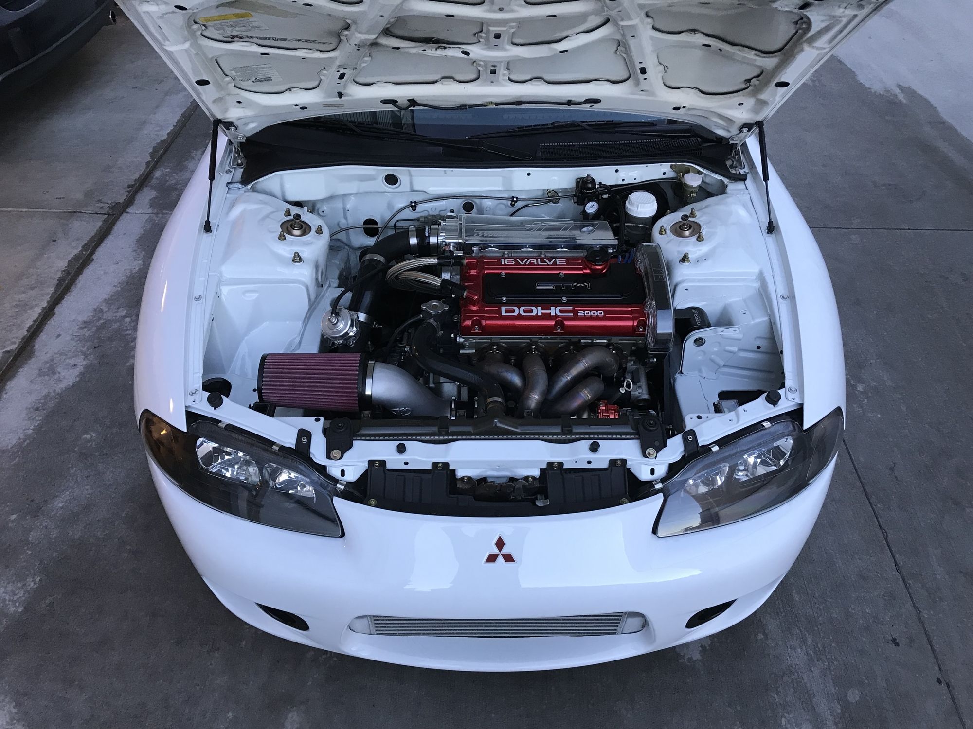

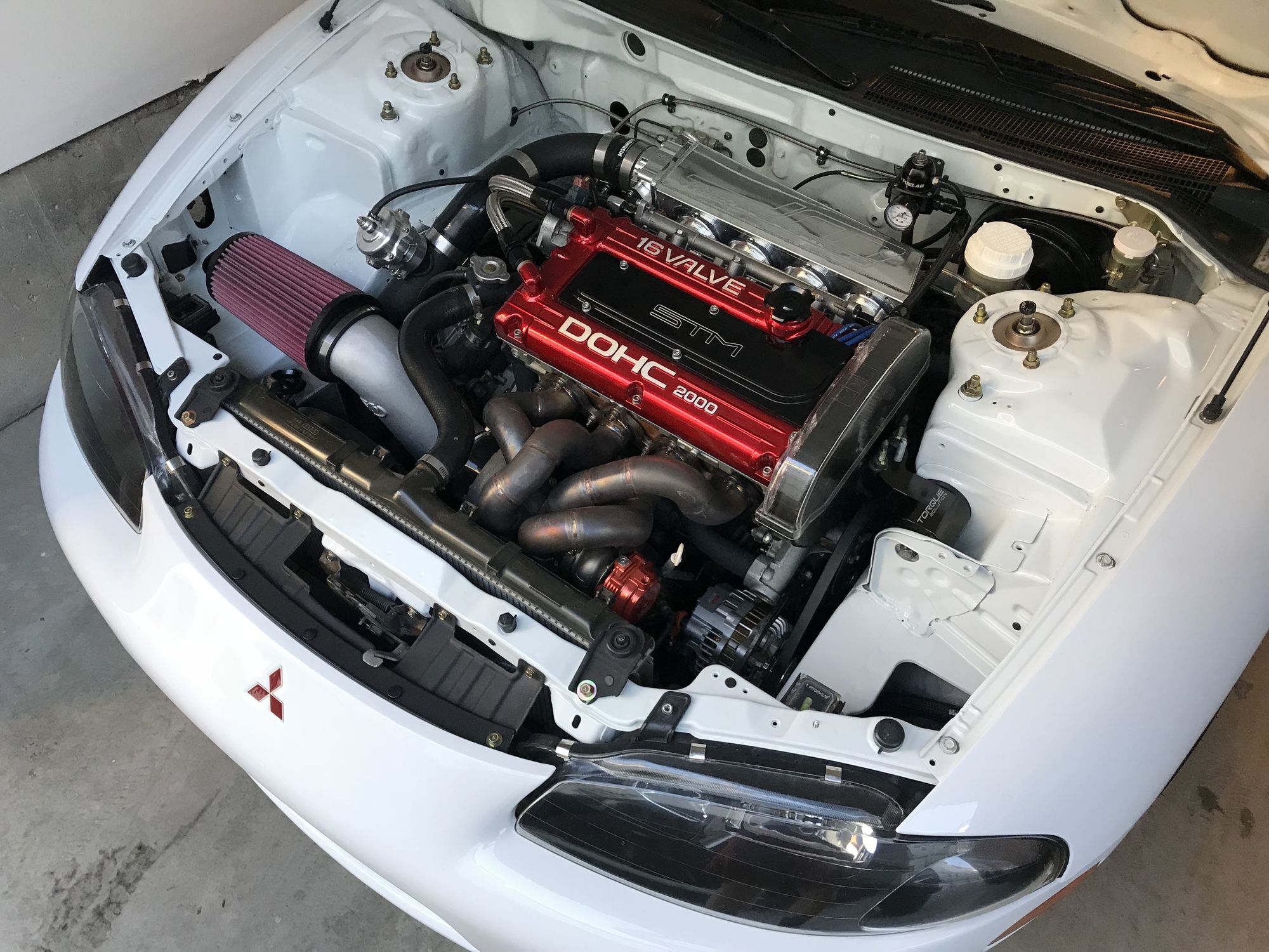

Cleaned the car, getting ready for winter storage. Its nice being able to detail the bay easily and quickly. I never used to be able to since I was dailying the car. Now I can clean it and it will stay clean since I don't have to drive in the rain!
Pic time!

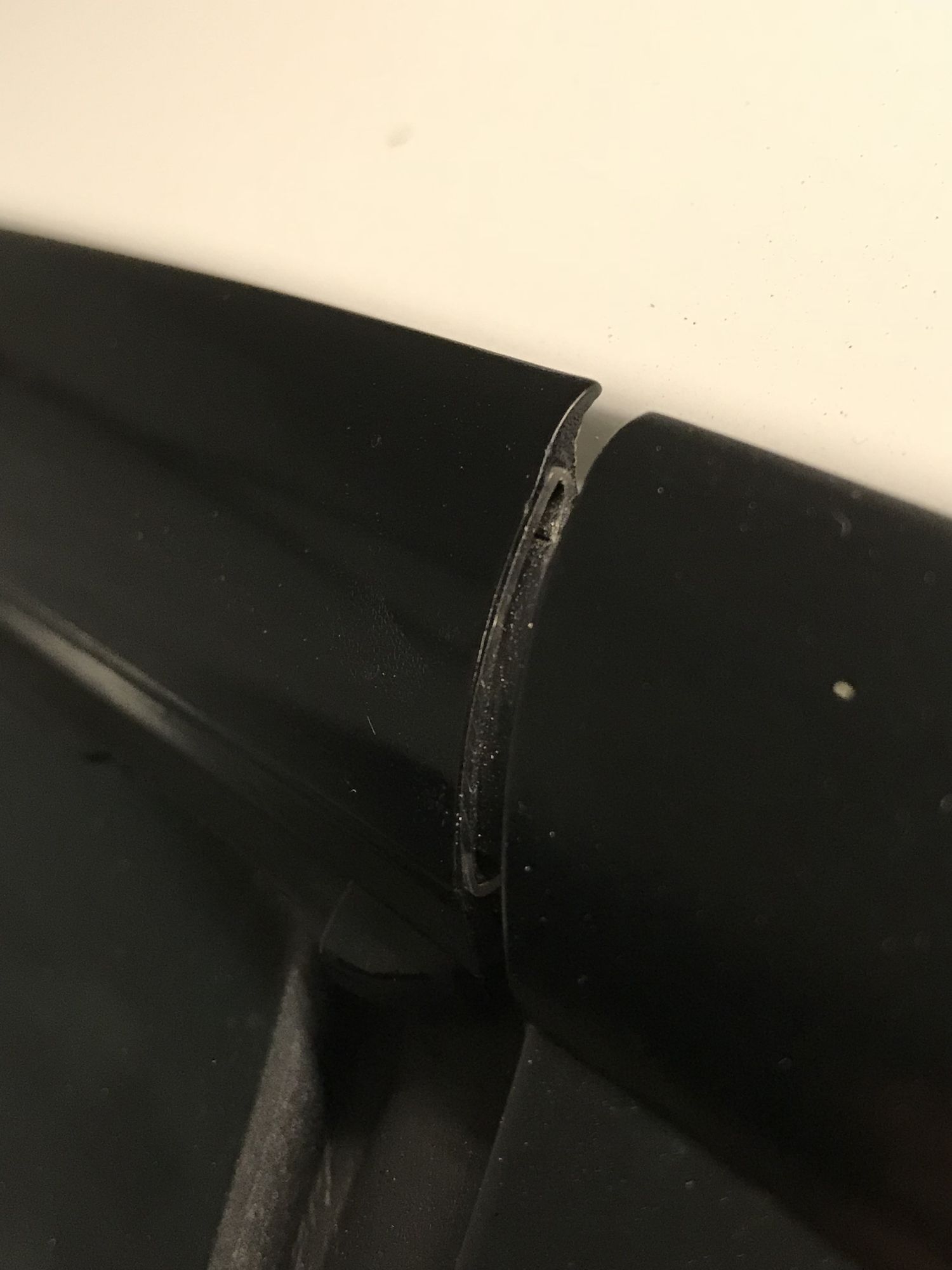

I have entertained the idea of somehow remanufacturing the drip rails. They are overmolded metal, meaning metal was in a mold, with rubber injected around it. I've been thinking that I could create a mold of some sort and remake them. We will see.
Here is a picture explaining how the drip rails are made. Rubber is molded around a metal frame. note the large "tail" of rubber at the top. This is something you cannot easily achieve by "spraying" the bare metal drip rails with anything.

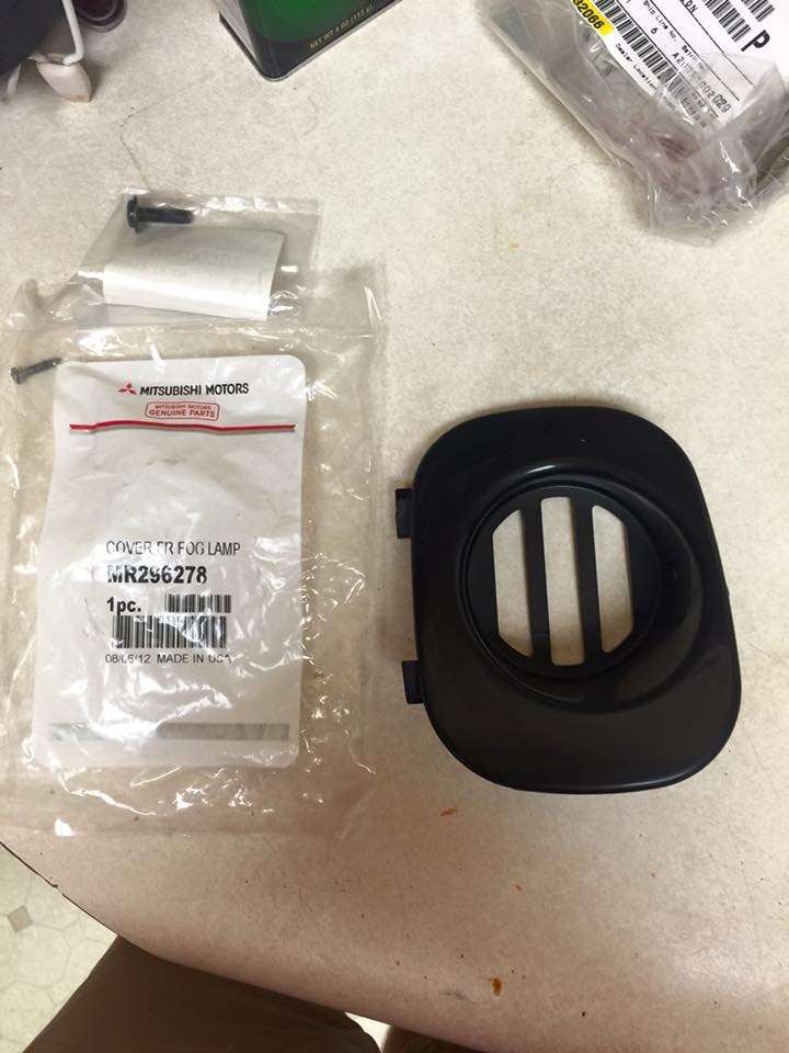

I’m super interested in those fog light deletes. Do you have a picture of them? I found the stock covers for the holes beside the fogs but didn’t know about the fog delete plates. Now I want a set. I don’t care if they’re gray as ash. LOL
The part numbers for both the left and right side “cover air intakes” btw are mr248233 (drivers side) and mr248234(passenger). My goal is to completely shutter off all holes with OEM parts. :)
11139995_10152989310381261_1612899862565106686_n by Brady Dingeldein, on Flickr
This is the one I had to buy because they were all discontinued. I bought this 2 years ago I believe, I had to dremel out the blockoffs since I run fogs.
Yeah I thought about those air intake blockoffs too. Idk If I will run with them though.
