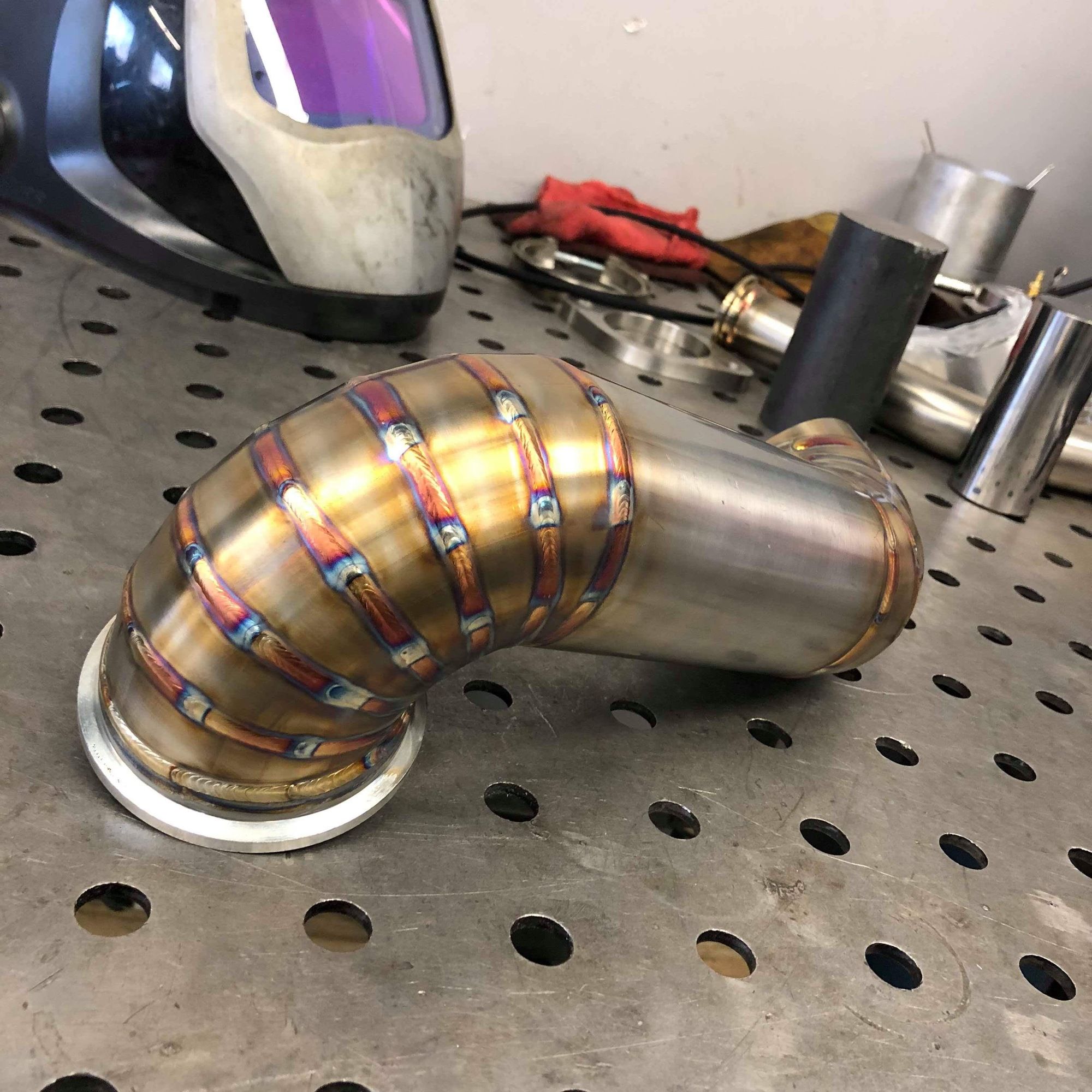

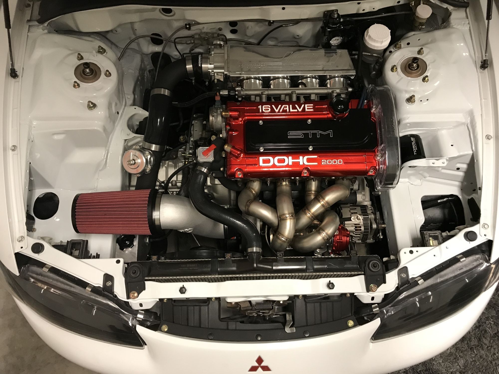

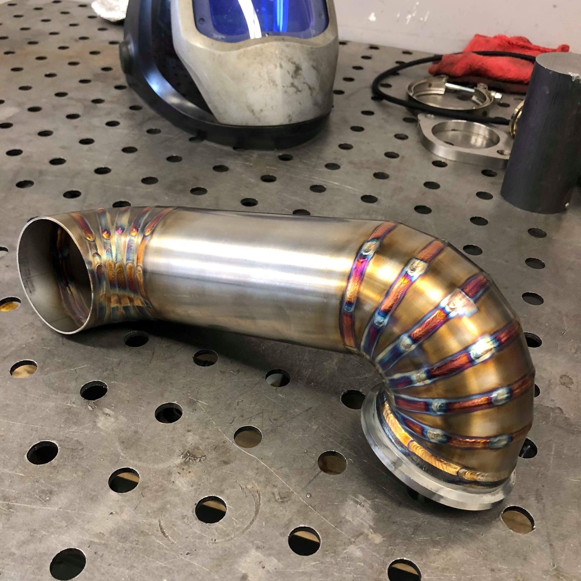

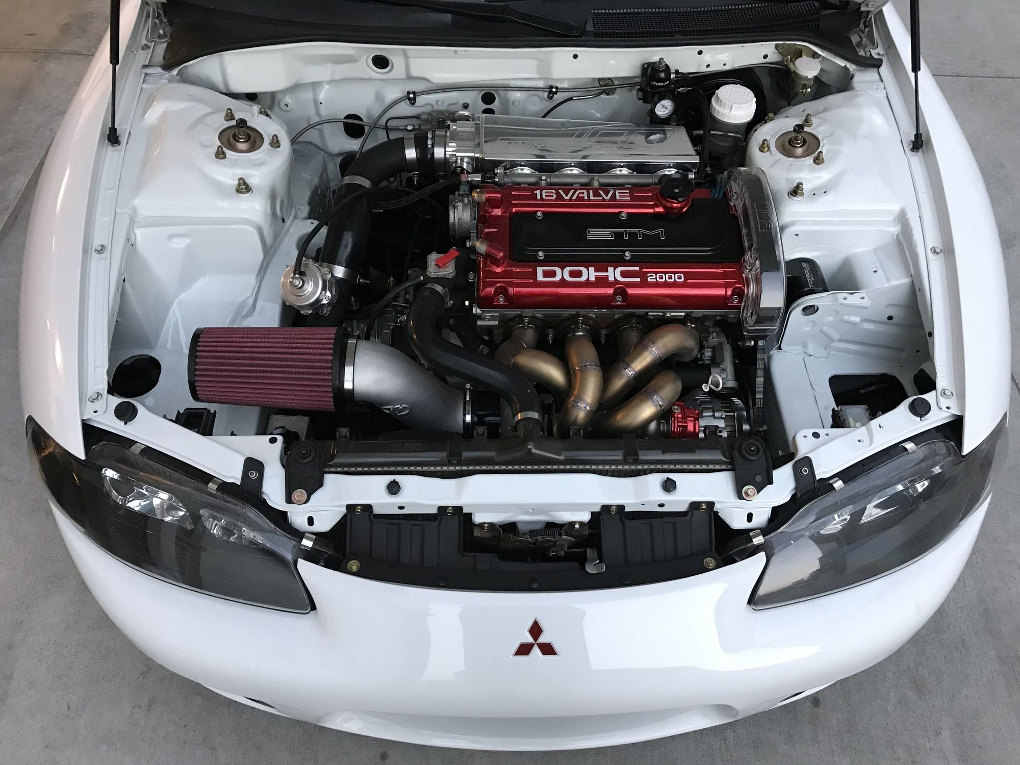

So I got my downpipe fabbed up last Friday and trailered it to my new house. The shop did an excellent job.
They at first told me it would be about 25% more expensive than they quoted me because they didn't know they were "fabbing up basically half of the entire exhaust" which was a little annoying considering they were replacing an off the shelf Apexi downpipe. They said it would be "absurd" to make a downpipe that long in one piece. Oh well, I got it all done out of stainless with no cat/test pipe. On to some pics!

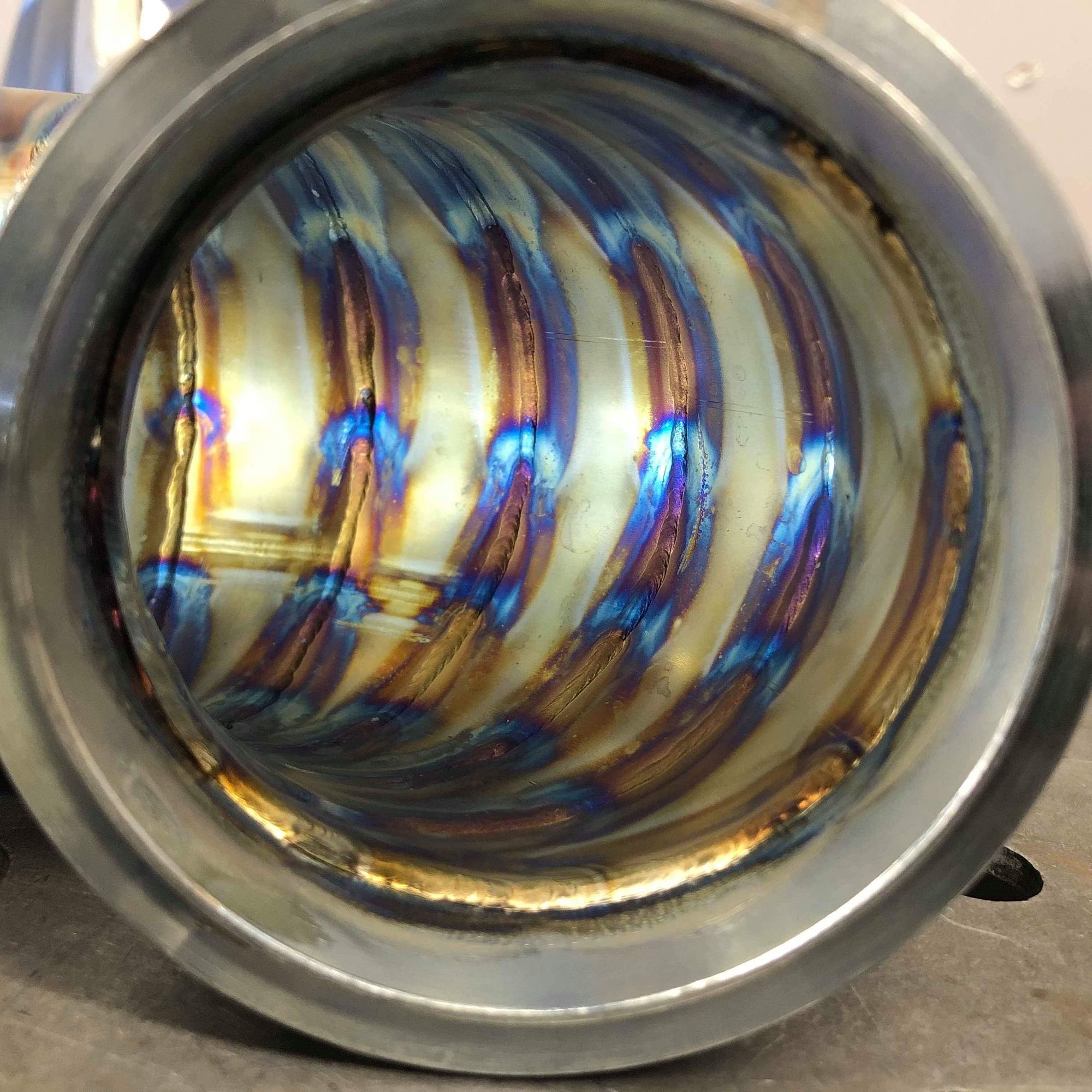

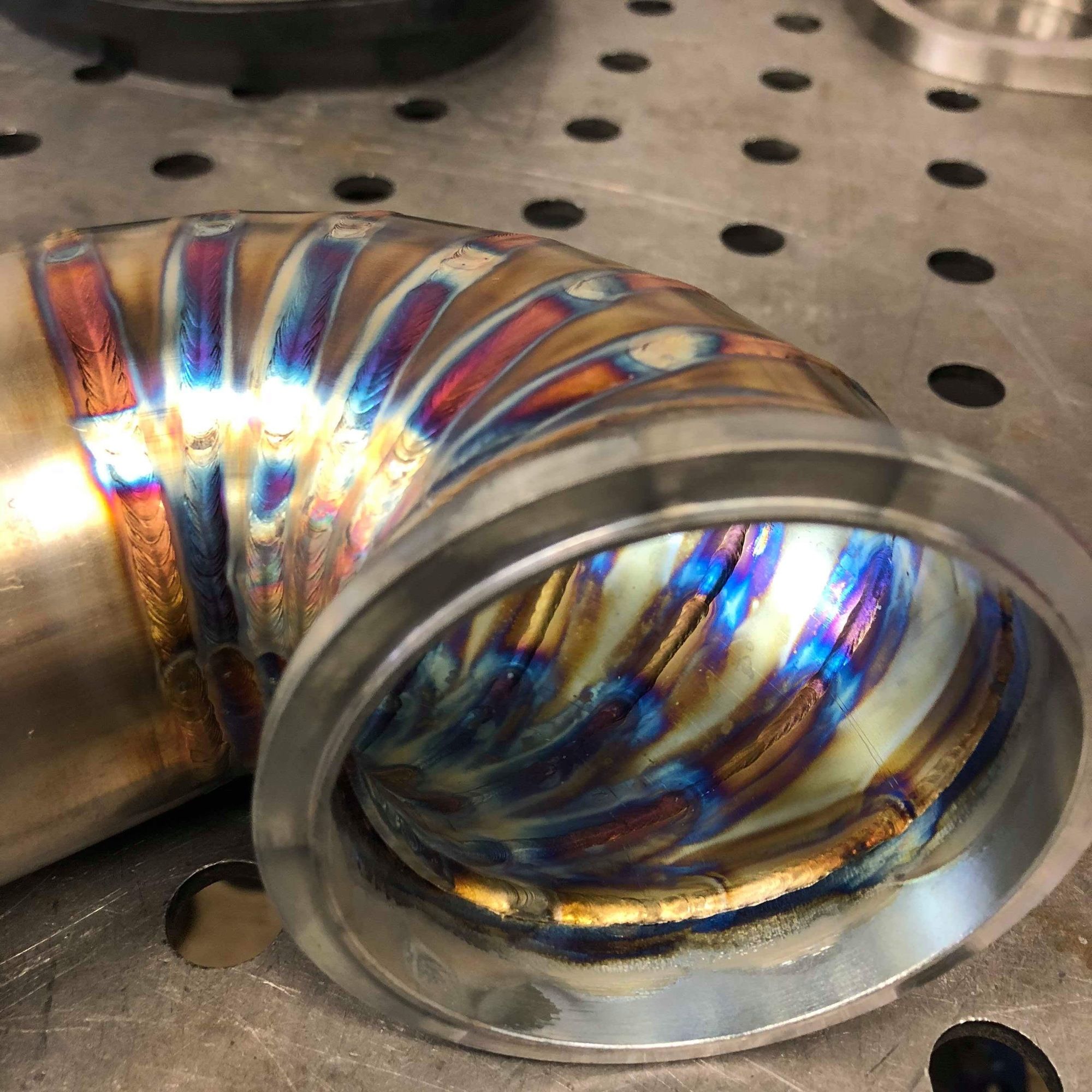

Here it is all done to show how much was actually done.
Here are some welding progress pics, keep in mind this was a one-day turnaround.

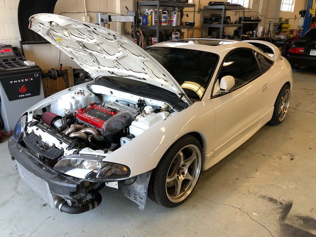

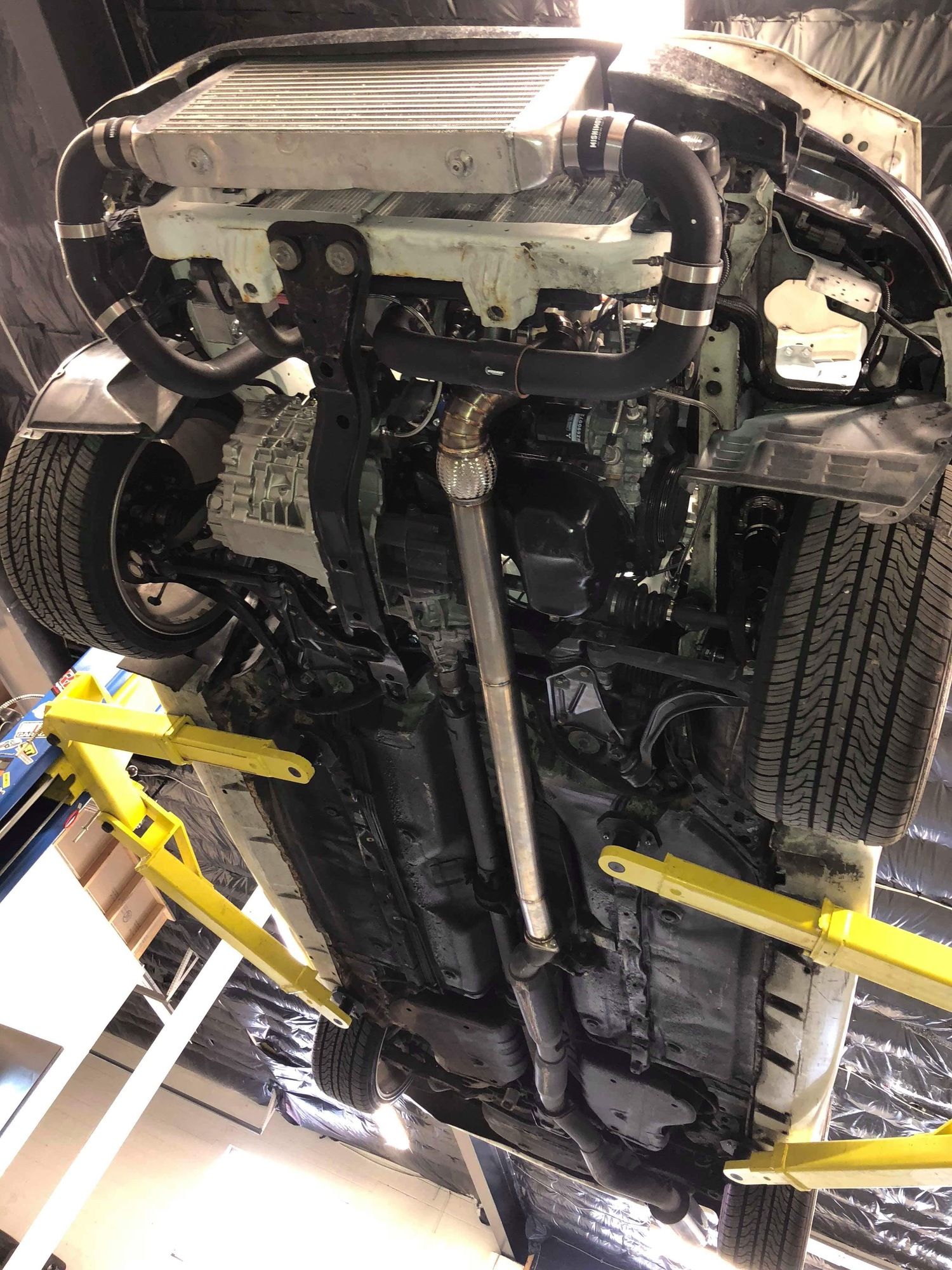

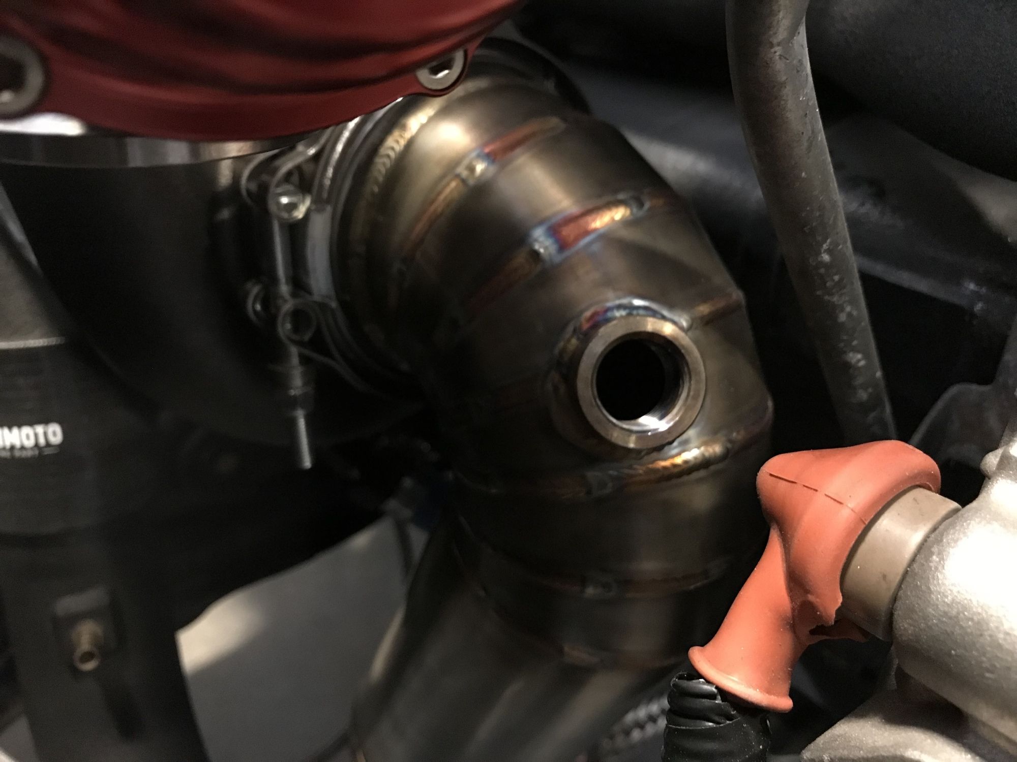

Here is a pic of it installed showing the o2 sensor placement
Then I got it towed home to its permanent spot in my garage.
Just missing the catch can!

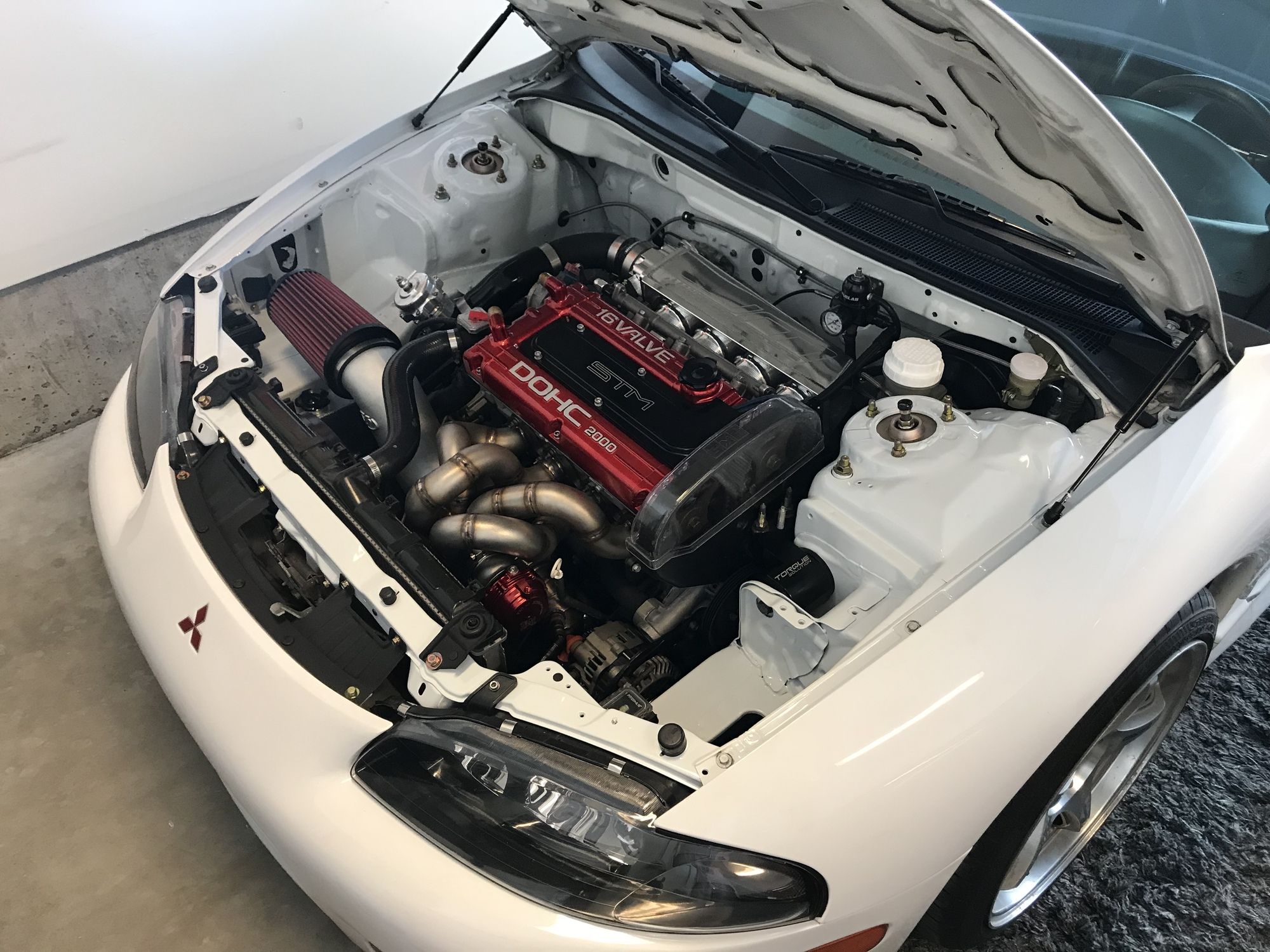

The engine had a horrible whining sound that I was starting to worry that it was some timing components or something rubbing, but the engine was perfect before I pulled it, so I was confused. Turns out the Harmonic Balancer took a dump, I finally replaced it with a Dorman unit, will maybe save up for an OEM unit, but we will see. The whining is completely gone though!
Next up is a horrible squeak which i'm assuming is a vac leak somewhere.. But the intake manifold is completely torqued down, and I really don't have any vac lines except BOV and FPR... So annoying.
I go the car idleing at 800 RPM and its rock solid. Crazy especially because I'm just running a bare TB, no ISC/FIAV.
Oil pressure is looking fantastic, as well as idle AFR.

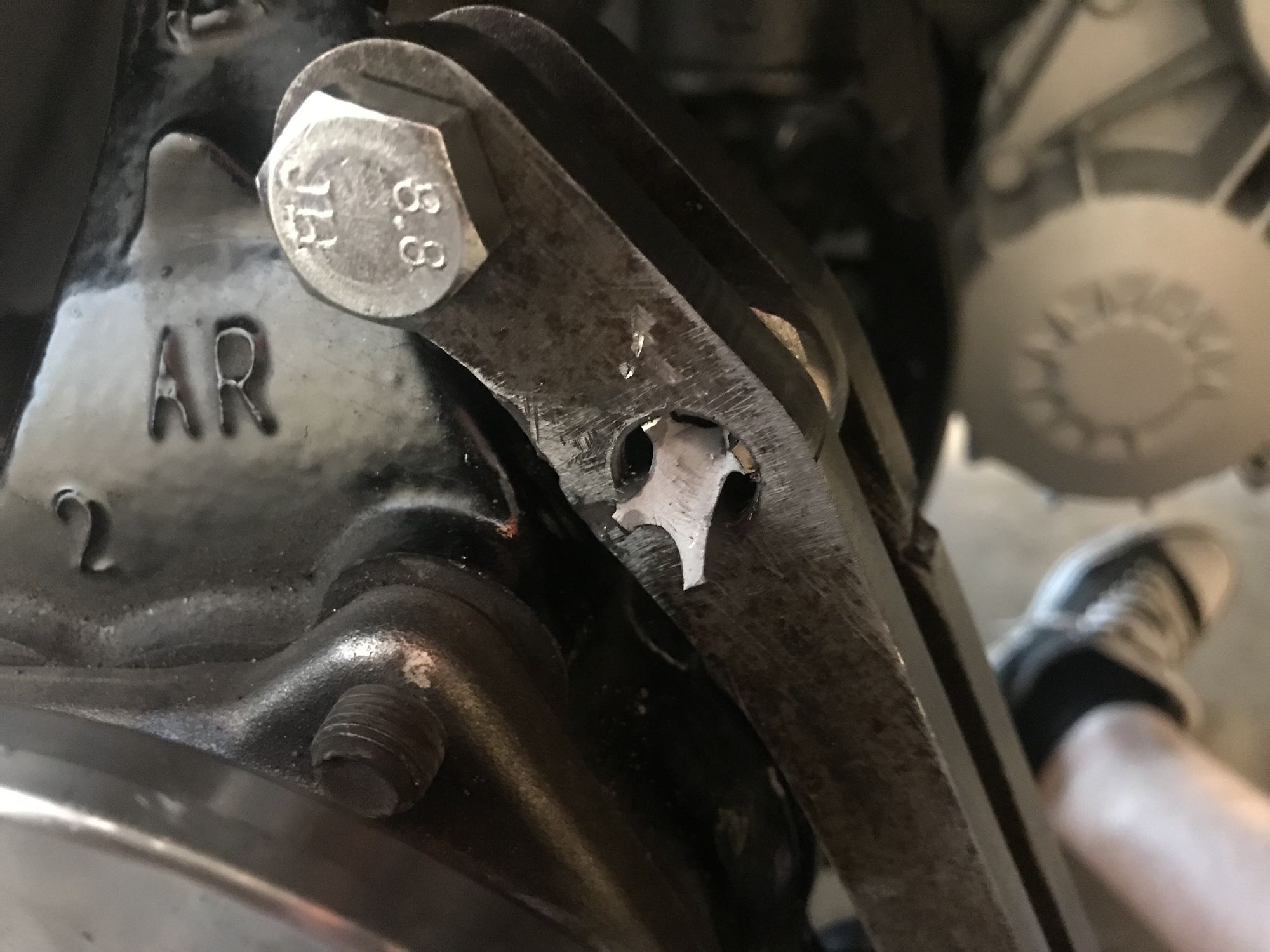

Starting to get annnooyyyeddddddd. All I need to do is install the calipers and bleed the brakes/clutch line. This is the second Matco Tap i've broken. The first one, the guy said hed have it to me in two days, well it took him 3 weeks. I kept saying to myself "I'll just buy another one online or something" but then I would talk myself out of it by saying "well, the matco tap will probably be here tomorrow anyway, i'll just wait"
Took three weeks....
Well that one just broke on me. I have the brackets tapped and used them as alignment in this picture. I've tapped DSMs before for brembos, I swear i'm going perfectly straight, coming out and then back in slowly, repeat, using lube etc. I ordered one on amazon instantly when I broke this one. I just want to take this for a drive already!

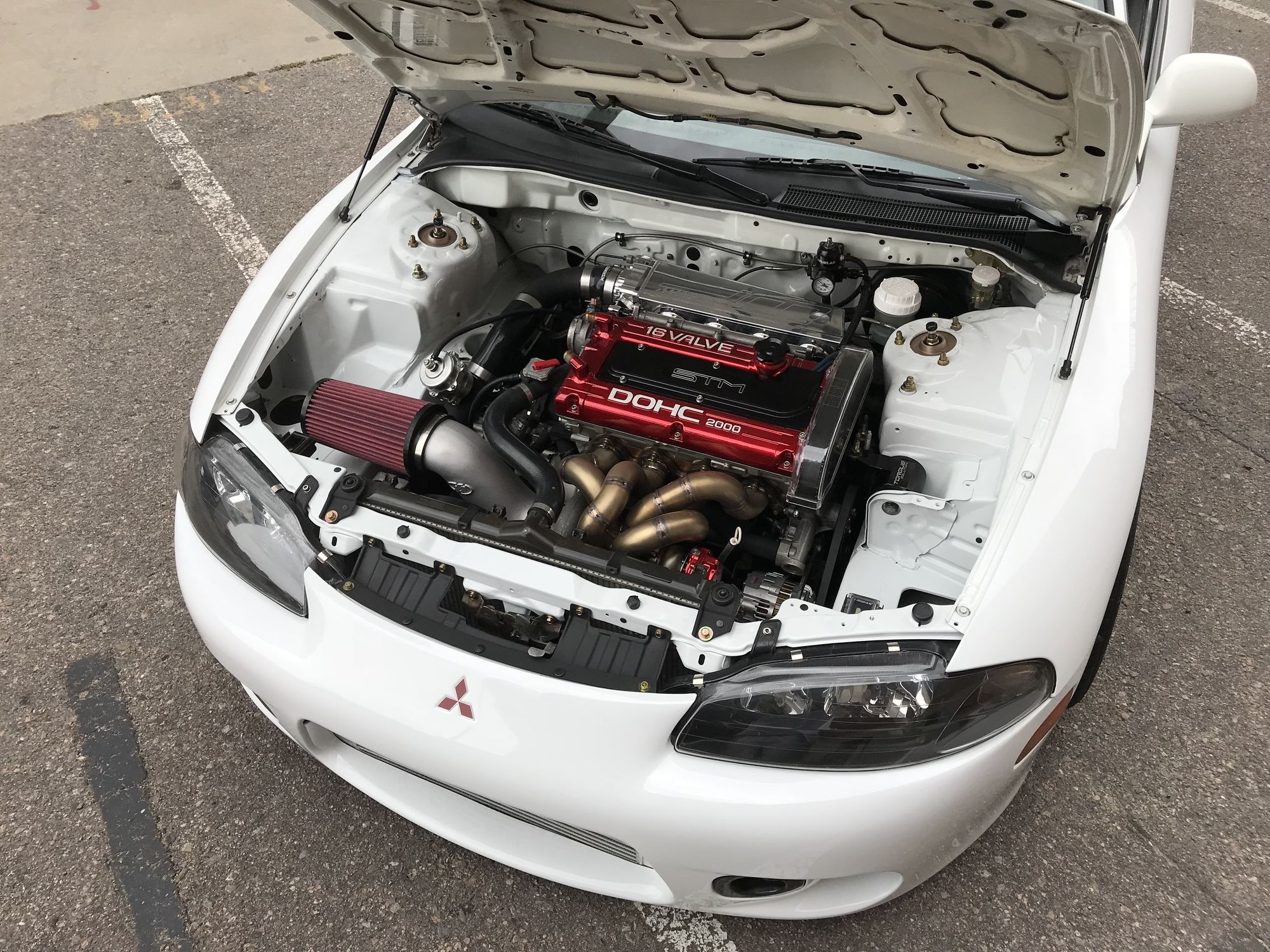

I took it for a drive after the brakes were bled and got about 50 miles on it paying close attention to the gauges/engine bay checking for leaks etc.
The plug on my water pipe has a pinhole leak, super annoying. So that will eventually have to come off. I have a coupler wrapped around the pipe and clamped down tight to avoid leaks for now.
I also have a tinnyy exhaust leak on the top right corner of the exhaust manifold. This is due to the Punishment Manifold not allowing you to get a socket on the farthest Stud in the head, I'm going to have to figure something out, I have the ARP studs that use a 12 point nut, I'll have to switch this to a regular hex nut. It just involves pulling the entire manifold off a little from the head so I can get the 12 point ARP nut off the stud, there is zero clearance between the stud and the manifold as it is now.
I have a small oil leak coming from the OFH, I think its just a loose fitting.

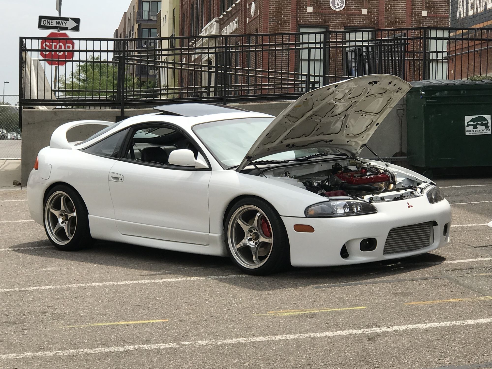

Now this brings me to the maiden voyage....
I had about 50 miles on the car, (keep in mind I had a full new tank of gas and fuel system cleaner in the tank) I was coming up a small hill and the car completely shut off fuel. It just stalled out on me basically. I had to pull over quickly into a half construction zone/half shitty old brick building parking lot.
Untitled by Brady Dingeldein, on Flickr
I thought maybe something came loose etc etc. I reset the computer, checked all plugs, TPS, CAS, IAT, plug wires, coil pack, all ignition related items. Nothing.
The car would crank and start over for 3 seconds then die, pressing the gas killed the engine.
I then thought the fuel cleaner gunked up the filter, so I changed that, nothing. Then I swapped out the CAS with another I had, nothing. Then I drove back home to grab a spare TPS and coolant sensor switch.
When I got back to my car, the parking lot was full, and an old lady (owner of the building) was charging $30 per spot for Rockies Baseball parking....
I told her I left a sign on the car saying I would tow it if need be, and to call me. She didn't see the sign, and called her tow company that charges 400 a tow.
I quickly told her that I would pay the cancellation fee ($50) and would pay for a parking spot ($30) so I would not be stressed about leaving my car downtown in a sketchy alley.
I pretty much spent my whole day messing with the car and called it a day, she said I could come back in the morning.
I showed up at 7AM and got to thinking.. I replaced the plugs and saw they were completely fouled out. So I know the injectors are WORKING and since the car started up for a second the ignition/compression was there. I knew this was going to be something STUPID. I have had 2 OMNI Power MAP sensors break on me, I unplugged the sensor and plugged it back in and it started right up.... Oh well, I'll probably end up getting a spare just to have in the car. I don't understand how these keep breaking. Do I need to remote mount it instead of having it on the intake manifold?
Anyways I got it home. This thing spools up and takes off like a jet at 4k rpm, I'm on 10PSI (wg pressure) right now until I iron out the kinks.

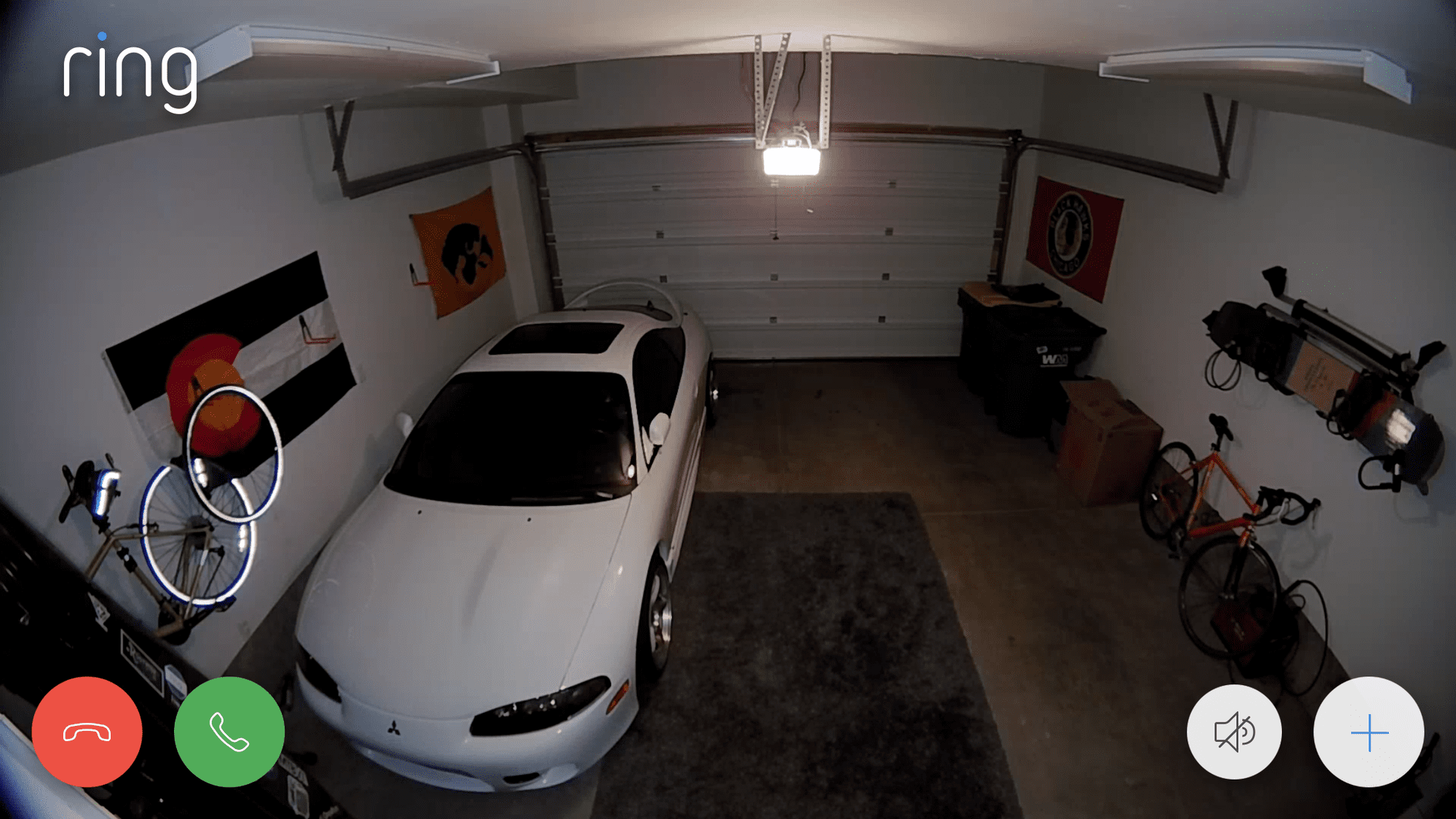

I also got a new security camera in the garage.
