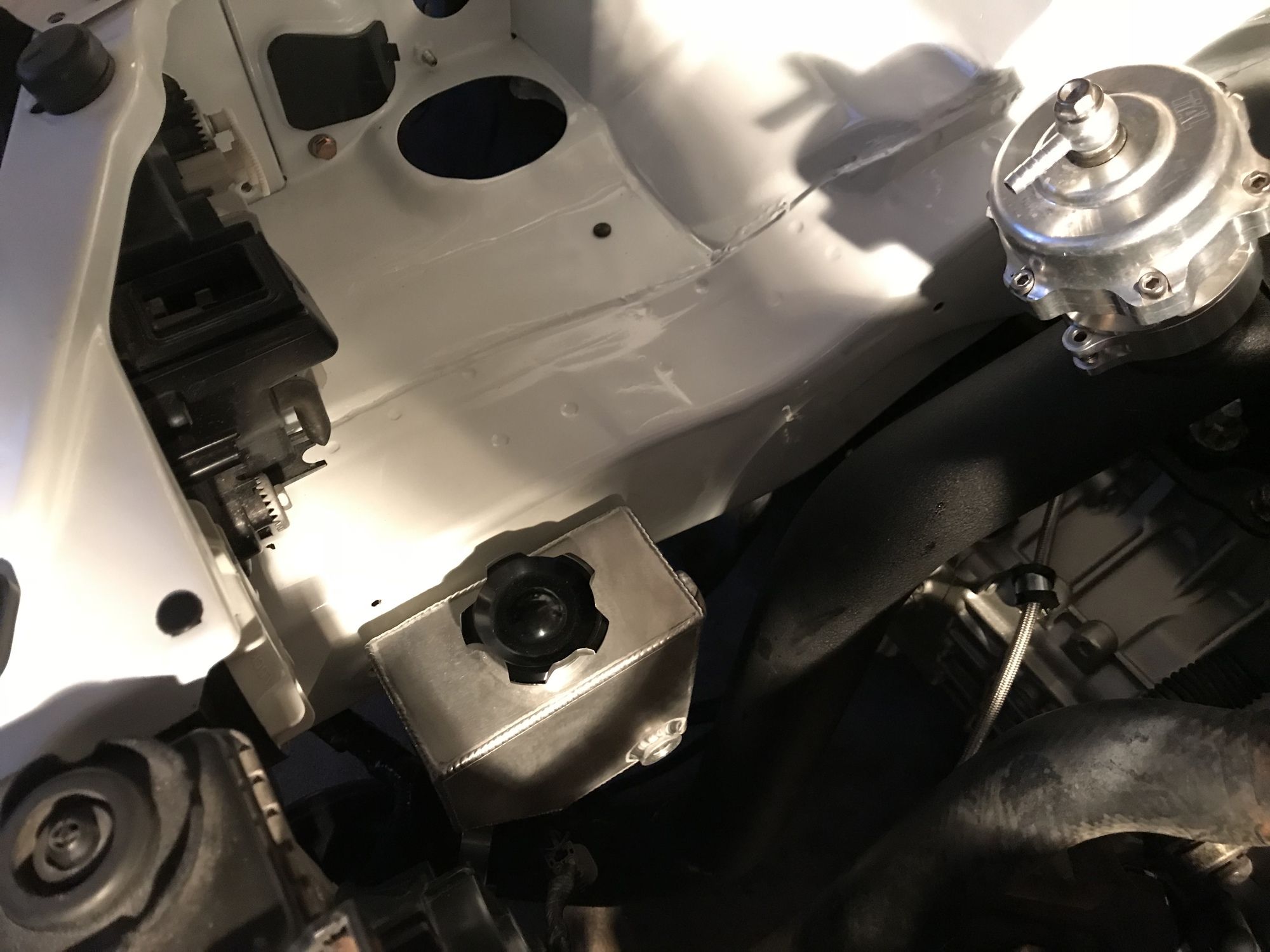

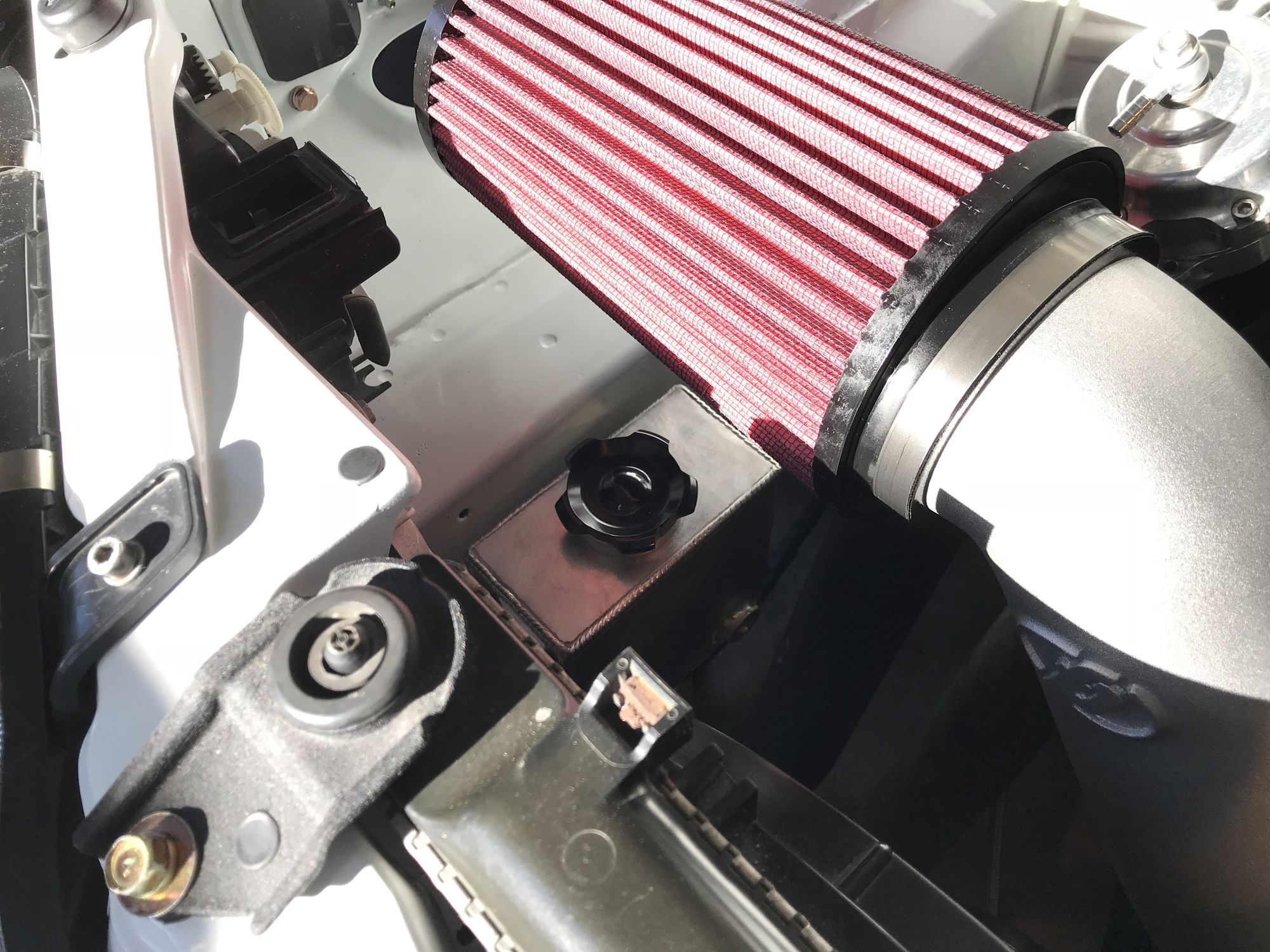

I wanted to wrap up my coolant overflow tank and get that all mocked up so I can polish it and then install it for good.
For anyone wondering, its a gamble overflow. I had him use the same vibrant cap on my valve cover so it would match, instead of the cap he uses.
I also had him not install the bracket, and had my own welded on that mounts it on the lower end of the frame rail, instead of the top. Works great.

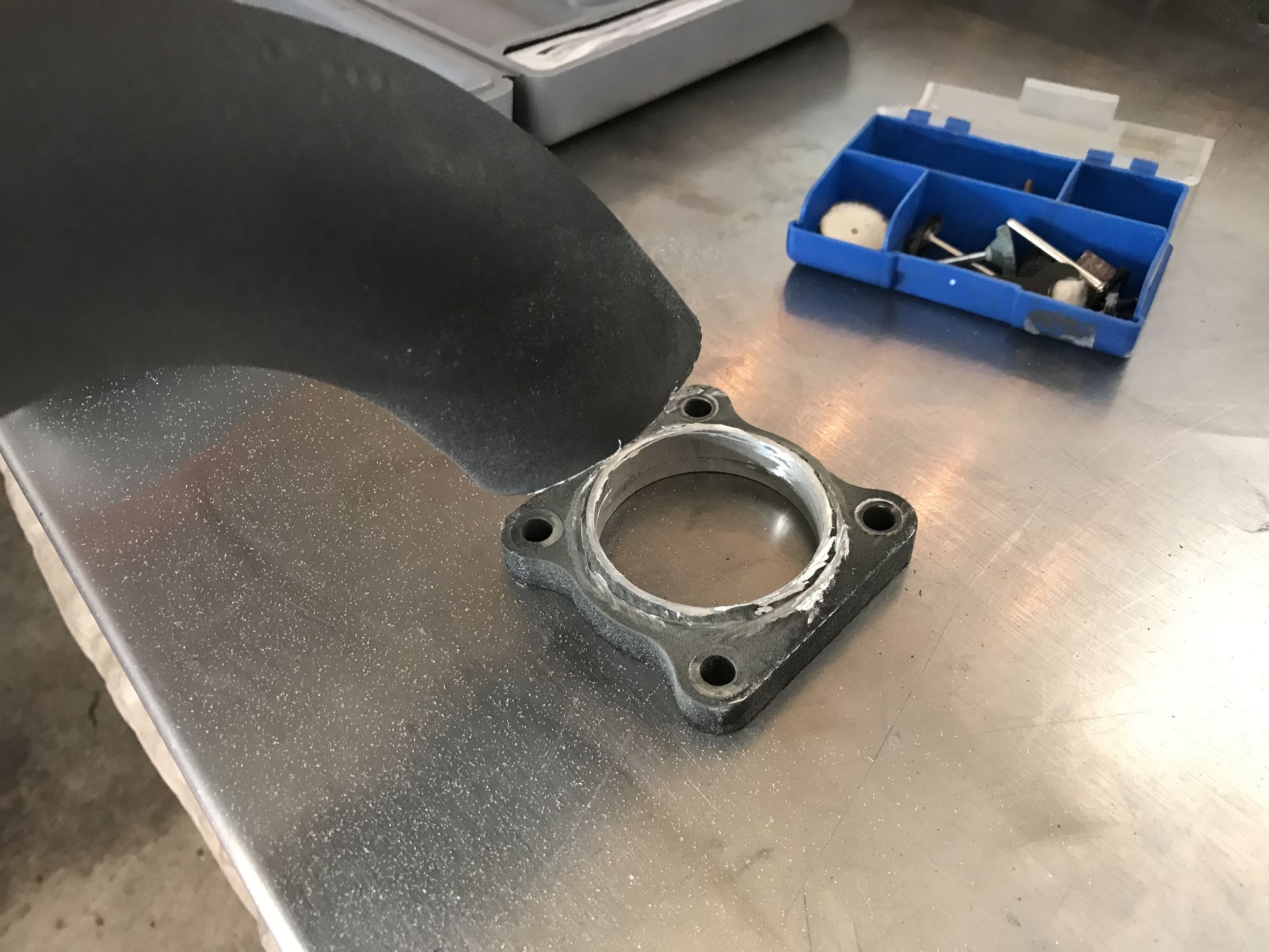

Next up was the TB IC pipe, I had to hack off the flange to fit the coupler on.
So that wraps up the IC piping, coolant overflow.

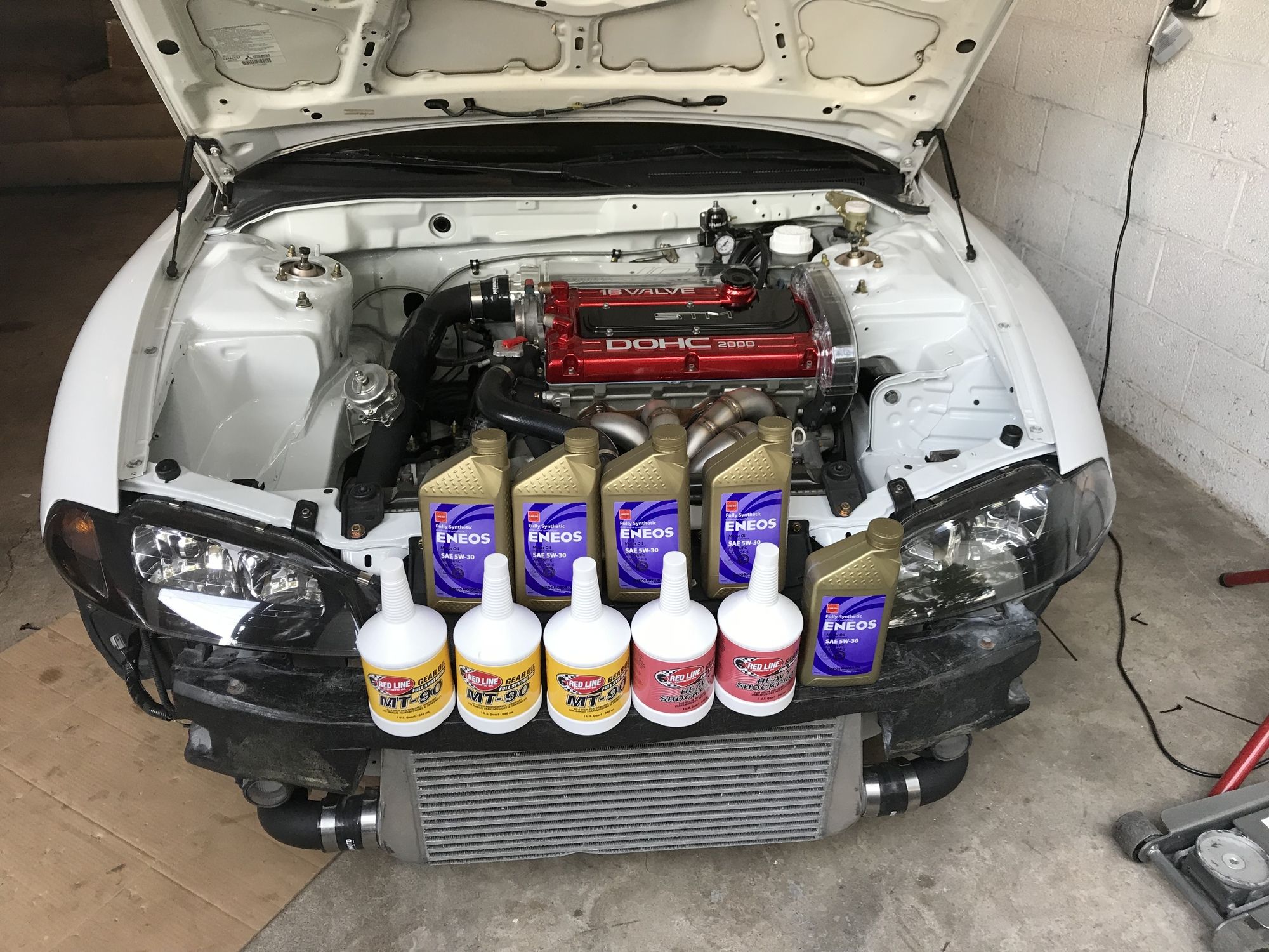

Next up was fluids! I did this veryyy slowly to make sure I wasn't leaking. I've dumped $80 worth of ATF in a car only to realise the axle wasn't in... Wont make that mistake again. But no leaks! Oil/tranny/xfer case/rear diff oil changed.
I'm going to get some vac lines and coolant hose to run to the overflow can, and then install my fuel rail and see if we can't get this thing turned over.

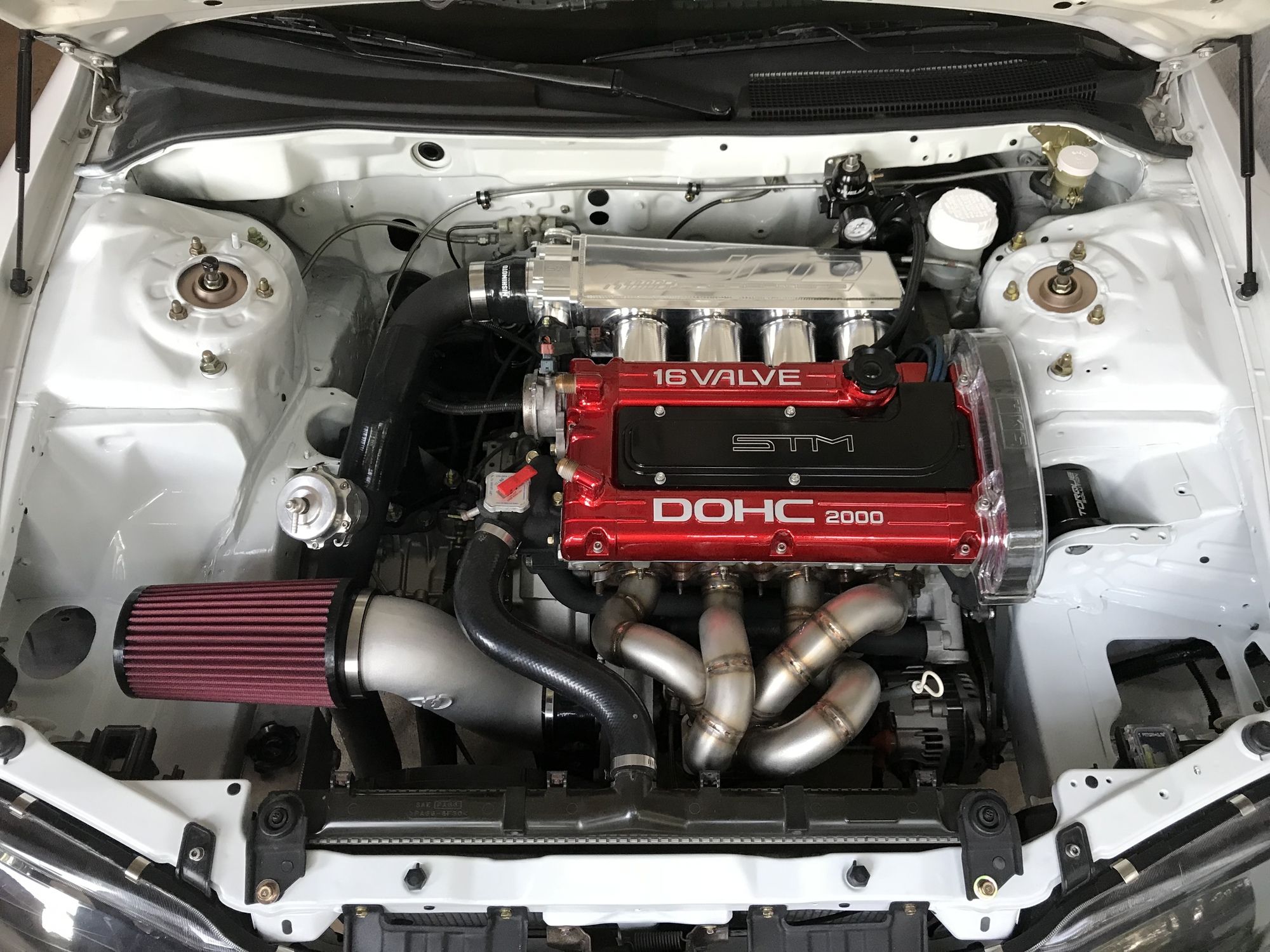

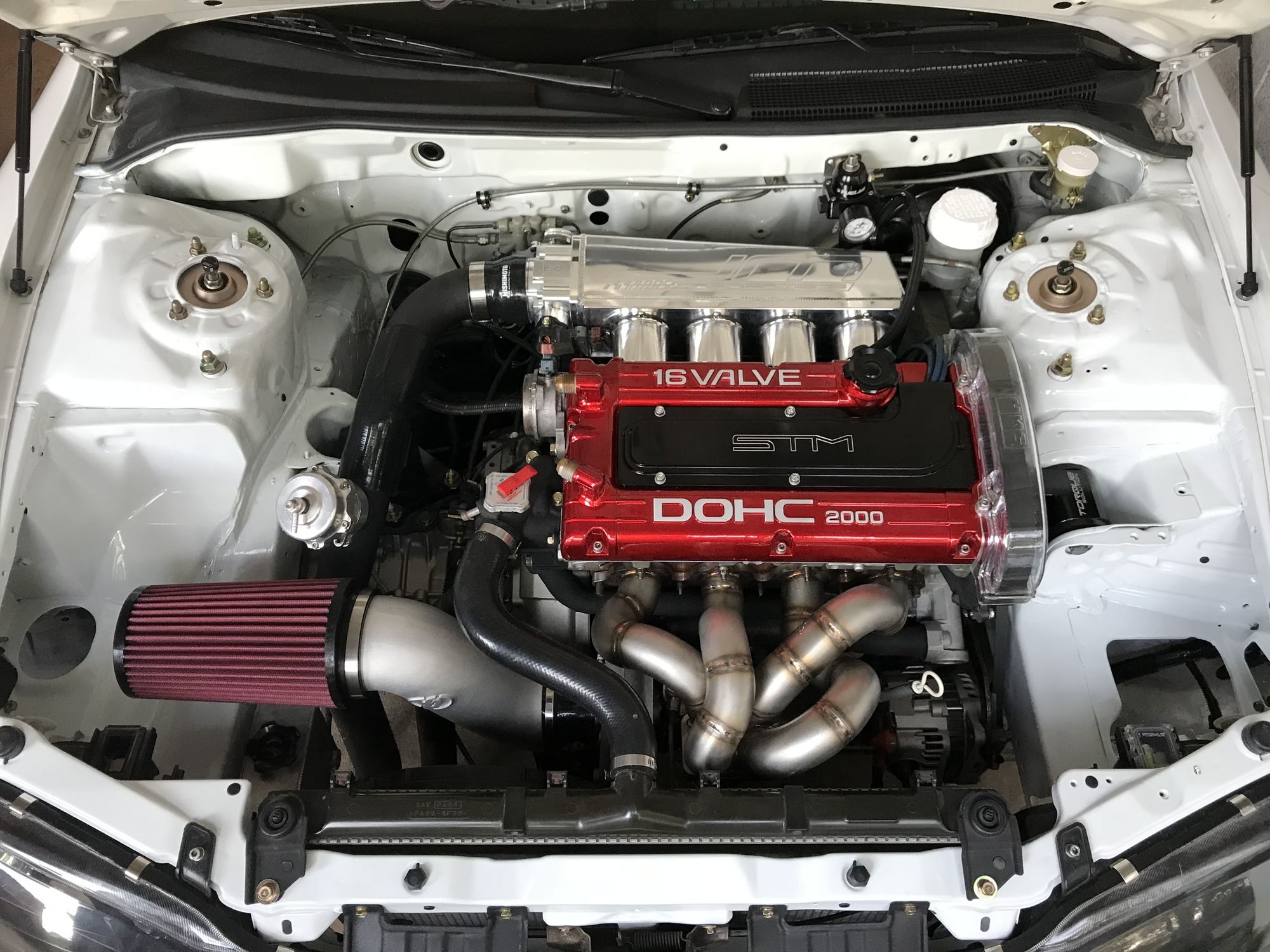

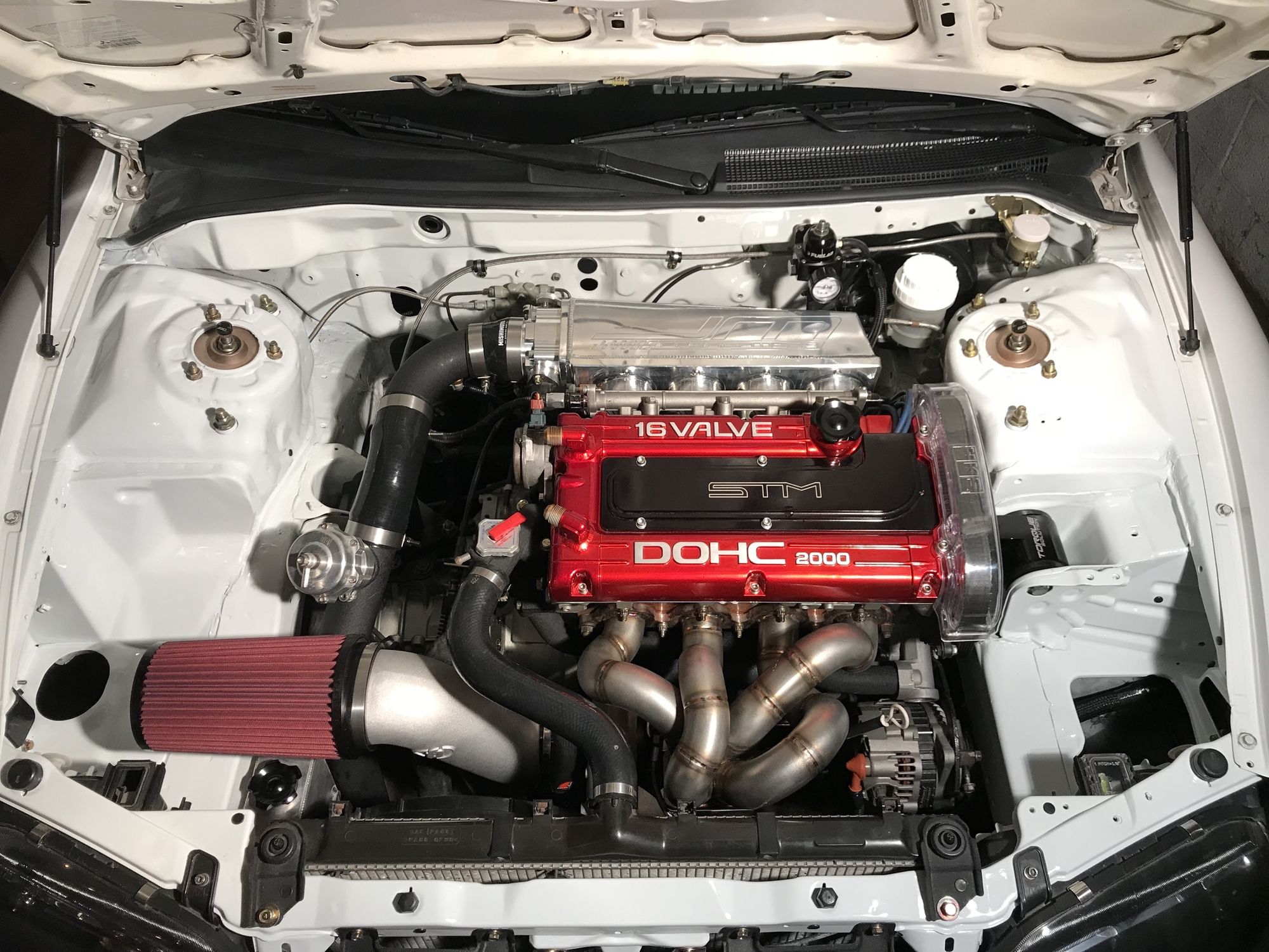

The bay is pretty much finished. This is how it will look, minus the catch can setup. But the catch can setup can wait a bit. I don't get any blow-by anyway.
Untitled by Brady Dingeldein, on Flickr
I'm pumped to get this thing on the road again, found out my car insurance will be basically nothing on top of my jeep insurance, so that was a relief.

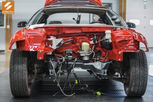

I think it was SIM that had a really cool setup, GT3 RS res/pump that was setup on the sub frame.
https://www.dsmtuners.com/threads/strictlys-2g-ff-street-build-part-2.515782/#post-153677575
Yeah they did a bang up job thats for sure! I don't really care too much, I don't race it or anything, just cruise around. I could always do an e-pump setup in the future, just dont care right now. I'll definitely report back on the feeling of the manual rack
I just started on the wiring. I have to say whoever designed the harness is an idiot. Plugs on the divers side ground to the passenger and vise versa. Wires that loop back on themselves but the loops are twenty feet long. This is going to take awhile.
