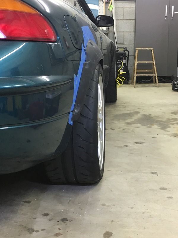

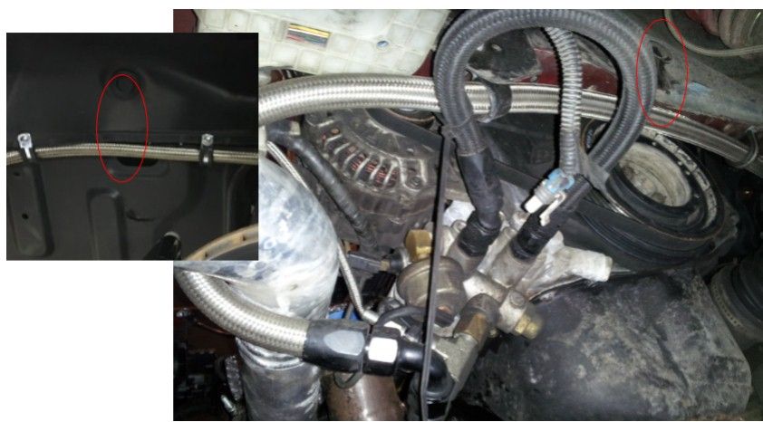

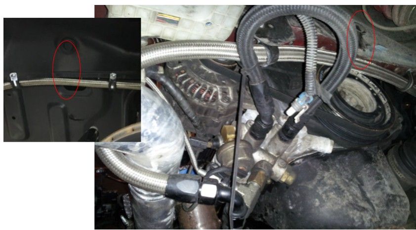

Check for tire clearance on your accusump line. I've circled the tire rub on my car. I think that mark is from over a decade ago, running a 235/40/17 BFG race tire on the stock 17x6.5 (with a .25" spacer), actually cut a 3" long flap into the inside shoulder as I spun out at full lock. Or maybe it was some other time. I obviously clean my wheel wells less often than you do :p
Check for tire clearance on your accusump line. I've circled the tire rub on my car. I think that mark is from over a decade ago, running a 235/40/17 BFG race tire on the stock 17x6.5 (with a .25" spacer), actually cut a 3" long flap into the inside shoulder as I spun out at full lock. Or maybe it was some other time. I obviously clean my wheel wells less often than you do :pView attachment 324692
You spin out??? Lol
Good call on that. The hose sits under the frame rail at that point, but i'll be double checking for sure.

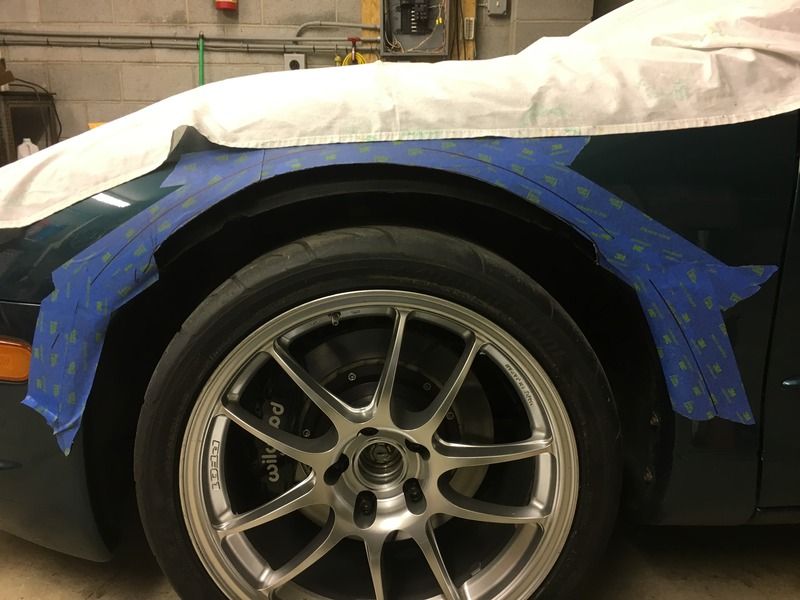

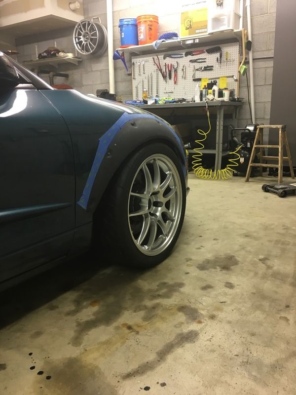

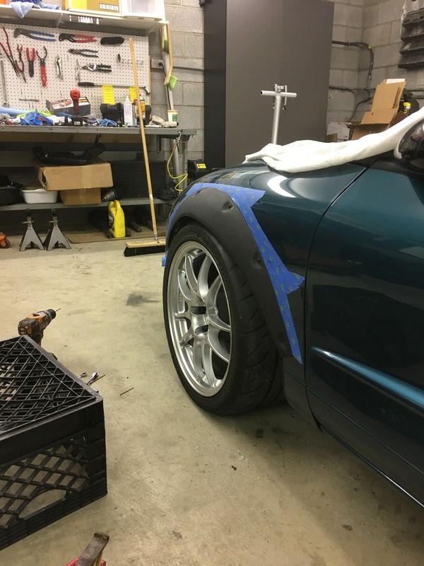

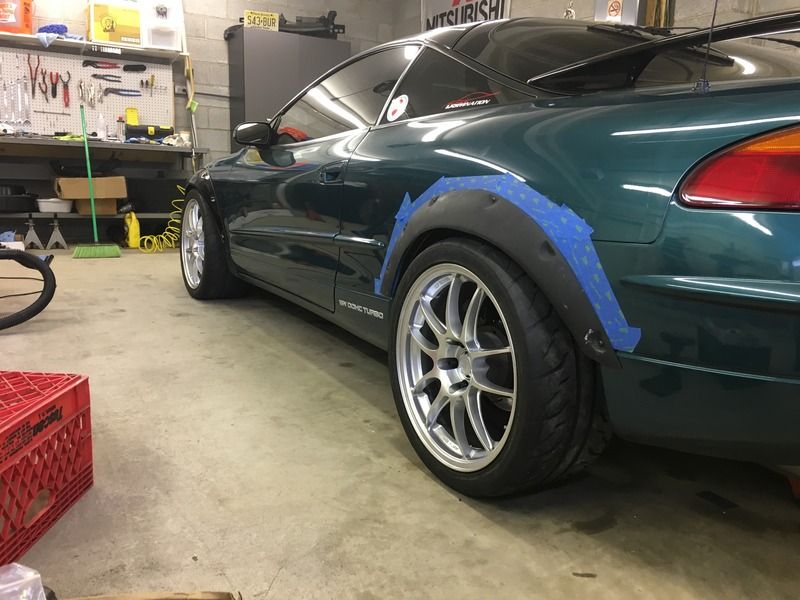

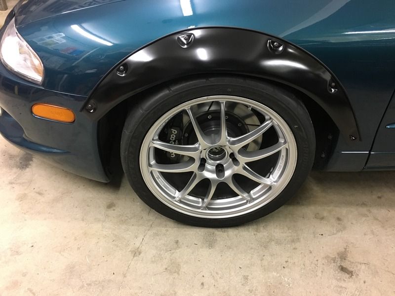

I was extremely undecided when I first mocked up the flares. I wasn't sure if I liked the look and I really wasn't sure if I wanted to cut up my car to get this to work. Well, the primary job is for it to autocross and do it quickly. I NEED to go with wider/stickier tires. So, its either cut and leave things exposed or throw some flares on and make it look presentable. I have no interest in making this car look hacked up so flares it is.
I've only finished this corner, but its a start and it came out great I think.
Made my cut on the line I drew one inch below where the top of the flare will sit. Angle grinder with a 3 inch cutting wheel zipped right through it.

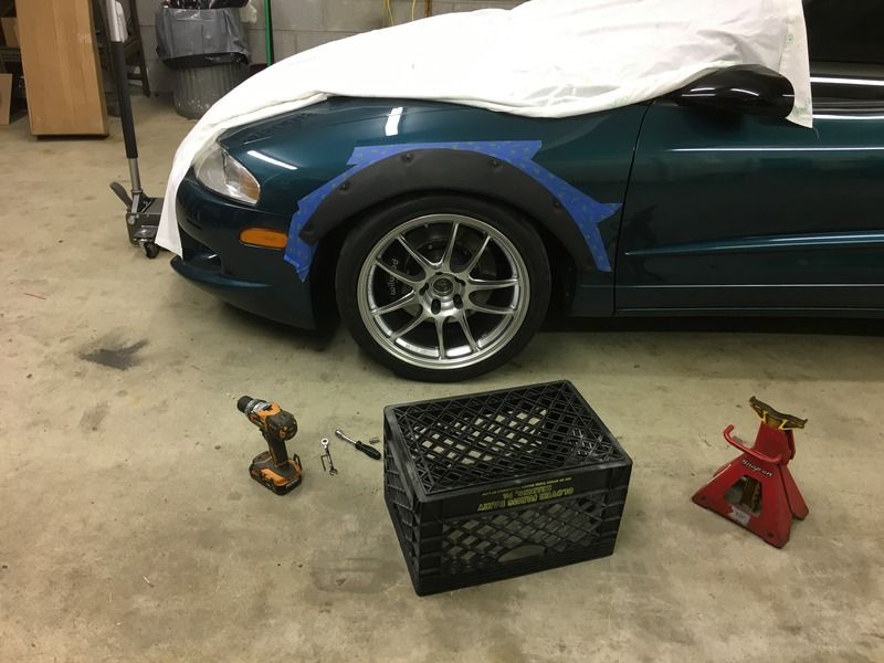

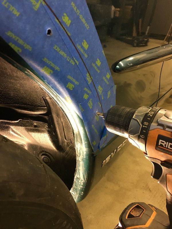

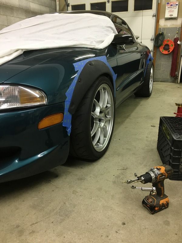

Used tape again to mock up the flare while I drilled through. I'll be using black oxide coated nuts/washers with nyloc SS nuts to mount to the body. Drilling the first hole was the most difficult as your relying on painters tape and one free hand to hold everything straight. The rest were much easier to get done.
I'll be installing the passenger side front tomorrow night followed by the rears later this week. Goal is to get the car to the alignment shop by Saturday or Sunday.

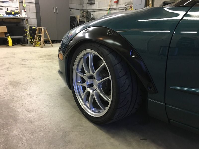

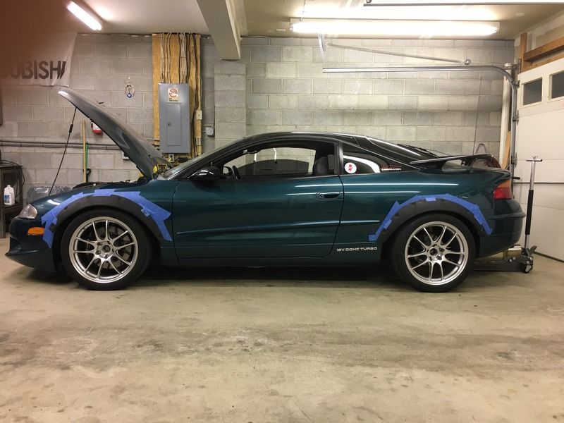

Also you'll notice in the pictures that my street tires are now mounted to the wheels. BFG R1 slicks off and 285/30/18 Bridgestone RE71R's are on.
Damn, I like that a lot and it doesn't seem very difficult at all...So basically you just drill holes and pass a bolt through with a nut on the other side? What brand flares are they?
Correct. The most difficult part is setting your ride height with room to spare so you don't destroy your tires/fenders. I pointed my gopro on the wheels and went for a spirited drive. This was the last point of measurement for me. Front's were fine. Rear's need a tad bit more room. I'm going to raise the whole car 1/8th inch. Increasing the rear spring rate would do the trick, but I don't want to do that just yet. I want to get a feel for the car with the new bushings first before changing rates again.
The flares are carbonetics. As far as I know, they are the only ones available at this time. I'm not thoroughly impressed with these, but for $300, I'm not going to complain.
Productive night tonight. 3 weeks until the first event so I'm in a little bit of a rush. Would like to be done with a week to spare in order to drive the car around a bit and really make sure everything is good to go. Luckily, we've been having some really warm weather in the northeast the last 2 weeks and I've certainly been taking advantage.

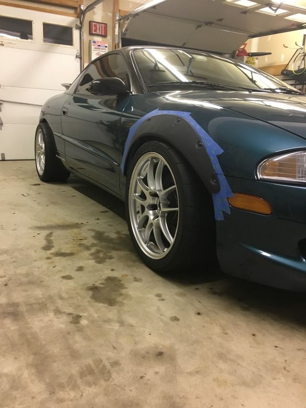

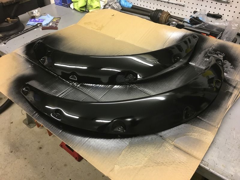

With that being said... I got the passenger side flare on tonight. It was a bit of a disappointment when I noticed that the passenger flare was not a mirror image of the driver side. Its a hair shorter in total width. After some measuring, mocking, more measuring, move a little here, and little lower there, I think I got it as perfect to the driver side as I could.

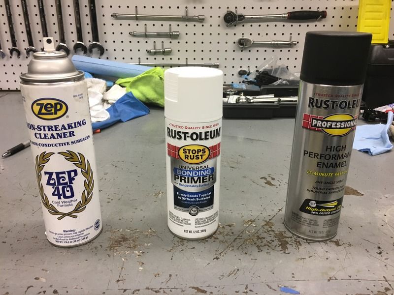

Once both front flares were on, I pulled them right off. LOL Cleaned them up with Zepp 40 non-streaking spray followed by two coats of primer and 4 coats of spray paint.
Here is what I used.
Came out pretty good I think, for some rattle can paint.

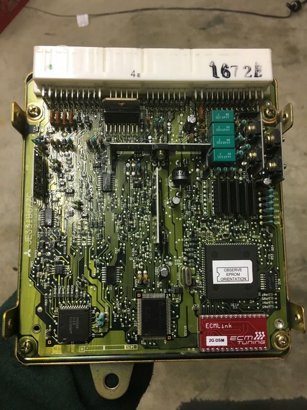

On another exciting note... I picked up ECMlink V3 with OMNI 4 bar map sensor and GM AIT for a pretty good price. You never know what you'll find on FB as long as you're looking every single day. haha

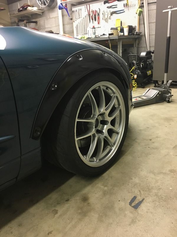

Got the front fenders finished up this weekend and the rears mocked up.
I used fender welting under the flares. This gives a nice water tight seal and also some grip between the fender and flare.
