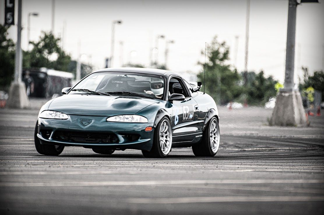

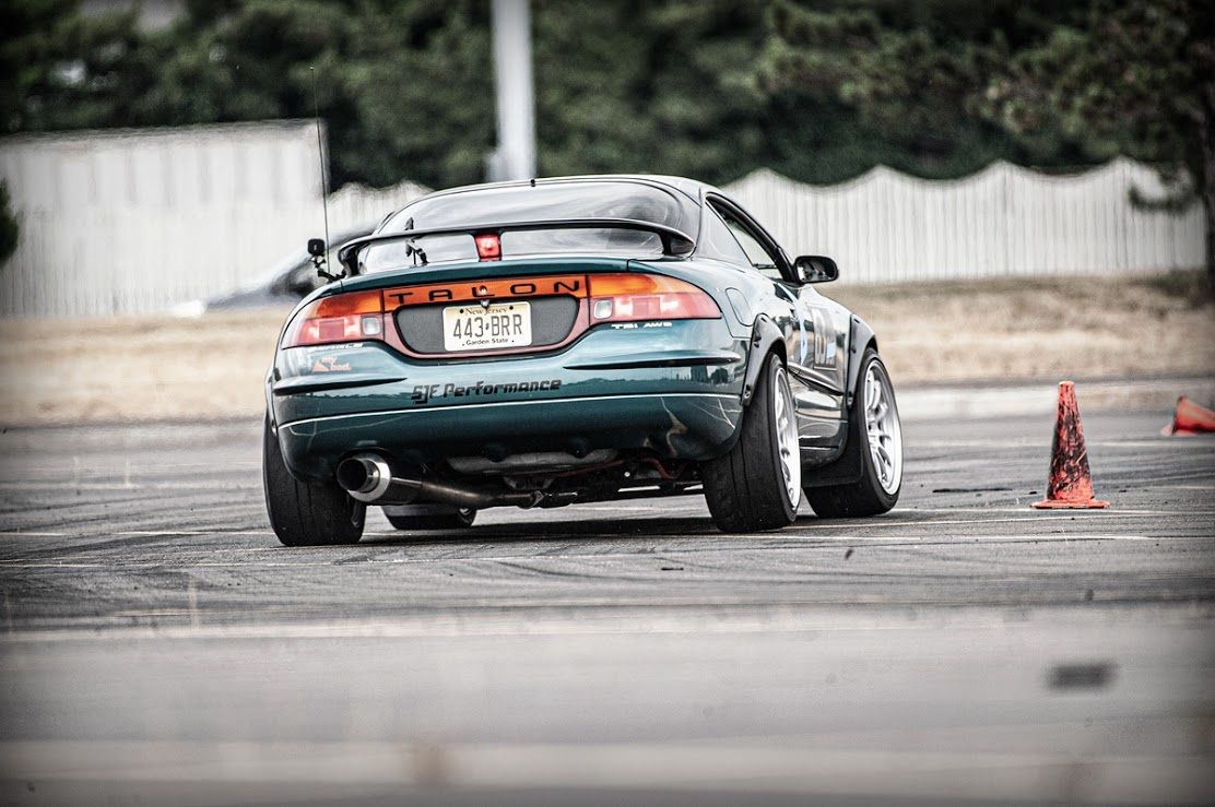

Picked this gem up a few years ago. Looking forward to autocrossing it.
SCCA NNJR autocross opening day, 6/28/2020.
Some STIFF competition as everyone was itching to get out. 1st in class and 12th in pax. 6 of the top 12 in PAX were SCCA National SOLO Champions and the rest of us except 1 are multi time national trophy winners. REALLY happy with these results as I know the car still has a bit more speed left in it. 11th fastest RAW time out of 99 drivers and 5th fastest on street tires.
Lets hope the car holds together for the rest of the year. I'm super excited to see how it turns out. :)

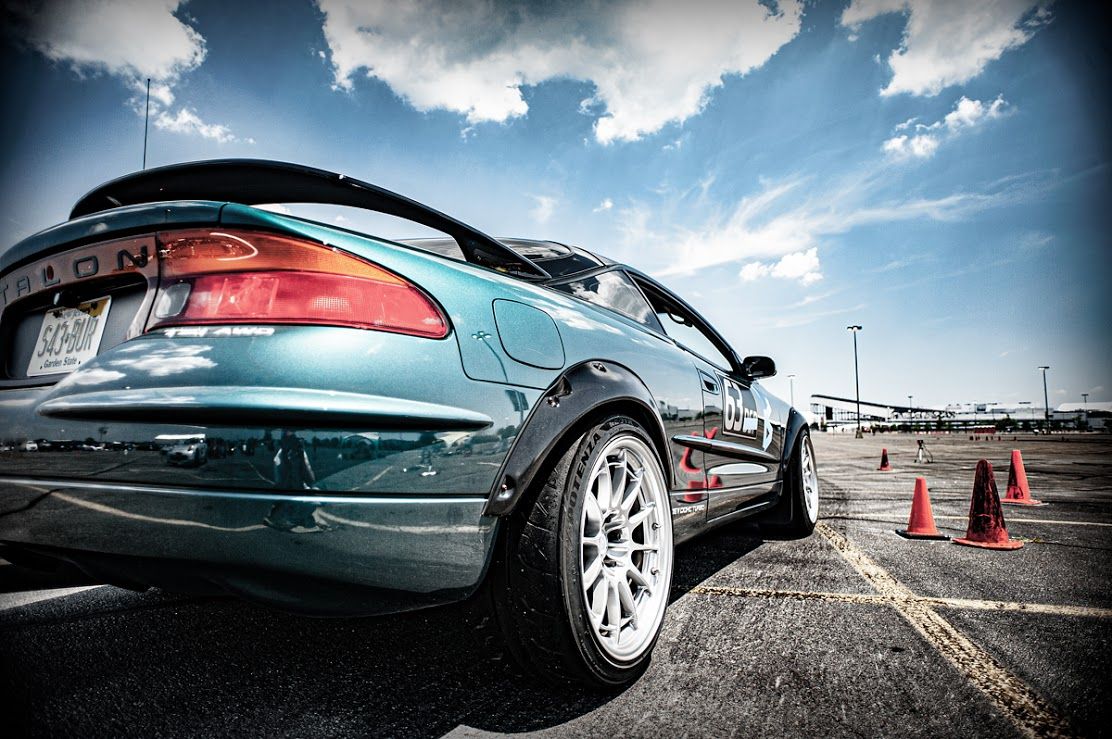

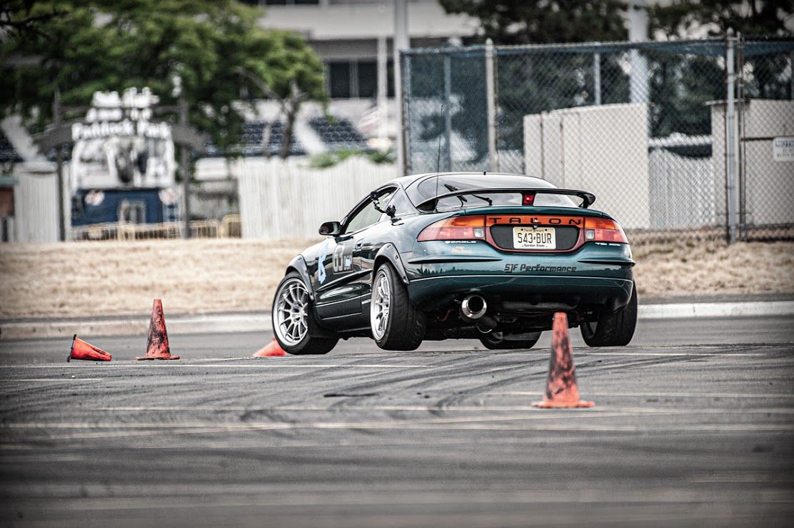

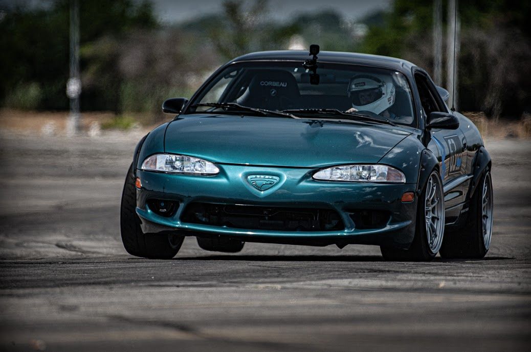

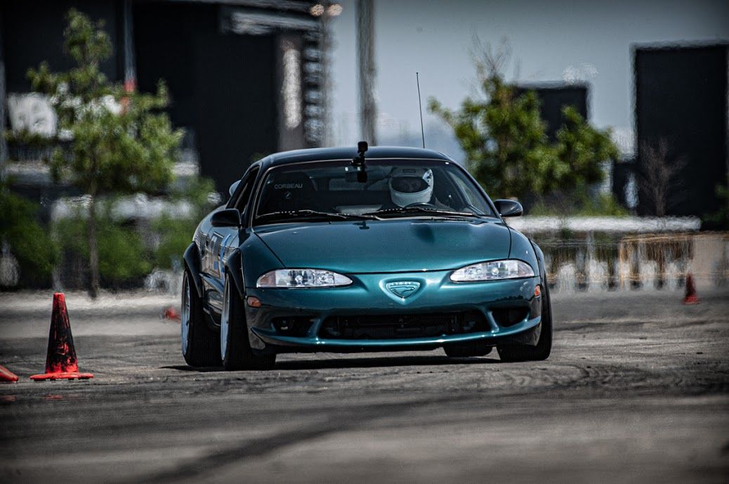

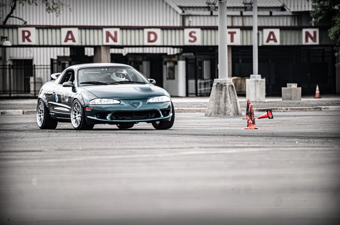

Very cool shots
Car looks great in those shots, and looks like you were having a ton of fun with all that contact patch!
Thank you, Luda.
265/35/18. The Hoosiers that will go on are 285/30/18 and I'll try to squeeze 295/30/18 next season. :hellyeah:
Actually, I MUST fit the 295's next year. The competition in DSP class (BMW's and RX8's mainly) are all on 305's or wider.
