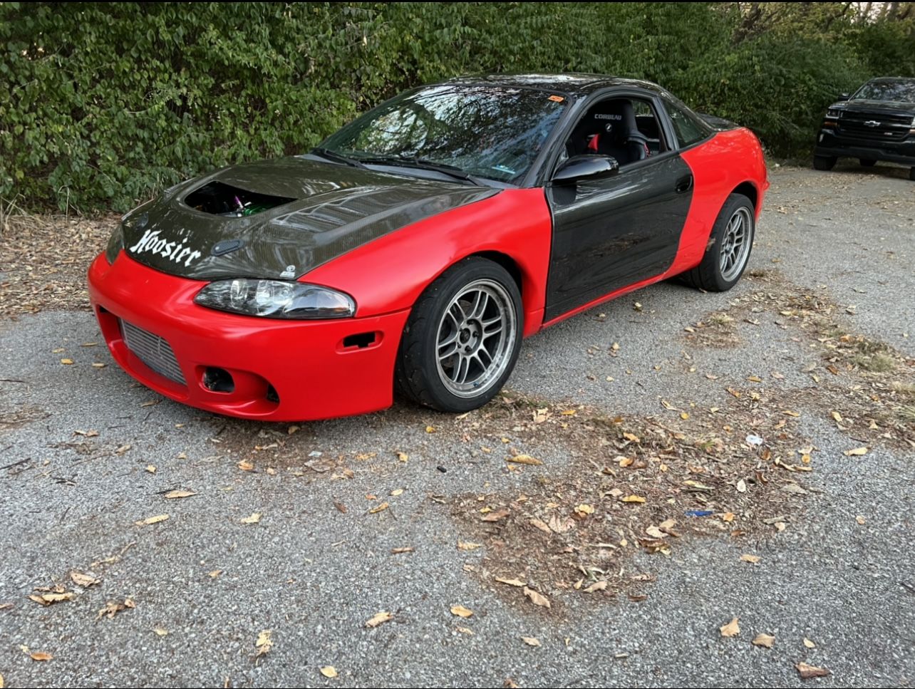

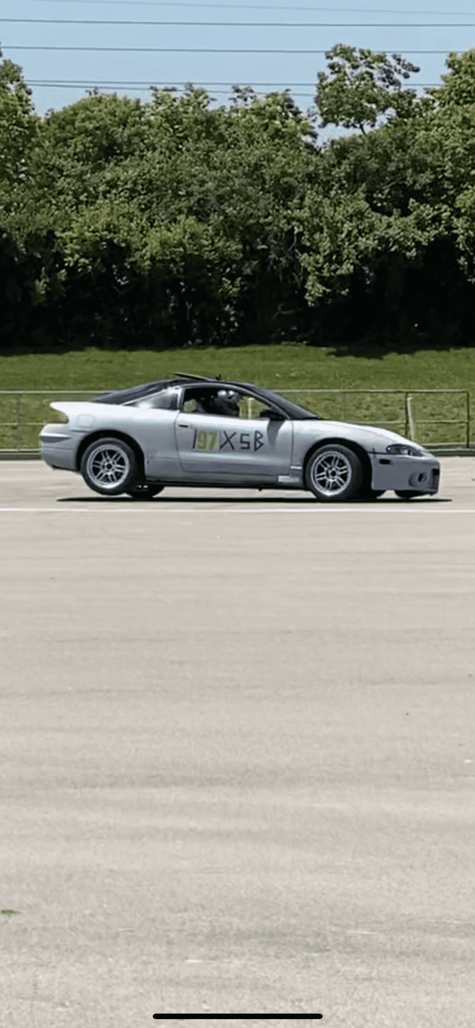

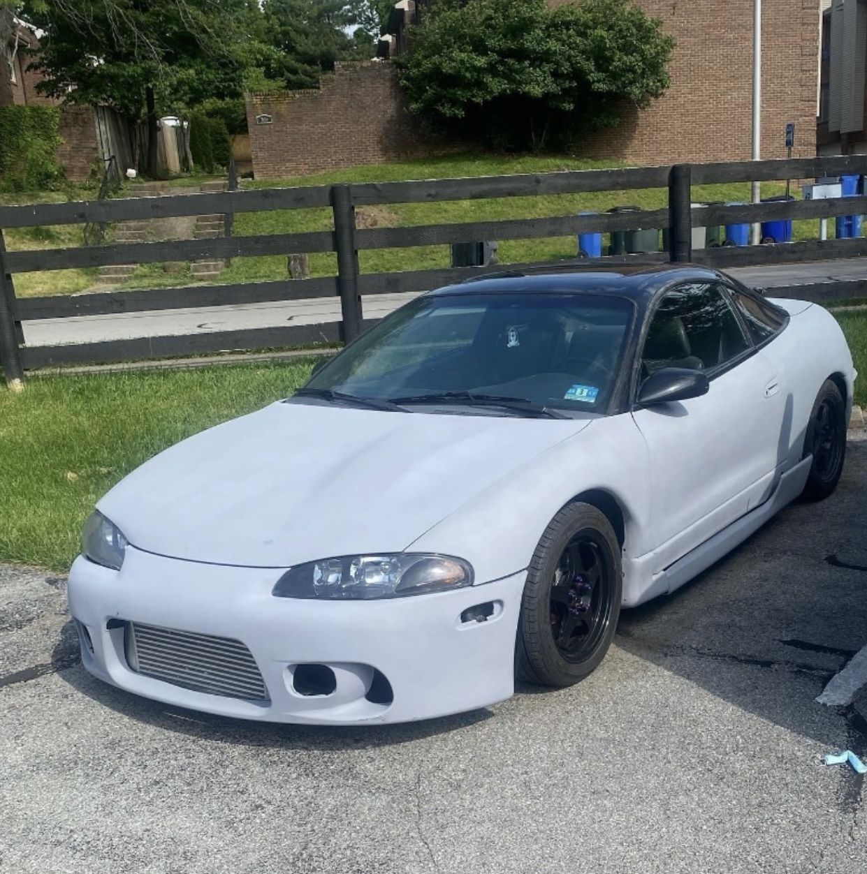

I’m a little late to start the build thread, but I’ll try to remember everything I’ve done to the car so far.
Mod list:
Intake/exhaust/engine
1. 4 inch intake tube
2. Air intake heat shield
3. Exhaust manifold heat shield
4. FP exhaust manifold
5. EGR Delete
6. Front Mount intercooler
7. Reflective wrap intake piping
8. Turbo back exhaust
9. Megan racing down-pipe
10. Recirculated O2 housing
11. Tial Wastegate
12. DSM6851S (FP68HTA V3) Turbocharger
13. Grimmspeed Boost controller
14. Catch can
15. Oil feed line from head
16. Kiggly HLA
Tuning
  1. Ecm link
  2. Speed density
Fuel System
1. Walboro 255 fuel pump
2. Fuel lab Fuel filter
3. Fuel lab Adjustable Pressure Regulator
4. Upgraded Lines from filter to regulator
5. 1220 FIC Injectors
6. E85
Cooling system
1. Aluminum radiator
2. Cooling fans
3. Fan switch bypass mod
4. Silicone hoses
5. Water temp sensor w/ gauge
Drivetrain
1. Clutch
2. Lightweight flywheel
3. Short throw shifter
4. Redline fluid
Suspension
1. Tien coilovers
2. 12k/ 6k swift springs
3. RM front sway bar
4. RM rear seay bar
5. Volk front LCA
6. Adjustable Upper B/J
7. Polyurethane bushings
8. Volk rear LCA
9. Volk rear toe arm
10. Volk rear trailing arms
11. Bobby’s rear UCA
12. DC sports rear upper strut bar
Brakes/Wheels
1. Drilled and slotted rotors
2. Carbotech Fr+Rr pads
3. Braided Brake lines
4. ABS Delete
5. RPF1 wheels
6. R660 Tires
Interior
1. Corbeau FX1 seats
2. Cipher harness bar
3. Cipher 5 point harnesses
