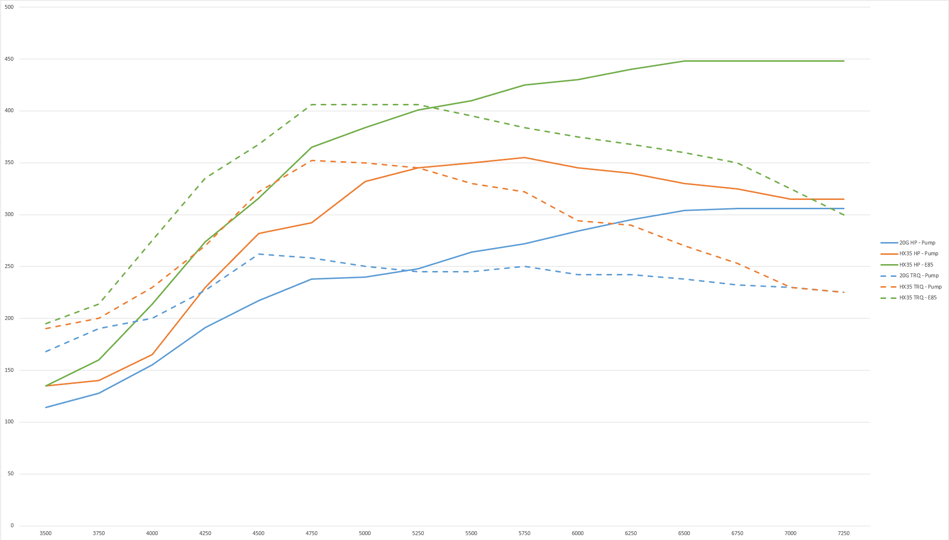

These comments were awhile back but I did put together a comparison of the two turbos in excel by parsing the dyno graphs. You can see how much more responsive the car is on the Holset. Especially with E85, but there is still a gain with an apples to apples pump gas comparison. Same tuner, same dyno, same motor/intake manifold/cams etc. Just a different exhaust manifold and turbo. Is this the go-to, super competitive Autox turbo setup? Absolutely not. But if you want a car you can use at an autocross event and be somewhat competitive and then freight train people on the highway on the way home, this is the setup for you.

@llxkevinxll did you plot boost pressure vs rpm to compare the turbo spool on E85 vs 93? You made a good amount of torque more on E even during spool up. Is this because the car make boost quicker, or that your running more timing during spool?
The spool is similar. Roughly 4600 rpm for 20psi in 2nd gear, (not the best gear for measuring "spool" but it was where I spend most of my time). The power is made up in timing that the car would tolerate on the Holset that it wouldn't with the smaller Mitsu style housing.

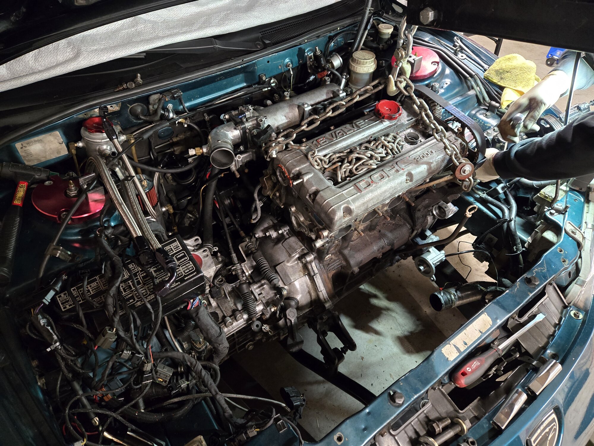

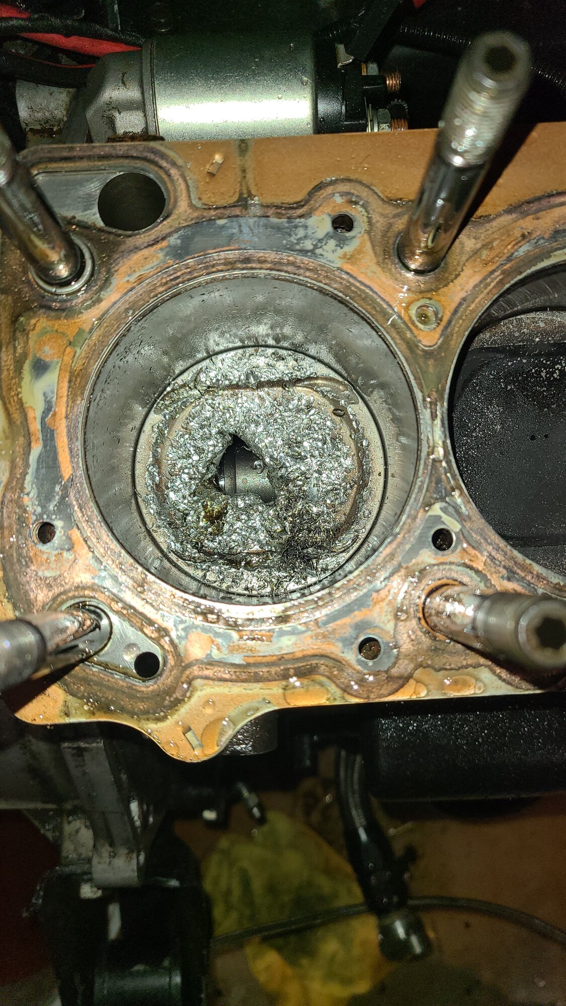

Long story short, August of 2020, I was coming through the finish line at an autocross event for my final run and the car started breaking up. Before I could get out of it, there was a clang and the car shut off. Our best guess was a coilpack failure led to fuel build up in #3 and it bent so bad it knocked the cylinder wall out. (It still started and ran after this shockingly, but made a bit (a lot) of noise). I replaced that engine with the long block from my 1G, but it never seemed to run right. Upon taking that engine apart to re-ring and replace bearings, two pistons had ring lands cracked in half. Which explained why the catch can was filling so quickly and the car was not running right. The Talon now has a third engine, purchased from Ricky at Rix Racing. It has a 6 bolt bottom end with Eagle H-beams and JE 8.5:1 pistons, with a 2g head up top with Crower valve train, Crower 272s, and Ferrea valves, along with an Evo 3 Intake Manifold. Turbo setup has remained the same.

The car feels really good on the new head/IM/cams. Much better than it ever did on the old engine, and that is without pushing it hard. I also have a mountain of parts to keep the car going for a long time. That being said, the Talon has proven to be down more than running, as is expected with any car making 200+ hp/L, but this has led to me lacking a lot of seat time to get my skill where I would like it to be. The car is also still not ready for any road race duty with the current cooling/safety situation, and driving the car to events farther than an hour away becomes a chore with solid/poly mounts throughout the car, no sound deadening, no balance shafts, no cruise, etc etc. That all being said, I did end up picking up a car to focus on using for Autocross and Track events, a 2022 Camaro SS 1LE. This car is ready to roll from the factory for what I want to do. Other than a catch can (to combat direct injection induced valve coking) the car won't be modified in any way for the foreseeable future.

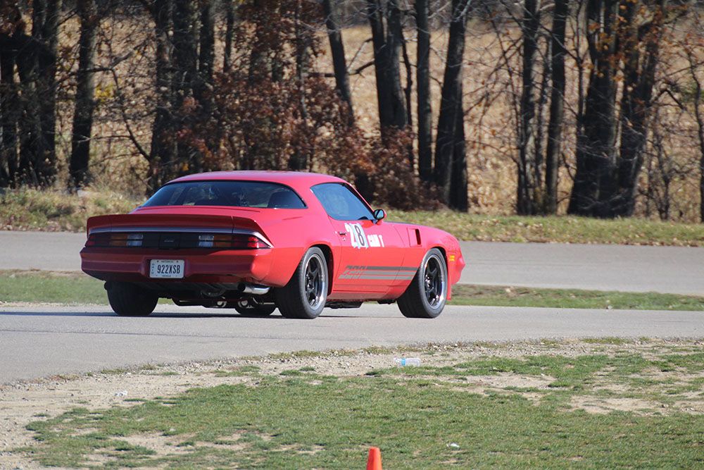

I come from a GM family, and was raised by my GM tech father, so the car choice was a no brainer. This car will actually by the 4th Camaro currently in our stable. On top of wanting a car to race, I ordered this car specifically to match my father's 1980 Z28 that he ordered new 42 years ago. A car he still owns, and races, to this day.
The Talon has taught me everything I know about working on and maintaining cars, tuning, etc. And I will continue to cherish (and drive) this car. There is still more to do, the interior being high up on that list (seats/harnesses/roll bar). But it will serve a different purpose going forward for sure.
It’s the announcers fault 😂. They always seem to be a jinx whenever they’re announcing games. Awesome you got a Camaro to match your fathers. His car looks to be in great shape 👍
Ya his is in excellent condition. No winters and meticulously maintained (and modified) over the last 4 decades and ~55k miles.

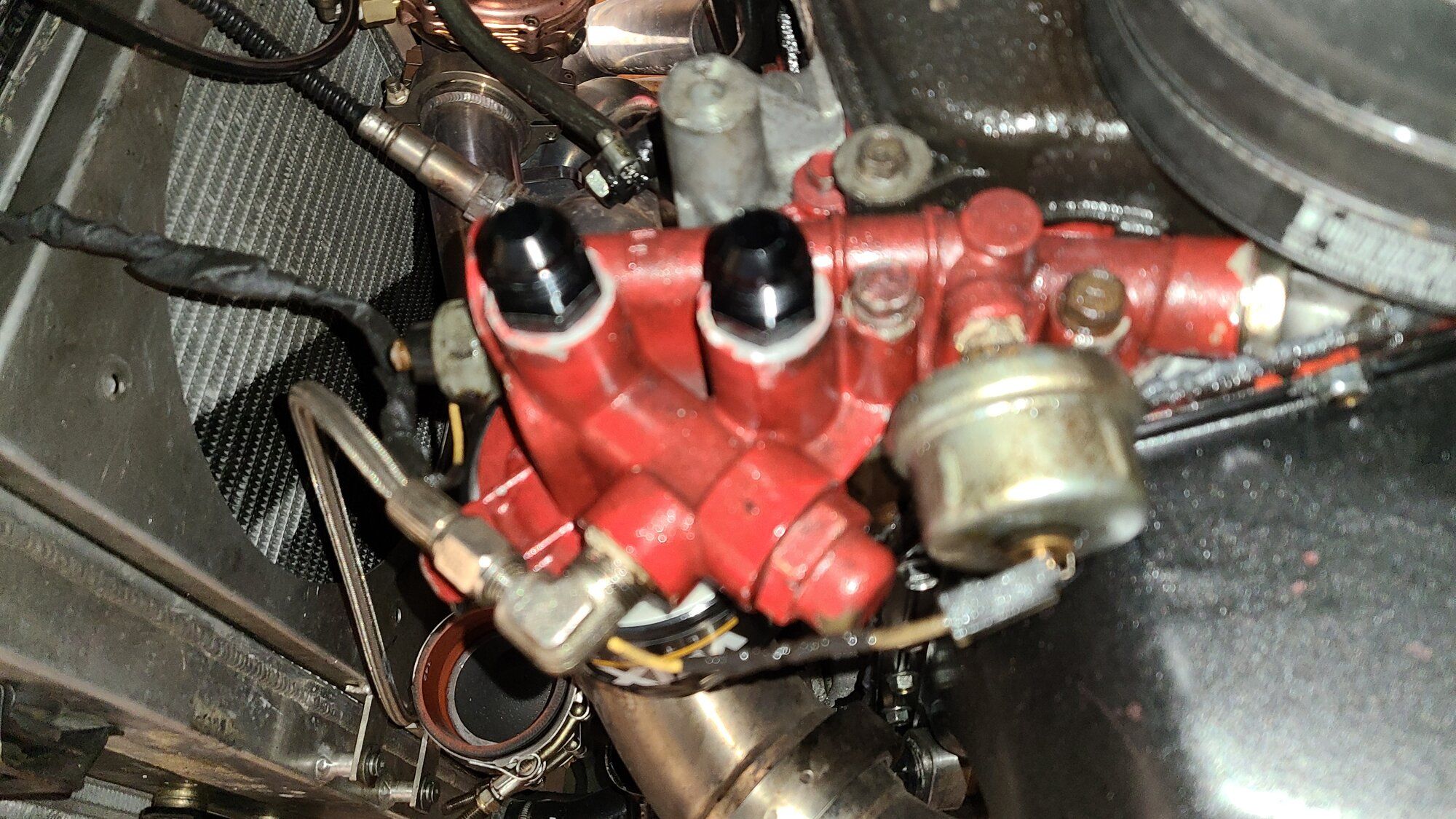

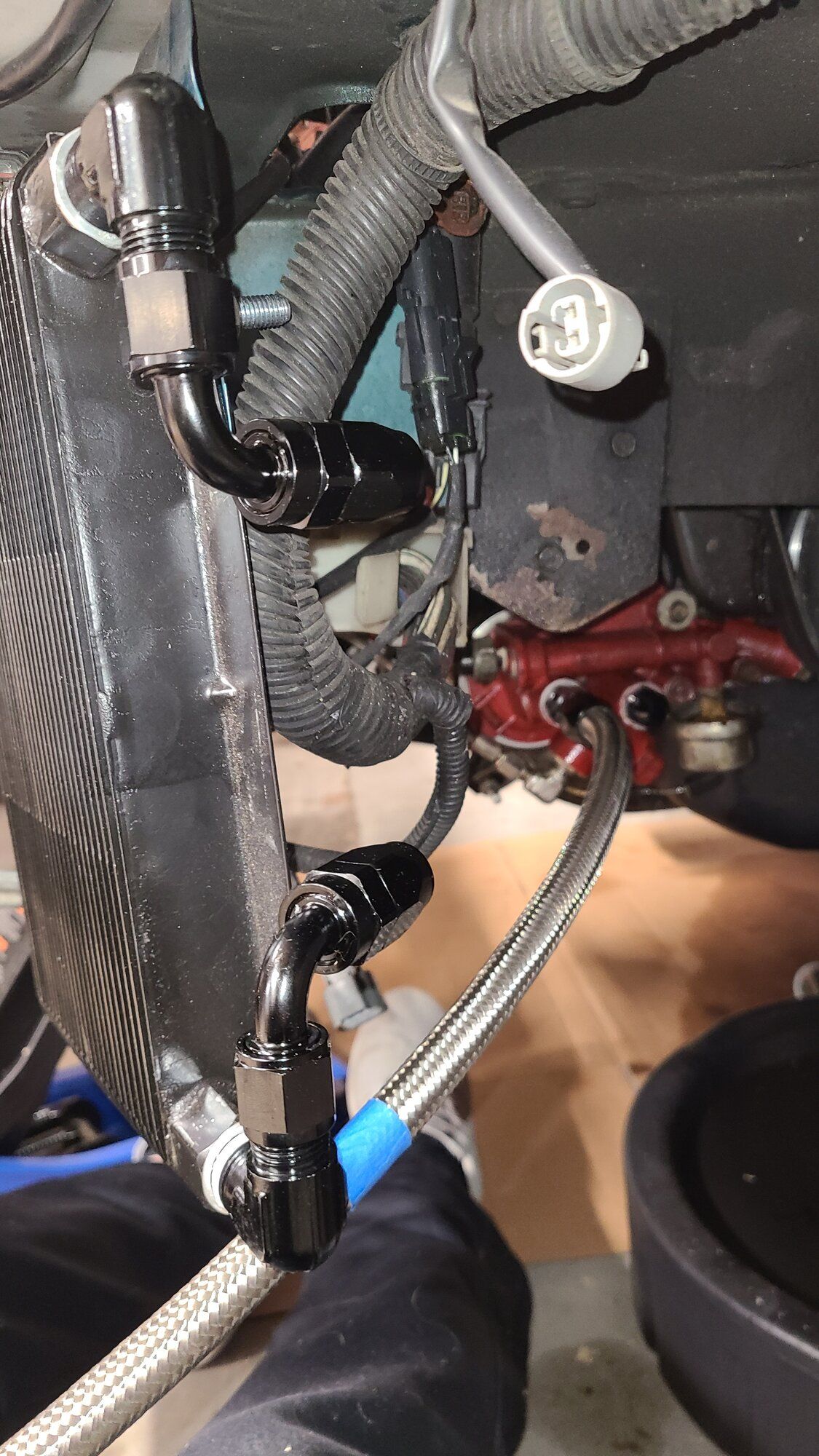

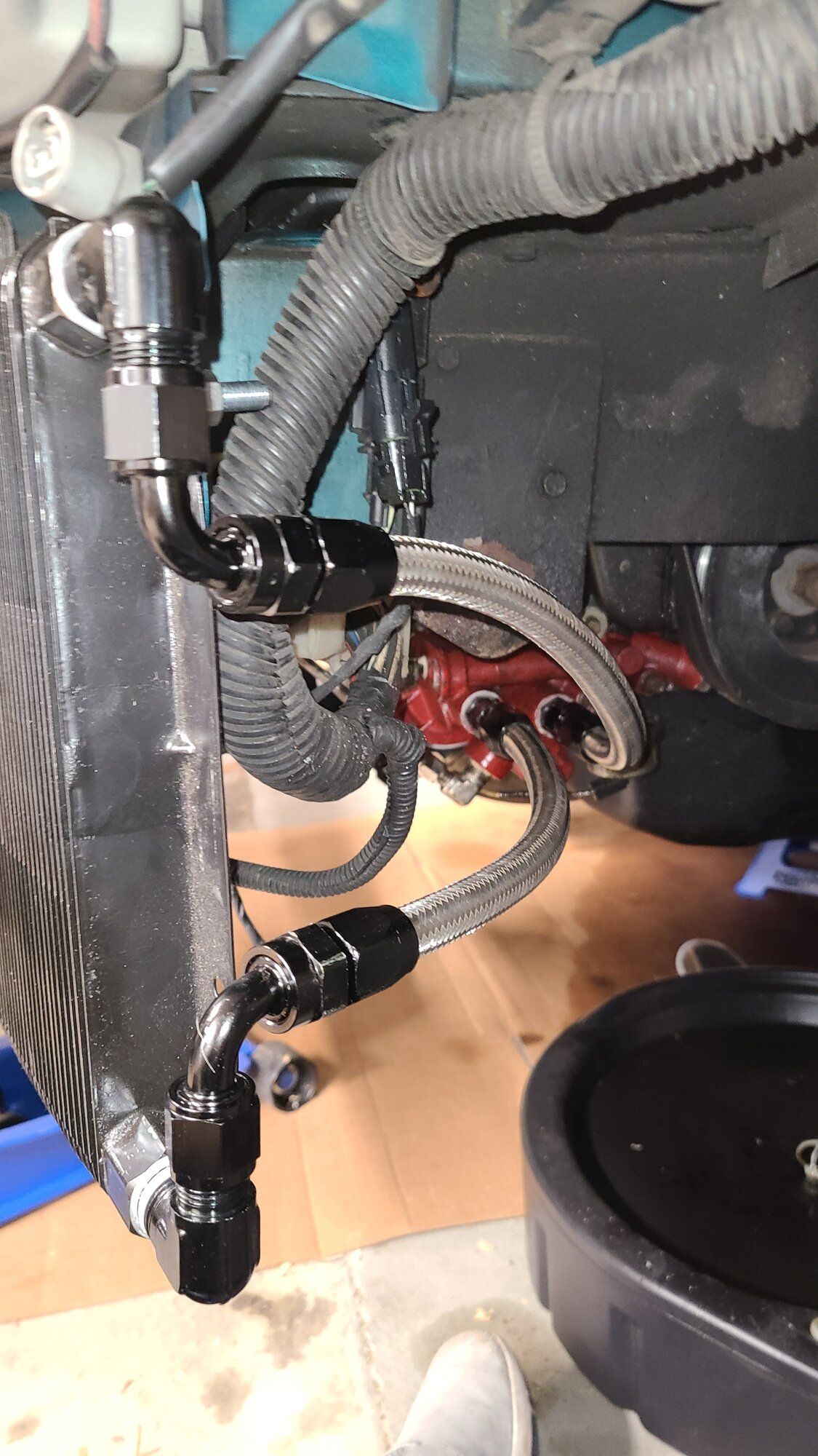

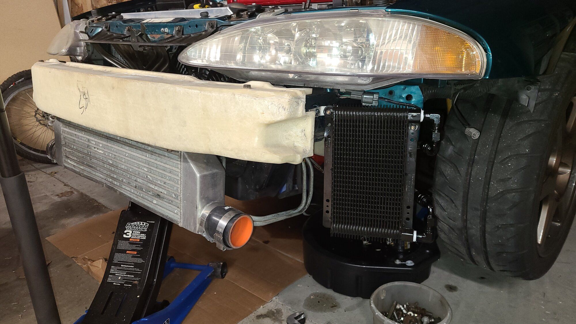

I have been sitting on this ExtremePsi oil cooler kit for about four and a half years and finally got motivated to get it on the car. I definitely have a cooling issue in this car when the ambient temps start climbing. I blame the poor airflow of the 2Ga Talon front bumper and the lack of factory ducting to get any usable air up to the radiator. I am hoping this helps keep temperatures down but I will for sure need to get the radiator more air.
I have been driving the Talon quite a bit this spring. Playing around in ECMLink and dialing it in on the new engine using the old tune as a base. It has been a fun learning experience and the tune is pretty soft for now. I will look to turn it back up in the near future. In that time I did do my first track day in the Camaro! Something I might try in the future in the Talon but even after 10+ years of working on it, it still isn't quite ready for that. So I will continue plugging away on things I want to improve or change on the Talon (alignment, re-tune, radiator airlow improvement, seats/harnesses/roll bar, built driveline if I feel the need/break this trans that has held up for the past decade I have had it and I am sure many hard years before that. The Talon will be a work in progress forever I am sure haha.

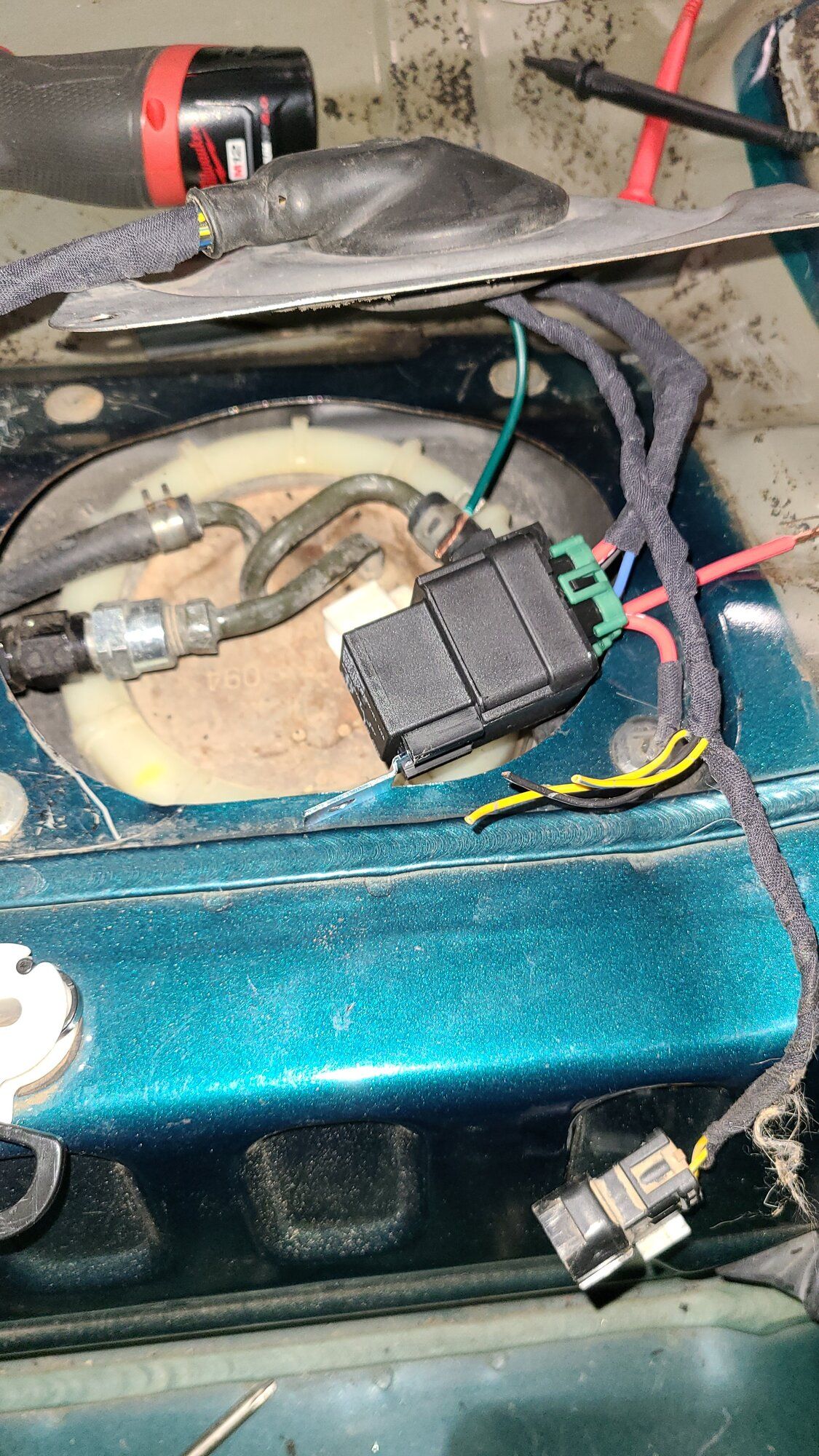

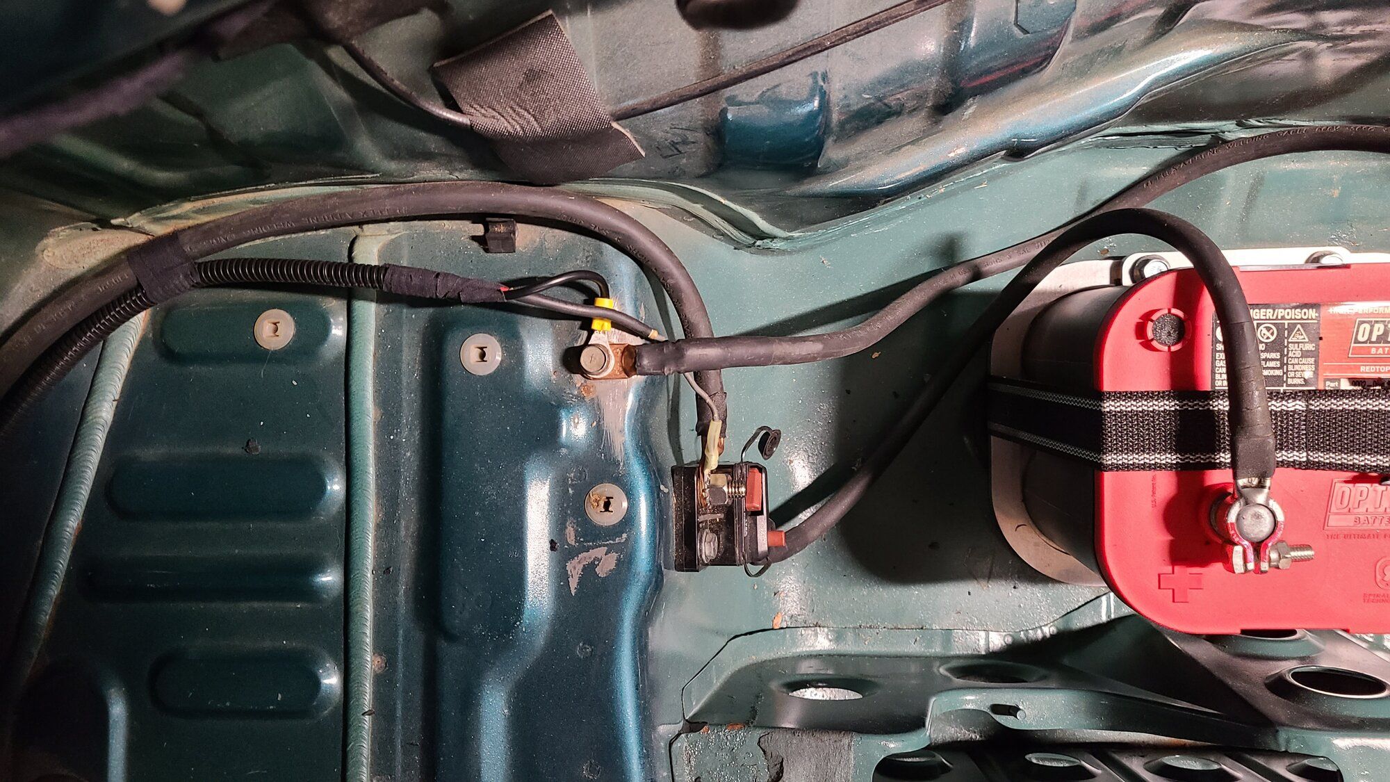

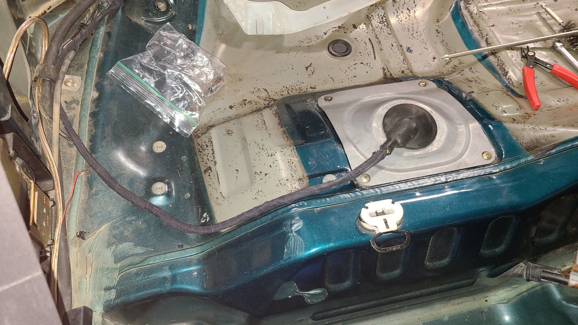

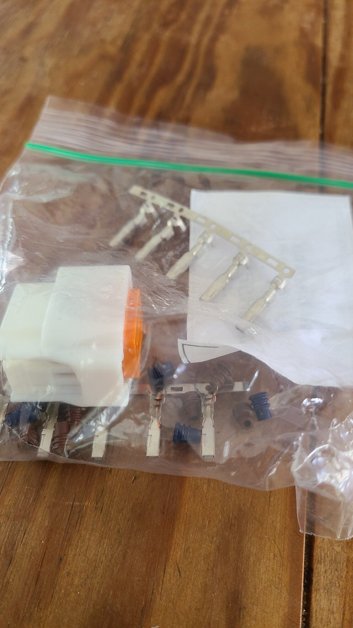

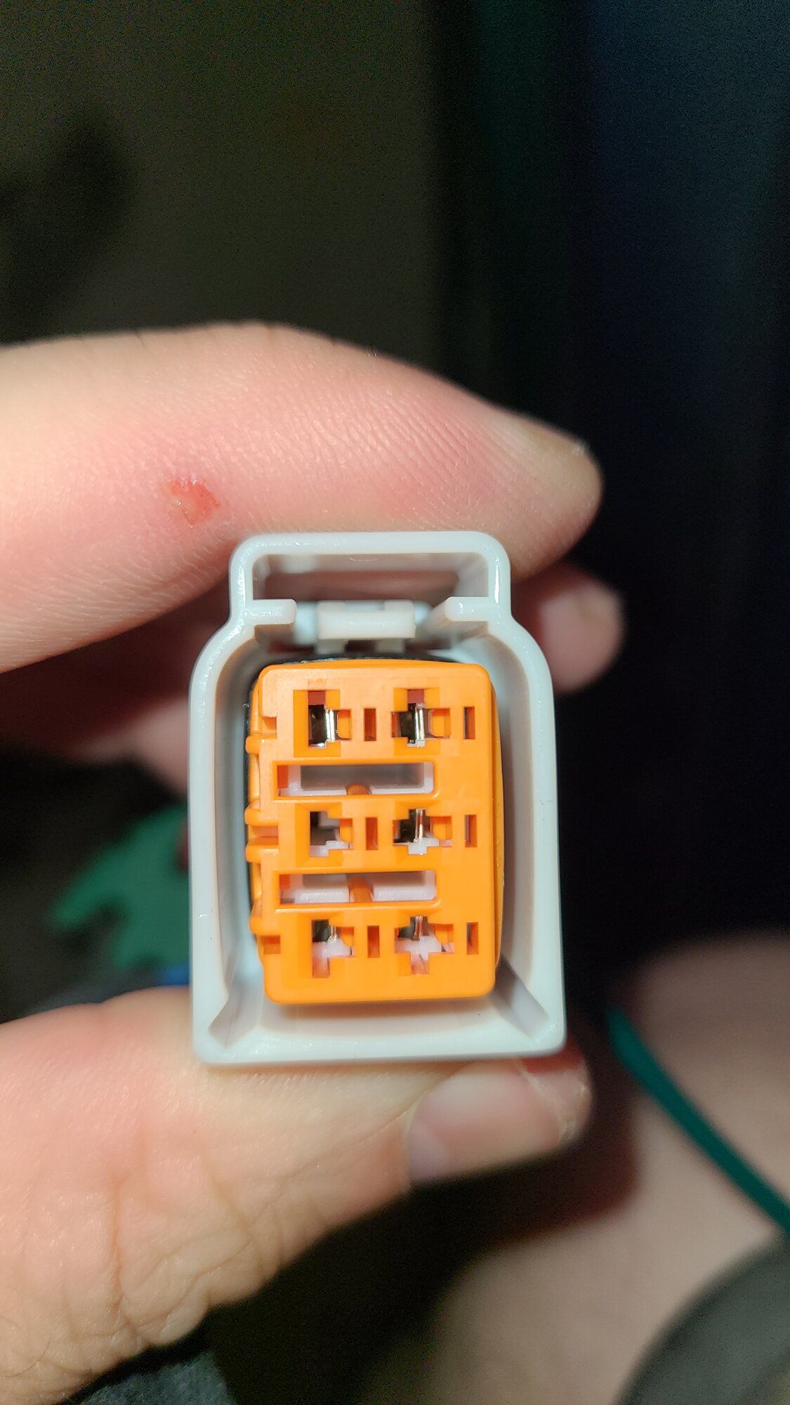

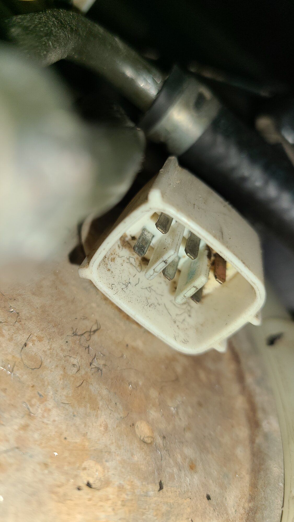

UPDATE #46 - 5/27/2022 - Fuel Pump Rewire Update

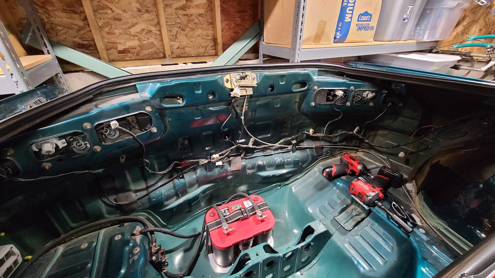

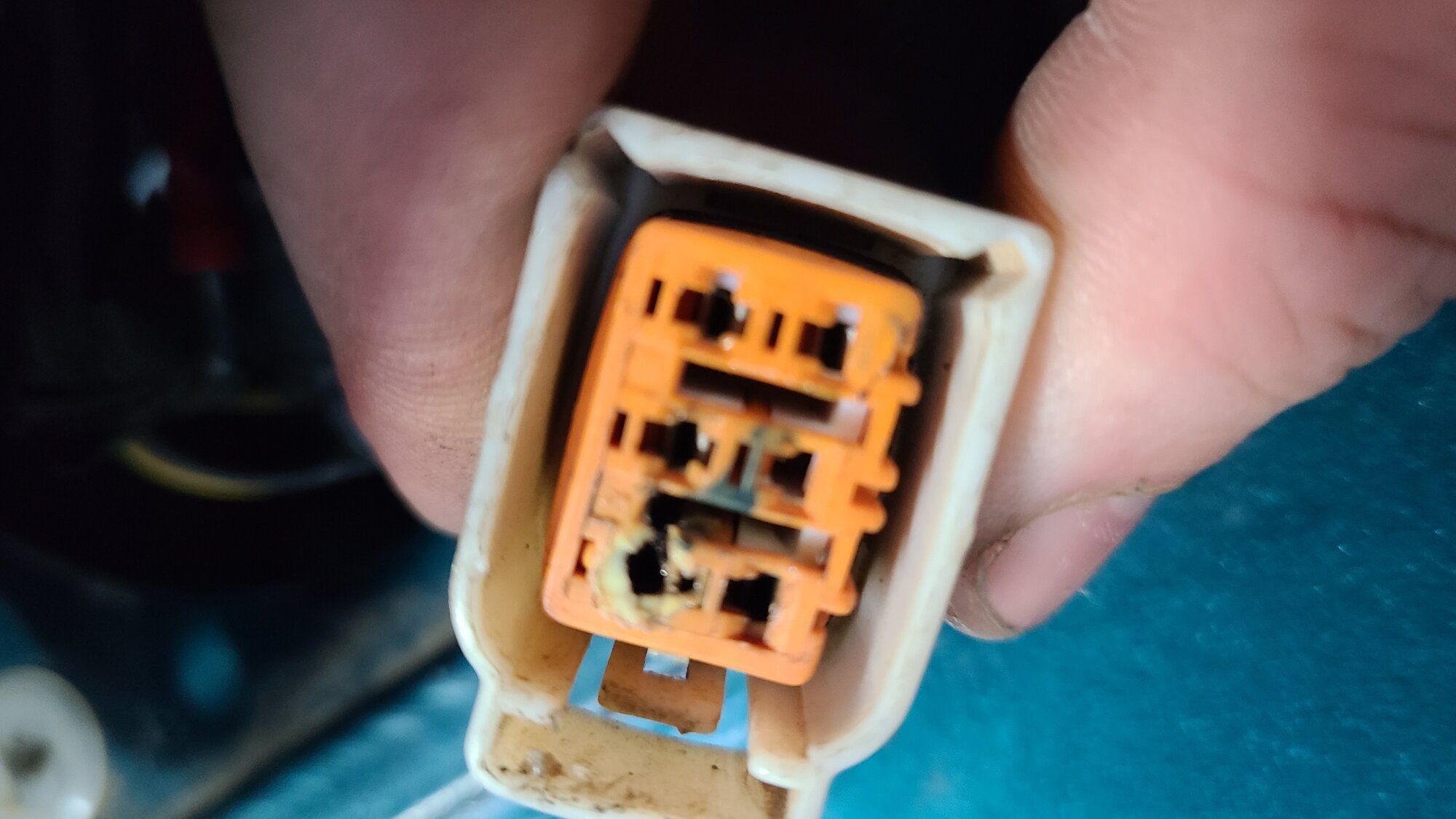

I had been experiencing intermittent issues with the fuel pump not working. Turned out to be a burned connector. So I took the opportunity to rework the entire fuel pump rewire setup. New Sheridan Engineer connector kit and re-routed wiring with a new relay.

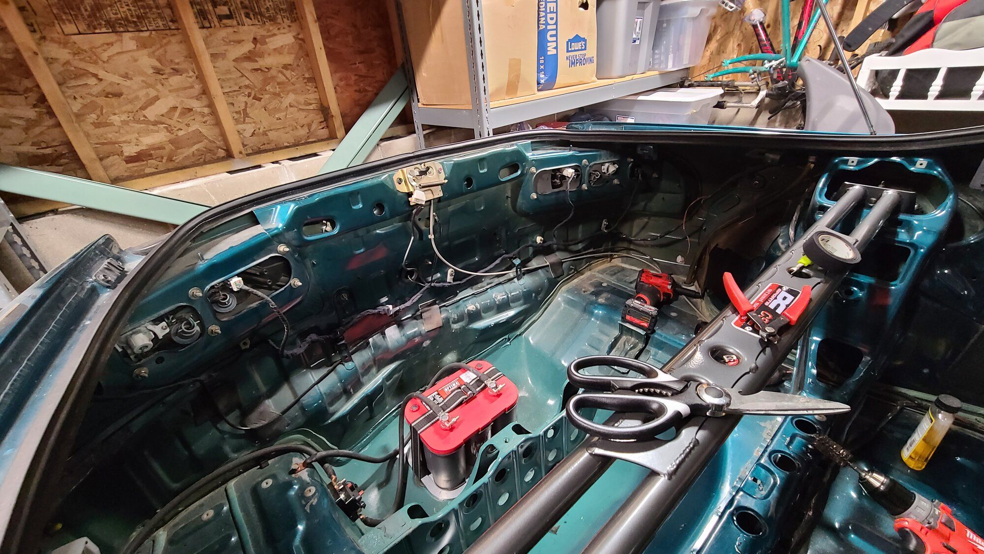

Took the opportunity to remove the rear half of the interior (what was left of it) and tape up the exposed looms with fabric electrical tape to clean up the look as I do not intend to reinstall the back half of the interior.

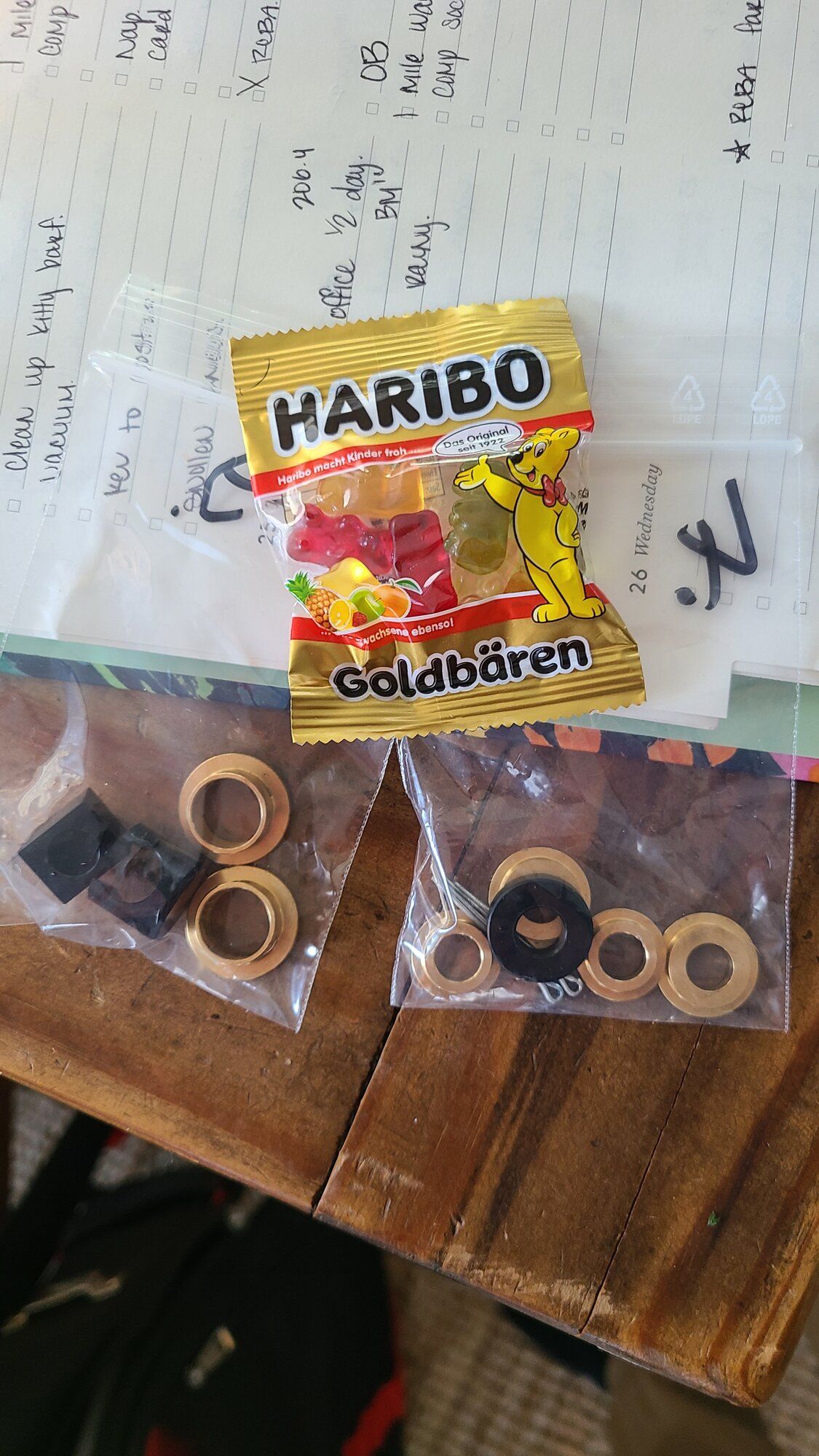

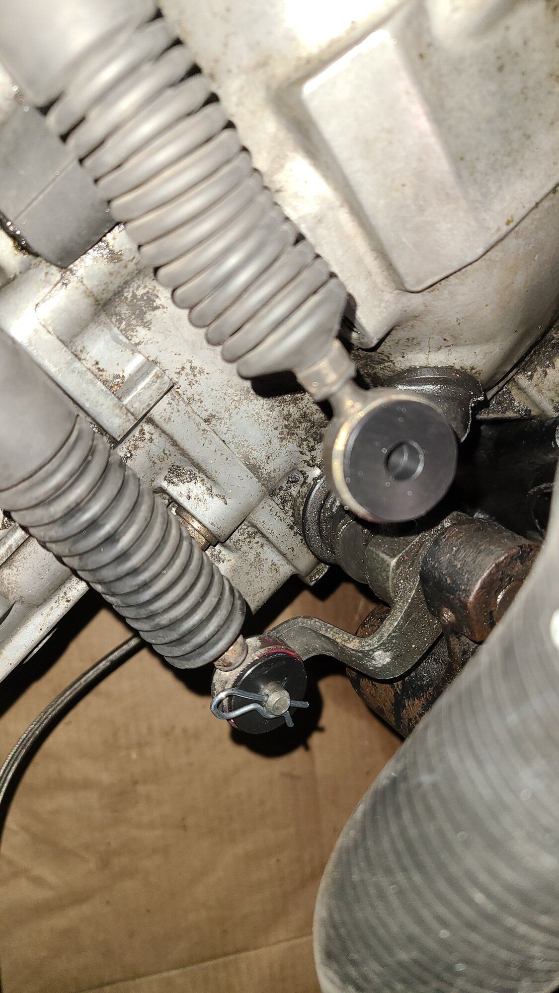

UPDATE #48 - 12/11/2022 - Shifter assembly rebuild/Lighting update

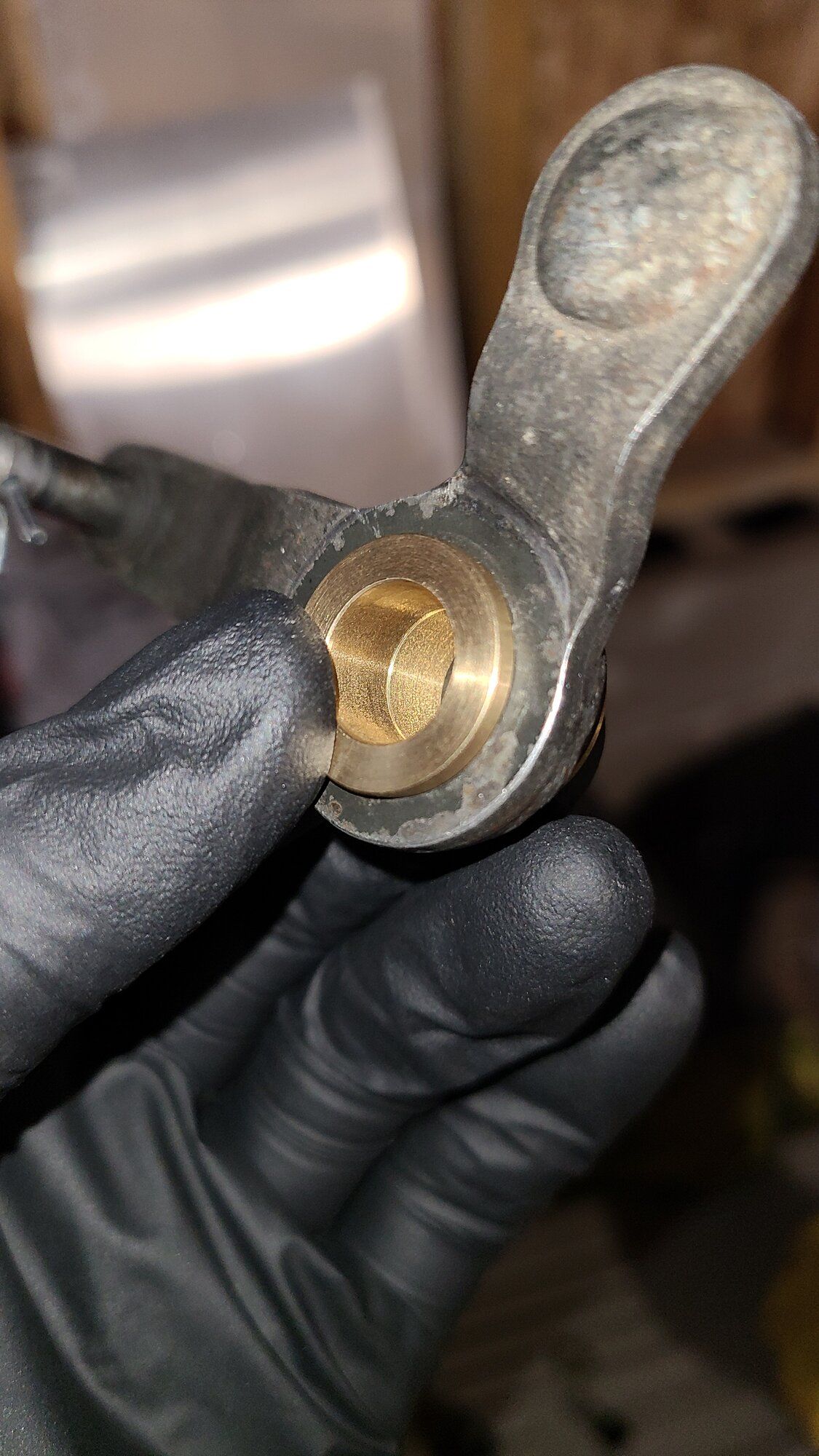

Compiled parts from a few different vendors and have a freshly rebuilt shifter assembly both interior and trans side.

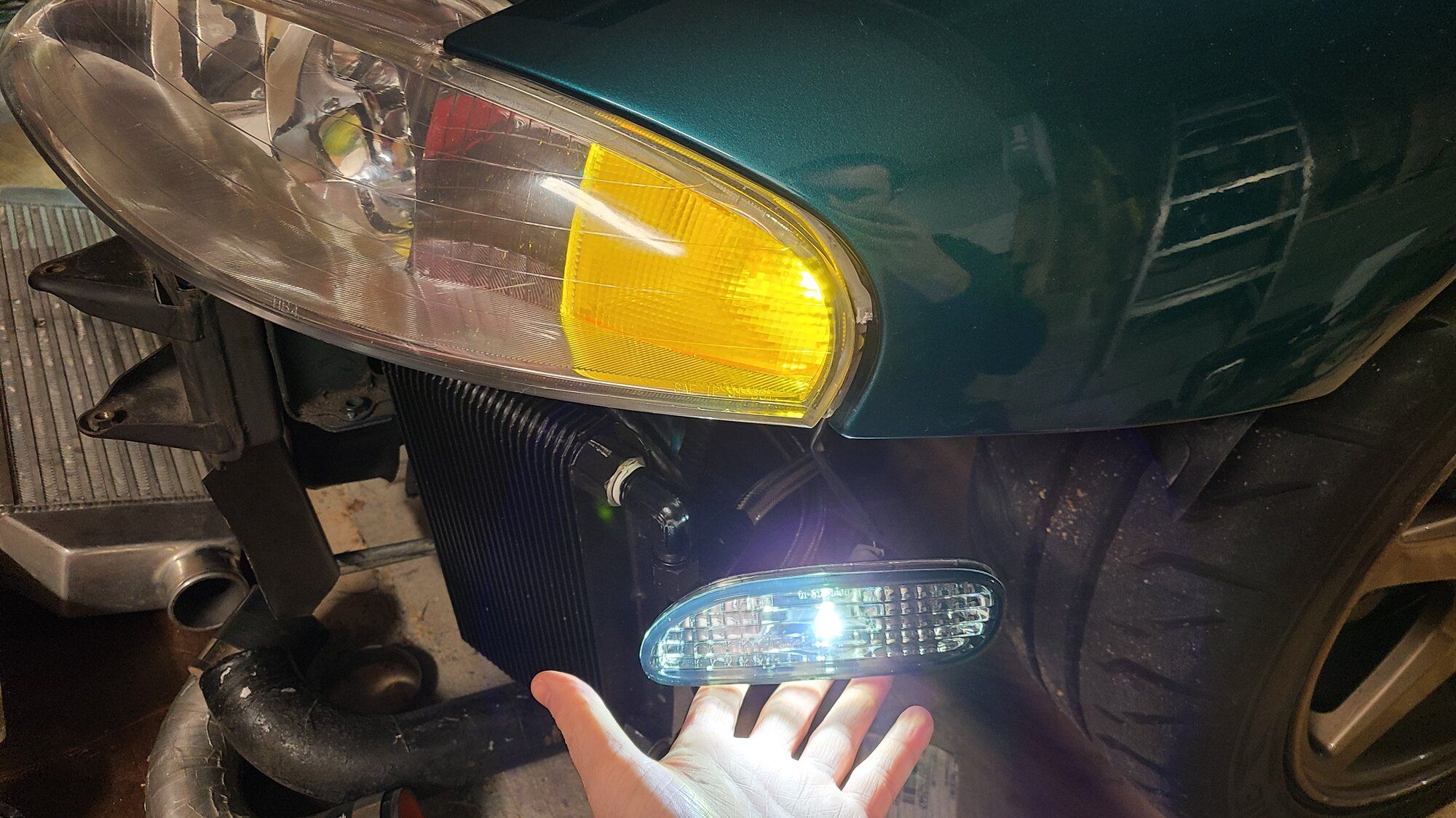

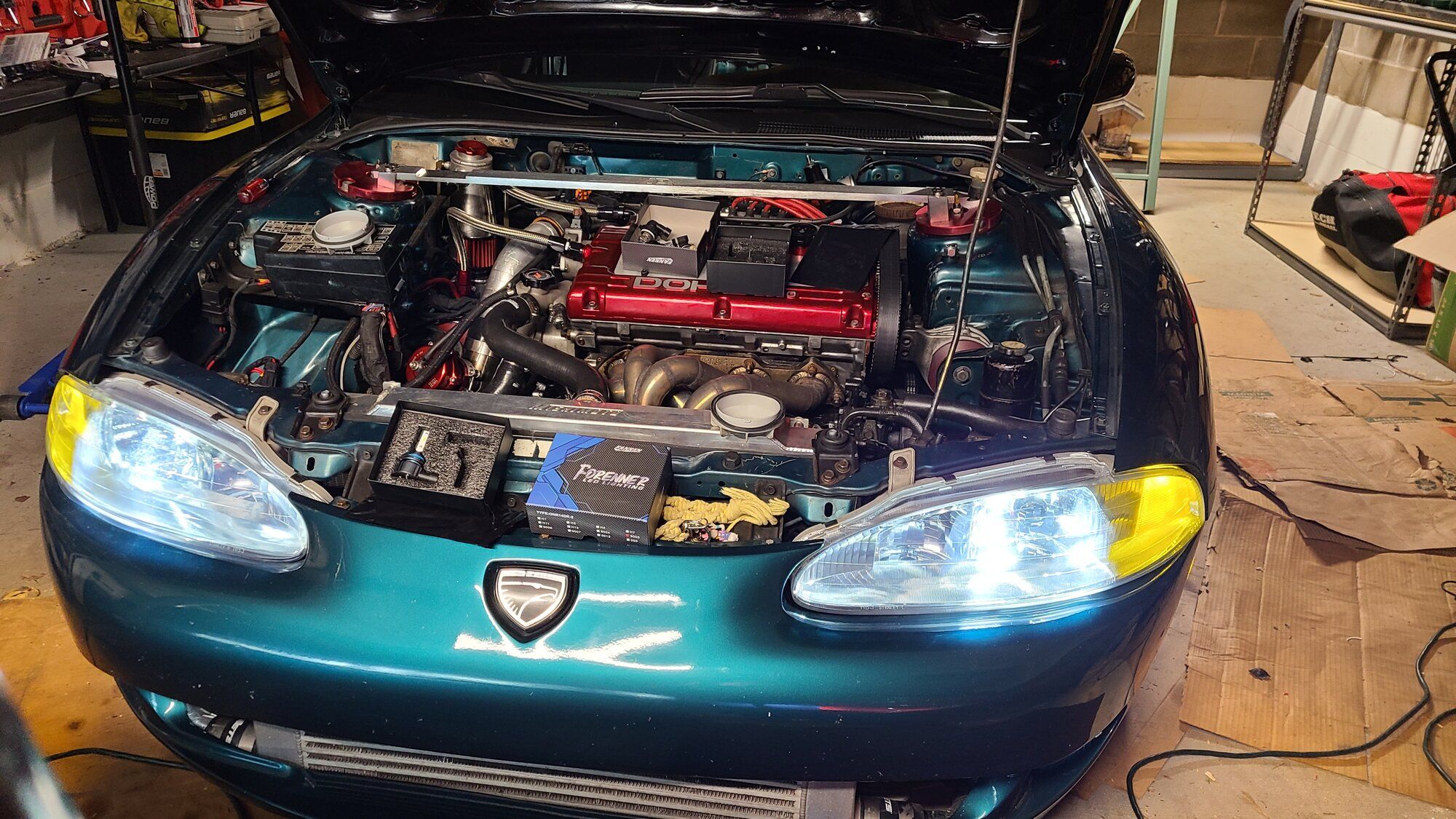

Also swapped exterior and interior bulbs for LED.

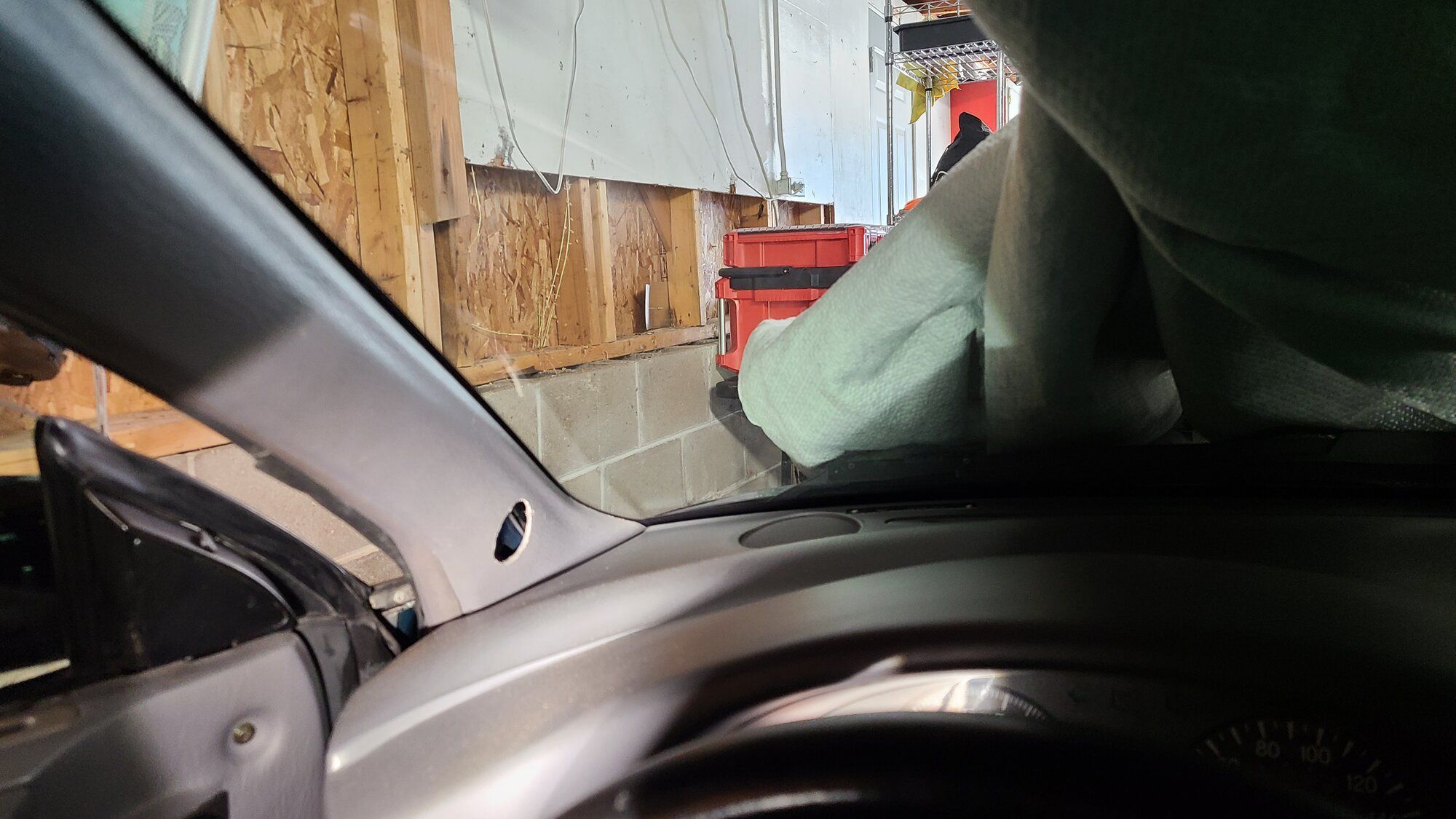

Finally took care of a few interior trim issues that have been lingering for years.

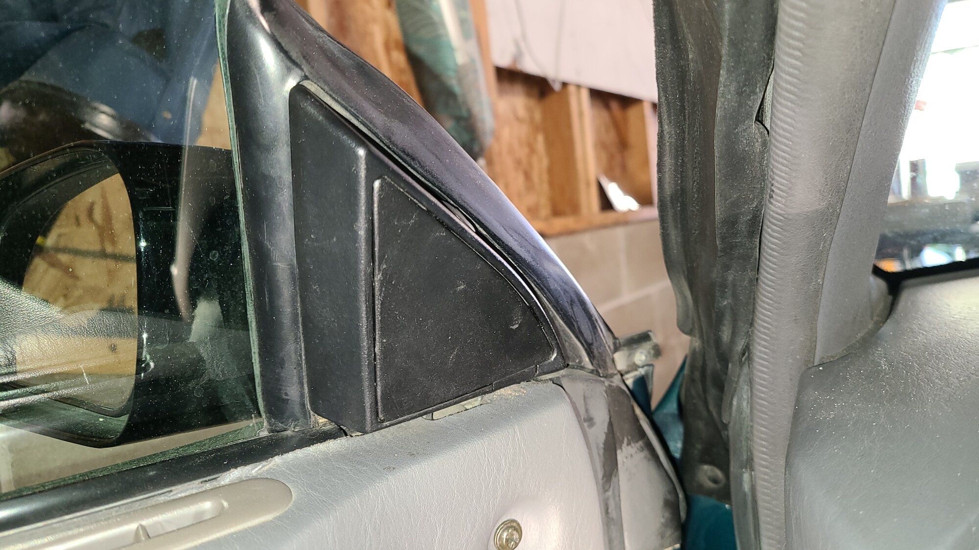

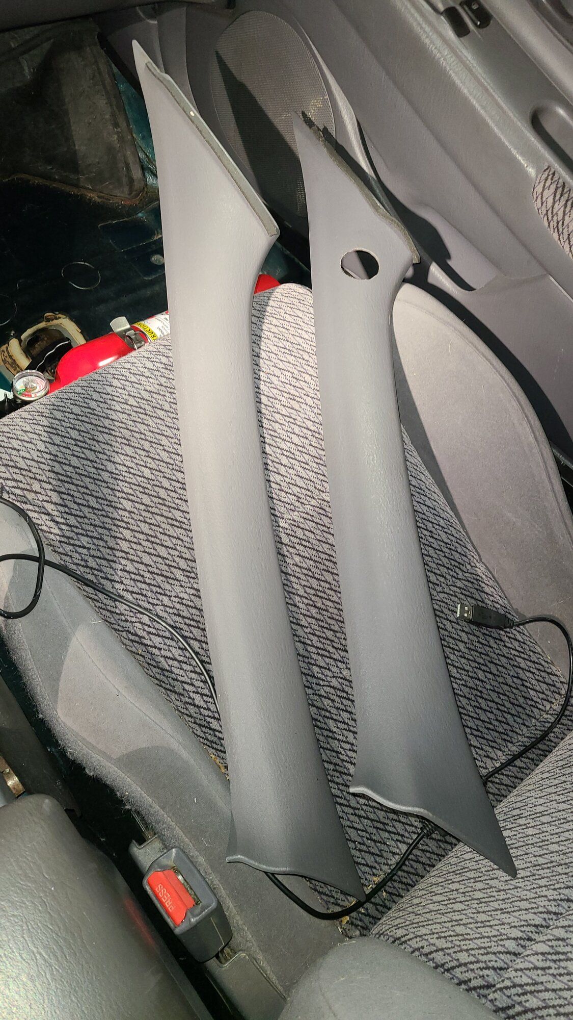

A-Pillar trim piece has had a hole in it for the previously installed gauge pod.

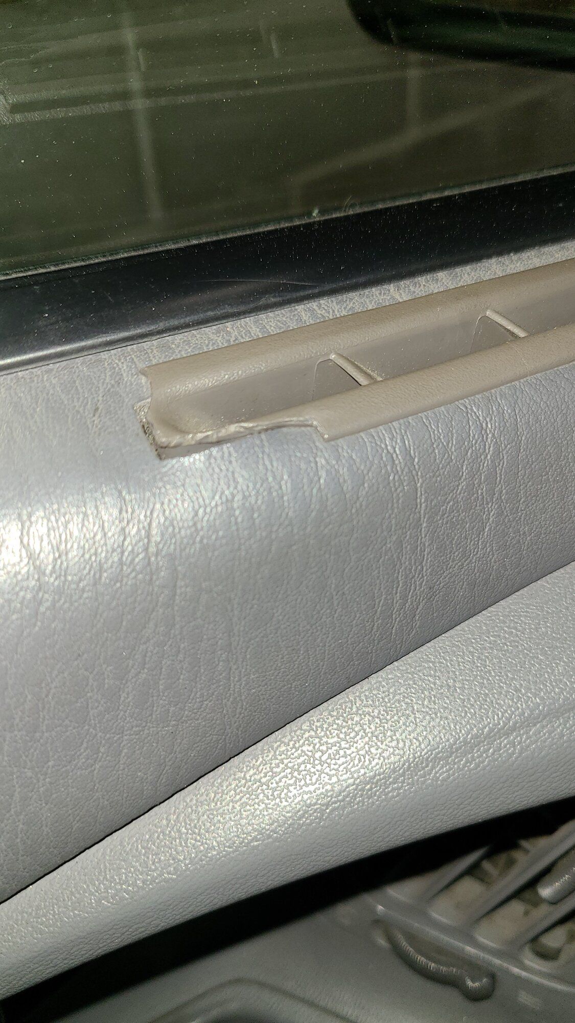

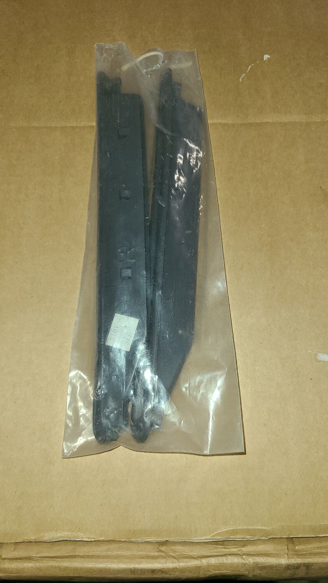

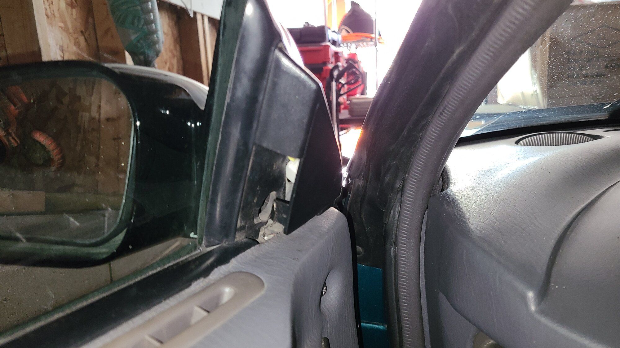

Driver side mirror trim has been missing a section. New one looks great.

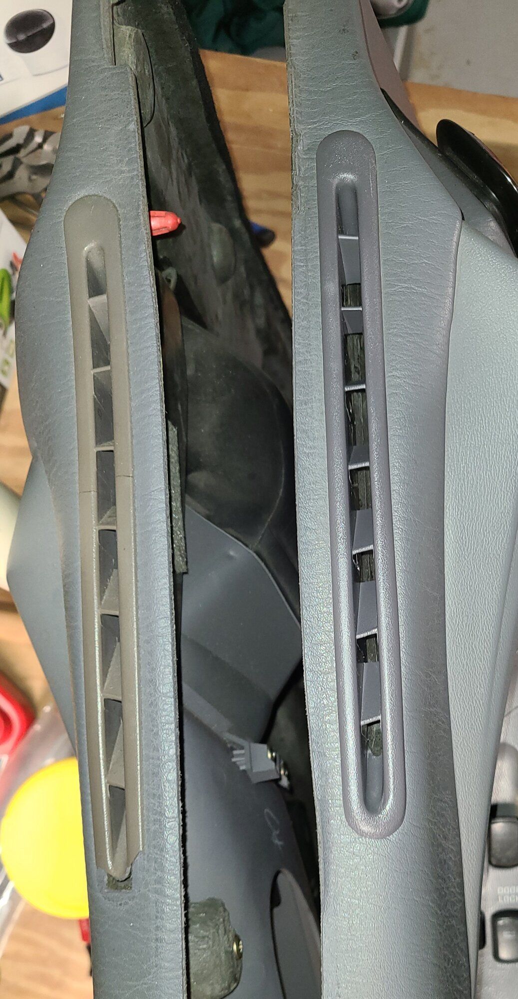

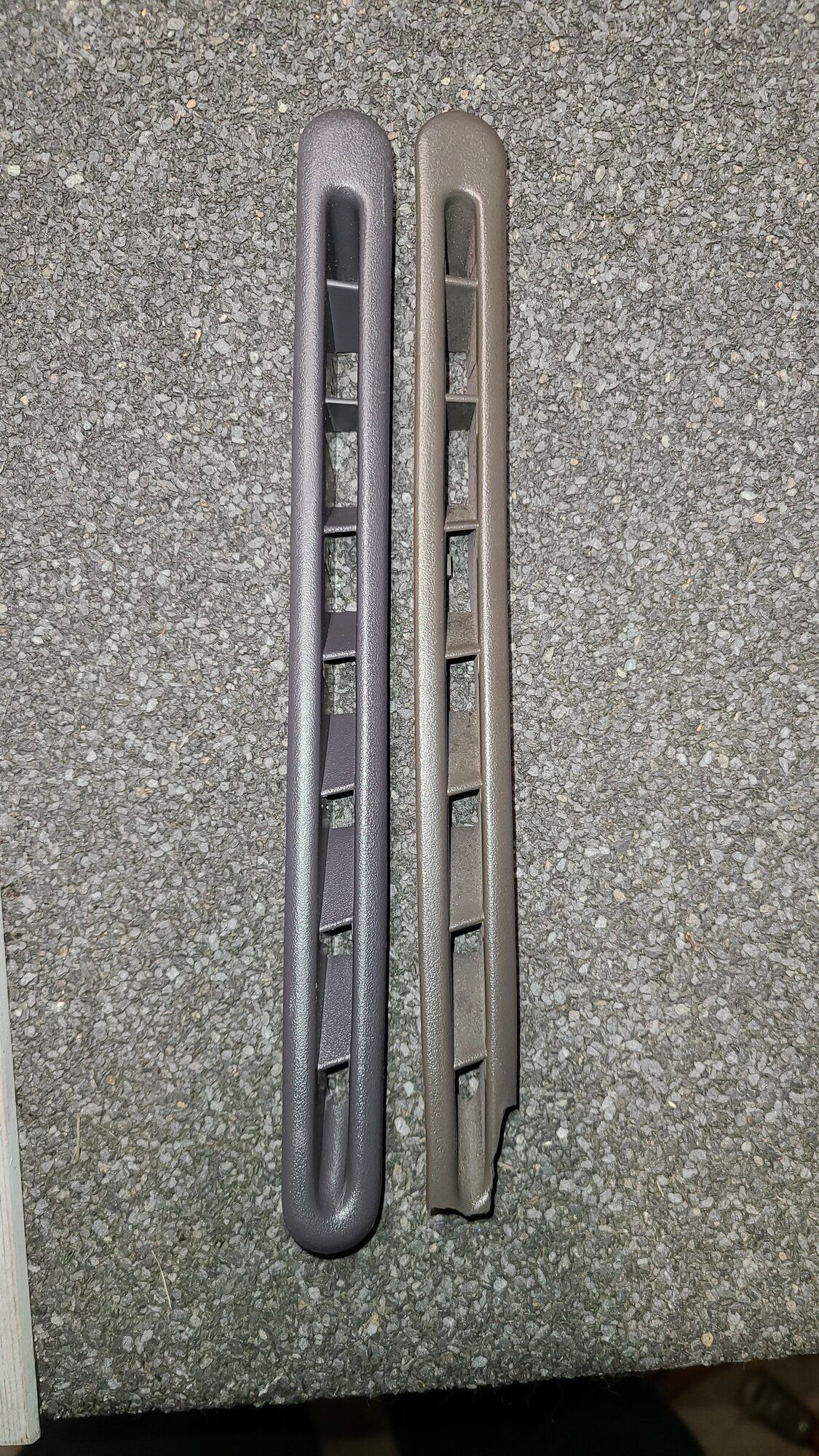

The window defrost vents were faded and cracked. Have been sitting on New Old Stock replacements for years and finally committed to installing them.
On top of the interior work, I am in the process of swapping the car over to running on a Haltech Elite 1500 with the Evo 4-8 Plug and Play adapter. Will for sure update as that process continues.

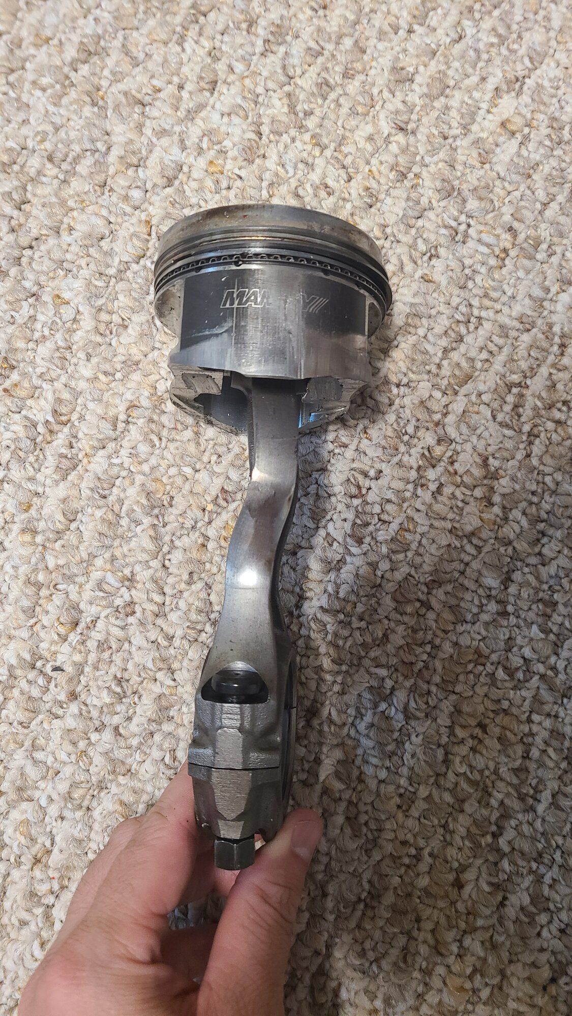

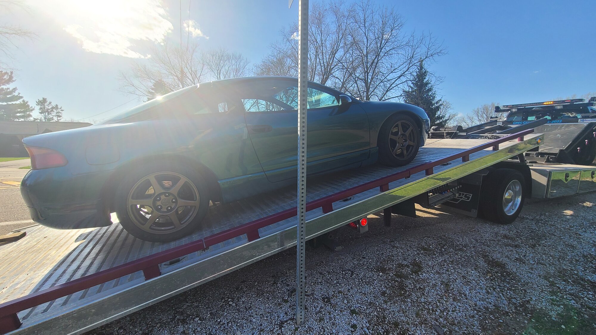

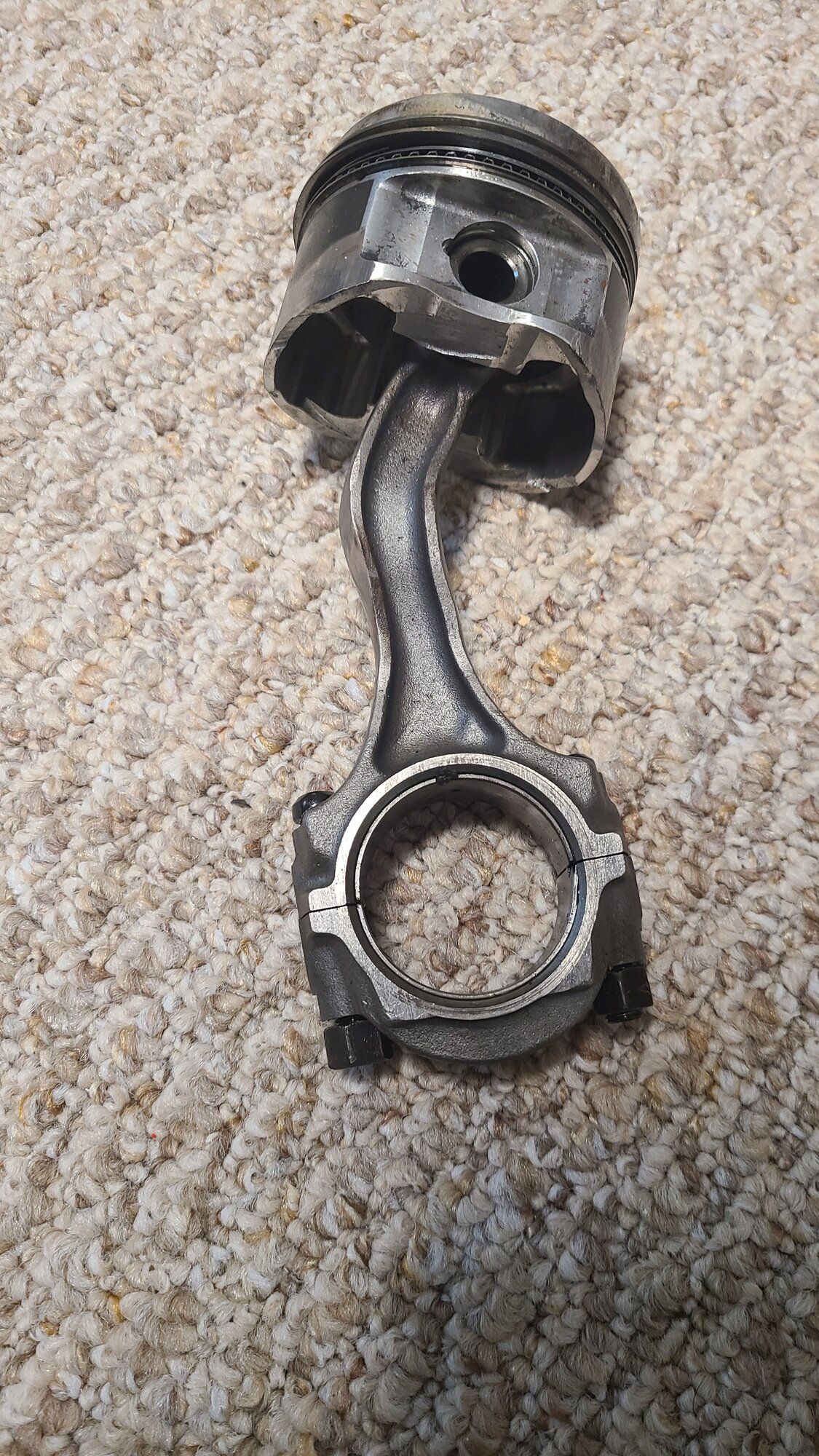

UPDATE #50 - 3/16/2026 - Another Engine Failure

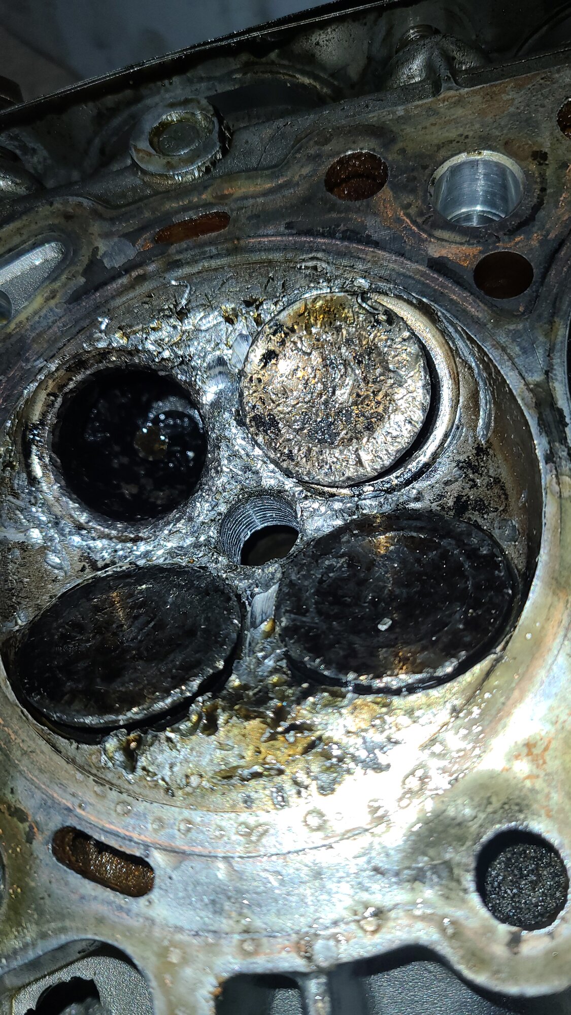

First drive of the spring in 2024 and the car had a bit of an issue after the first high rpm pull. Something happened on decel leading to the damage seen below. Unsure if it was an oil contamination issue, part failure, or what.

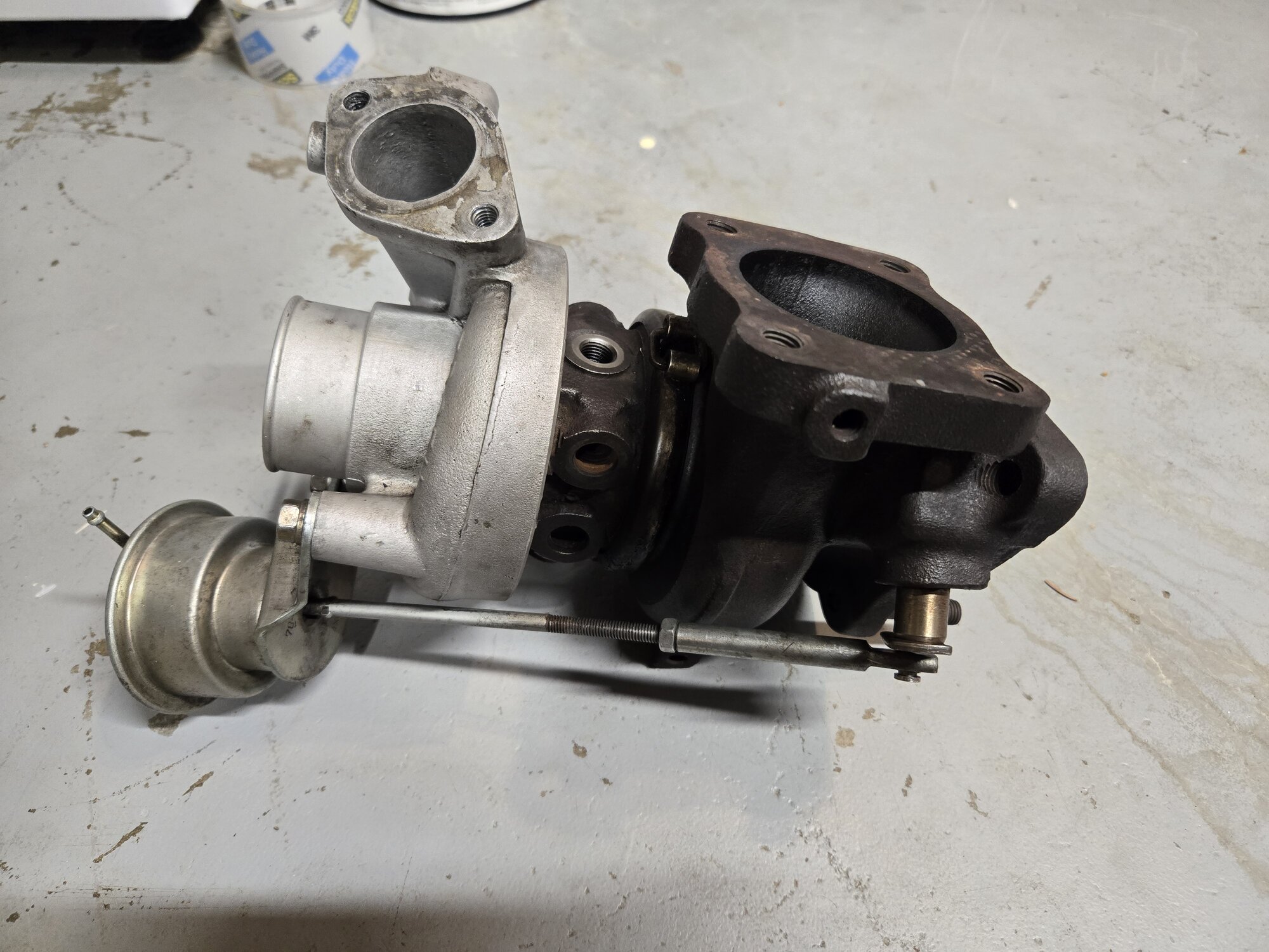

I had a fully stock ~150k mile split thrust 7 bolt that I dropped in to get the car running again. Rebuilt a Small 16g to use instead of the Holset for this stock engine.

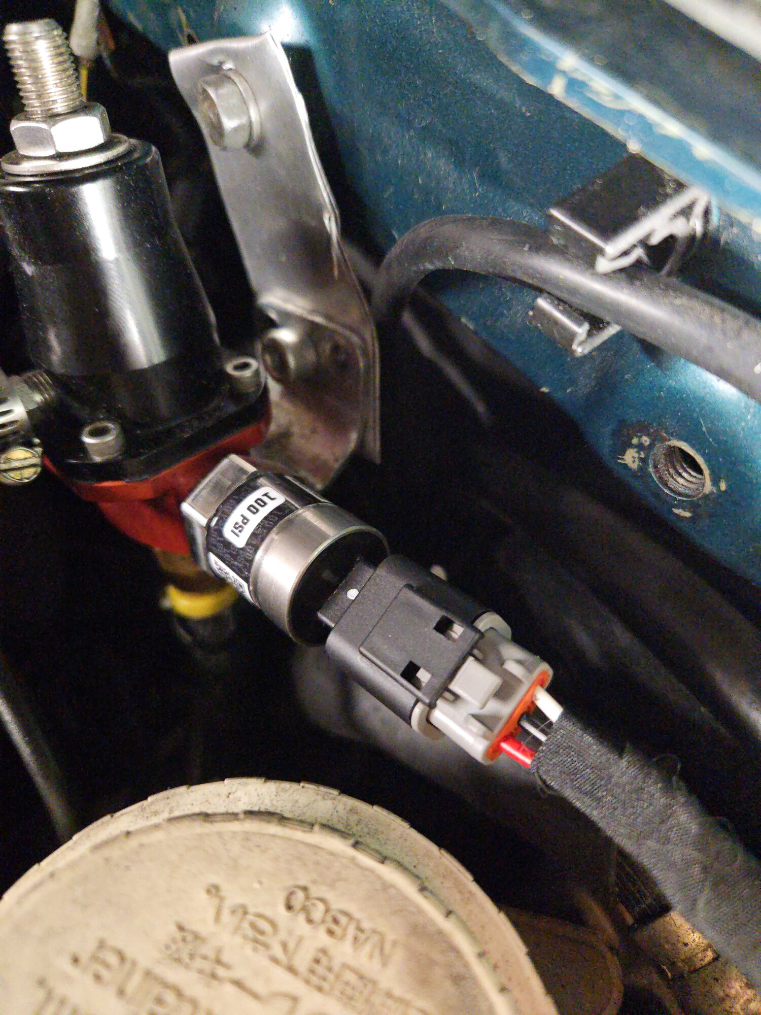

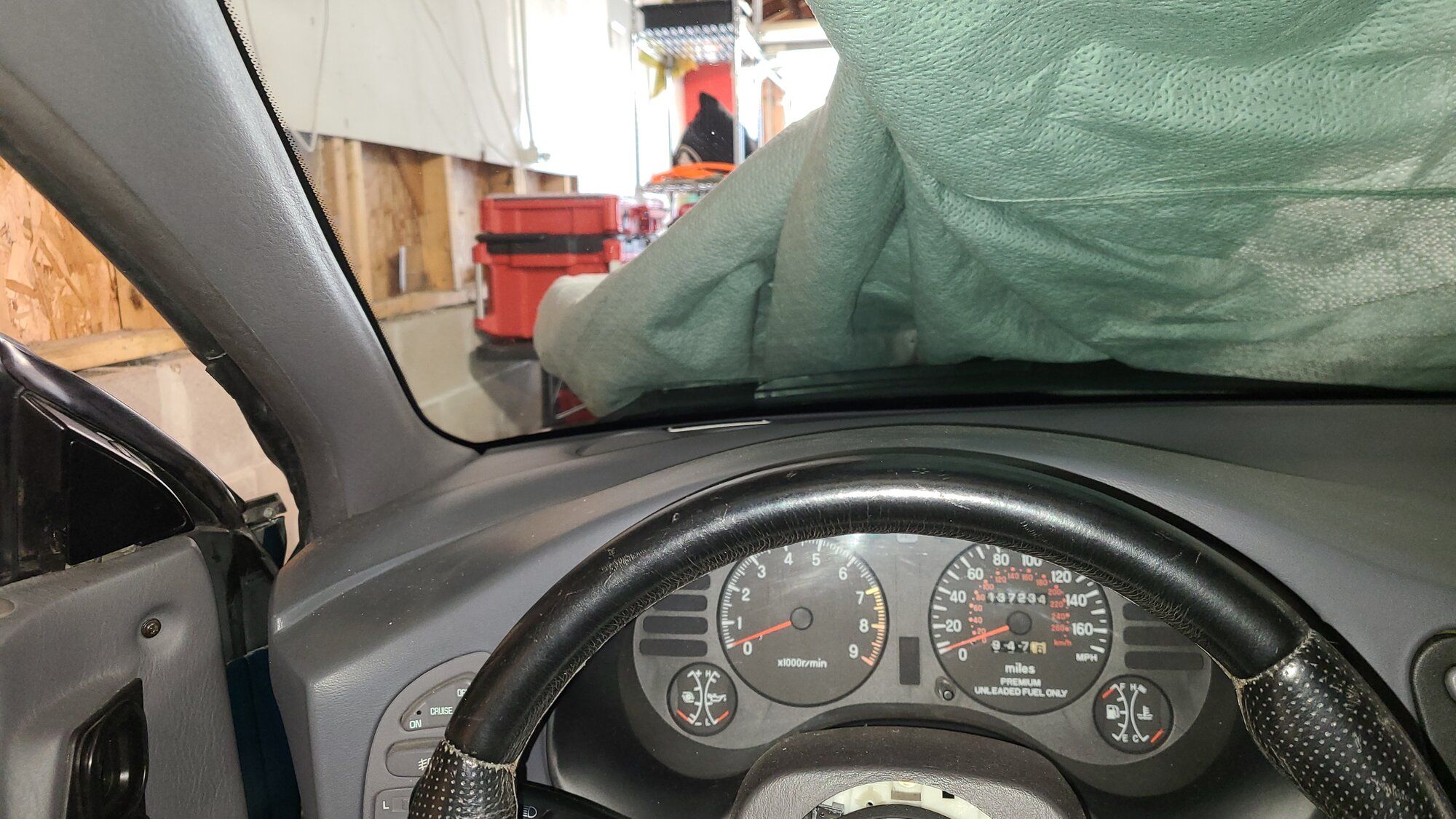

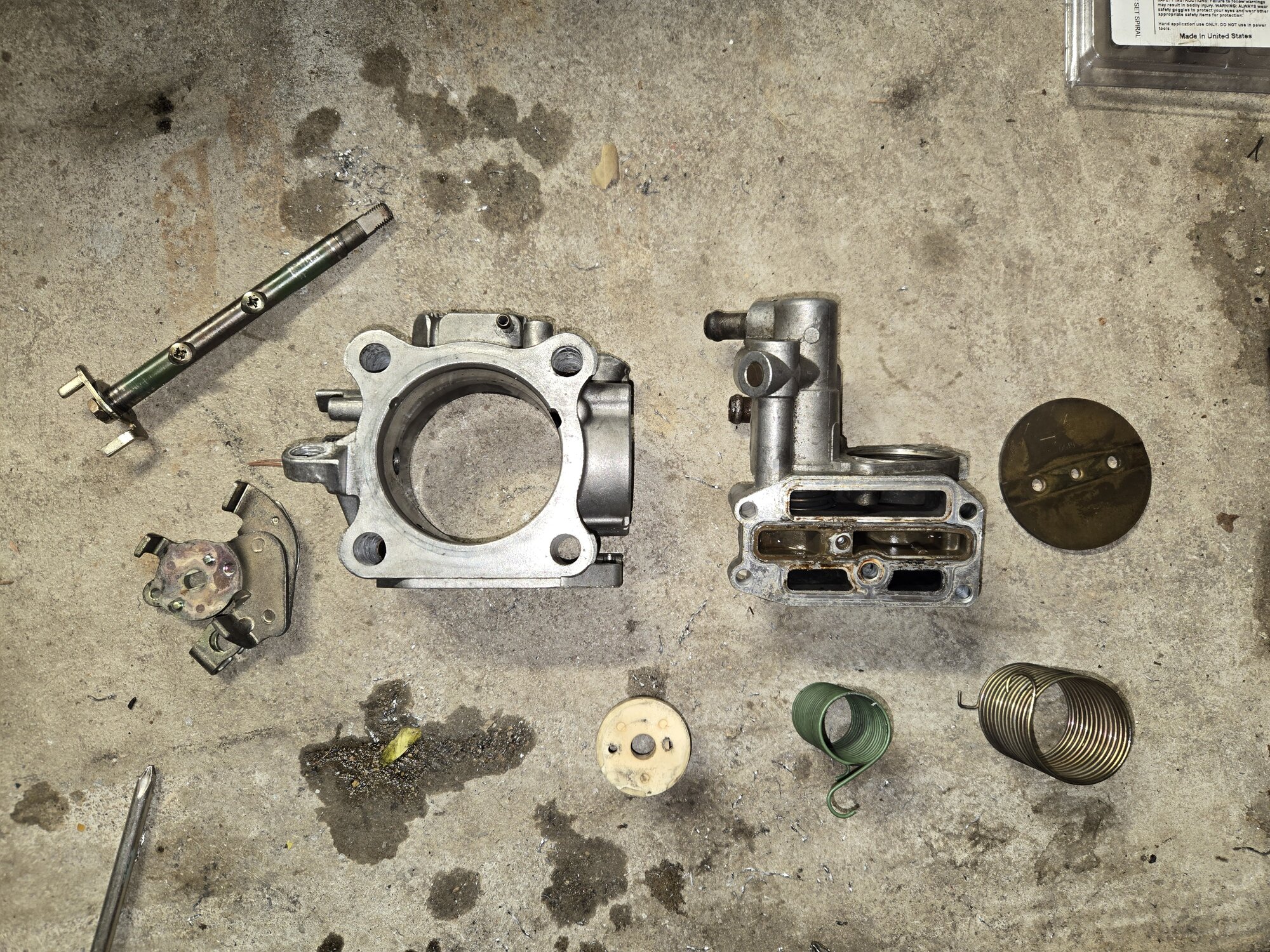

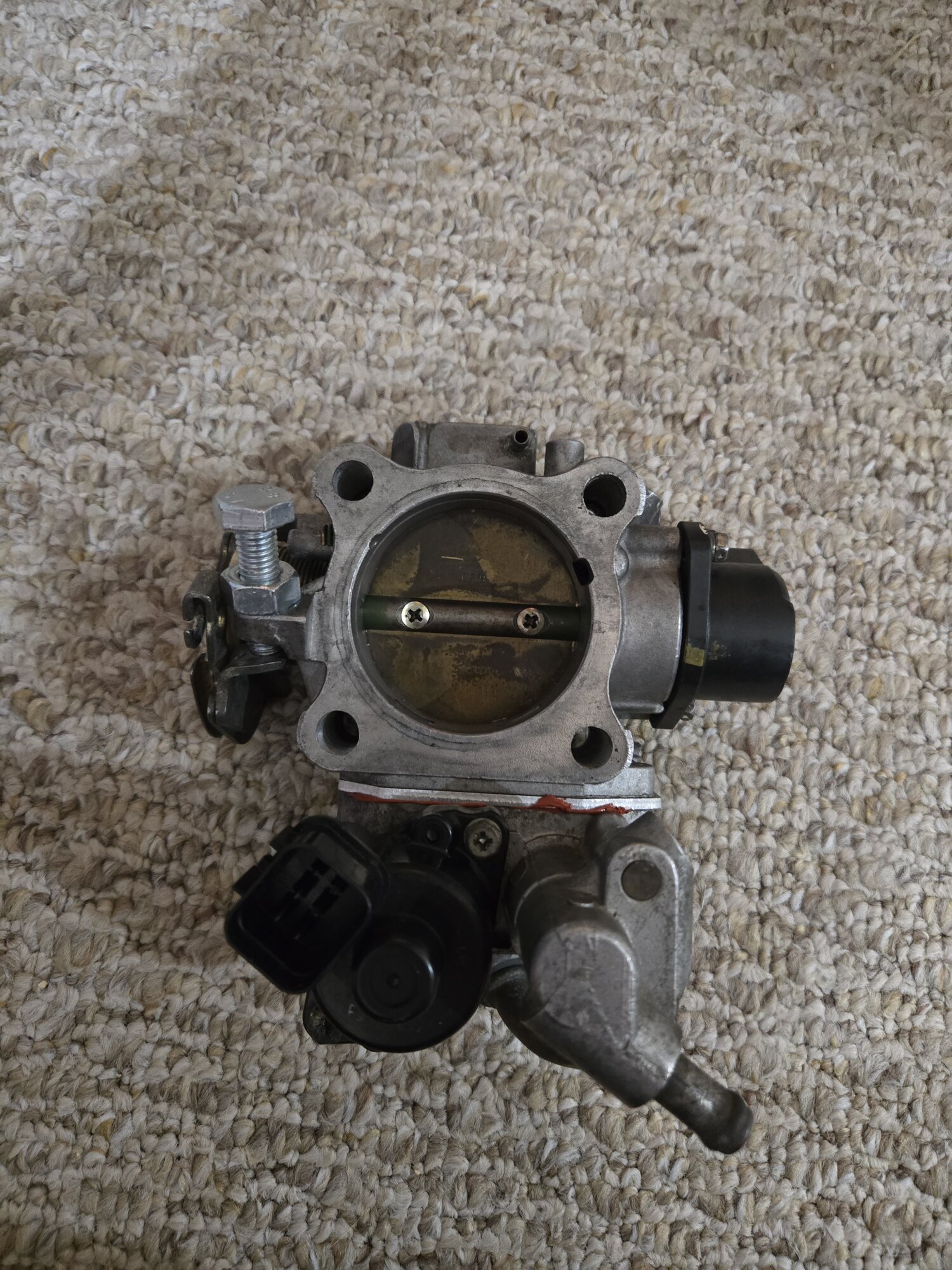

UPDATE #51 - 3/16/2025 - Throttle body rebuild and electronics upgrades.

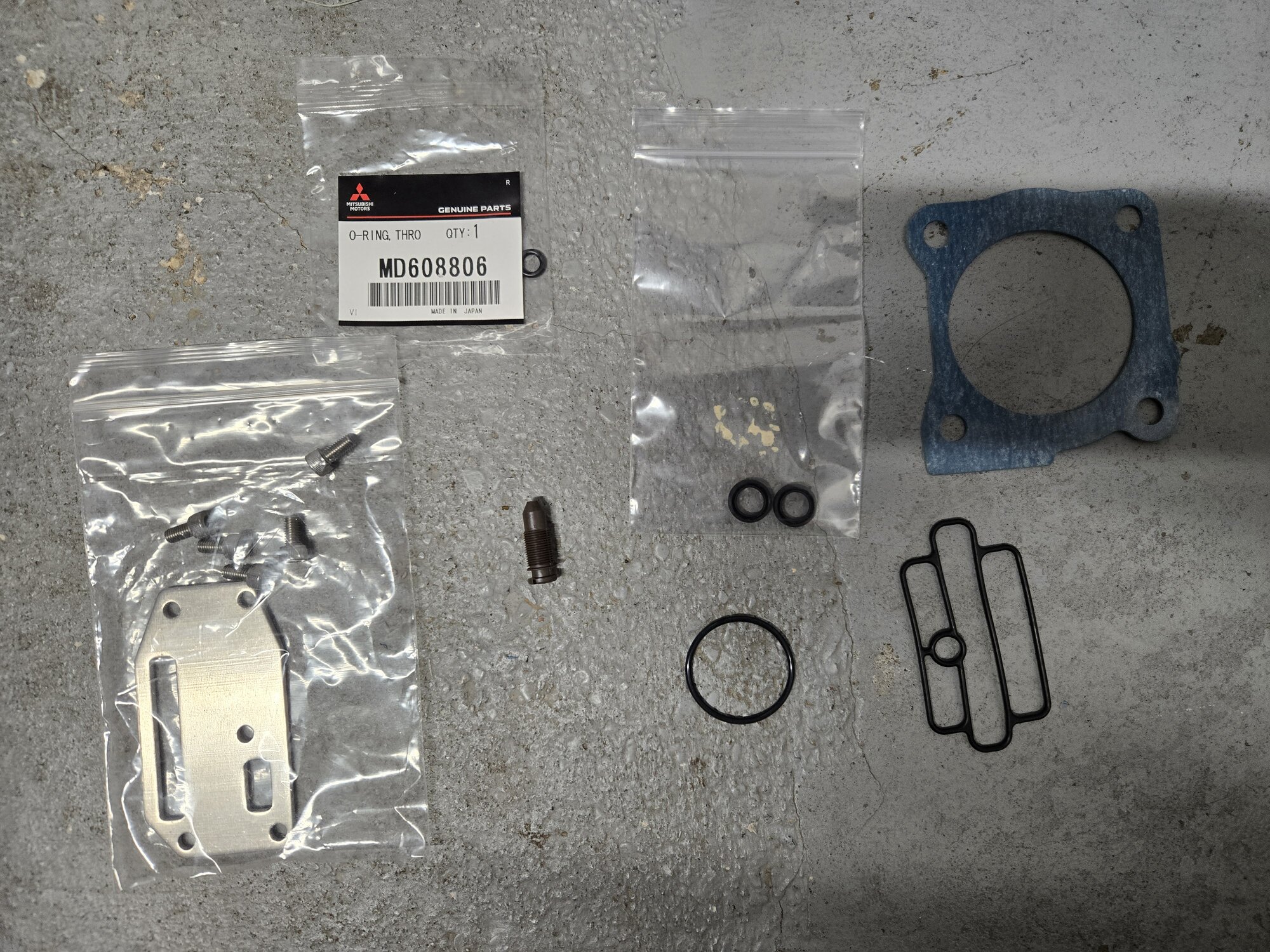

I had been using the 1G TB that came with the car when I bought it years ago. I had noticed the Haltech was showing some weird long term fuel trim behavior at idle. I am assuming the FIAV or worn out seals in the TB were the culprit. Rebuilt the TB and did a FIAV block off to see if that cleans up the idle fuel trims.

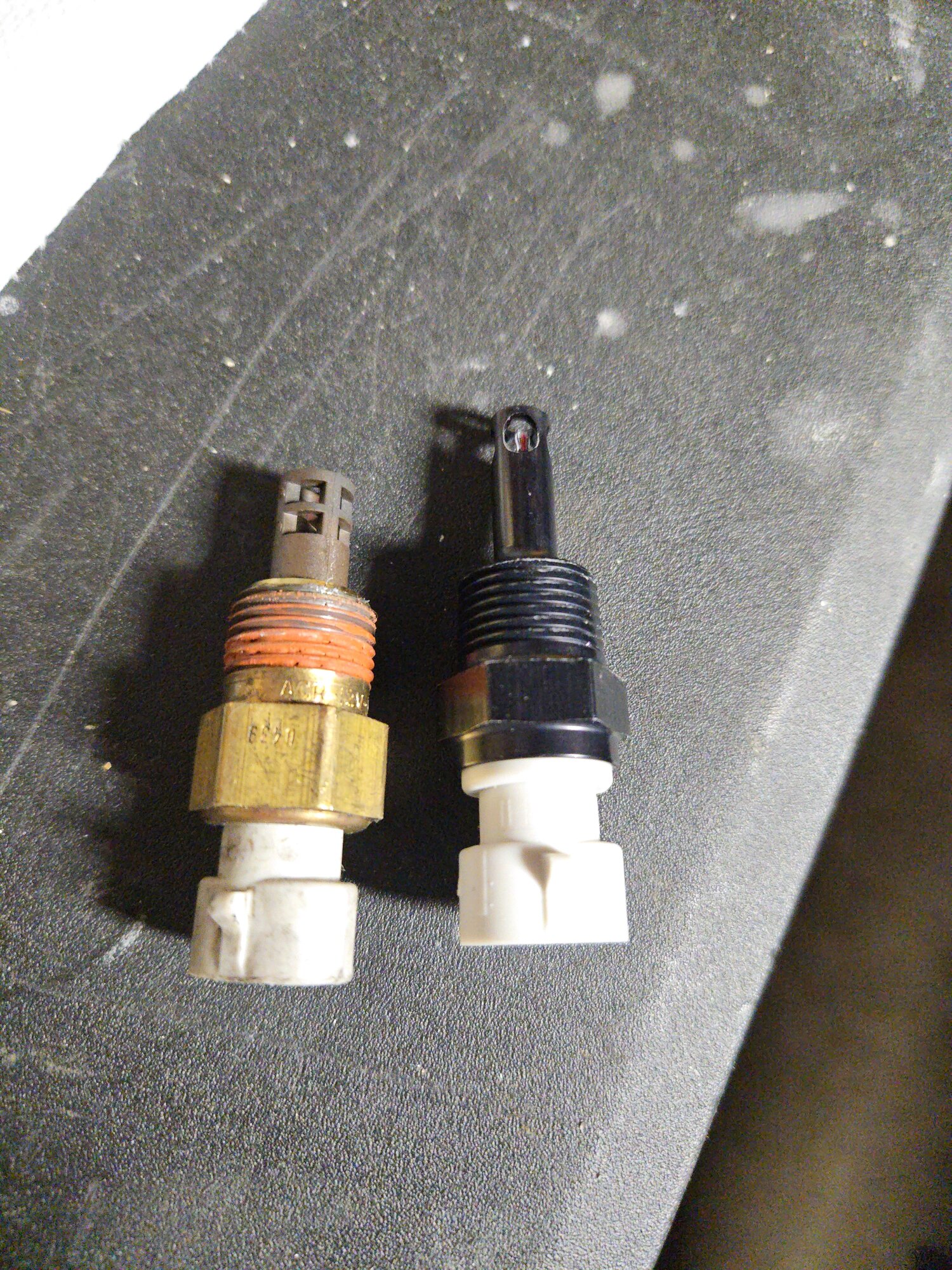

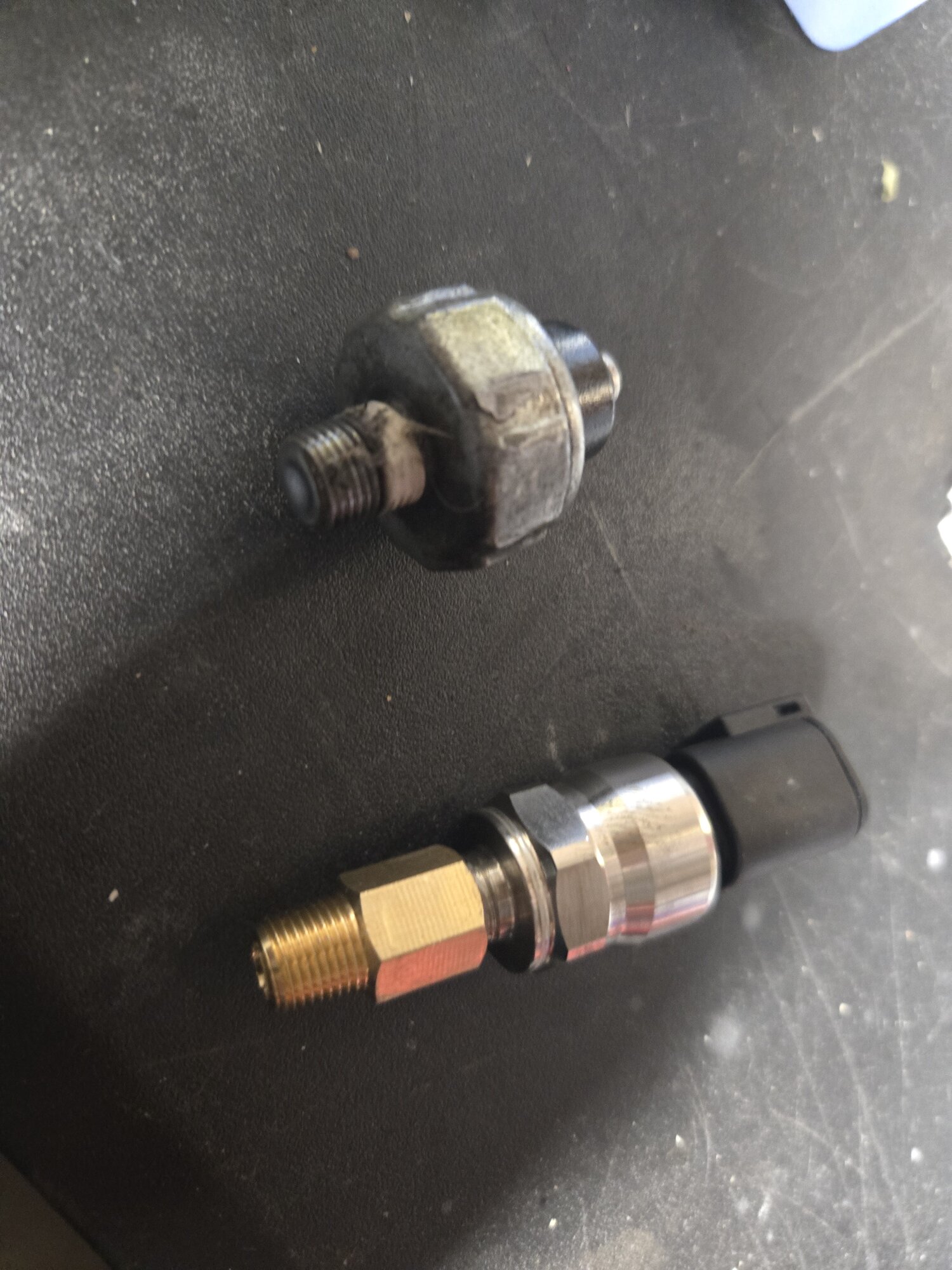

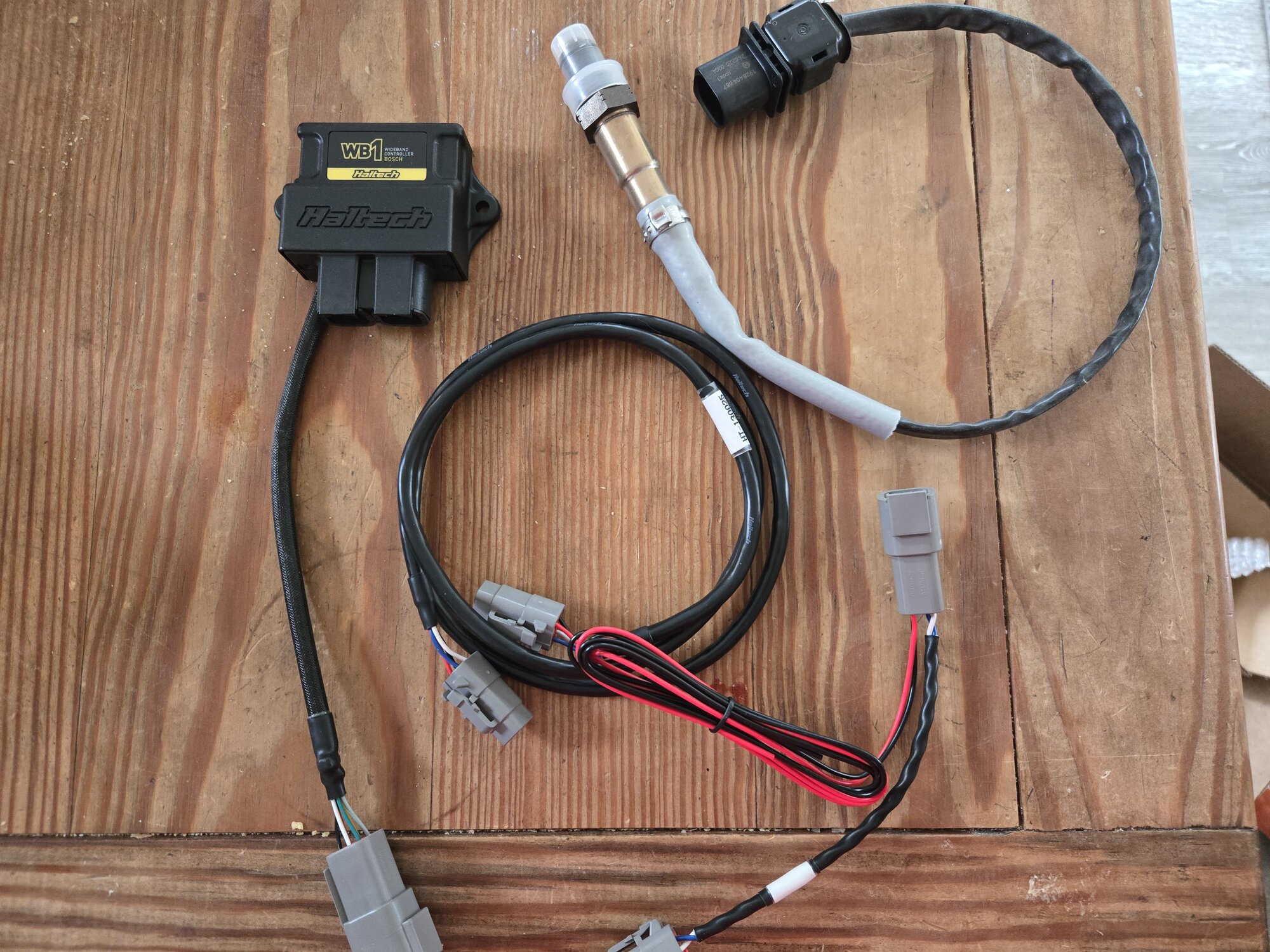

I also grabbed a complement of new, more modern sensors to integrate into the Haltech. Rife IAT, Rife Fuel Pressure, Syltech Oil Temp/Pressure combo and a Haltech CAN wideband to replace the Innovate MTX-L.

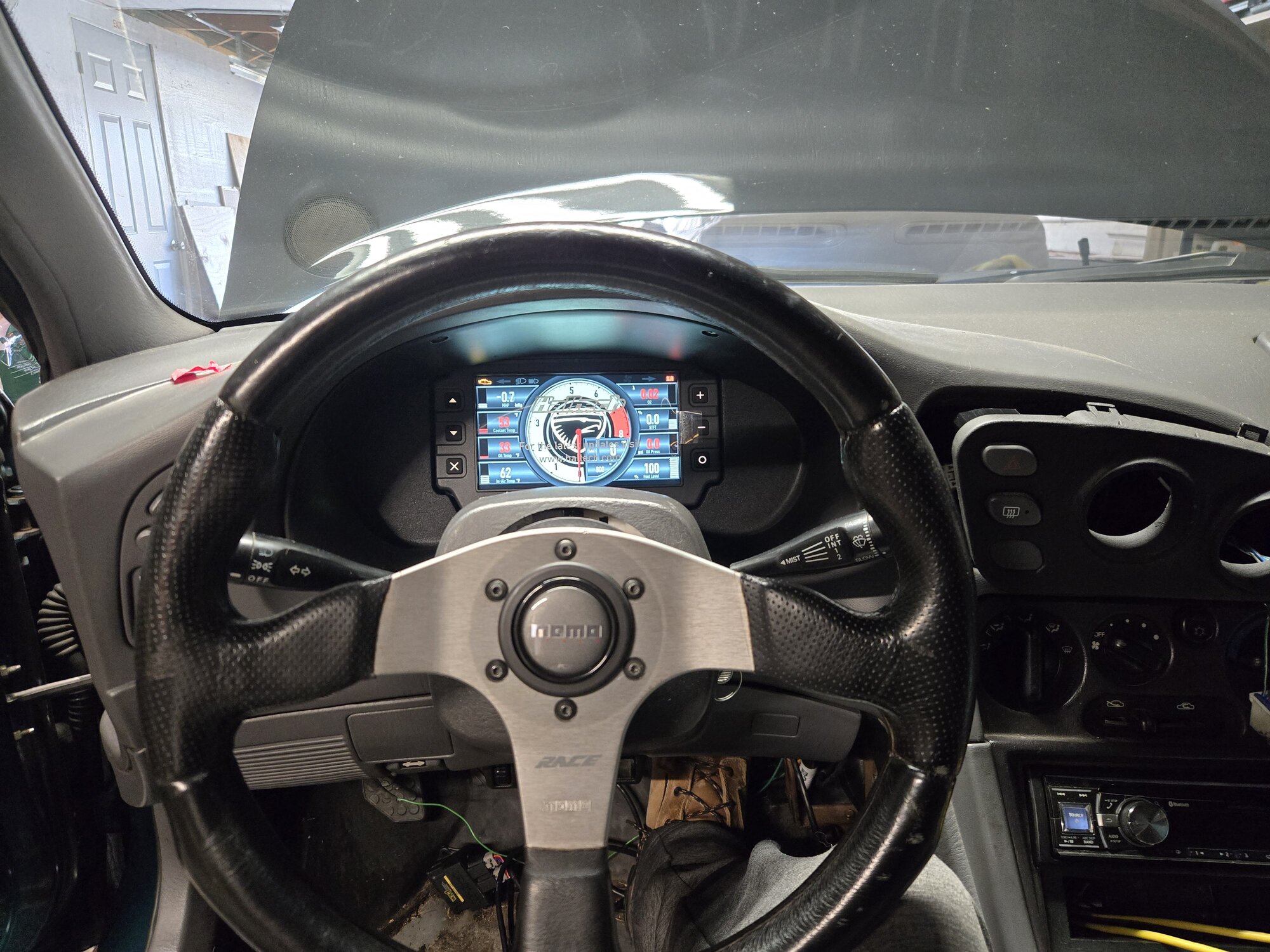

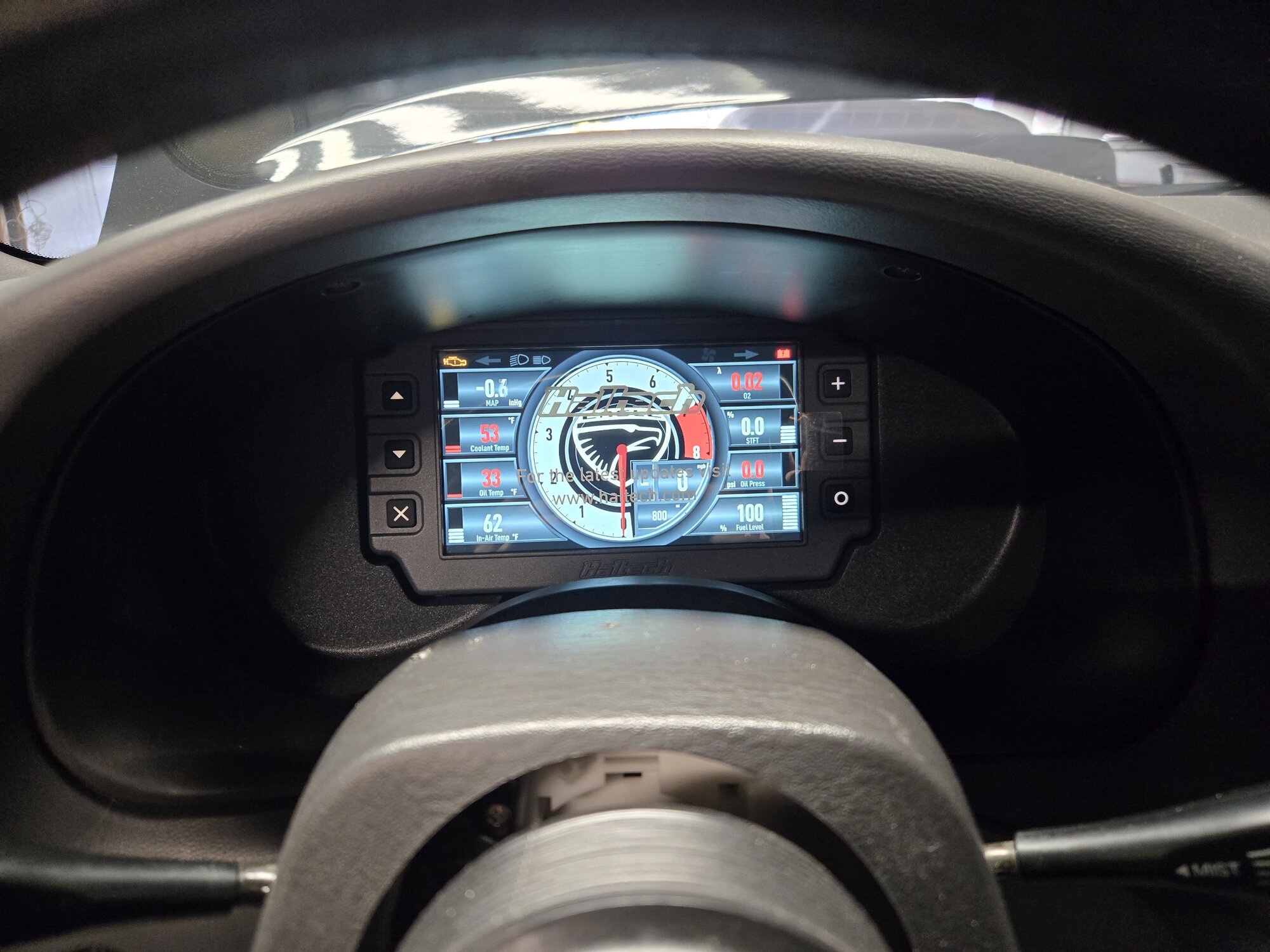

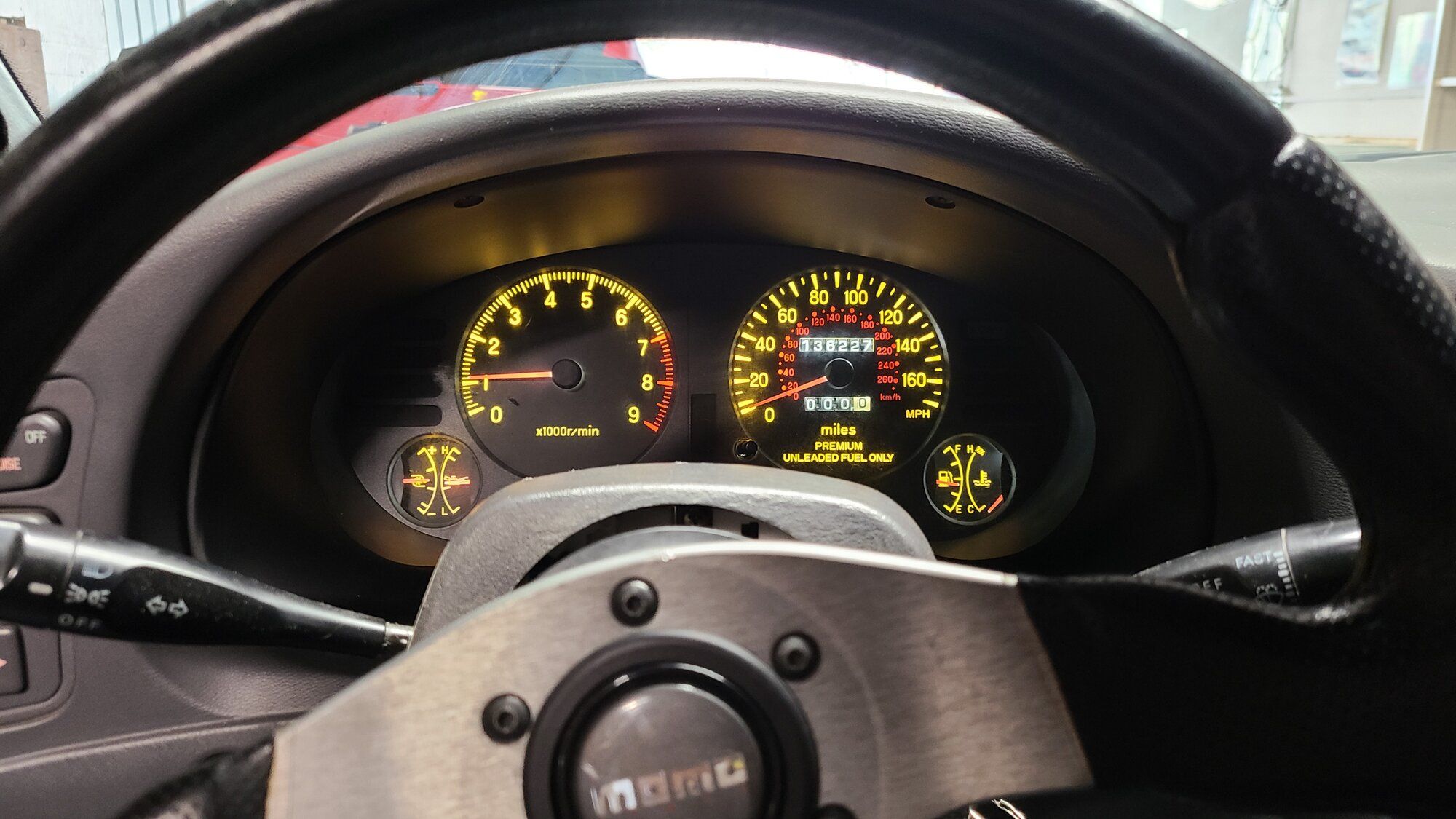

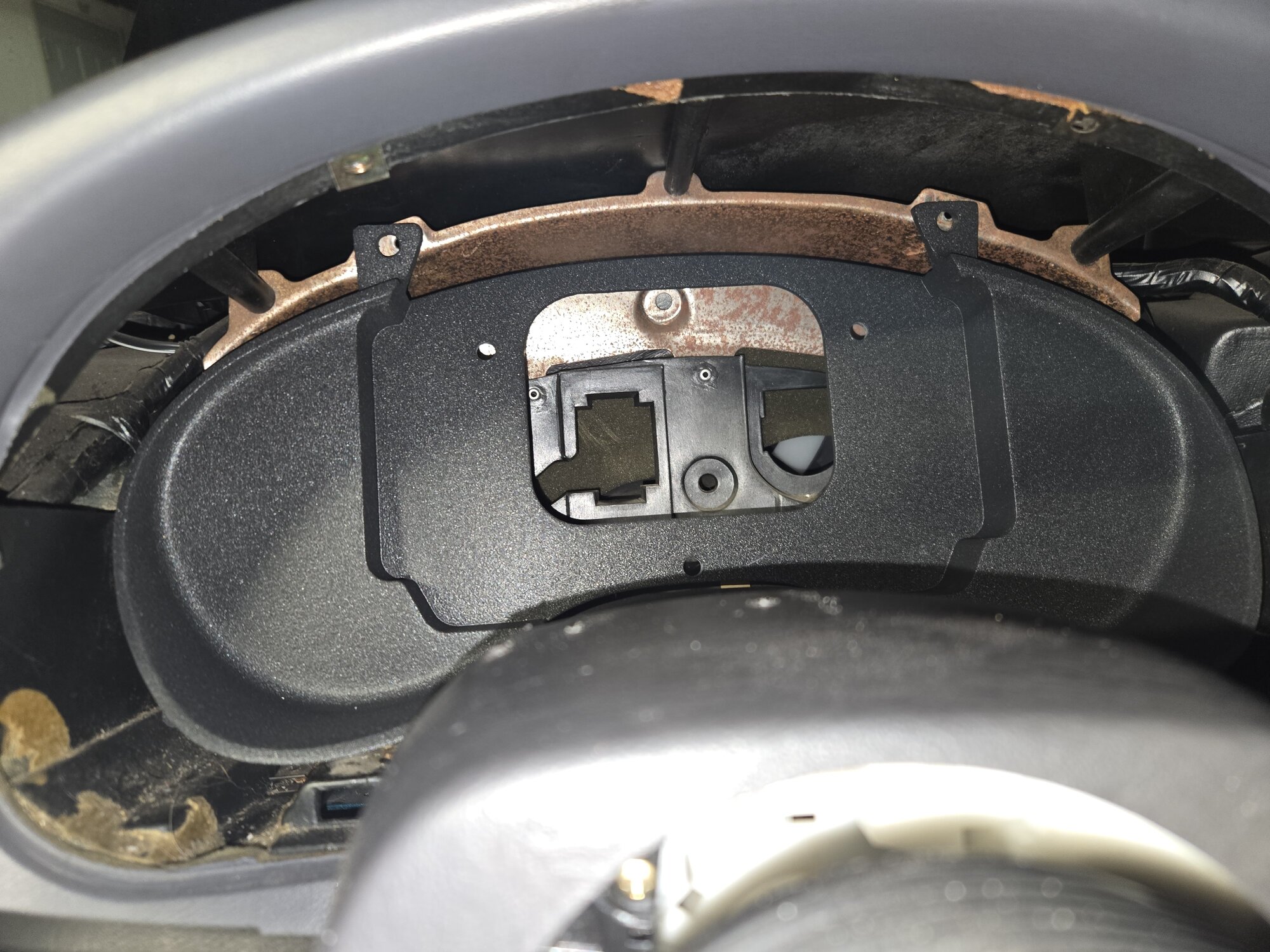

UPDATE #52 - 3/22/2026 - Haltech IC7 Install

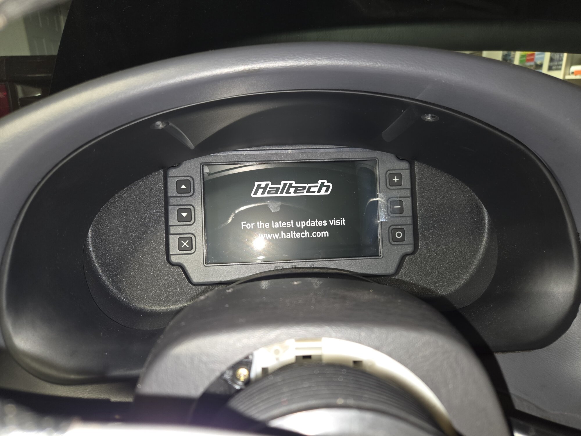

Installed a Haltech IC7 digit dash with the Mako Motorsports 2G DSM dash mount. Install and fitment was excellent. The combination of the Evo3 OFH (single pressure sender port) and Haltech ECU (no factory boost gauge operation, intermittent tach operation), and swapping LED bulbs in without resistor burned a few traces for the indicators etc. My factory 2G cluster was 50% useless in the car, plus more data with fewer gauges pushed me towards the digital dash.
