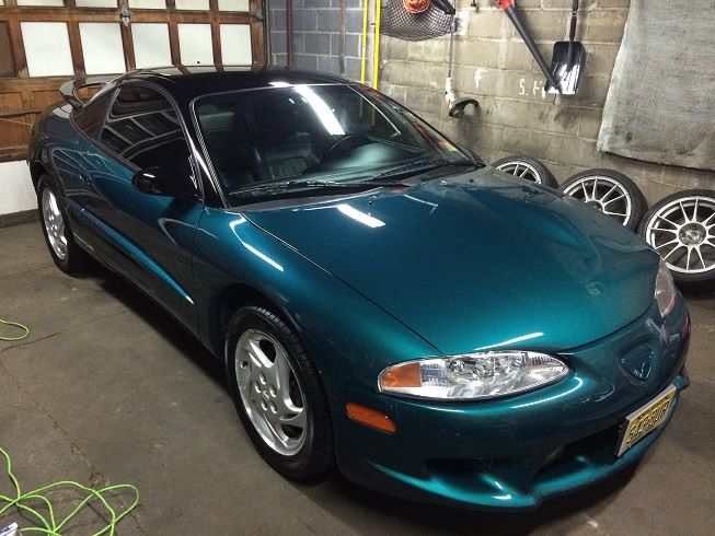

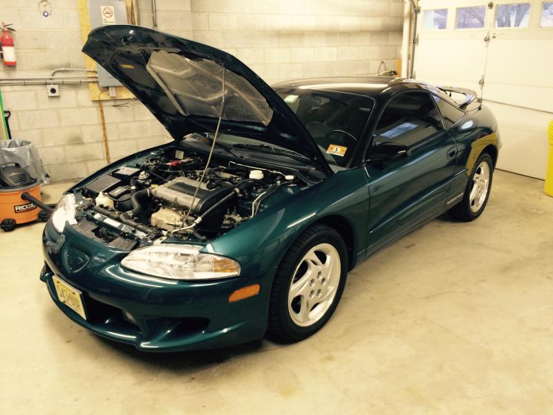

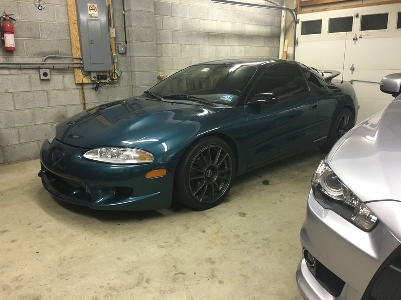

I bought my current DSM in June of 2013. It was near mint, bone stock, and had about 53k miles on it. It was a gem and I was very excited. I didn't need this car to be my daily (at the time) so it spent most of its life being driven on the weekends or sitting in my grage. I think I put about 3000 miles on it the first year that I bought it.
(Pictures are after I completed a two-stage paint correcting detail.)

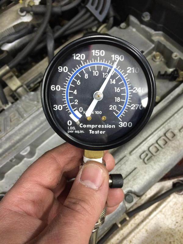

Also, part of buying a used car is checking its health status. While the car did come with many new items like stock brakes, belts, etc., you still never know the health of the motor. I'm happy to say, the compression was damn near perfect across the board.

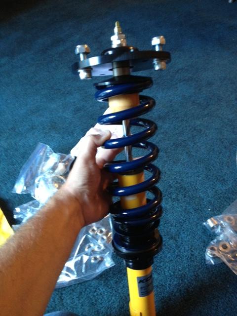

I was lucky to find a set of DG style koni coilovers for sale here on the forum. They were new in the box. The prior owner totaled his 2g before they shipped in. I had to have them so I jumped on it.
800lb front springs with 350lb rear. I had no use for them at this point so they sat in the box for a few months.

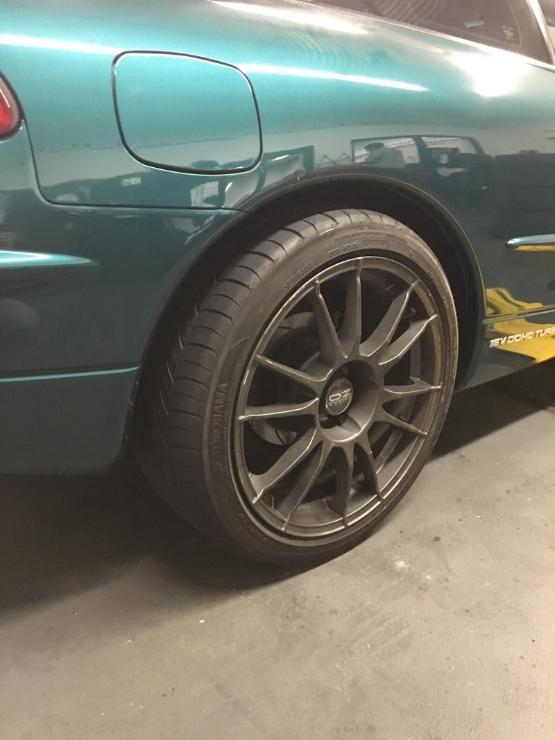

I couldn't leave the car completely stock so I put the coils on as well as a set of rims I had leftover from one of my old Evo's. OZ Ultralegerra 18x9, +35. Each rim only weighs 19lbs. Excellent for an 18. I'm surprised they fit to be honest with you. I had no intentions of over lowering the car so it worked out. Another inch or so and the tires would rub the body while cornering. Tires at the time were 255/35/18 Kumho ASX all seasons.
And this is how the car looked/ran until September 2014 when I bought a house and moved 40 miles away from work.

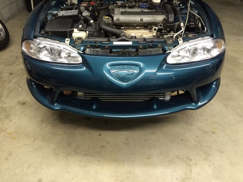

Again, between my wife and I, we had a new Grand Cherokee, my beater Hyundai accent, and my Talon. After moving, my commute went from 1 mile to 38 miles. I'm not going to lie, the Hyundai was not in the best of shape. I could not rely on having to get to work and back in that car, especially during winter months. So, the talon went back to stock and I daily drove it for about 10 months. During this time I collected a few parts: Apex GT Spec 3.8inch catback exhaust, Greddy 24V FMIC, an Evo 9 metal BOV, and an Innovate electronic boost gauge. The easy stuff got installed first, while the larger items sat around while I collected more parts. Adding a mortgage into my monthly bills really slowed things down a bit, but we managed.

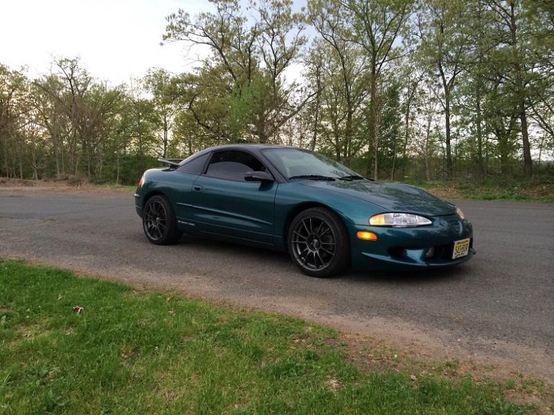

June 2015
I'm back to being single. My soon to be ex-wife and I probably rushed into marriage and it didn't work out. Sucks, but whatever. Talon went back into storage mode and I traded in my Jeep for a new Evo.
Being single again gives you plenty of time to yourself so the RNR Racing downpipe, Apex Catback, and Greddy FMIC immediately went on the car including the prior coilovers and wheels.

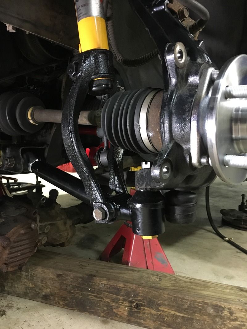

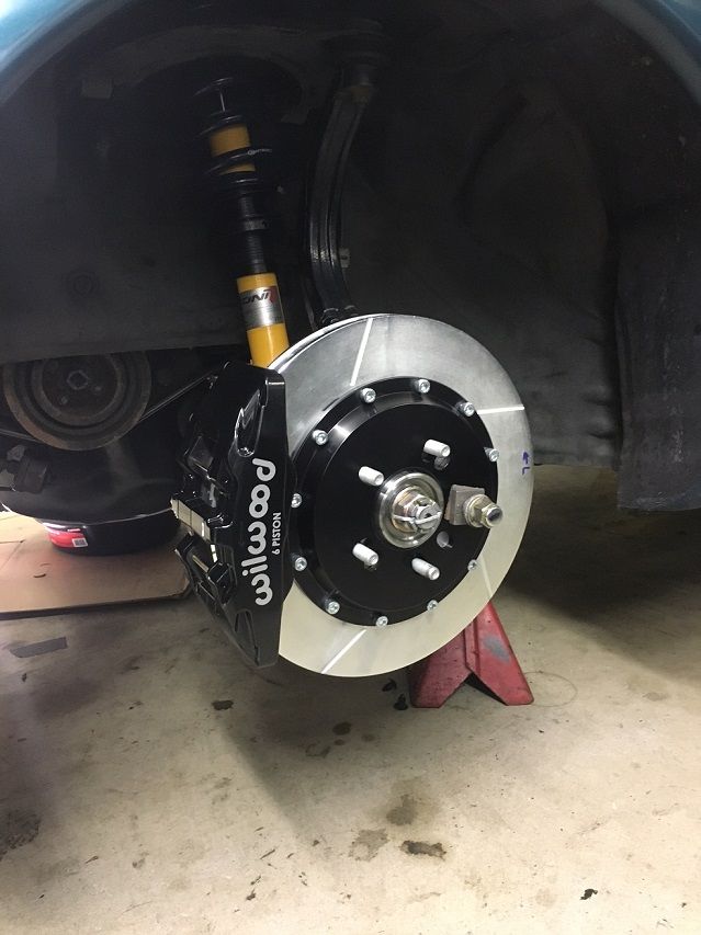

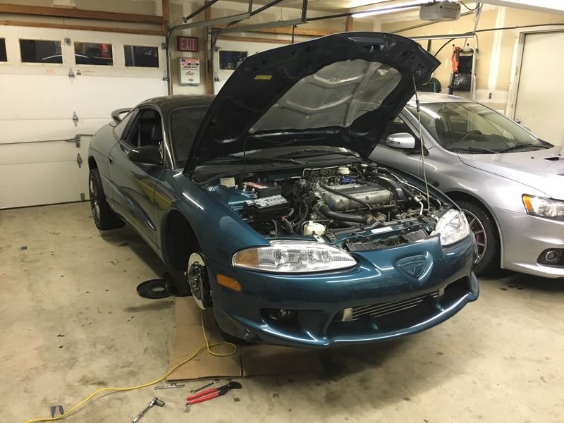

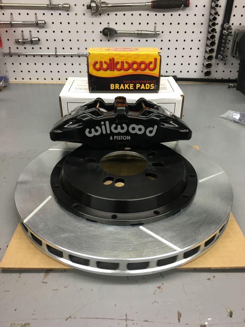

Its starting to get cold out. Real cold. Winter is approaching and I know I don't want to drive the Talon with salt on the roads. Luckily, the new daily can handle all 4 seasons. At this point, the talon's stock clutch started slipping. Among other things, I had some maintenance and mods planned out while the car sat so onto jack stands she went.
Its real nice when you can have the car sit around for a bit while you get to work on it. I'm used to rushing to get things done so I can get to work the next day. Never again will I heavily mod a car I have to commute in. Its way too convenient to work at your own pace.

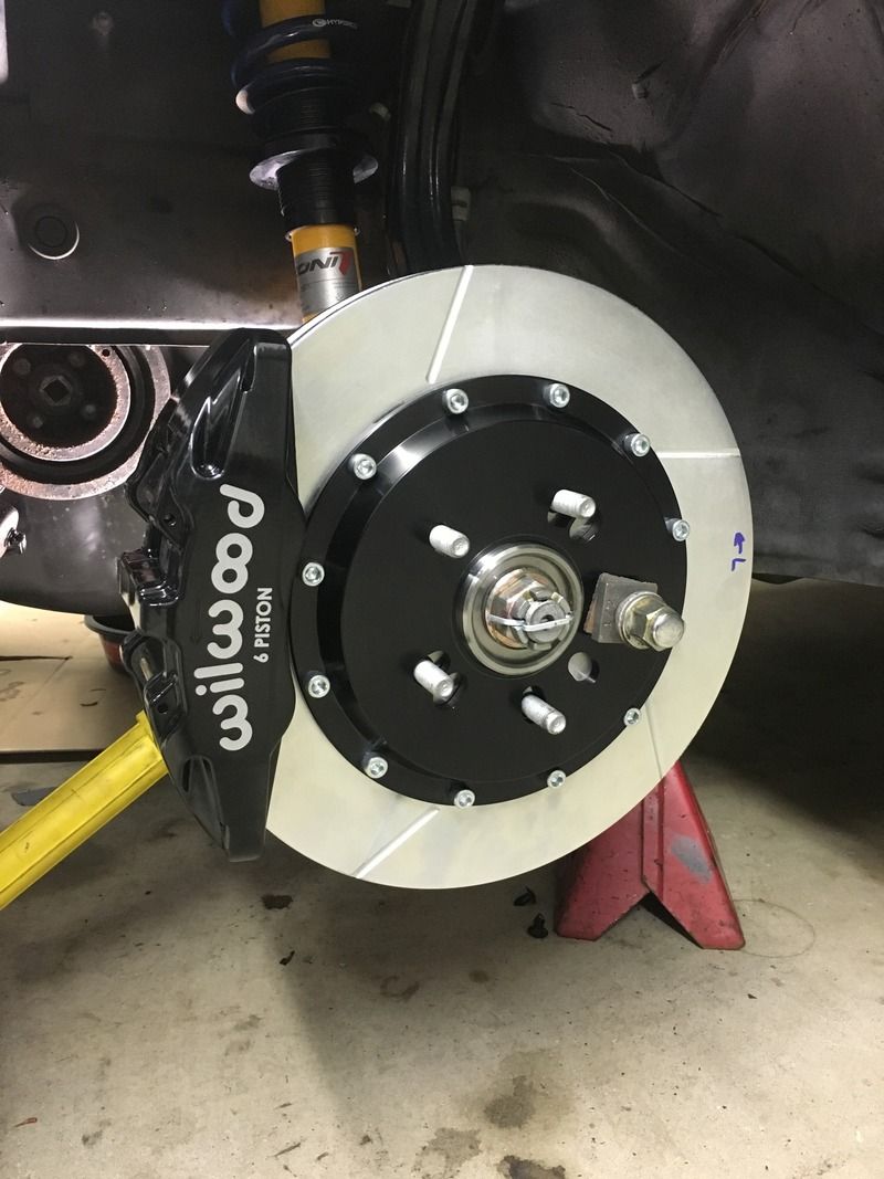

The winter work season included the following:
  • Southbend SS clutch kit with sprung full Ceramic disc. (Tim Zimmer is good Man.)
  • Paul Volk tubular front control arms. (Paul is also the Man.)
  • RM Racing front and rear anti-roll bars.
  • TCE/Wilwood Plus 4 BBK.
  • Slotted Rotors and Hawk HP+ pads for the rear.
  • SS brake lines front and rear.
  • New inner and outer tie rods.
  • New front wheel bearings
  • Redlines fluids for the drivetrain.
  • Flush brake fluid with high temp racing fluid. (Cant remember the name of the stuff I used.)
  • New clutch master and slave cylinder.
  • Rebuild my leaky throttle body and boost leak test.
  • Plus a few random things I can't remember right now.
  • Get an alignment.
Needless to say, I had my work cut out for me.

The Kumho tires I originally had on my wheels were showing their age. It was time for a new set, and NOT all season tires. On goes 245/40/18 Yokohama Advan A13C. Despite the size difference, only 3mm narrower than my 255's and with a 180 treadwear index, much stickier. I sorta got these for free as I took them off my Evo X to put on winter tires. Only 2500 miles on them at this time.

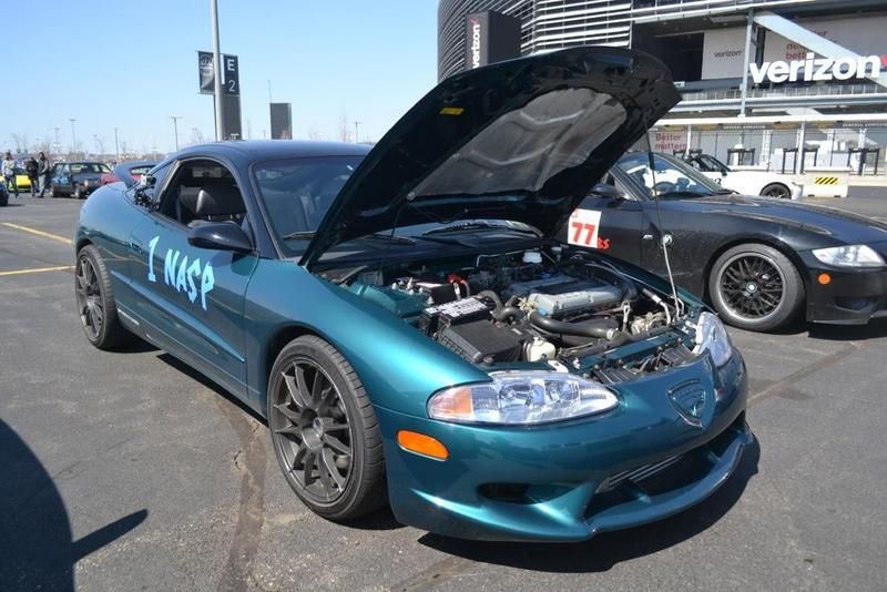

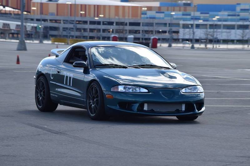

I took about a week or so to set my ride height and off to the alignment rack she went. Sorry, no pictures here. I'm itching now to start autocrossing. I sign up with Motorsports Northeast. www.motorsportsne.com They are a local club that runs at Metlife Stadium, about an hour from my house. I'm ready for our first event on 3/20/16. With my luck, the event gets cancelled due to snow in the forecast. Snow! It was 70 degrees a few days prior. Well, the snow never came and we lost out on the event. I'm kind of pissed, but whatever. I'm already registered for the next event on 4/3/2016. But, I'm itching to autocross now. I temp register with the SCCA and run their season opener on 3/26/2016.
I had a f***ing blast autocrossing. I went once for fun many, many years ago. Nothing to cry home about so I was a bit nervous. I ran in NASP (Novice ASP) and came 3rd out of 6 cars. I was barely edged out by a 370z on Toyo R888's and 330whp. 1st place went to a really really fast BMW 1M on slicks. He crushed us by over 3 seconds.
Out of the 25 novice drivers, I came in 4th. I was actually very surprised and happy for the day. That was until I got home and watched my videos. My driving lines were terrible! I could have easily came in 2nd in my class and 1st from the novices. (My 4th place PAX, I had the 2nd fastest RAW time.)
