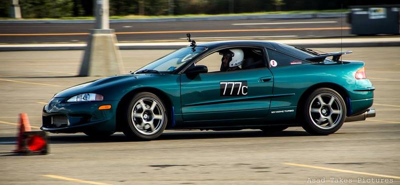

First event from July was on 8/21/2016 with MSNE. (the above video) Loved the course. Could stay in boost for nearly the whole run, minus the first 3 turns. Car felt great. I was confident in my driving and all my times kept me in a podium finish for Class C. I ran multiple 50.0 sec runs which would have secured me in 2nd place. Last run is up and I decided to drive balls out. If you're not spinning, you're winnin. LOL Run felt super awesome and the timing board lit up a 49.554 time. I was ecstatic. Felt good to sit in 1st place. I knew one of the instructors did not finish his runs just yet, but he always beats us up in Class C so I didn't care much to lose to him. He ran his last few runs in the 2nd heat and was able to manage a 49.7xx. Whoa! Did I just beat Konrad? I was even more excited.
Now here comes the sticky situation. The club was having computer problems the whole day. Either the logging software would crash or it simply would not record the times. Re-runs galore. While I was packing my car up, getting ready to work the course, my brother let me know that my fastest run was not showing on the computer. What?!? I walked over and spoke to the club organizers. I told them what I had ran and explained that my brother, a friend, and a few of the other racers saw my time as I passed the finish line. No problem, they understood the computer was having problems today. I kept my time and got my first place trophy. I was also top PAX for the day.
When I got home, I checked the club's website to check my times. All was well. I ended up checking again a few hours later and noticed that I got bumped to 3rd in class and 6th in PAX. I messaged one of the organizers and he let me know that he was able to recover the crashed files and I coned on my last run. Nooo!!! LOL I'll be bringing the trophy back at our next event.

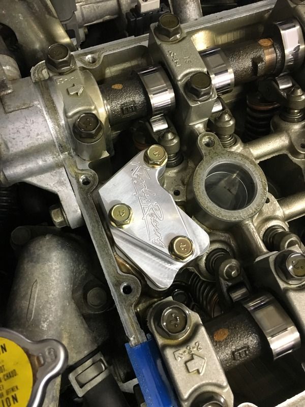

I've been running a catchcan on the car for the last 2 events since I noticed a ton of oil in my intake and intercooler pipes. The catch can nearly got full at the last event! I think I'm just overfilling the motor with too much oil. Better safe than sorry. I ordered a Kiggly HLA and it should be here today. I'll get it on after work and hopefully that stops the oil from puddling in the head.

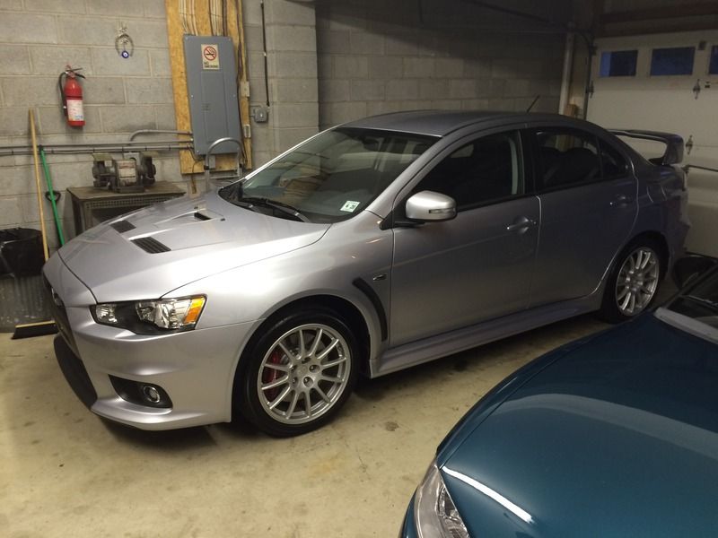

I'm back to being single. My soon to be ex-wife and I probably rushed into marriage and it didn't work out. Sucks, but whatever. Talon went back into storage mode and I traded in my Jeep for a new Evo.

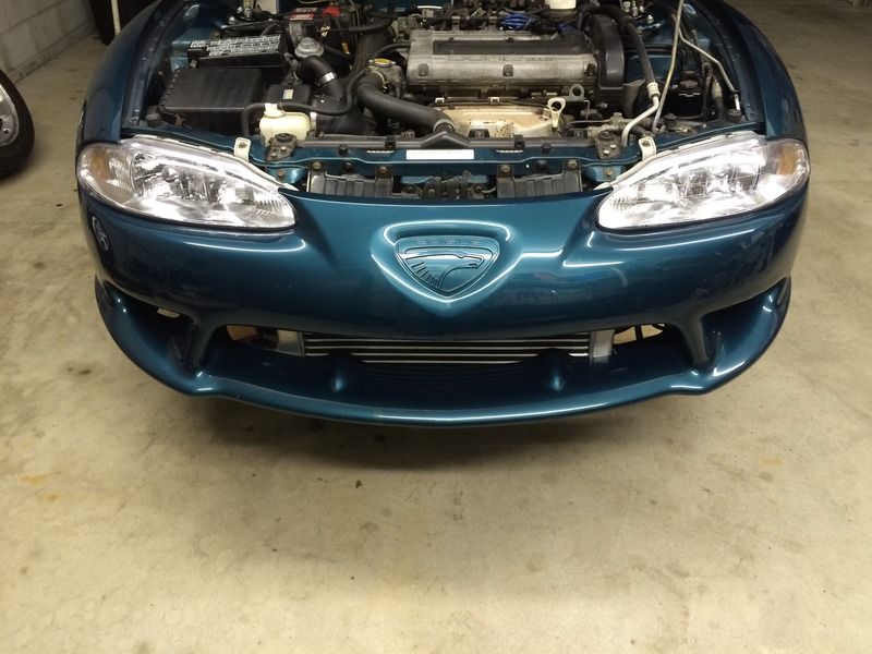

Being single again gives you plenty of time to yourself so the RNR Racing downpipe, Apex Catback, and Greddy FMIC immediately went on the car including the prior coilovers and wheels.

So i'm up on the fence about the kiggly HLA. Not that it did anything wrong, but I had hoped it would combat some of my blowby coming out of the VC, mainly the oil that is accumulating in my catch can. I assumed less oil in the head would mean less oil in my catch can. When I ran up at Deven's (more on that later) nearly zero oil got into the catch can. This included 11 runs with two very high RPM sections. (70+mph in 2nd gear) I thought I was in the clear. Last weekend at a local event, 80% of the catch can filled and oil looked like it was blowing by the seal of the oil cap. Ugh. Back to the drawing board. The only thing I will assume now is that I have a bad PCV valve and its allowing boost into the VC. Next winter, I will have to build a dual catch can setup as I did on my old GSX.

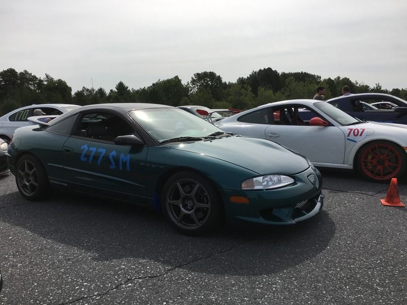

The venue is a decommissioned Army airport base. Its the main location for all things autocross in Massachusetts. Its also about 4 hours from my house so driving up the morning of did not make any sense. An autocross buddy of mine and I hit the road Friday after work and spent the night at a local hotel. Sam Krauss, my DSM autocross guru, also joined us for the event. He sent me the invite initially.
This was NCR Porsche Club's event # 5. The course was setup up relatively fun and they did use as much of the space as possible. There is only 1 main runway and a few taxi roads with a large open section near the tower. The start was setup so that launching hand no affect, left to right to the start line followed by an offset slalom. This led into a very understeery (sp?) right hander onto the runway with a few left right transitions including this one left hander that looked like it had a half chicago box with the cones purposely setup so you plow into them. (Ask me how I know) Next were a few more left right transitions into another right hander onto to the taxi road. 3 walloms followed by 90 degree right hander. This is where it really got fun. A small right handed sweeper into a left handed sweeper, HARD ON THE BRAKES for a split second, followed by another right sweeper into a little jook right before the finished line. This last section was fast, hitting the rev limiter nearly both times, before and after braking. It was fun.
Going to events with Sam is always a blast because he's such a good driver and he is willing to help. His instruction helped me knock off nearly 2 seconds from my times. Started off the day in the 67's, got down into the high 64's, and dipped into the mid 63's. I kept hitting the last damn cone in the stupid half chicago box so my fastest clean was 65.5. Ran a bunch of 64's and a best of 63.6 +1. I hate hitting cones, but Sam's instruction goes a long way so i'll take the 2 seconds plus 1 cone and try to lose the penalty next time out. LOL My clean runs paxed me 42 out of 71. Really shitty, but i'll take it as a learning experience. Had both my 63 sec runs been clean, I would've been top 15. But, no excuses. It was fun. I'm happy.

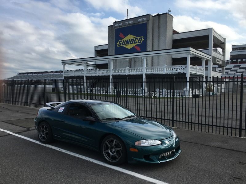

With that being said, I feel like I drove like shit today. I didn't get a chance to walk the course because my first work station was working the entry gate. I did get a bit lucky in that the other 5 cars in SM were just as under-prepared as my car is for that class. We were all on street tires except the Genesis on slicks. My first run, despite not walking the course, was good enough to win the class. I got a bit quicker, but kept hitting cones. I had a talk with myself, yes myself, before my last run and more or less told myself to stop being a *****. Last run ended up being a clean 75.4, my fastest time of day, and put a 2 second gap between myself and second place. I truly feel like the car had 73's in it, just not the driver. I'll get there one day.
