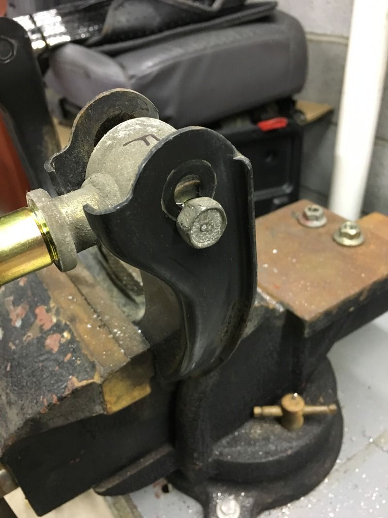

So I need more negative camber. With my current drop and Paul Volk's lower control arms, I'm currently at -1.7 degrees up front and about -1 in the rear. I'd like to be between -2.5 to -3 up front with around -1.5 in the rear. The rears are easy to set by removing a few washers from my homebrew camber kit. The front is a little more difficult, especially since I'm not a fan of what DSM's have available in aftermarket parts. I will not run the adjustable balljoint. I don't like the fact of it hitting the chassis on full compression. The eccentric bushings shift over time, but what other option do I have. I bit the bullet and ordered SPC eccentric bushings only to have my money refunded with the distributor claiming they aren't made anymore. Great! I then tried to order SPC anchor bolts with the eccentric bushing built in, but could only find 1 bolt on amazon and nothing anywhere else. Wonderful! I called SPC and left a message, but haven't heard back from them yet. I'd bet they too aren't being made anymore.
The last resort I had in mind was to cut and weld my control arms. Seems like a great idea and is more of a permanent fix. Unless the arms fails, I shouldn't have any of the usual issues found with camber kits. After doing some research and removing my upper arms, I decided against it. I don't know how to weld and without me being there and measuring and making sure the welder does a good job, I didn't feel comfortable with having someone else do it. I have buddies who can weld, but they are not welders by any means. I then came across a thread on ecmlink's forums about a guy who re-drilled the mounting points on his control arms. Make sense. Drill new holes so the arms sits further into the car. Seems easy enough. So out came the measuring tape, drill, and drill bits.

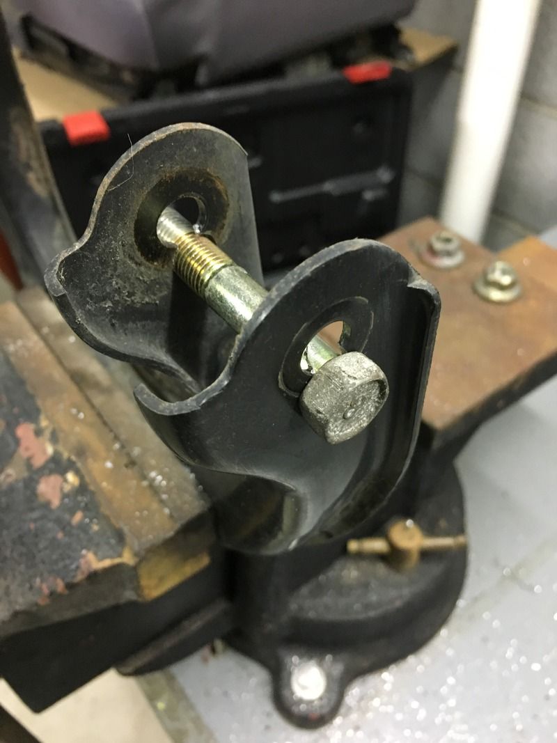

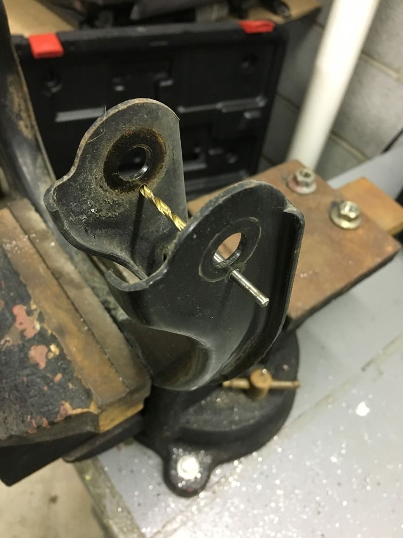

Made a measurement for exactly 3/8th inch from center of current hole to new hole. Being careful that I made the angle the same on both sides. This was a little nerve wrecking but after test fitting my driverside arm, I had no binding.
Gradually worked my way up until the bolt was able to pass through.

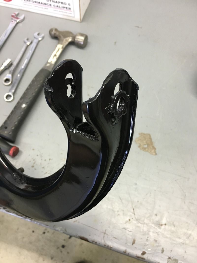

Semi finished product.
The arm extension doesn't seem to contact the body. But, I do have to grind away a bit at the "valley" where the anchor bolt travels through as it gets caught up just a little bit on full extension. I'll have a buddy weld some washers around the new holes for some strength as well. Trying to get this done as soon as possible and get an alignment done before the May 1st event. :crossing fingers:

Welded up and freshly painted. I had to grind the arms a bit so the anchor bolt can travel freely and ends of the arms don't make contact with the body. So far so good after 250 street miles.

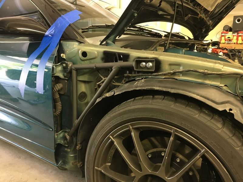

After a few years of haggling Kevin for his fender braces, he got in contact with me and got me on the list for a set. I jumped at it. Was anticipating these for a long time. Very exciting.
Yes, I have painter's tape holding up my door. (put these on myself, until I had to set up the door lines.)

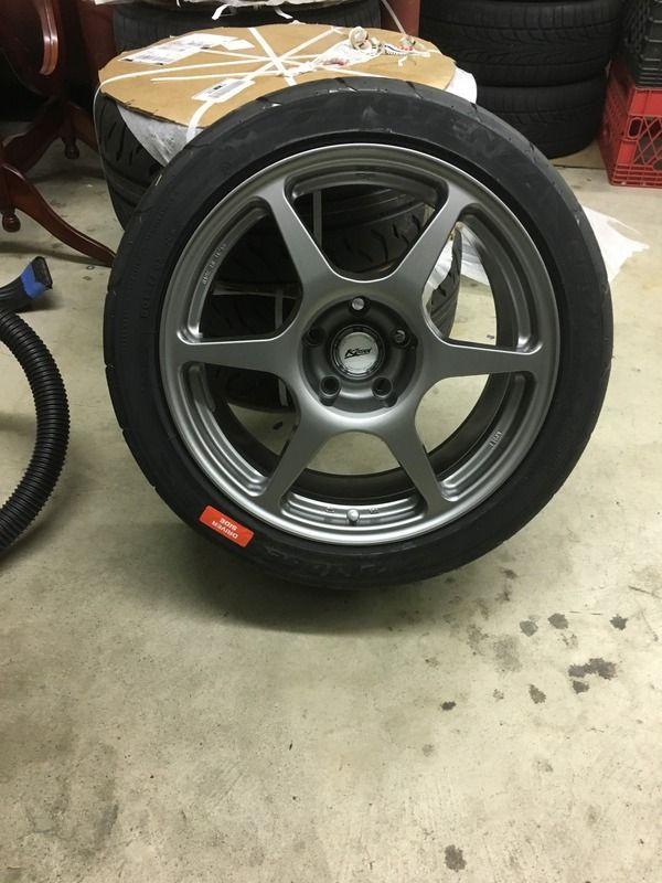

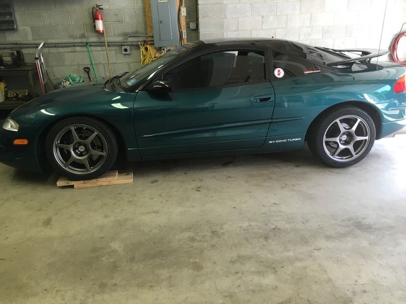

So, at this point, I got tired of making excuses for myself due to the tires I had. Things were looking good so I ordered a set of wheels and tires from Tirerack. The wheels are on closeout as well so that helped me with the decision.
17x9 Kosei K6r wheels with a +35 offset. Tires are Bridgestone RE71R in 245/40/17 size.
Initial impressions... OMG can't believe how much grip these things have. My yoko's have much stiffer sidewalls so turn-in was a tiny bit more crisp. However, the increase in overall grip is tremendous. Plus a much smoother ride. The new wheel/tire package is exactly 2.5lbs lighter per corner. Advertised weights showed a 5lb difference, but actual weights came in at 2.5lbs. 45.6lbs vs 43.1lbs. 10lbs of rotating weight is good so i'll take it. T25 needs as much help as possible.

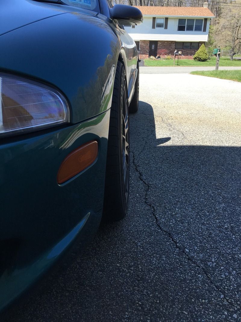

Random shot while setting the ride height. I also took out a few spacers from the rear control arms for a bit more negative camber. Noticed my current tires were wearing a bit faster on the outside.

I installed the braces a week or so before putting on the new wheels/tires. Steering response increased and turn-in felt much better. They also seemed to have cured a bit of off and on throttle understeer. Heavy braking feels more stable as well. I'm very happy with them. If Kevin charged double what does, I would have still bought them.
