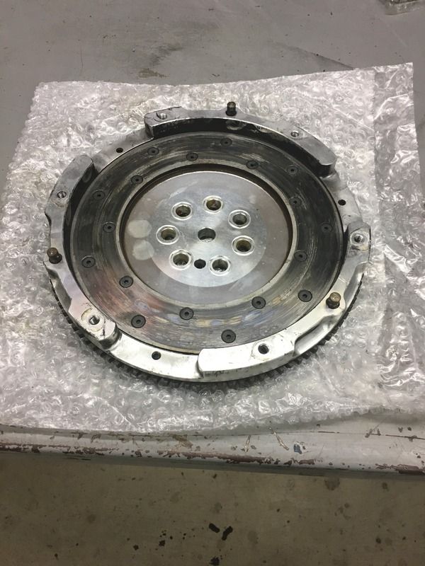

On a positive note, I replaced the flywheel with a Clutch Masters 8lb aluminum unit.
11lbs lighter than stock. I actually had this thing in storage and completely forgot about it until now. After measuring the step height with a set of digital calipers, I installed it as is. It had very minimal miles on it. Excited to remove 11lbs off the front end. I also measured my clutch disc and it still has quite a bit of life left. What didn't have much life left were my front brake pads. Replaced with the same Wilwood PB-10 compound. They warm up relatively quickly so I'm happy with them.

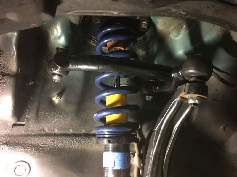

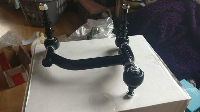

Over the last few months, Bobby Gould (@ec17pse) and I have been discussing him designing adjustable upper front control arms. As you are aware, he has made a prototype set which are being tested on his car. He also made a 2nd set which are now on my car. Being that I put my car through its paces and the amount of stress autocross does to the car's suspension, Bobby felt that I could give them a good stress test.
They feel very well built and very high quality. I got them on last weekend and rushed for an alignment before the Saturday event.

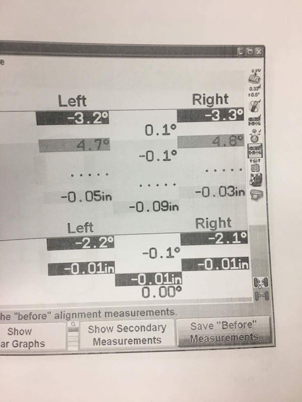

I have Paul Volk's lower front arms on my car and I do use them to increase front track width. When this happens, you lose caster. My car has never had good caster. Bobby's new upper arms have helped me gain that caster back and also get both sides near equal. (2g's run unequal caster when using the stock compression arms.) Honestly, there is still more caster to be gained, but I was in a bit of a rush to get these on and the car aligned in order to not miss the events this weekend.
Setting the camber and caster is quite easy, honestly. The megan arms were more of a pain to deal with and they still used the stock anchor bolts. With Bobby's arms, you get adjustment at all points, and also a little increase in roll resistance. What took me by surprise was how well the steering response now is. An unexpected positive as I already had prothane bushings. The front end feels more solid and the increase in caster also helped keep the car more steady on the highway. I've put about 200 street miles on them (on NJ shitty roads) including 12 autocross runs and so far so good. The best part is how well the front end responds to steering input. Catching the car in mid slide or after trail braking has never been so easy. Very confidence inspiring and the results speak for themselves....

Would like to send a big thanks to Bobby! His arms performed flawlessly and helped me attain one of my best performances to date. You're the man!
I am glad i can help you progress and glad you are happy with them and the results they give you, also big thanks for testing them for me. I wanted an outsiders view on these because these are much needed in our community and while i can be as honest as i can and spec list the details etc etc, it helps from someone elses view and physical contributions aswel with real world feedback of the part to the group!

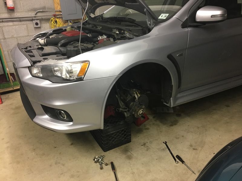

Talon is still down so needed to find a seat for the last event. My buddy Chris was nice enough to let me jump in his STU prepped Evo X with him. This car is in class B under the MSNE ruleset. This is the same guy/car that always seems to snip me by 3 to 5 tenths at the SCCA events in overall raw time. Should be a good test to see if me driving the Talon just couldn't keep up with him or if he is just that much of a better driver than I.
Results speak for themselves... 2nd in class and 3rd in overall PAX, falling behind to two gentlemen who have multi national championships each. I was able to beat Chris by 4 tenths and Jonny by slightly over 1 sec. I'm very happy to say that Chris did not out drive me, but rather the Talon is just not on the same level of a prepped Evo X.
